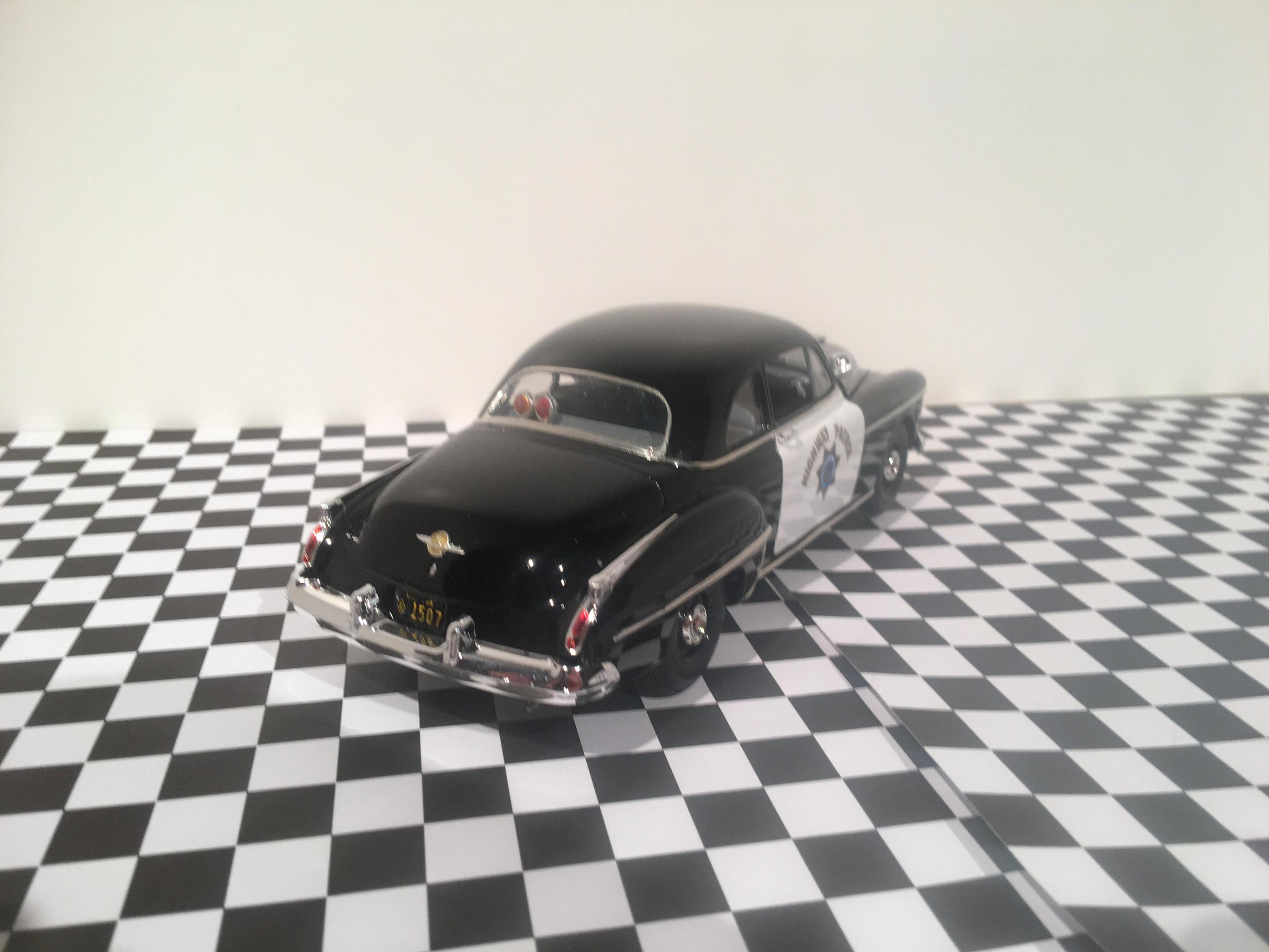

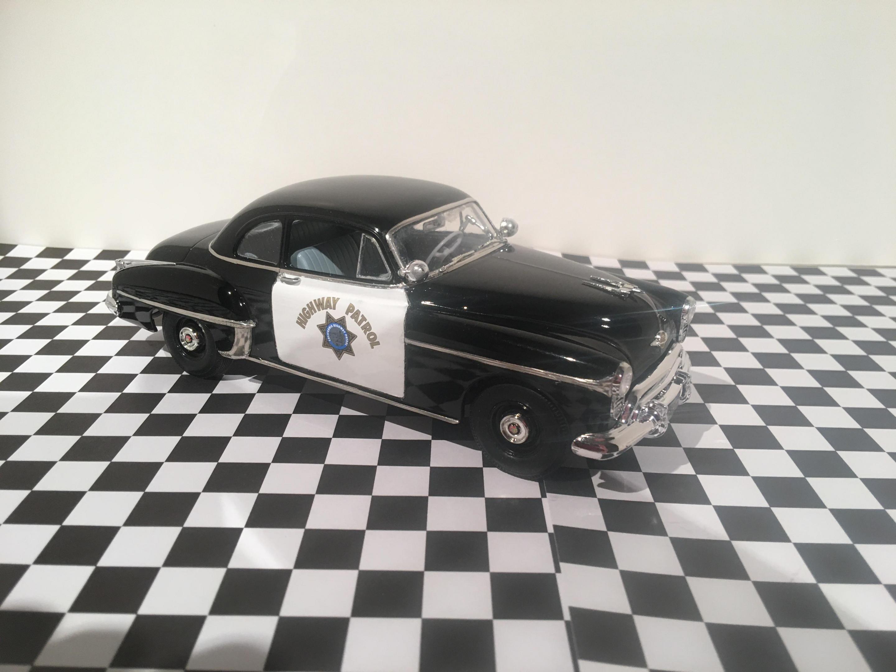

espo Posted May 4, 2020 Share Posted May 4, 2020 (edited) "50 Oldsmobile California Highway Patrol Car. Built basically out of box with modifications to look like a patrol car from that era. The door decals are from Chimneyville Hobbies. The two way Radio was from the '48 Ford kit and the Spot Lights are from Galaxie '48 Chevrolet Aero Sedan kit. TT Edited May 6, 2020 by espo Quote Link to comment Share on other sites More sharing options...
Classicgas Posted May 4, 2020 Share Posted May 4, 2020 Well done. Quote Link to comment Share on other sites More sharing options...
Plowboy Posted May 5, 2020 Share Posted May 5, 2020 That's a cool patrol car David! I don't think I've ever seen an Oldsmobile built as a police car. Looks like it has all of the period details. Nice work! Quote Link to comment Share on other sites More sharing options...
espo Posted May 5, 2020 Author Share Posted May 5, 2020 8 hours ago, Plowboy said: That's a cool patrol car David! I don't think I've ever seen an Oldsmobile built as a police car. Looks like it has all of the period details. Nice work! Thank you for your comments on this. In doing a little research on the CHP web sites I found that they did indeed use '49 Oldsmobiles and in this exact body style. They have an extensive picture gallery of cars that they have used from the 1930's thru today. I remember in the '60's they had Oldsmobiles and Mercurys at different times. Quote Link to comment Share on other sites More sharing options...
Plowboy Posted May 5, 2020 Share Posted May 5, 2020 20 minutes ago, espo said: Thank you for your comments on this. In doing a little research on the CHP web sites I found that they did indeed use '49 Oldsmobiles and in this exact body style. They have an extensive picture gallery of cars that they have used from the 1930's thru today. I remember in the '60's they had Oldsmobiles and Mercurys at different times. Sorry David. I should have been more clear. I meant I don't think I've ever seen an Oldsmobile model built as a patrol car. I bet there were a lot of full scale Oldsmobile police cars in 1950 with Ford still using the flathead and Chevy still using the straight six. Quote Link to comment Share on other sites More sharing options...

Caballero_ScaleModel Posted May 5, 2020 Share Posted May 5, 2020 Hi again David I just found this post after you comment on mine! Really really nice build, the paint job is superb, really clean. It is nice for sure to see this car with the original emblems. Would love to see some photos of the interior and engine bay Quote Link to comment Share on other sites More sharing options...

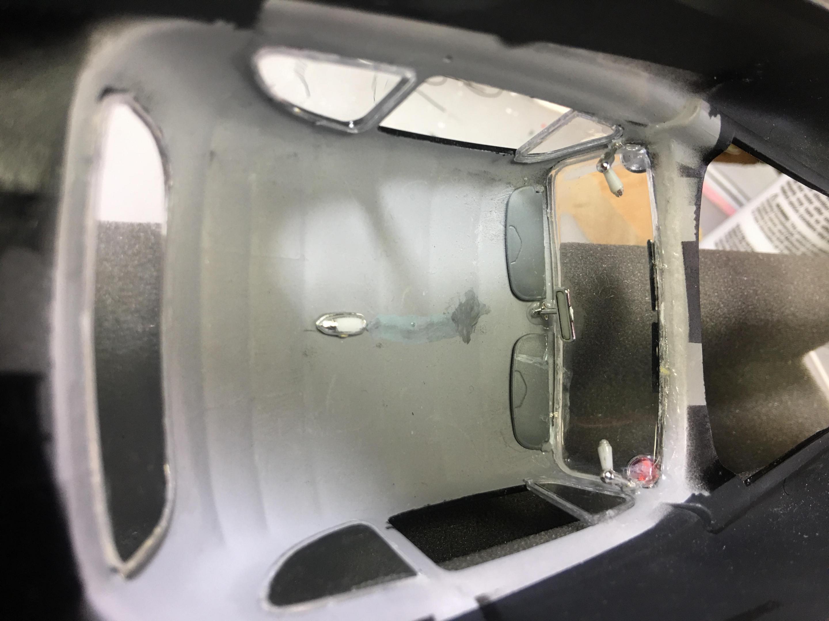

espo Posted May 6, 2020 Author Share Posted May 6, 2020 7 hours ago, Caballero_ScaleModel said: Hi again David I just found this post after you comment on mine! Really really nice build, the paint job is superb, really clean. It is nice for sure to see this car with the original emblems. Would love to see some photos of the interior and engine bay I have a couple of pictures I posted before I finished. The interior is much as it would be from the factory. I removed the clock and radio since the CHP cars wouldn't have them. I used the 2 way radio from the '48 Ford kit. This should be close to what was used but there really isn't anyway to know but it looks correct to me. The two lights on the real package tray represent what they used at the time. The red and amber lights would alternate flashing when needed. I used the spot lights that are from the Galaxie '48 Chevrolet kit. The driver's side is red an d the passenger side is clear. Quote Link to comment Share on other sites More sharing options...

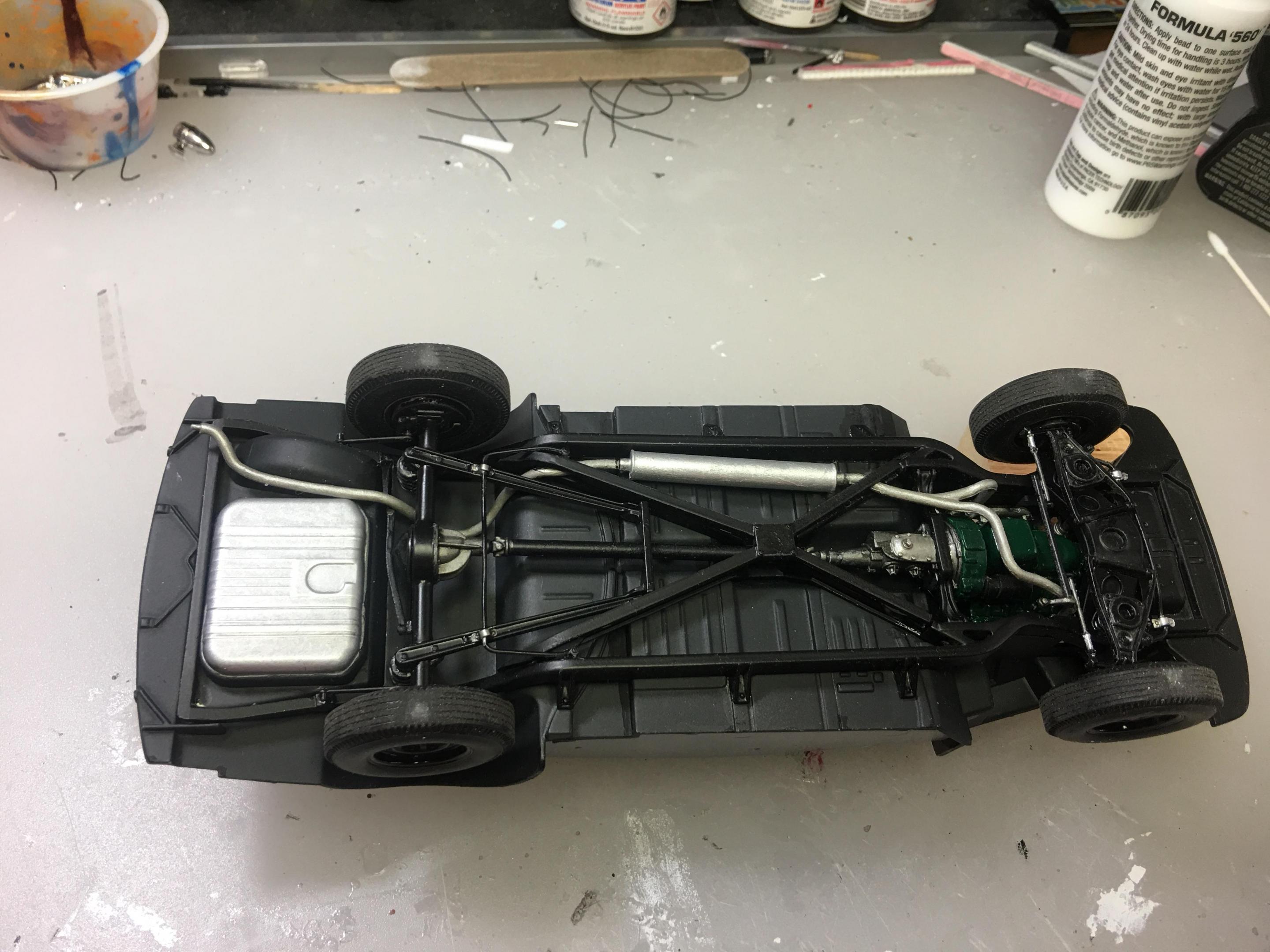

espo Posted May 6, 2020 Author Share Posted May 6, 2020 7 hours ago, Caballero_ScaleModel said: Hi again David I just found this post after you comment on mine! Really really nice build, the paint job is superb, really clean. It is nice for sure to see this car with the original emblems. Would love to see some photos of the interior and engine bay The engine is built stock with spark plug wiring added but with all the other parts of the engine compartment you wouldn't notice that. The chassis is also stock and detailed only using different shades of black and some dark metal colors. Quote Link to comment Share on other sites More sharing options...
Caballero_ScaleModel Posted May 7, 2020 Share Posted May 7, 2020 On 5/6/2020 at 3:16 AM, espo said: The engine is built stock with spark plug wiring added but with all the other parts of the engine compartment you wouldn't notice that. The chassis is also stock and detailed only using different shades of black and some dark metal colors. Really nice interior details David, I like the addition of the 2 way radio very much. The engine compartment looks great, it happened the same to me with my Oldsmobile, after the effort on wiring the engine you can hardly see it when finished ? What model are you working on right now? Quote Link to comment Share on other sites More sharing options...
GLMFAA1 Posted May 7, 2020 Share Posted May 7, 2020 Nice job on kit, radio needs antenna greg Quote Link to comment Share on other sites More sharing options...
espo Posted May 7, 2020 Author Share Posted May 7, 2020 1 hour ago, GLMFAA1 said: Nice job on kit, radio needs antenna greg Your right, and I was trying to come up with something. The photo from the CHP Archives show the antenna mounted on the drivers side just below the C Pillar and above the rear fender. Maybe when they start letting us out of the house I'll look for something in the Doll House section at HL. Quote Link to comment Share on other sites More sharing options...

NOBLNG Posted May 12, 2020 Share Posted May 12, 2020 Excellent job on this. That upholstery looks amazing! Quote Link to comment Share on other sites More sharing options...
espo Posted May 12, 2020 Author Share Posted May 12, 2020 10 hours ago, NOBLNG said: Excellent job on this. That upholstery looks amazing! Thank you. I used Scale Motor Sport decals for the pattern. They offer several different patterns but are delicate and easily torn when applying. Quote Link to comment Share on other sites More sharing options...
Agent G Posted May 12, 2020 Share Posted May 12, 2020 The build looks great. Lots of possibilities with that kit. Get a ball headed straight pin, cut the pin shaft 1/4 inch from the ball. Take a disc of styrene about the same diameter of the ball, drill a small hole in the center and insert the cut off pin shaft through it. Now you have the base and the attachment flange. Drill another small hole in the ball at a 90' angle (or other suitable angle) from the pin shaft. Insert a suitable length of straight wire, I use .015 music wire, as the antenna itself. (I don't care if it is too stiff to bend over) Use some floral wire and wind a tight coil over the shank of a small diameter drill bit. trim it to length and slide it over the antenna. Now you have the ball mount with mounting flange, spring assembly and whip. Drill a small hole in the appropriate location on the fender and use the cut off pin shank as a mounting pin. Here's my take. here's a better illustration. G Quote Link to comment Share on other sites More sharing options...
espo Posted May 13, 2020 Author Share Posted May 13, 2020 20 hours ago, Agent G said: The build looks great. Lots of possibilities with that kit. Get a ball headed straight pin, cut the pin shaft 1/4 inch from the ball. Take a disc of styrene about the same diameter of the ball, drill a small hole in the center and insert the cut off pin shaft through it. Now you have the base and the attachment flange. Drill another small hole in the ball at a 90' angle (or other suitable angle) from the pin shaft. Insert a suitable length of straight wire, I use .015 music wire, as the antenna itself. (I don't care if it is too stiff to bend over) Use some floral wire and wind a tight coil over the shank of a small diameter drill bit. trim it to length and slide it over the antenna. Now you have the ball mount with mounting flange, spring assembly and whip. Drill a small hole in the appropriate location on the fender and use the cut off pin shank as a mounting pin. Here's my take. here's a better illustration. G Great looking Patrol Cars. Your Olds is on the order of what I was thinking, just wasn't sure how to pull it off. Thank you for your input. This is the first Squad I have ever tried and my fear was I would screwup the body and paint. Now with a road map maybe I can get it looking a little more complete. The mouse ears lights on the Olds just don't look right to me, but I'm sure there were agencies that did it that way. I also like the '49 or '50 Ford coupe CHP car. Who did you get your door decals from ? Quote Link to comment Share on other sites More sharing options...

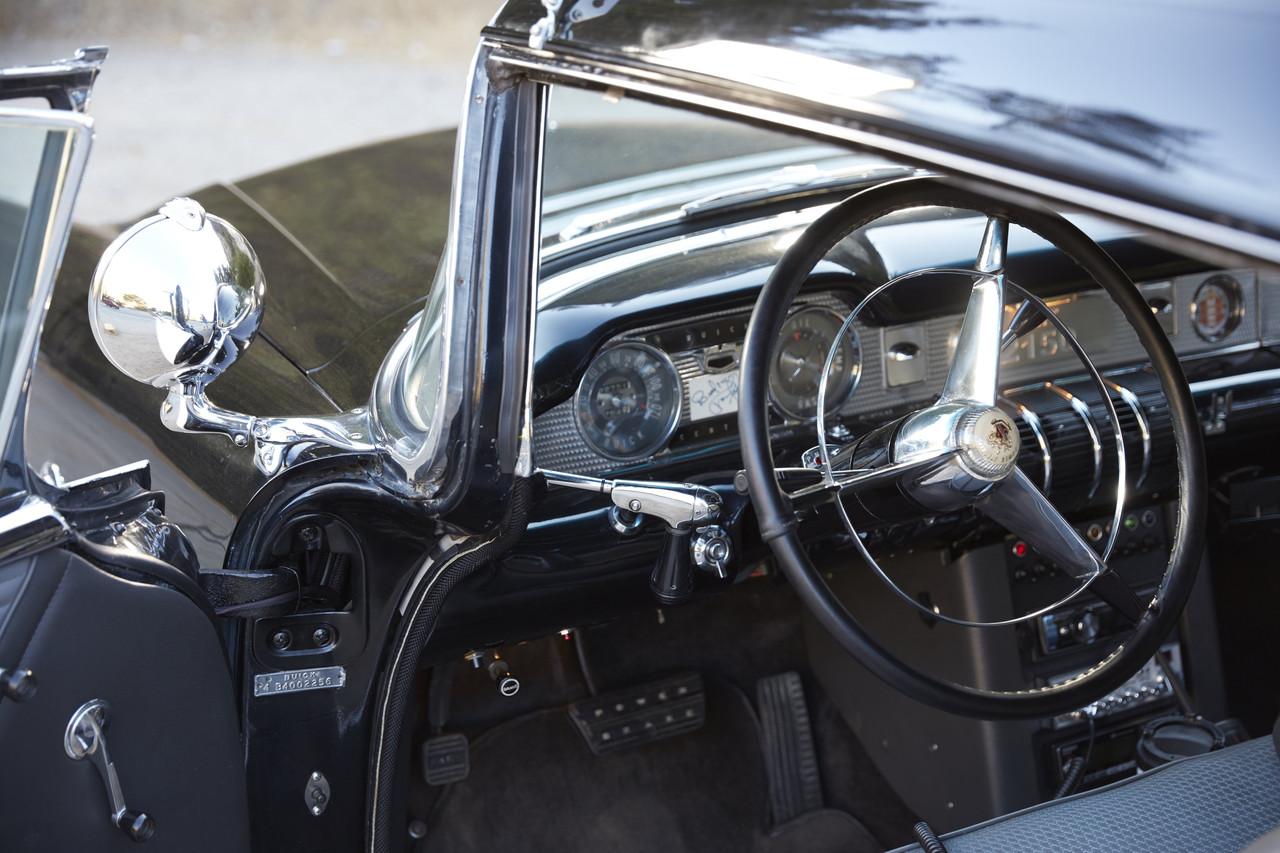

Mike999 Posted May 13, 2020 Share Posted May 13, 2020 (edited) Nice clean build! Looks awesome. Here are a few pix that may help you, or anybody doing an early CHP car. I found these when building the Maisto '55 Buick CHP car. (It's over in the Diecast section.) The second pic is an early General Electric police radio used by the CHP. The third pic shows the radio installation in a CHP '55 Buick. The fourth pic is a "tribute" '55 Buick, not an original, but it shows the typical spotlight mounting in CHP cars. Look closely and you can see Broderick Crawford's autograph between the gauges! The last pic with the cop in the car is also a '55 Buick. The switchbox under the dashboard at the far left controls the lights and siren. Edited May 13, 2020 by Mike999 omit4 Quote Link to comment Share on other sites More sharing options...
