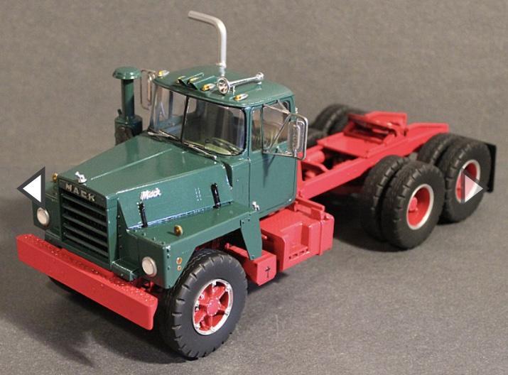

I went back and did a deeper Google search and found that they did in fact make a steel hood R truck. So, the question still remains, can a hood from the AMT DM-800 fit a R685ST truck to make a R Steel hood like in the picture? In other words, kit bash without the need for a resin body.

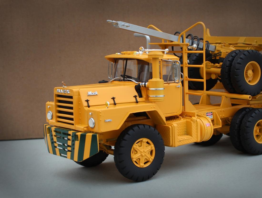

Here’s one of Dave’s (AITM) he used his flat back cab. The flat Back was made from late 1965-73. They add 3” to the back of the cab in 73. I’m not sure what your asking are you building a Mack DM600 short steel hood? If so I would buy one from Gary Wallace. He sells the hood only and use the new AMT/ MPC Mack DM600 or DM800. Yes you can take a MPC Mack DM800 and Married it up with a AMT Mack R model cab.  You will have to Re-Fab the top of the hood and make the back of the fenders If you want I can take some pics of the one I got from Dave. Hope this helps
