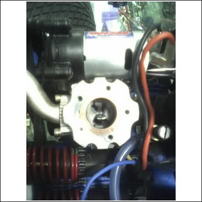

Joe Handley Posted July 23, 2009 Share Posted July 23, 2009 Had a customer bring in a 3.3 Revo that had just been tuned by another area hobby shop and it quit shortly after he got the truck home and started driving it For some reason the piston got stuck half way up the sleeve on the compression stroke (Dad thinks it was run HOT sometime very recently, most likely by the guy who "tuned" it for this customer) and the crank and rod kept going. The rod split length wise in two after getting shoved into the wrist pin and continued it's path through the top of the piston before the rod and crank finally stopped just short of the head and plug! Quote Link to comment Share on other sites More sharing options...
dwc43 Posted July 23, 2009 Share Posted July 23, 2009 Wow. So that's the pic that did not show up in that e mail you sent me last night. Never seen a rod split like that before. I guess anything can happen at 40,000 rpm. Quote Link to comment Share on other sites More sharing options...
Joe Handley Posted July 23, 2009 Author Share Posted July 23, 2009 Yup, I resent the pic tonight too David, I think the crank finally stopped turning when the big end of the rod got near the wrist pin. Quote Link to comment Share on other sites More sharing options...
dwc43 Posted July 23, 2009 Share Posted July 23, 2009 Yup, I resent the pic tonight too David, I think the crank finally stopped turning when the big end of the rod got near the wrist pin. That would do it. Or it just locked up from the heat. You should find black on the parts if it's heat related. I spun a 3 and 4 rod bearings on a 323 race engine one night at 68 to 7200. It was an oiling issue. That's when we started feeding the crank from both ends. The rods were black from the heat and lack of oil. Quote Link to comment Share on other sites More sharing options...
Joe Handley Posted July 23, 2009 Author Share Posted July 23, 2009 We never pulled the motor apart, the guy is probably going to exchange it for a new 3.3 Quote Link to comment Share on other sites More sharing options...
steve_b Posted July 24, 2009 Share Posted July 24, 2009 I actually have seen that before...couple time.... on a boat when it capsized at full throttle and hydrolocked, if tore it up exactly like that. but, that really looks like a lean burn seizure....(but, it sounds sooooo cool when they bumblebee out like that) *sigh* hope they don't let the same person tune the next one Quote Link to comment Share on other sites More sharing options...

Joe Handley Posted July 24, 2009 Author Share Posted July 24, 2009 I actually have seen that before...couple time.... on a boat when it capsized at full throttle and hydrolocked, if tore it up exactly like that. but, that really looks like a lean burn seizure....(but, it sounds sooooo cool when they bumblebee out like that) *sigh* hope they don't let the same person tune the next one Apparently this one sounded a bit like a V-Twin when he fired it for the first time after getting it back from this shop. The guy who ran that shop called the one I work for asking if the guy was telling the truth because he was trying to get a new engine for his truck from this shop because of this. Sounded like from now on he will be shopping with my store from here out for his hobby needs. Wouldn't you get better responses to your question if you go to an RC website? I am not being rude or anything and I am sure you have a handful of guys that like RC here but the question just doesn't fit quite right in this forum..... I was just showing a carnage pic here, figured that even though it was RC related, there might be a few good stories in 1:1 and smaller scales that would match this pic Quote Link to comment Share on other sites More sharing options...
Joe Handley Posted July 24, 2009 Author Share Posted July 24, 2009 I dabble in a little R/C, as does Gregg, and, I'm sure, others who post here, so the occasional R/C post does not offend me in the least, so long as it doesn't get out of hand. Joe, if you wanted to see a totally fried motor, you should've seen the Traxxas 2.5 the guy brought into the shop where I work awhile back. It was in a vehicle a guy had bought off a kid for $50, and the kid had completely disregarded the break-in procedure. That thing was toast! We've had a few engines come in like that, especially the early 2.5's, but this it the first one I've seen where the rod actually split on the wrist pin and punched through the top of the piston. Quote Link to comment Share on other sites More sharing options...
v8horsepowercj Posted July 24, 2009 Share Posted July 24, 2009 Looks like the guy tuning really knew what he was doing I have a traxxas Jato with the 3.3 in it I run it on 30% and with a slightly rich ( safe ) tuneup it makes so much power you can't keep the front end on the ground. I can't for the life of me figure out why somone would spend that kind of cash on an RC and disregard the break in and tuning instructions????? But hey he did provide the customer with a really nice wrist pin inspection port (HOLE) LOL Chris Quote Link to comment Share on other sites More sharing options...
