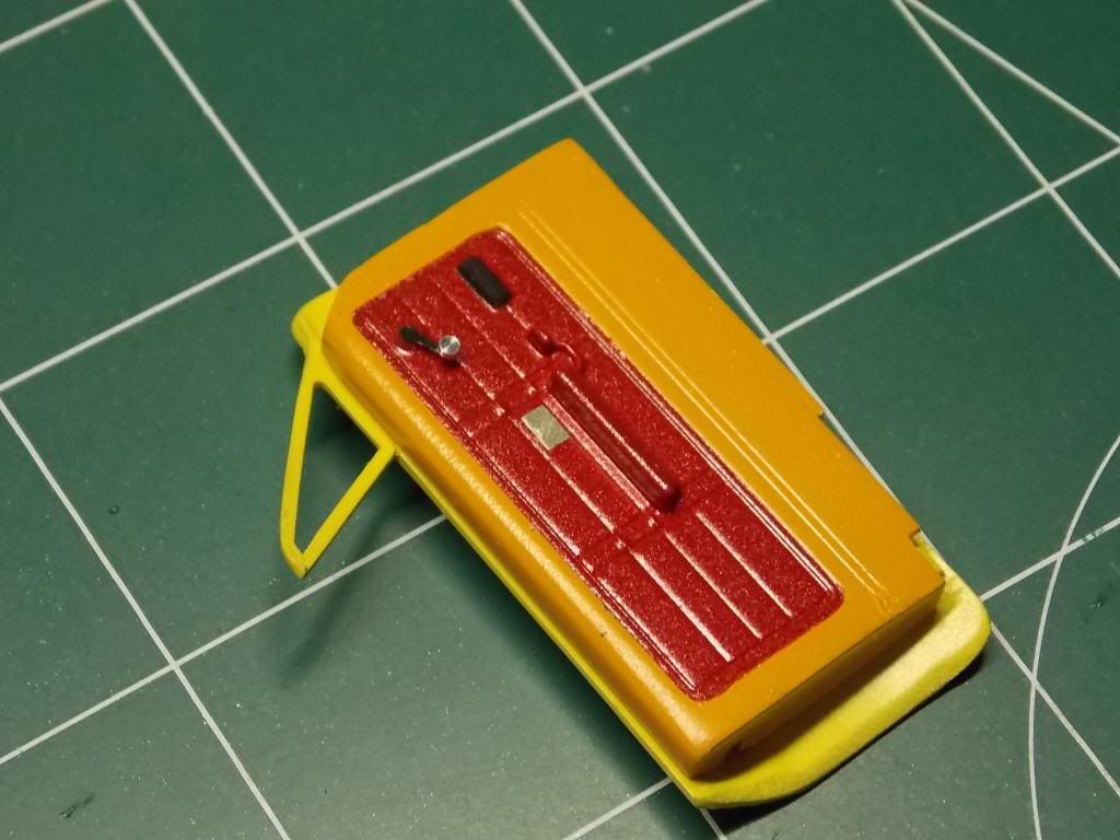

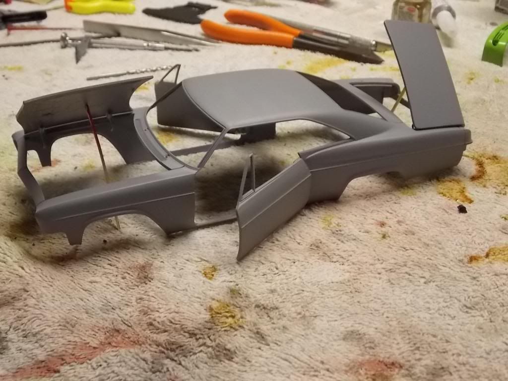

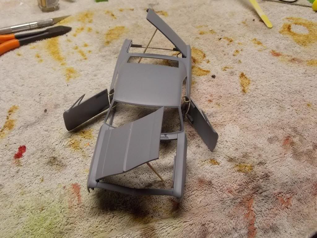

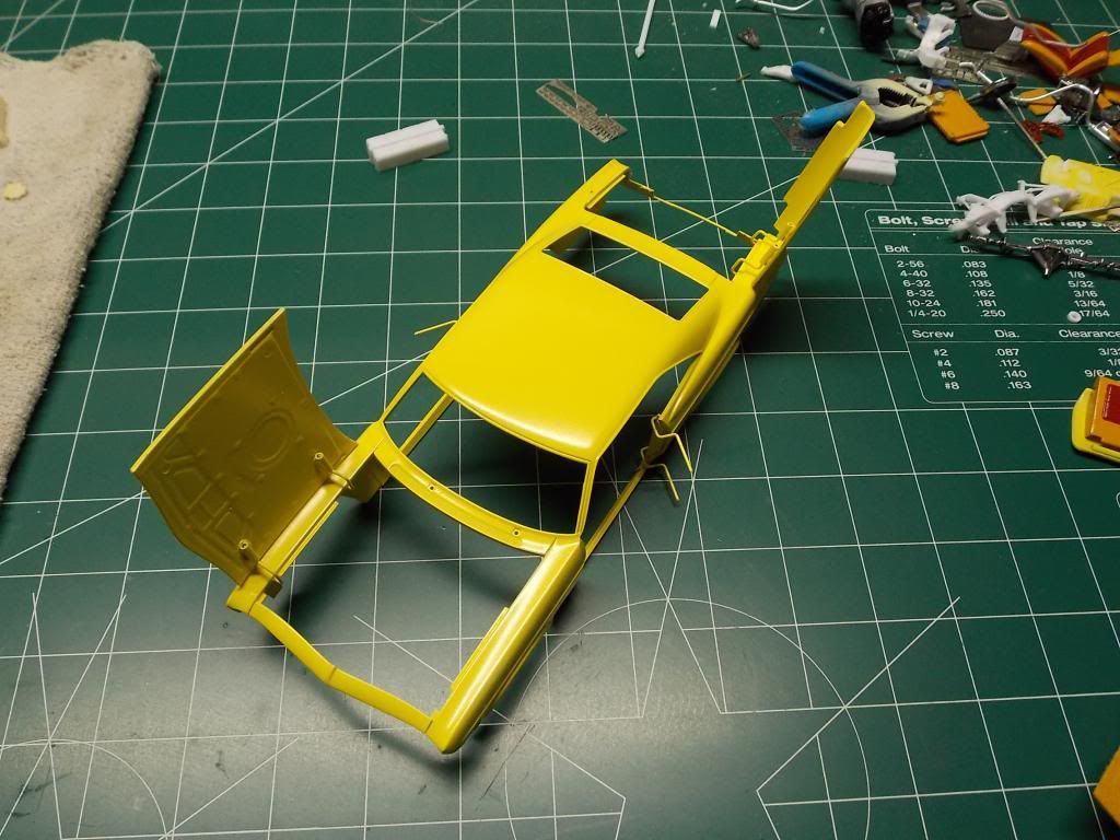

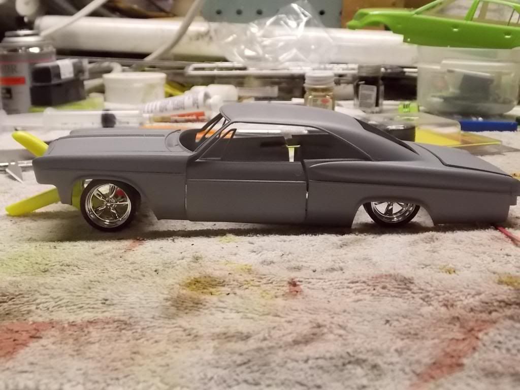

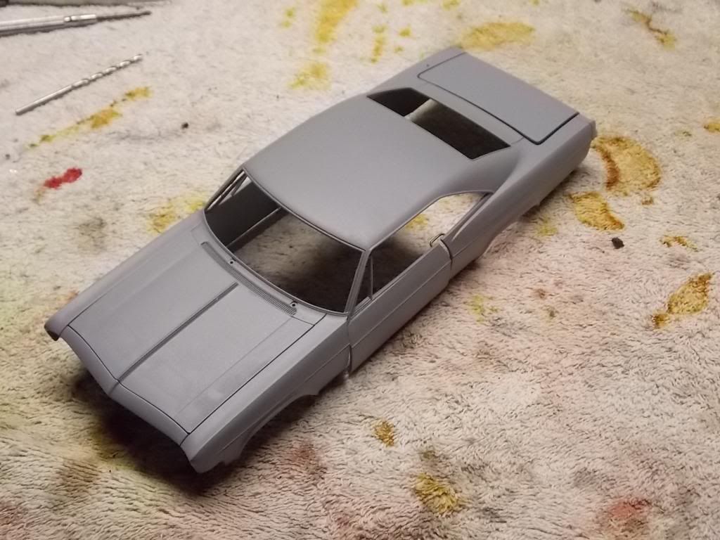

Christopher J Posted February 28, 2013 Posted February 28, 2013 Not too long ago a buddy of mine had a 66 SS that he had a bad paint job on and gave up on the model. He knew I wanted to try some things on a model and rather than risk messing up a new one he gave me this one. The paint had reacted with the body and it looked like finely wrinkled fabric.. I can't remember the type of paint but the plastic DID NOT like it!! It was dipped in easy off for 24 hrs which only softened the paint. Next it was put in the purple potion for a little over a week. Once down to the bare plastic I started doing body work and some sanding to try and get it back to looking somewhat decent. Since I had it to practice on I decided to open it up as well, I watched a few vids of Dr Cranky's a few times and dove in. My first attempt at hinges and opening doors and trunk. Here's what the body looks like so far....
Dragfreak Posted February 28, 2013 Posted February 28, 2013 cool project!! what do you use to make the hinges for the openig body panels?

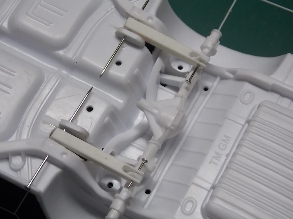

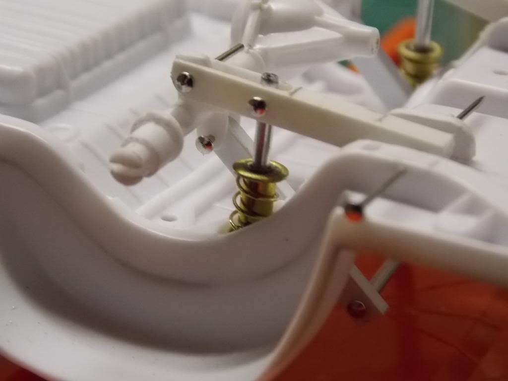

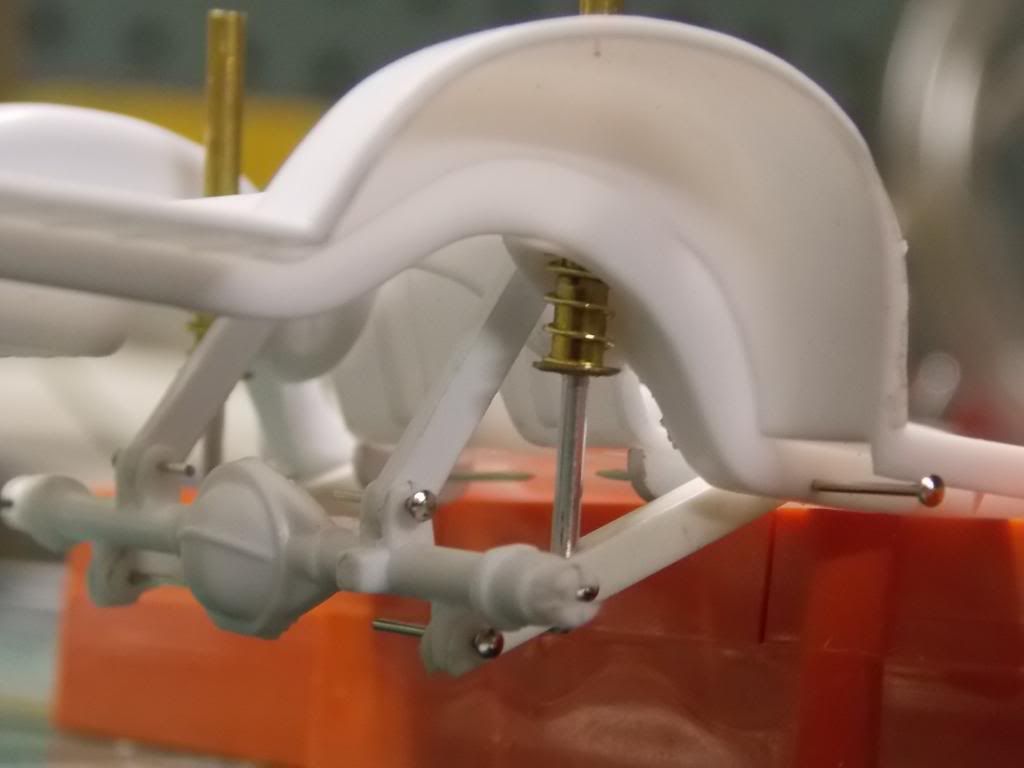

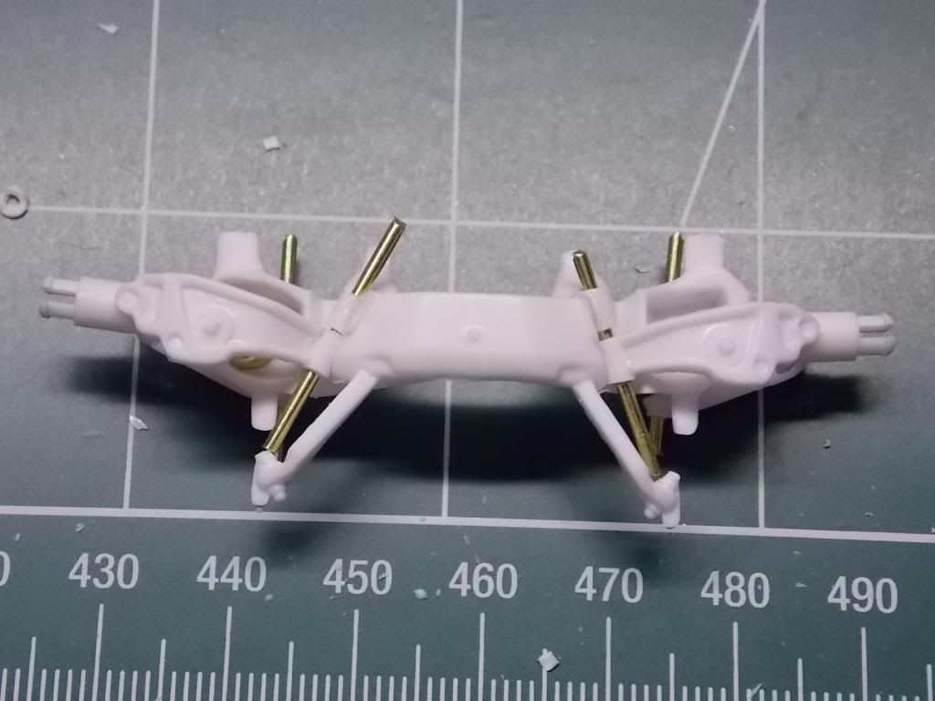

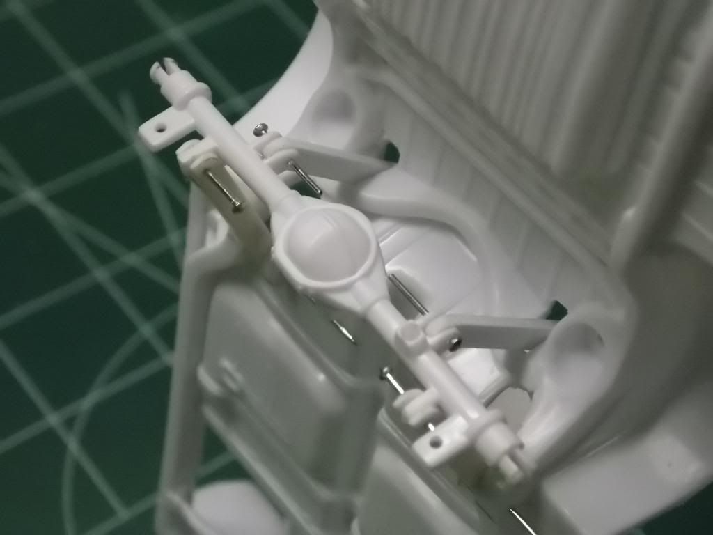

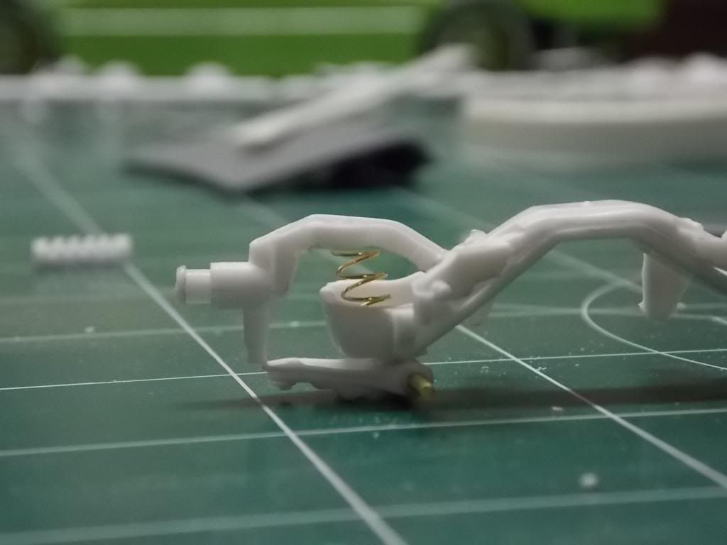

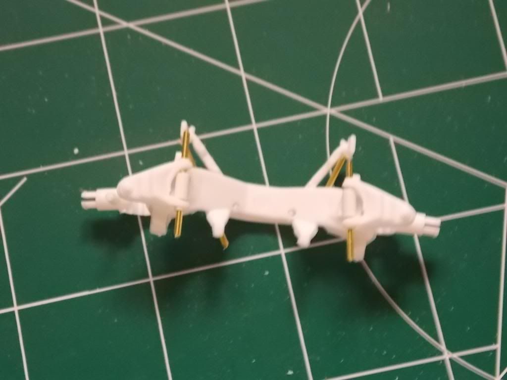

Christopher J Posted February 28, 2013 Author Posted February 28, 2013 While tinkering with trying things since I'm thinking of making this a mix of a custom street/lowrider I decided the suspention needed to be funcional so I can display and different attitudes..... The front suspention was carefully cut apart, modified, and sanded then included was some styrene tube cut to needed length and brass rod cut to put things together to check for fit and operation. Down the road I'll cut the rods down to a millimeter or so under length and glue them in. Next came the rear. This took me a couple days to wrap my mind around and figure out, but so far so good... The one thing I learned on the front was to drill smaller holes so I could use smaller pins Next I'll work on cleaning it up some and making the hydraulic cylinders
Christopher J Posted February 28, 2013 Author Posted February 28, 2013 cool project!! what do you use to make the hinges for the openig body panels? Dragfreak, I use brass wire. I bought a few different guages. I was looking for somewhat easy to bend, yet strong enough to retain shape and strength. I'll have to take a look at the pakage and get back to you on the guage I ended up using. For the retainers to be able to slide the panels off and on until the final stages I use small diameter Plastruct tube. When I get ready to glue them in place I'll use E6000 glue as I found it sticks to metals rather well.

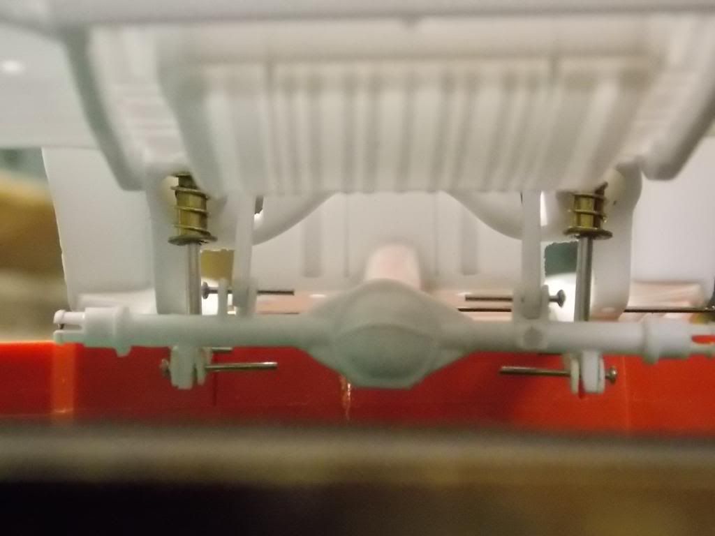

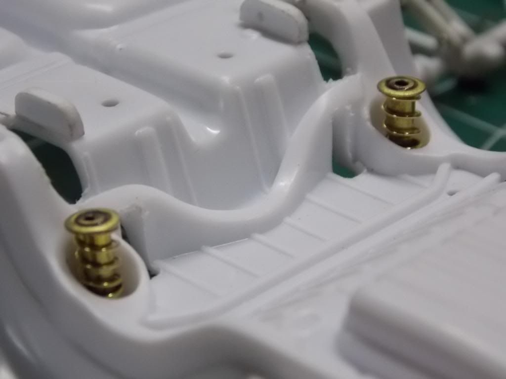

Christopher J Posted March 3, 2013 Author Posted March 3, 2013 Had a chance to get some more work done to the rear suspension last night. I looked around the parts boxes of RC Helicopter odd n ends and model boxes before I found a good way to make spring retainers. I found that the brass inserts for the servo grommets to keeps screws from smashing them were a perfect fit for the brass tube I was using. For springs I took a spring from an ink pin, cut it in half than cut it down to desired size. I used JB Weld Quick to set the brass retainers. Next I worked on the inner tube. I first slid in the square arms and marked on the arm were I wanted to drill my holes. because the tube fit perfectly in the arm I was able to use the arm to hold the tube so I could drill through it without the drill bit wandering. Next the inner tubes were cut to length and fit. I had to remove some more material from arms to allow for a little bit of swing of the inner rod depending on the suspensions position. So far here is what I have.... I believe this is pretty much final minus some sanding and cutting the pins to size before painting. Next I'll be wrapping my mind around the front shocks.

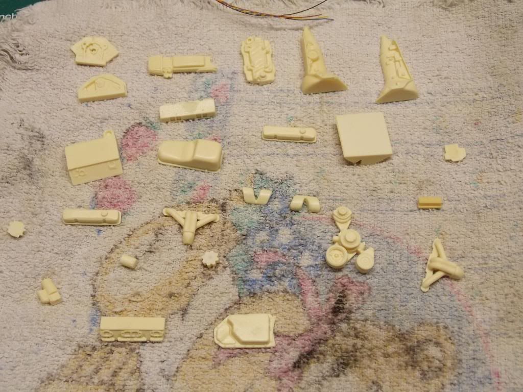

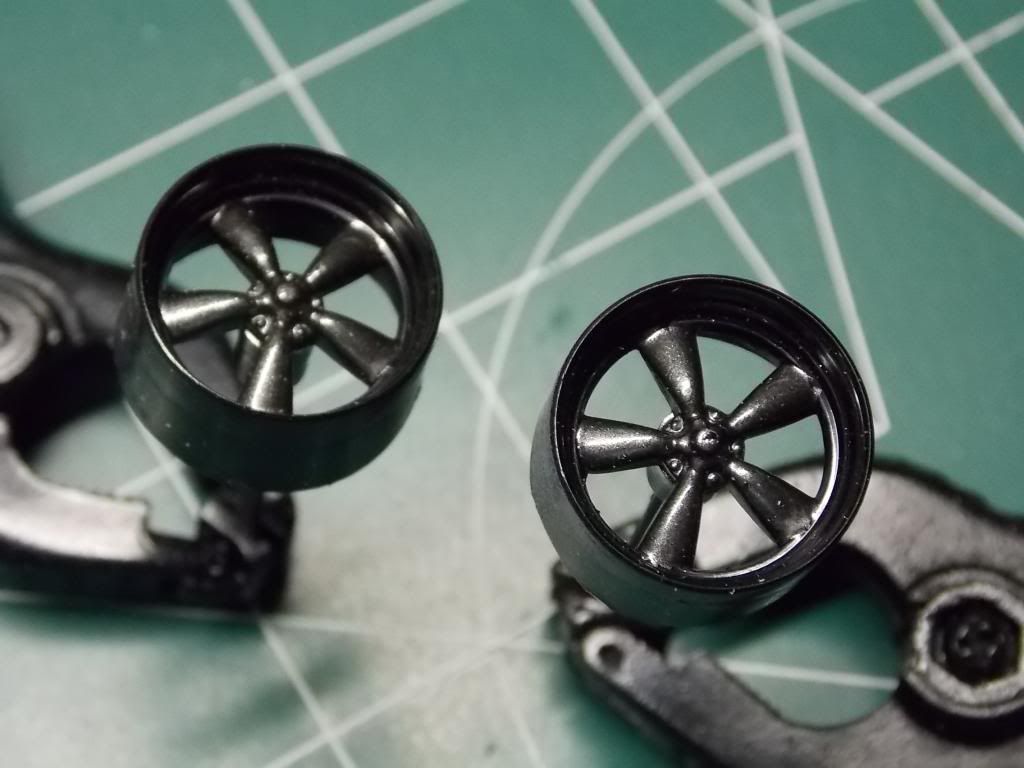

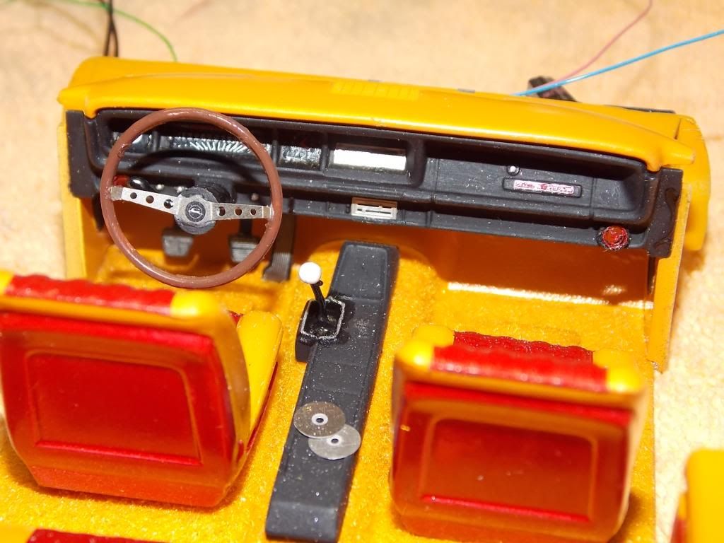

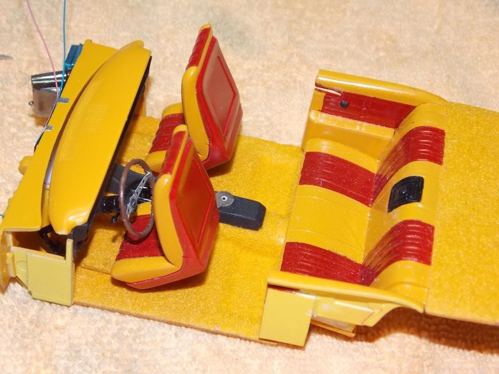

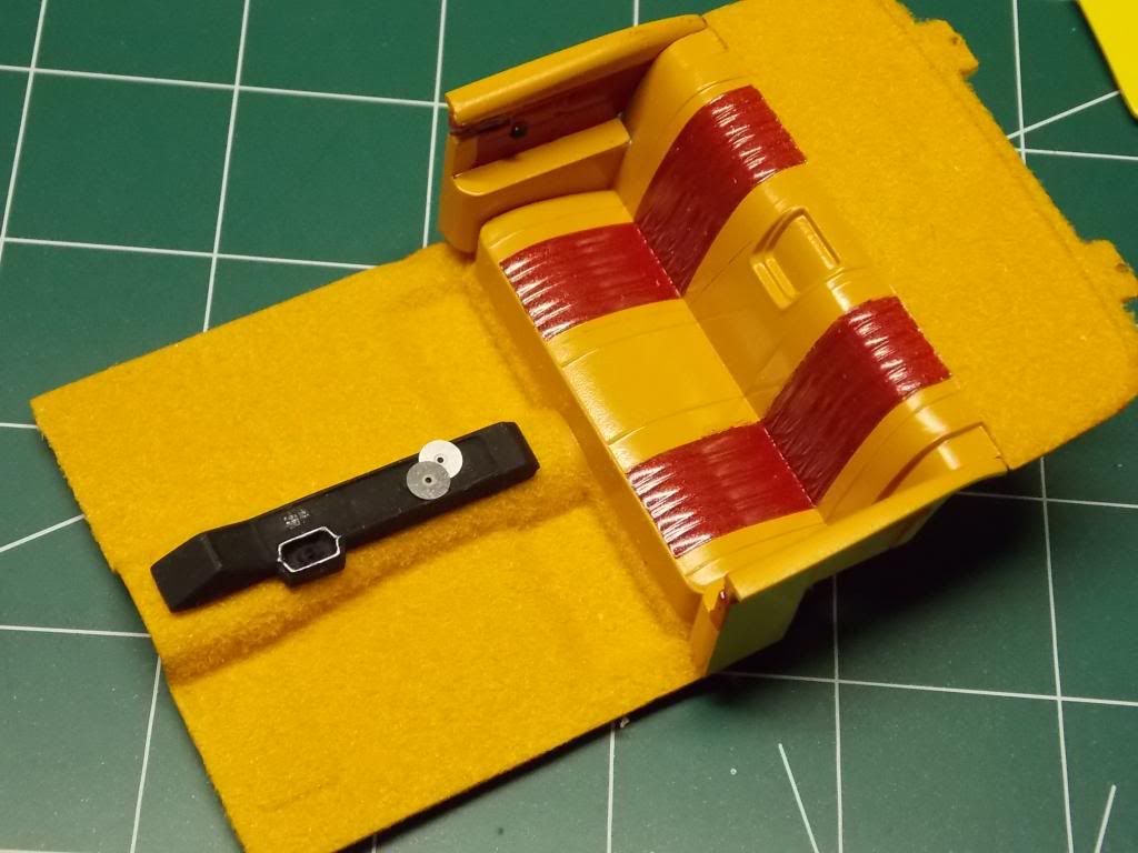

Christopher J Posted April 14, 2013 Author Posted April 14, 2013 Been busy working on several projects but have been on the 66 as well. So far the interior has been painted and flocked as well as some small details added. The kit engine partially built up and wired.... Took the 19 inch T's and stripped them. Painted the centers Gun Metal and the rims gloss black. I plan on very little chrome on the exterior. The bumpers and grill were stripped and painted black as well. After doing some looking around, I decided to go with a Ros Gibsome 350 motor for the build. Here it is after being cleaned up and washed.

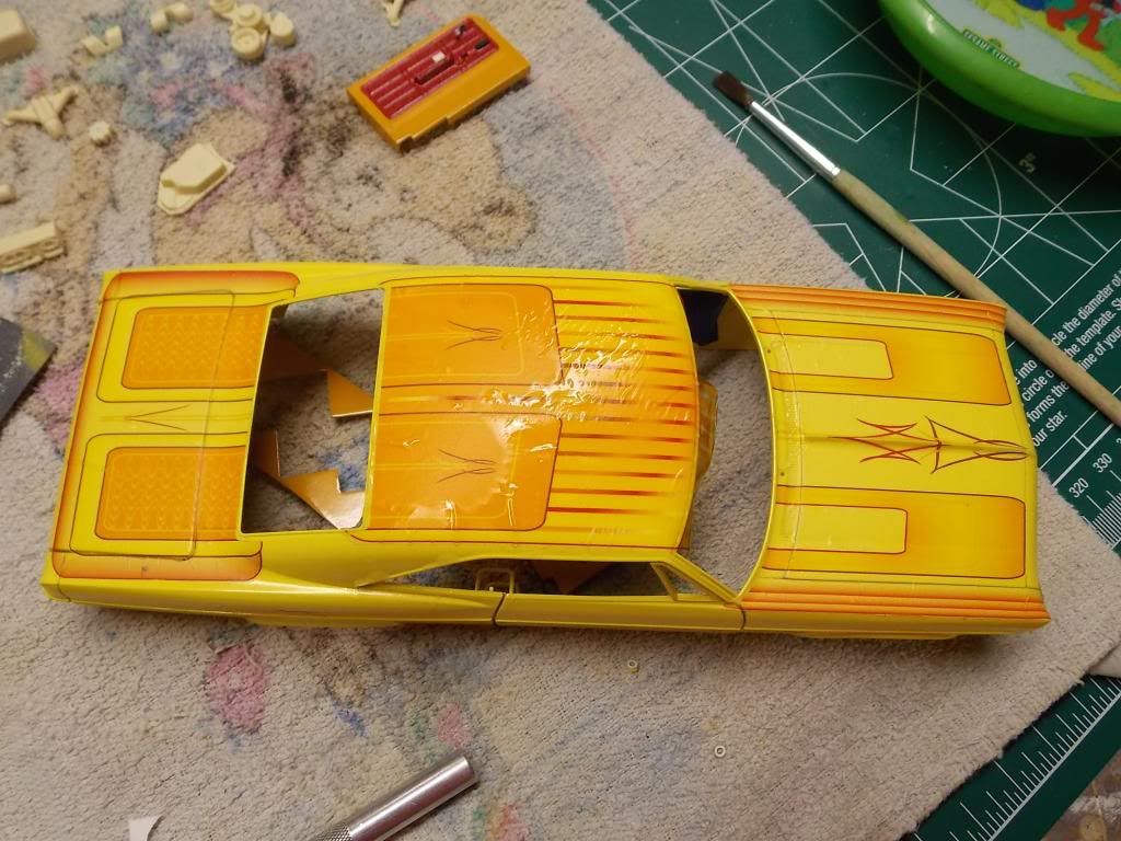

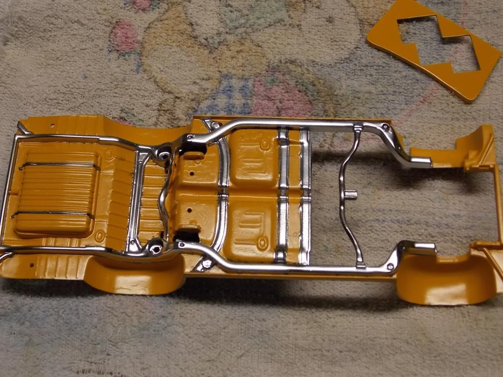

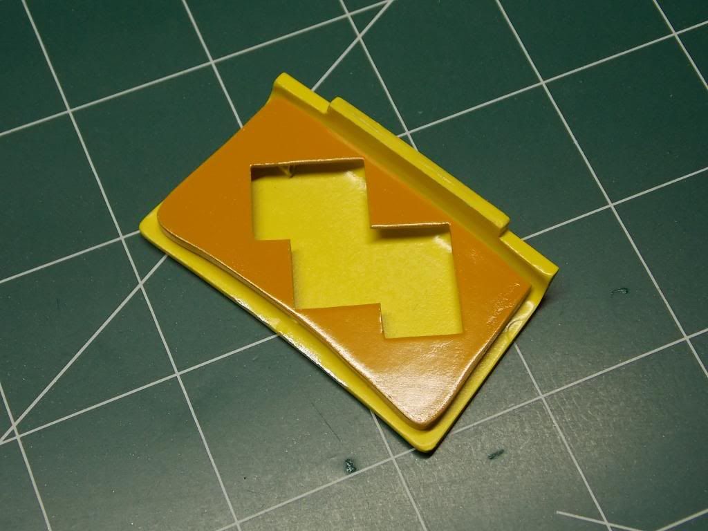

Christopher J Posted April 14, 2013 Author Posted April 14, 2013 Trunk with interior panel for the amps. The body painted The chassis... After painting a contrasting color to the body I gave it three coats of liquild mask and trimmed it out, from there I used Alclad chrome to detail it a bit on the frame sections. I ordered some decals from Franklin Ink. You can find him on the lowrider forum. He makes decals for a lot of different models in various patterns and color choices that fit very well. He also makes murals which I will be using on couple other lowrider builds. When Micro Sol and Micro Set are used they conform to the body extremly well.

Christopher J Posted April 15, 2013 Author Posted April 15, 2013 Thanks for the compliments guys. This is one of those builds where I've been pushing myself. After the roof decal settled and dried I put the side ones on and washed up the Ros Gibson engine. I'll start that tonight and post some more wip pics later.

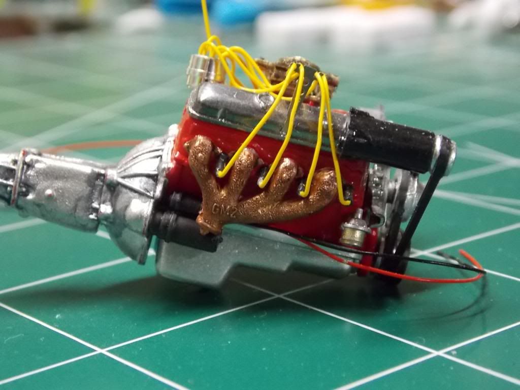

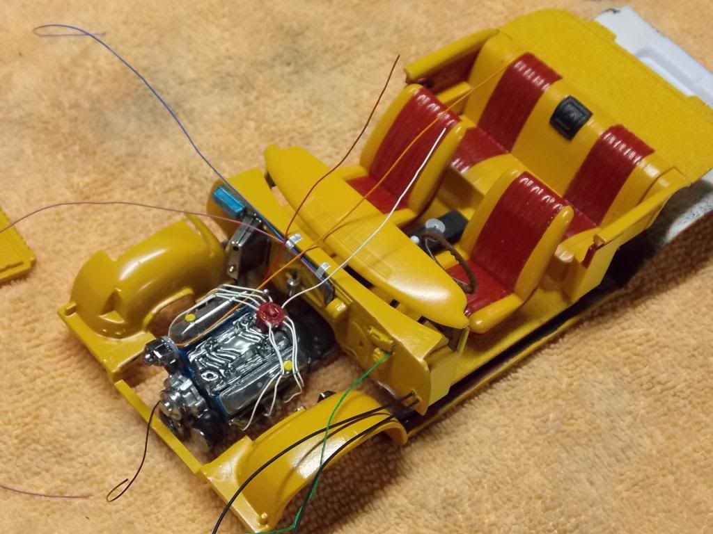

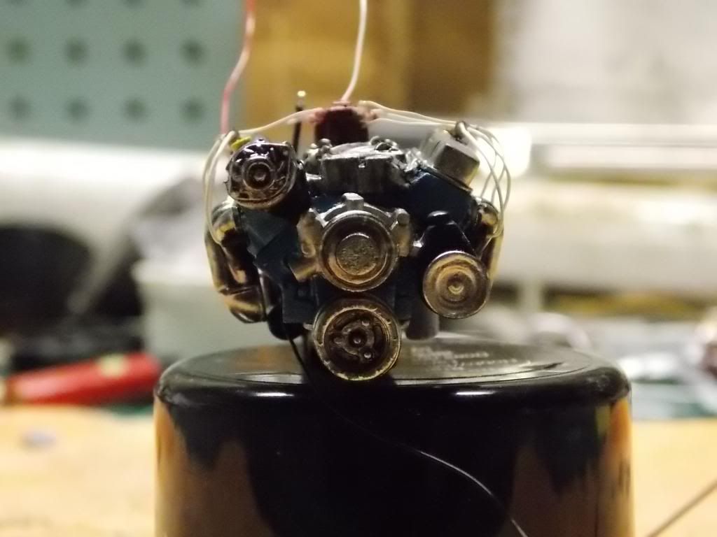

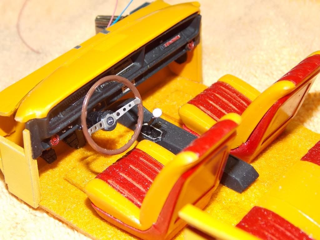

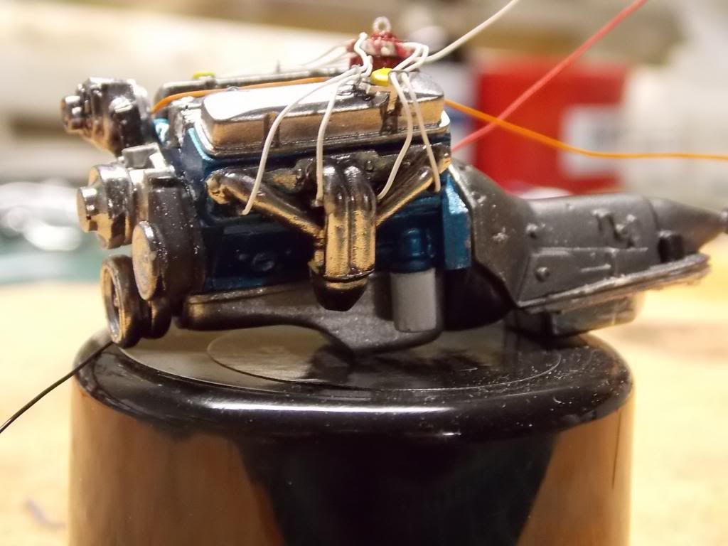

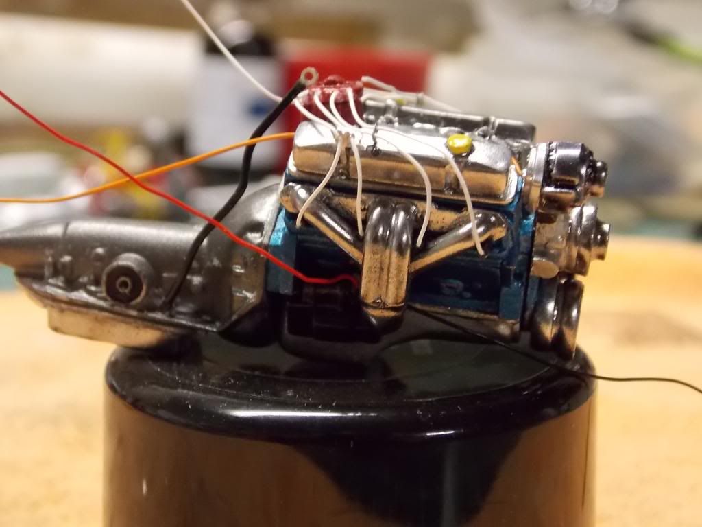

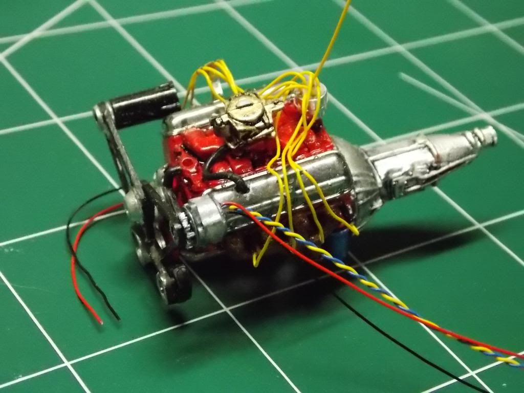

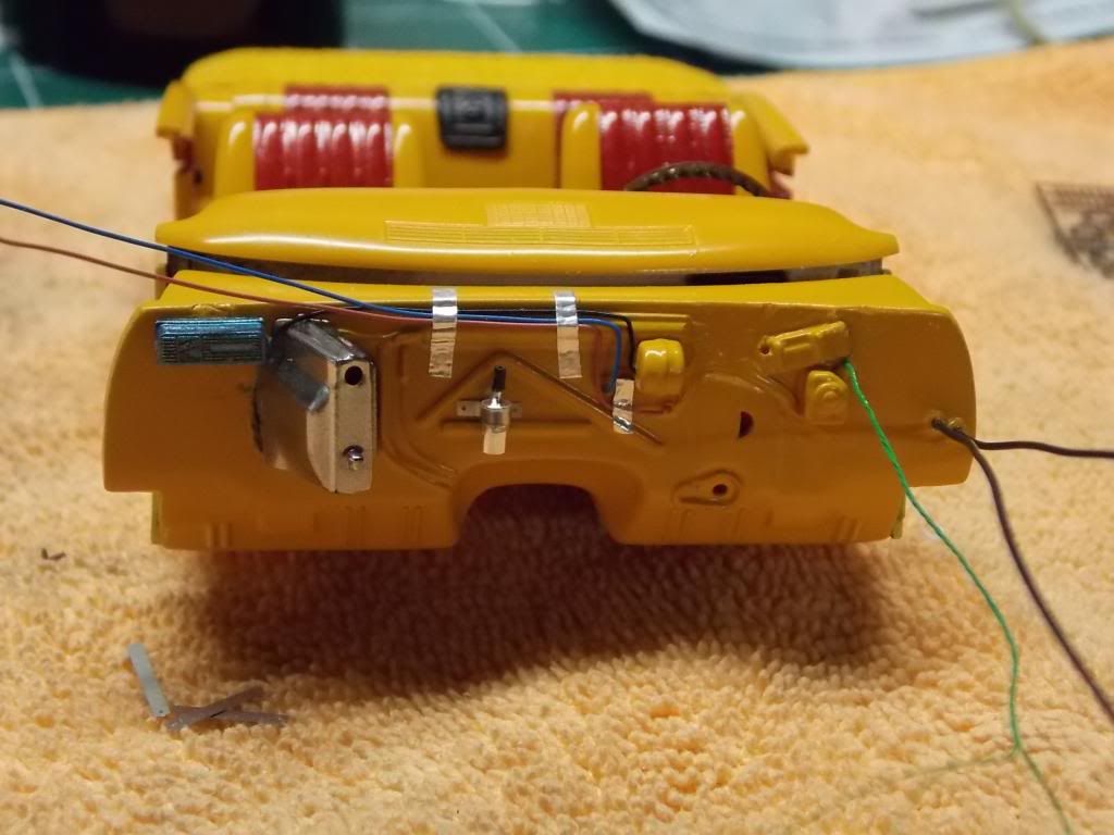

Christopher J Posted April 28, 2013 Author Posted April 28, 2013 Here's what I've got done so far....... After having to dip the engine parts a few times until the mold release finally "released" I've FINALLY 90% assembled the motor. The block is a Tamiya blue, the tranny Tamiya gunmetal, oil pan is Testors diamond dust, the rest is Alclade chrome with a black wash to help some of the detail show and not just be chromed. Next is the interior which is also close to being done. I'll need to gently clean it as it looks to have gotten a paint dust from when I was spraying a silver flake, not biggie as it wipes right off, just gotta be careful next time I'll pay attention before using that stuff and cover things up Wired up the fire wall a bit. I'm going to have to change the metal strips holding the wires they're too big and look out of place.....<sigh> Did a bit of a mockup to see what I was dealing with. If you look closely you can see the front two wires on the left of the distributor are broken away...that was on purpose. When I tried fitting the intake plenum it wouldn't go into place because it's molded for a snug fit, so rather then reshaping a chromed piece I pulled the two wires as the top of the cap is hidden under the intake extension and the where the wires exit make it appear to still look good That's it so far....next is going to be doing the BMF. I wish they made it in black since I've stripped all the other molded chrome and blacked it out...oh well. a little chrome won't hurt, I was just going for a different look.
