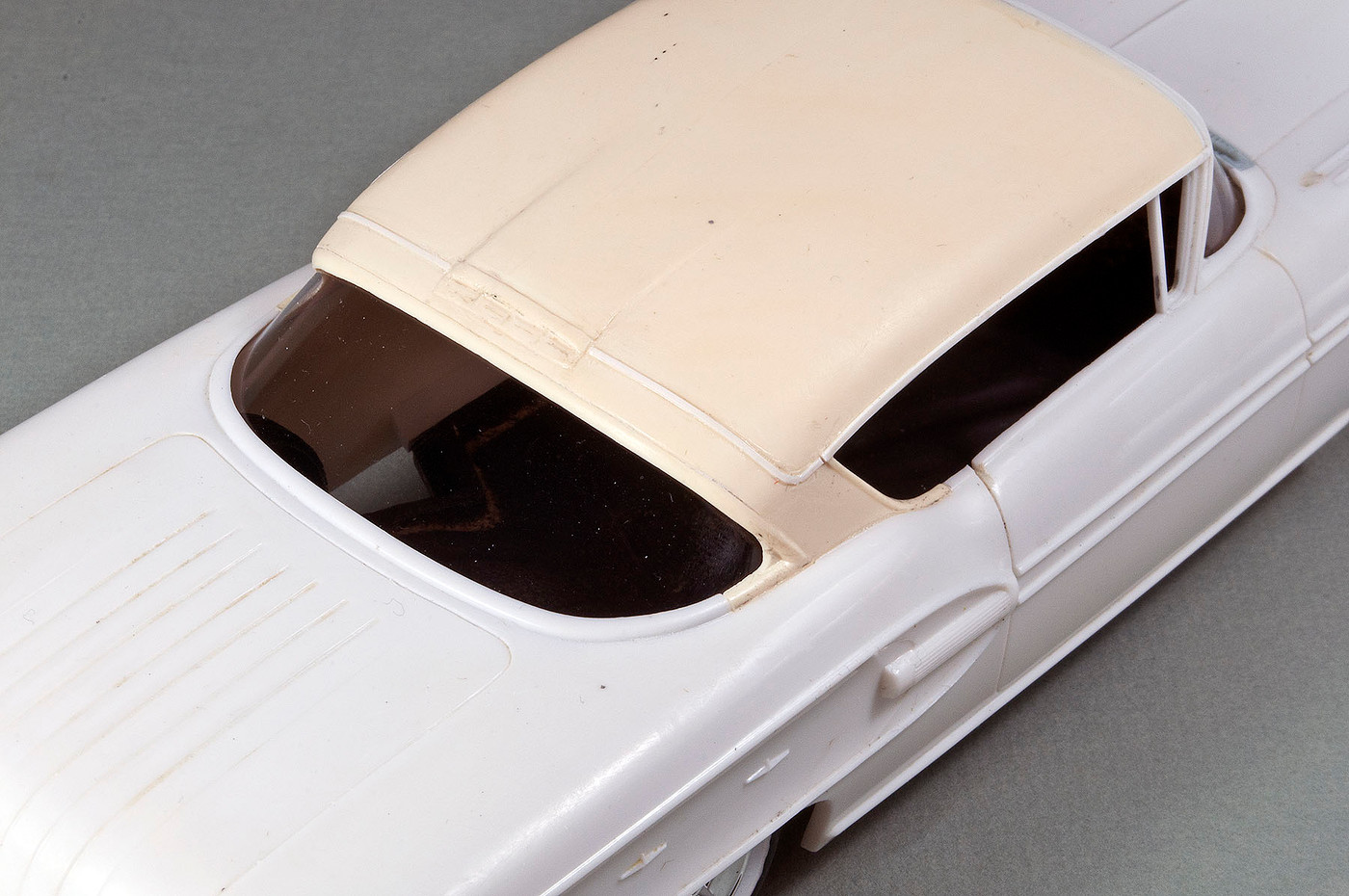

John Goschke Posted March 20, 2018 Author Share Posted March 20, 2018 Now that the '58 Ford is finished I can get back on another neglected project, this '58 Bonneville. Worked on fixing some nagging issues. Weak cowl vent detail resolved a with piece notched in from an AMT '58 Impala. Shaved the front fender ornament "jets" off and replaced the fender top raised crease detail with filed-down .030 triangle strip. Made a clear PVC windshield and replaced some damaged moldings at the rear of the roof with styrene strip. Good to have this one moving again! Quote Link to comment Share on other sites More sharing options...

rsxse240 Posted March 22, 2018 Share Posted March 22, 2018 How did you make the PVC windshield? Where did you get the material and what thickness did you use? Quote Link to comment Share on other sites More sharing options...

John Goschke Posted March 23, 2018 Author Share Posted March 23, 2018 22 hours ago, rsxse240 said: How did you make the PVC windshield? Where did you get the material and what thickness did you use? Ken, I covered the kit windshield with a piece of masking tape before installing it in the body. Then I used a pencil to trace the shape of the windshield opening onto the masking tape. Next I peeled the tape off the windshield and applied it to a piece of manila file folder to create a pattern by cutting it out approximately 1/16" larger than the pencil outline. Then I cemented pieces of styrene strip inside the windshield posts and the bottom corner of the windshield about 1/16" inside the opening. The strips act as brackets to hold the windshield in place. After peeling the tape off my new folder stock pattern I fit it inside the body and trimmed as needed to refine the fit until the pattern popped into place in the brackets and fit nicely around the opening. Then I used the pattern to cut the new "glass" out of the sheet of PVC. Before cutting I protected both sides of the PVC with masking tape. Once the new windshield was cut out and tape peeled off it was test fitted inside the body. Luckily this one popped into place without any adjustments to the fit. It sounds like a lot of work but this one only took about 1 1/2 hours and the results are sure worth it! Thanks to Steve Boutte for persuading me to give it a try. Here are some photos from when I did the windows in the '58 Ford... Quote Link to comment Share on other sites More sharing options...
rsxse240 Posted March 24, 2018 Share Posted March 24, 2018 They look amazing! I'm going to have to try this out. Thanks for the quick how-to! I'm sure I'm not the only one who will benefit from it. Quote Link to comment Share on other sites More sharing options...
Ron Hamilton Posted March 24, 2018 Share Posted March 24, 2018 On 3/23/2018 at 11:44 AM, John Goschke said: Ken, I covered the kit windshield with a piece of masking tape before installing it in the body. Then I used a pencil to trace the shape of the windshield opening onto the masking tape. Next I peeled the tape off the windshield and applied it to a piece of manila file folder to create a pattern by cutting it out approximately 1/16" larger than the pencil outline. Then I cemented pieces of styrene strip inside the windshield posts and the bottom corner of the windshield about 1/16" inside the opening. The strips act as brackets to hold the windshield in place. After peeling the tape off my new folder stock pattern I fit it inside the body and trimmed as needed to refine the fit until the pattern popped into place in the brackets and fit nicely around the opening. Then I used the pattern to cut the new "glass" out of the sheet of PVC. Before cutting I protected both sides of the PVC with masking tape. Once the new windshield was cut out and tape peeled off it was test fitted inside the body. Luckily this one popped into place without any adjustments to the fit. It sounds like a lot of work but this one only took about 1 1/2 hours and the results are sure worth it! Thanks to Steve Boutte for persuading me to give it a try. Here are some photos from when I did the windows in the '58 Ford... That is what separates the Masters from the Wannabes. Quote Link to comment Share on other sites More sharing options...
