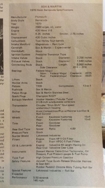

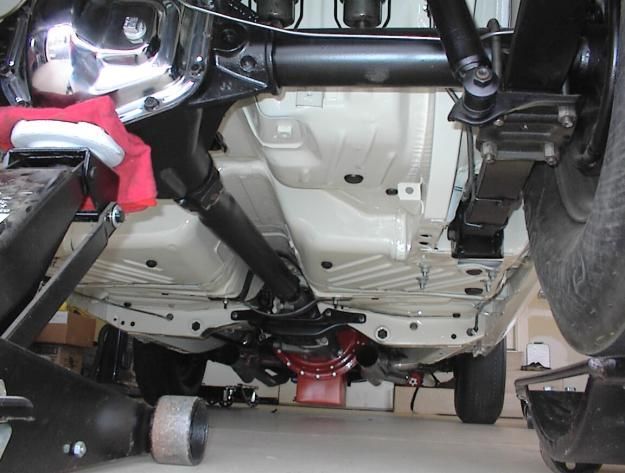

Force Posted July 30, 2014 Share Posted July 30, 2014 If you're striving for period accuracy, you'll need to source a reinforced racing bellhousing they were mandatory on manual transmissions. I haven't been able to find a good picture of what Sox ran. I got all excited when I saw the pic above then noticed the disclaimer below it I have looked into this but I have only found a picture of the underside of the restored car. The 1970 Barracuda specifications here under from the Popular Hot Rodding April 1970 article says "Shatter Shield - Lakewood Industries", and it for sure looks to be a Lakewood steel bellhousing on the restored car...if it's correct or not I don't know but I have seen pictures of Grumpy Jenkins Toy VIII 70½ Camaro with a Lakewood bellhousing. Quote Link to comment Share on other sites More sharing options...
