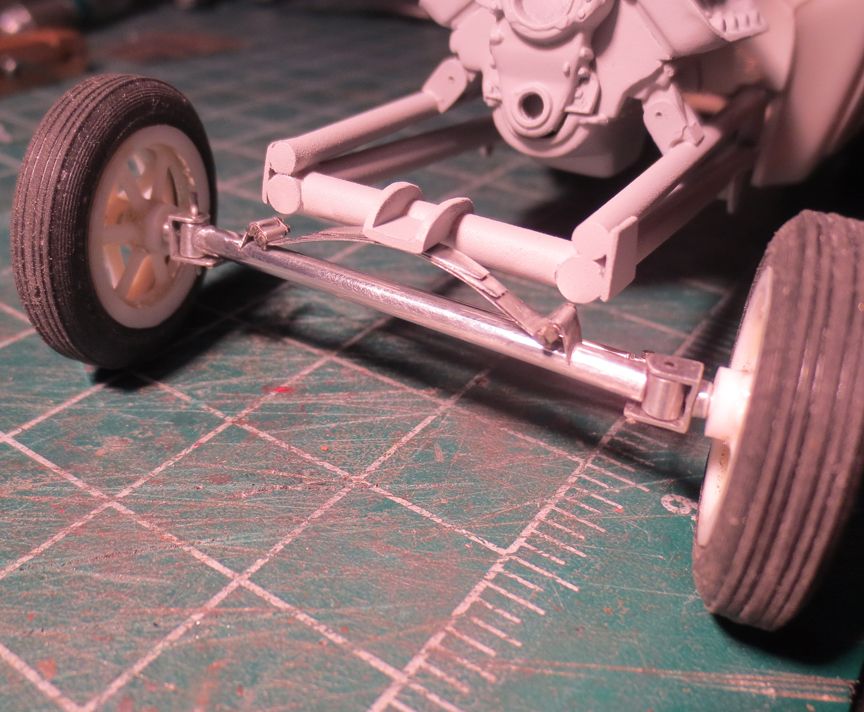

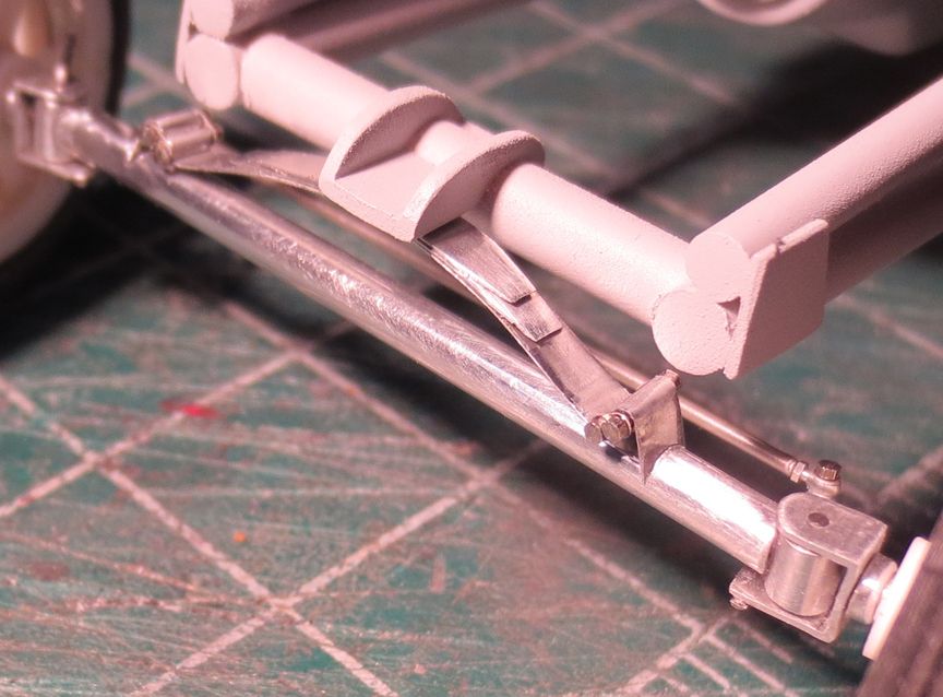

gasser59 Posted September 5, 2014 Author Share Posted September 5, 2014 My eyes are able to focus again after a night's sleep. I made the individual leaves from printing plate along with the part that mounts directly to the axle. The ends were bent around a piece of piano wire and then polished with some micro abrasion pads. For the connectors between the spring ends and the mounting pieces were 2 hole photo etch wire looms and I used Scale Hardware bolts for the connections. I only had four of the 2 hole wire looms so I had to be careful not to shoot any of them across the room. Thanks for following along. Again, comments welcome. Quote Link to comment Share on other sites More sharing options...
10thumbs Posted September 5, 2014 Share Posted September 5, 2014 "shooting across the room"....man, I hear that! The work looks fantastic. Brad, I don't follow you how the unit was attached to the round tube axle. How are the half-round clips attached? Michael Quote Link to comment Share on other sites More sharing options...

gasser59 Posted September 5, 2014 Author Share Posted September 5, 2014 (edited) That part really caused me to ponder Michael. I knew on the full size axles, the fish mouthed piece was welded on. Obviously that wasn't going to work in scale. Then I realized I could make a thin saw cut in the aluminum axle and insert the flat ended piece into the slot and it would look right and still give me enough surface area to glue. Problem solved. Thanks for the kind words Michael. Chris - I'm not the new sheriff in town but I really appreciate your vote of confidence. Edited October 1, 2014 by gasser59 Quote Link to comment Share on other sites More sharing options...
10thumbs Posted September 5, 2014 Share Posted September 5, 2014 (edited) Hi Brad, OK, good idea with the slit, this way you get enough retention for Z-a-G to do its thing. This is really working out to be information that I can use for my upcoming Hot Rod and Altered builds. I'm nuts about these type of cars because there is no real plan for them, do as you please, but do it good, and right. The front axle is highly visible and leaves lots of room for improvement. With your technique, this goal has become well within reach for what I would like to see and do. I've found in the meantime some precision model shops in Germany that offer decent nuts and bolts in proper scale, and I don't have to pay exorbitant shipping prices. I will though soon be ordering parts like rod ends and for future builds some really good looking 4 link setups from some of the guys here on this forum. Michael Edited September 6, 2014 by 10thumbs Quote Link to comment Share on other sites More sharing options...

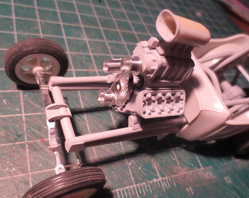

gasser59 Posted September 11, 2014 Author Share Posted September 11, 2014 (edited) It sure seemed to take alot more time than I expected but the pulleys are all set up. I had to source an appropriate timing belt cover and then modify it. What's left before painting the block is to source an external oil filter which goes on the right side behind the headers. I tried to turn one this morning on my Dremel but I think its too small. Here's a pic of the pulleys and cover. Progress continues. Edited September 11, 2014 by gasser59 Quote Link to comment Share on other sites More sharing options...
MikeBoyle Posted September 11, 2014 Share Posted September 11, 2014 Looking great. Just remember on the oil filter, they are available in different sizes, so even if it looks smaller than a stock filter, it may resemble an aftermarket alternative. Quote Link to comment Share on other sites More sharing options...
