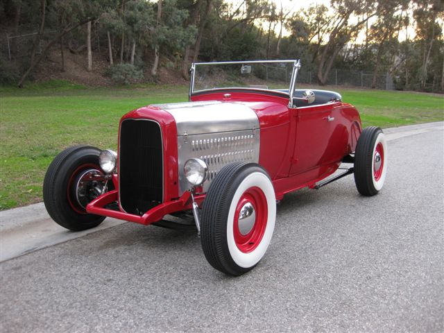

Thanks for the reply Bernard and your nice comments. We put alot of heart and soul into the movie and it's obvious that it has struck a cord with you. Actually that was our goal in making this film! We wanted to help re-vitalize the era of the Traditional Hot Rod. It's very flattering that you chose to do a model of Challenger. I love the car too. It has a great look.
In regards to the wheels, I'm baffled too. Dave told me that he got them from another chassis he had laying around. The wheels are NOT Ford rims. They required 1" thick adapters to mate to the vintage Ford drums. The bolt pattern is not Ford. I think from their design they are Chrysler wheels. The front wheels/tires are 6.70x15" and the rears are 7.50x16". However the adapters did make it possible to have a set of very low profile smoothie hubcaps (hubcap clears the protruding axle & hubs). These adapters do make the track width of the car wider and maybe more stable. If I weren't so concerned about keeping the car looking like it did in the film, I'd remove the adapters and I would put '53-'56 Ford pickup wheels (15") up front, and '46-'48 Ford wheels (16") out back. And I'd probably use 1940 Ford Deluxe hubcaps or 1948 Ford hubcaps all around.
If you need any photos of the interior, or other areas, please let me know. -Jerry:>)

Thanks for the follow up, Jerry. The new pics show how nice you've gotten the car to look. I'll think some more about the wheels but definitely will go with 15's on the front and 16's on the back. This originally was going to be a fairly casual build, but, like the movie, it's starting to take on a life of its own. As I mentioned earlier I'm not by nature a replica builder. I tend to focus on the "feeling" the completed model projects. But I think it's important to "show respect to" the mythic character of The Challenger, which it shares with the Deuce of Spades and which, of course, you all took such great care to transfer to film. (Isn't it interesting how this is a work of fiction which all those whom it touches feel obliged to treat as if it somehow has become fact?). As a result I think that all the particular details of the model may not necessarily be the ones that were physically photographed for the film, but they most certainly should be the ones that are in the car we imagine we saw on film. That will be my guiding principal.

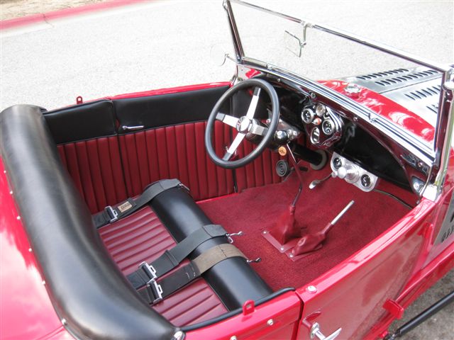

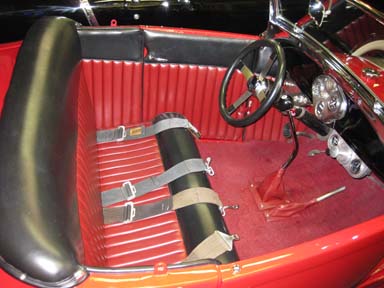

I edited my earlier post and added an interior shot for you. I have many more photos if you'd like. The interior is as you say black & burgundy tuck and roll. Dash rail is chrome, but dash itself is black semigloss. The steering wheel is a dished Track Style Wheel. In the film its a bit larger diameter, but impractical to live with as my hand (and the actor's) was continually hitting the shift lever and kicking it out of or into gear. Not good! I think it's 15". The seat belts are Deist aviation style belts, about 3" wide. The car's brake pedal is to the left of the steering column, requiring that I drive with both feet. That took awhile to get used to!

... I edited my earlier post and added an interior shot for you. .... The car's brake pedal is to the left of the steering column, requiring that I drive with both feet. That took awhile to get used to!

Thanks again, Jerry. The interior pic is just what I needed. I won't worry about the pedal placement. My car will have a manual transmission! Regarding accuracy, my inevitable "drift" from meticulous accuracy is already "in play" with the discussion about the wheels. Another area will most likely be the rear deck louvers. The Archer decal louvers are not very tall and tend to get buried under paint. While they work well under thin metallic paint as I used on the hood, under layers of primer, color and gloss they tend to get lost. So I'm considering using the louvered rear deck from the Drag city Casting which is based on the Revell '32 Ford 5-window coupe. It adapts fairly easily:

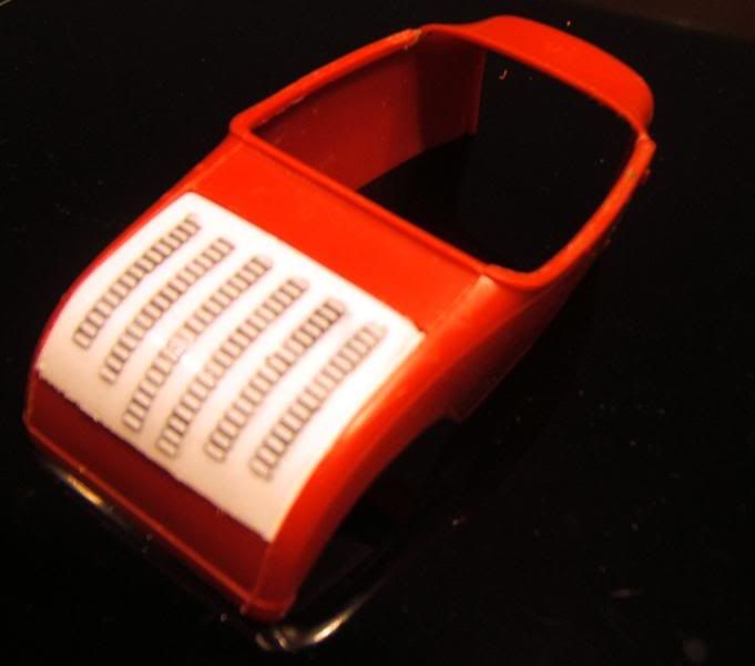

The other option is to paint the car and wait until I'm ready for the final color coat and clear and apply the resin decals. I suspect it still won't be "strong" enough. I haven't decided which way to go yet, but as you can see the molded deck lids louver pattern is the reverse of your louvers (top to bottom V). A far more skilled modeler than me would make a deck lid out of brass and punch louvers in it!

Speaking of louvers, between the hood and rear deck there are 262 louvers on the car. That's alot to model!

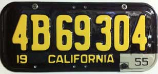

One thing that would help you would be a photo of the CA license plate used in the film. I just added it here. Another little story for you: Before I got involved with the film Faith had made some fake 1951 CA Plates with taped on '55 tags. They were very thin and looked a bit washed out. So for the Saugus Drag Strip Scene (actually filmed on a person's personal airstrip in Agua Dulce, CA) I made 65 fake CA plates. They were beautiful, but for a close-up, they might not work. So when it came to the scene where you see the rears of The Deuce and Challenger, Faith asked me to put a real plate on the car. Now where would I find that? Keep in mind that we are at a remote location and Challenger had no provision to bolt on a plate. We were taping paper plates onto the cars as it was. Another of our DOS Miracles: my buddy AJ had a single REAL plate in the trunk of his black '29 roadster. So I quickly taped it, along with a phoney '55 tag, to the back of the car and off we went. After I bought the car, AJ gave me that plate as a gift, and I had it restored. It's now on the wall next to Challenger with some of my DOS keepsakes. -Jer:>)
