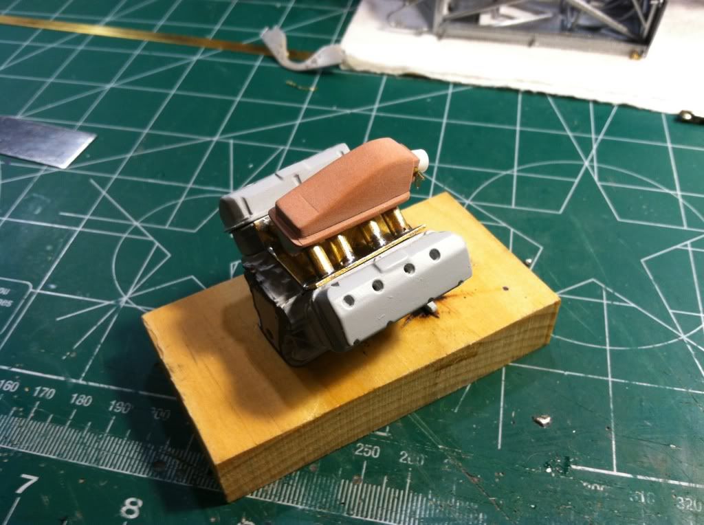

MicroNitro Posted August 30, 2012 Share Posted August 30, 2012 I was of course kidding in "demanding" to be answered, I was just joking around. I'm looking for material to build my own F.I. intake for a turboX2 440 I am doing. The one I built isn't quite right... This is were I get rentool and shape http://www.freemansupply.com/RenShapeModelingan.htm Quote Link to comment Share on other sites More sharing options...

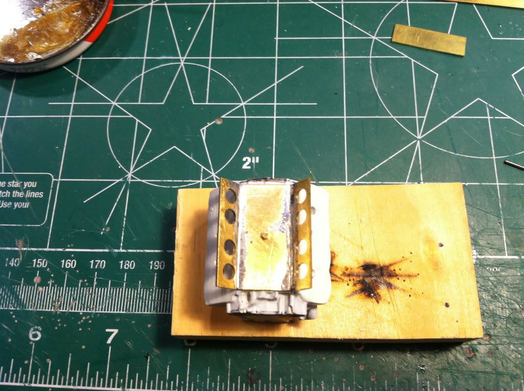

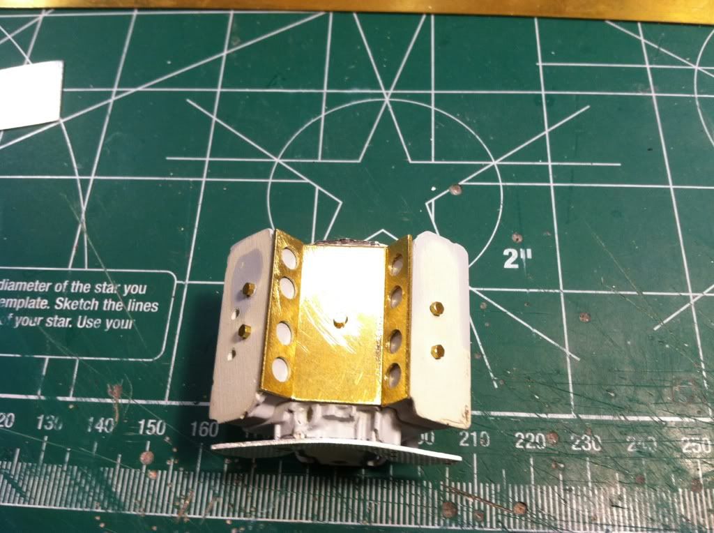

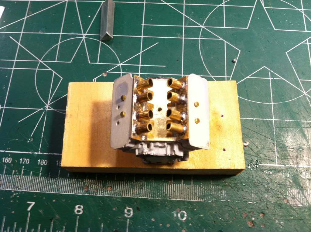

Prostreet Posted September 1, 2012 Author Share Posted September 1, 2012 Thx. Guys, Well i wasn't happy with the flimsy styrene lower intake, So it was time to bust out the brass and do some soldering. The more i solder brass the more i like it. The lower turned out good and i'm much happier now. Next will be trying to figure out how to do injectors and rails, i wanna run dual rails and i think i can fit them. The injectors will probably be just some different size round rod, It's getting pretty tight in there to make them look accurate. Hope to tackle that tommarrow evening. I started with some flat stock, 2 smaller pieces for the sides and 1 for the lower. Then drilled some 5/32nd holes. All soldered together. The 5/32nd tube added and soldered in. What it will look like when together. Quote Link to comment Share on other sites More sharing options...

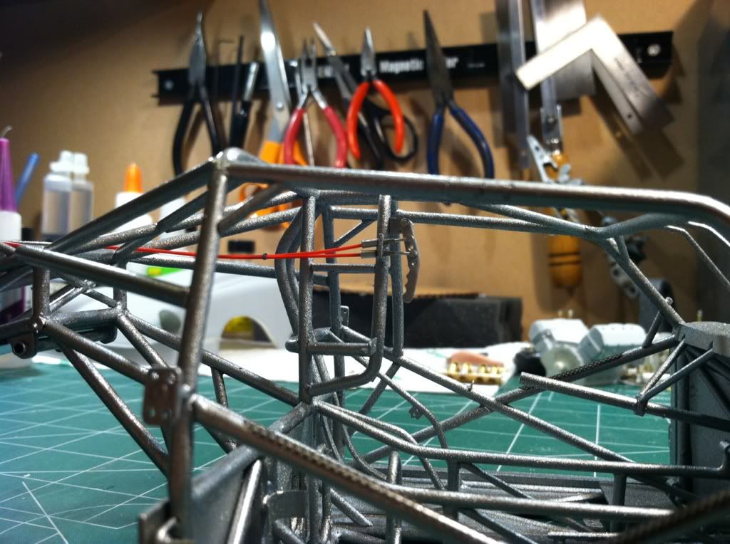

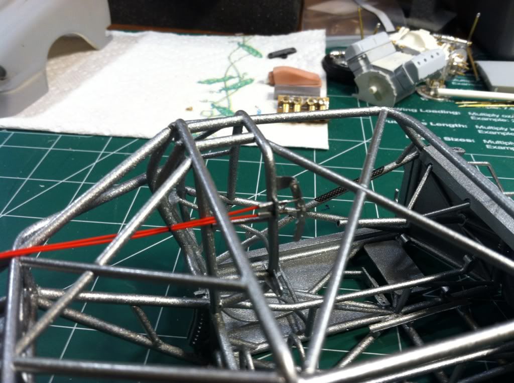

Prostreet Posted September 3, 2012 Author Share Posted September 3, 2012 (edited) Thx. Guys, Very happy with the intake so far. Had some time today so i knocked out the chute handle and lines, Scratch built the handle and used RB motion hardware,Took me 5 hours just to do this. my brackets were not 100% where i wanted them but it worked out, There is no way in heck i could do this in 1/25th with the size the hardware would have to be. Might start installing the pedals tommarrow, not sure if i have enough hardware, may also start on the ISP pads for the cage. Edited September 3, 2012 by Prostreet Quote Link to comment Share on other sites More sharing options...
