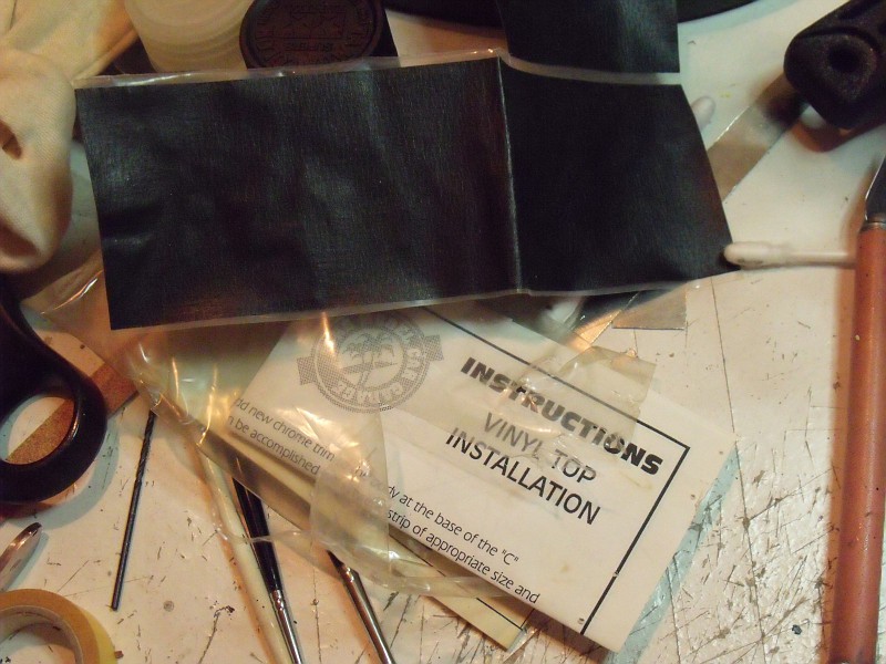

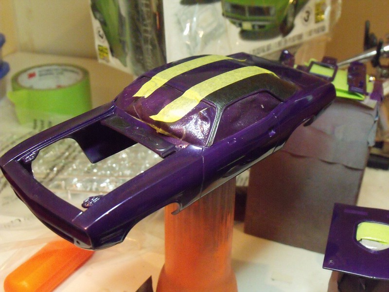

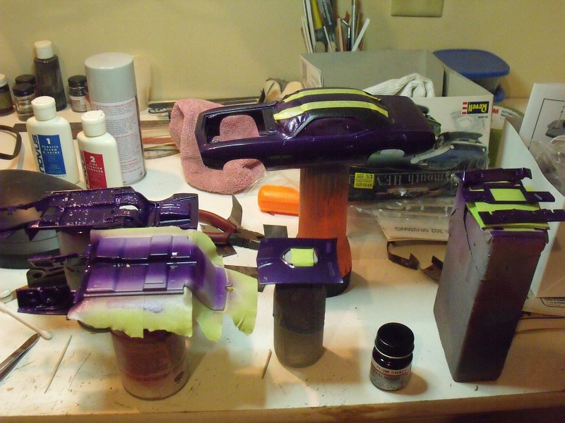

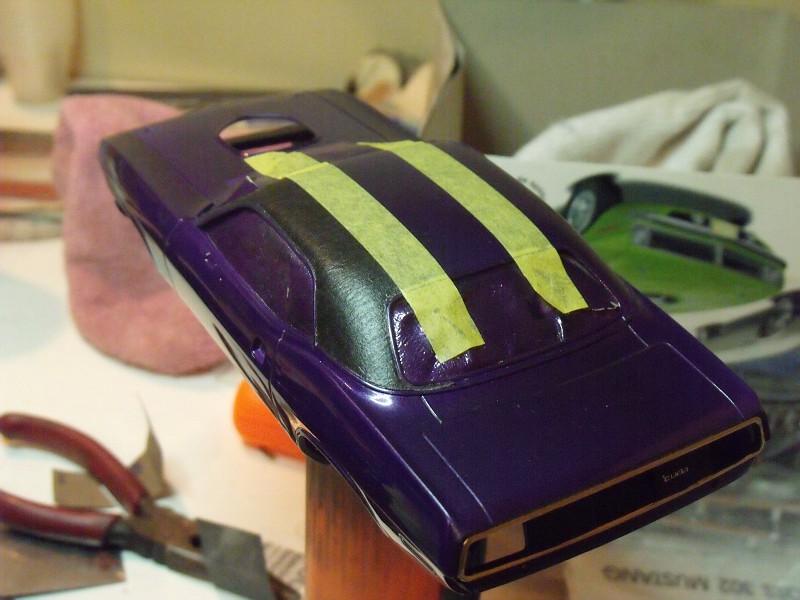

I just started back up building this past year. Boy have I missed it. I have already completed a few builds and at some point will post them for you all. I recently bought the new Revell 70 Hemi Cuda kit and wow do I like it. I know there are a few issues with it, but, hey, there are with most kits anyway. And besides thats why they call us model builders. Right? Part of the fun in building kits for me is correcting what I can, and adding and changing what I want. Well for this build I decided to do a vinyl top verson. It will be painted testors plum crazy purple enamel. I'll be posting a few pics along the way. I have already corrected the wheel openings, built the side window trim out with evergreen strips, instead of etching them deeper- this helps with the thickness of the vinyl top material I am using from the model car garage. I, also, have already scratch built the molding, below the rear window, for the vinyl top from evergreen strips. The body in the first few pics has already been painted, clear coated and polished and I have already started applying vinyl top meterial. I primered the body with tamyia thin grey primer. Then mixed my paint as well as my clear coat at 50/50 with hardware store laquar thinner. Excuse the pic quality, my camera is almost as old as I am LOL. I'll be posting more as I go along. Thanks in advance for checking this post out.

Thanks guys, and Glen, The Vinyl Top material can be bought through the Model Car Garage Website. You can get it in Black or white. You get enough material to do 2 to three cars with it, provided you follow the instructions for it carefully. One thing I do that they dont tell you to do, I give the top area a good coat or two of wax to make the material easier to remove and ajust as is needed. This is because it sticks down really really good, and in the past I found that not laying it over a waxed area, it can be hard to lift and adust if needed. here is the link to the top material they sell: http://www.modelcargarage.com/store/pc/viewPrd.asp?idproduct=63&idcategory=9

Update for today. I finished the vinyl top- And took care of most of the Bare Metal Foil work. I plan to order some better tires than came in the kit. The ones I plan to use are the BFG Radial TA tires from Fireball Modelworks Stay Tuned. More to come. DSCF2400-vi.jpg

Ok time for another update. Glenn, I haven't started on anything else yet, other than to base paint the chassis body color. I will be starting on the interior and engine with in the next few day.
I got alot of the body finished today.
