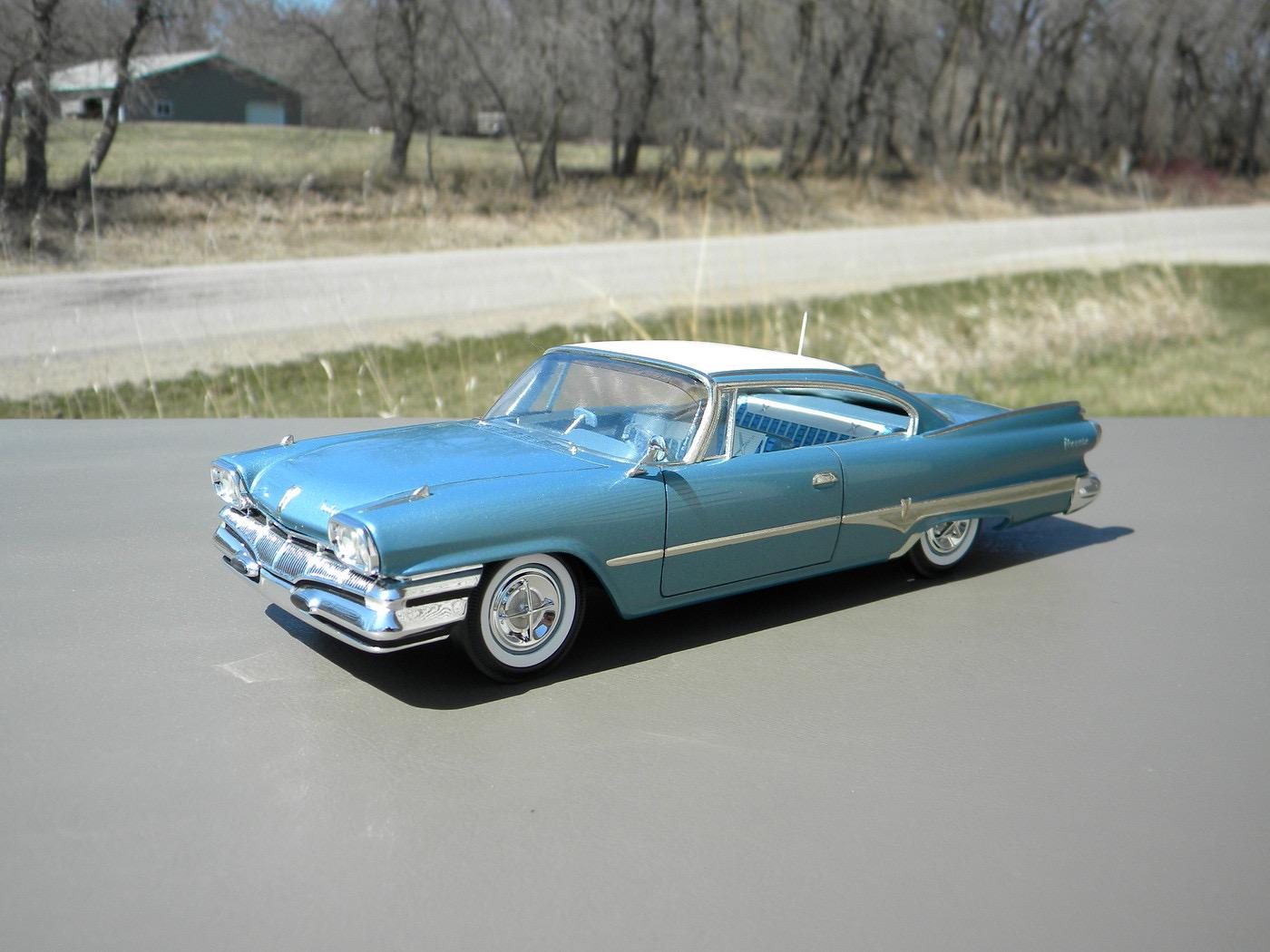

  4. There are polishes designed for use on models, as there are many that are designed for 1:1 automotive applications. If you use paints that are designed for use on real cars, you can use any type of polish that you wish. Of course my suggestion is to polish the clear coats applied over the color and not the color itself for a number of reasons. Myself, I use polishing pads from Micro-Mesh, followed by liquid polishes from Novus, and finish with a light polish with an automotive scratch and swirl remover, and it never fails me. As I said, I will never consider myself a great painter, possibly not even a very good one, but the results speak for themselves. The final destination is what is important. How you get there is meaningless in my opinion. By the way, the red '62 Chrysler and black '60 Mercury that I posted earlier were both sprayed entirely with spray cans from primer to clear coat, (all Duplicolor) and then cut and polished to perfection. You can spend a number of hours cutting and polishing, but it's up to the individual whether or not they consider it worth the effort, or if they would rather just shoot and hope. A few more examples of models sprayed entirely with Duplicolor lacquers, and then polished. Steve

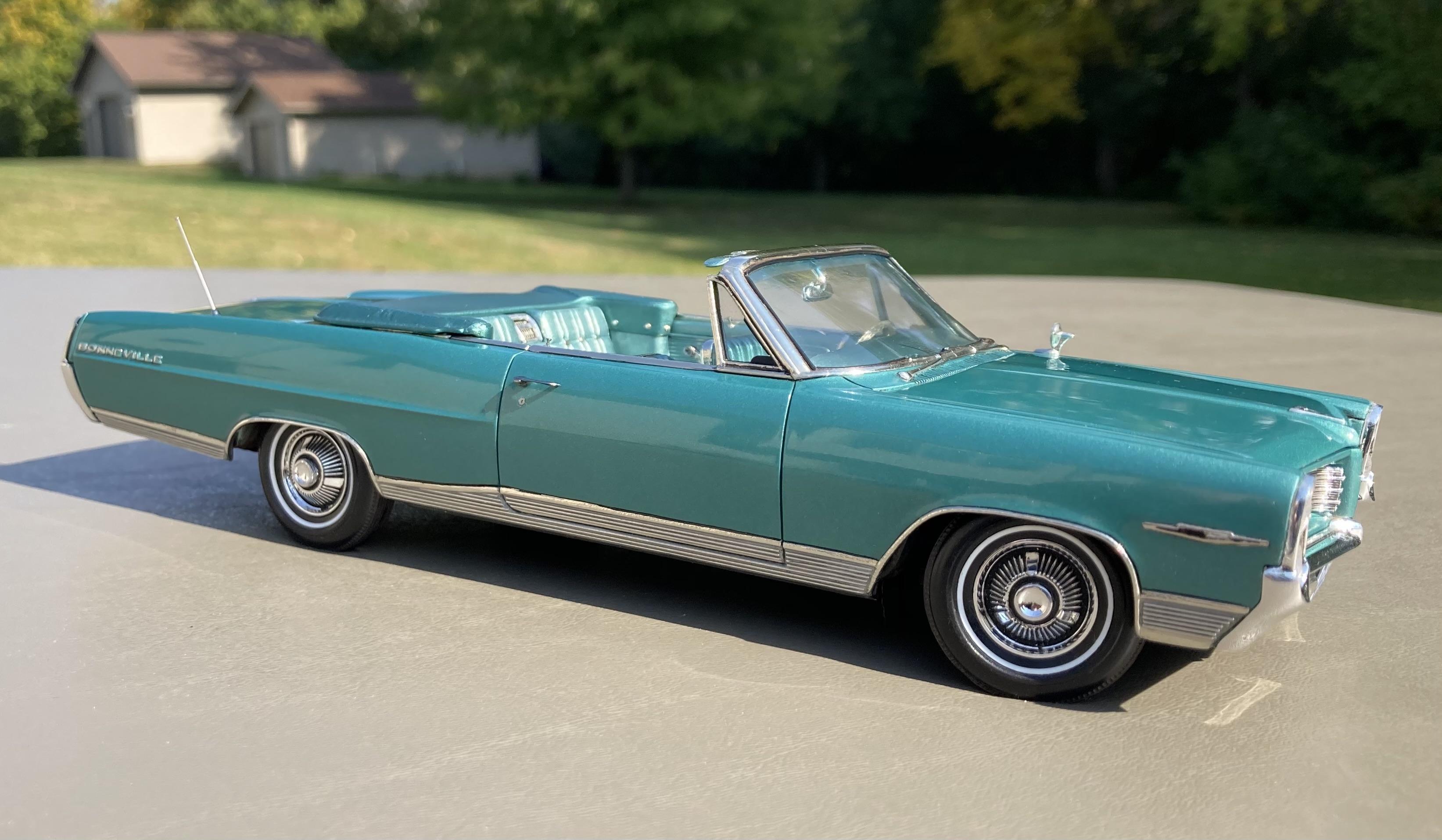

  22. I don't do fancy custom paint as a rule, although I wouldn't necessarily be afraid to go there. It's just not my genre. My stuff is predominantly factory stock, so my paint work reflects that. I don't remember the last time that I posted anything in this thread, but here are a couple more recent and my "newest" favorite paint jobs. Steve
