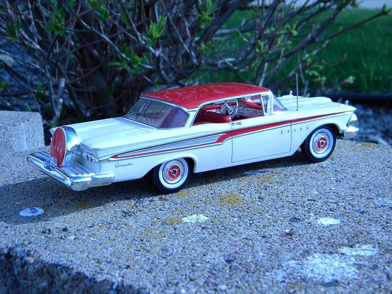

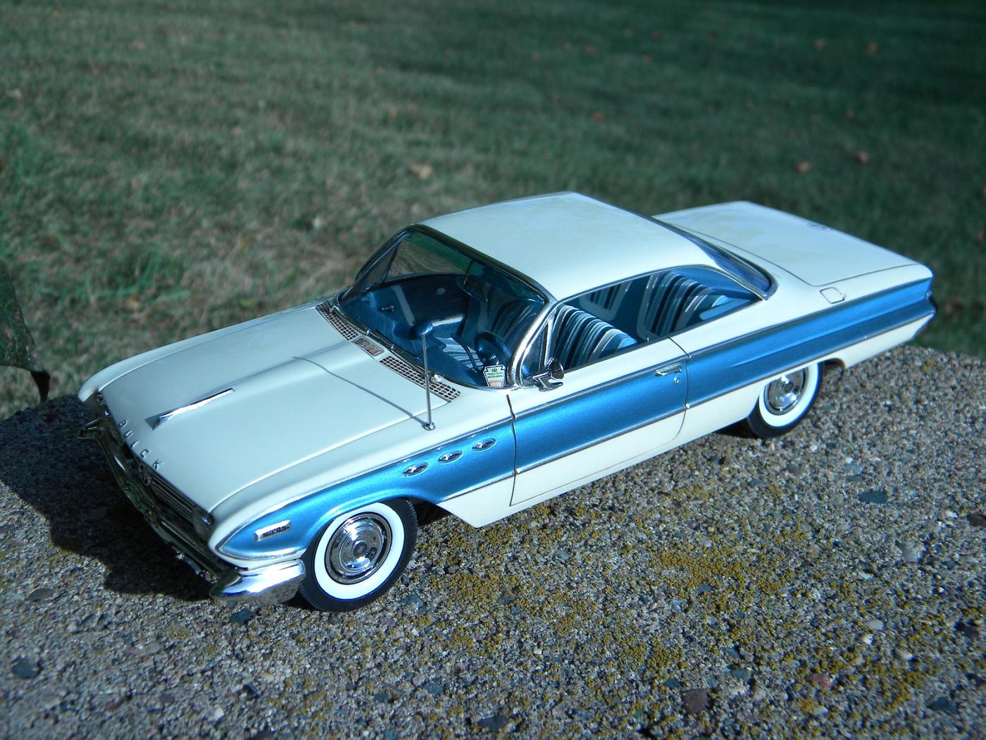

  16. Both of these models were painted with nothing more than Duplicolor white sandable primer, and Duplicolor white lacquer touch up paint, straight from a rattle can. The Edsel was molded in blue plastic, so good coverage was essential. Plenty of primer, and several light coats of color was all that was required. A few coats of clear will go a long way to adding depth to a “drab” paint job as well, even white. These are both painted with a “warmer” white, but you get the picture. I don’t recall either of these being any more difficult to paint than any other color. Steve
