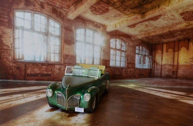

  1. Clear added. It didn't even crack, bubble or craze. At least not yet.

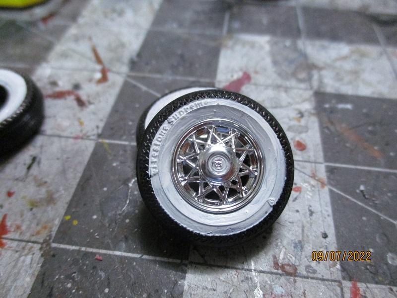

  5. Working on the foil.

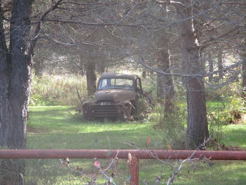

  7. Beautiful build. Love the display dioramas too. Here's one in town here should you decide to do a 1:1.
  8. Then I must find a truck to put mine in. And your model is stunning my friend.

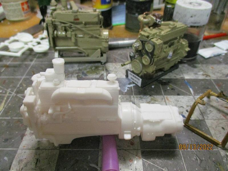

  9. While the second white turned out OK, the removal of the masking tape did not. I likely forgot to de-tack the tape before applying it.

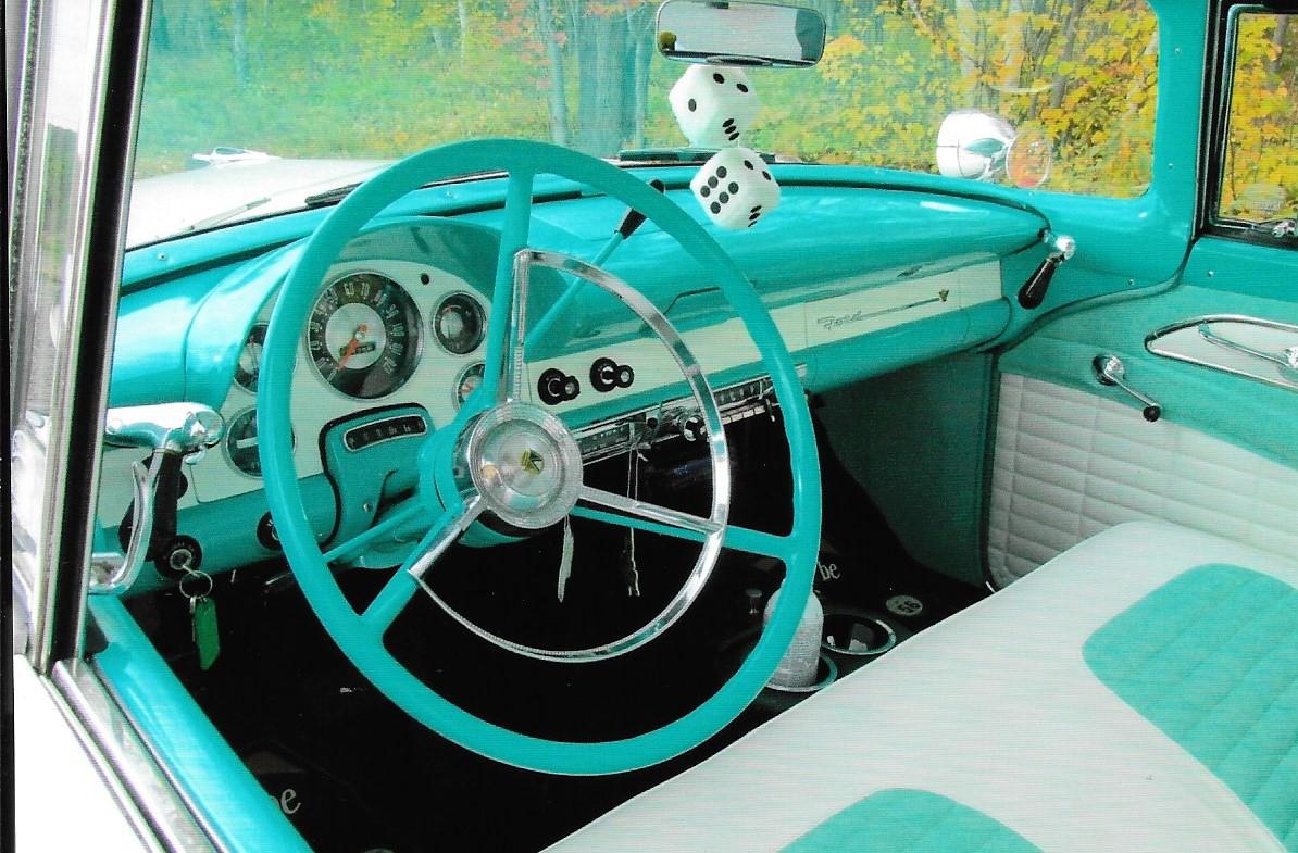

  10. The interior is different from the 1:1 I am trying to replicate. Maybe the kit is a compromise between different models of Ford.

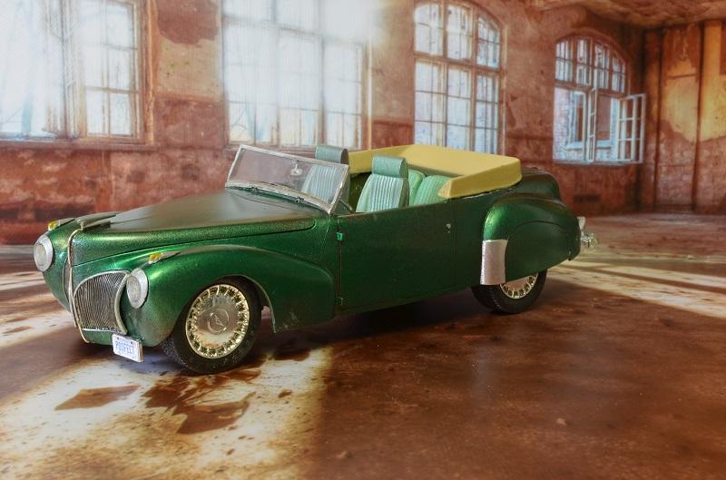

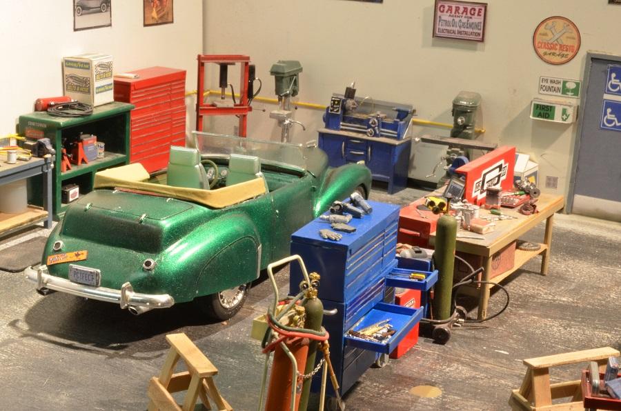

  14. Masked the car and shot the green....outside as this is real car paint complete with isocyanates. so shop coat, gloves and respirator. Looks OK to me.

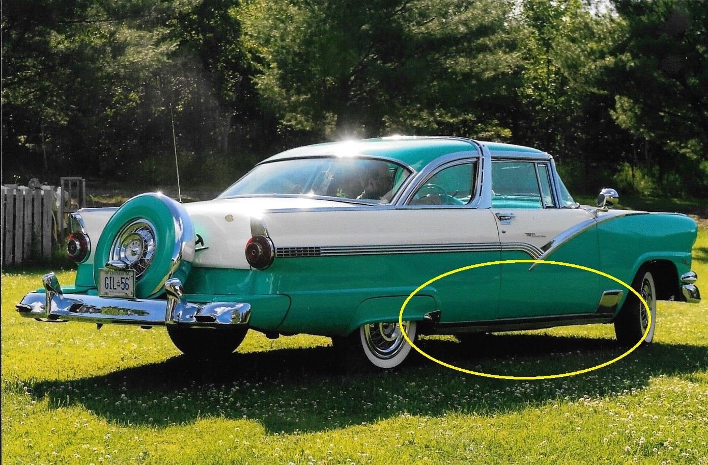

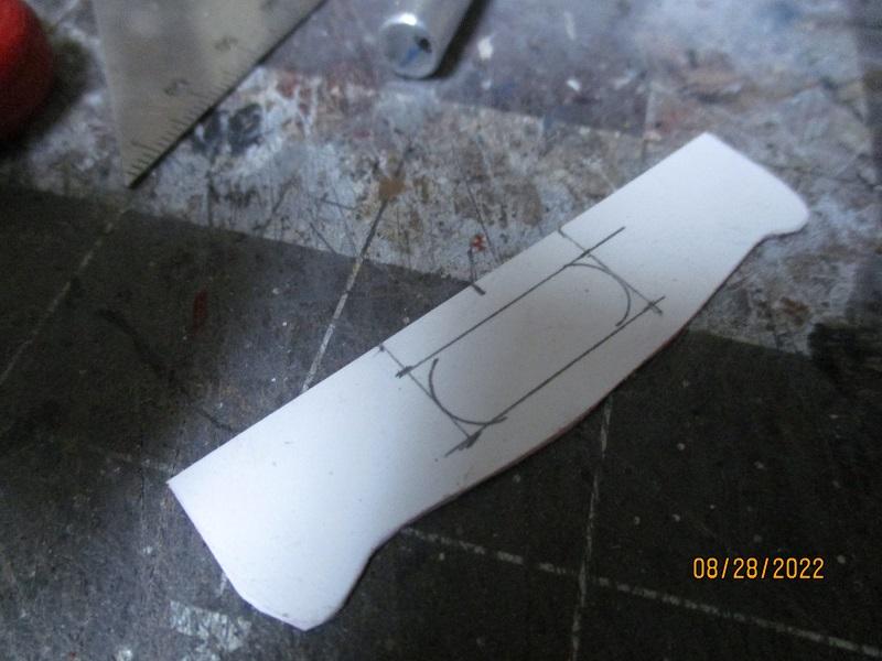

  15. Fabbed up fender skirts using the following method. Took a picture from the net, reduced it to size using Microsoft word, printed it and used it as a pattern. Used half round for the bead.
  16. Looks like it will work. I must remember to score the inside to show the shutlines.
