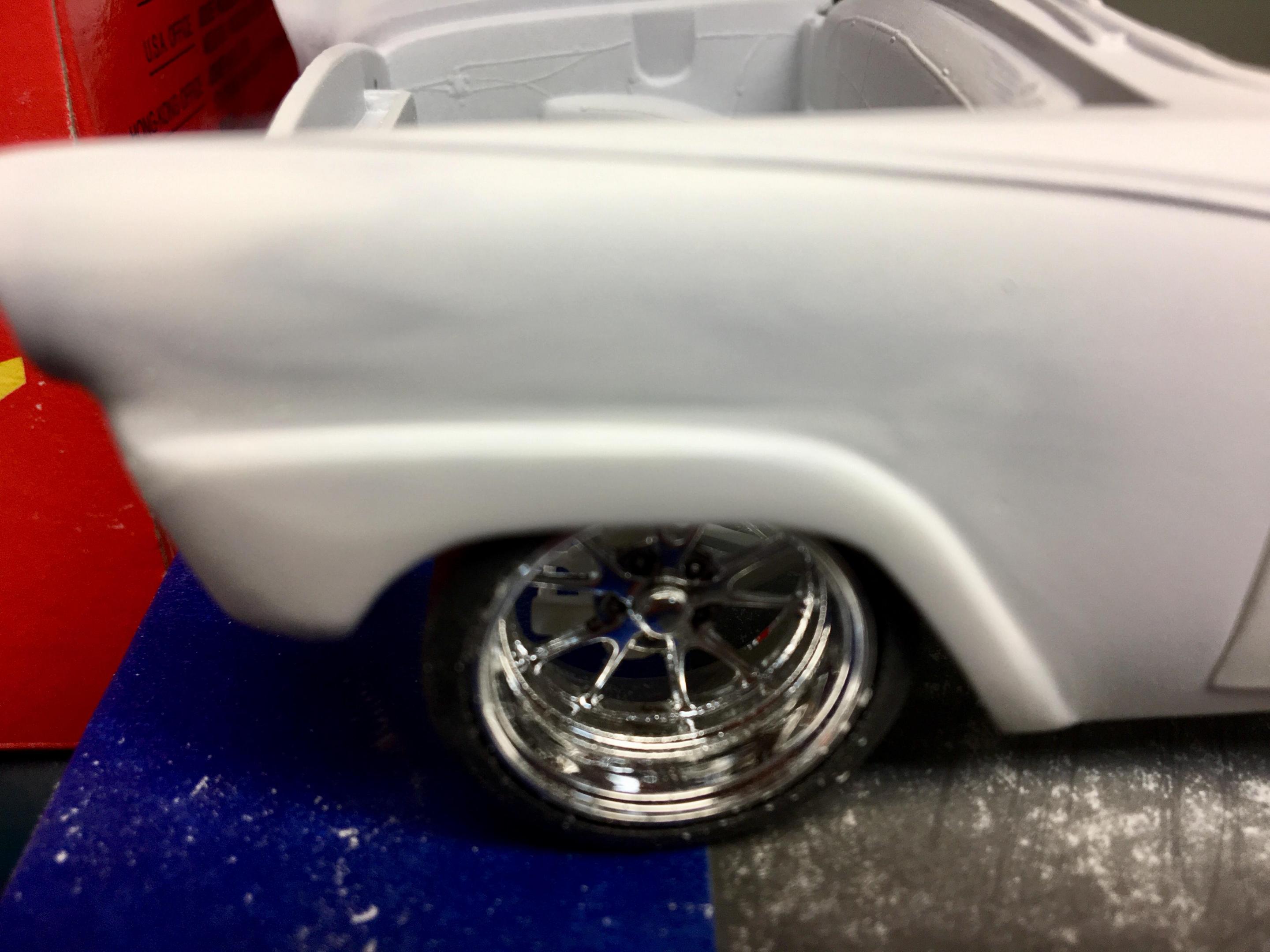

Unfortunately, I didn't get photos of the process so I'll try to explain what I did... This was the original issue Crown Vic and as such, the body was fairly thick. Using a dremel under slow speed to not melt the plastic, I ground down the inside of the fender-wells to see if I could gain whatever room I needed. Right idea but still needed more room. Z wheels are basically 3 pieces, an outer rim, the resin wheel and an inner rim. So I tried sanding down the inner and outer rims and offsetting the tire a bit but STILL not enough. So, I had to reinvent the wheel (eh...so to speak) I took a piece of paper and traced the flared part of the front and rear fenders, cut it out and traced it to a 0.030 sheet plastic. Next, opened the wheel well on the body just enough to let the outside dimension of the wheel/tire to fir...almost there. Glued the section of sheet plastic to the body just a tick lower than the original fender flair (going a tick lower gives the impression of the suspension being lowered without really lowering it) Sanded the sharp edges down of the extended fenders, filled and sanded smooth and contoured the new fenders into the original so it looked stock. Finally, got out the dremel and again removed plastic from the inside of the new fender-well. Sanded and primed as needed. Here's a diagram...the red line was what I removed from the original fender to let the tire fit. Primed

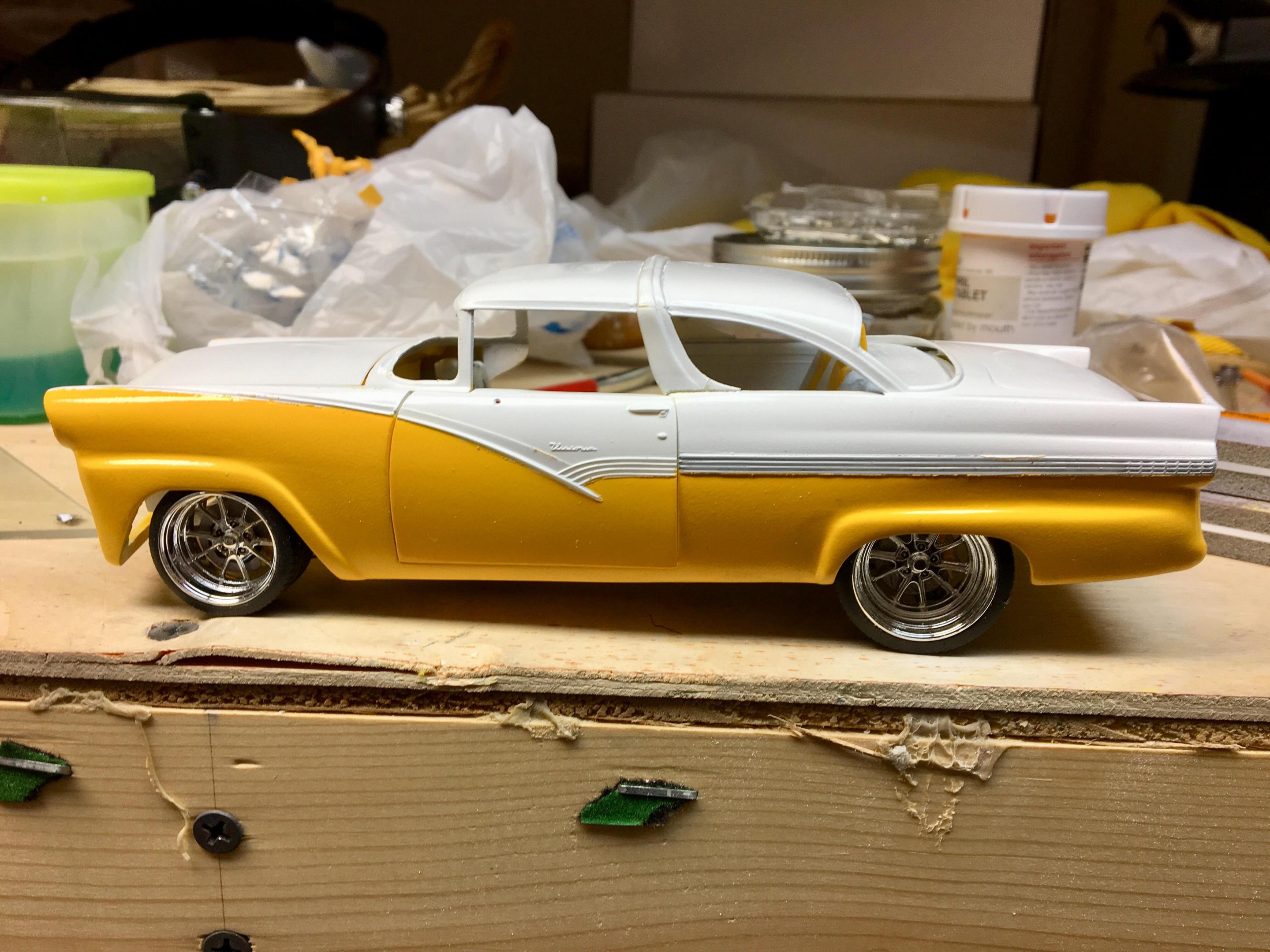

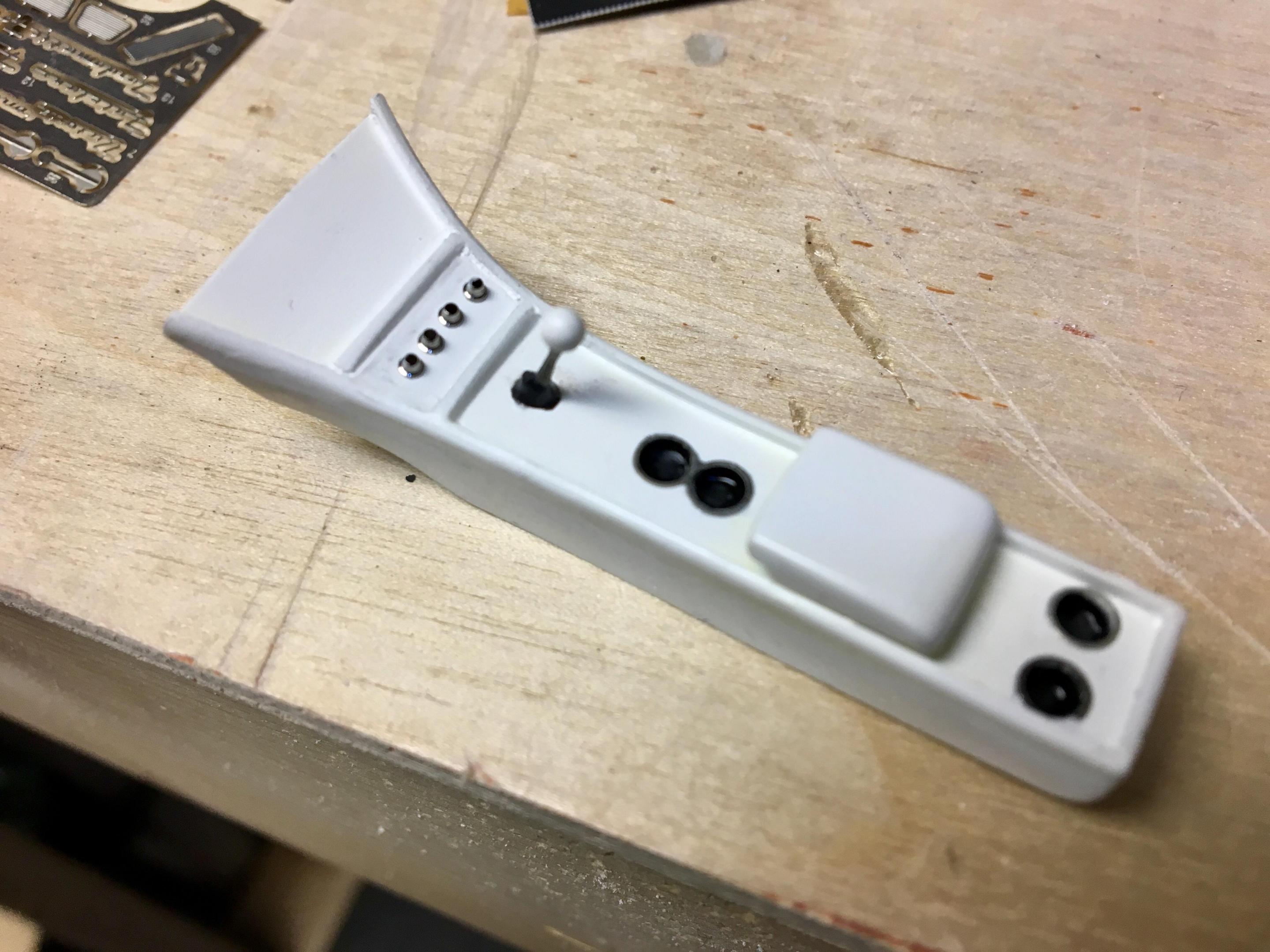

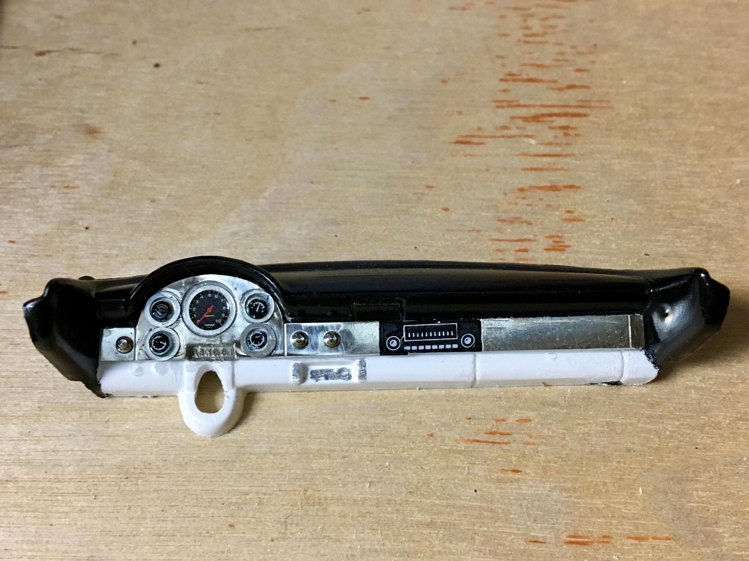

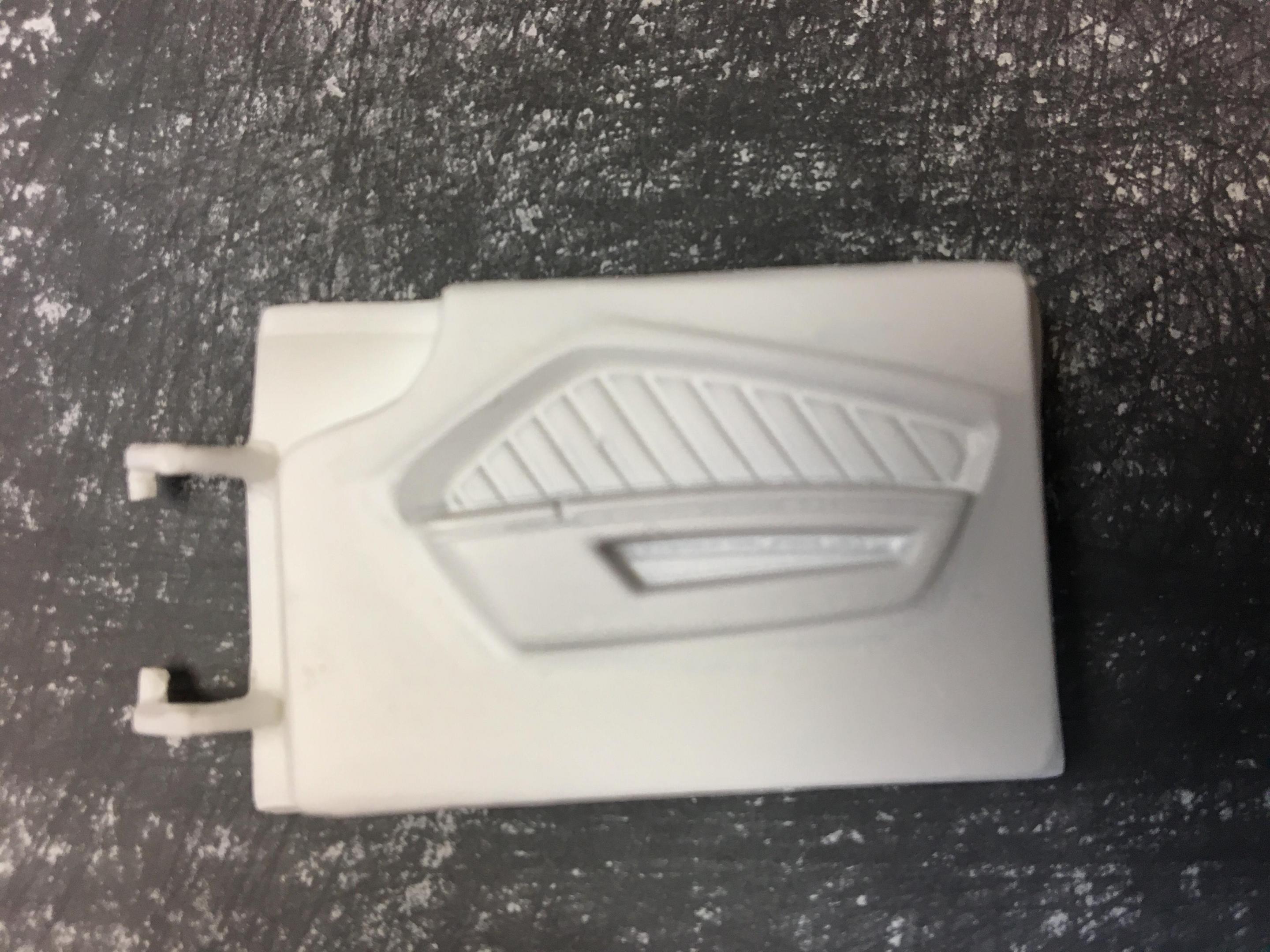

Something I’ve been working on for a bit and was inspired by an article in Street Rodder magazine. Steet Rodder Its been a work in progress with each modification being followed up with one or more. 1st order of the day was to remove the floor pans from the frame...which evolved into a change in the front and rear suspensions. Front was adapted from a nascar Ford while the rear came from the Foose pick up I planned on a set of Z wheels and soon realized it was going to be a tight fit. I had made all the changes I could in the suspension so the next step was to widen the the quarter panels just a bit. The end result looked pretty darned good to me as in this mock up i didn’t like the bench seat idea so looking at various kits/kit parts on the shelf, a 2014 Mustang appeared with a gleaming halo around it. I adopted the rear seats and front buckets then scratch built a center console... Basically, a stock dash... Then something hit me, I really disliked the inner door panels and since this will be an opening door model, I grafted in the centers of the mustang interior panels to the crown Vic’s The dash and console work well together... Still have a long way to go but it’s finally shaping up! Stay tuned!
