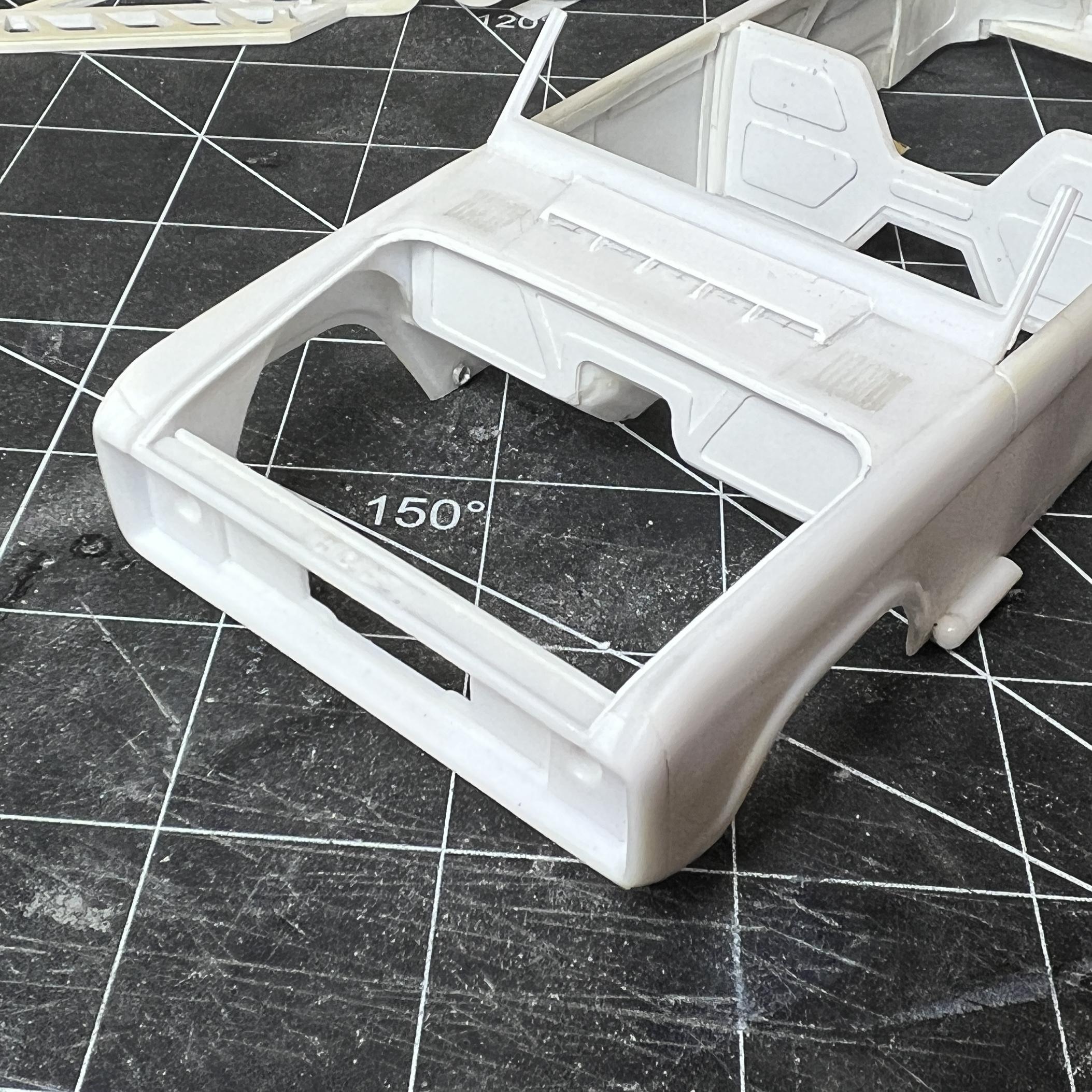

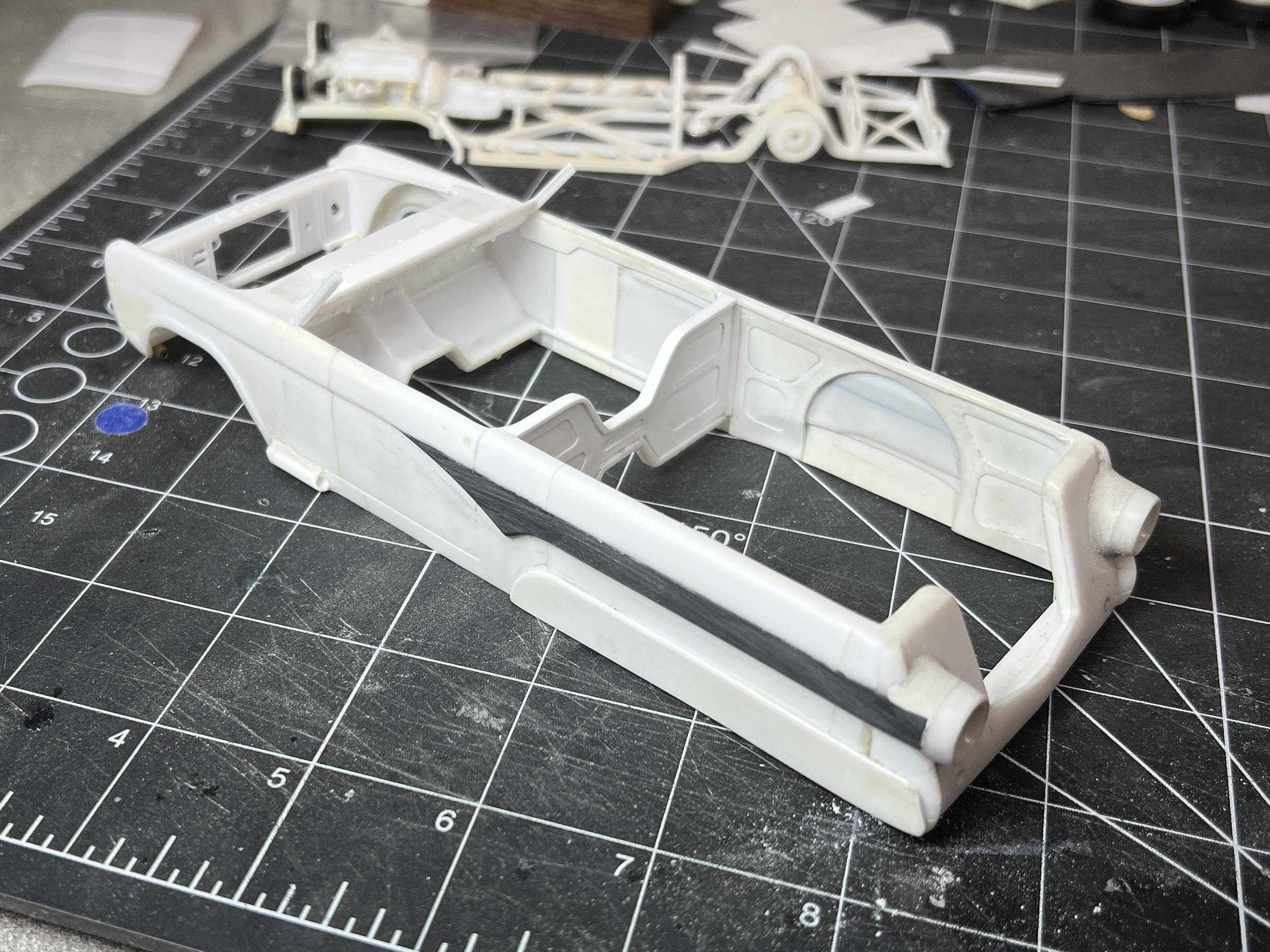

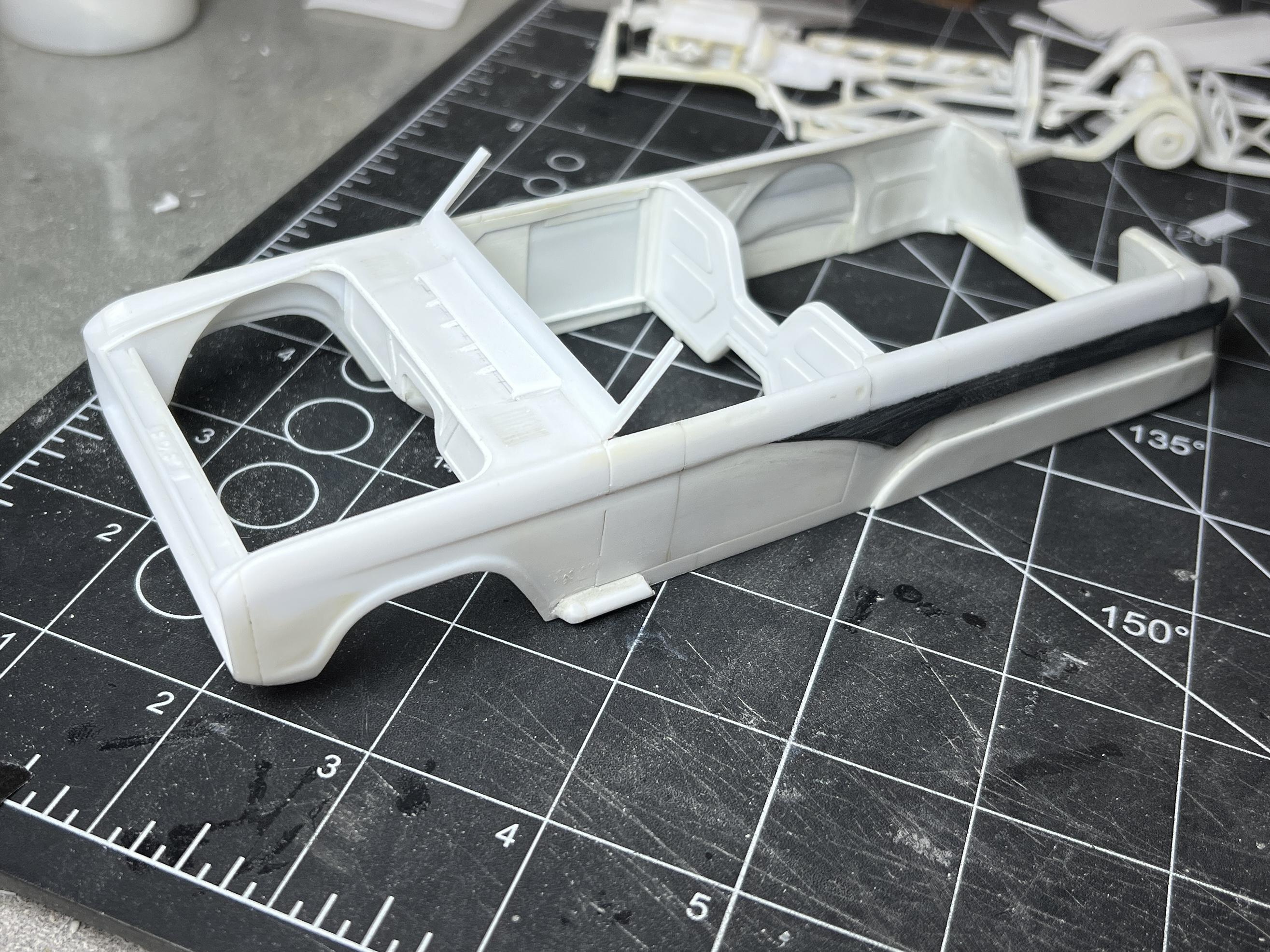

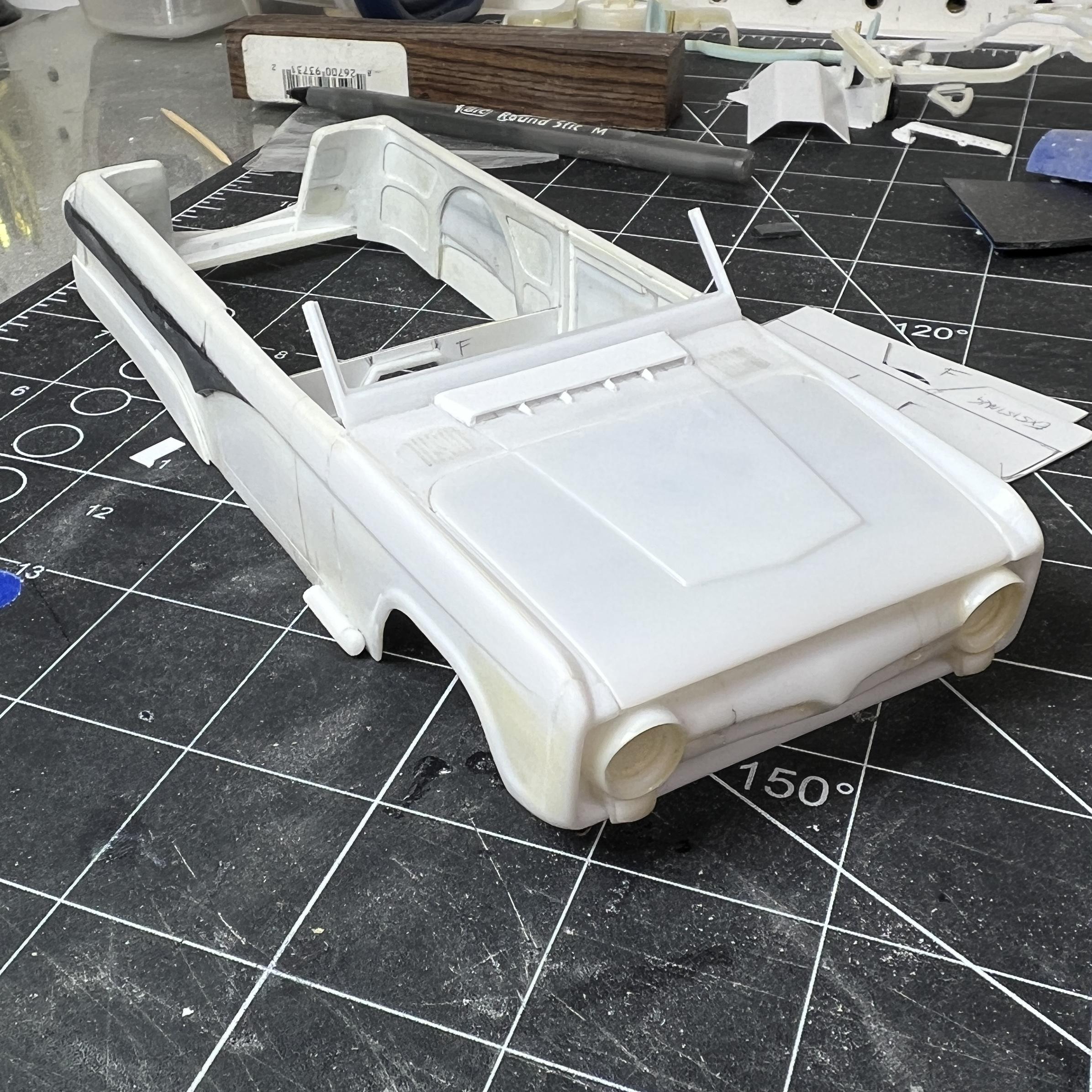

Remember this thing? to be honest I completely forgot about it.. However I booked my room for NNL East, and I want to take something... I went into my workshop to take inventory and look for a model I can have completed by April and this one jumped out at me. So here we go! NNL East of Bust! There were a few things that I was stumped on back in 2018 that caused this to get set on the WIP shelf of doom, so first things first lets get those out of the way. taillights bike ramp hood So first up were the taillights, I grabbed some parts box bezels and then altered the body line with some thick styrene. I'm going to use some epoxy putty to mold all this together. This helps make those cruiser skirts look less foreign and gives me a nice flat surface to do some 1956 ford inspired copper trim!

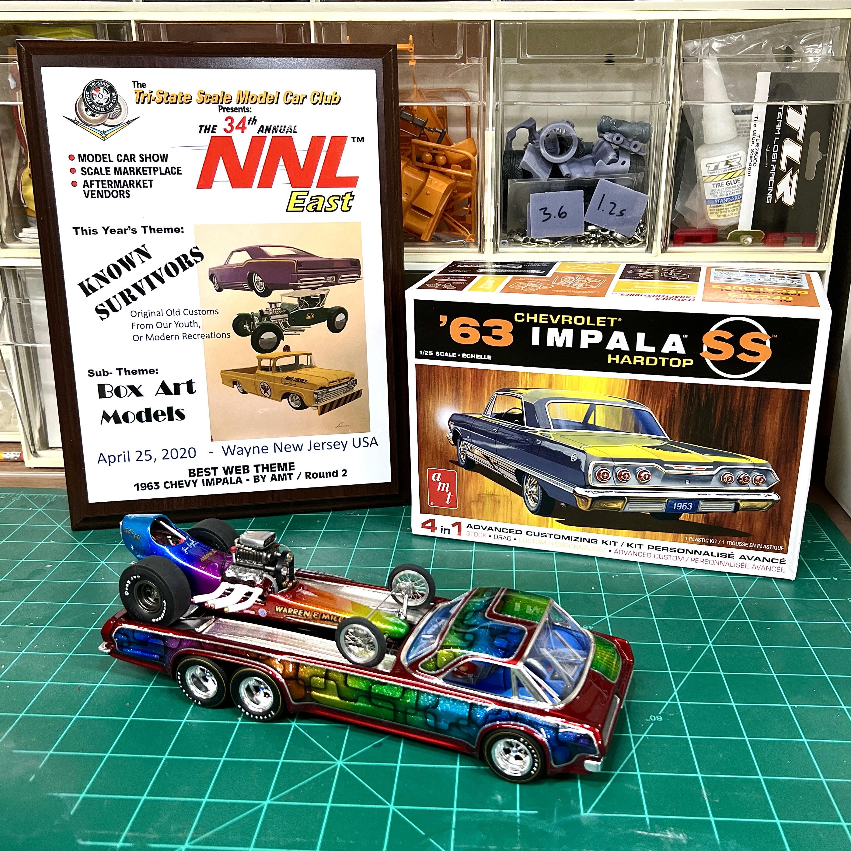

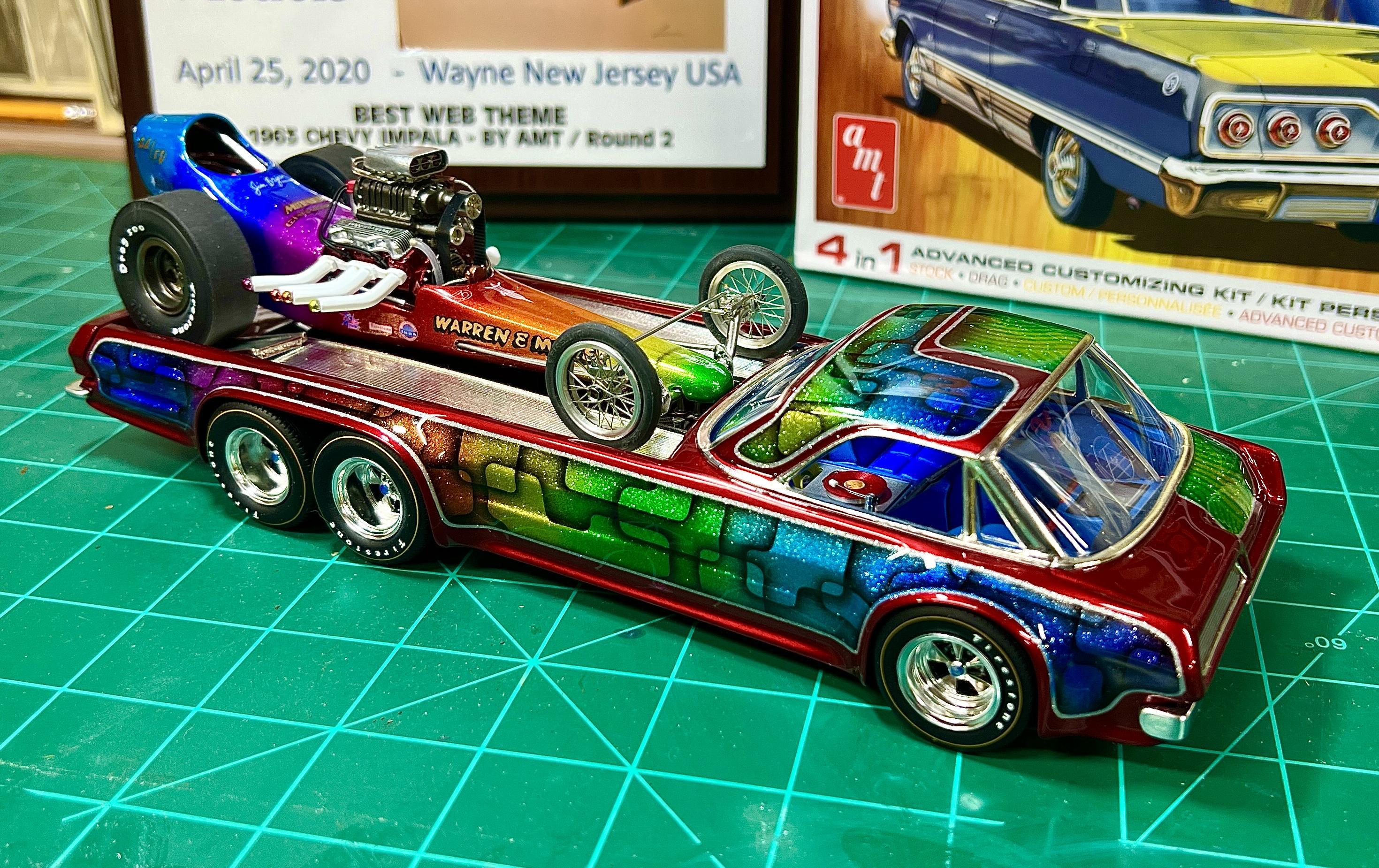

Thank you guys!! So I lied, these details came out too good not to share... but now it is officially done! I can not wait to unveil the pair at NNL East Saturday! Its been far-far too long..

Thanks everyone for following along this crazy train! I still have a few little minor details to do, but I'm going to call this one done! Ill do a nice under glass photo shoot after east!

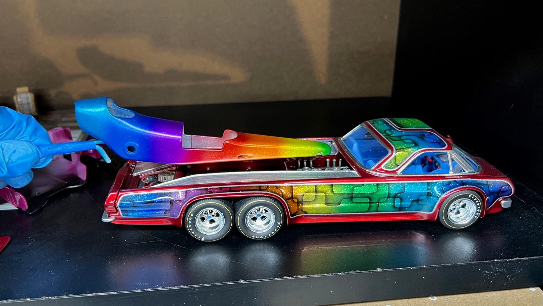

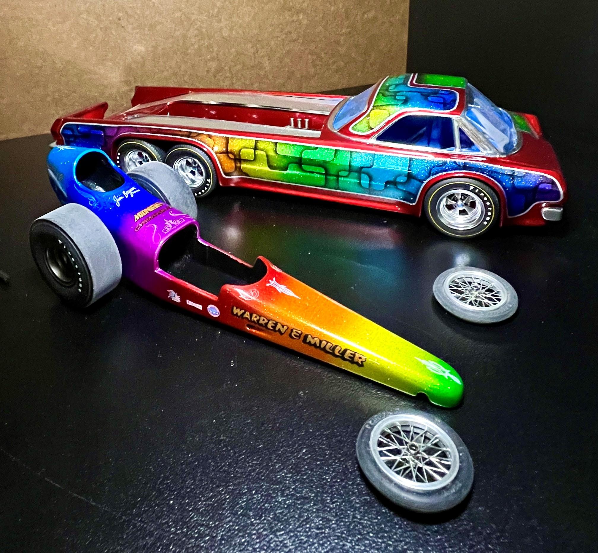

So trying to make a push to get this complete for NNL east... 3 years late but whatever.. ? I got the W-Block built and detailed.. still some final touches to add, but I'll do that after its final installation into the dragster. The fuel lines on the injection were extra fun... I finished up the body work on the body, primed and used the same metalflake combo on it as the hauler... then a bunch of urethane clear to smooth it all out. Last night I was able to get it sanded down with 2000grit and spray the rainbow kandys on it... the Splash Paints Kandys go on so nice, and the color builds easy so its a pretty controlled process... The plan was to have it match the colors on the hauler and I think I pulled that off pretty decent. I did bugger up the overlap in the back between the blue and violet, but its mostly covered by a tire and should be fine. Ready for one more round of clear, and then final assembly!

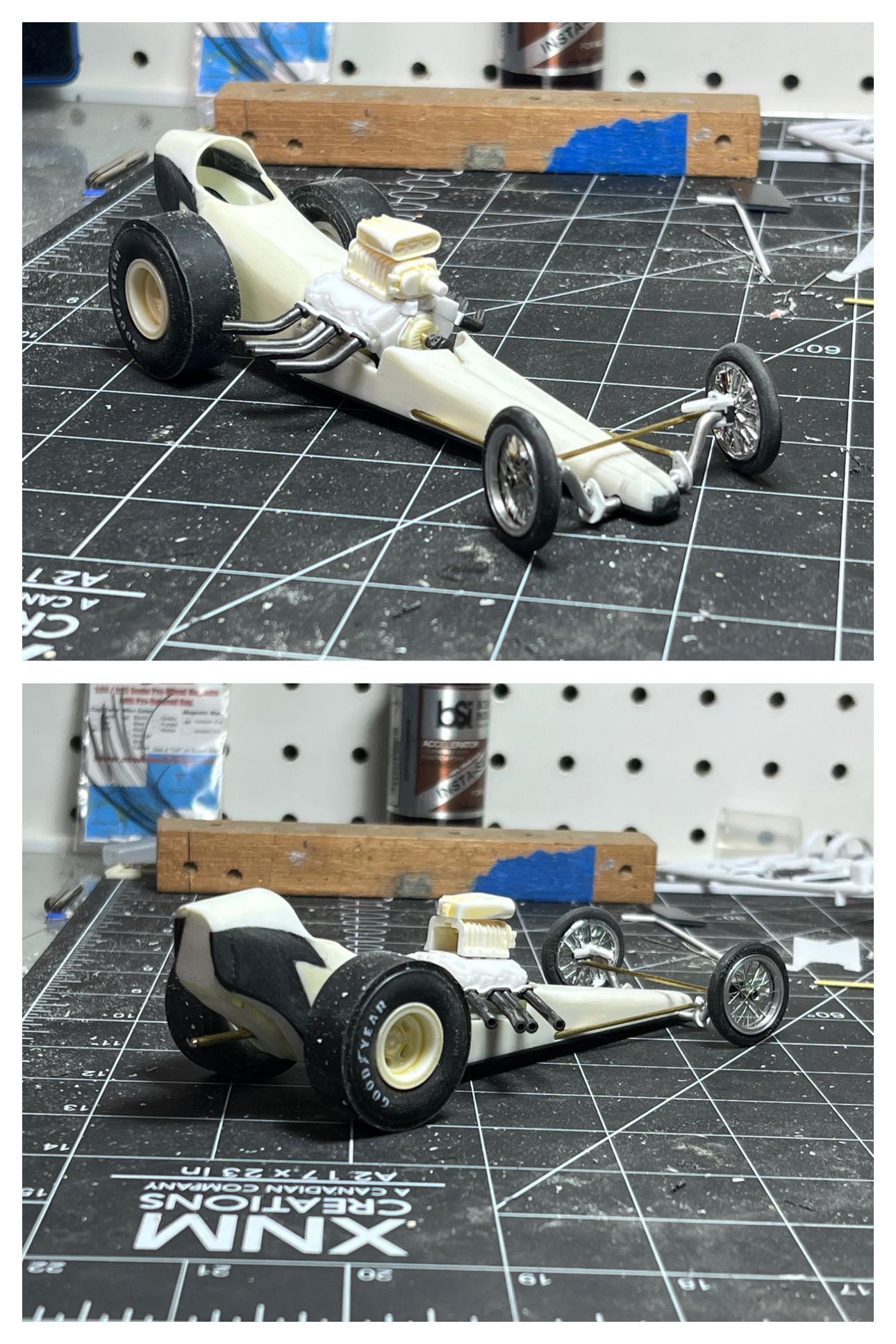

Thank you guys!!! Well, it looks like NNL East is a go! I booked our room.. now I need to finally finish this thing. I was actually going to do just that, until I saw this older tutorial on here and figured I had all the raw materials.. I should at least give it a go. http://www.modelcarsmag.com/forums/topic/150597-wire-wheel-lacing-tutorial-feds-simplified/ Surprisingly it was pretty "easy-ish"... I have only done the one so far, because I want to film the other as a "How-To" for my YouTube channel. I have also been fooling around getting the pose-able steering front axle built, located and the rest of the dragster body fabricated... Lots of experimenting with styrene shapes. I knocked out the headers and lowered the engine another 1/8" to make it look a bit more cohesive.... progress is happening!
