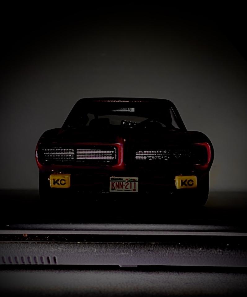

My entry for the 2021 cannonball is a Revell/Monogram 1969 GTO judge body with a Revell modern NASCAR chassis and drivetrain The paint is a spray bomb Chevy Red with a few different shades of testors and tamiya brown and black with some primer grey and the iconic GTO orange showing through in some spots. the air dam is the Revell NASCAR rear wing that is modified to fit the front end of the GTO and the KC lights are from a Revell 91 Ford F-350 roll bar. The engine is from the NASCAR kit as well but with a few minor changes such as the supercharger from a clearly scale resin LS3 and it is painted a slightly more modern version of the original Pontiac blue.

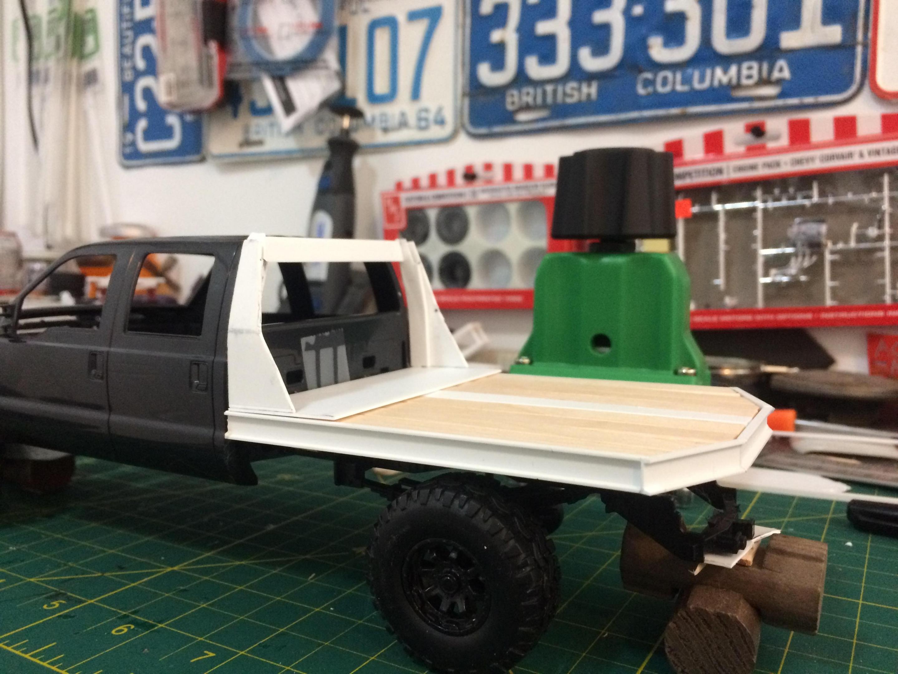

After 2 years of cutting, welding and grinding I have finally finished the flat deck for my truck. Now I just have to prep the truck for paint.

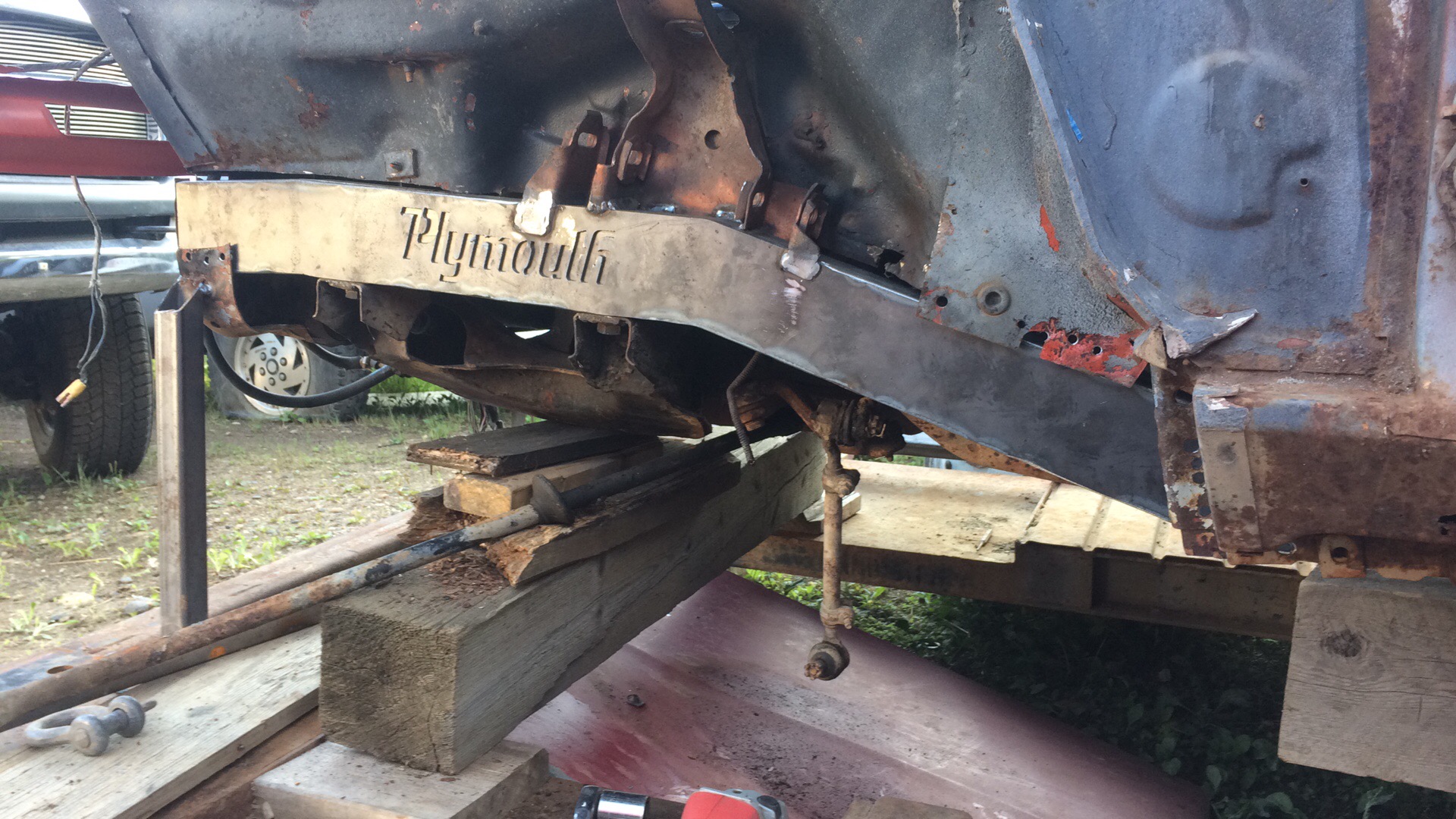

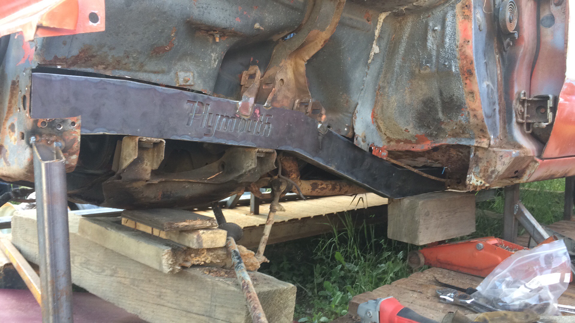

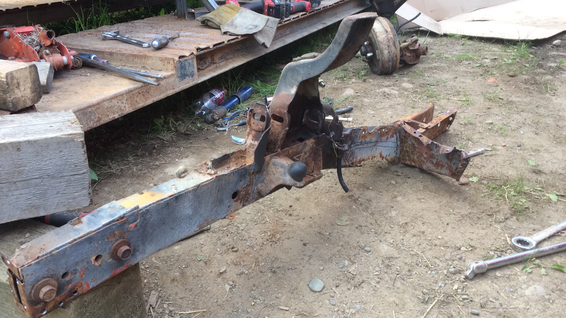

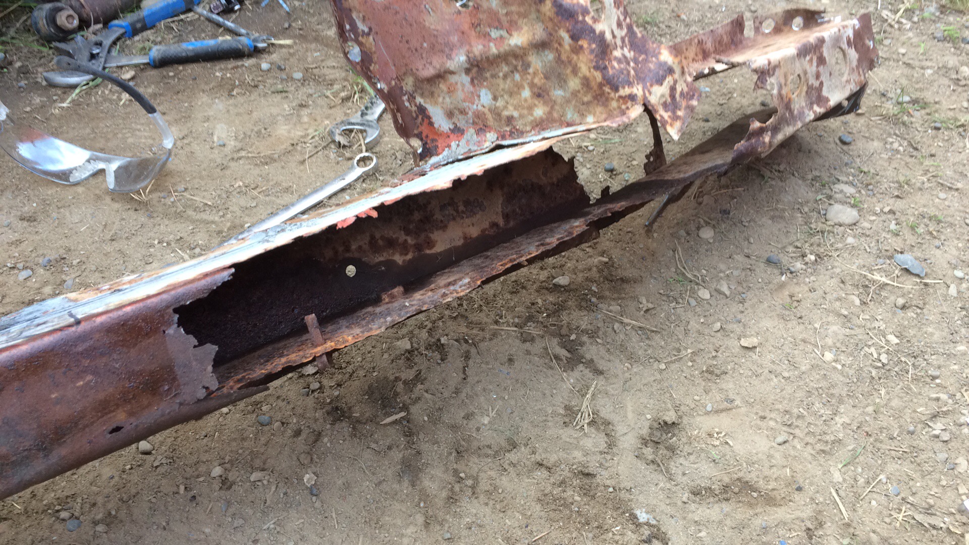

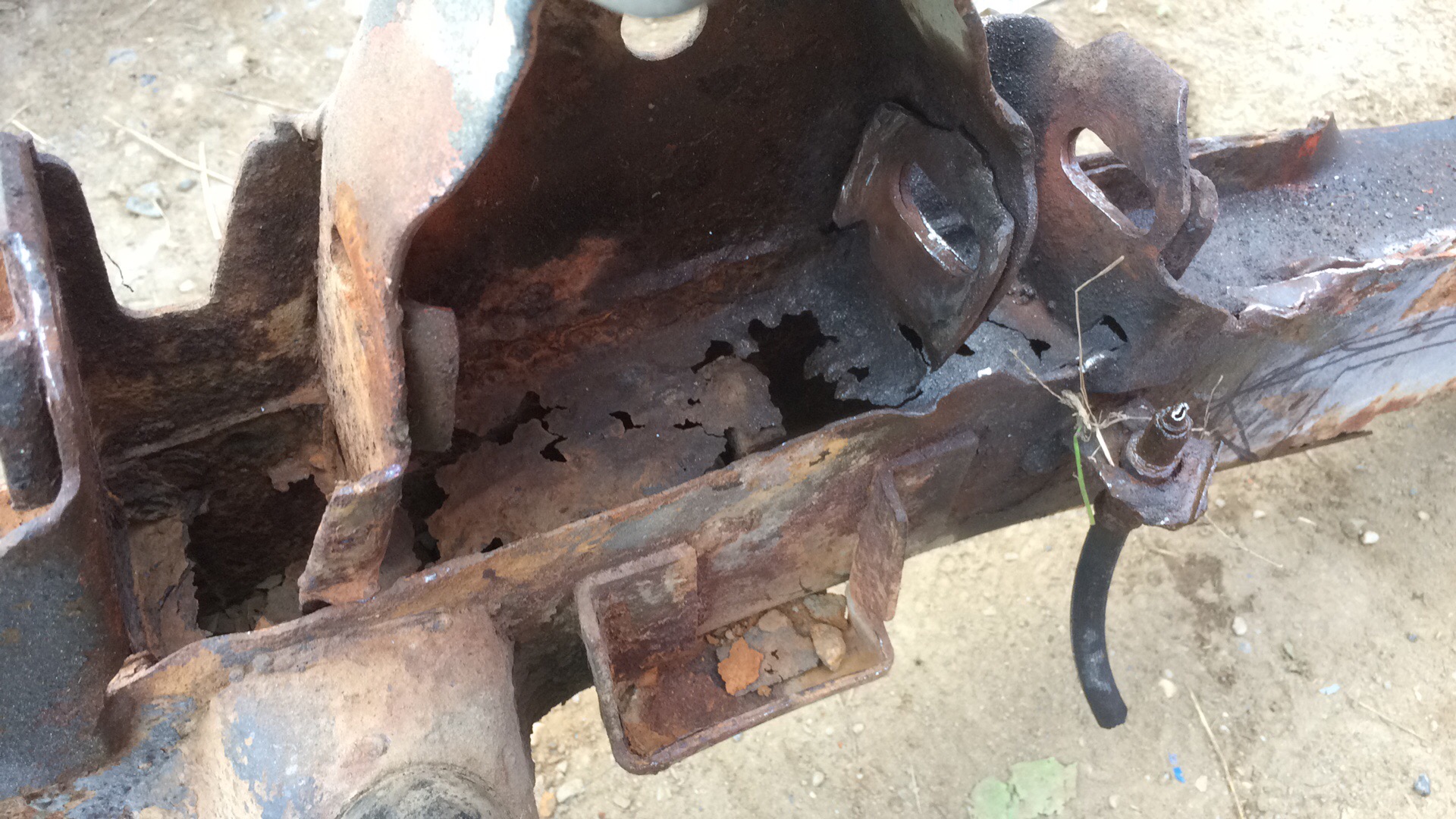

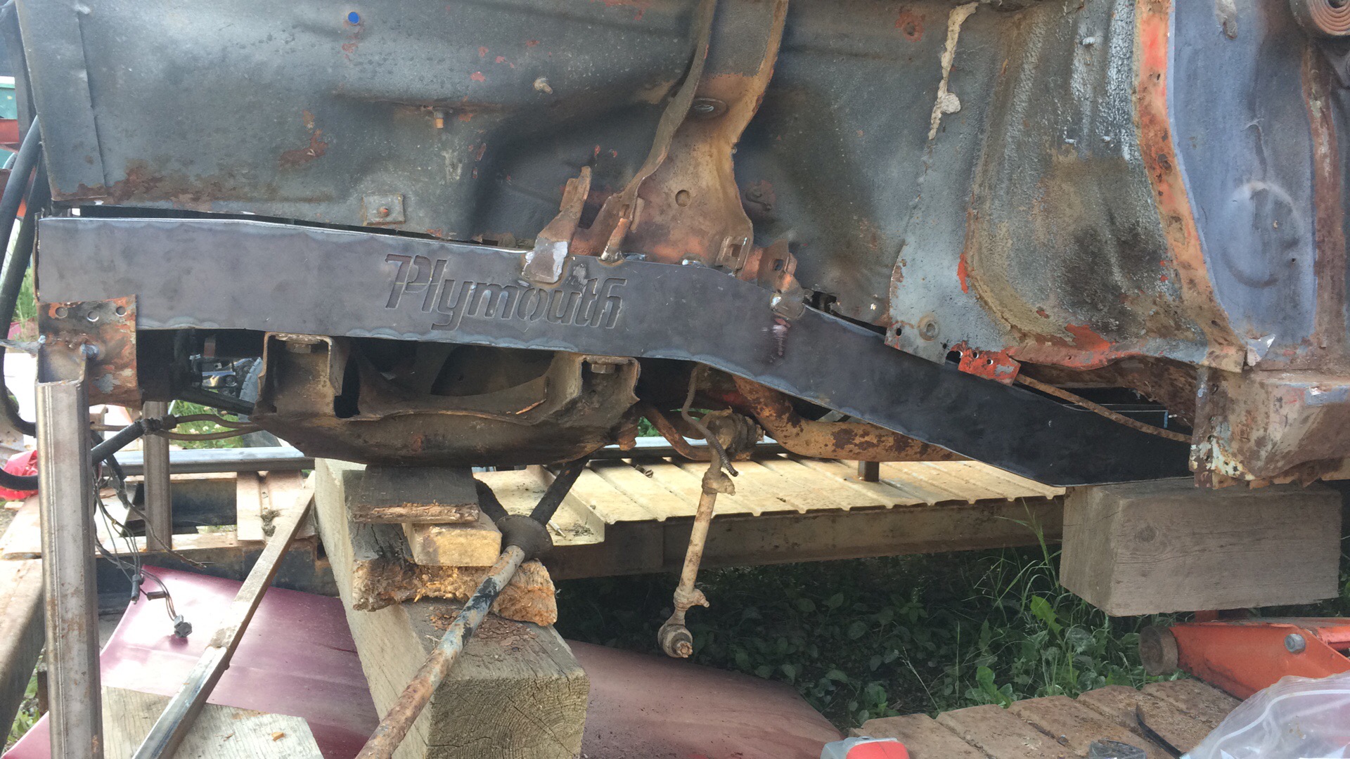

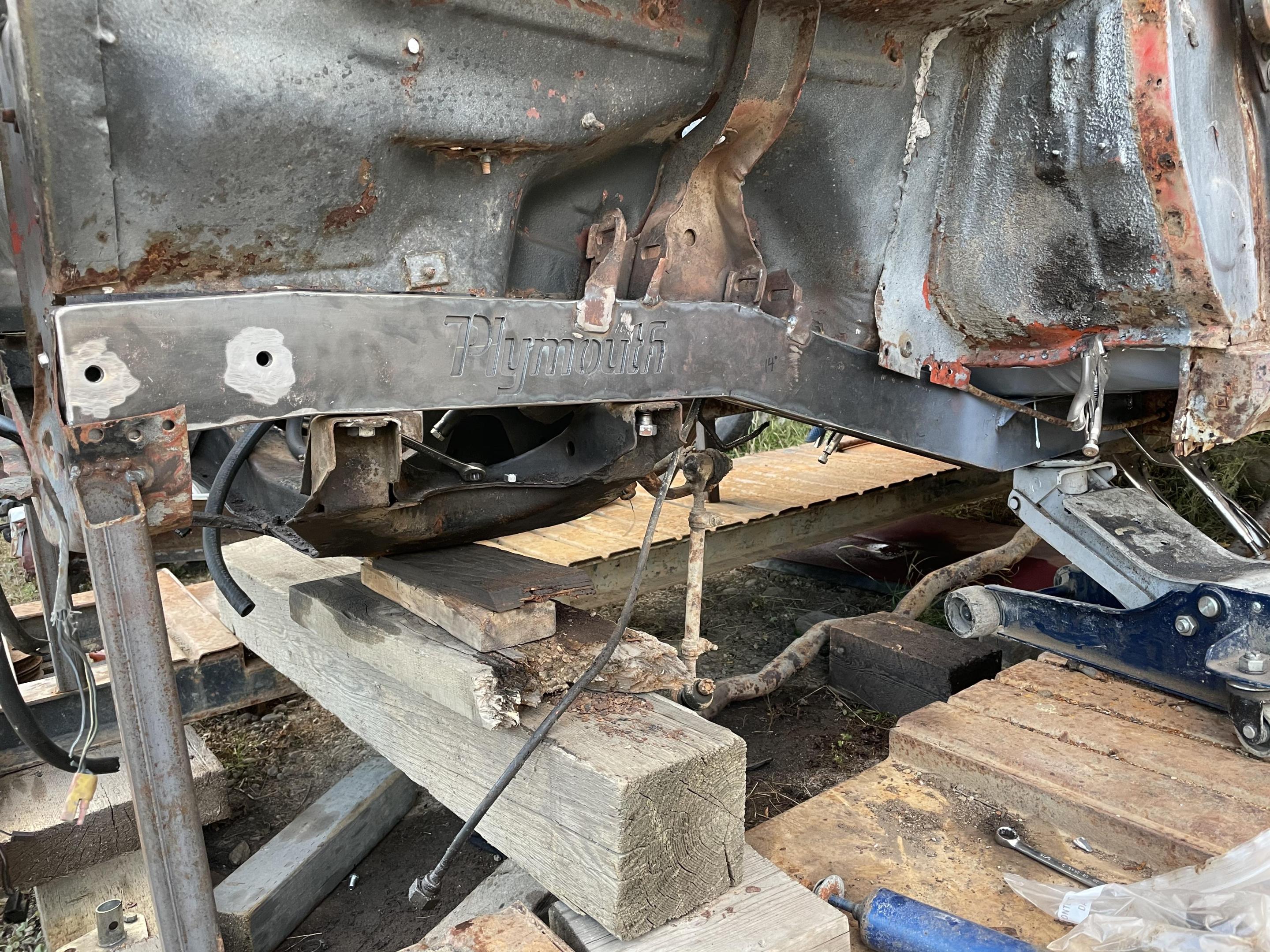

Test fitted the first of the two front frame rails that I’ve been working on for the past month for my 71 Plymouth valiant, the car has a sunroof and has sat for the past 20 years so the original frame rails were very bad. the new frame rail, it’s 2X4 1/8” tubing with a 1/8” plate on one side. the original frame rail.

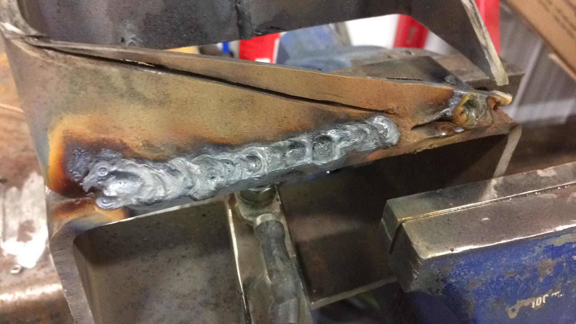

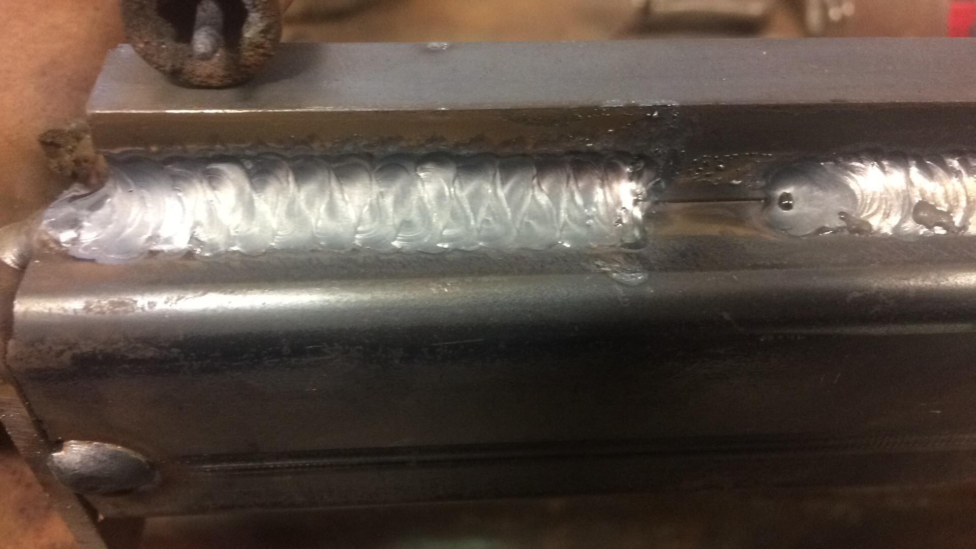

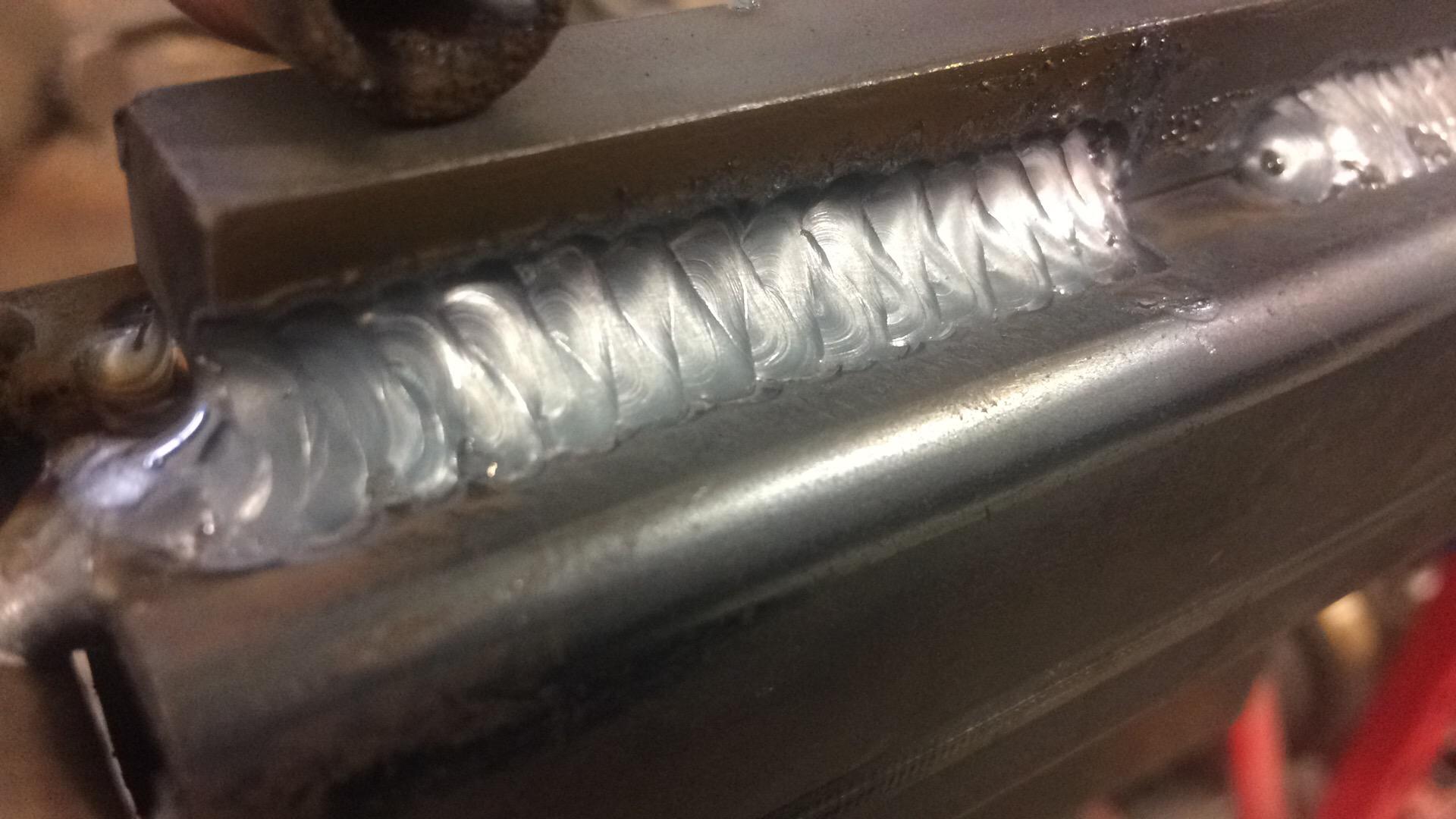

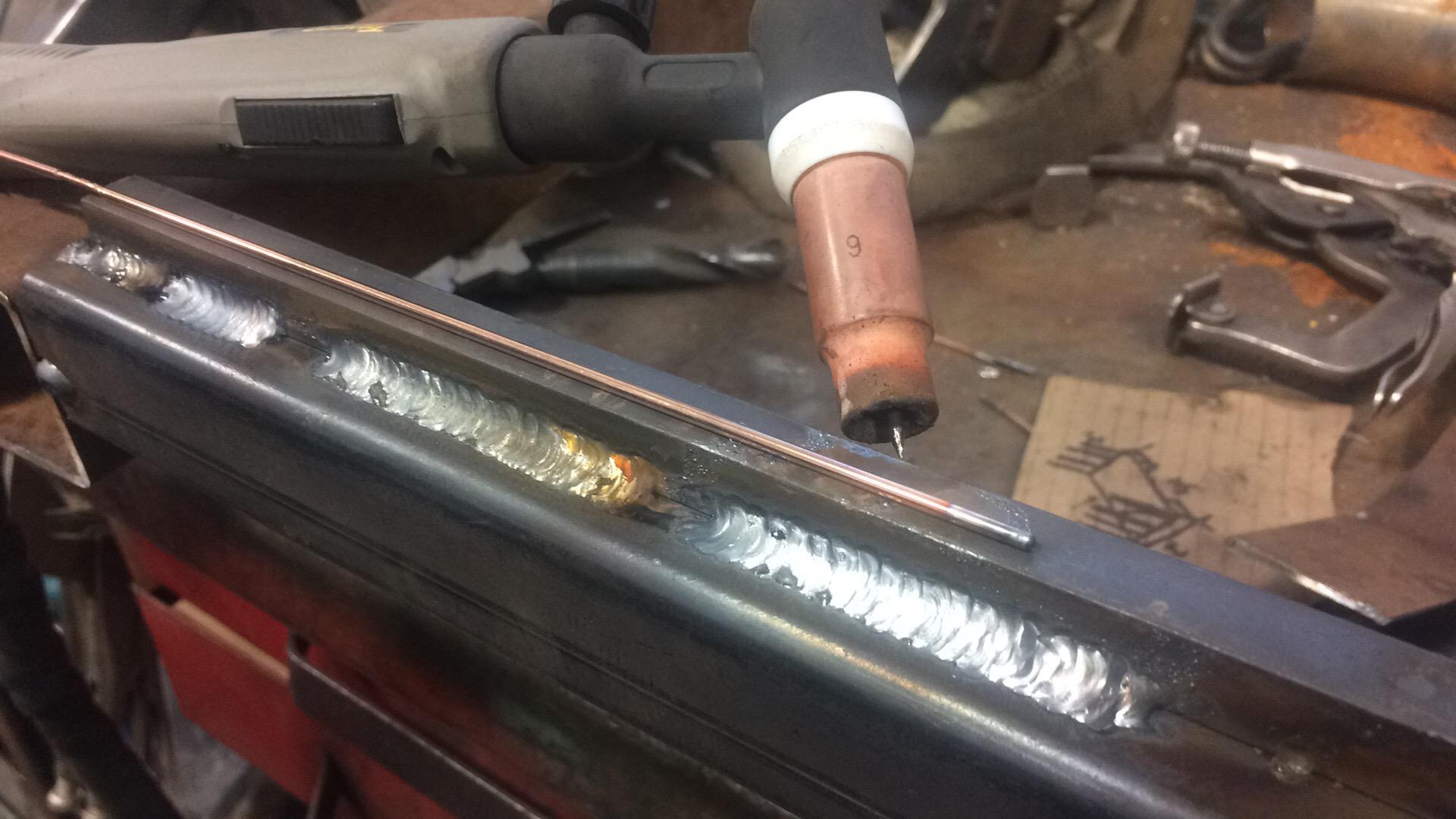

Two days of teaching myself how to tig weld and I’ve already started to lay down some nice looking welds on mild steel. This last picture was how the first hour of learning to tig turned out before I realized I did have my gas turned on....
