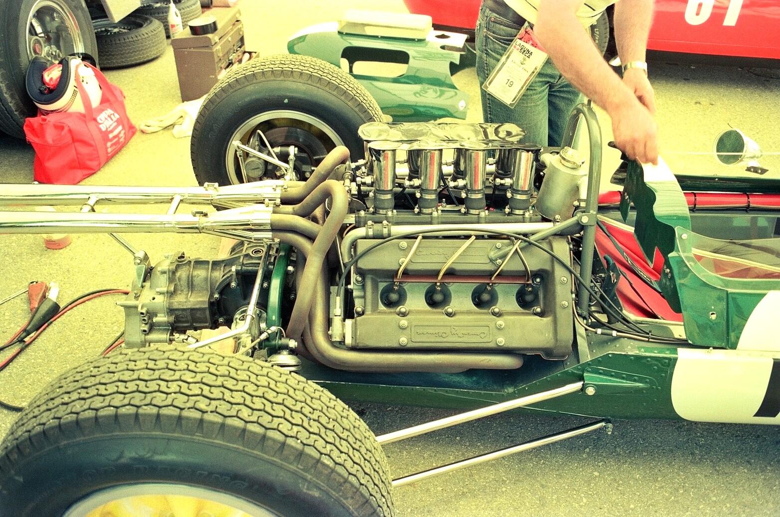

  6. Next experiments / white metal to white metal - the opening in the cowling was closed because the team Lotus located the transistor box up high in back of the carbs - until they changed over to fuel injection - team ran the Climax 8 with carbs for most - all? - of 1962 - if you were wondering where i got a scrap peice of white metal - its the strip that i cut from the kit top body half … which will come in very handy for some additional body mods …

  10. Sorry Mark - i’ll do my best to confuse you again shortly … Brit modeler Matt used some lo temp solder for his Auto Kits BRM build … i’m trying my hand at this - using this low tem solder and flux - and a Weller solder iron with digital temp control … off we go -
