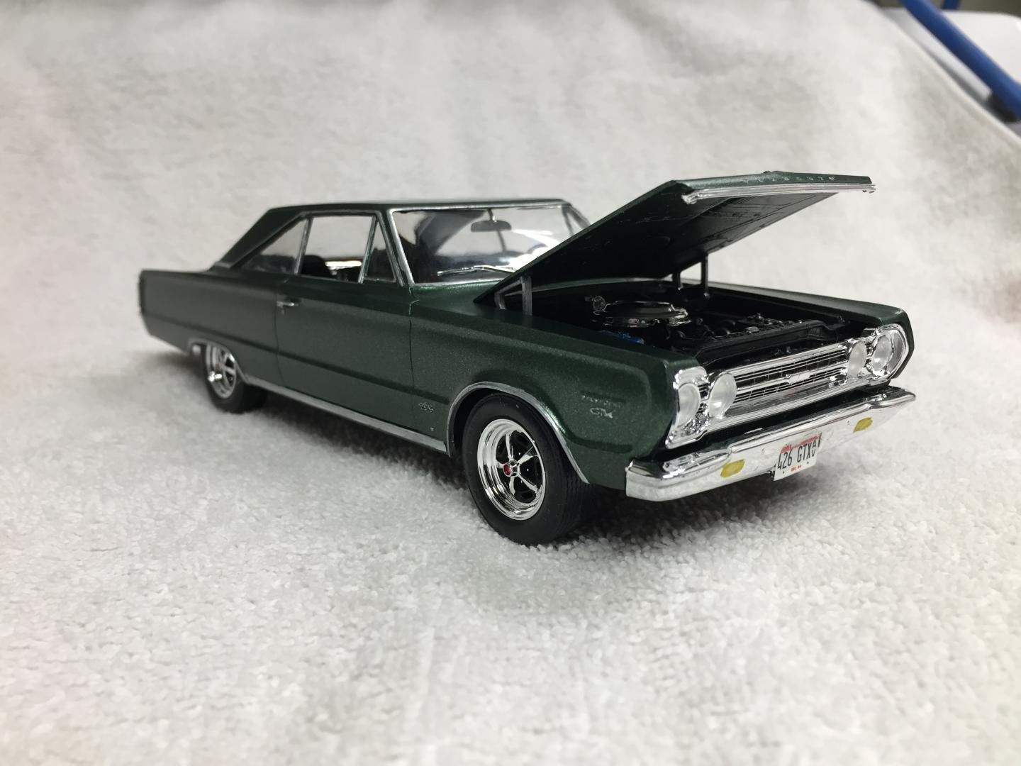

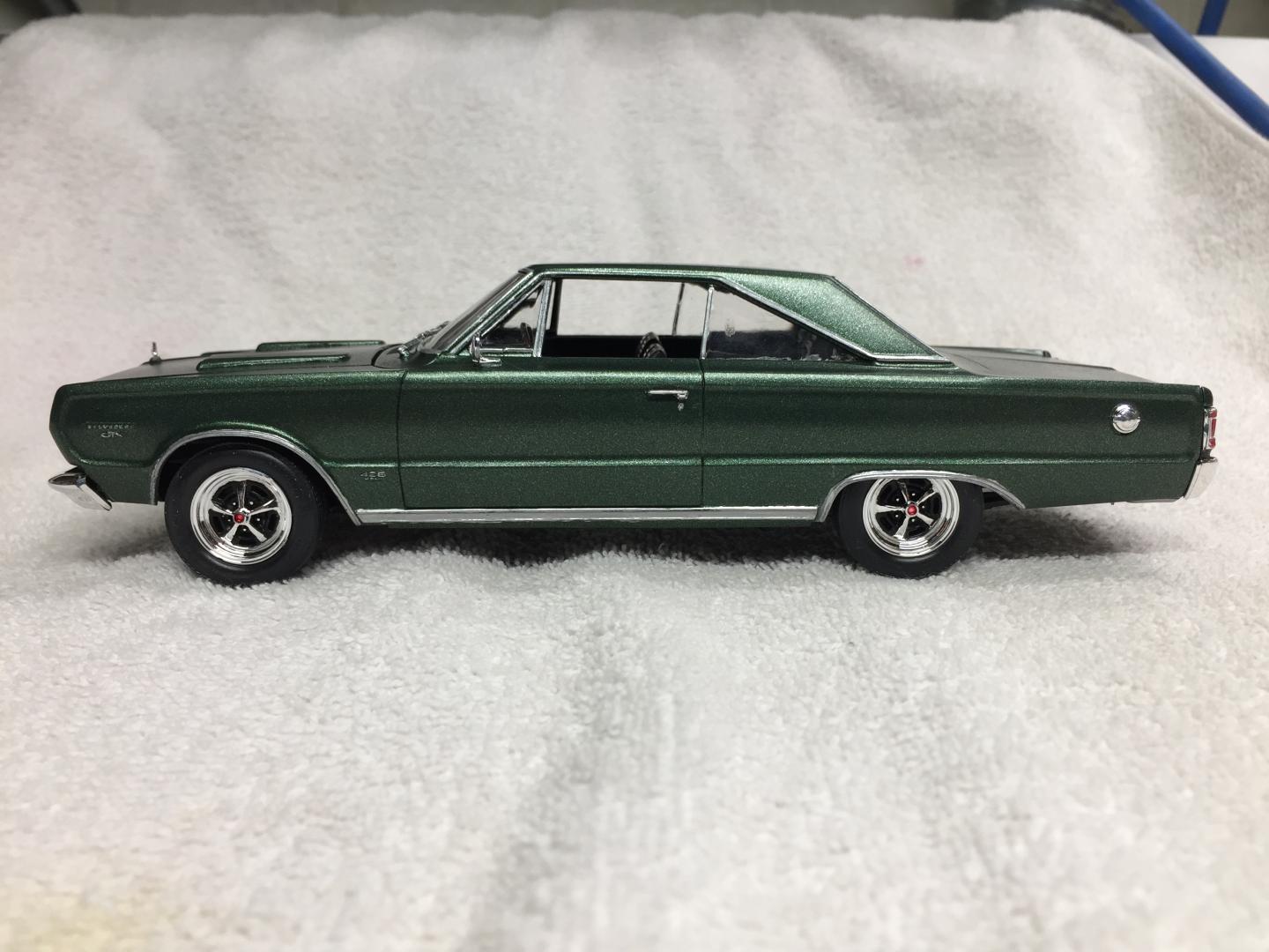

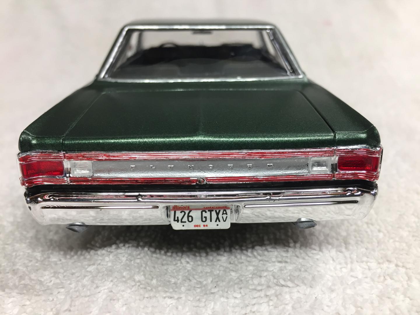

	Thank You for the compliments. None of mine are going under glass, that's for sure! On the rear I used MM stoplight red metallic and I should have thinned it down...it is very sticky stuff. By out of whack, do you mean out of scale or don't belong on this vehicle? Just curious. Greg.

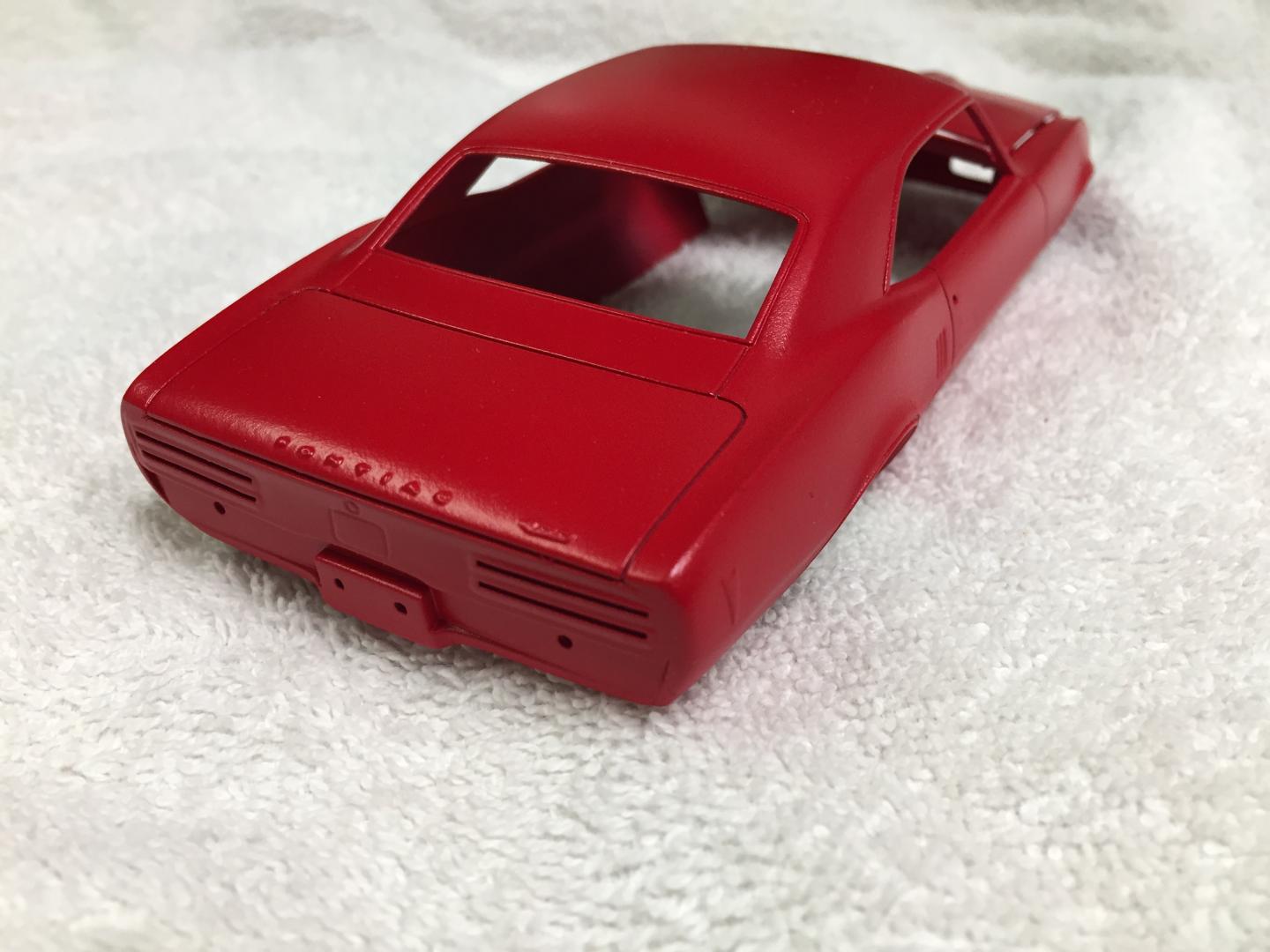

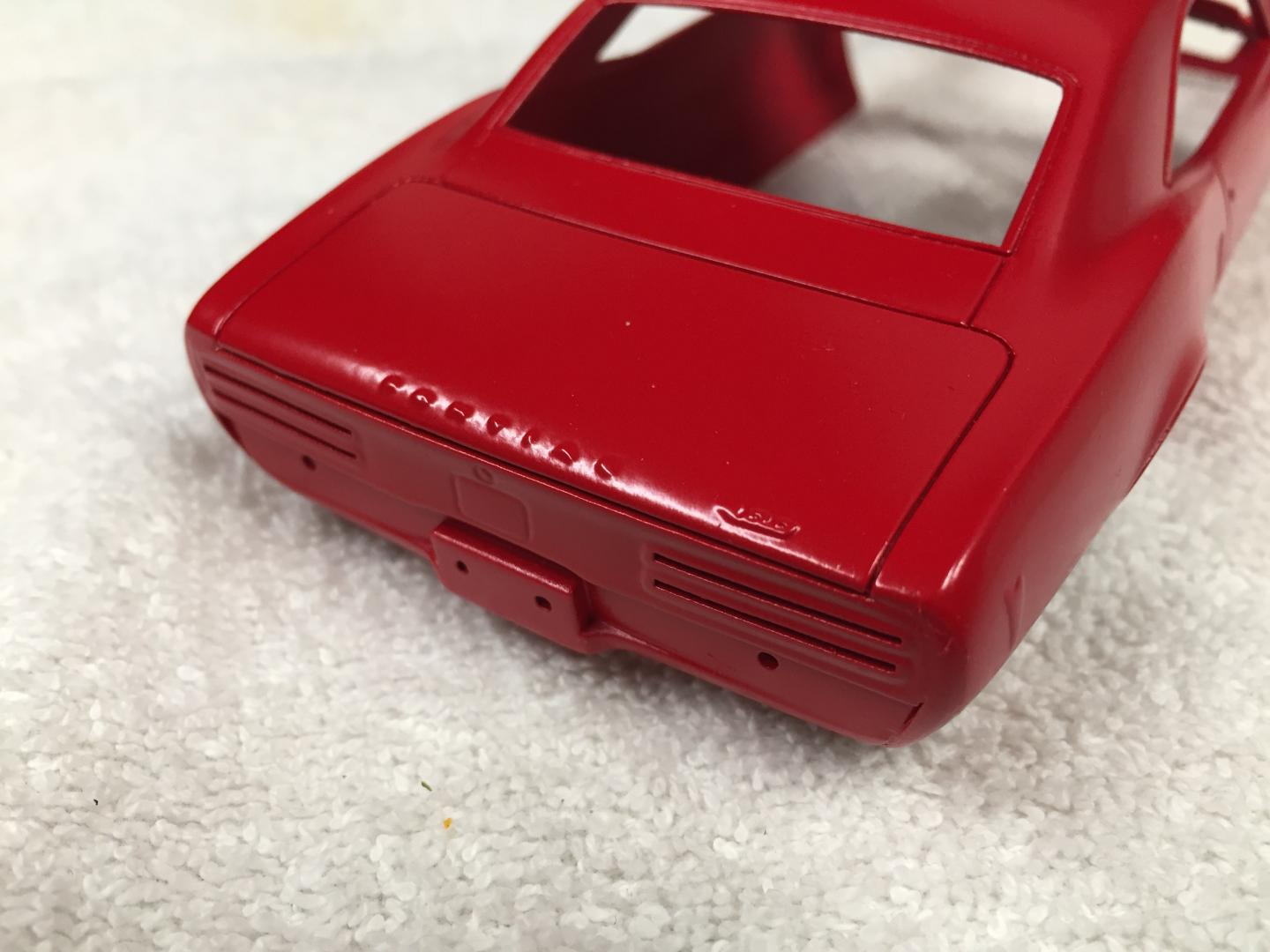

	I am trying to get this Spaz Stix solid red paint on smooth. I put one coat of krylon grey primer and one coat of krylon white primer from a rattle can. Then I airbrushed a lite coat of the red, heavier coat of red, wet-sand, another coat of red, wet sand, another coat of red. This coat, although fairly smooth, has dust or lint in it and needs more sanding. By now I have lost a lot of the detail on the script, mostly from paint build-up, as I tried not to sand it! I have read somewhere on here that some folks sand the script off and just use the decals. I have also read that some put 12 coats of paint on? Should I strip the paint and start over? What do others do to preserve the details?

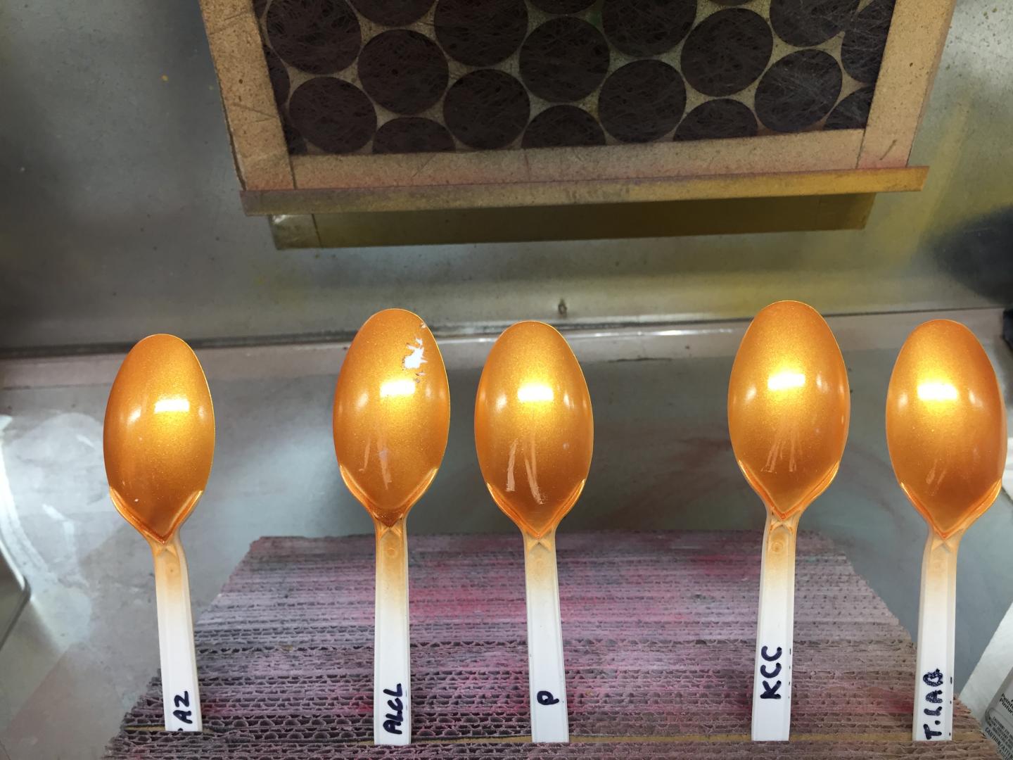

	I did a little durability test by scraping the back of the spoons with an Olfa knife. You can see how each of these faired. Once again the Testors Aztec seems to be the toughest. I am currently trying some Tamiya Pearl Clear. No pics yet, but it sure is purty!

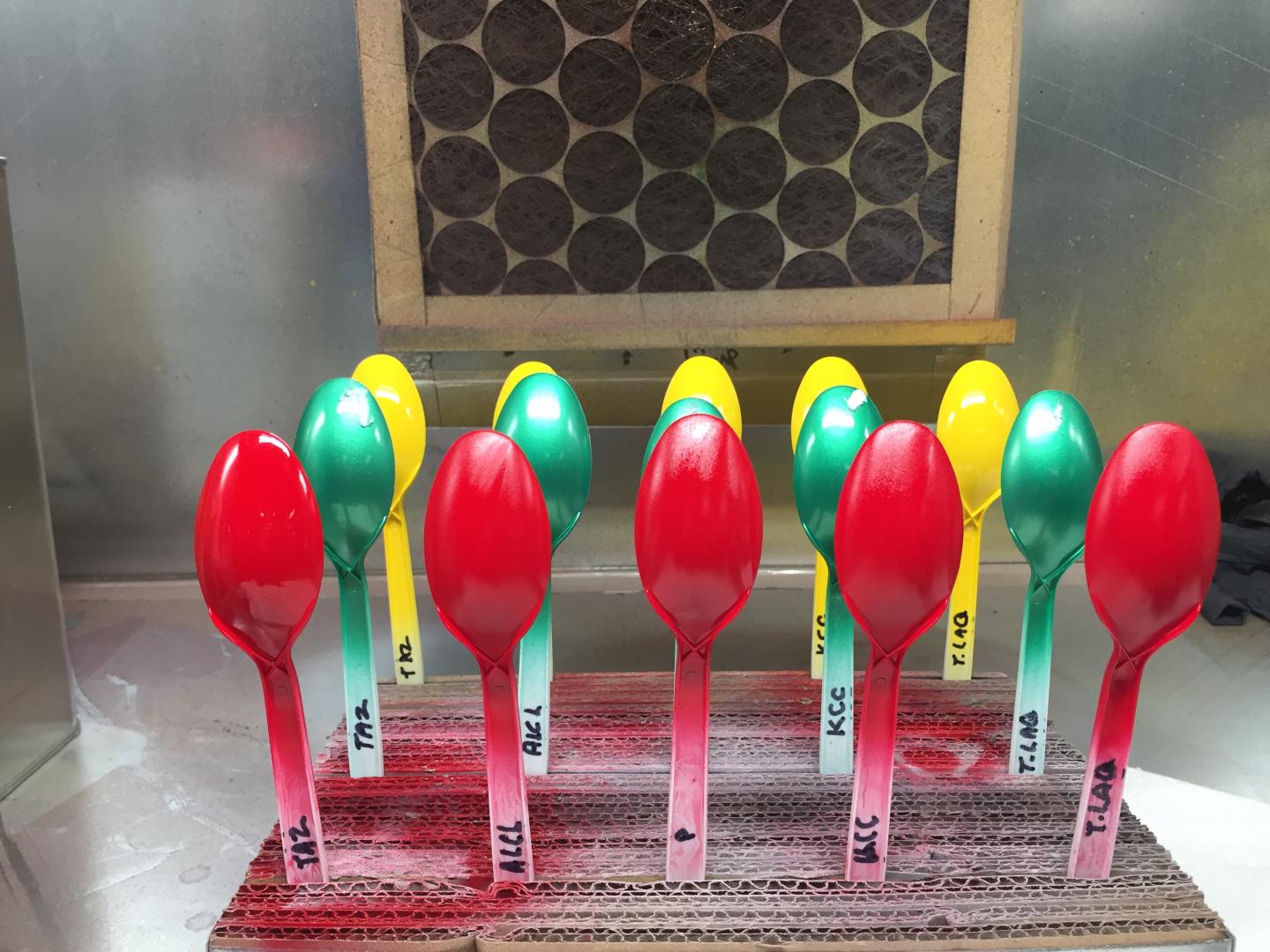

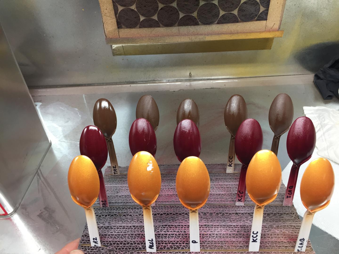

	So I tries a quick test of some clear coats on some different paints. The yellow is Craftsmart acrylic satin (AirBrushed), the green is Testors acylic pearl (AB), the red is Spaz Stix solid red enamel (AB), the brown is Krylon aerosol enamel? (RattleCan), the burgundy is something I got mixed at a local autobody supplier for my truck (RC), and the gold is Craftsmart acrylic metallic (AB). The clears from left to right are: Testors Aztec acrylic (AB), Alclad Gloss laquer (AB), Pledge/Future (AB), Krylon Crystal Clear (RC), and Testors Gloss Coat (RC). Keep in mind that I did not adhere to proper application techniques. All paint was done in one heavy coat with no spoon prep at all. All clear coats were done in two heavy coats about two hours apart. All of the clears seemed to do pretty well over the acrylic paints, but the Testors Aztec is the clear winner in my eyes!

	Ok, so I've got the body of my '68 firebird painted with Spaz Stix solid red. I will wet sand it a little to get it smooth, then... Pledge, install windows, BMF or...install windows, pledge, BMF or.......?
