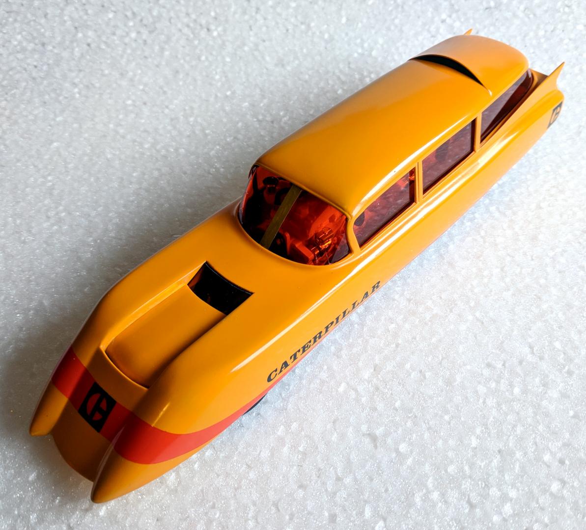

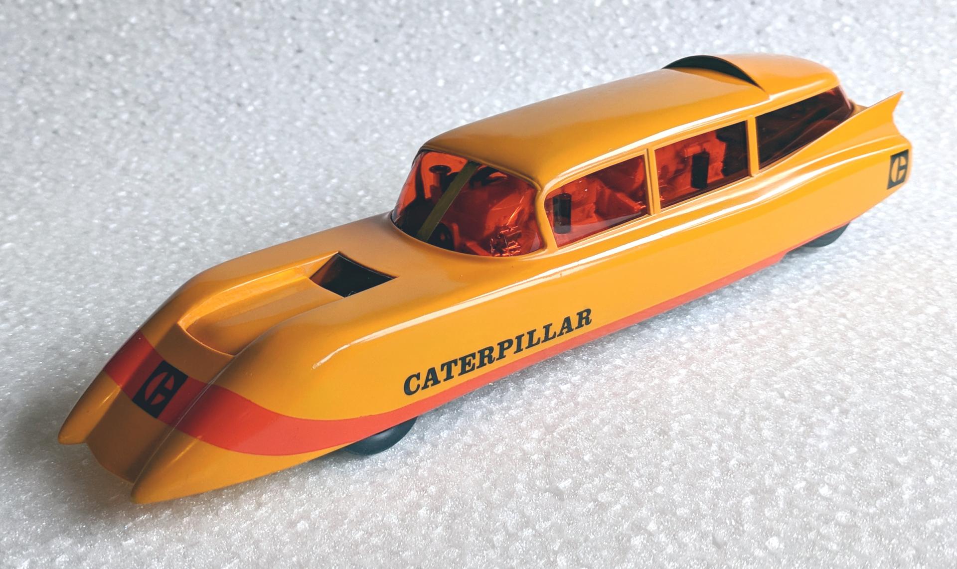

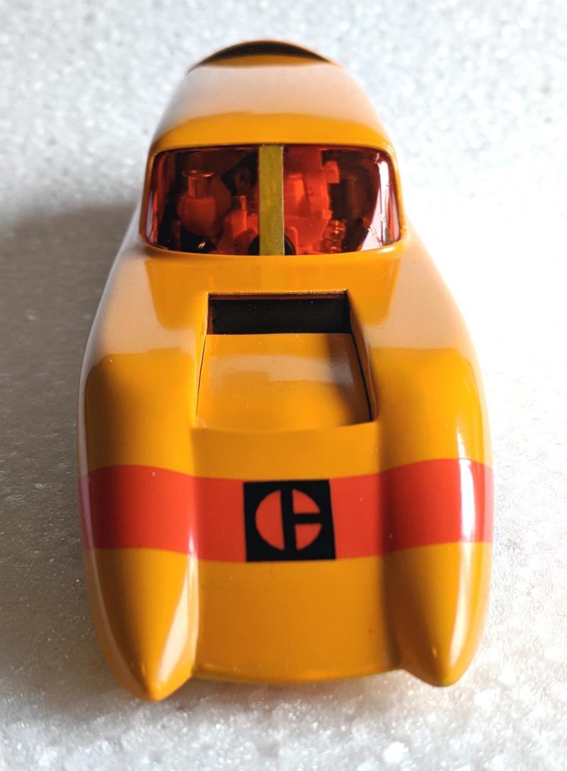

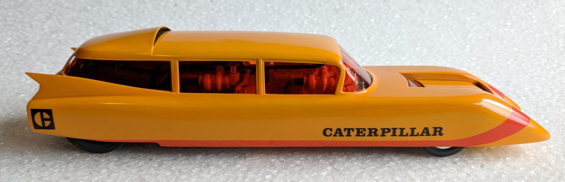

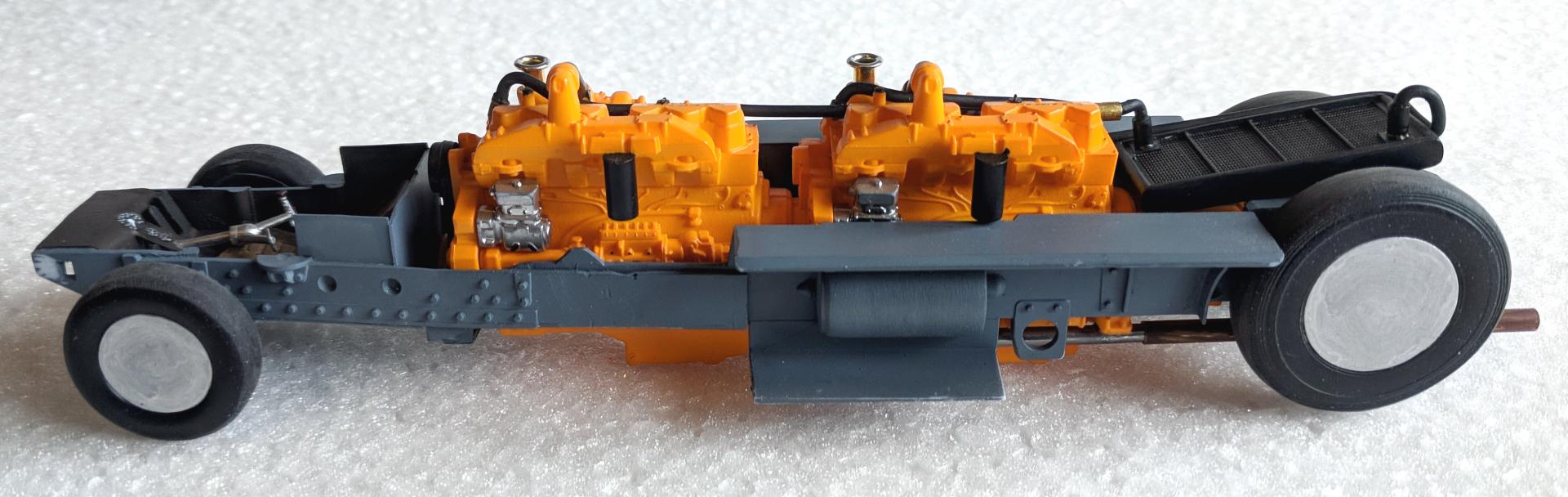

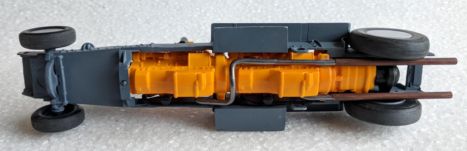

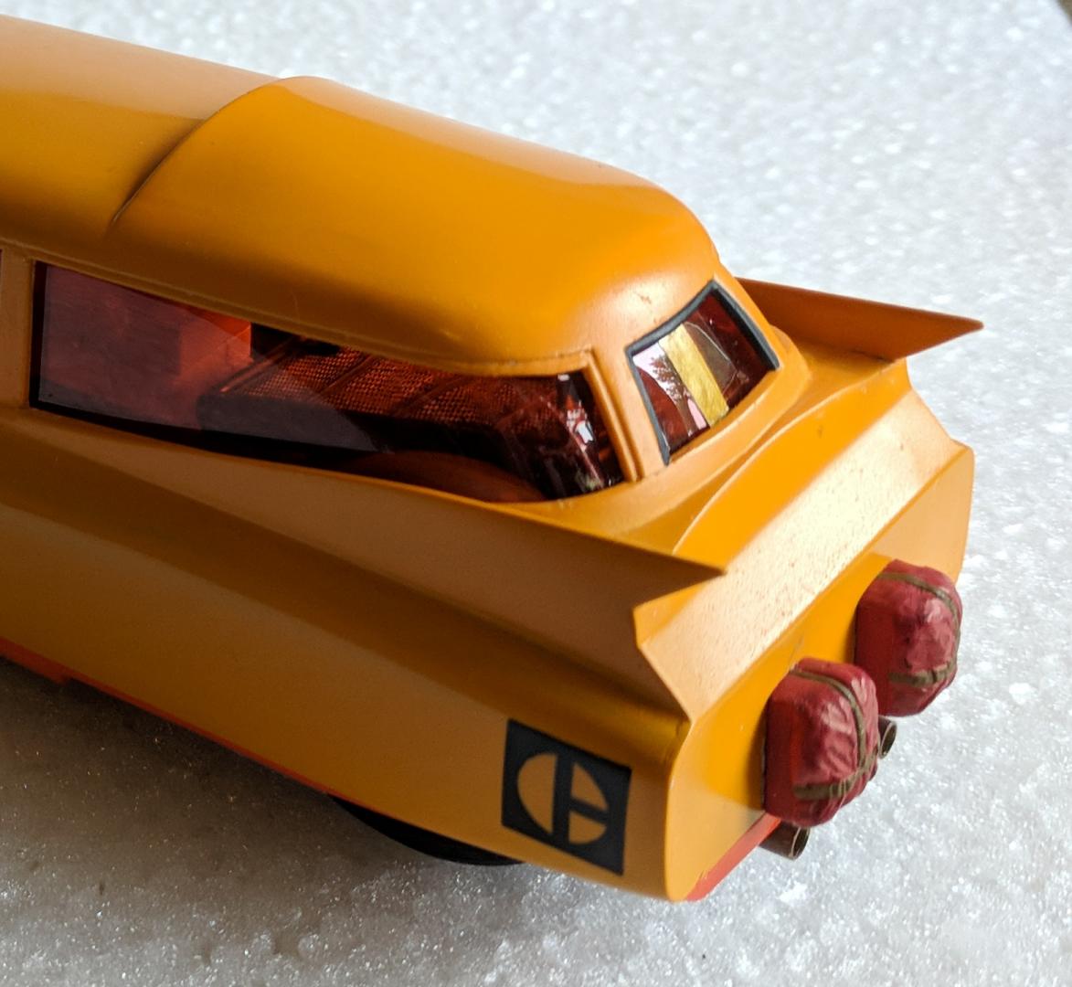

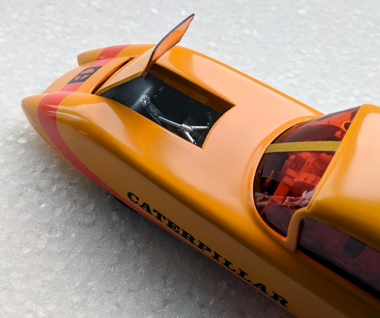

  14. It's done! Cat Diesel Land Speed Record Fantasy Car
  15. This is a land speed record car that "could have been but never was", based on components available in 1973. Power is two Cat 3406 6 cylinder diesels, conservatively rated at 550hp each but capable of much more. Target speed is 300mph, which I think would have been possible, IF you could find a driver crazy enough to climb in. Here's the specs: Displacement: 1786ci (29.2L) HP: 1100 @ 1800 rpm Torque: 3700 ft lb @ 1200 rpm Weight: ~20,000lb Cd: .40 Frontal area: 8 sq ft This was one of those projects that got totally out of hand, as you can see from the build thread here. I had recently finished another fantasy LSR car (Quicksilver), and this one was forming in my demented mind even then. The main components started life as an AMT Ecto1A and a Revell Kenworth W900, with an extra engine from ebay and lots of mods and bits from the junk box. Paint is Createx, Wicked Golden Yellow/Wicked Orange with 5604 Gloss Top Coat. "Caterpillar" lettering is dry transfer, "C" decals are photo printed. Call me crazy, but I find it very entertaining to imagine I'm behind the wheel of this monster with seven tons worth of diesels rumbling behind me. I may do more detailing on it someday, but I'm done with this one for now - except for the fantasies!

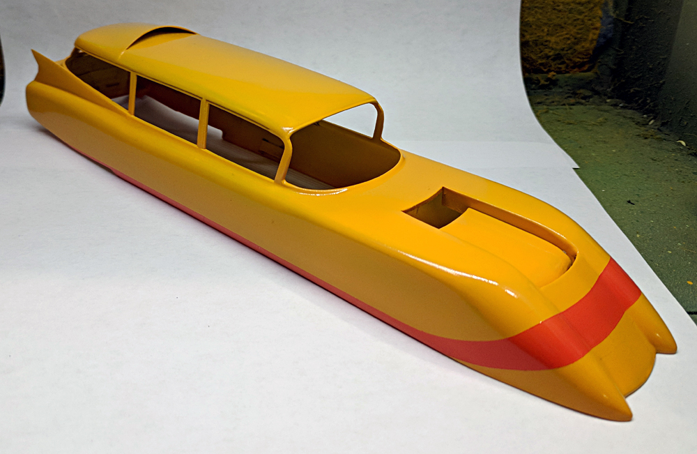

  16. And you all thought I died, right? Nope! Lots of other things happening in life, but slowly making progress on this one and looking forward to many more.

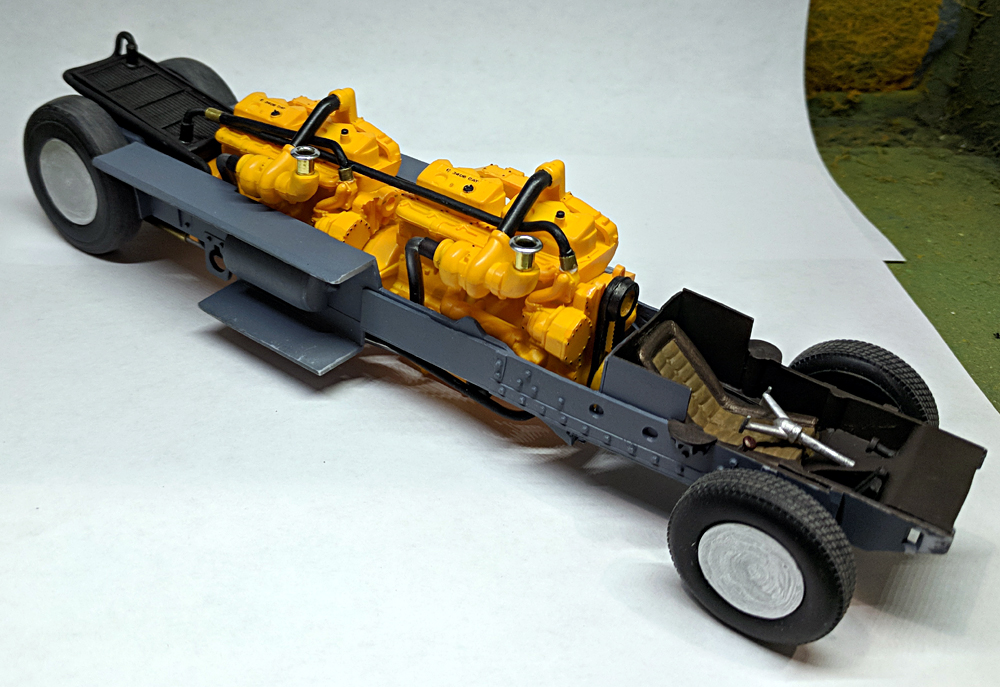

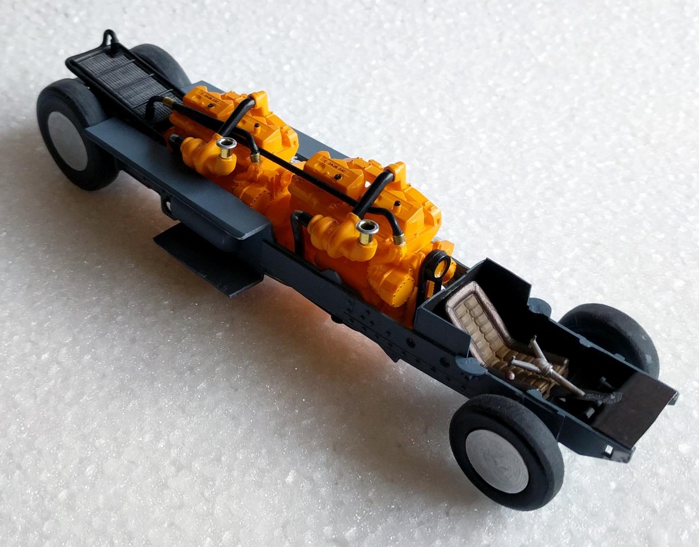

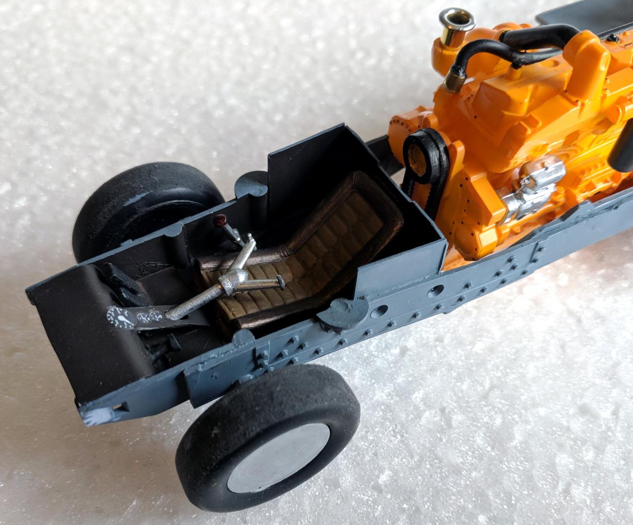

  17. Chassis is coming along nicely, still some touch-up to do on my sketchy painting. Got both colors on the body and started clear coat, but still much to do there. I have to finalize the name and design the graphics, too.

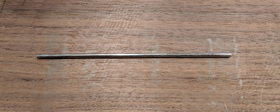

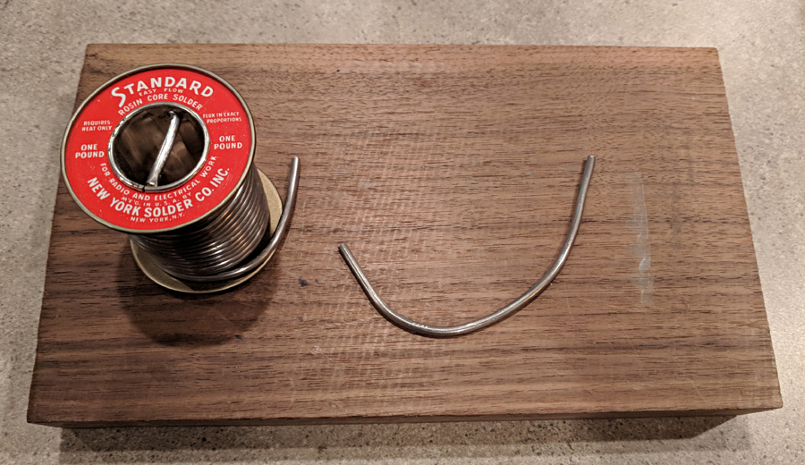

  18. Added the exhaust system today. I used solder for the pipes, I've seen this done by others but thought I'd share my method. As it comes off the roll it's rather kinky: But after rolling it under a flat board on the countertop - with considerable pressure - it straightens right out: After lots of measuring, bending, and messing up, I produced two form-fitted exhaust pipes... And got them installed, along with some brass tubing for the rear outlets: Safety note: I used rosin core lead based solder because that's what I had on hand, I much prefer it for actual soldering. Lead-free solid solder would probably be a better choice if you're purchasing for for modeling.

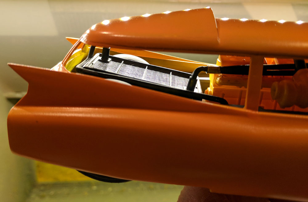

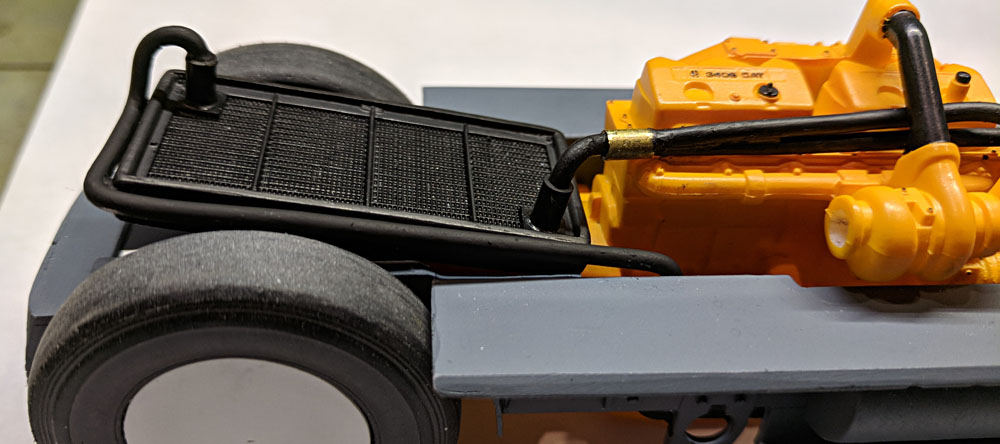

  23. It's been a while since I updated, but I haven't been sitting still on this project. Radiator has been fabricated, water lines run, just need to add intake and exhaust lines: Added a scoop on the roof to feed that radiator, and applied the first color to the body: Radiator is made from parts of the Kenworth kit sectioned and resized, hoses are solder: It's getting a little tight under the roof, still have to find room for the exhaust pipes! I've also spent some time playing with my new toy out in the snow!

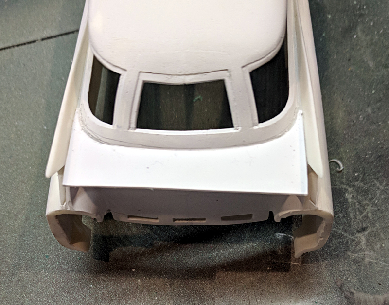

  24. Rear end construction starts with sheet styrene cut to fit just below rear windows: Another sheet scored, bent, and glued in place: Trimmed and ready for putty:
