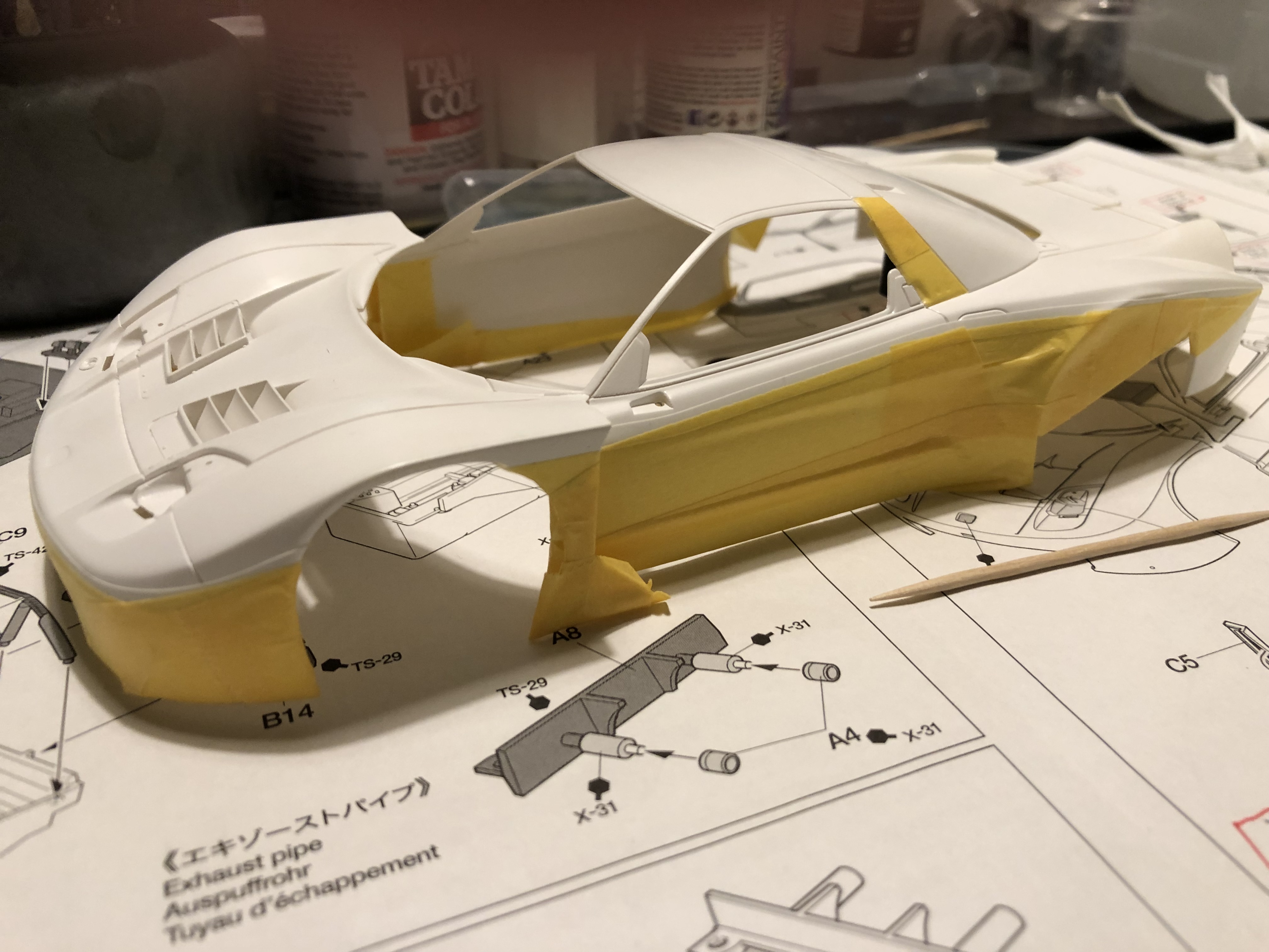

  1. So it didn’t turn out so great :/ tore the seam between the masking and the body when I removed the paint. I waited about 10 minutes. Any tips for next time? I’m going to sand the seam to make it more even. Maybe I just applied too many layers of paint.

  3. Airbrushing lacquer onto primer and a base coat for two-tone body. When do you remove your masking tape? when the newly applied paint is still "soft" an hour after last application, or 24/48 hours later when it is cured and more brittle? always wondered which method produced cleaner lines. I am using zero paints and tamiya masking tape.

  9. Yep. I sanded the body with 400 grit and I always wash the sprues and body with dish soap. ? I will test shoot some of the zero primer applying a wet coat this time and see if there is a difference.

  11. New body. Primer’d with Tamiya white. Ran out, so I tried the new Vallejo “base coat” spray cans. Not a big fan. It seems to be tacky to the he touch 24 hours after application, and also brought out the ghost lines in the mold lines. Honestly, might just stick to the Tamiya products in the future. They are pretty BLAH_BLAH_BLAH_BLAH solid. also already applied the pure white paint to the bottom half of the body. Giving it a few days to dry fully before I mask and apply the blue. Also tried a new primer for the chassis and interior parts. It’s a product by Gravity-colors. So far so good! laid down easily and highlights details nicely. It only came in “grey” though.
  12. So first attempt on the body was a total failure. After masking and applying the EPSON blue (by Zero Paints), the paint started to blister and crack at stress points. The conclusion: non-existent primer etching into the plastic. Either the zero paints primer is a poor product, or I did not apply it correctly. Some have told me I needed to apply a wetter than norma coat to etch Into the plastic. The 400-grit key on the plastic didn’t do anything either. With this in mind, the body was a total loss. Instead of striping the paint, I just bought another kit and started from scratch.

  15. Yeah it’s a shame... they really need to just pull the product. For me it wasted quite a bit of work and a ton of re-work. Not happy but I learned from it.
