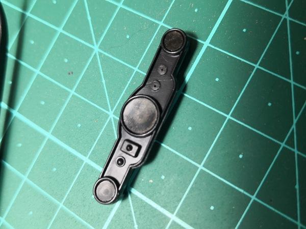

So after quite some time away I have dusted off this project and aim to complete it soon enough to get cracking on a few others... I had a look at the front spindles of the kit and compared to reference photos and redesigned matching spindles and 3D printed them. Reference: 3D design: Cut off the original spindles and modified the frame to fit the new parts: -

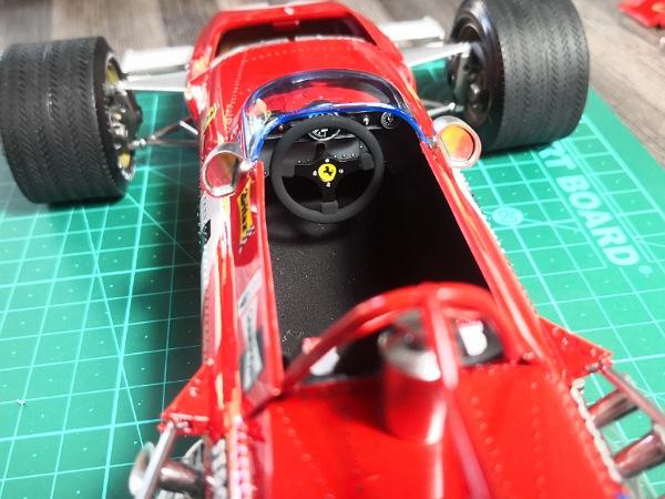

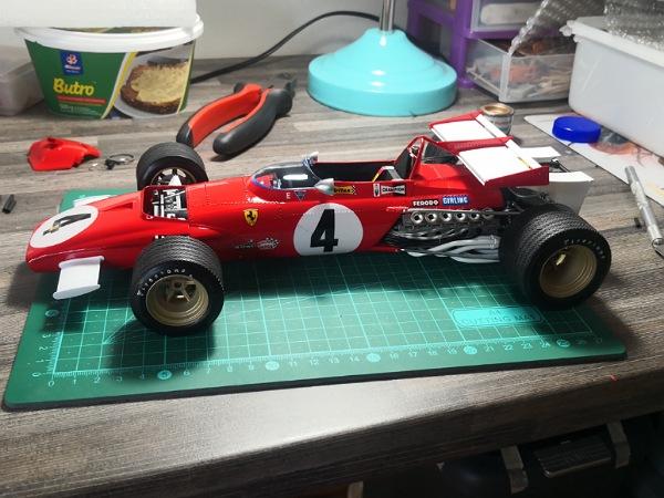

So with a bit of a push, I am hands off, job done! Will get a couple better uncluttered pictures a bit later, but for now here she is on wheels and ready to go. -

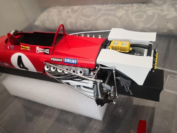

4 days left.... And we're hooking up the battery about to fire some life into this baby. My own 3d printed and designed battery terminals, with some rubber hose I had lying around... Was a bit worried that they were too thick, but loving the look now that it's on. Otherwise, rear suspension is on as well, so mostly tying up all the final bits and pieces now. Will take some additional pictures later. -

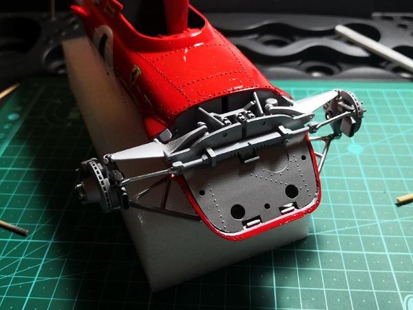

So with exactly 1 week left until this needs to be done, I am feeling pretty confident, although each step still seems to take so much longer than expected. My own designed and printed vented brake disc's - kit part is unvented which is inaccurate and quite visible. Front suspension on, feels like we're starting to get there. -

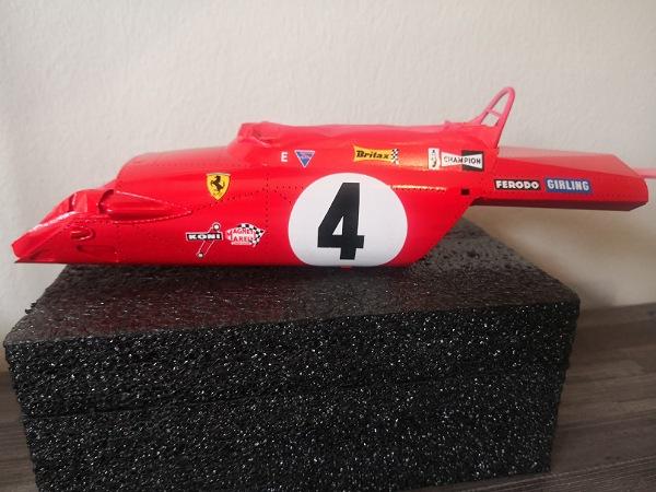

Well as it stands right now, my count down to completion is now on 14 days if I am going to make it for the local competition.... Last SA GP was 1992 won by Prost in the Williams. Can't wait to get this one over the line now. -

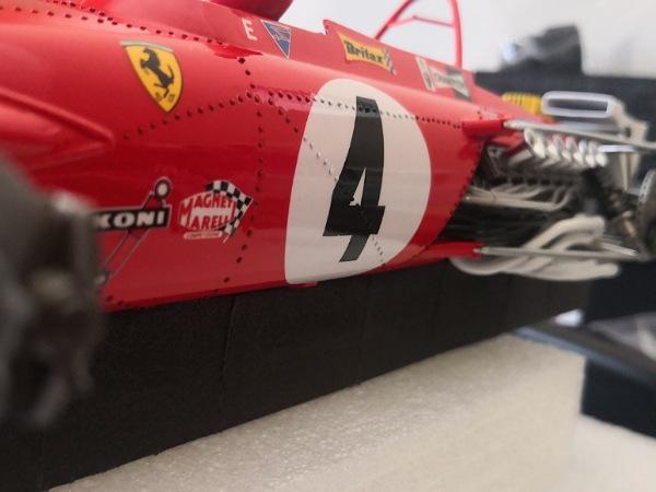

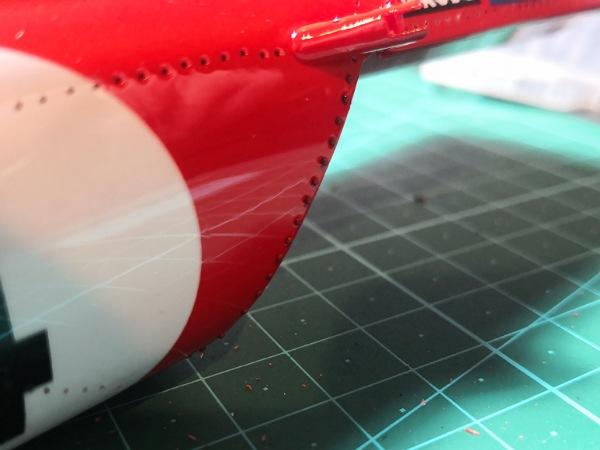

Getting stuck into the fitment of the 3D printed rivets... I quite like the results, but what a lot of work, having to redrill all the holes first and then try slot one of these bad boys in the hole.... -

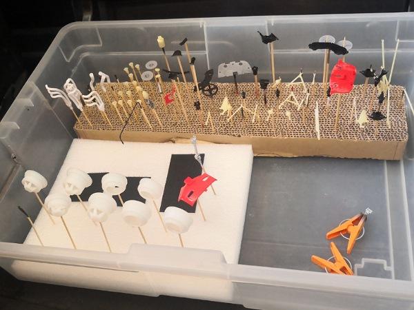

Going to hopefully be a couple of updates coming up, and hoping to get this one over the line as I try to complete it for a local modeling competition... Big painting session yesterday: Also managed to finally find a solution to these holes where the gauge decals are meant to be, my kit did not come with any inserts, later kits had photo etch disc's to provide a level base for the decals. 3D printed these little disc's as inserts: -

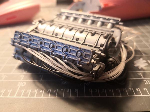

So after quite a break from this build, I have started making some progress... Wiring up the engine: and finished (hopefully) sanding the main body section in preparation for primer and then the base colour coats... Some careful masking needed, can't wait to see it in colour... -

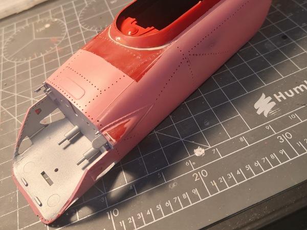

Pulled this back out of the closet, and previous sanding efforts showed a slight indentation along the join on the one side. Spent a couple of minutes applying some more putty, added it quite rough, as it's a soft, easy sanding putty. Will need to let it set, then sand smooth... As much as I have enjoyed this phase, I am really looking forward to getting some primer and colour on. So that's my short update.... -

Been working on the seam between the upper and lower body parts... It's about as good as I can get it, for a first round... Made a template out of plastic to use to shape the wet putty to try avoid excessive sanding later. Will have to wait for it to dry to see if I need another layer...
