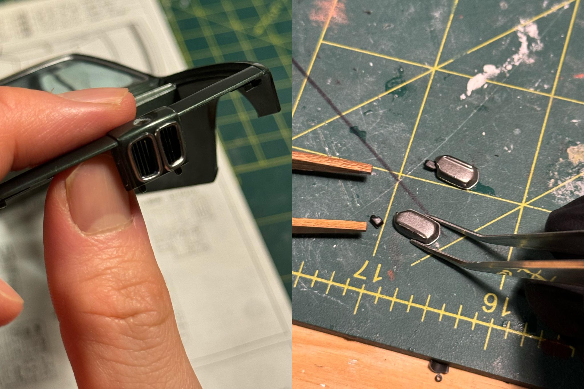

Final assembly was actually somewhat challenging as there were so many parts involved! Brake light assembly is like 10 parts, all chrome trims are separate parts but it's now finished.

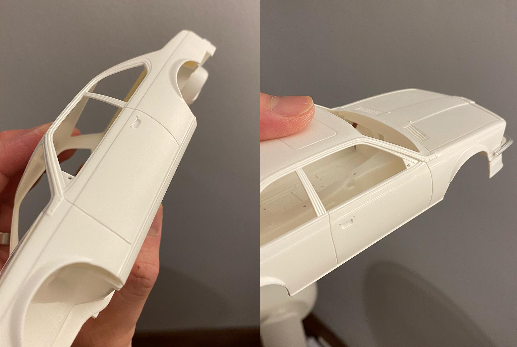

Thank you! I love maroon. My pleasure. Thank you! Thanks a lot! I usually glue all the non-movable body panels (as long as I can actually assemble bottom without breaking) first to make sure I don't rub any paint or get glue marks. Cutting the roof support was dicey but looking at the spruce location I had to cut it to make sure none of them are visible after painting. Sometimes I break A pillars but this time I was super careful!

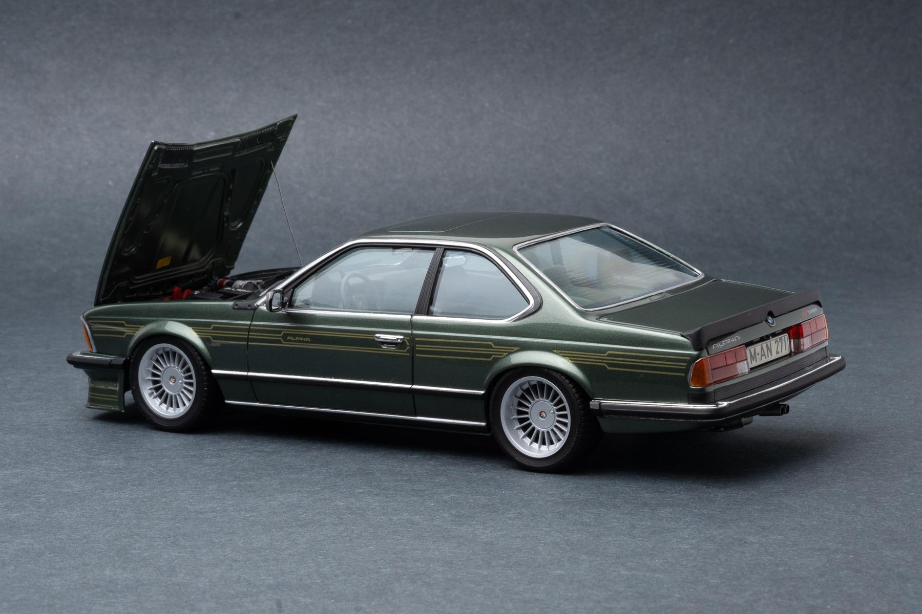

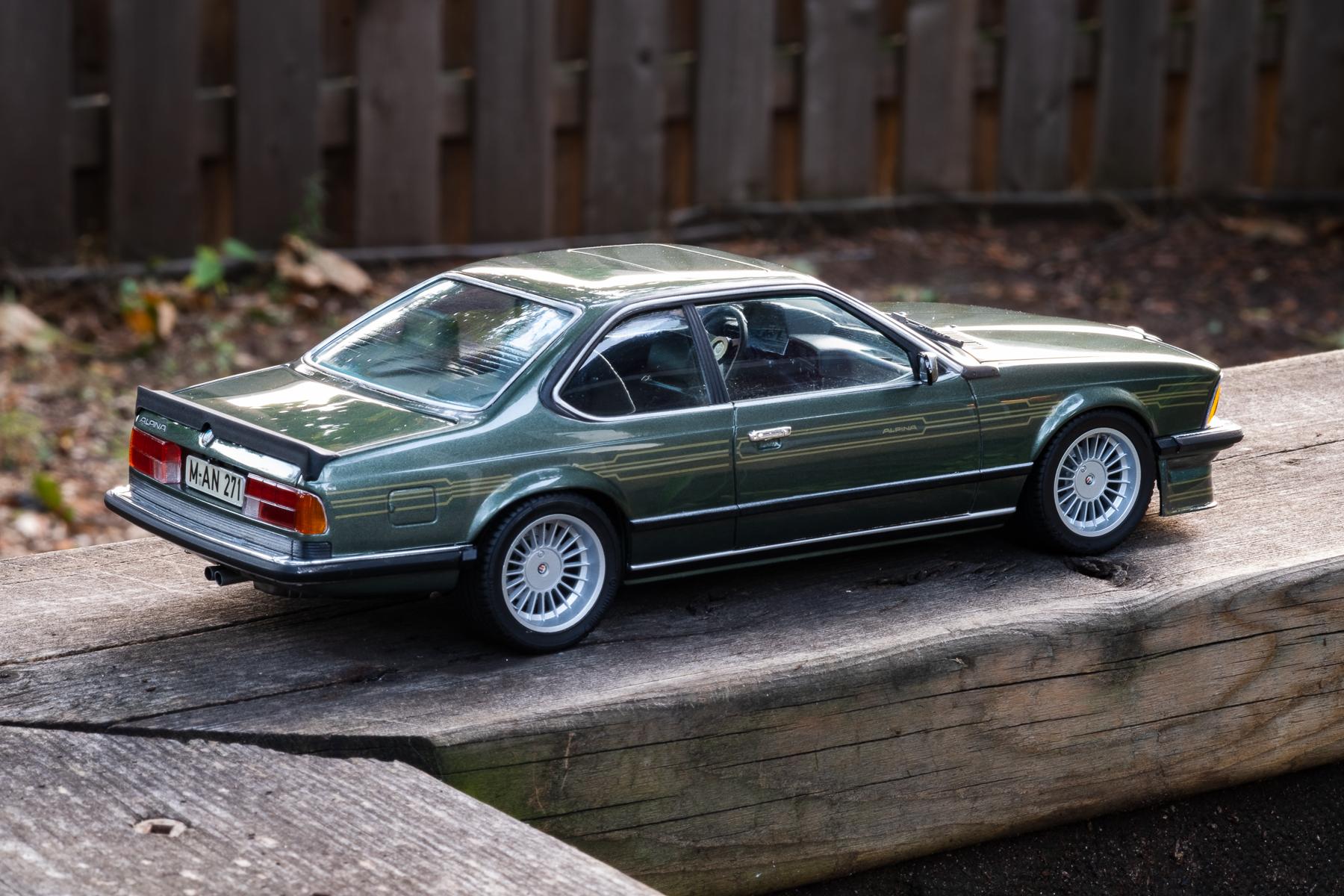

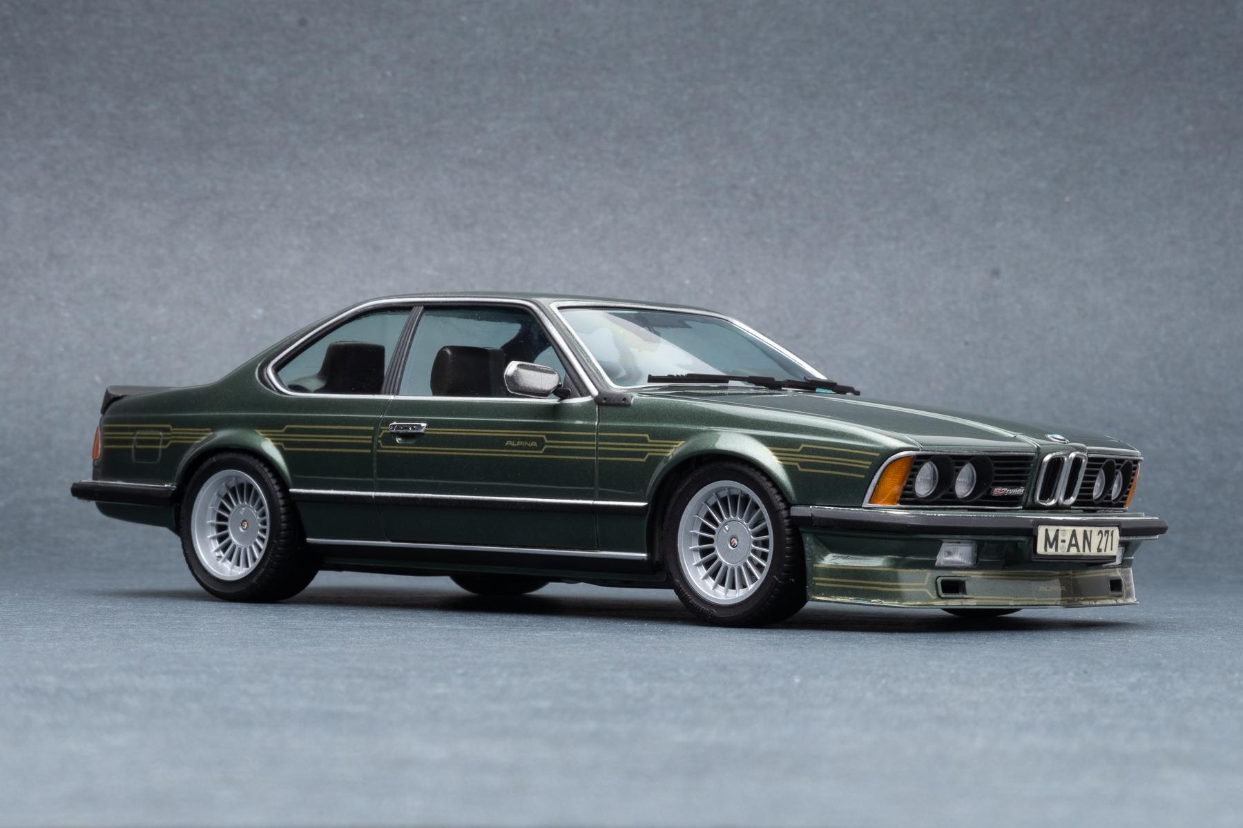

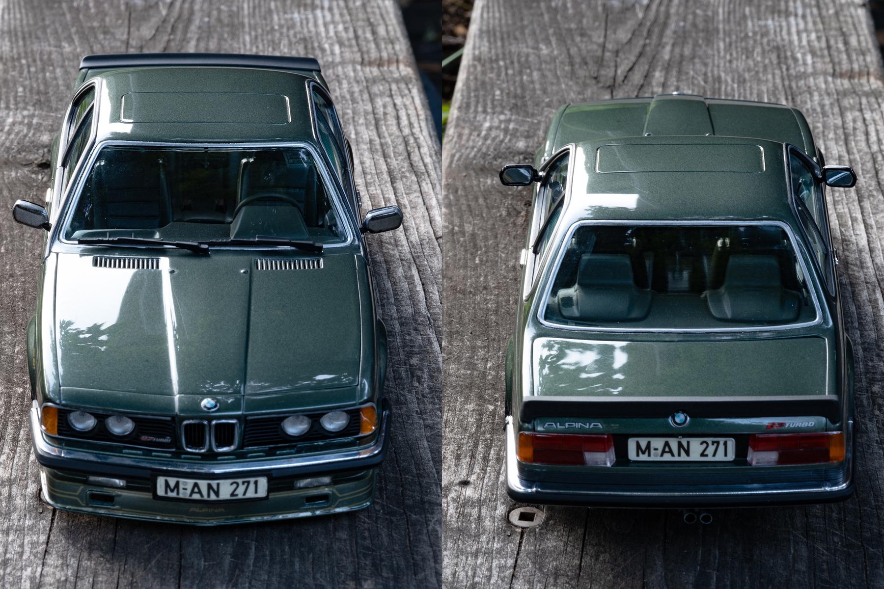

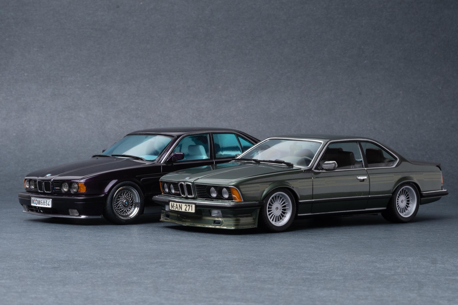

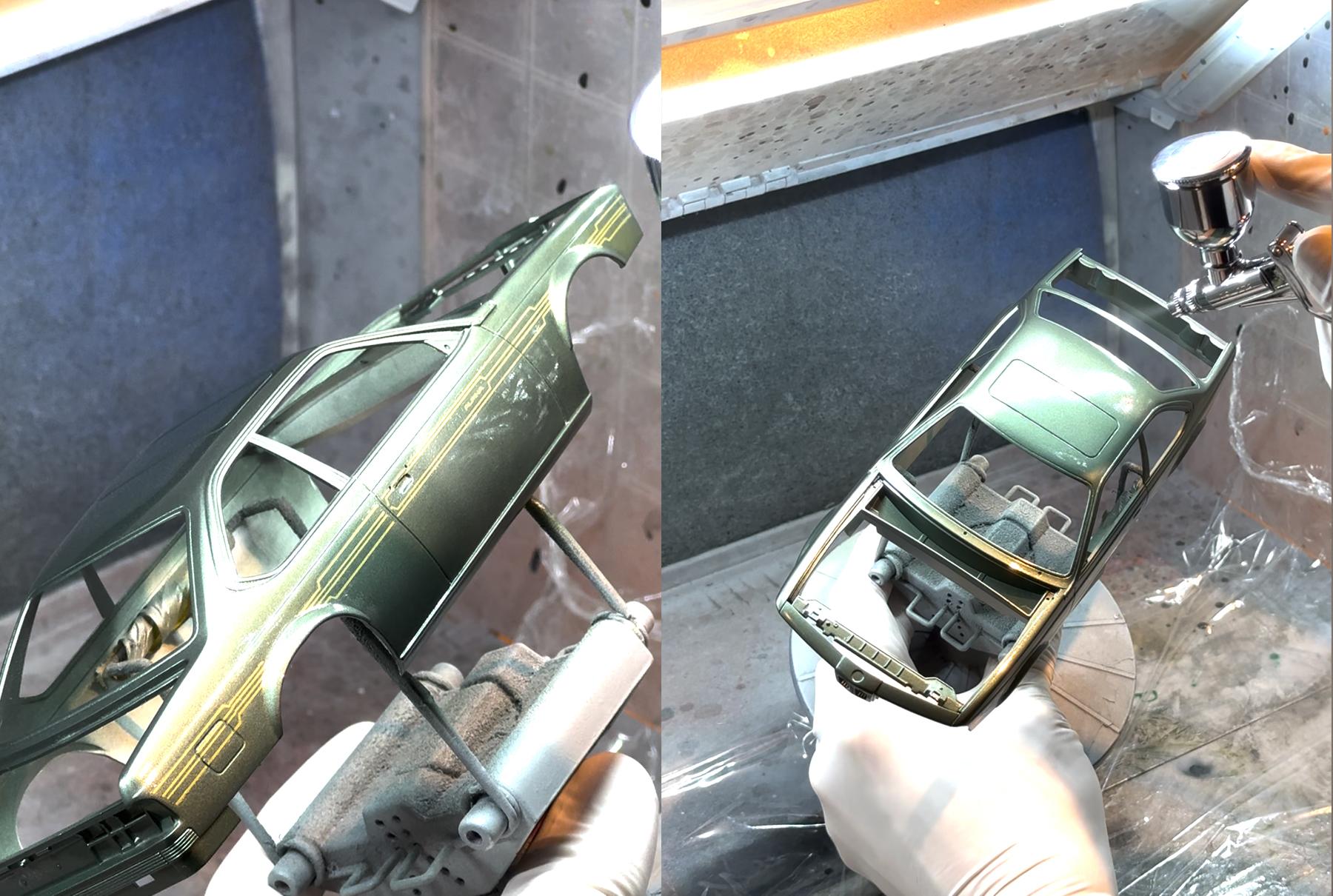

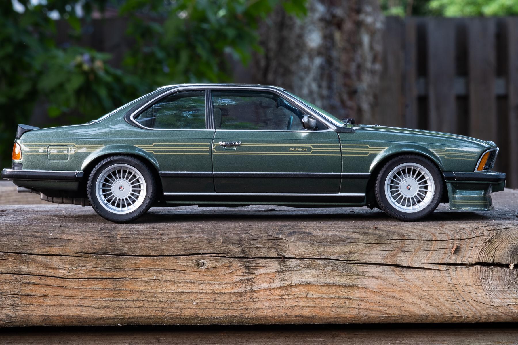

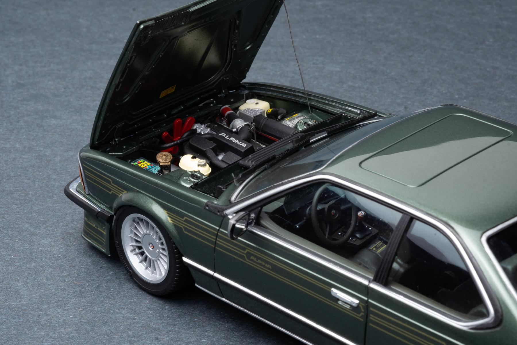

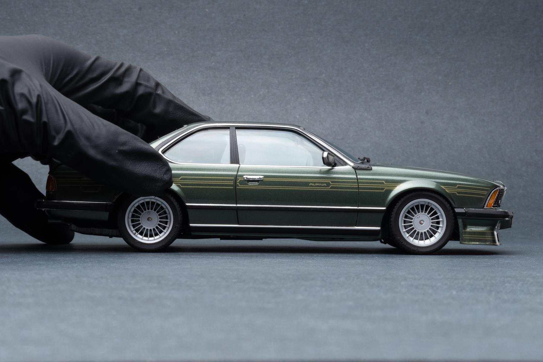

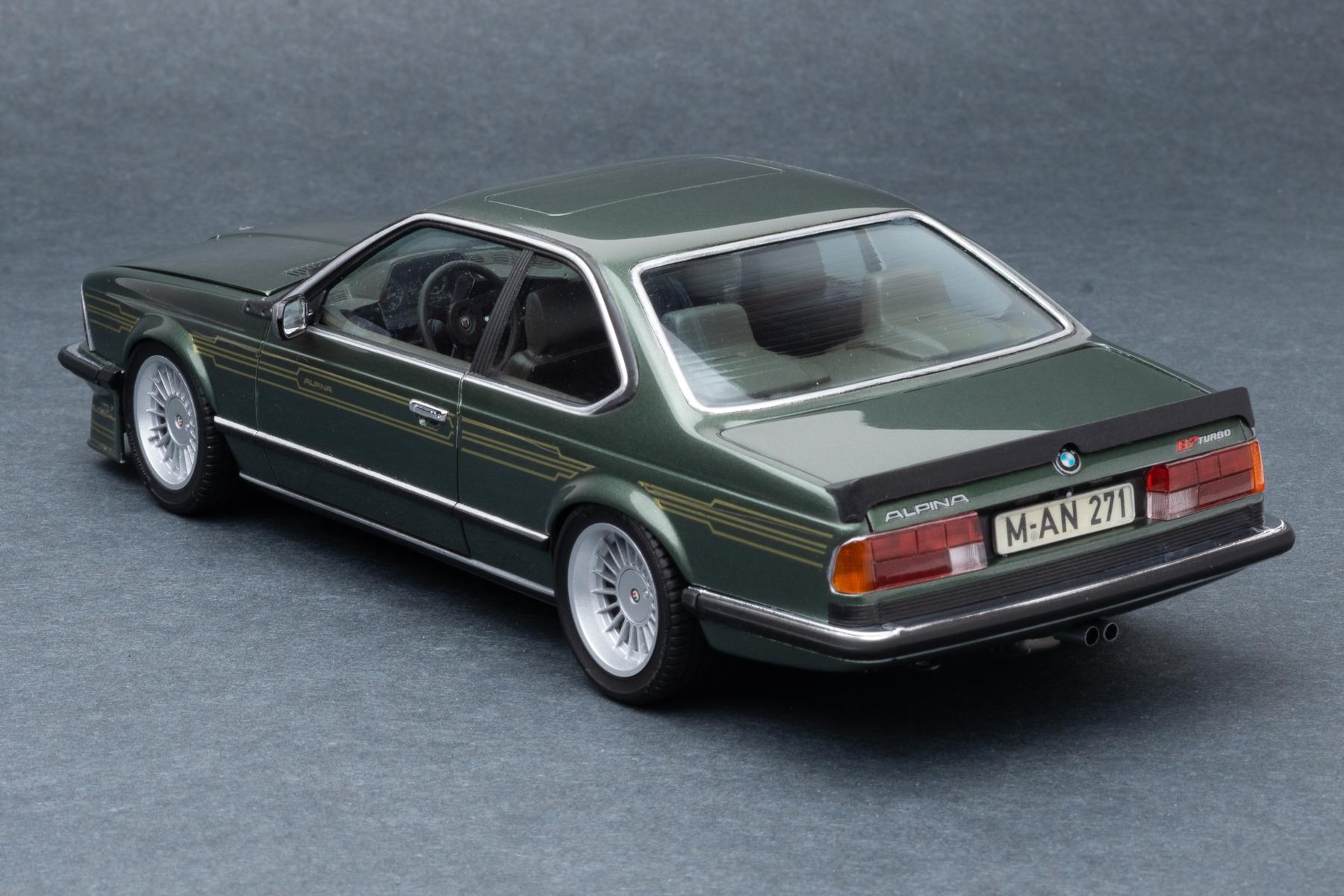

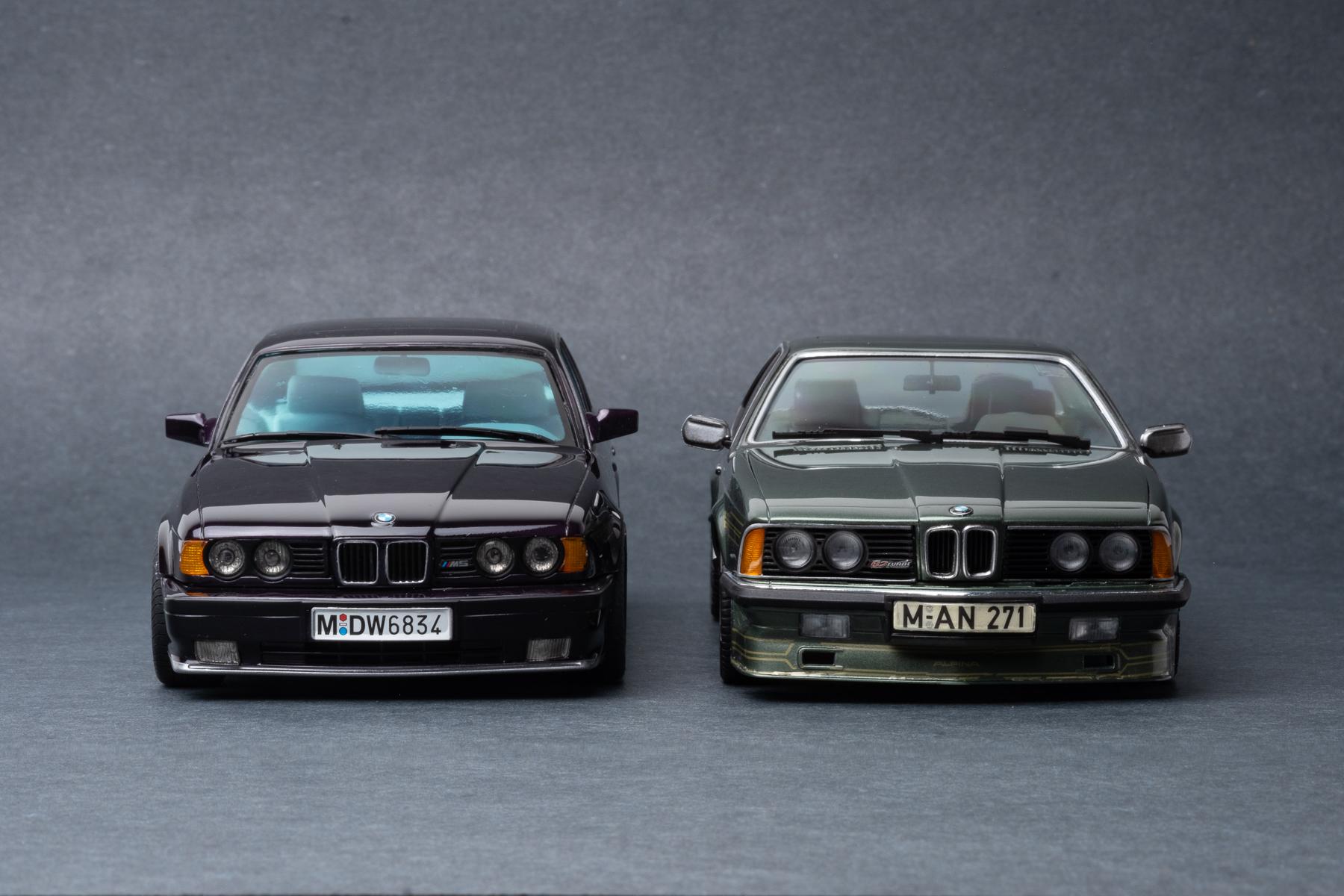

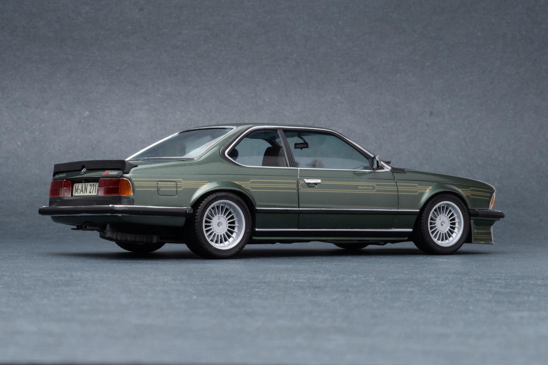

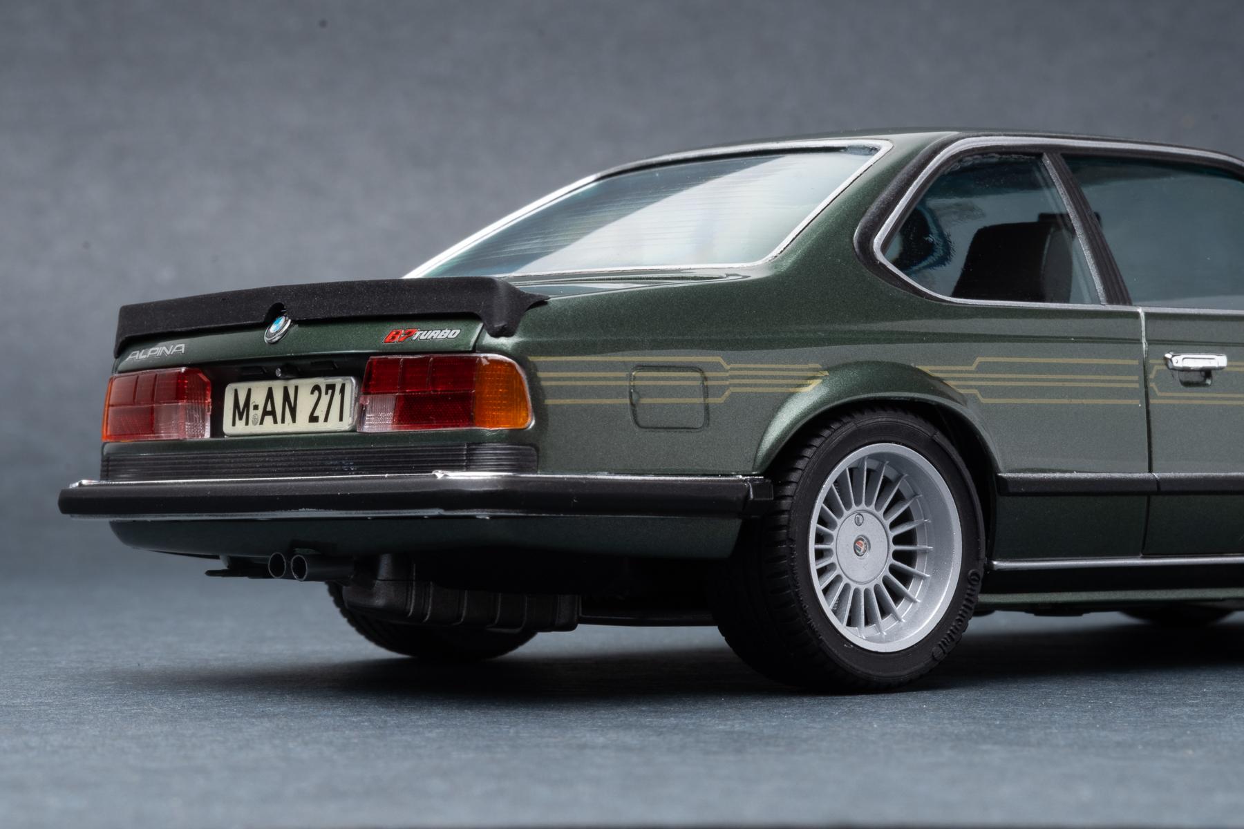

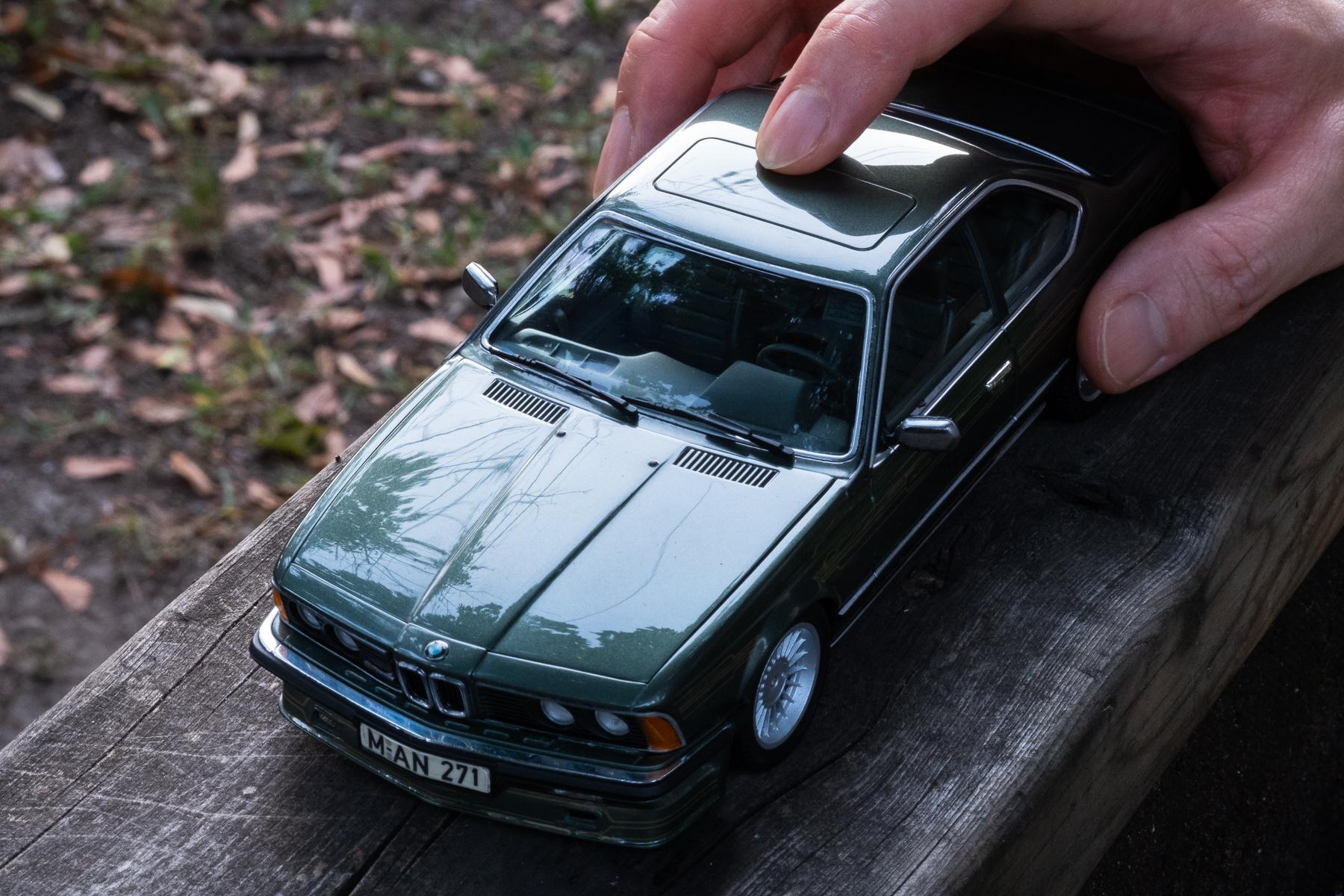

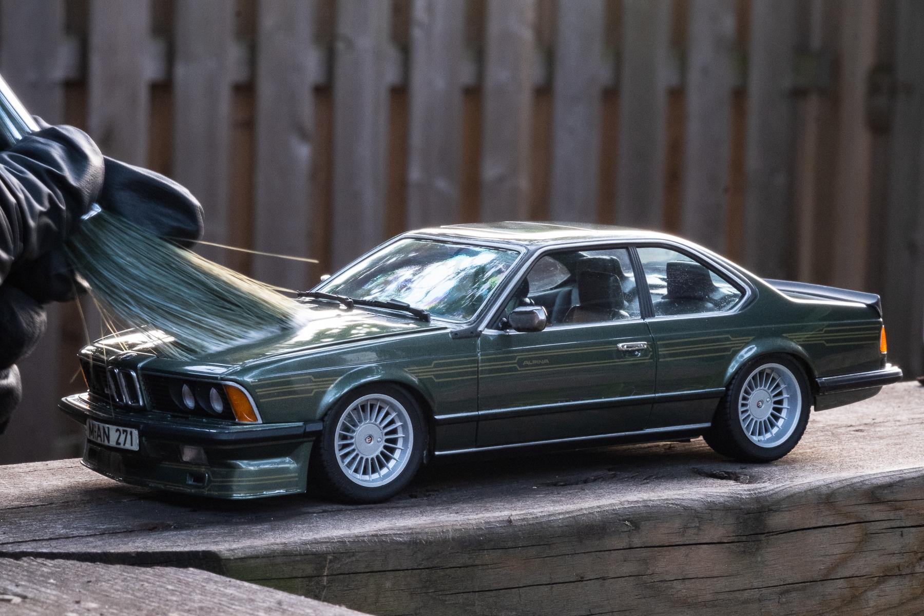

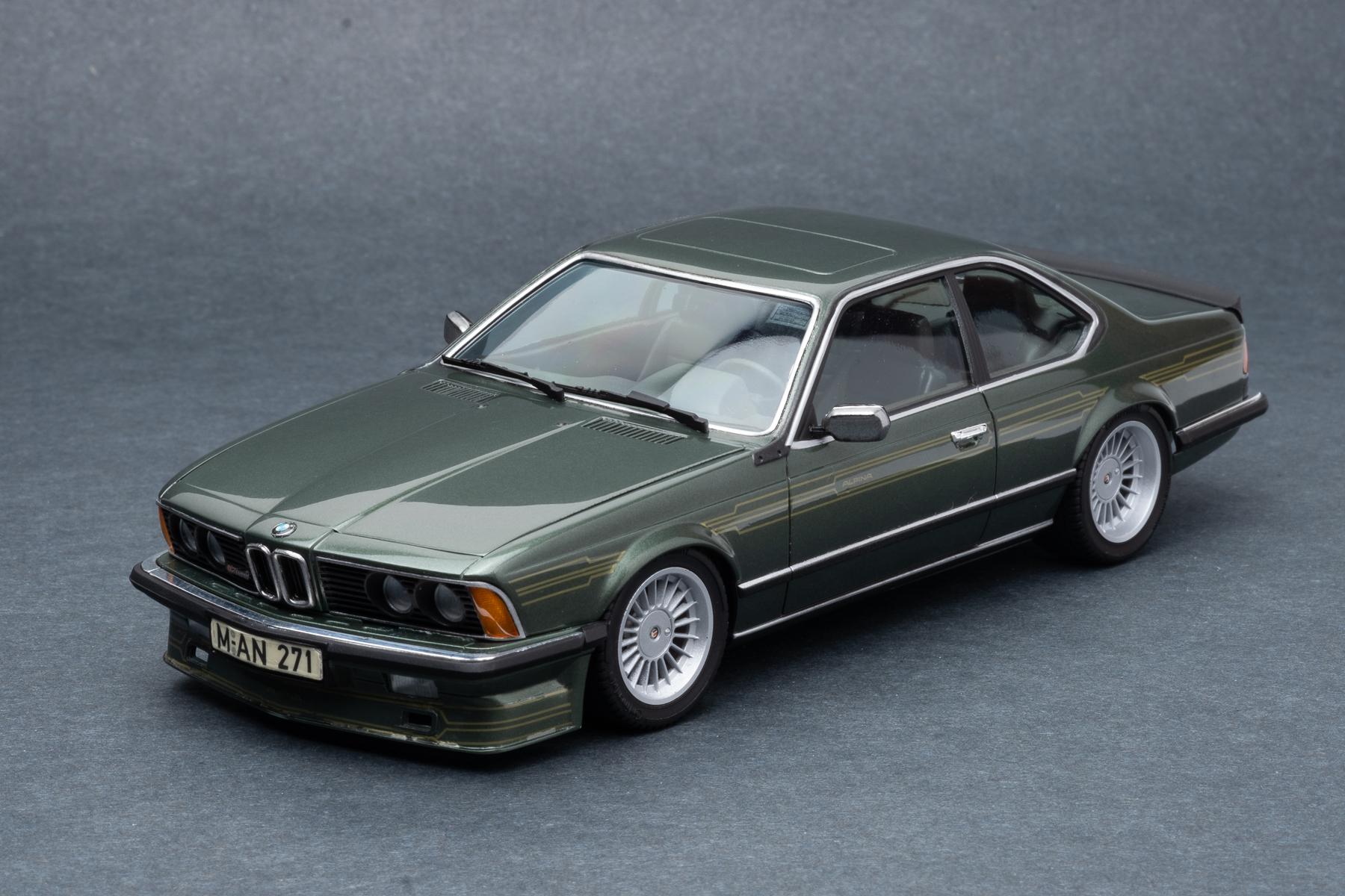

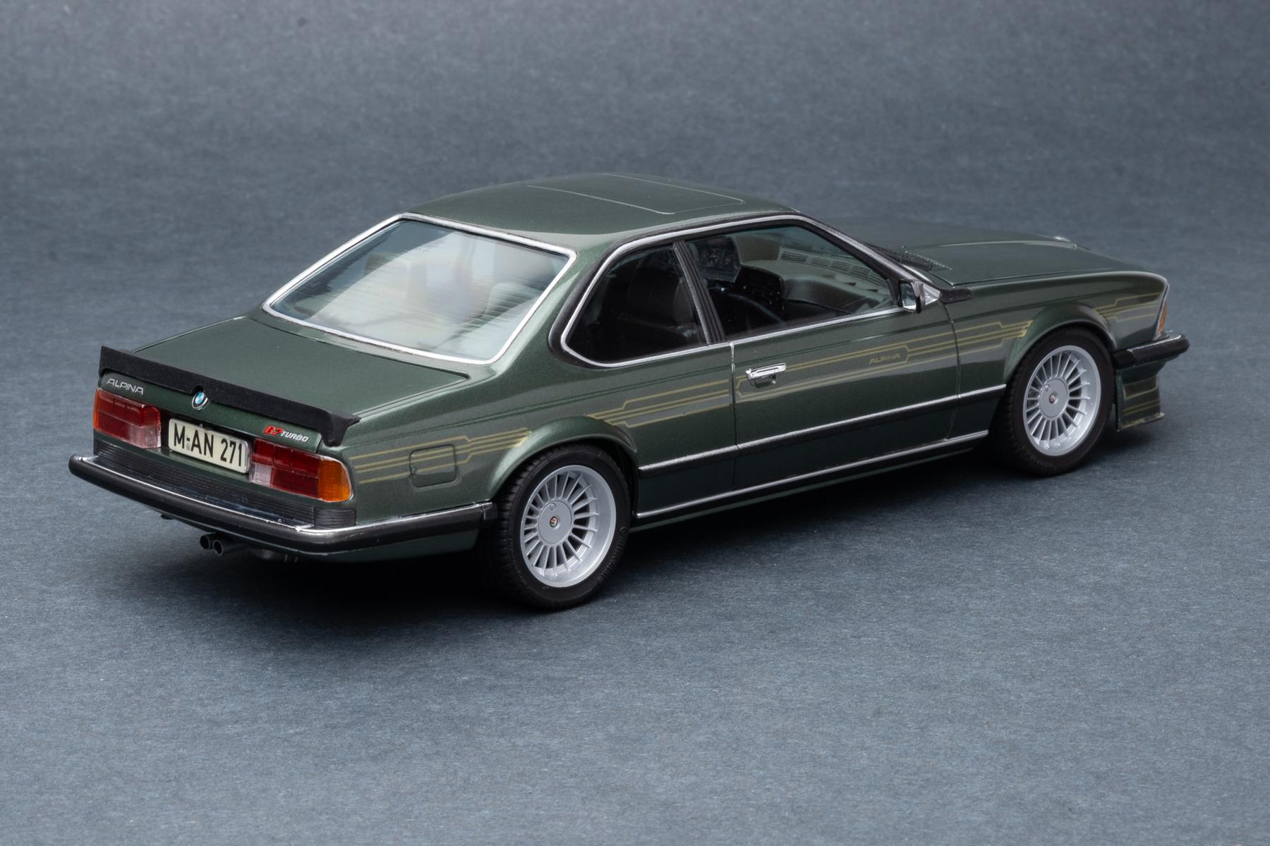

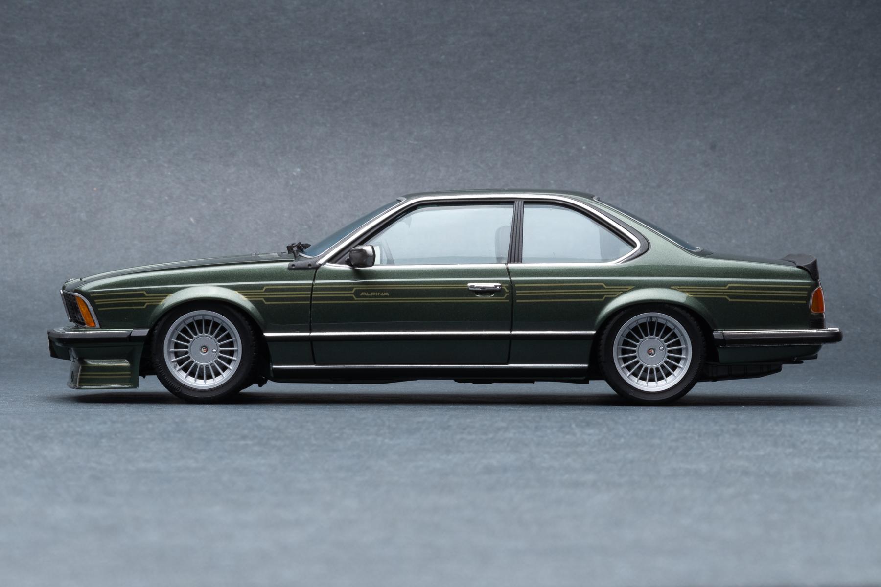

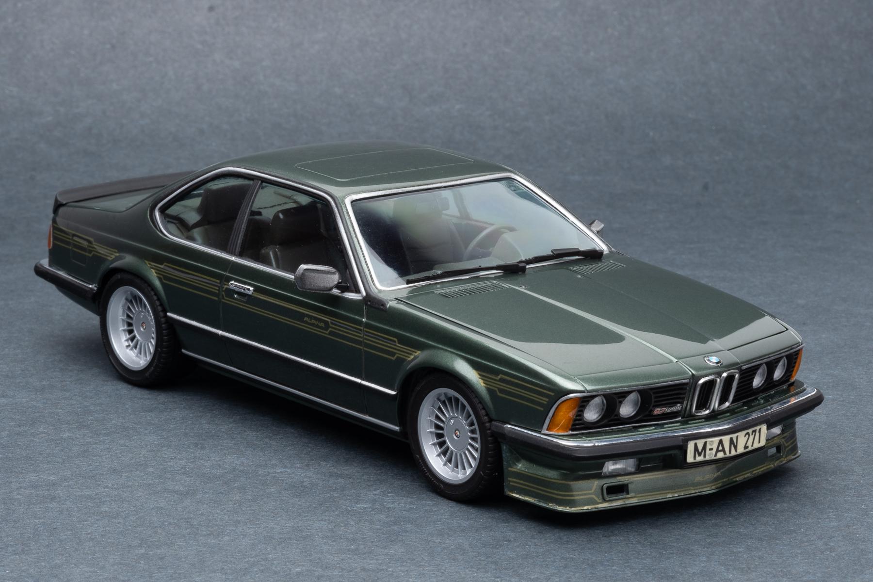

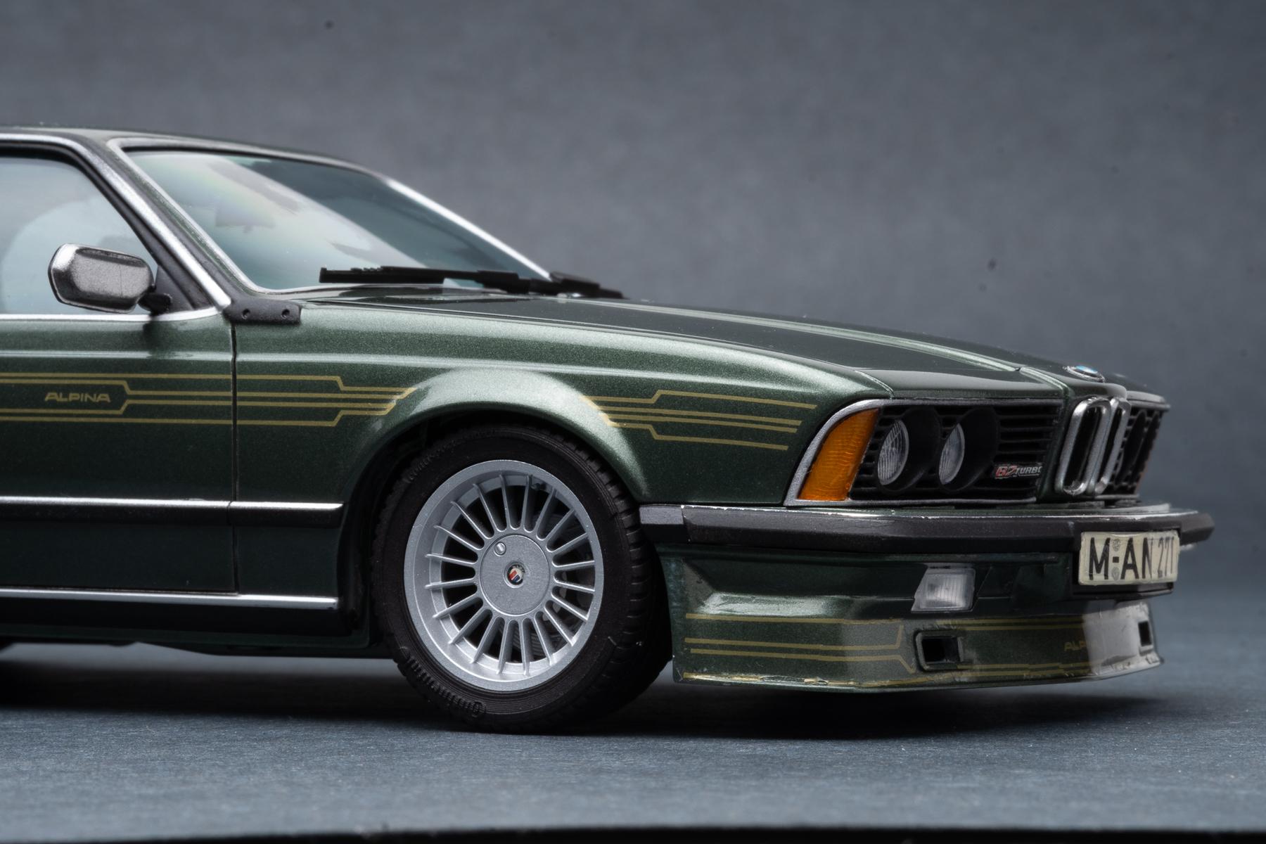

Hi all, Here’s my finished Fujimi’s Enthusiast Series Alpina B7 Turbo coupe! With more than 250+ parts to assemble I kept the build mostly out of box except for lowering suspension and fitting larger and wider 17” staggered Alpinas from USCP. This time I wanted to simulate one of my favourite BMW colours - Malachitgrün (Malachite green) for body and Pine green for interior. (Some of reference pics below) The full process: - Scribed panel lines and wet sanded the whole body with 1500 grit - Airbrushed silver and wet sanded again with 2000 grit - Mixed Mr Color’s GX metallic green + black + silver and gold and laid 2 base coats - Applied decal and laid 3 layers of super clear III with wet sanding in between to smooth out the decal and rest of the surface - Fully cured the paint and wet sanded 3000 > 6000 and 8000 grit - Polished with Tamiya 3 stage compounds and Hasegawa ceramic compound - Added embossing powder to the floor and painted the interior with flat black, IJN green and IJN gray - Added cooling houses and throttle cable - Mask painted window trim with flat black and chrome silver - Wet sanded window and painted the inside with diluted clear green and clear blue to simulate factory glass color There are areas I could've done better but overall I’m pretty happy with how it turned out.
- 34 replies
- 24

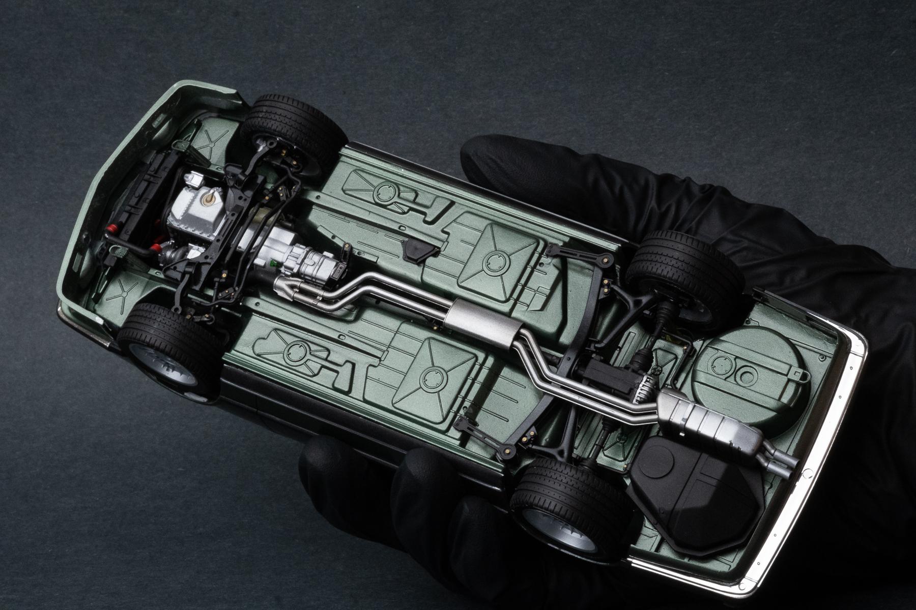

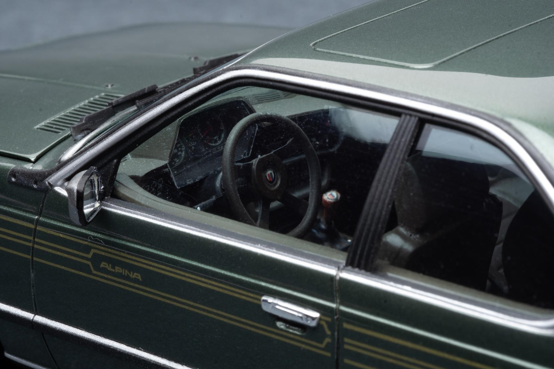

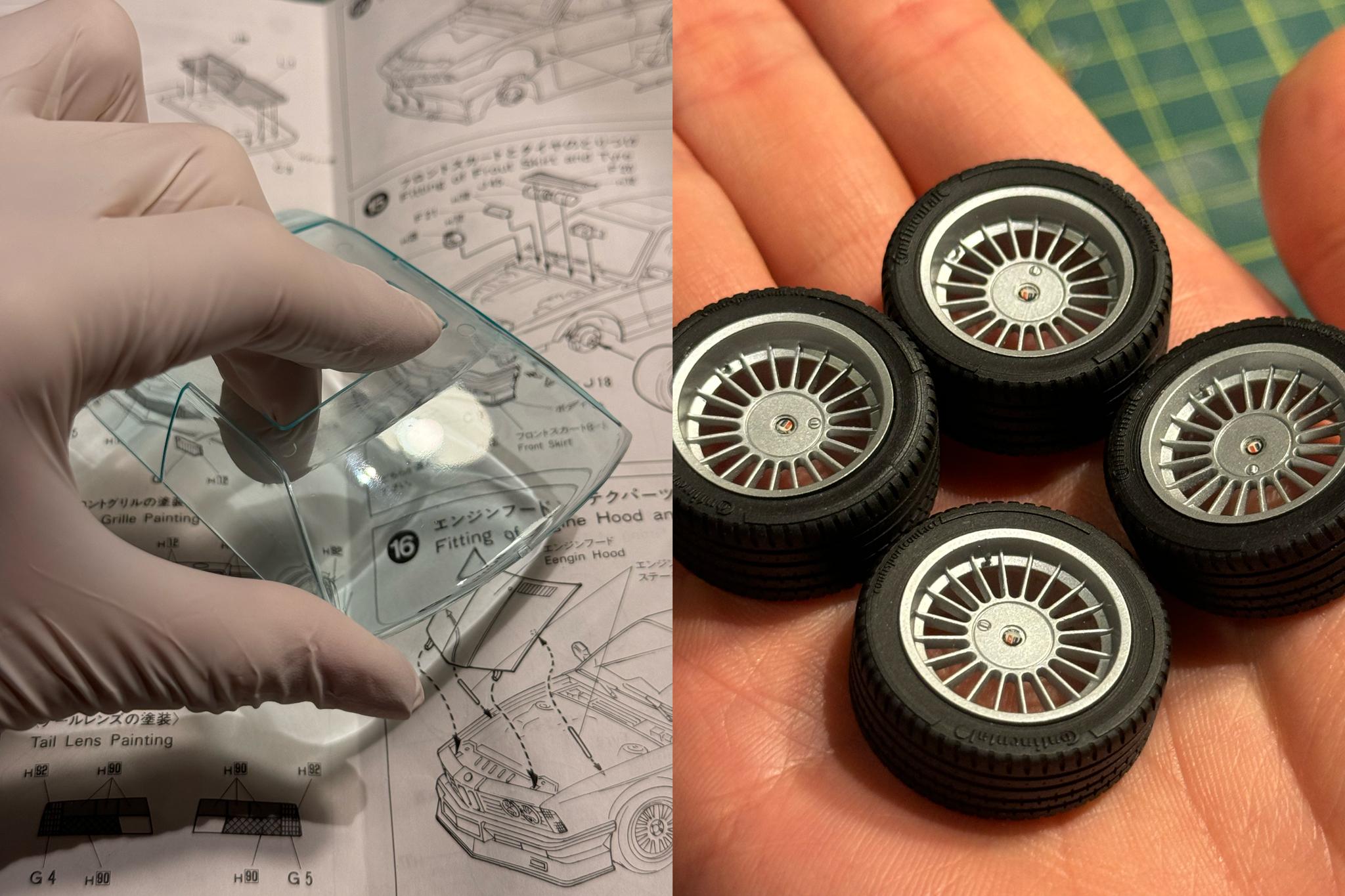

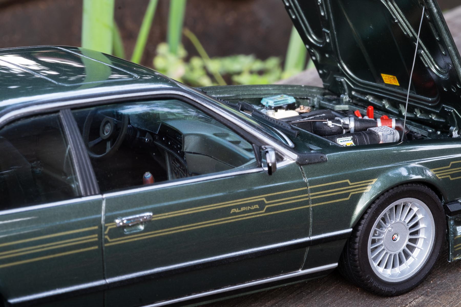

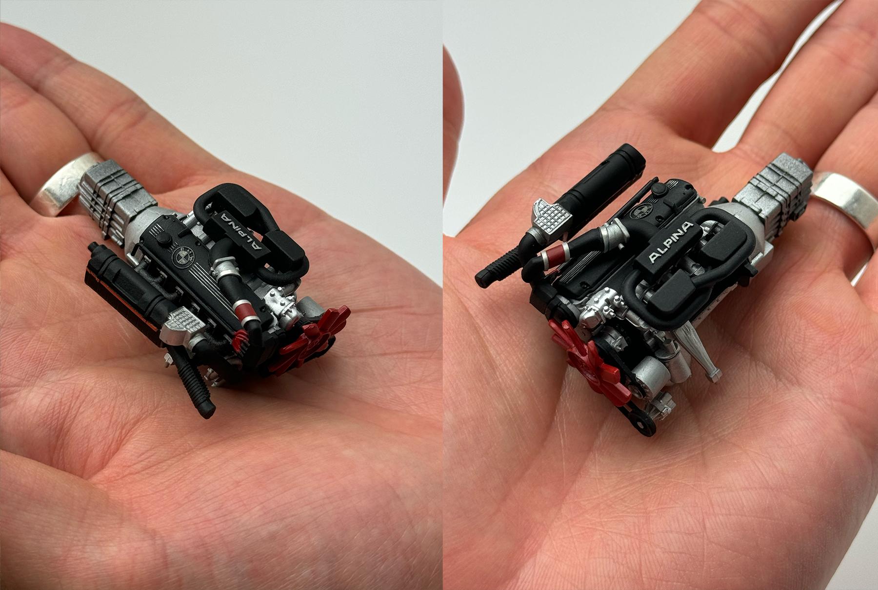

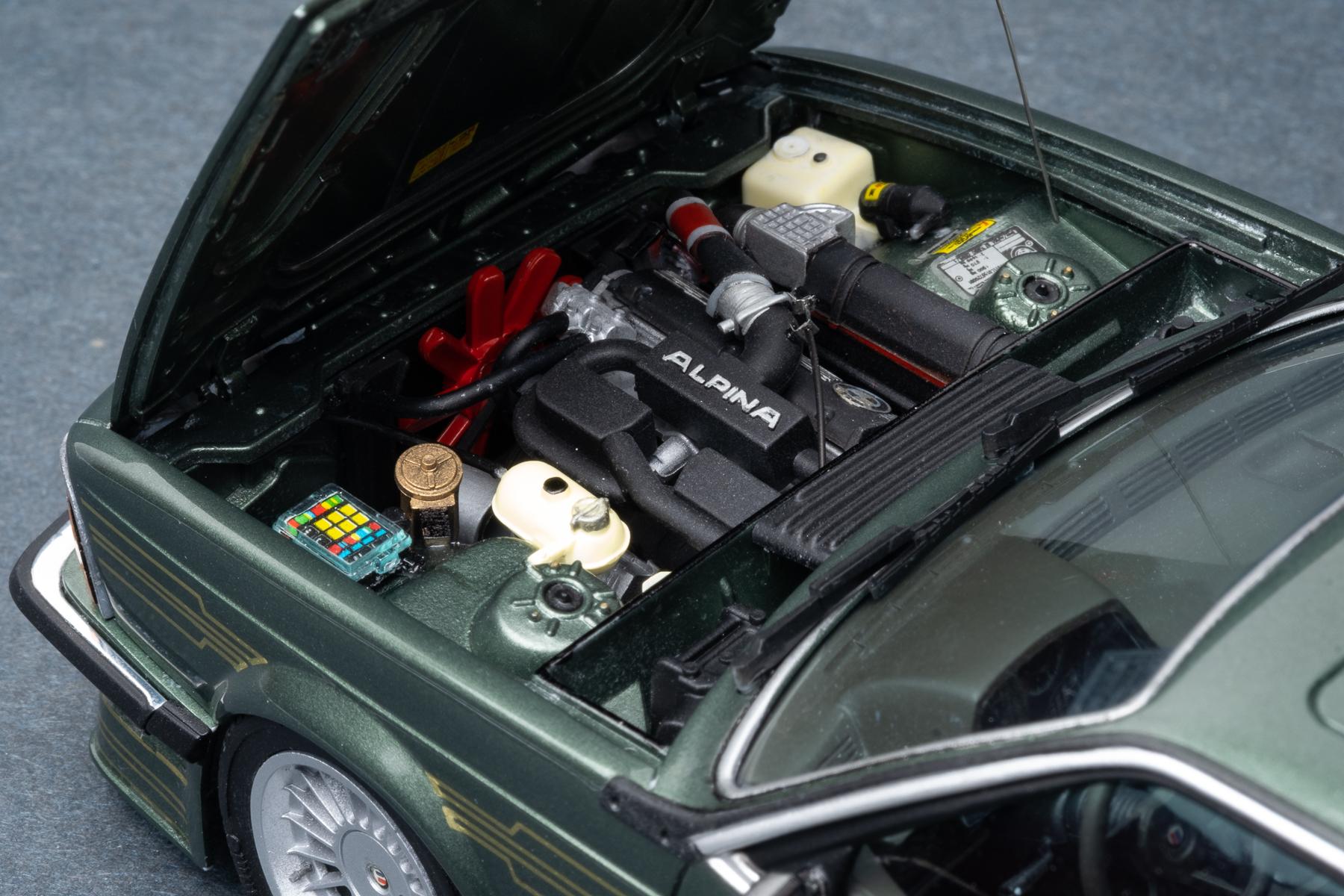

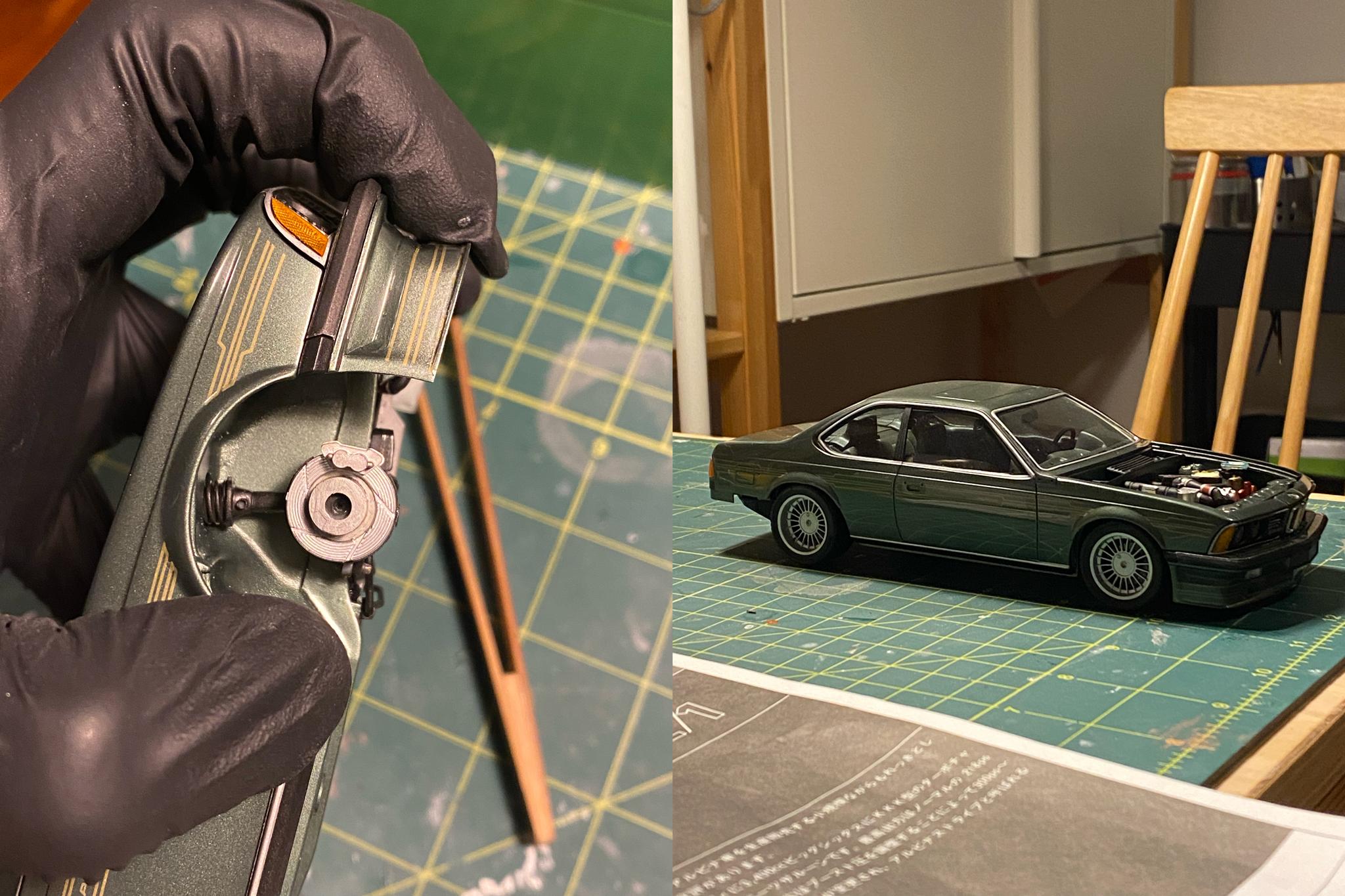

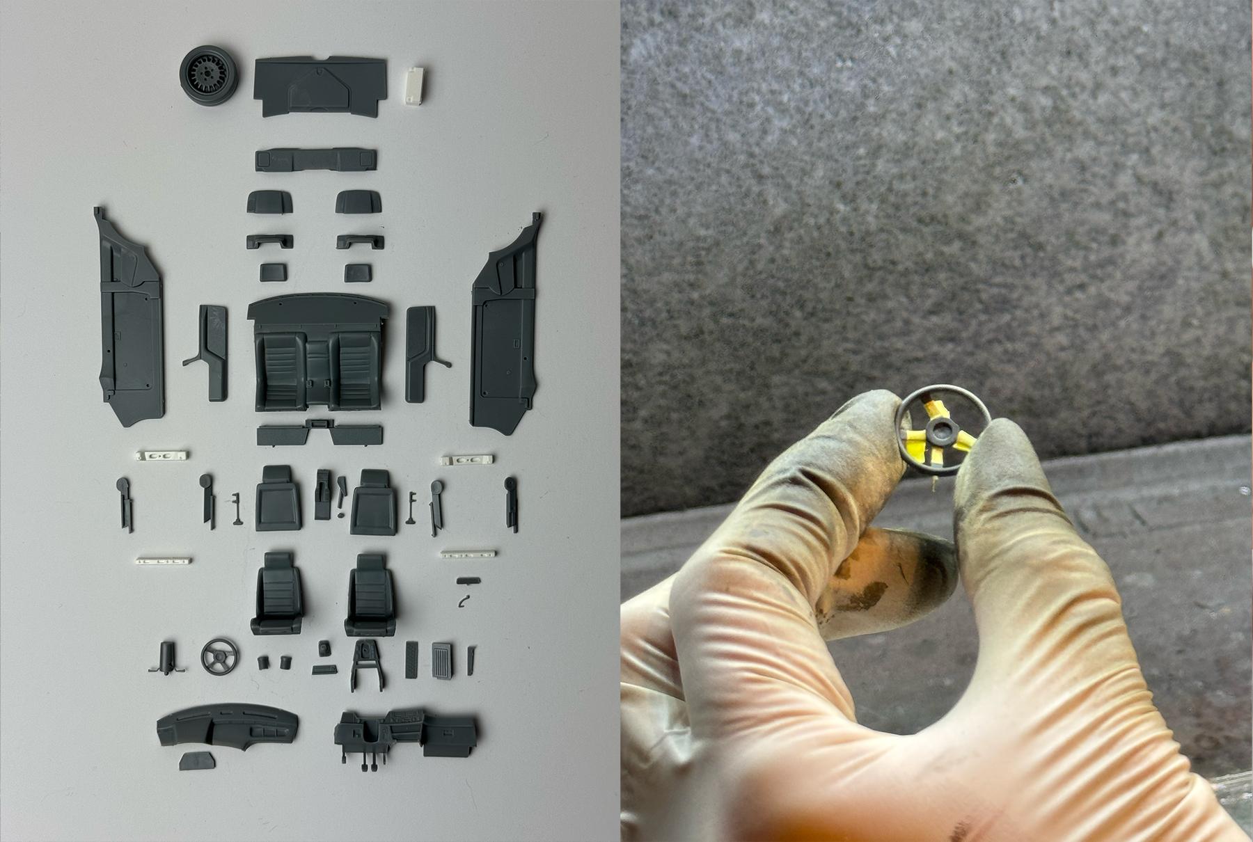

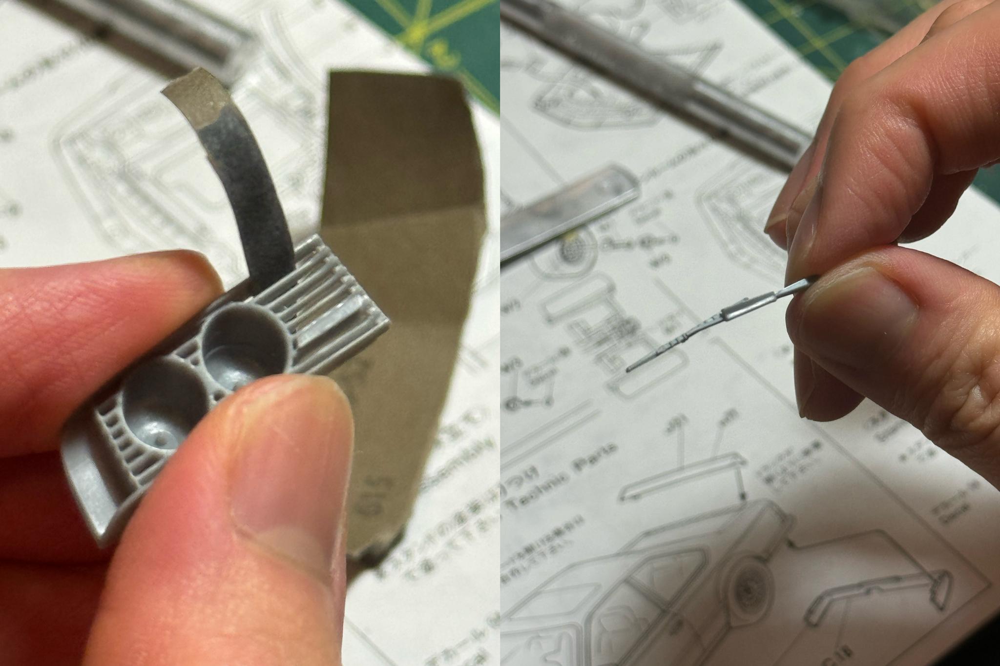

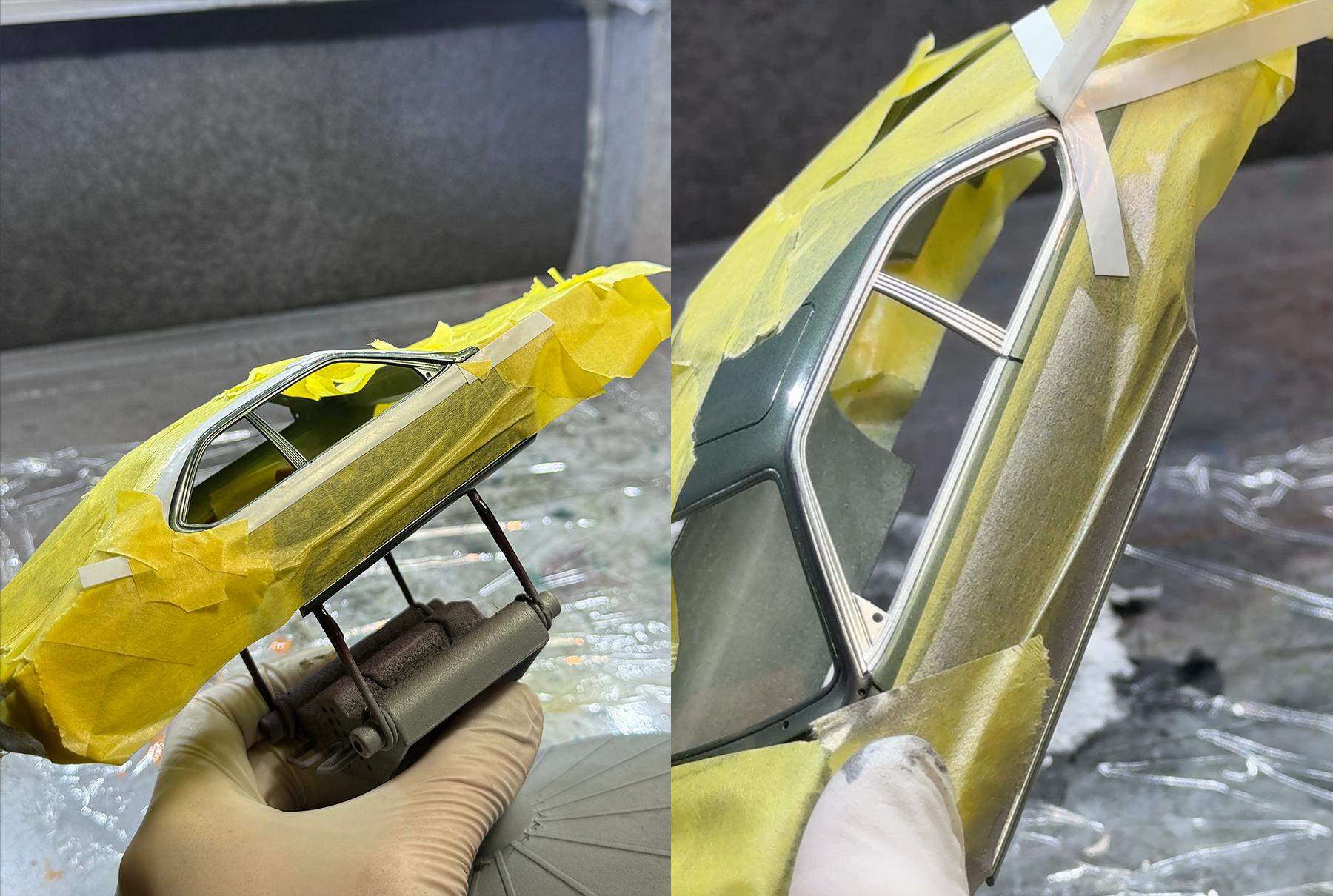

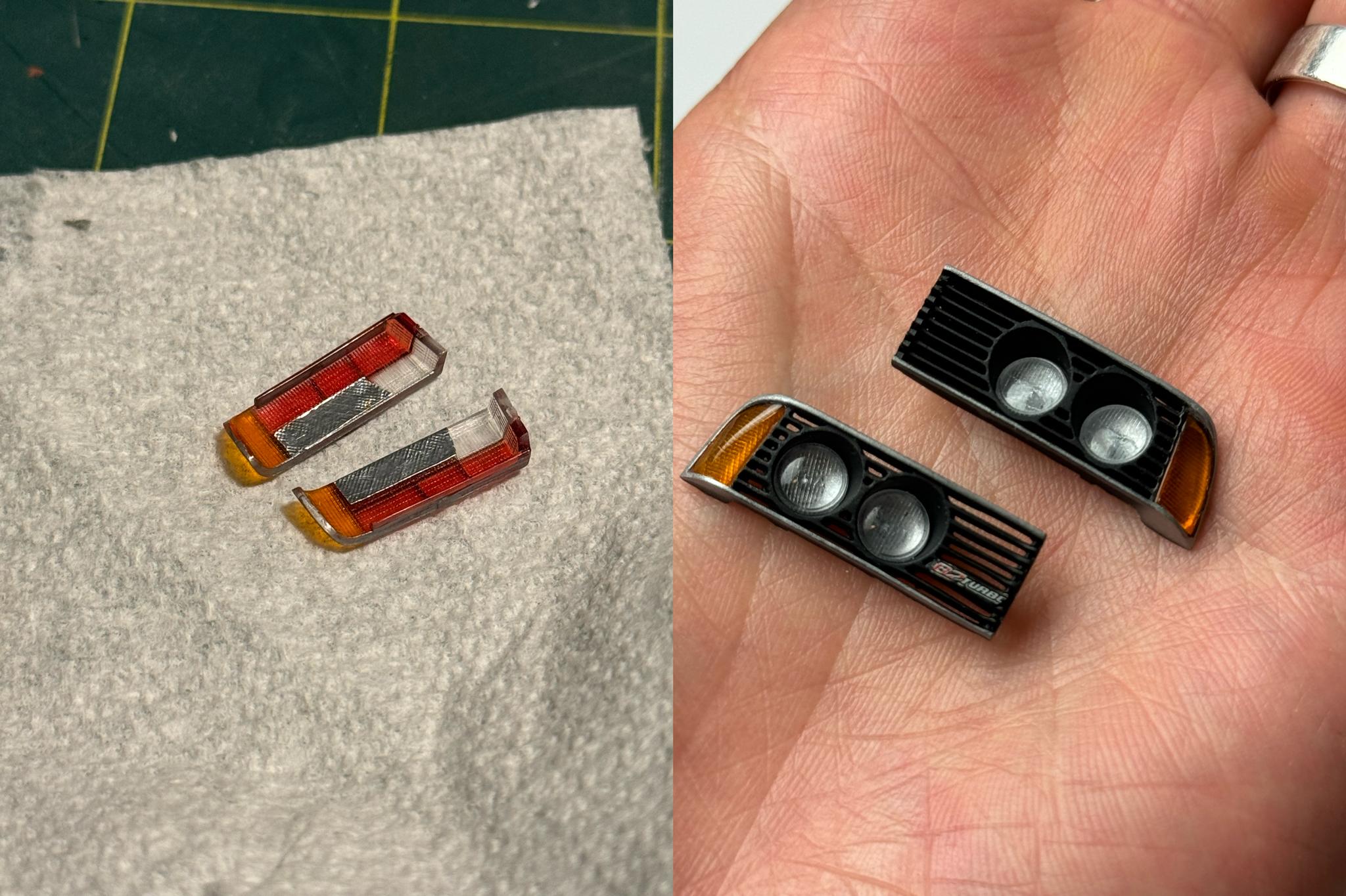

Hi all, here's the final build update: Mold qualities are generally great but I had to sand pretty much every single part (the grill part has separate badge part and this driver side wiper has also two parts) before assembling and painting them. As usual I de-chromed all chrome parts, painted them with gloss black then laid Alclad chrome. Actual BMW taillamps have different depth so I applied BMF to the lower section. I then wet sanded the windshield with 1000, 1500, 2000, 3000, 6000, 8000 and followed the same polishing process, then painted the inside with mixture of clear blue, clear green, (lots of) clear to simulate the factory tint. I also added valve stem to the Alpina wheels. Assembling EM kits are always nerve-wracking because they don't have much support for glue to work its magic. I think I ended up securing front bumper and valence overnight with super glue to make sure they don't sag. To get the right stance, I cut the both front and rear shock and adjusted the camber with white putty until I got the stance I wanted. I'll soon post the finished photos - thank you for reading!
Thank you! Yeah go for it! Make sure you spend time aligning the wheels ? Tamiya curve masking tape is great (and it's got some awesome sealing) but it tends to want to go back to its original shape after applying. So I had to do them all at once.. Thank you!

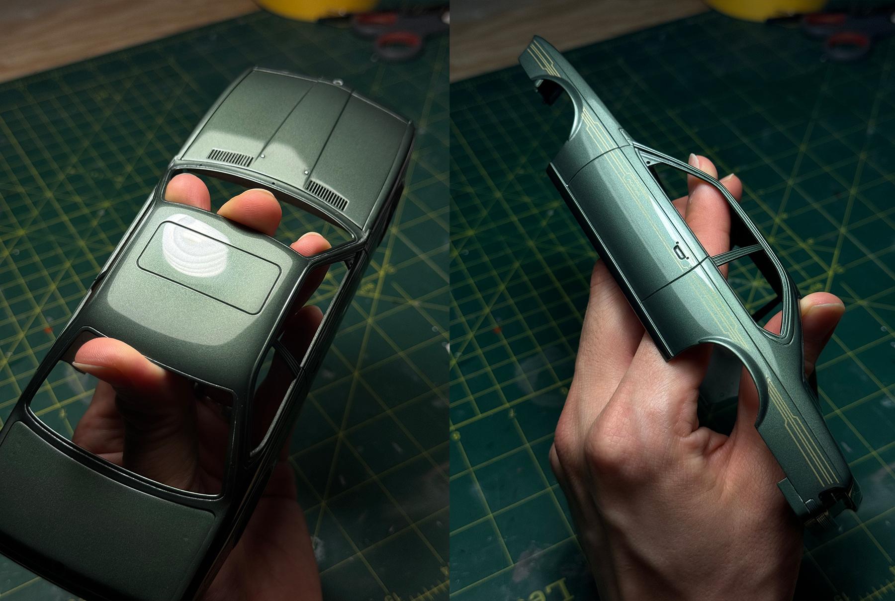

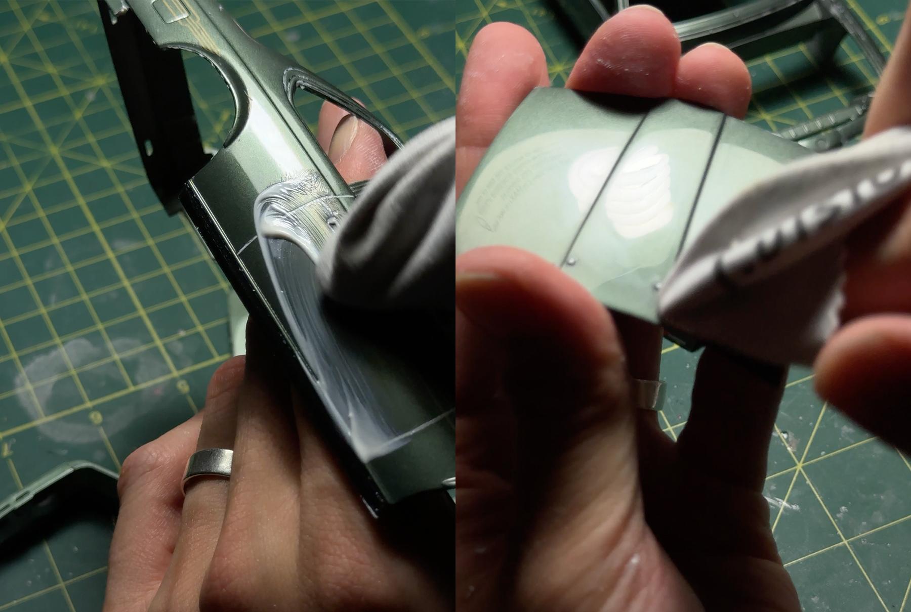

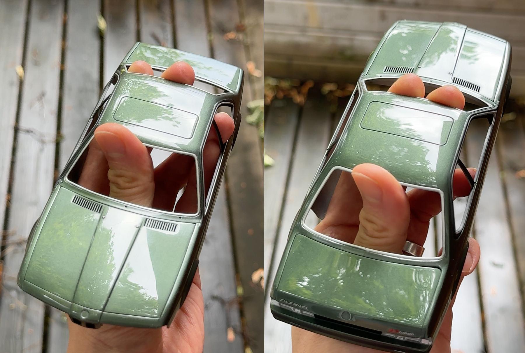

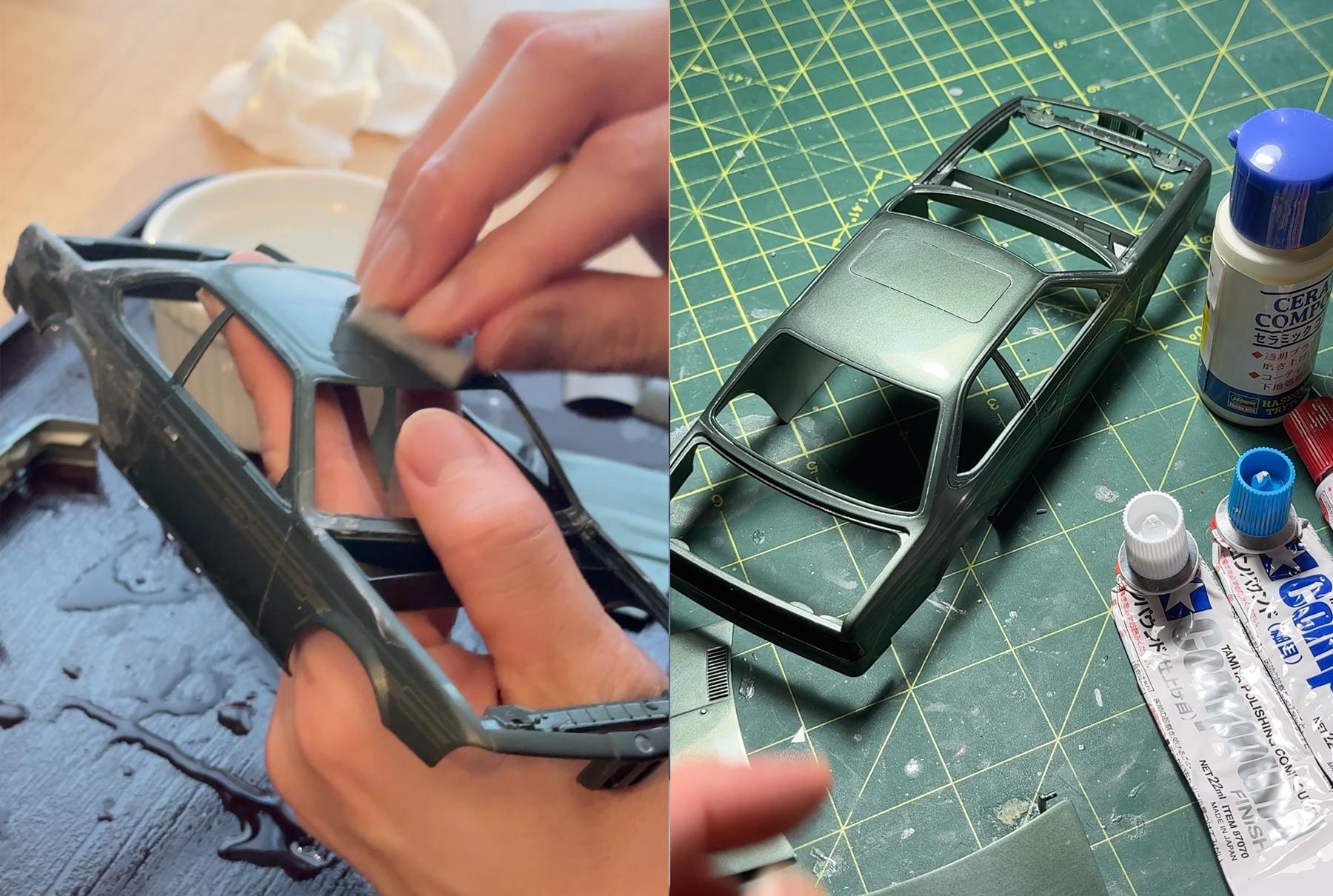

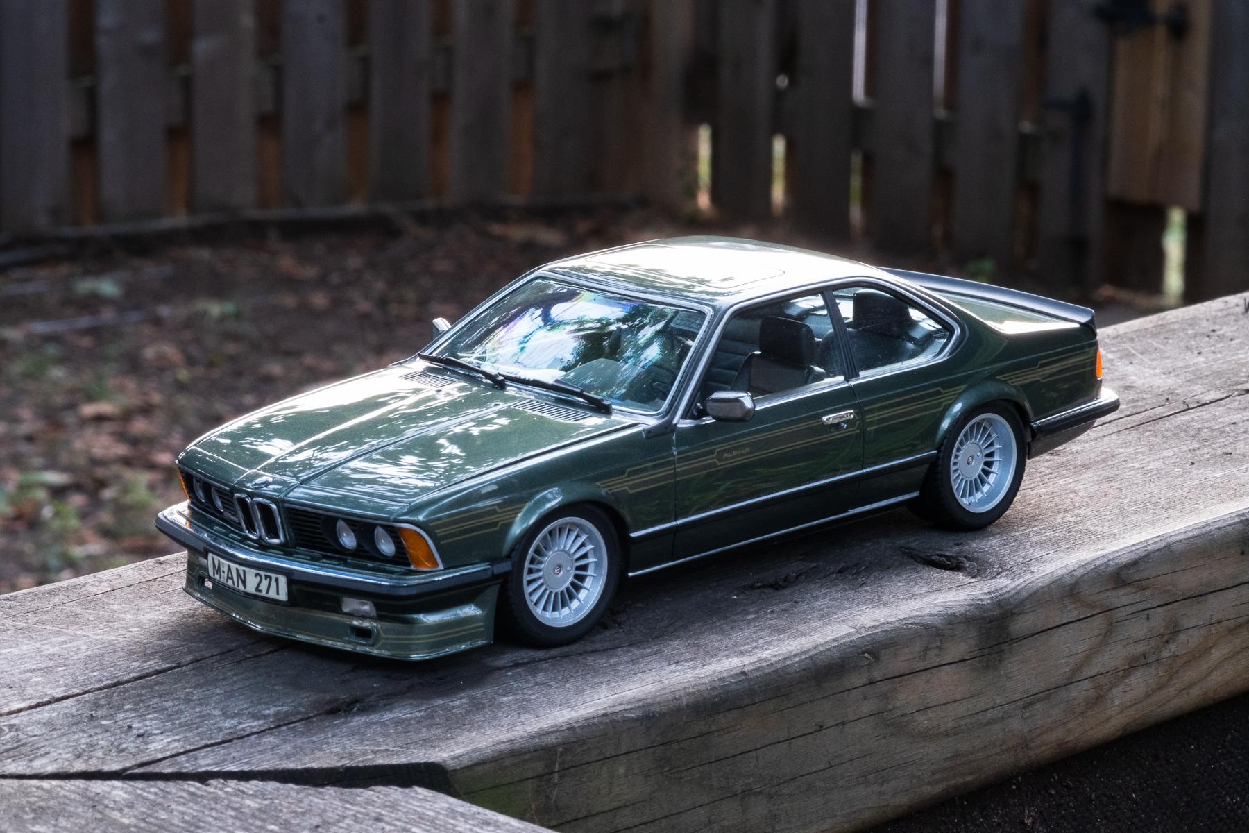

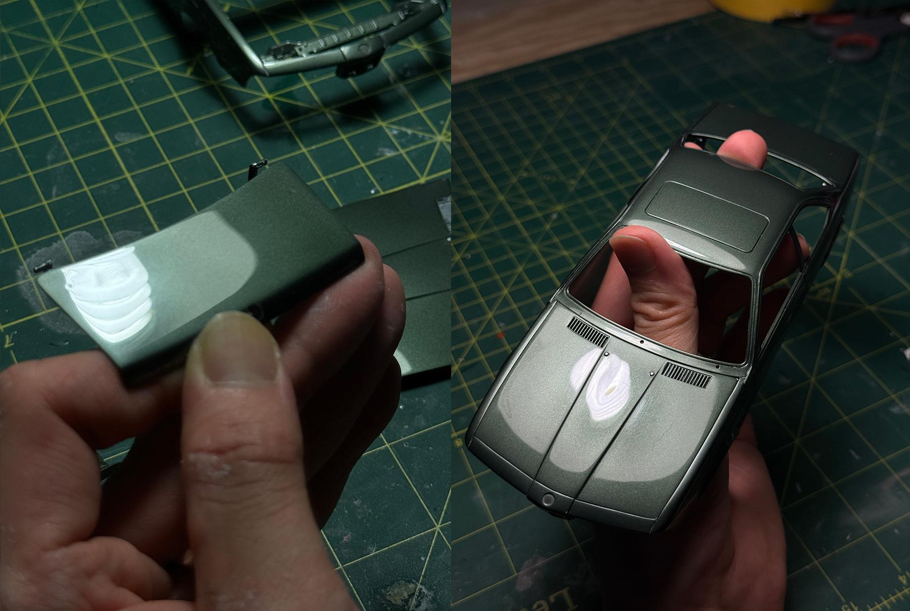

After curing the paint for few months (I always cure minimum 1 month), I wet sanded with 3000 > 6000 > 8000 grit and polished with Tamiya three stage compounds and Hasegawa ceramic compound. Masking the windows were a bit tedious since it has rubber seals between the chrome trims - so I ended up masking three times to paint the each part. I still need to fix a bunch of imperfections around masked area (touching up + removing any over painted bits with polishing compounds) but it turned out pretty decent.
Thank you! Appreciate the compliment! Thanks a lot! Thank you! I think this is one of the better EM kits vs. some incorrect 911 and Stratos kits Thank you! Hopefully I can assemble all these without any accident! Thank you! Thanks a lot! Not quite immaculate but I try!
Thank you! Finishing EM kits always feels super rewarding. Thank you! I love the E24! Thank you so much! It's always the assembly that makes these kits super tricky - I'll try not to make any mistakes! Alpina B7 definitely commands premium but 635csi had been recently re-released so they should be easier to find! Thank you! Appreciate it!

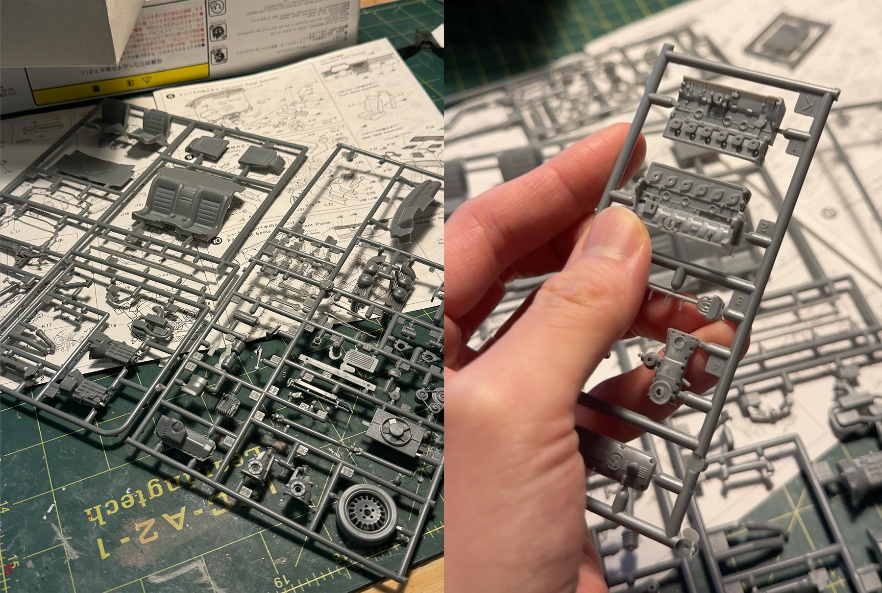

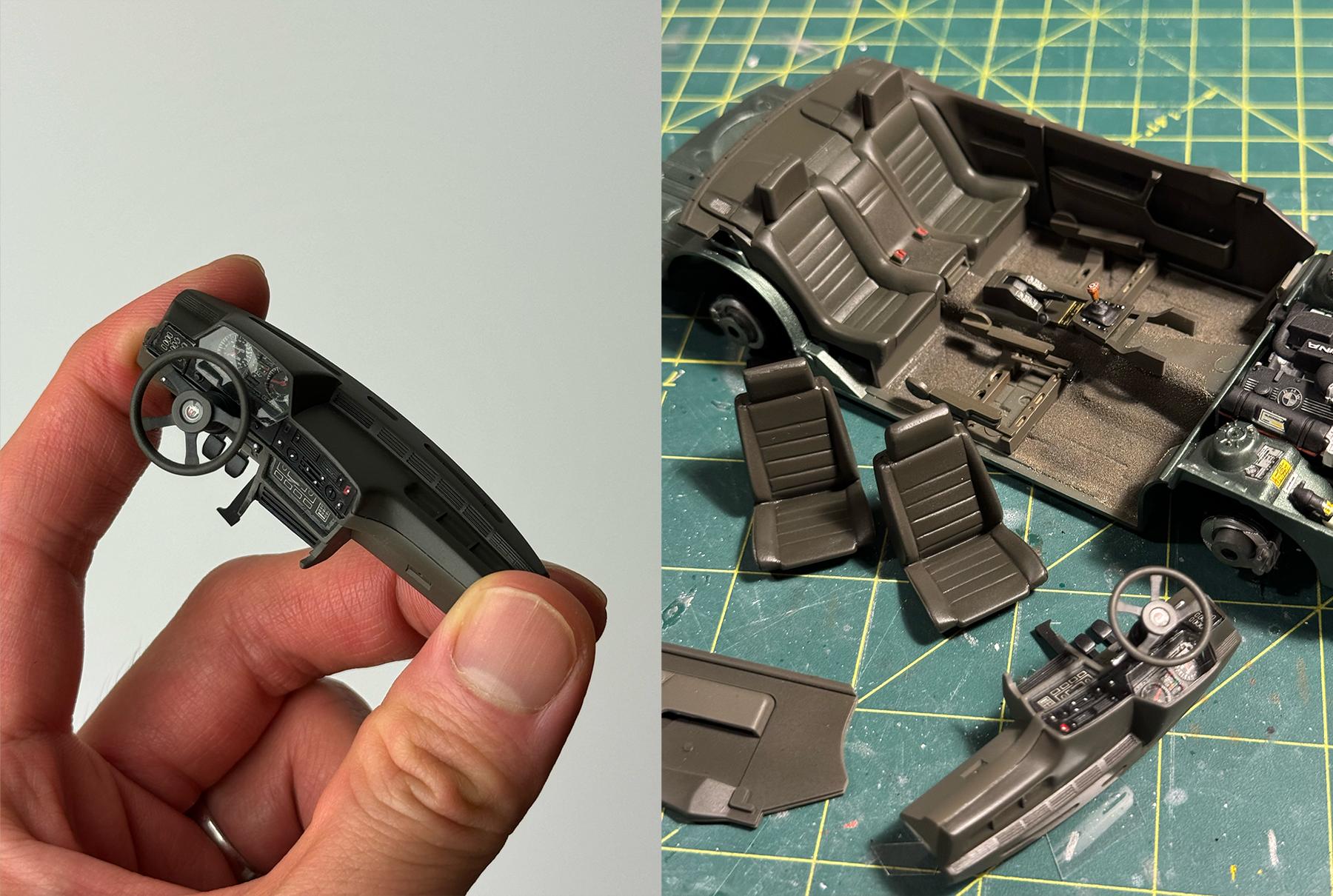

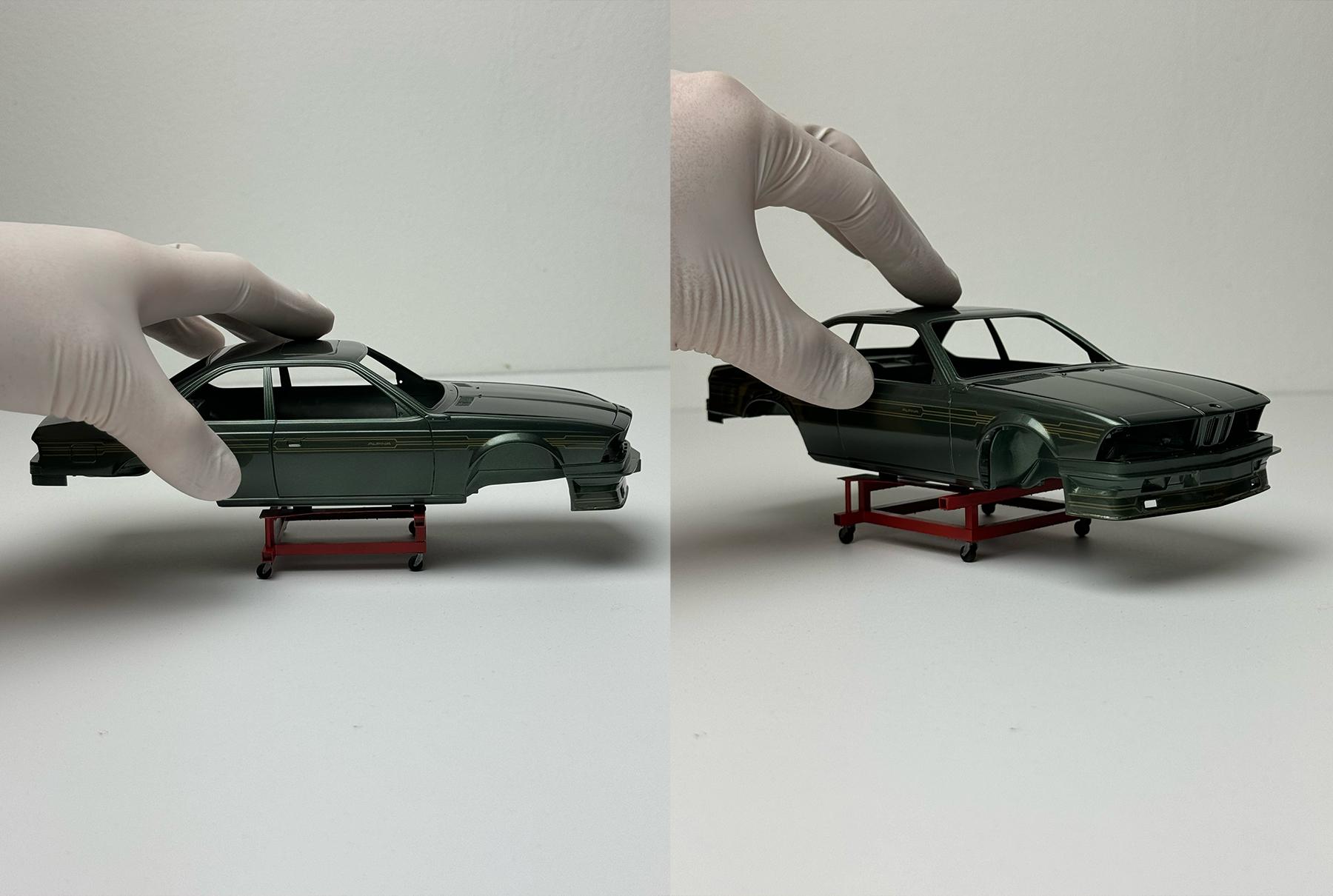

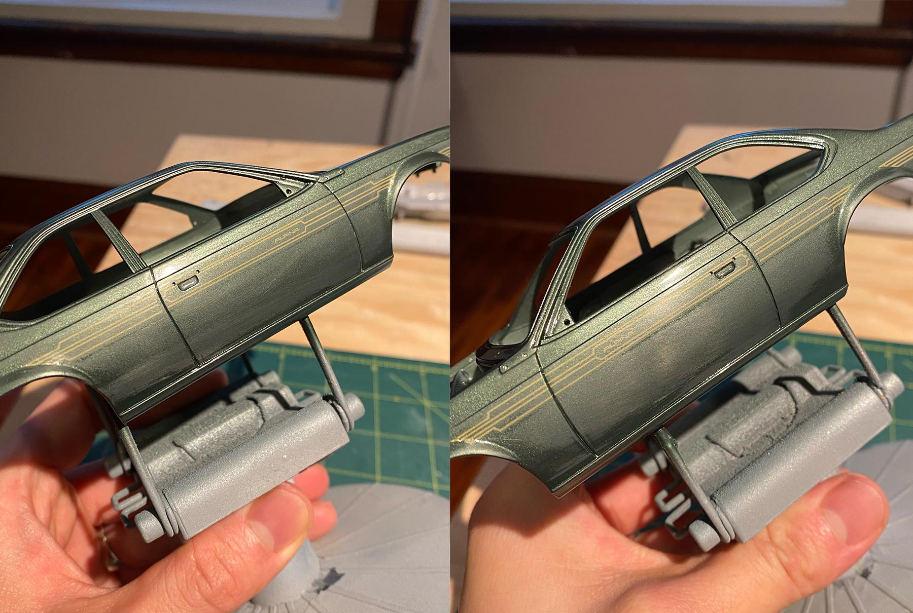

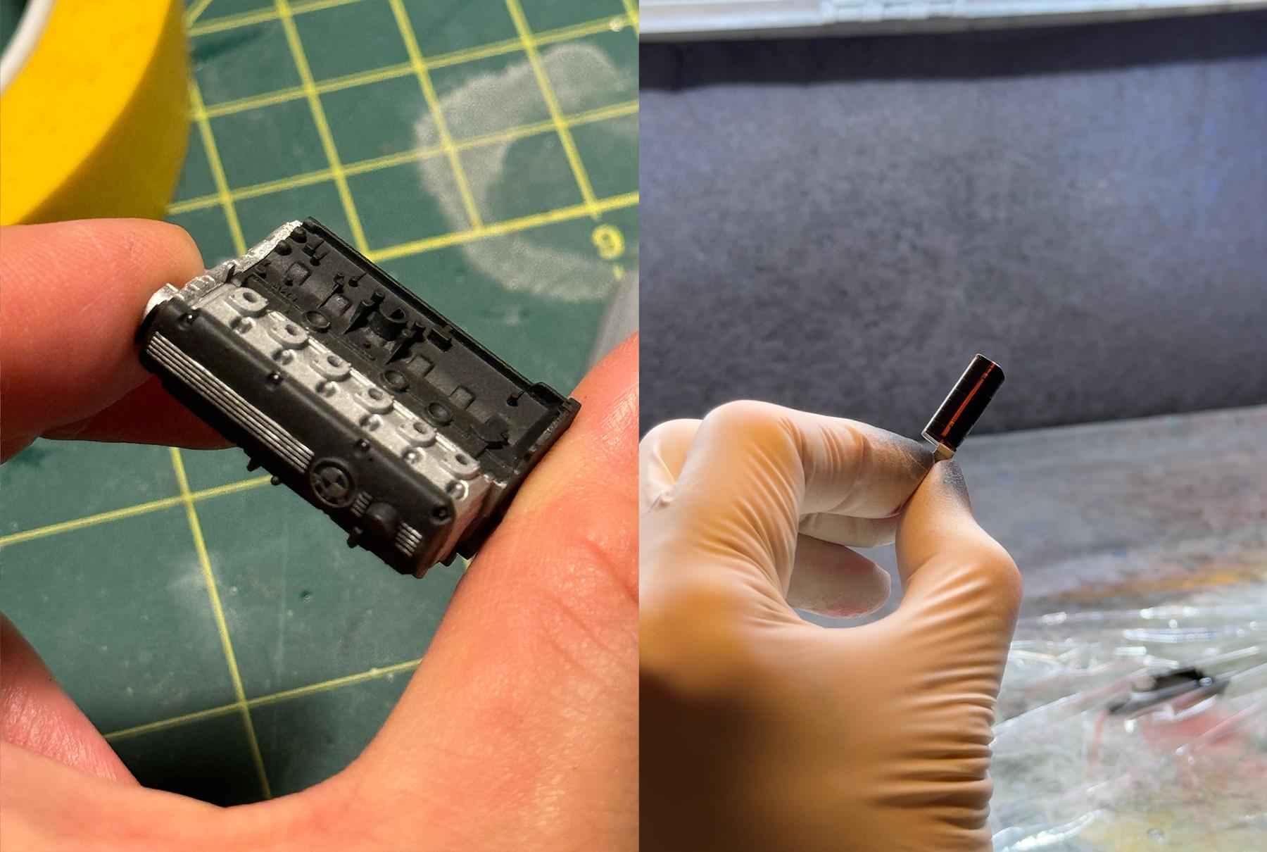

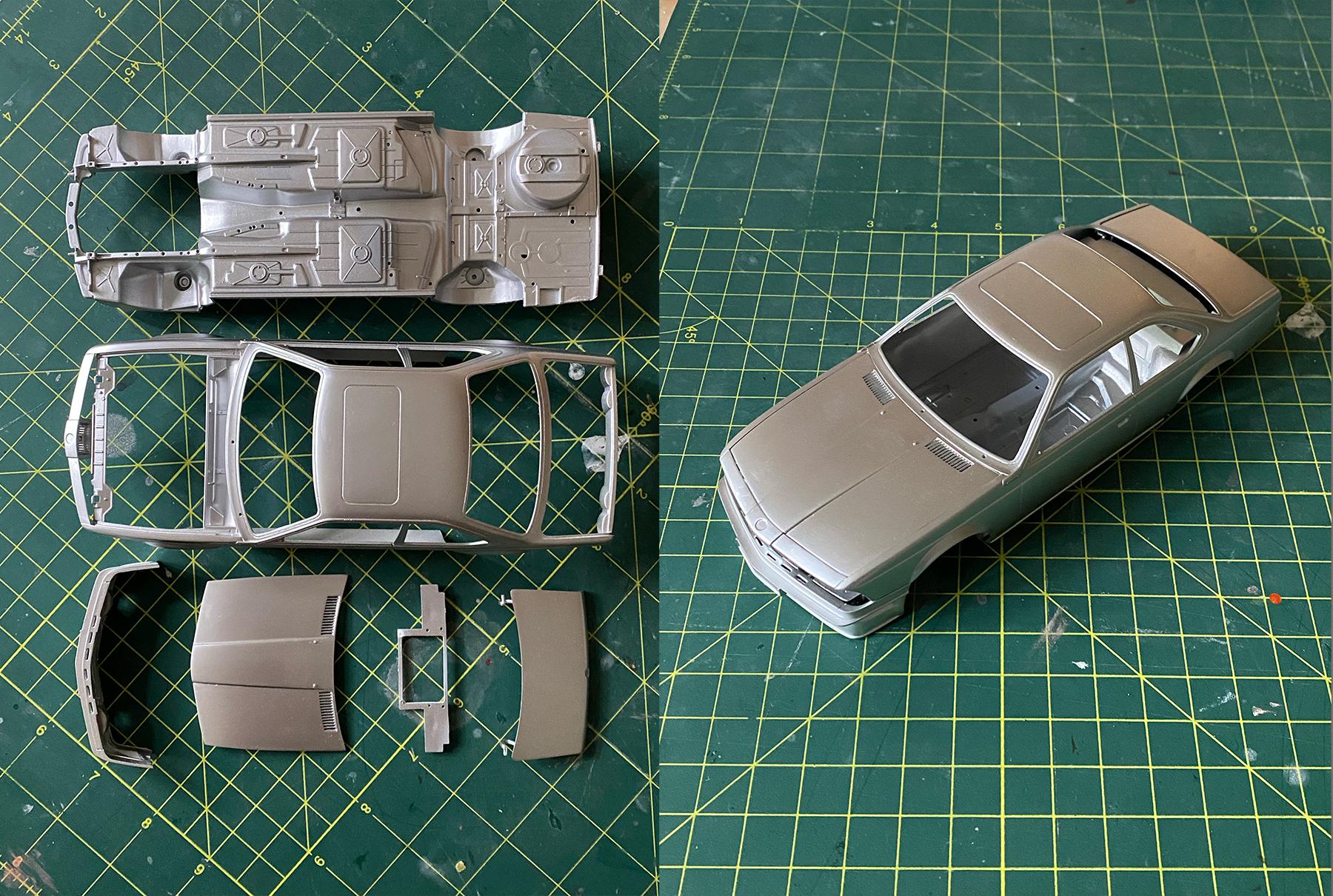

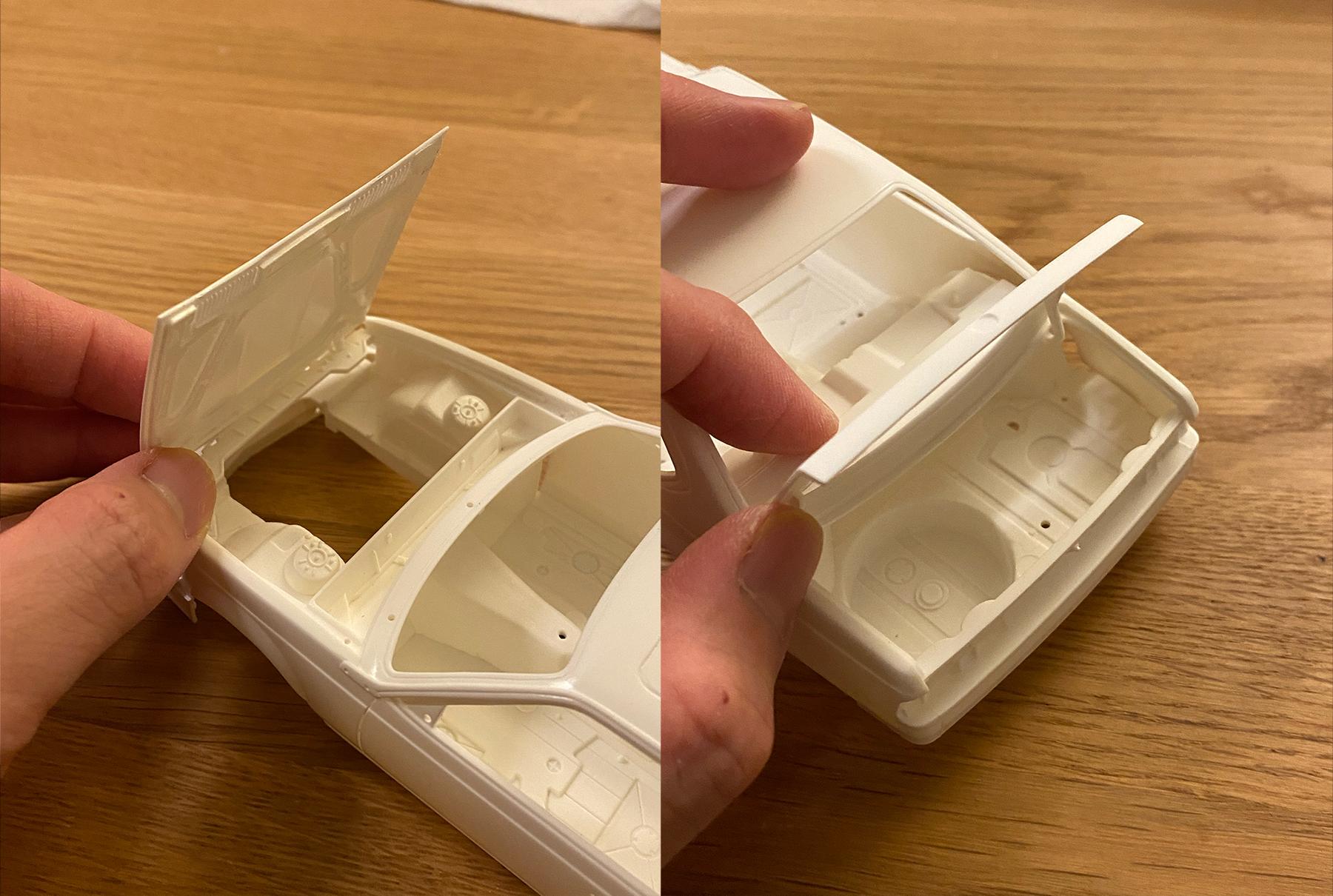

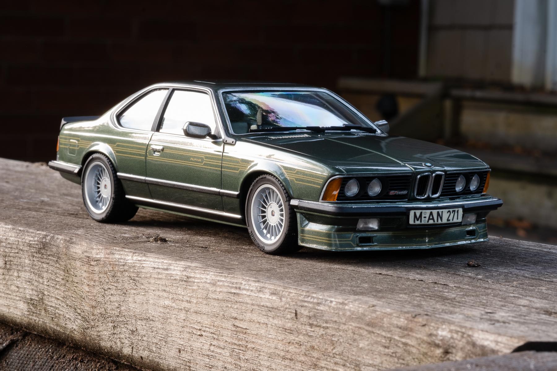

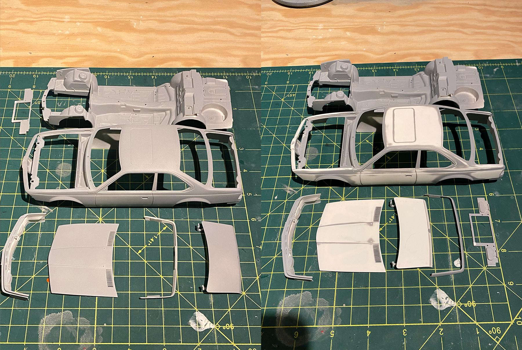

Hi all, My latest build is one of Fujimi Enthusiasts series - E24 Alpina B7 Turbo Coupe. This had been released twice (86 and 97) and this is likely the second release given the decal is still alive. Mold detail is almost as good as new releases from Hasegawa. So much detail! I started scribing the panel lines, wet sanded the body with 1500 grit then adjusted panel gaps for hood and trunk. I then laid grey surfacer, wet sanded again with 1500 to get rid of any flashes, laid silver then painted the base coat. To simulate one of my favourite BMW colours Malachitgrün (Malachite green), I mixed Mr Color’s GX metallic green, black, silver and gold. One of pitfalls of this kit is stock Alpina rims that feel a bit too small. The kit simulates E28-based 6 series but the wheel looked like smaller ones made for older E12-based 6 series. So I ended up ordering custom staggered 17” alpina with correct tires from USCP. I was scared of dried decal but most of them were good to use straight out. I laid Super Clear III and wet sanded the thickness and repeated that three times. Here's the shot after 3 layers of clear, before any wet-sanding and polishing. While the body was getting fully cured, I started the other stuff. M30B35 and Getrag 265 are faithfully shown - so many parts and so much details! I masked the airbox to paint the rubber/sponge seal in red, and used silver sharpie for valve cover letterings. And this is how engine looks after assembling - quite nice even without any detail-up parts! I painted all the suspension bits, wheels and tires.. And cleaned up all the interior bits. I wanted to do green on green so I chose to simulate BMW pine green for the interior by mixing flat black, IJN green and IJN gray. I used lighter shade of mix for carpeted area. After assembling the dashboard I made cluster cover using clear acetate. This is probably as good as injection-molded kits can go. Now I'm going to polish the body and move onto the final assembly!
Thank you very much! Thank you! Good luck with your build! Appreciate the compliment! I had some concerns knowing the history but it turned out much better than I anticipated. I didn't even have to adjust anything other than doing a lot of sanding! Thank you so much!
