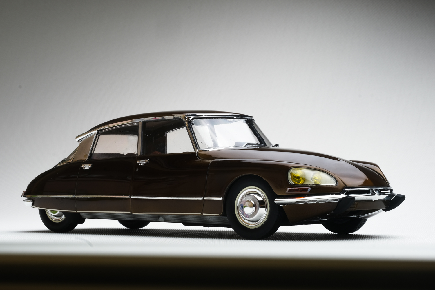

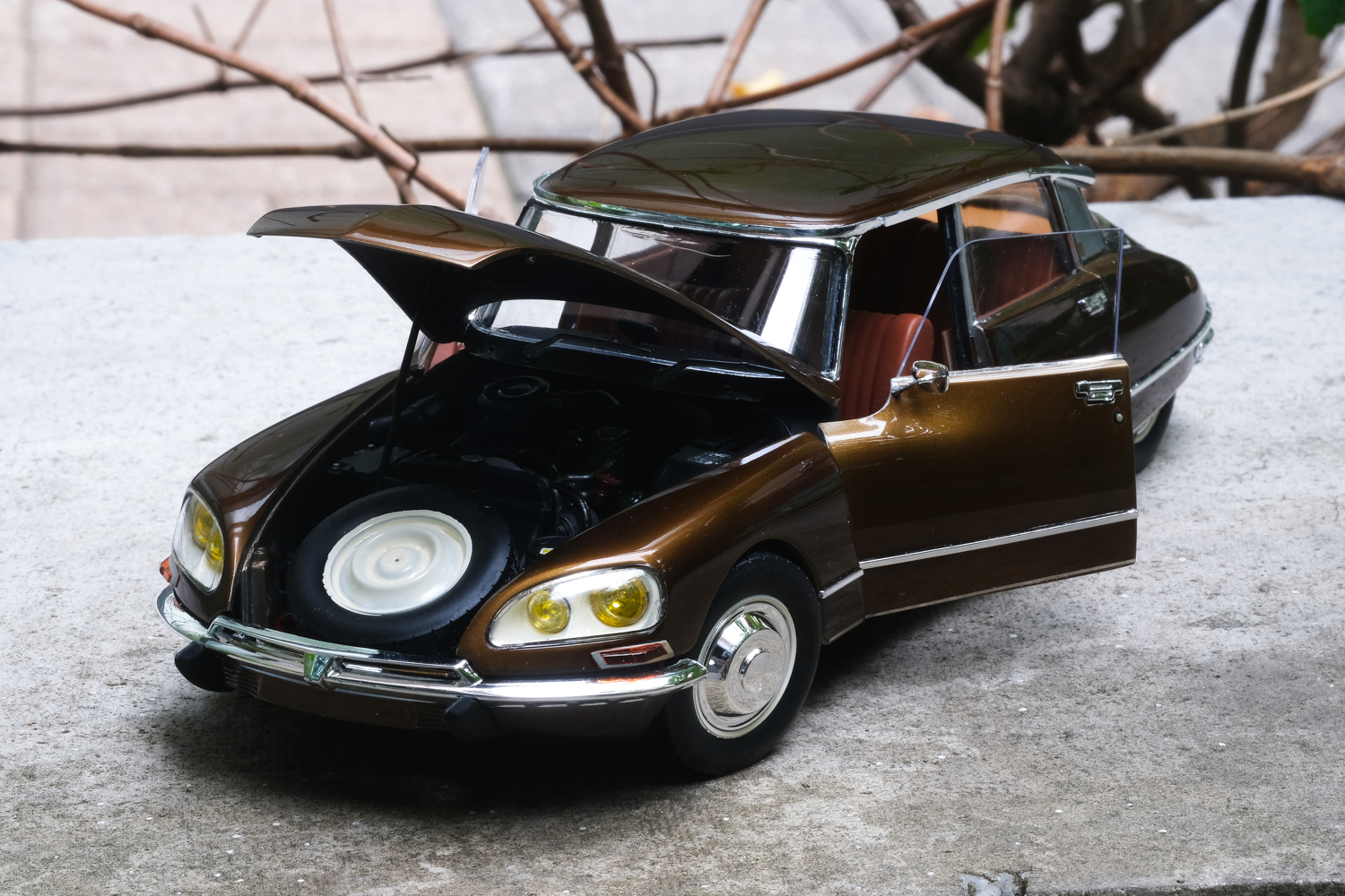

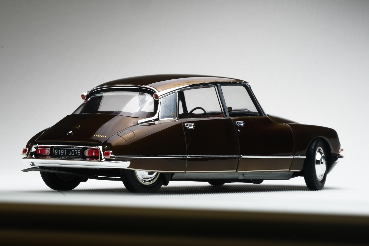

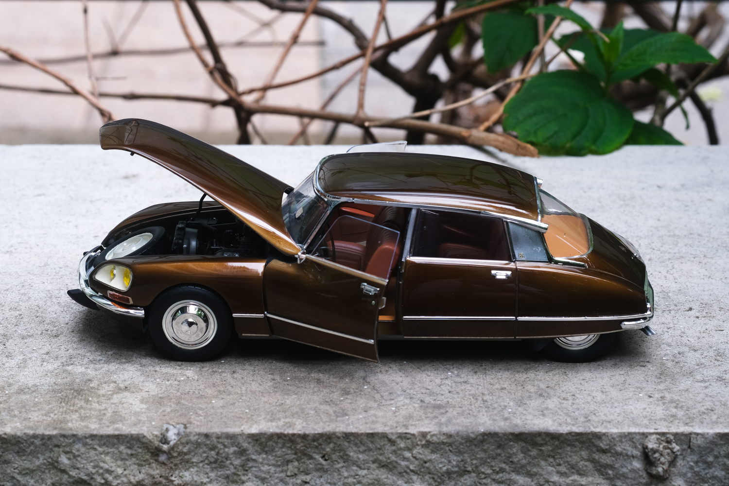

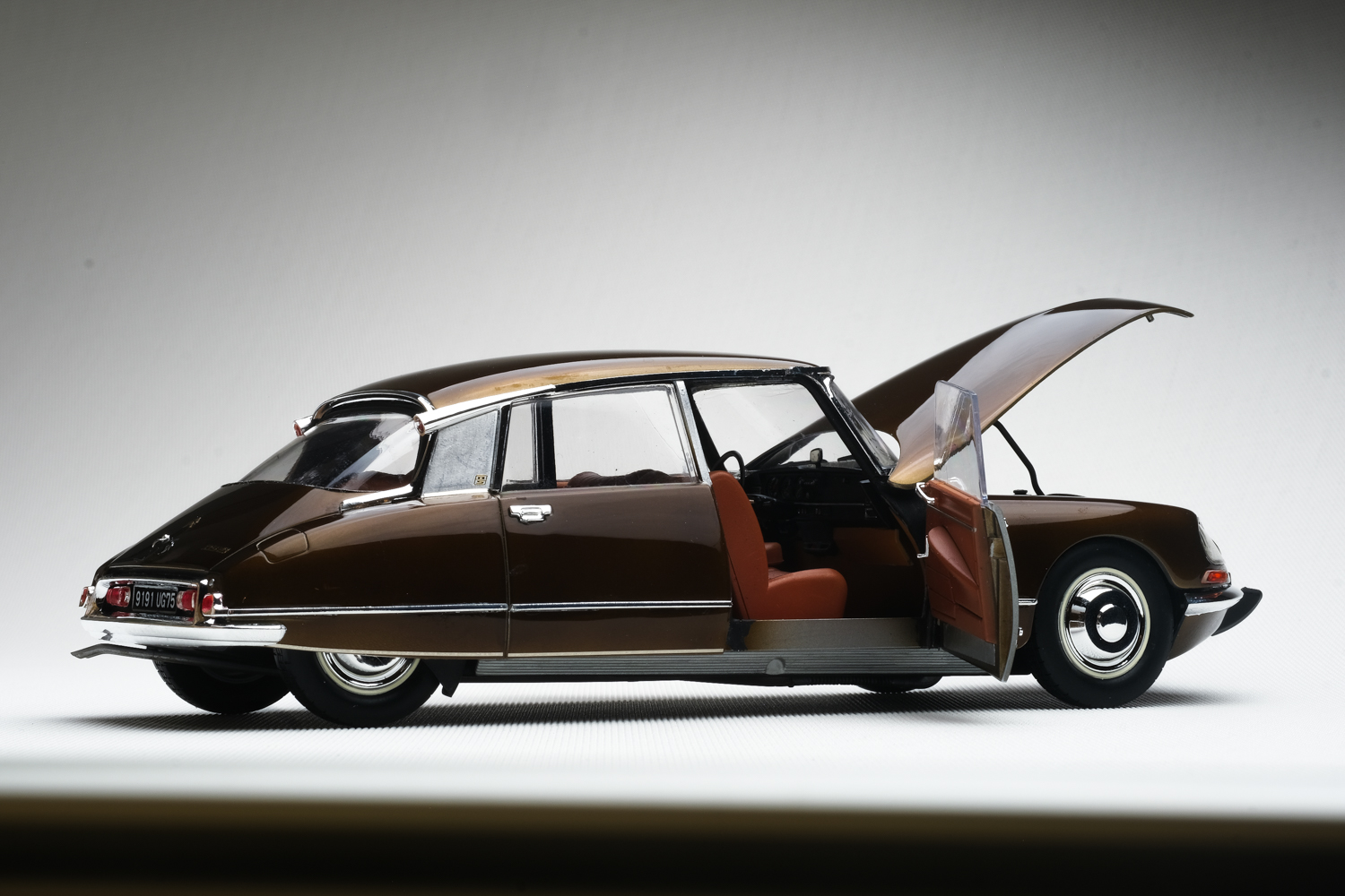

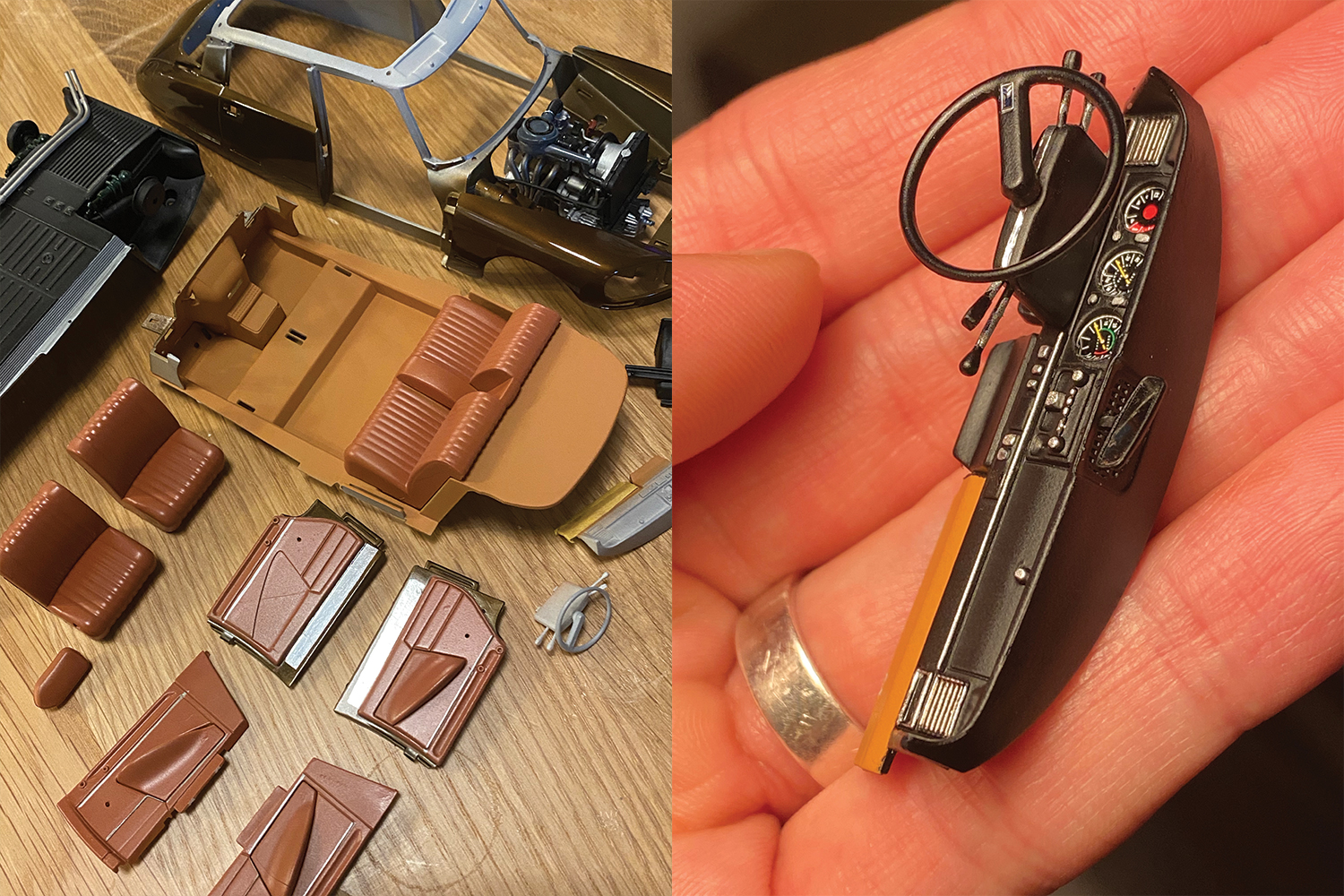

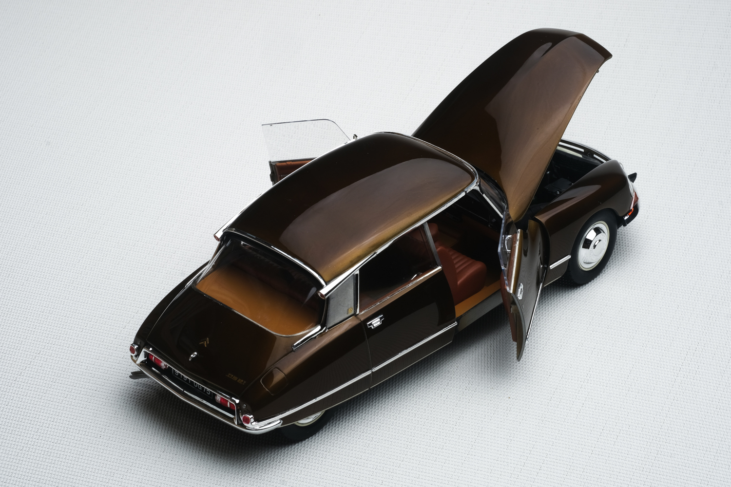

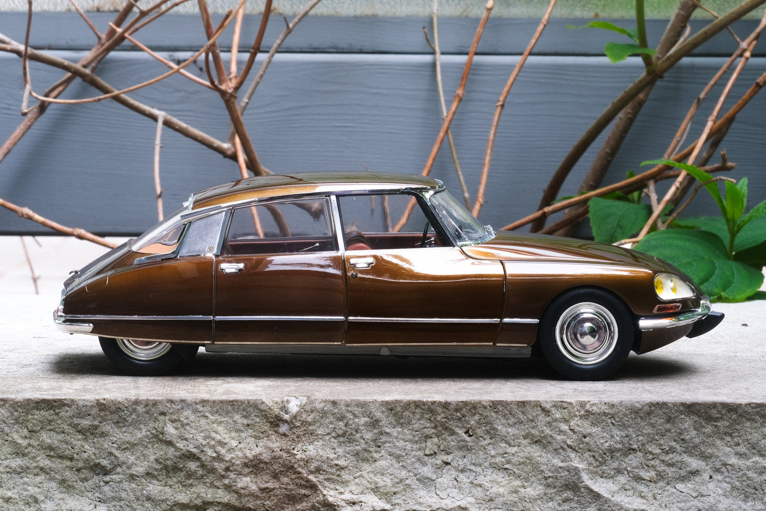

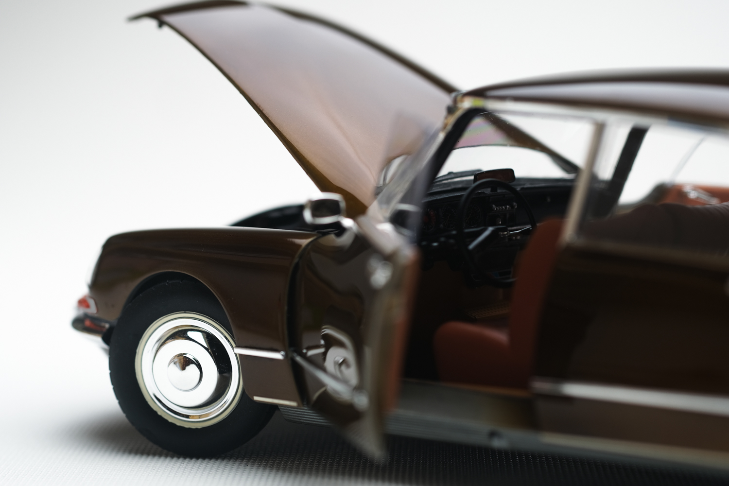

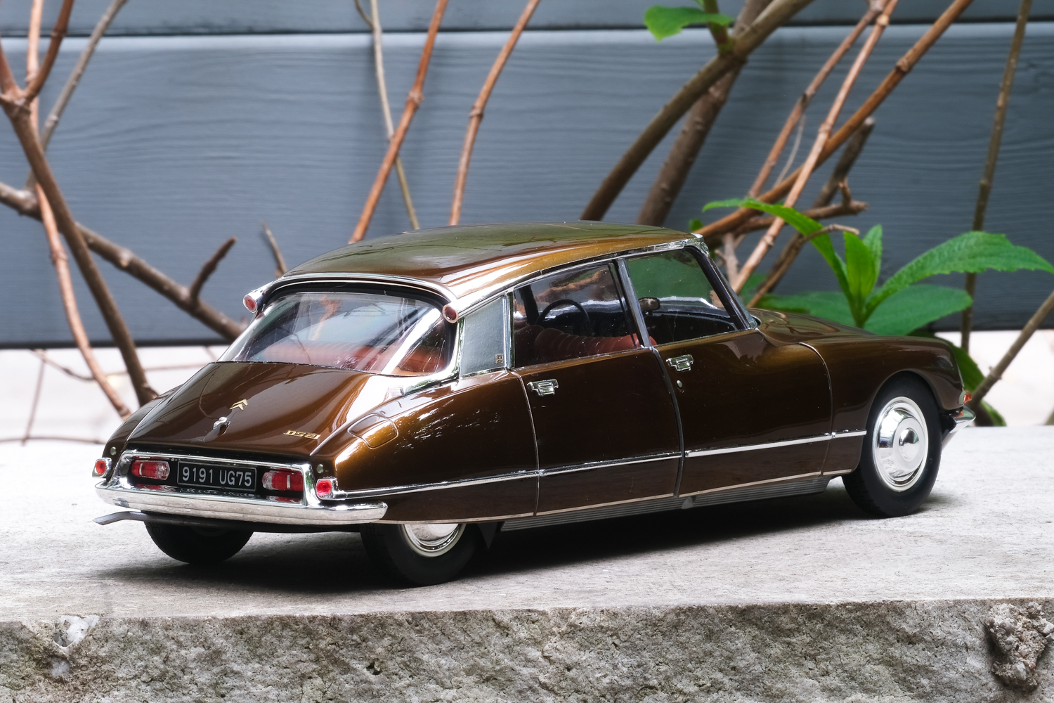

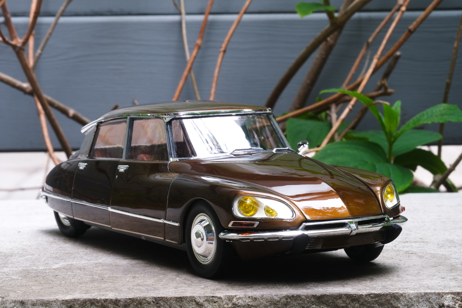

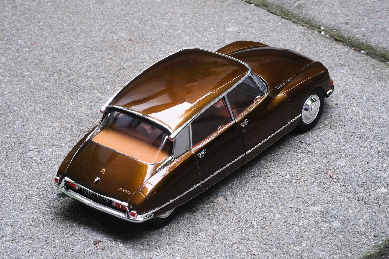

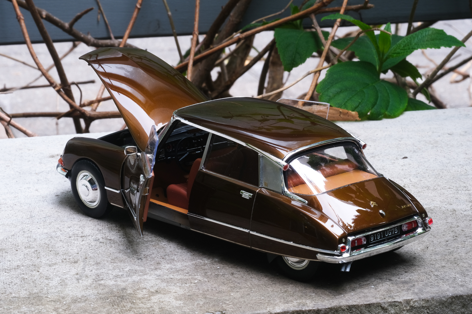

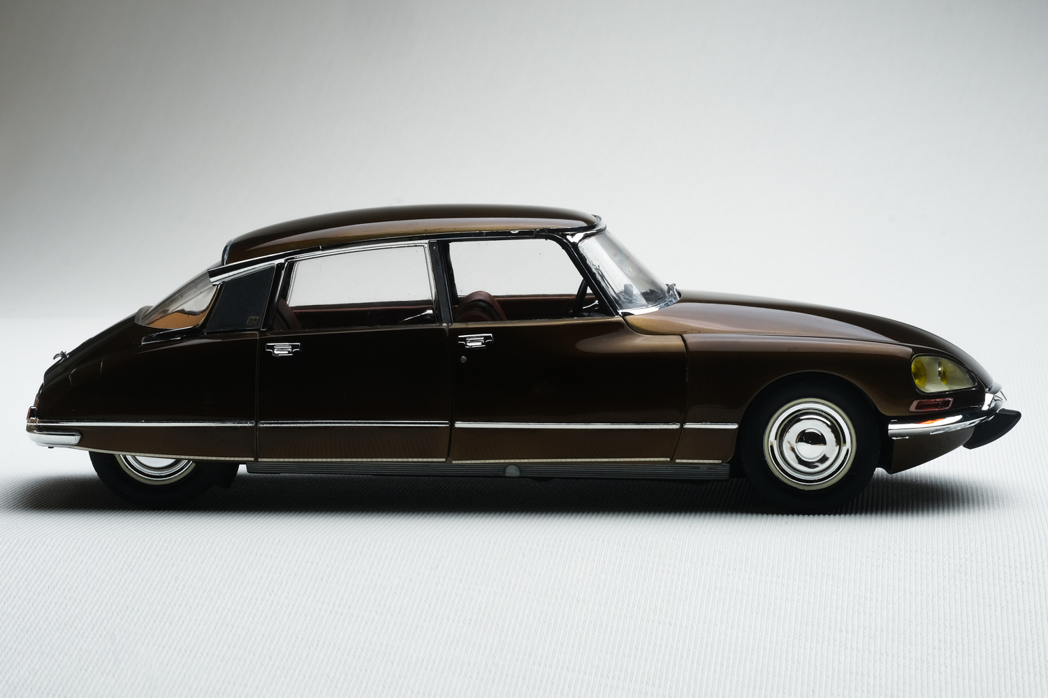

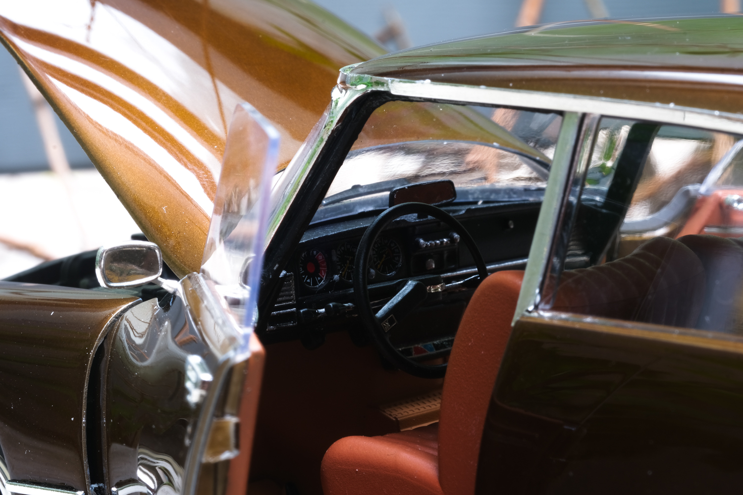

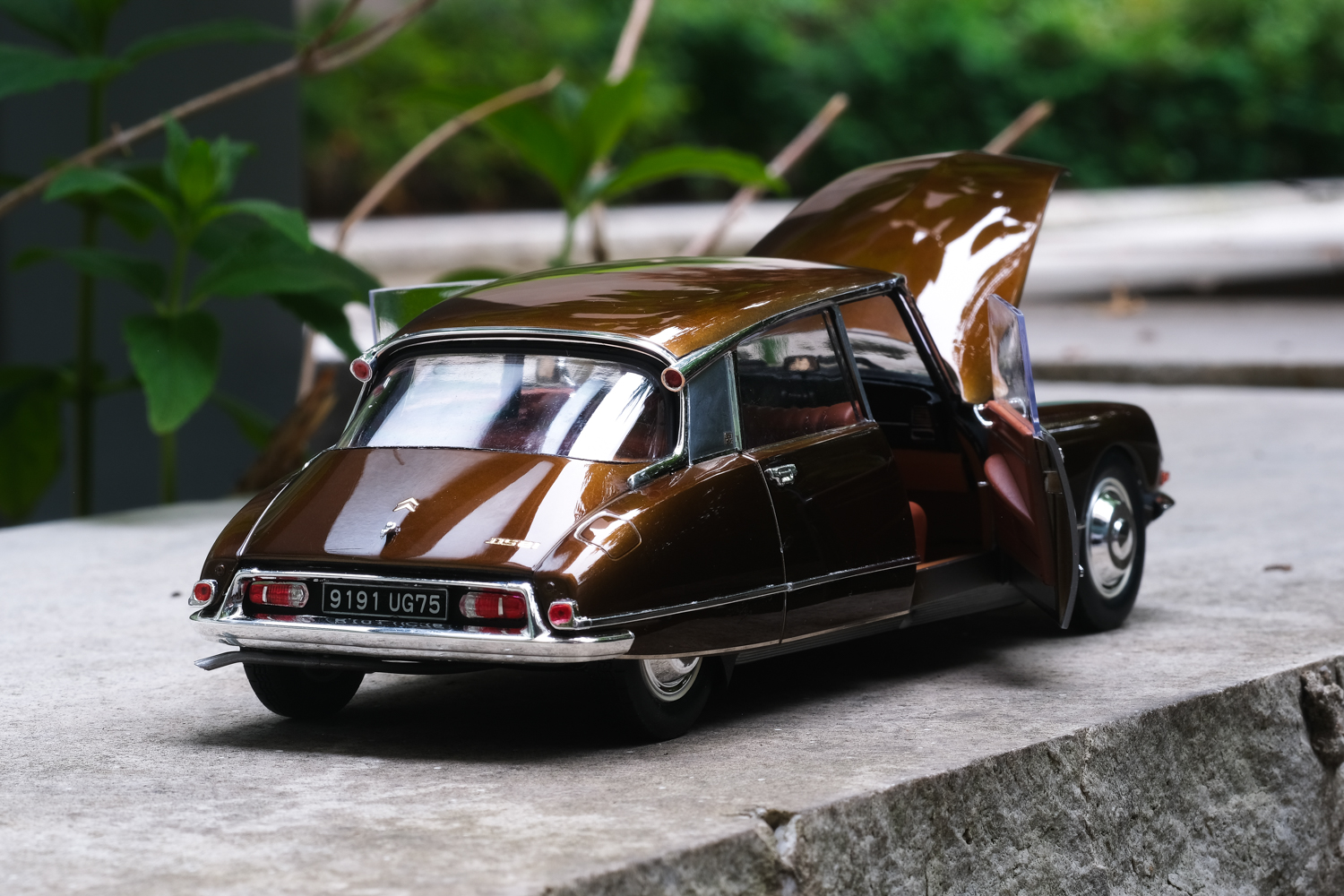

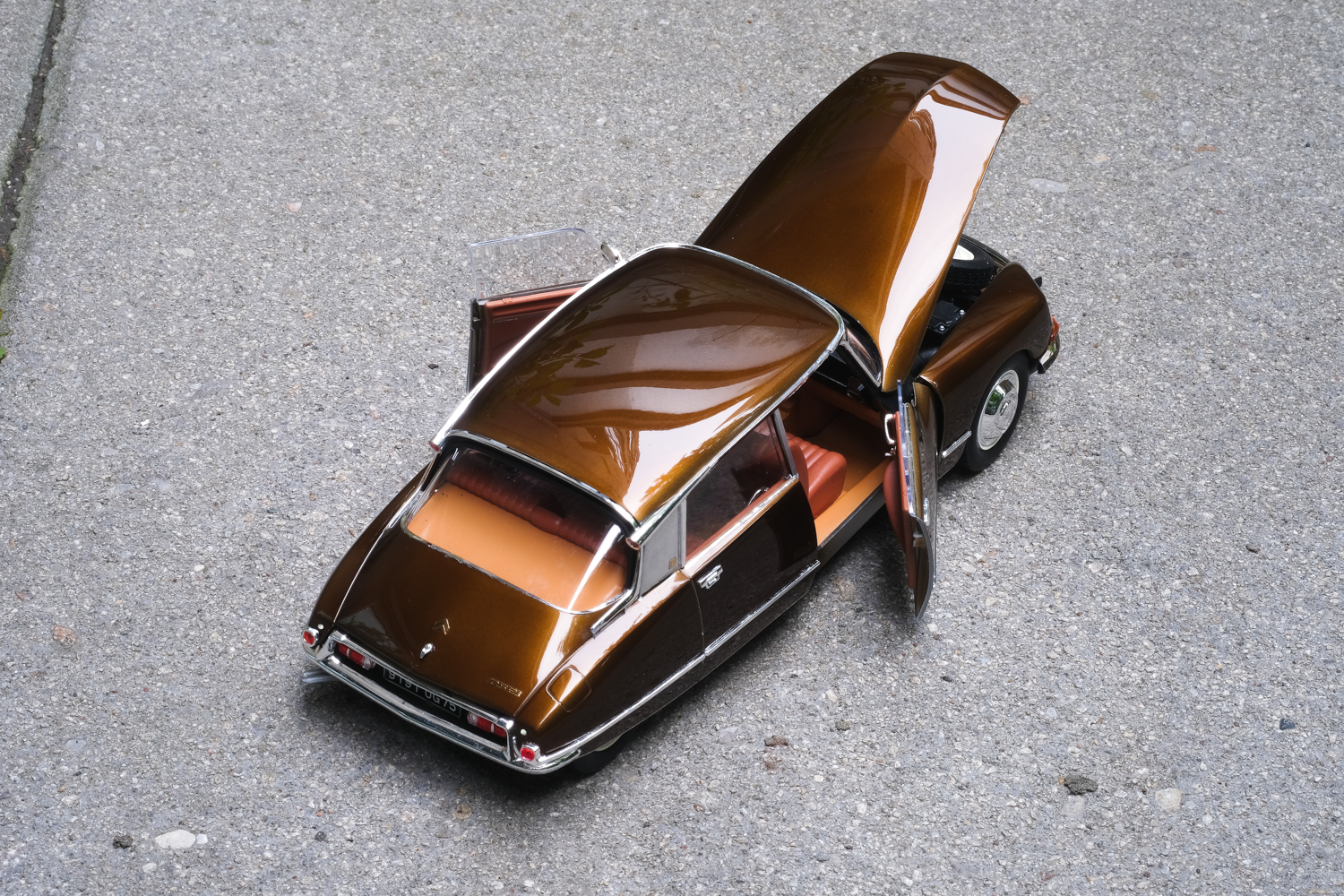

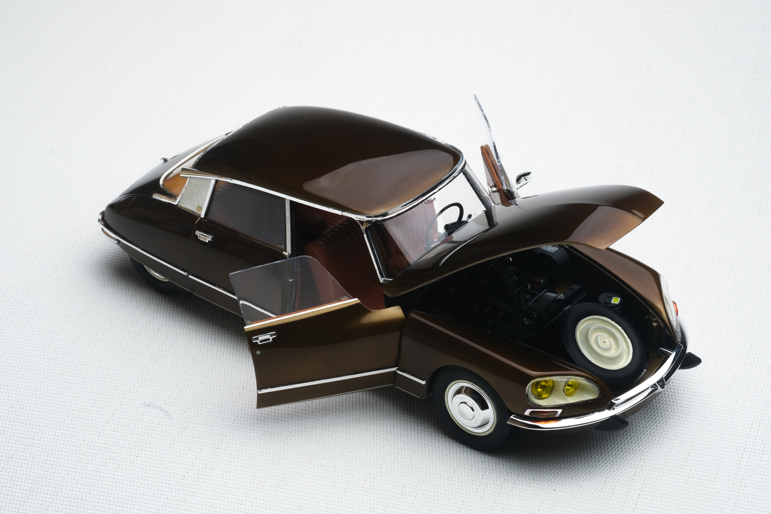

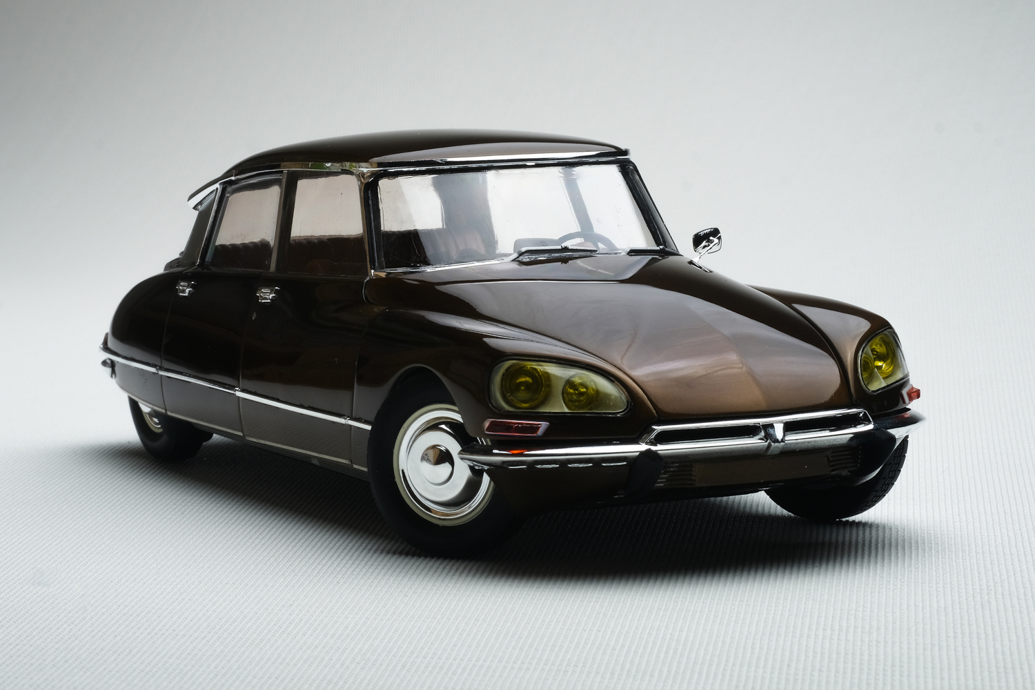

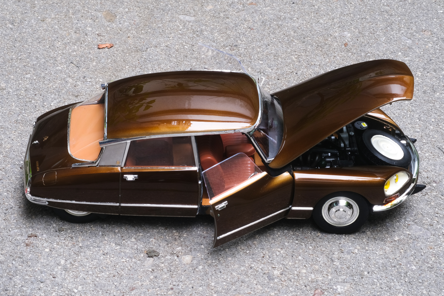

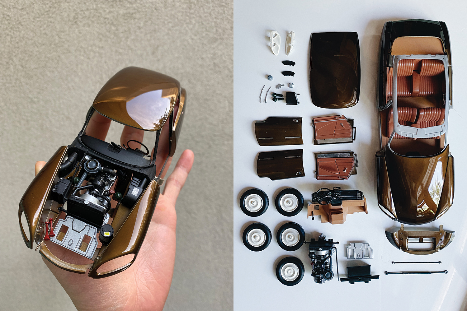

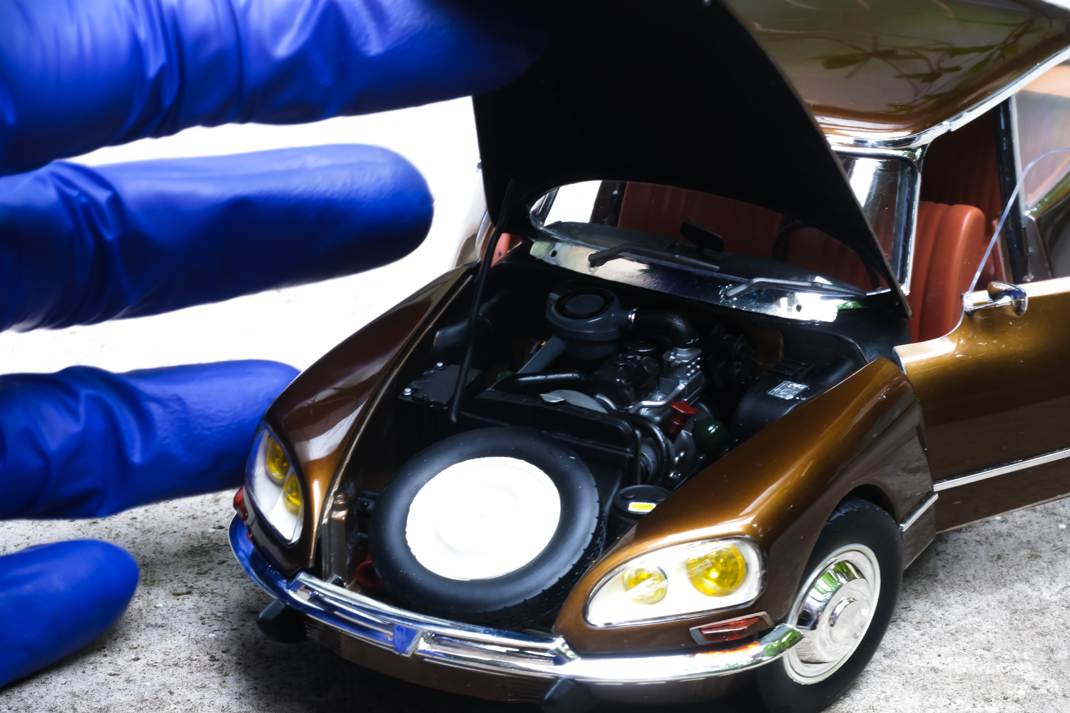

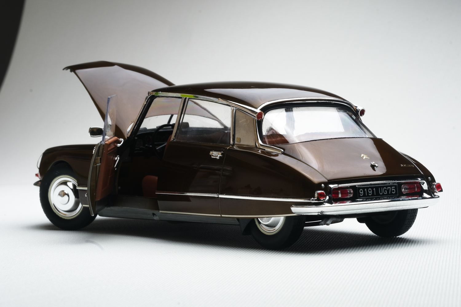

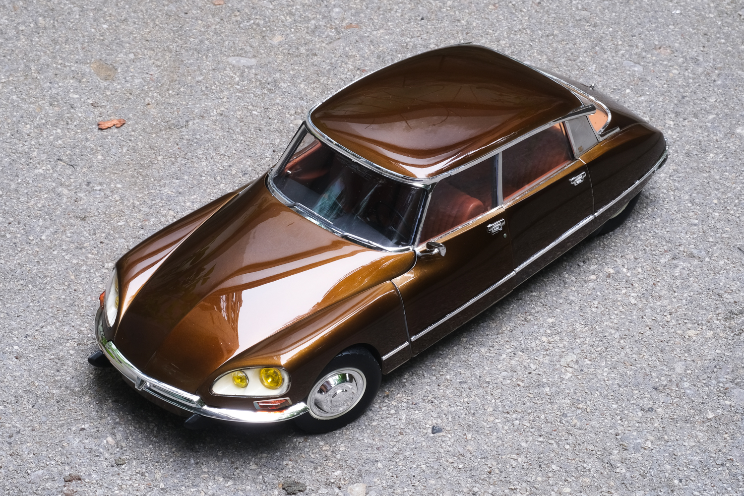

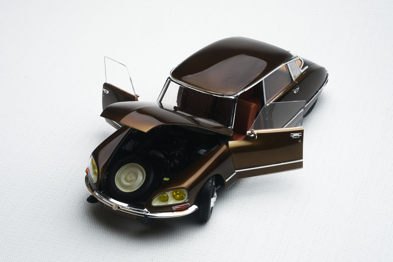

Hi all, I finally finished Ebbro 1/24 DS21 Pallas - it’s a fairly new release from Ebbro and it’s a fantastically engineered kit with working doors and full engine and suspension details. I built this one completely box straight - DS was available with many beautiful colours but I thought DS21’s Brun Scarabée is pretty iconic, so I laid Mr Color’s GX109 clear brown on top of chrome silver to simulate that. As for the interior, I used mix of Tamiya acrylic red, yellow, brown and tan to simulate brown interior and carpet, then laid semi-gloss clear on top of all leather trims to get the similar sheen. As for the rest of interior details, I used BMF and Molotow chrome marker. As for the body; Removing sink marks with 600 > 1500 grit Tamiya grey surfacer Mr color’s chrome silver 2 layers of gx109 clear brown 3 layers of Mr color’s super clear III with 3000 grit sponge before the final coat drying the paint for 1 month in room temperature 3000 grit sponge > Tamiya compounds Applying BMF matte aluminum to C pillar Even though the overall quality of kit is very impressive (after all Ebbro has very close tie to Tamiya), there were a few pitfalls such as chrome trims that go around the roof, incorrect looking wheel caps, and headlamp cover that doesn’t have vertical hairlines. Hope you guys enjoy!

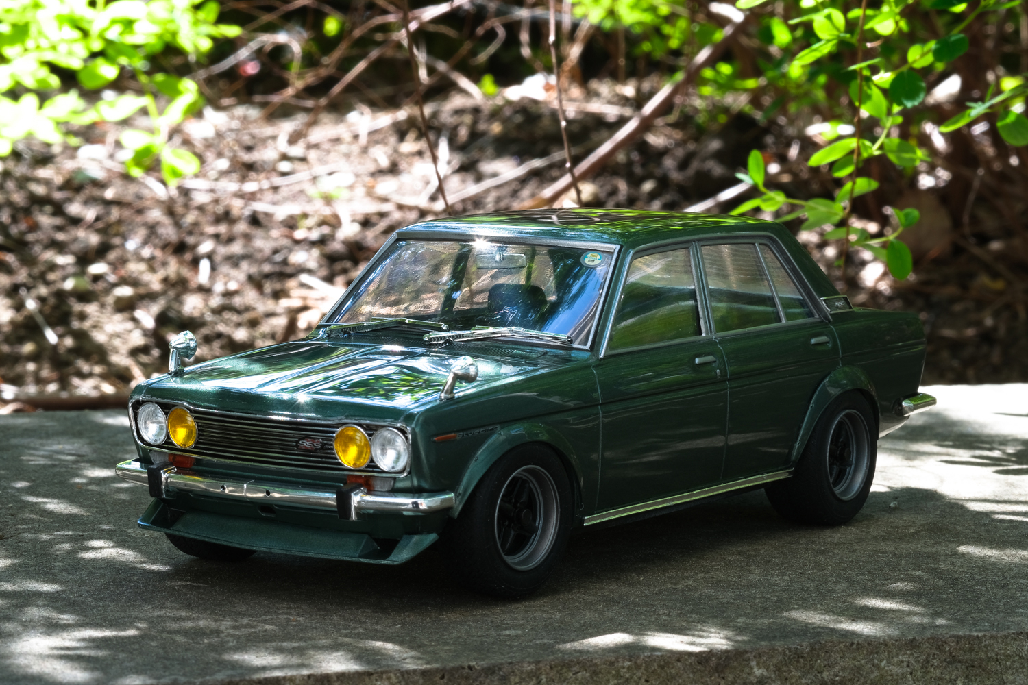

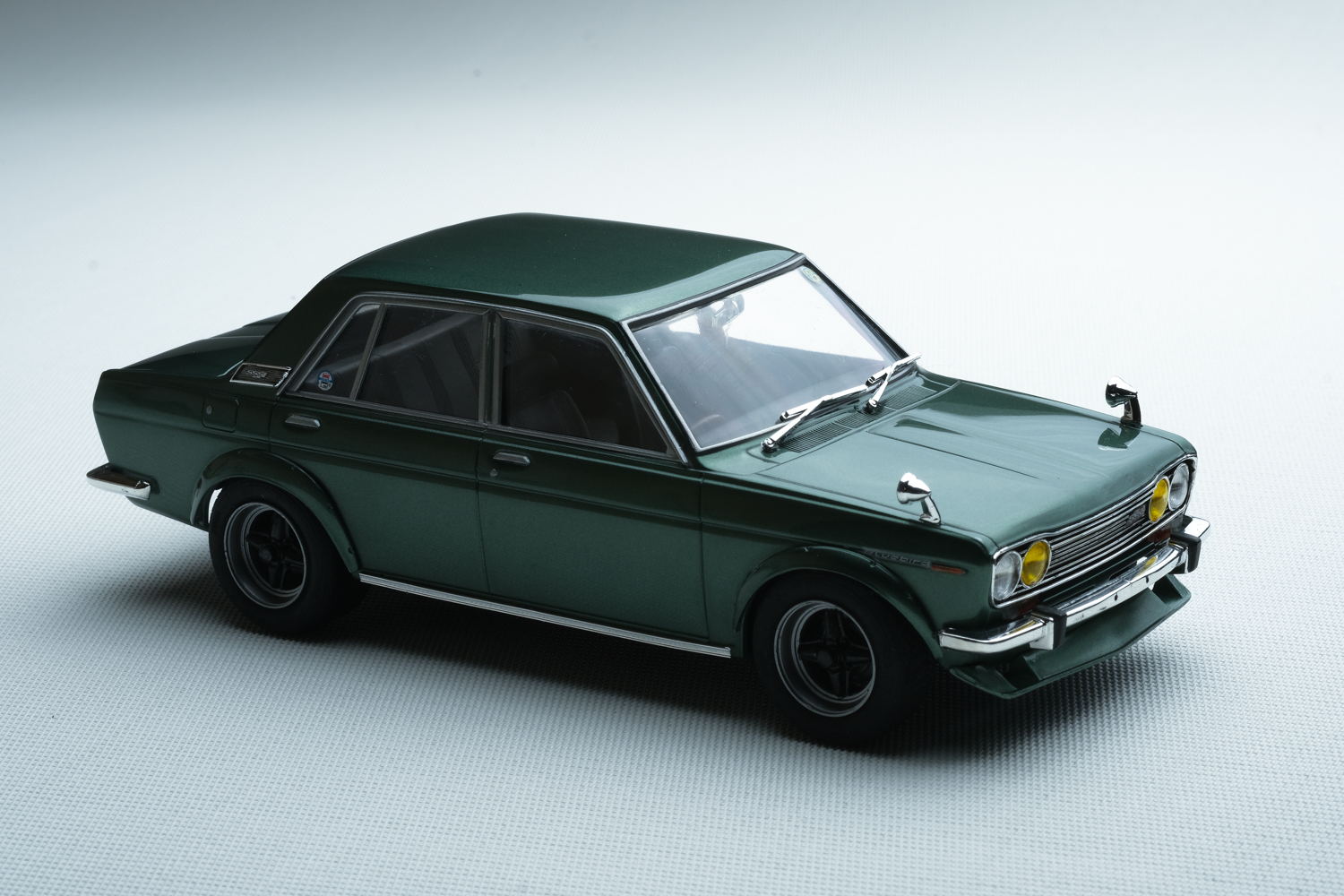

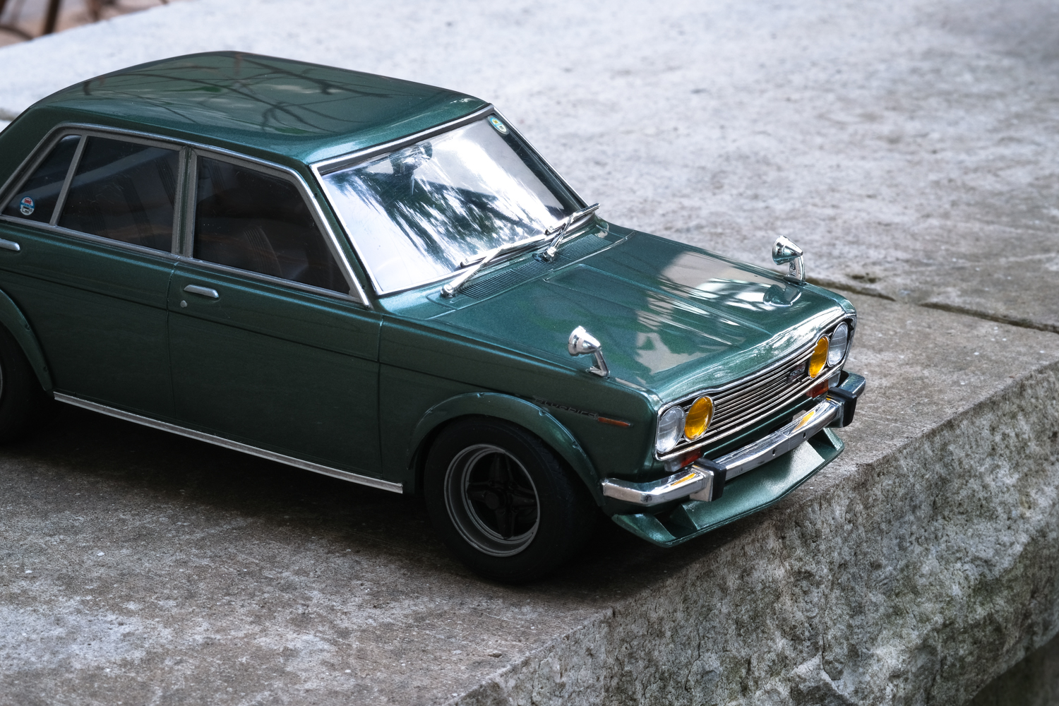

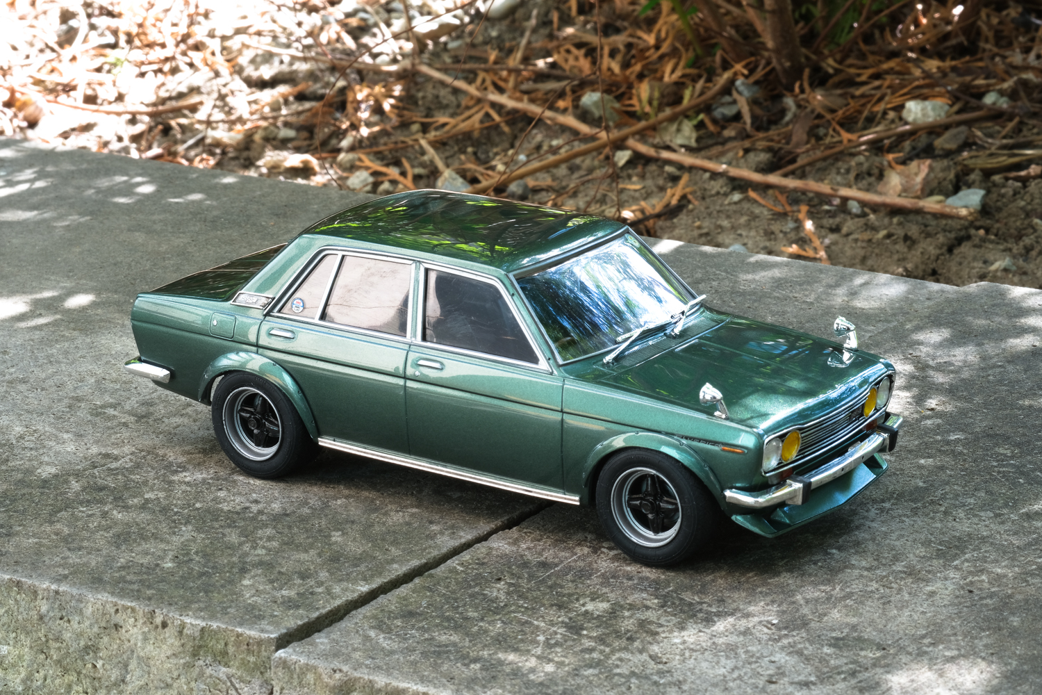

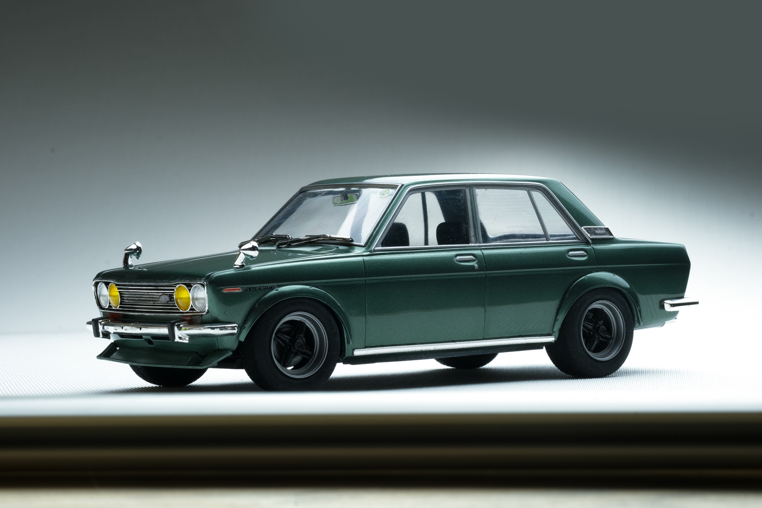

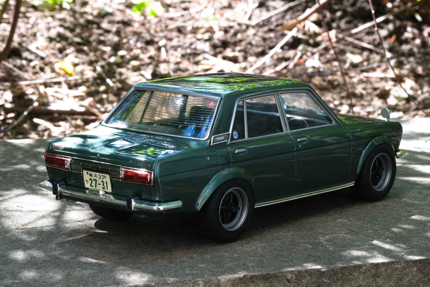

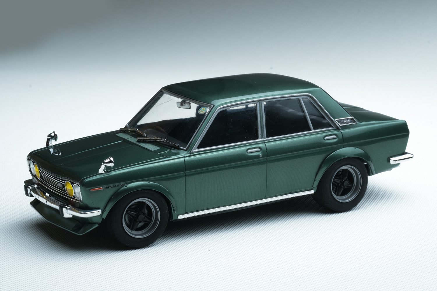

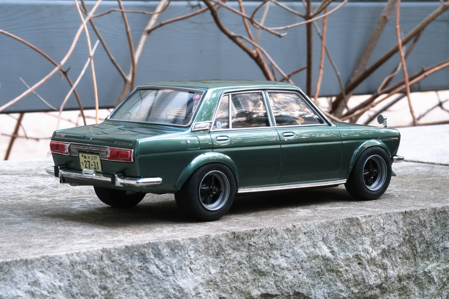

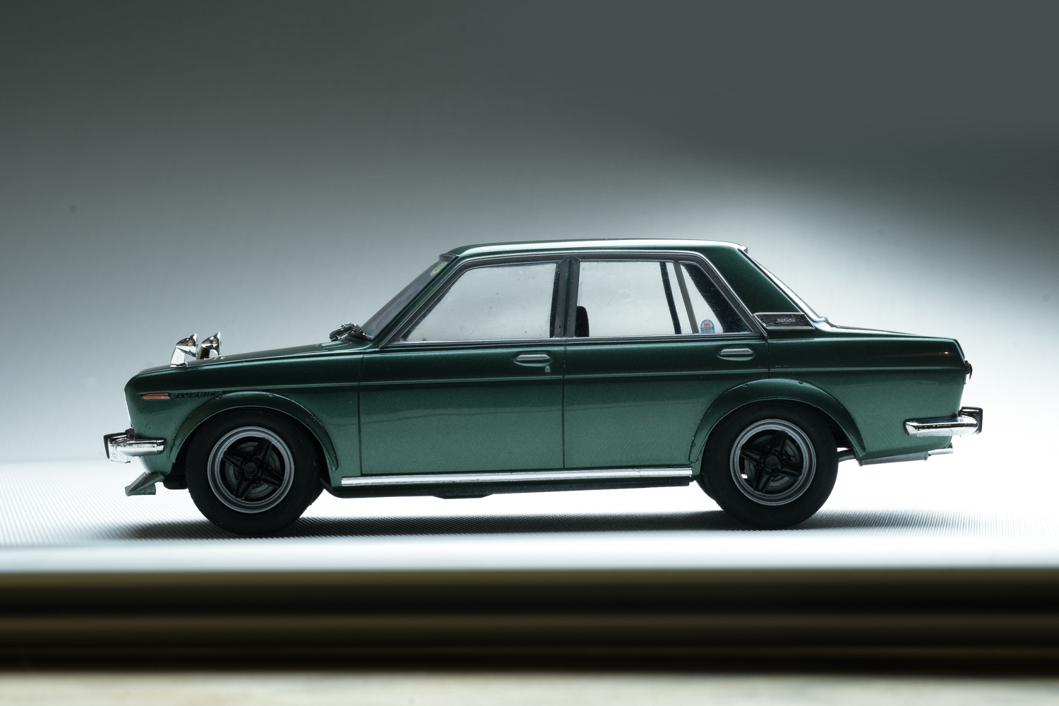

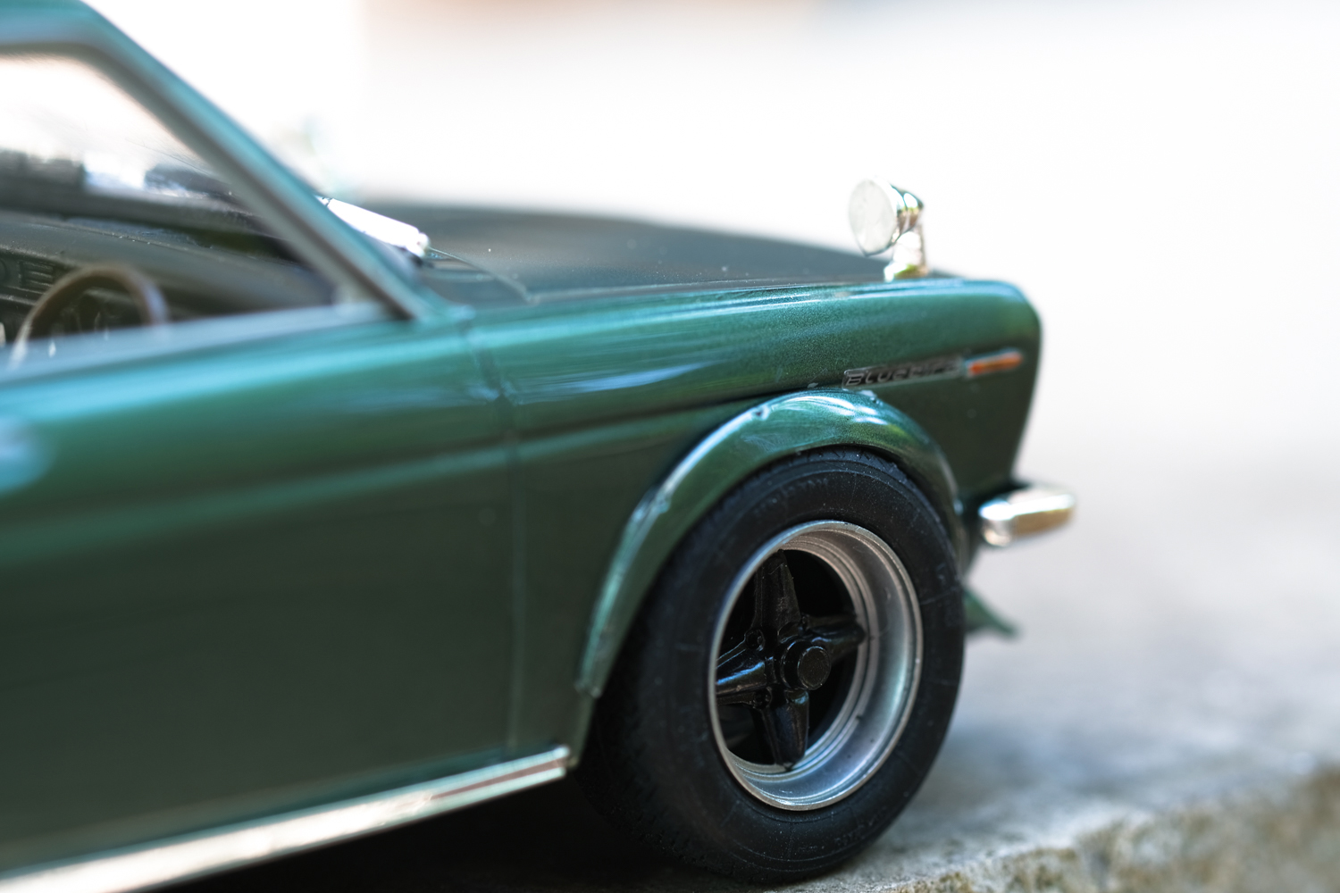

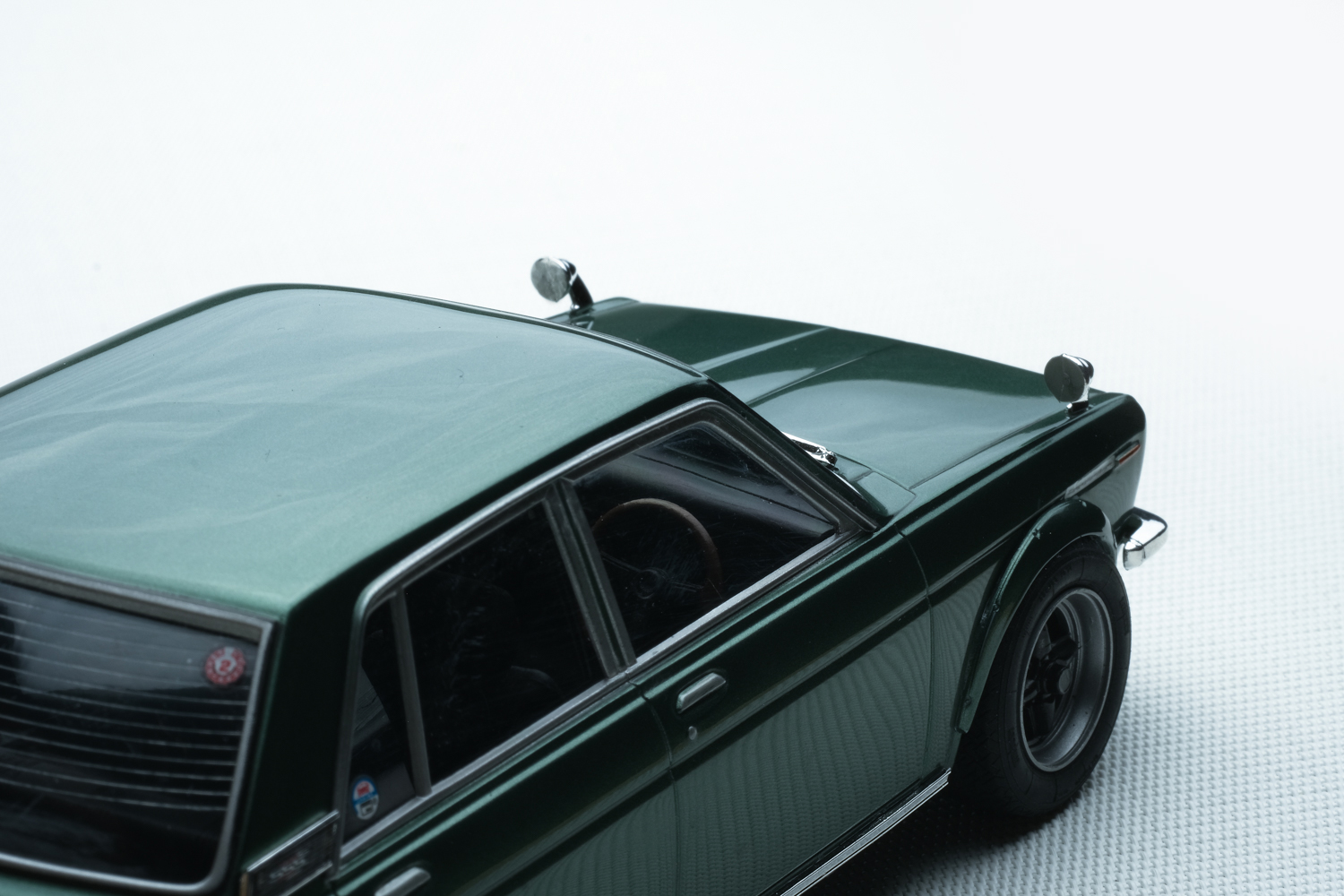

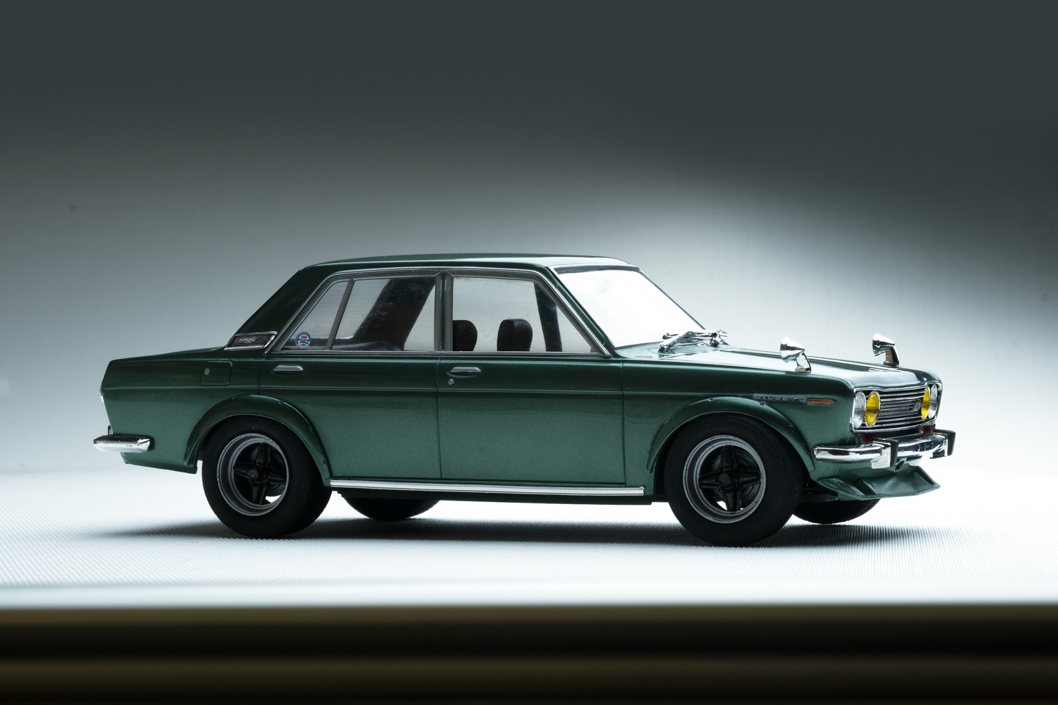

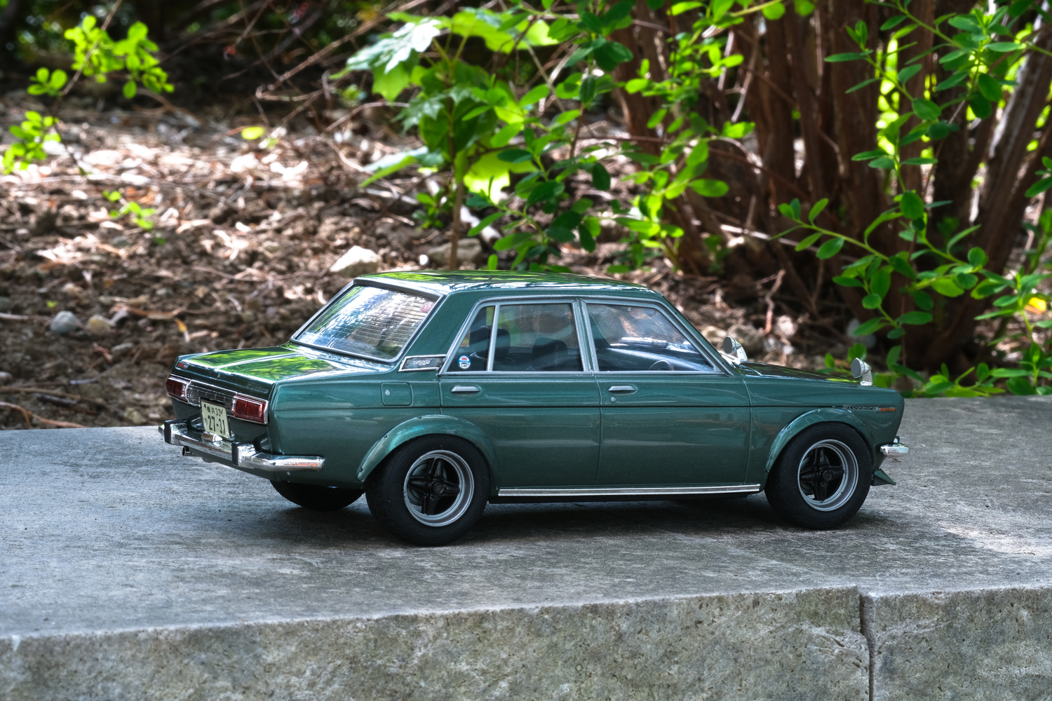

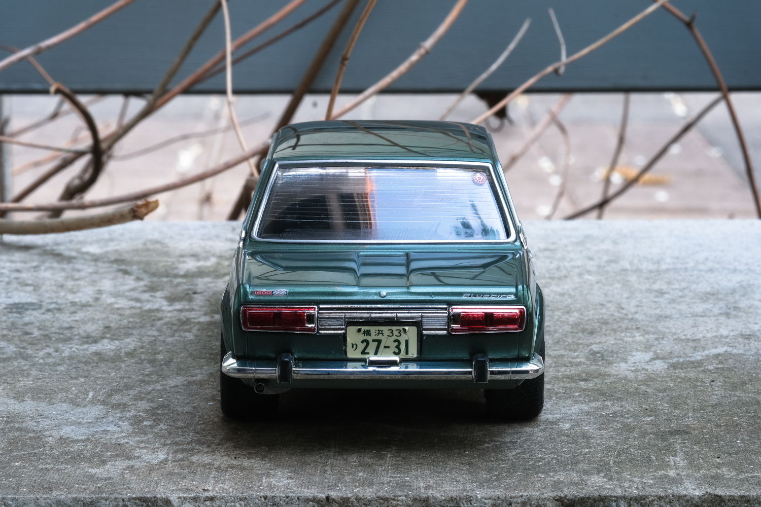

Hi folks, I haven’t been able to do as much modelmaking as work got so much busier this year, but I didn’t stop buying more kits.. so I needed to start finishing to clear up space for new kit boxes. This is a recent re-release of Hasegawa Datsun 510/Bluebird which includes front valence and Watanabe-style wheels, but when I got the kit the wheels were way too small for this car, so I instead decided to go for a period street racer/autocross look, with aftermarket rims from Aoshima that looks similar to American Racing Le Mans wheels which were go to choice by BRE and period looking Fujimi tires. I also added fender flares sourced from Hasegawa Fairlady kit to clear the rubbers, with good amount of trimming around the wheel arches and underbody. Here’s my build summary as usual: - Cleaned up mold lines with 600 grit and gave whole body a good 1500 grit wetsand prep - Sprayed Tamiya grey surfacer - Mixed Mr Colors’ aluminum, gold, metallic green and tiny bit of metallic black for a base color to simulate one of rarer period Datsun colors - 302 Leaf Green Metallic - Applied three coats of Mr Colors’ super clear III and progressively added more self levelling thinner on each coat (wet-sanded the second coat with 2000 grit to get the optimal surface for the final coat) - Dried the paint for 1 month (for the most of time, I usually dried 2 weeks for all the bodies I painted with TS spray cans, but then I noticed some of my recent builds would lose some shine couple of weeks after I finished them, and bit of research I realized 1 month drying time for lacquer clear coat was the rule of thumb in most Korean and Japanese modelling community) - Wet-sanded with 3000 grit sponge then polished with three-stage Tamiya polishing compounds - Masked the front & back windows and sprayed Mr. Color’s flat black, then masked them again and applied chrome silver to simulate rubber surroundings. Thank you for looking and hope y'all enjoy!

Thank you! It's a great kit that doesn't need ton of work to make it look good. It's a recent re-release so they're available for cheap price as well. Thank you! My new macro lens helped getting some good pics! Thank you very much!
