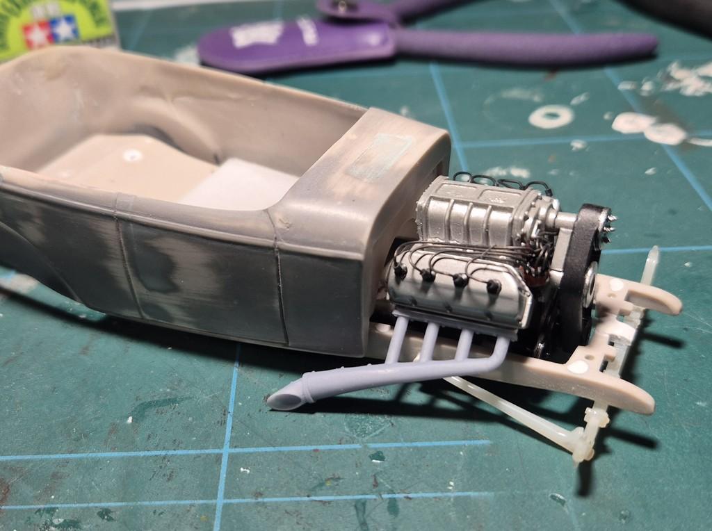

With the rear end finished I threw some color on it and while waiting for it to dry I moved on to tackling the exhaust starting with the Lakester style headers. I had to make a wedged shape piece of styrene to glue between the head and header flange to raise the angle of the primaries up so that they would not interfere with the chassis rail/ I took this opportunity to drill some holes and super glue styrene locating pins to the header flanges. It is my intention to run an exhaust pipe out of the back of the headers under the vehicle some how.

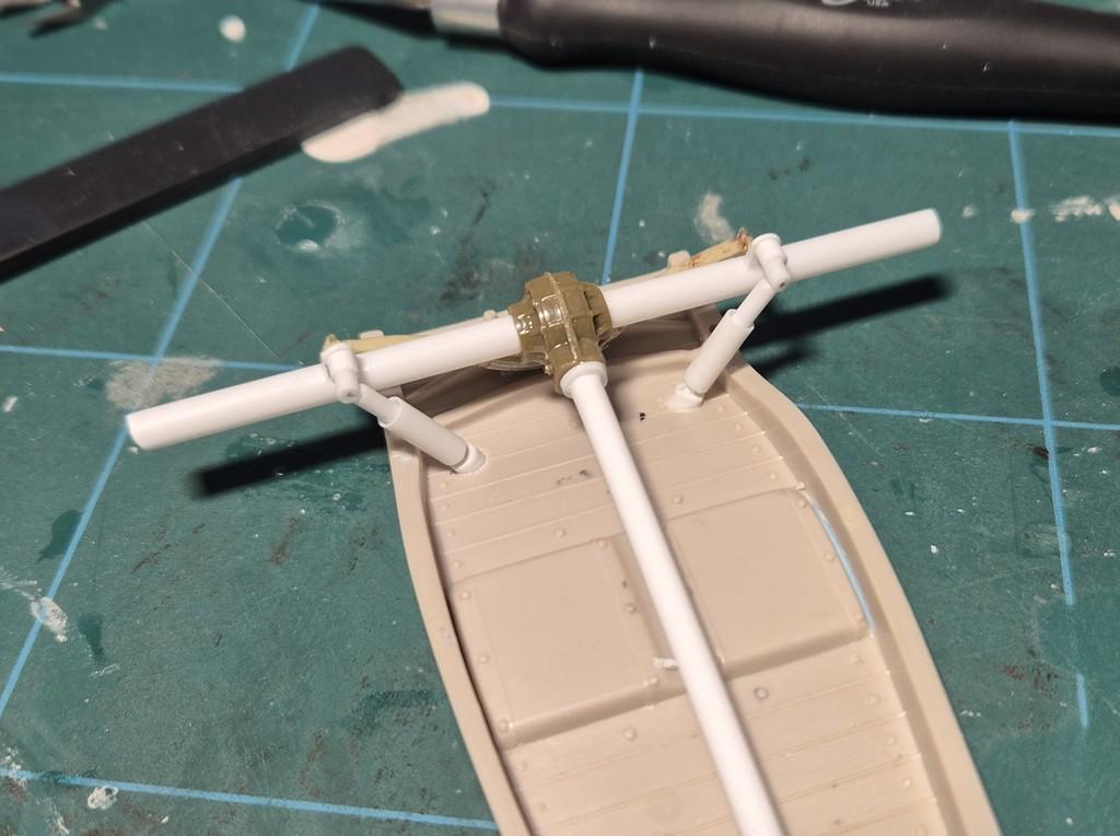

Trimmed things up a little and drilled some holes for the pins I have used to secure the transverse spring to the axle tubes and it all looks like it fits pretty good. Next up will be shock absorbers. I haven't been able to find anything suitable in the parts stash so these at this stage will be scratch built also.
Well after spending a little bit of time modifying this axle this afternoon I've decided I really don't like the results. I stumbled upon a chrome center section just randomly laying on a shelf in my display cab net. i have no idea where it came from or what kit it came out of but I played around a bit with it and decided I liked the look. I stuck it in a shot glass of bleach and stripped the chrome from it split it into two halves and gave it a good cleanup, I glued the two halves bvack together and drilled it out to accept the axle tube and I have decided to stick with the enclosed torque tube for a drive shaft. I think I'm liking the results so far, what do you think?
So I pulled the phaeton out of the display cabinet this rainy afternoon to discover that the rear wheels have a huge amount of negative caster. I guess the resin has maybe not cured strong enough to hold the weight of the model itself for an extended period of time. The axle seems quite firm and was originally cured under a uv lamp. I don't feel much like making another one even though I do have the mold. After a quick cup of coffee I decided to cut the axle tubes from the center section. I am going to drill a hole through the center of the center section an slide a length of styrene tube with a piece of wire up the center of it for strength and move on. I have never been 100% happy with the look of this axle, to my way of thinking it lacks a little in detail around the center section so I may attempt to add some more detail as well. I'll see how I feel about this once I have sorted the bent axle issue.
