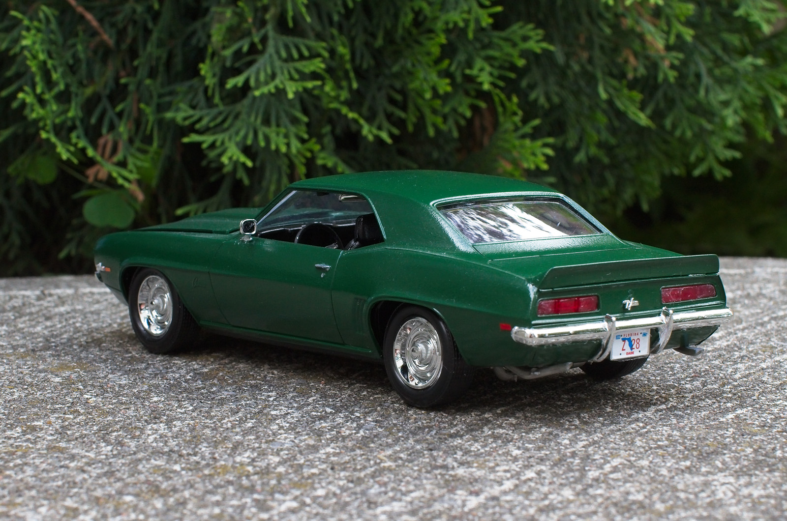

Thank you kindly @David G. @Can-Con @mustang1989 @chris chabre. Definitely a few errors made and new techniques learned along the way. The photos flatter the build a little, however, overall I'm pleased with the final result. ? Cheers!
All done! Took some photos this afternoon. Many thanks to all those who gave me good advice along the way. Cheers! ?
