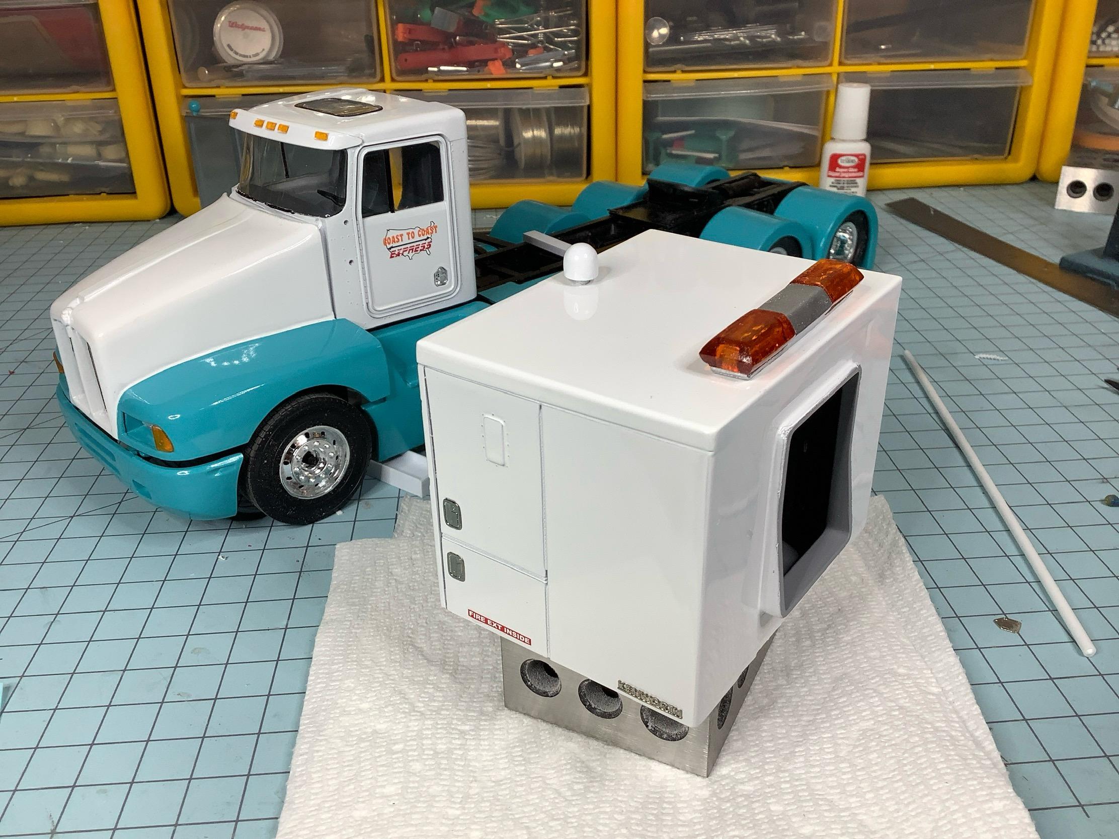

  8. The shell of the Morgan box is together, next, ceiling braces, then floor frame. got some finish work on the outside of the box. Rivets here Saturday, other parts (lights, door parts) arrive Friday.

  11. Got the front panel together, will need some finish work, but all the radius surfaces are now there. Seems weird to be building from the top down or up side down.

  14. Getting started on fabrication of Morgan box. Built a fixture to divide a .500 tube into 4 radius parts for the front corners and roof. next to cut side/ front panels and roof panel.
