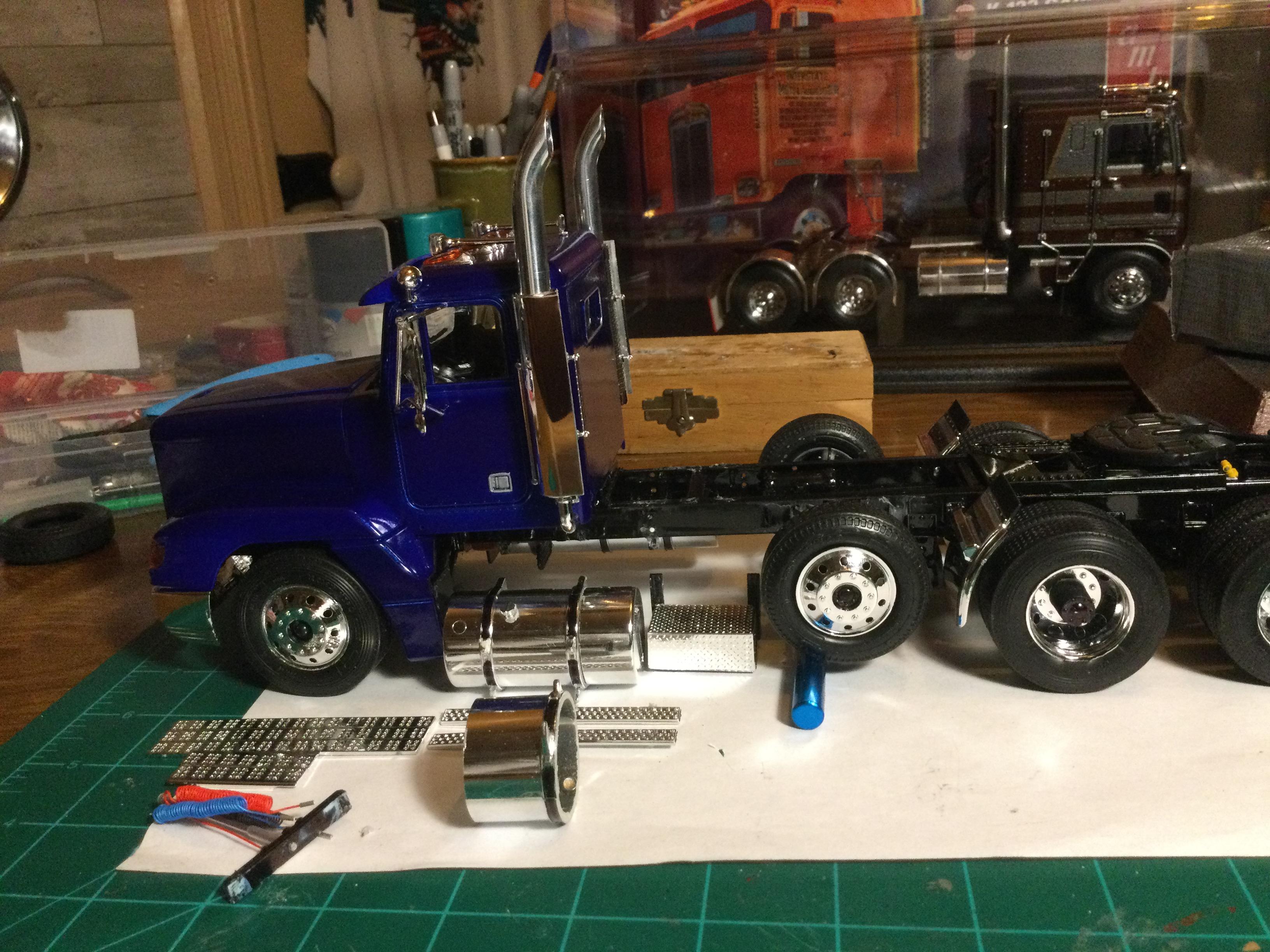

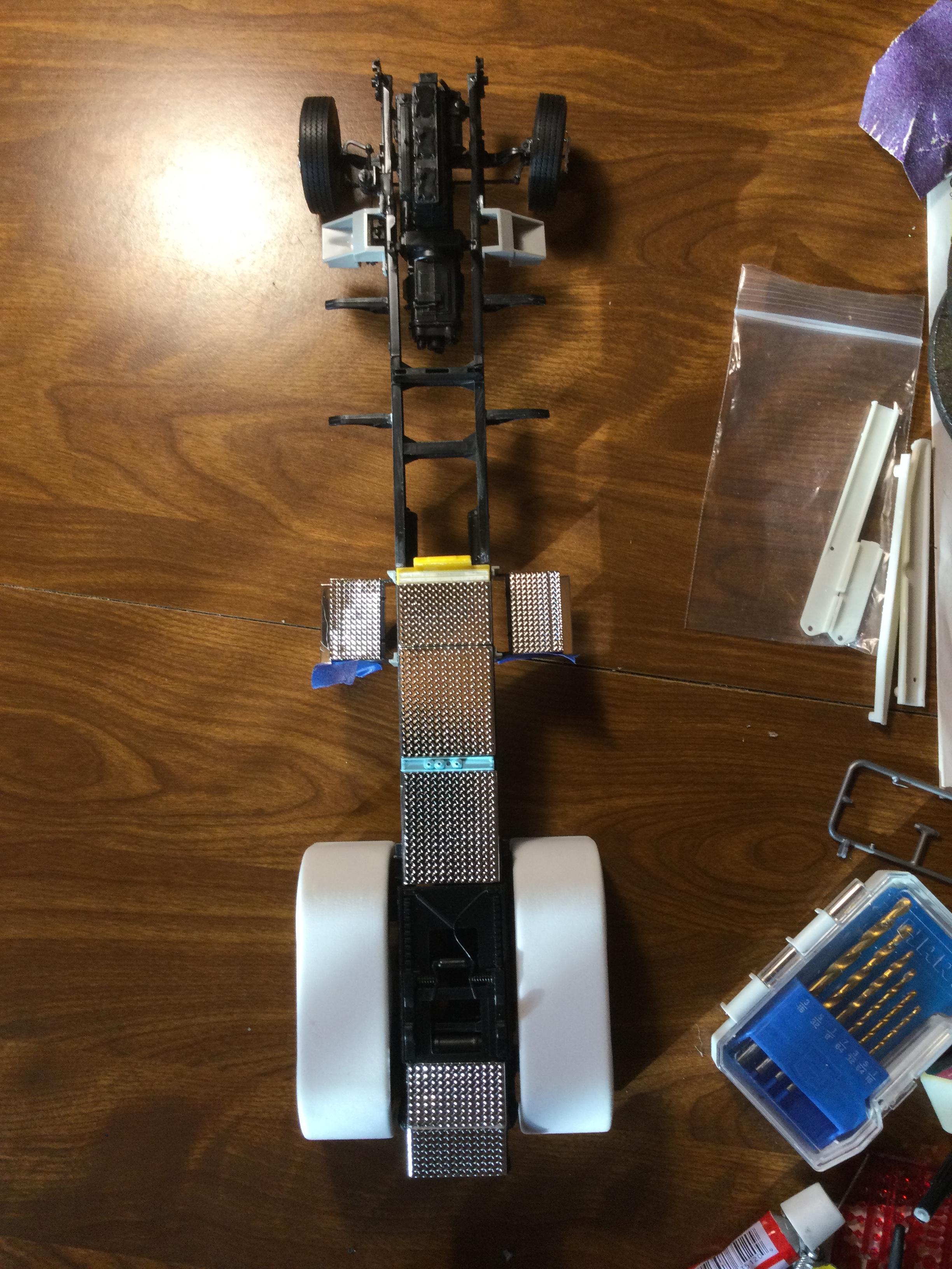

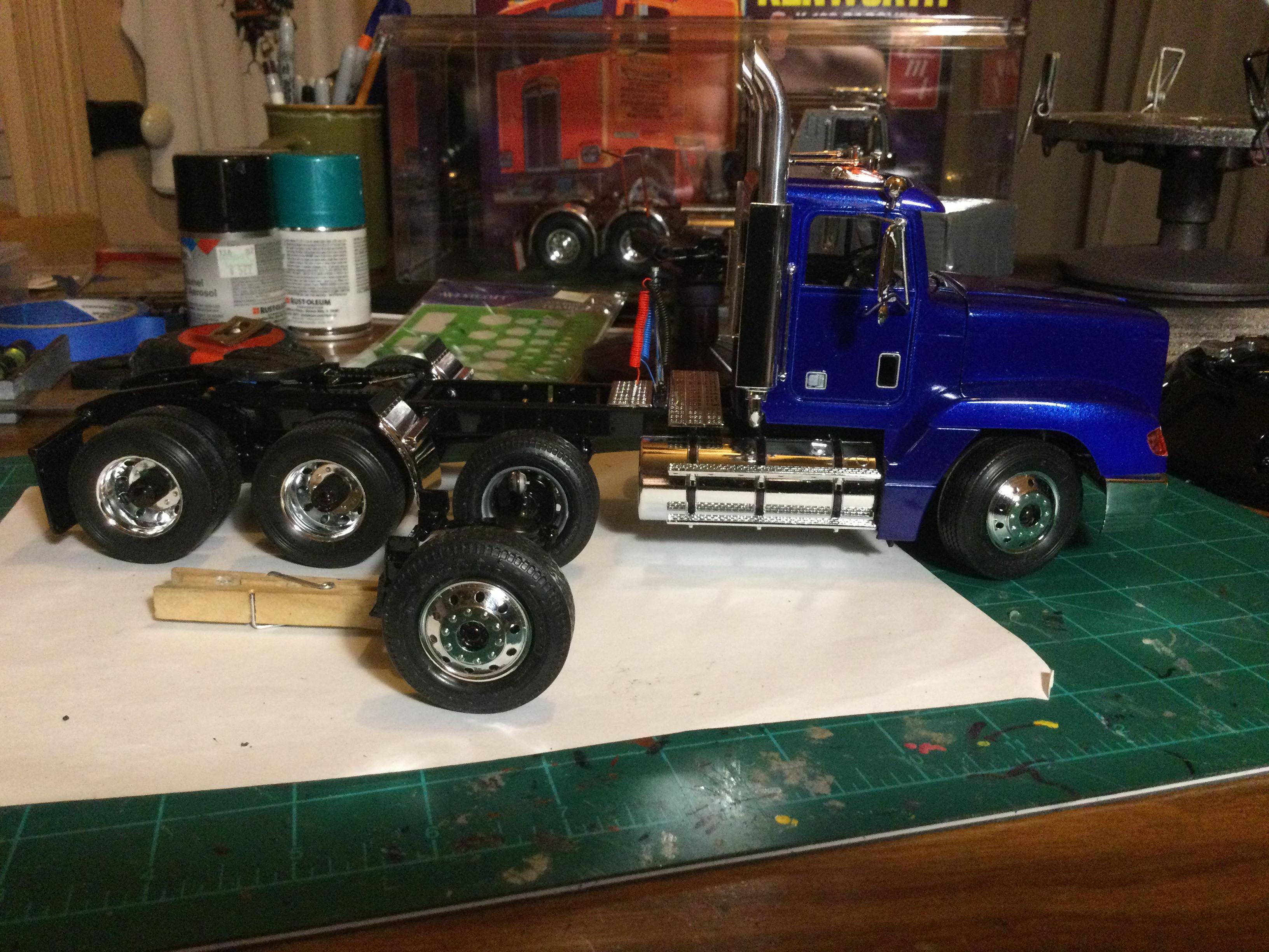

  1. waiting on the super singles pack so I can put the wider rims & tires on the front

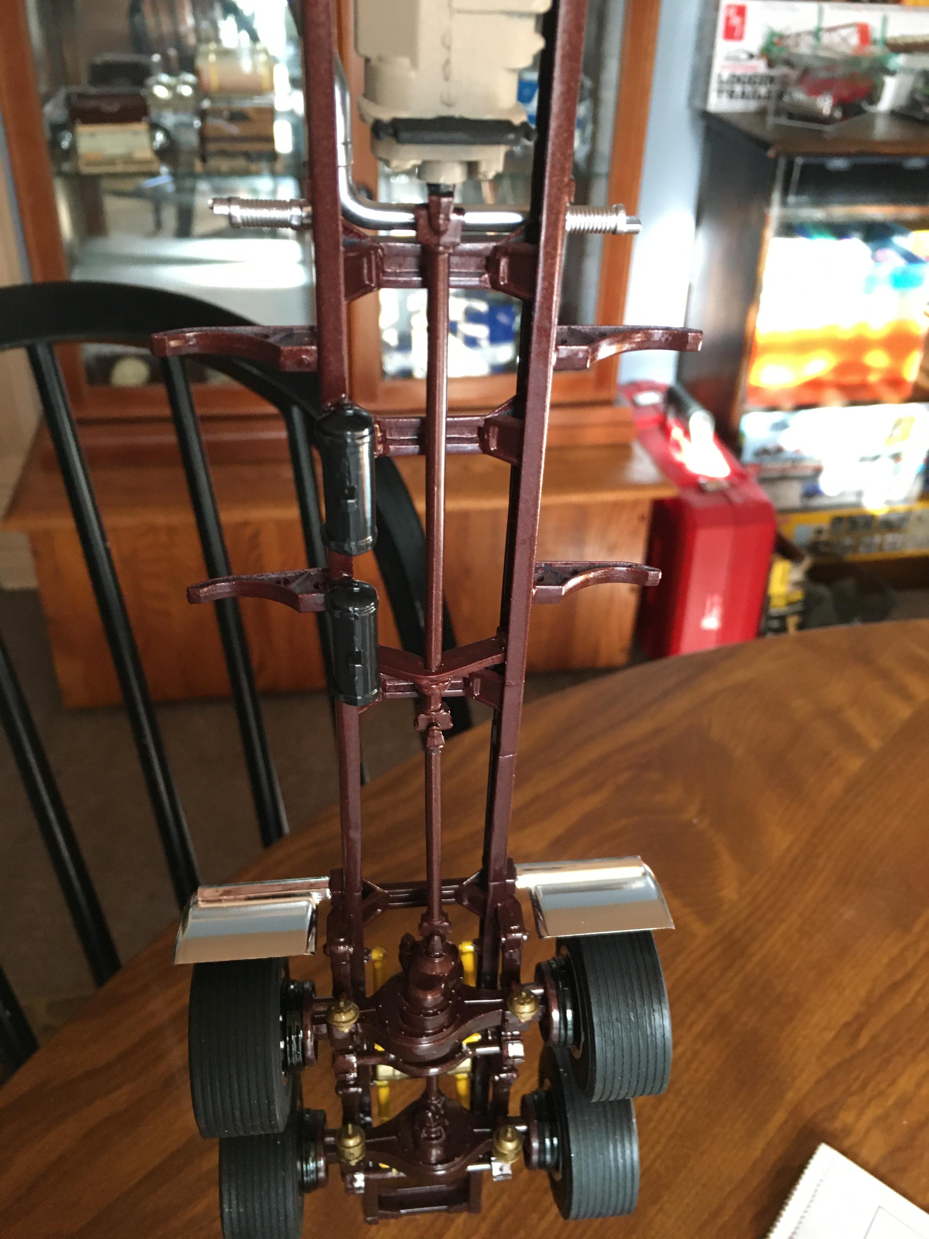

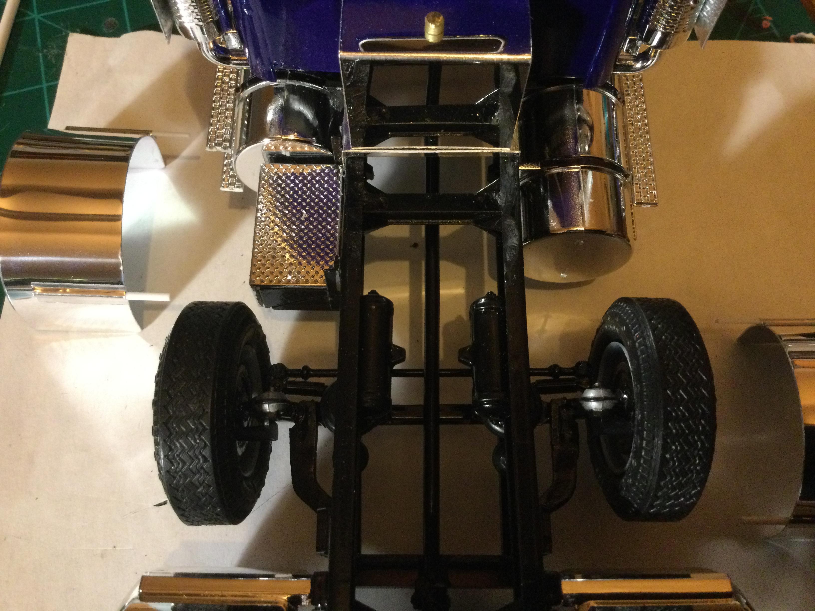

  2. Now that the lift axle is mounted properly and the new battery box scavenged from a Pete Cabover is in place the question is am I missing anything or what have I missed

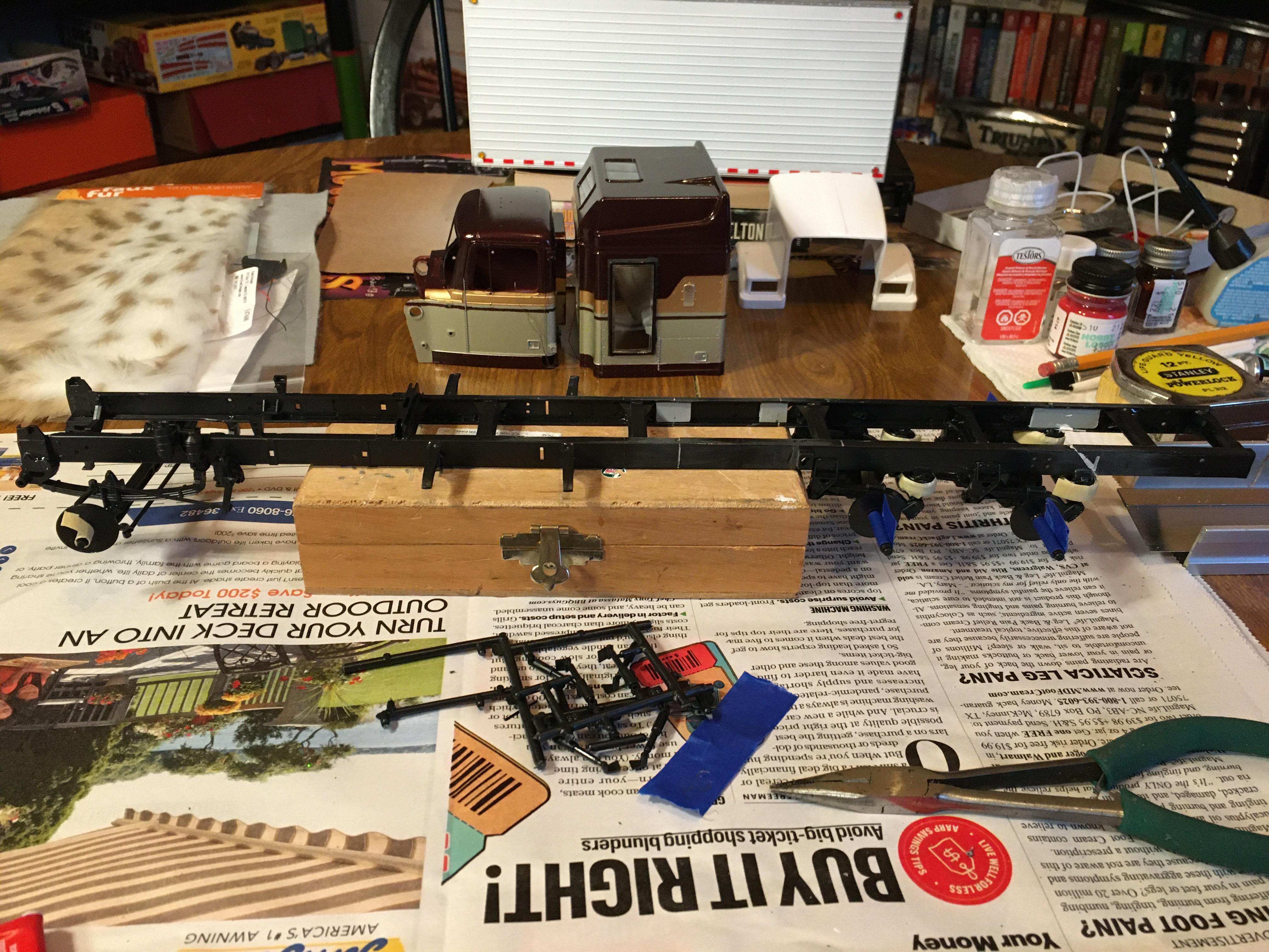

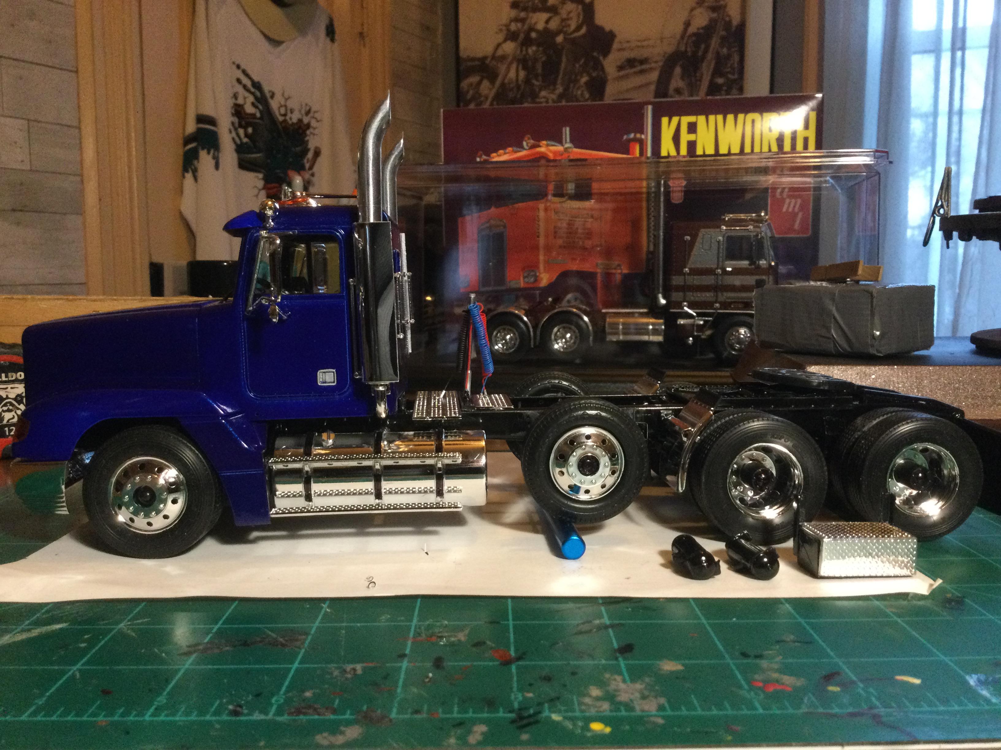

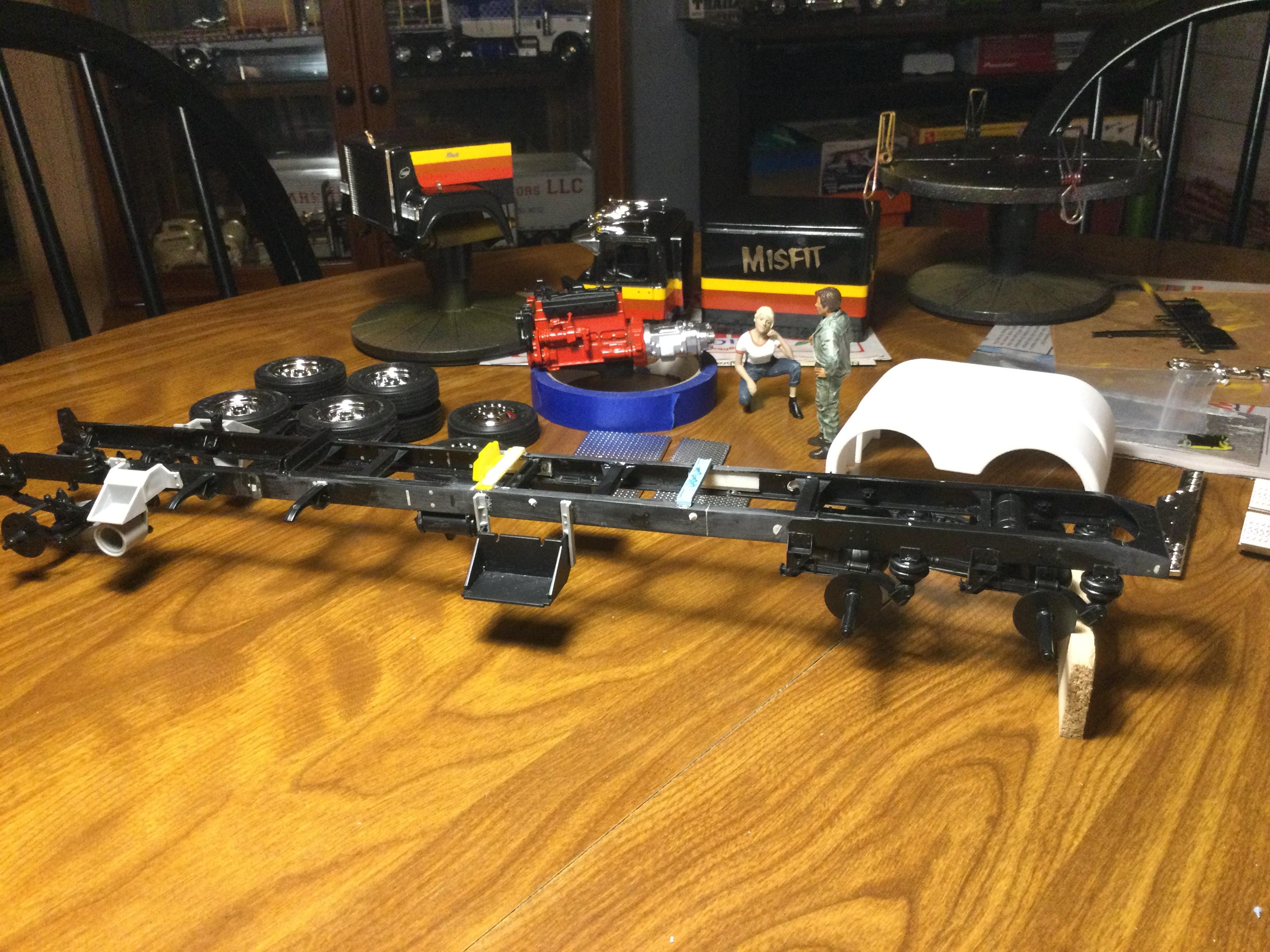

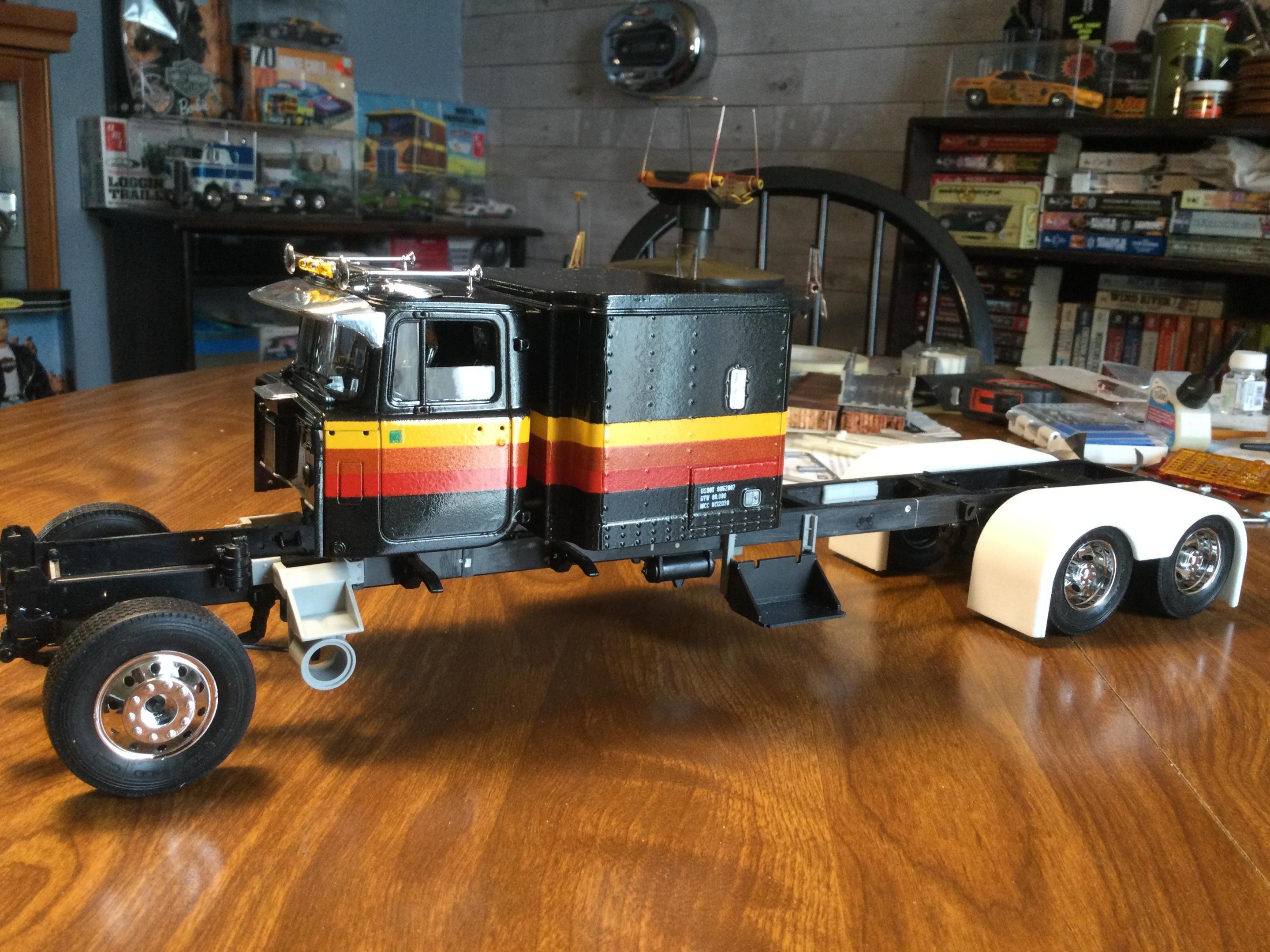

  4. After disassembling cleaning up the frame rails relocating the bottom arms of the lift and going back to paint I think that I will be almost ready to reassemble and get a little closer to finish this build

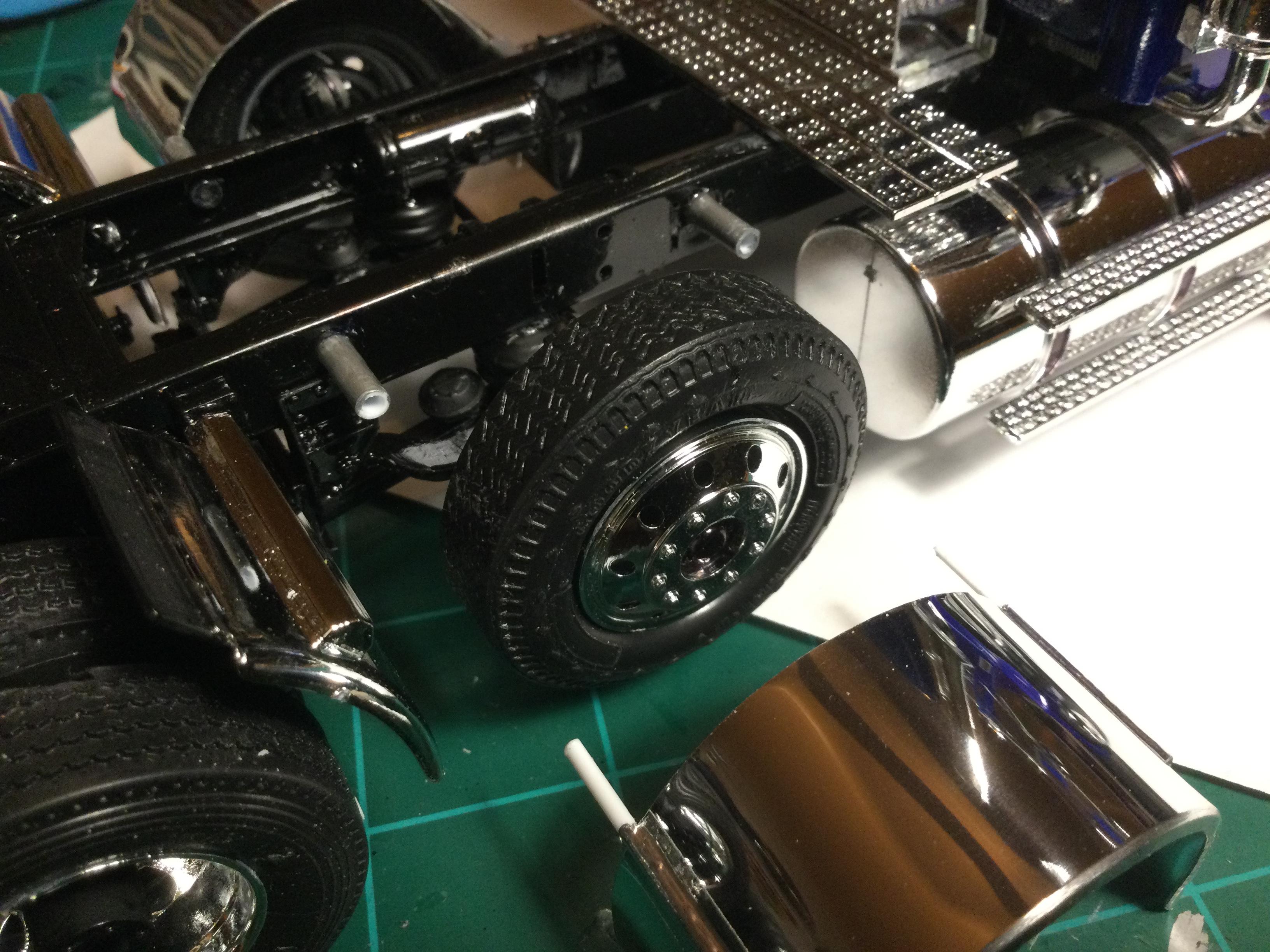

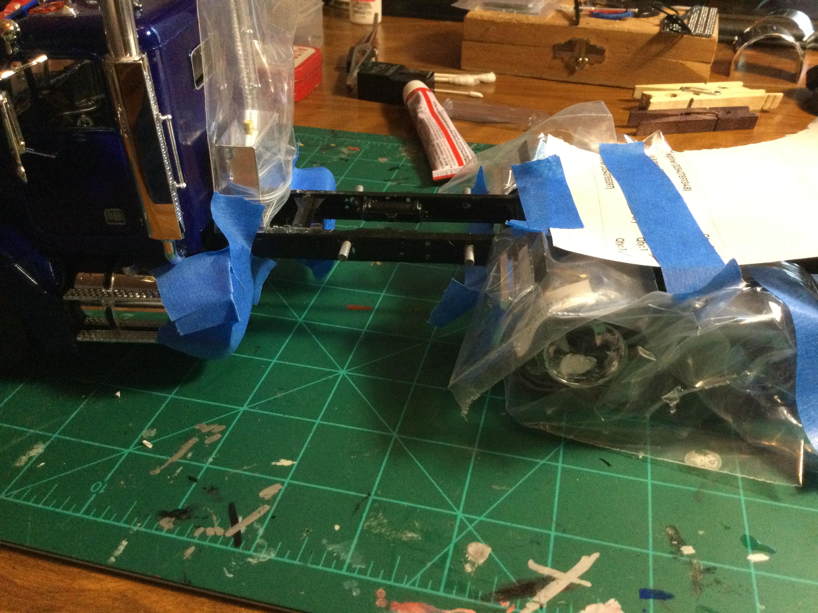

  5. Time to take a breather should have done a little better research I installed the lift backwards had to deconstruct time to take a breath

  7. Revell always a problem child warped frame rails cab and bunk when first mounted looked like they were traveling up hill and maybe it was something I did but the hinge mount’s for the hood didn’t match up and this paint job just gave me fits (stripped it twice)

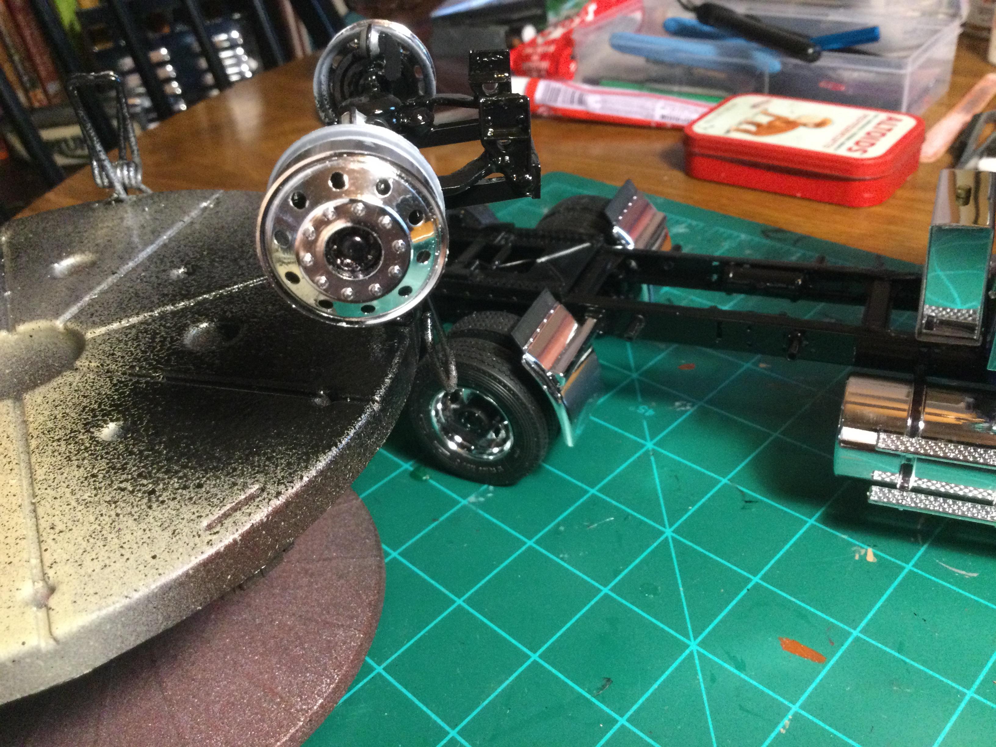

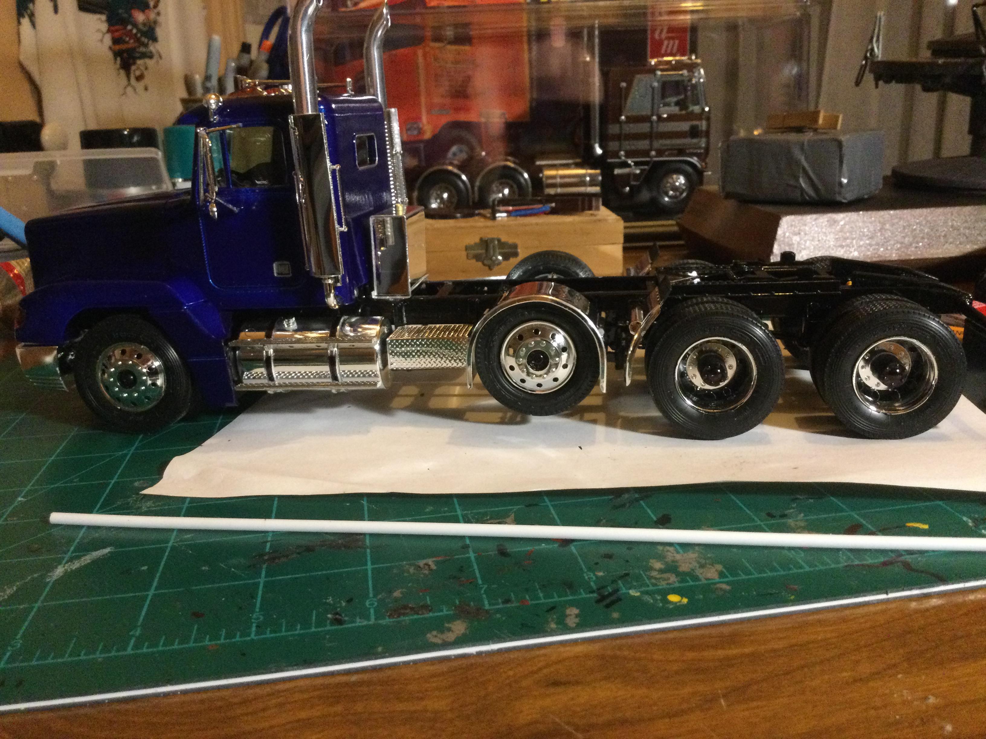

  8. Finally mounted the lift and finished prepping the fenders
  9. Carrier bearing and drive shaft ?

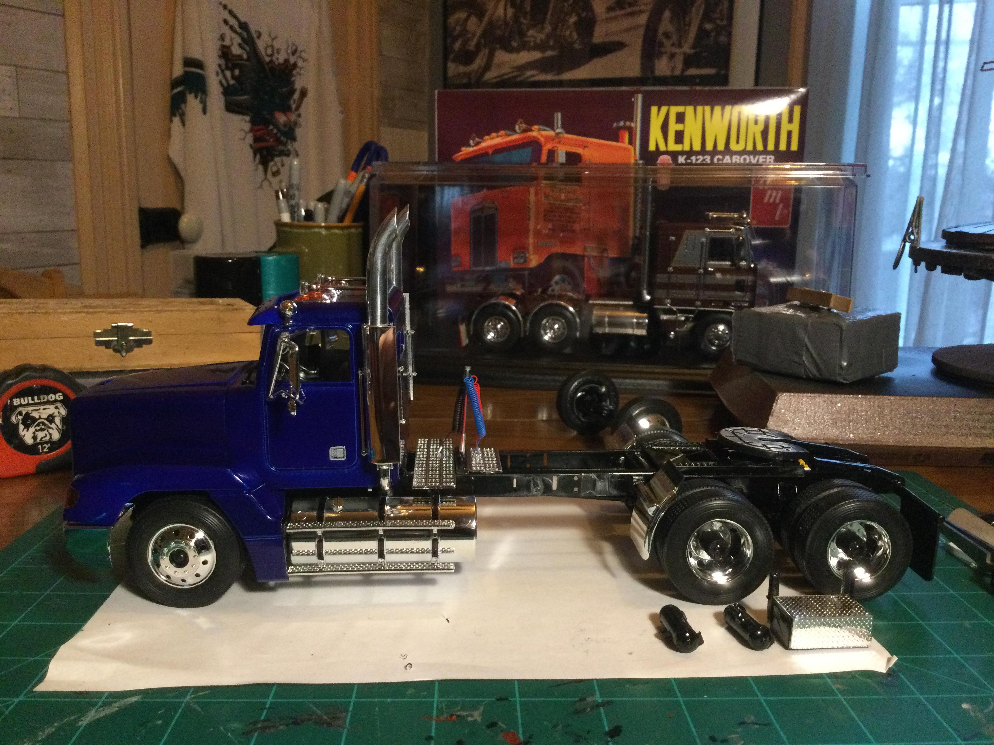

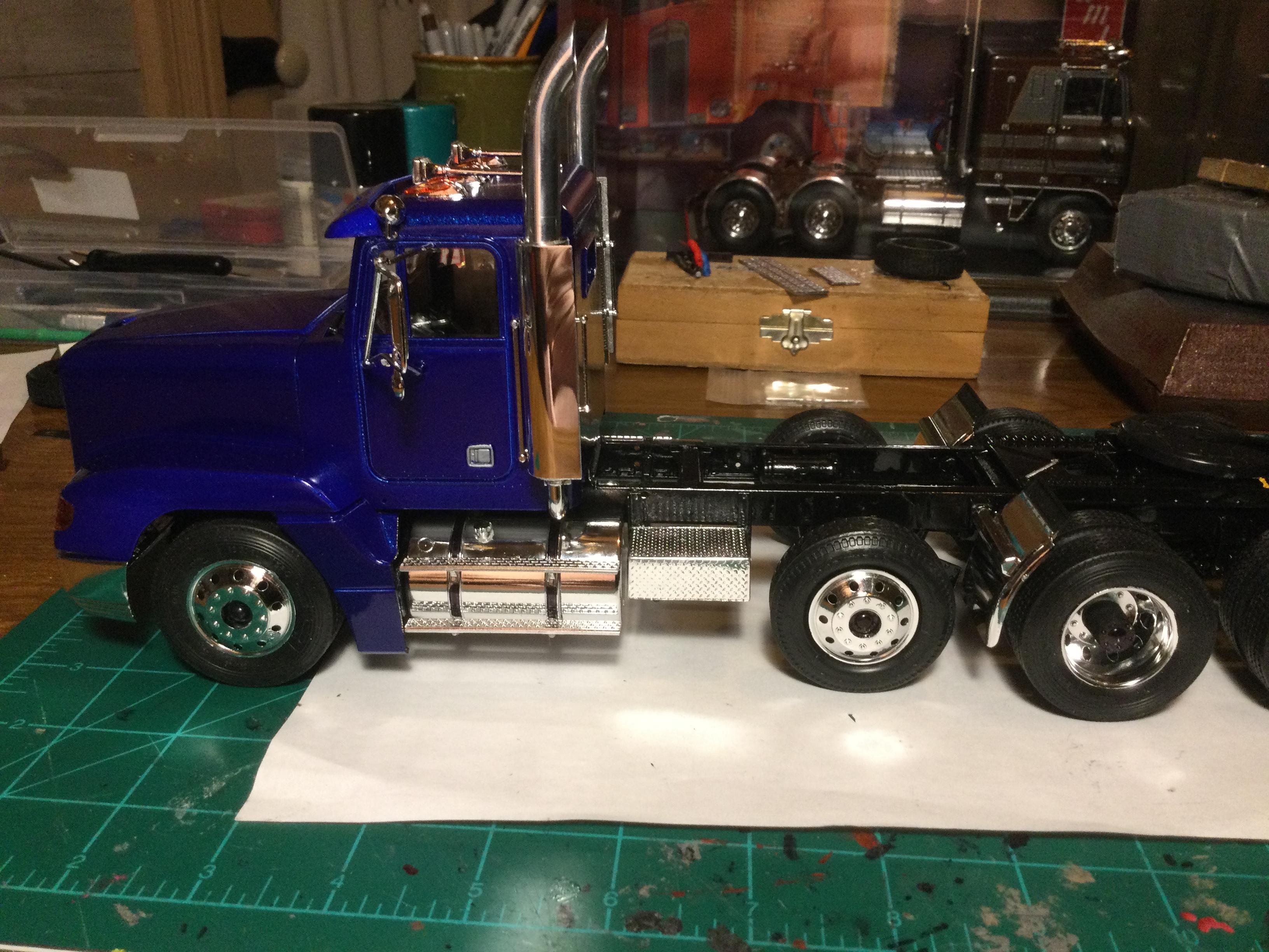

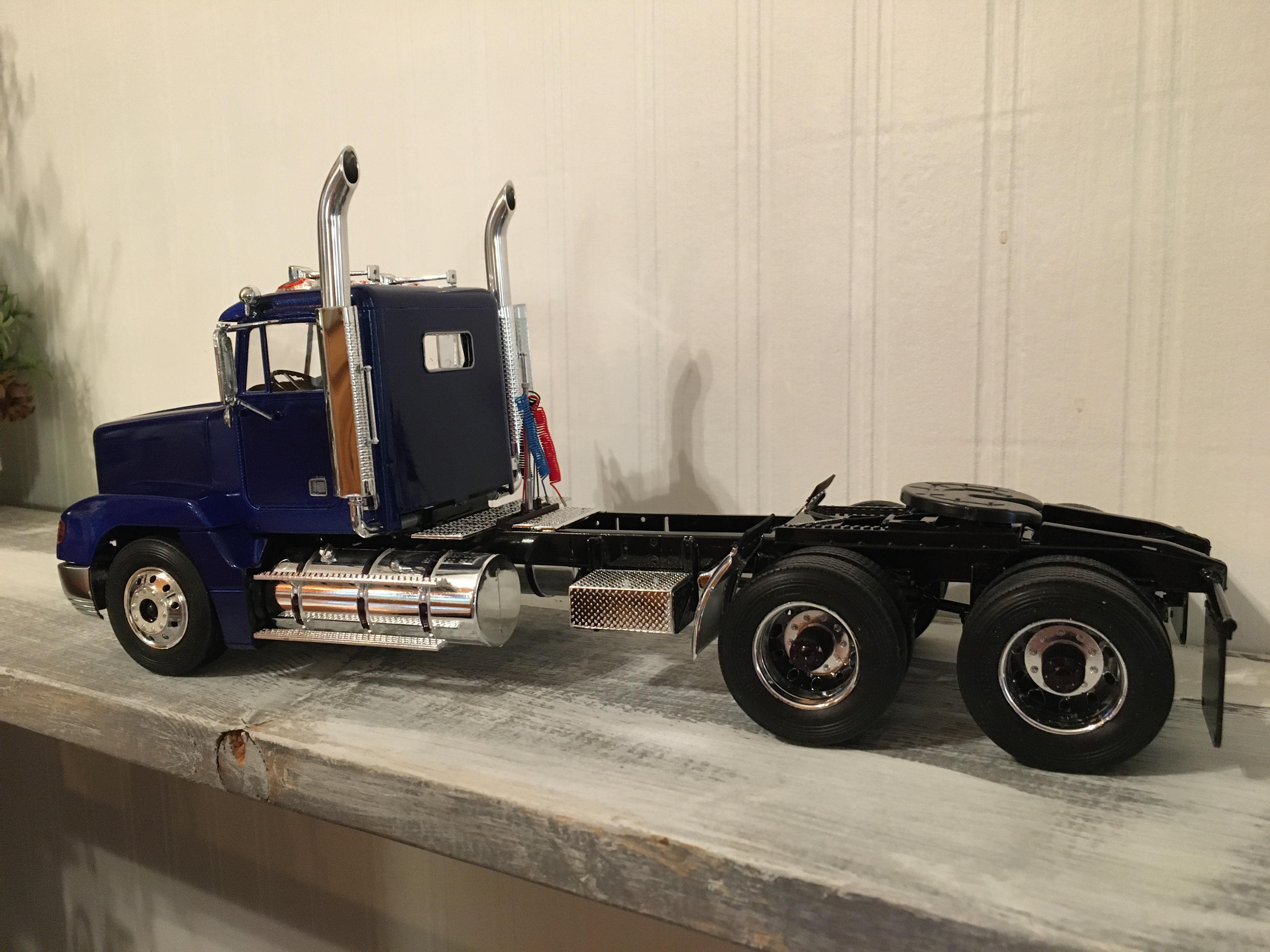

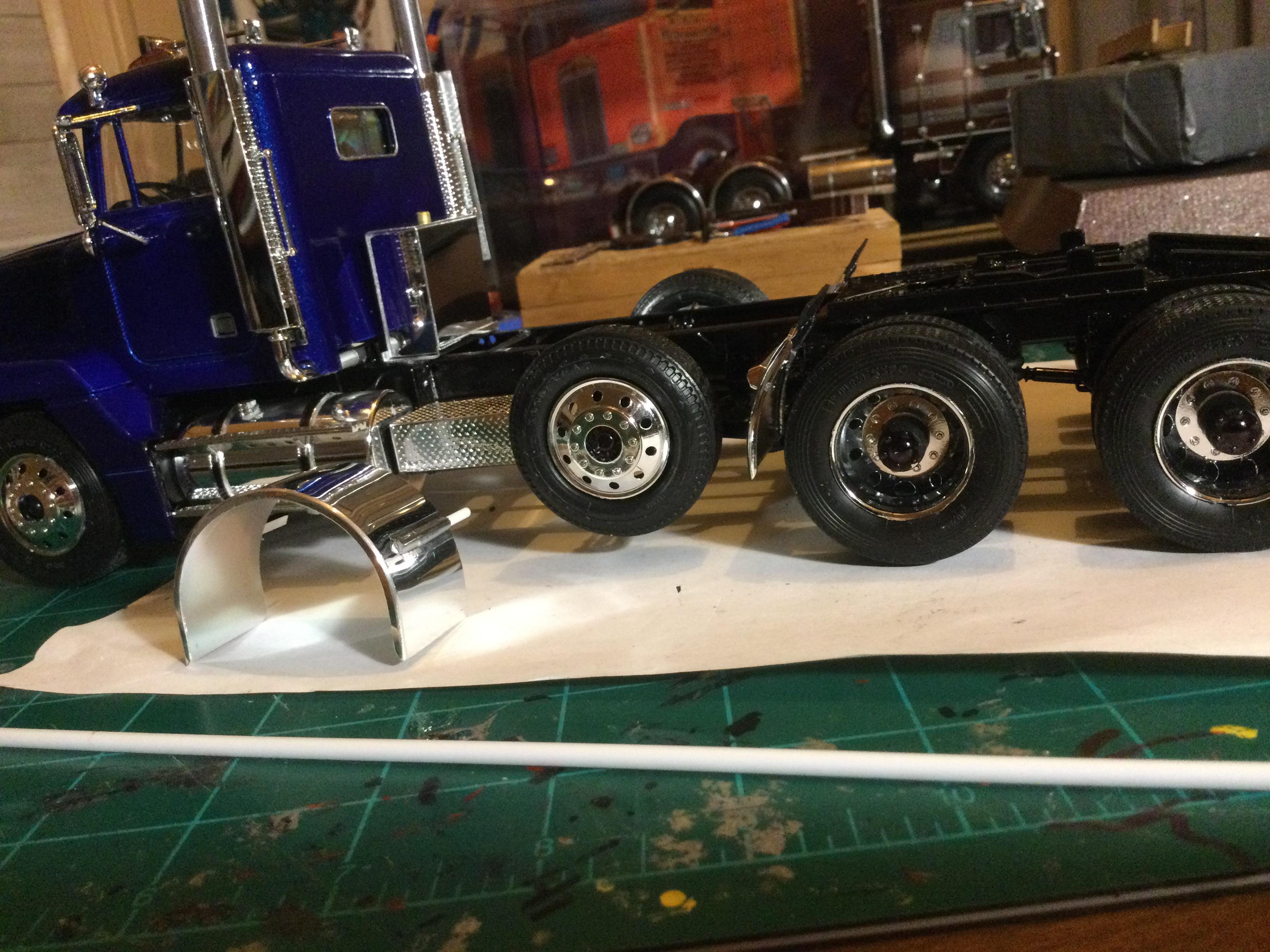

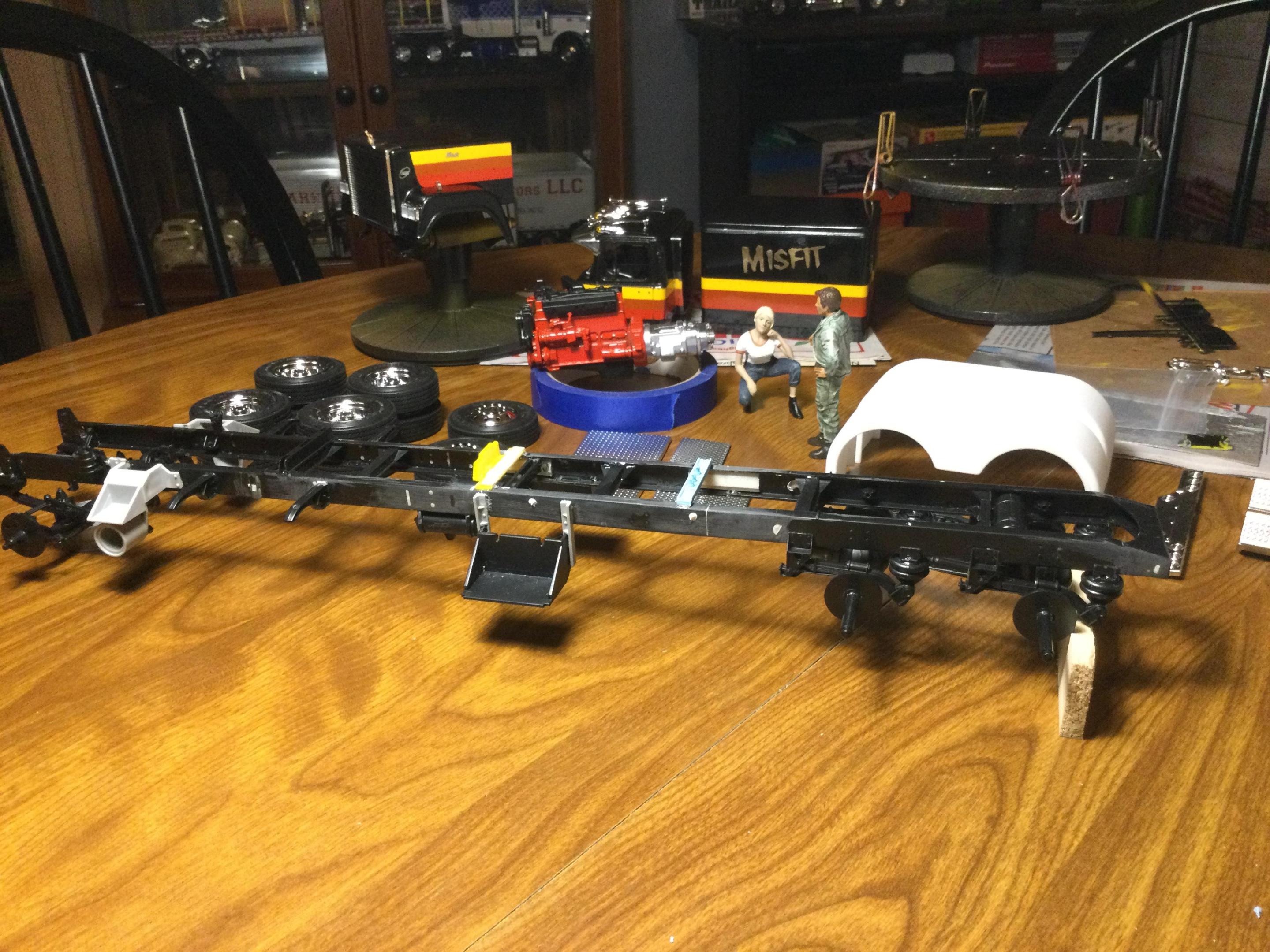

  11. Relocated air tanks inside of frame, sectioned the fuel tank to make room for the battery box and removed the deck plate’s and pogo stick to make room for a hydraulic tank and lines

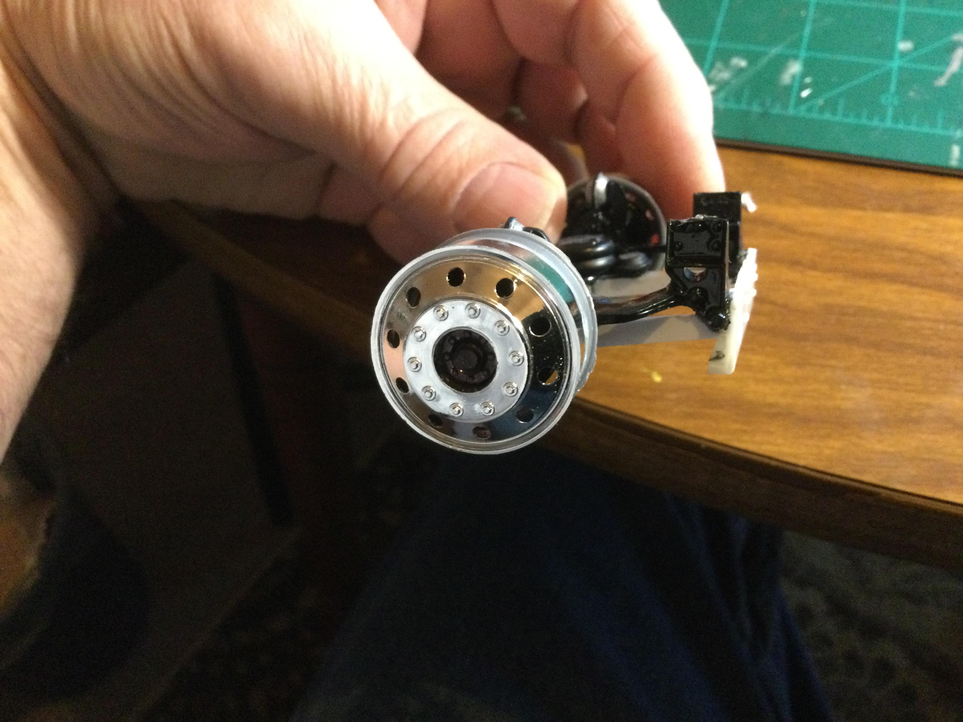

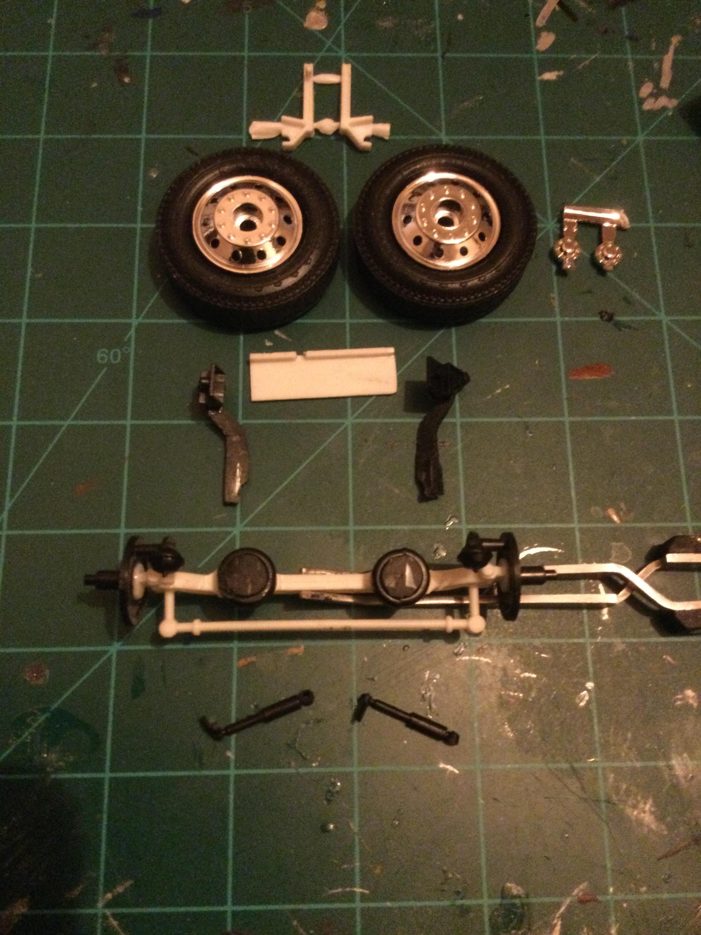

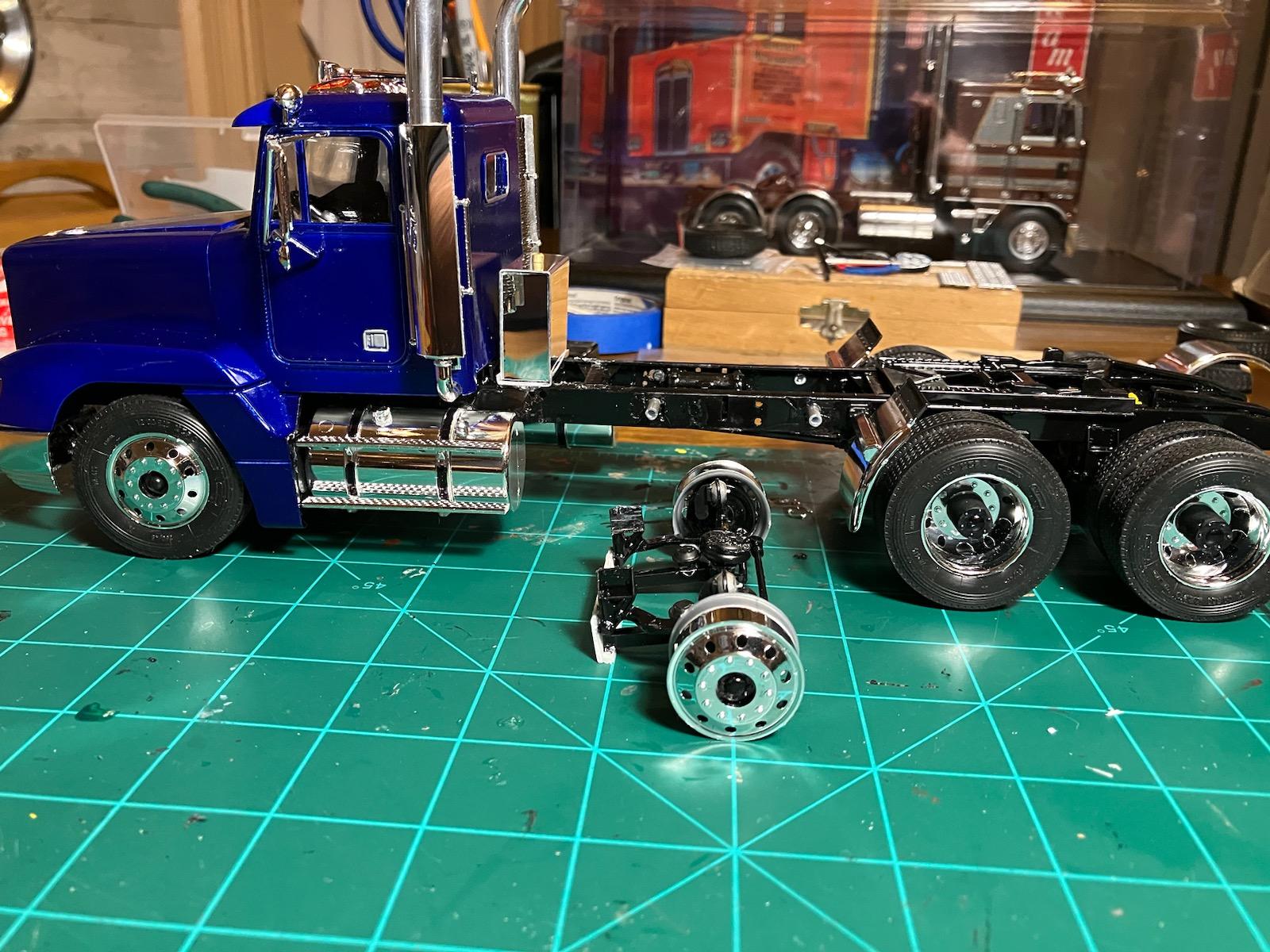

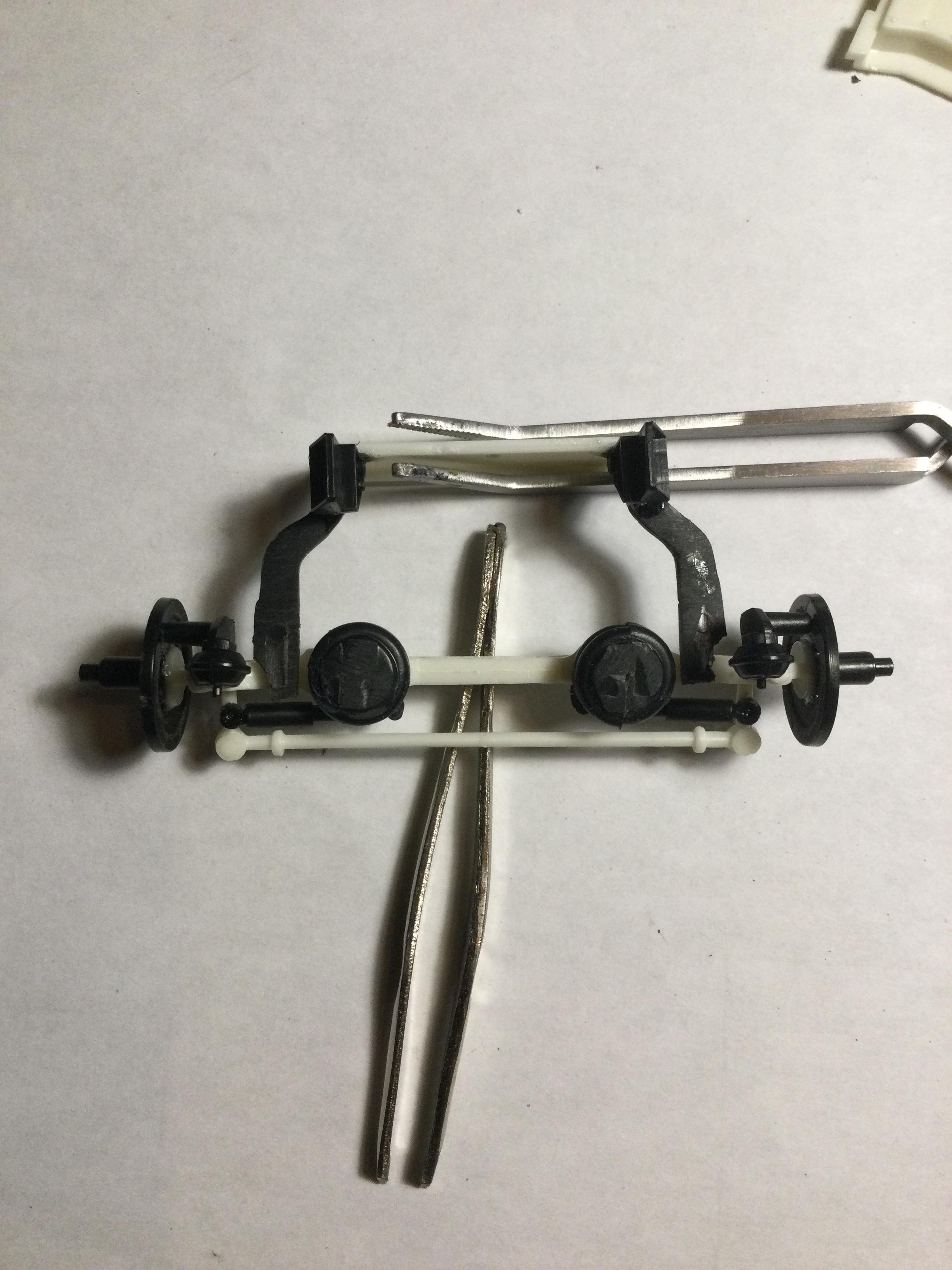

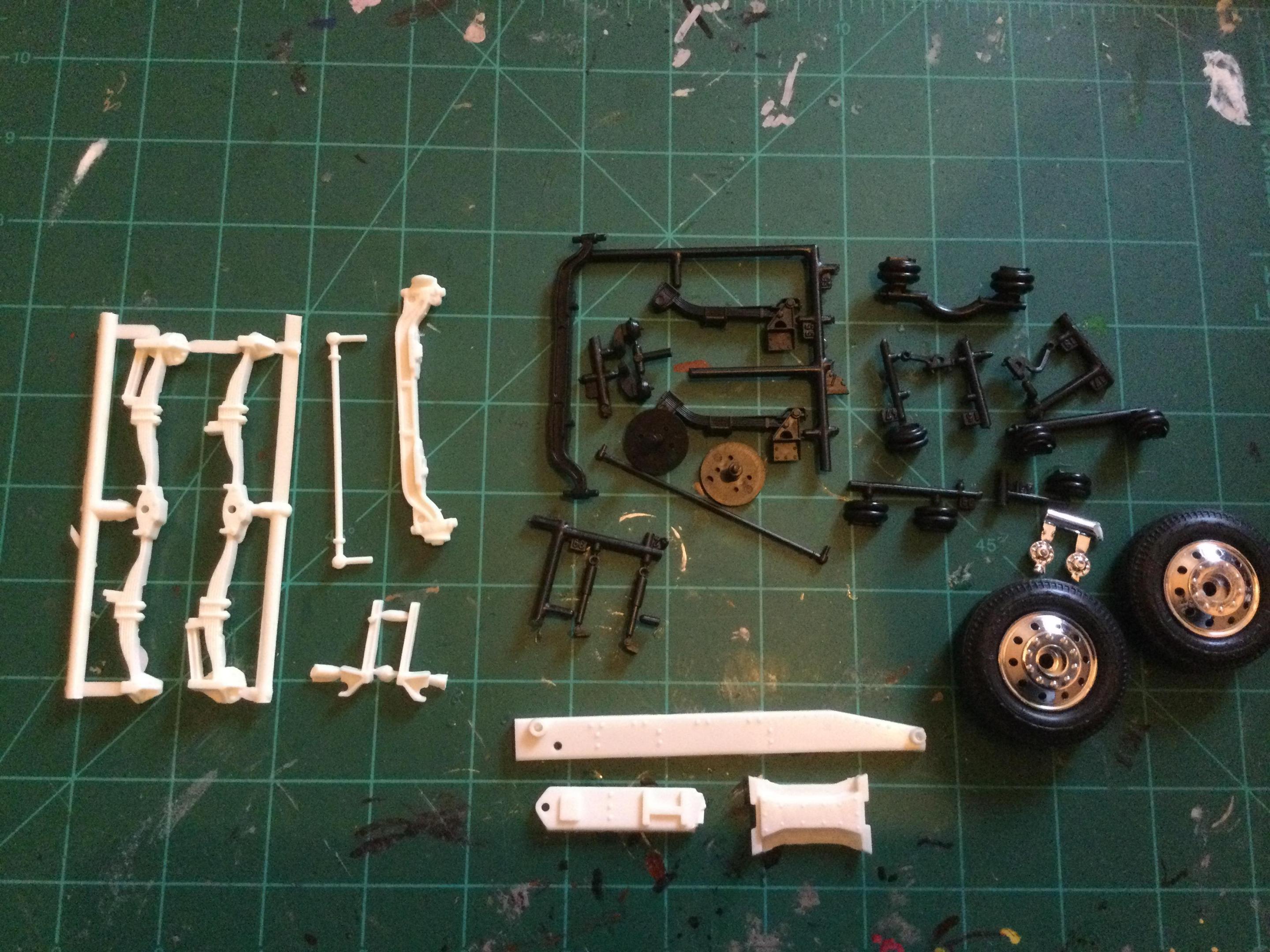

  12. Well I finished the lift steer axle now to see if I can modify and install without wrecking this FLD build

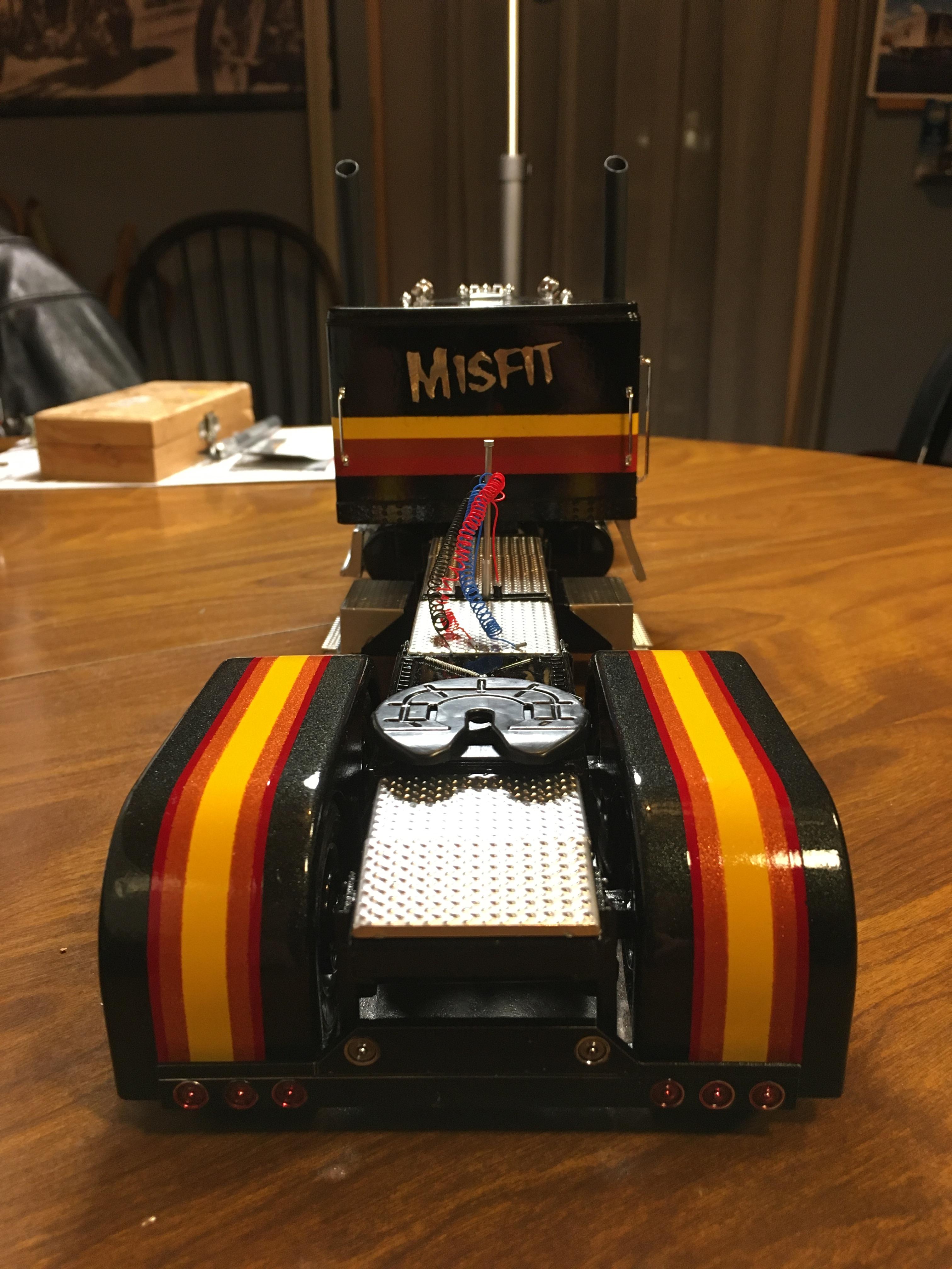

  13. I am not much of a decal guy but if you are keeping it simple I am all about masking and painting my own stripes lacquer paints seem to work better for me

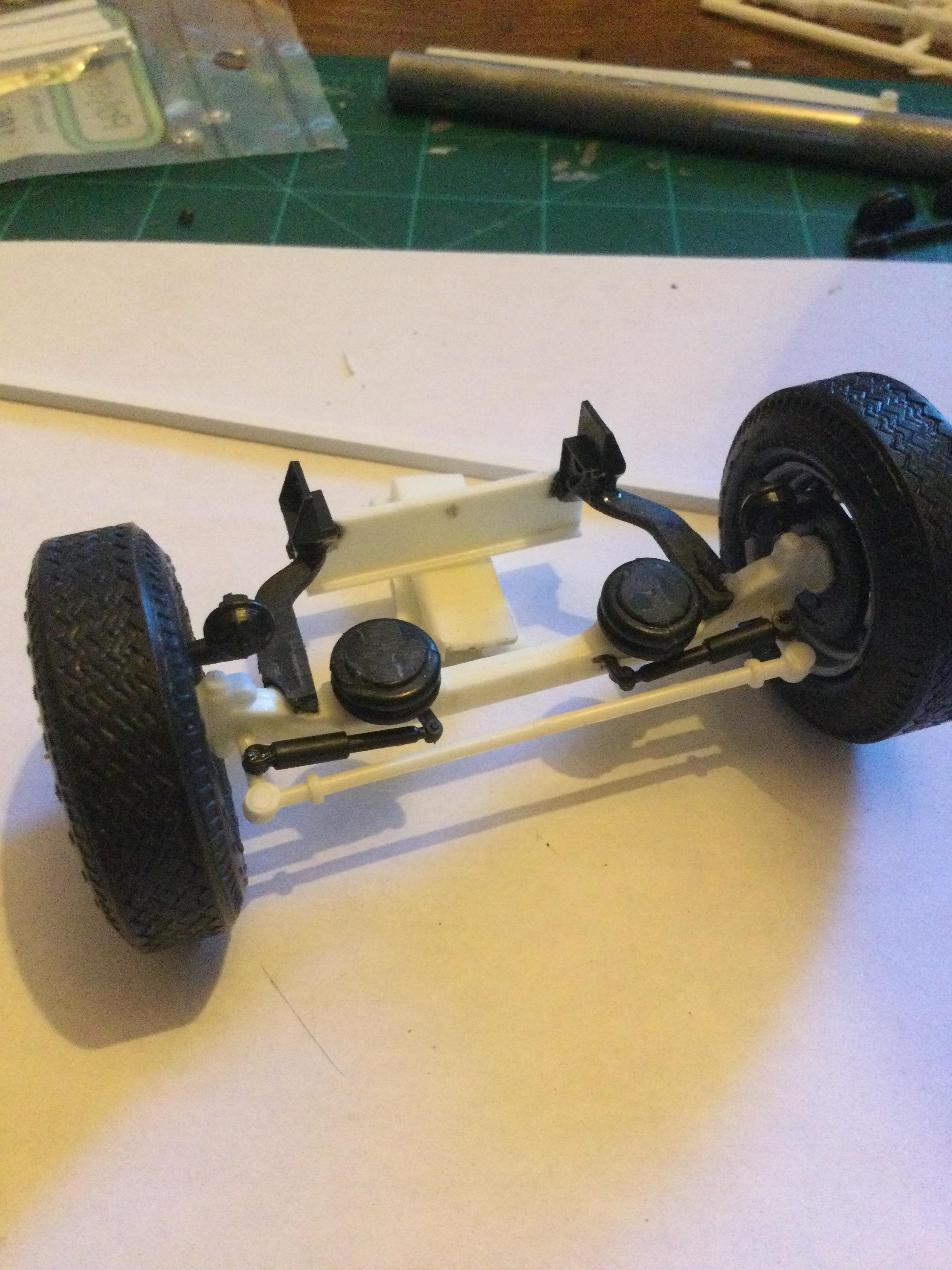

  14. When I saw the first picture I thought it was a picture of something you were going to build all I can say is that is one freaking awesome build

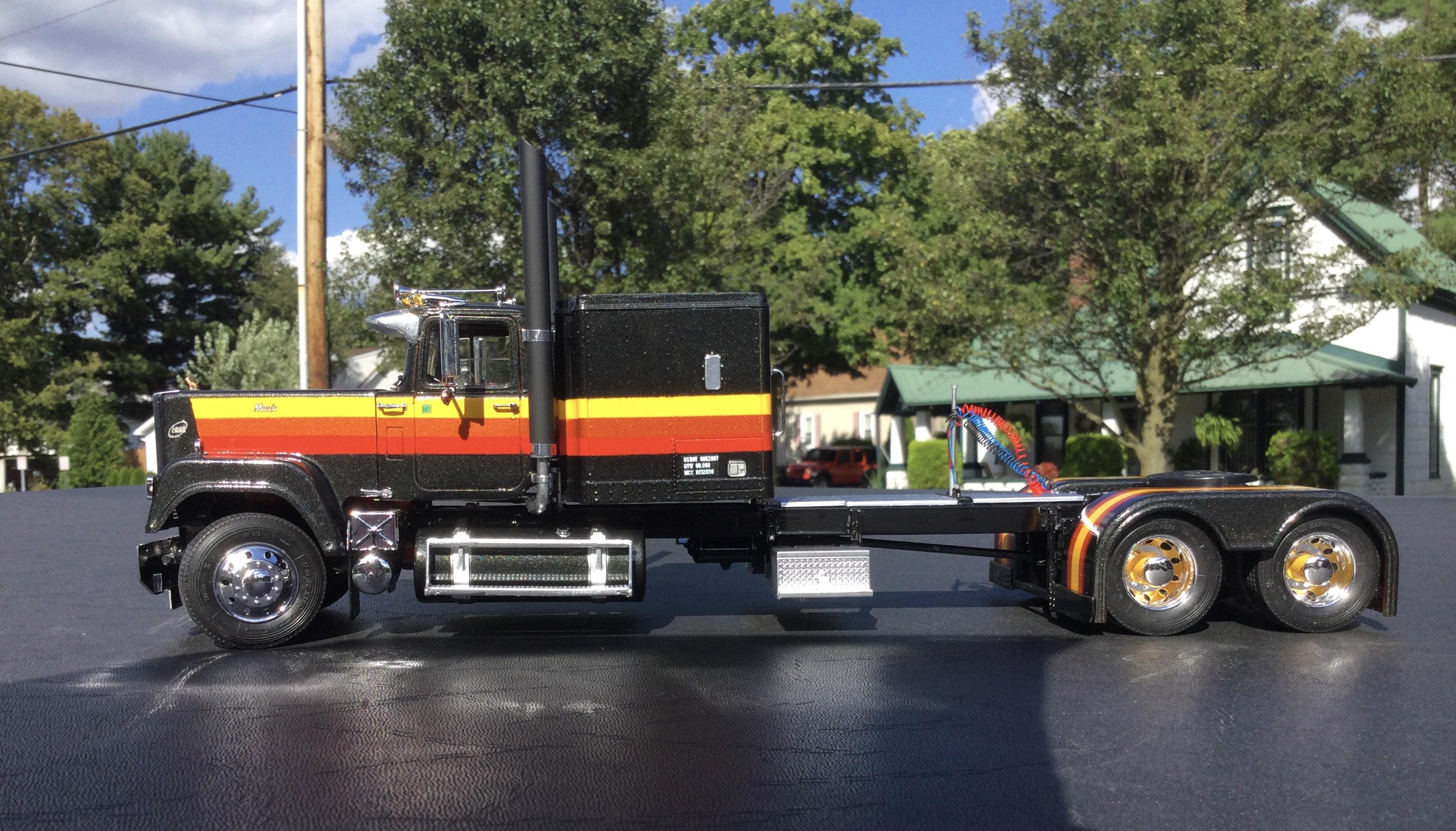

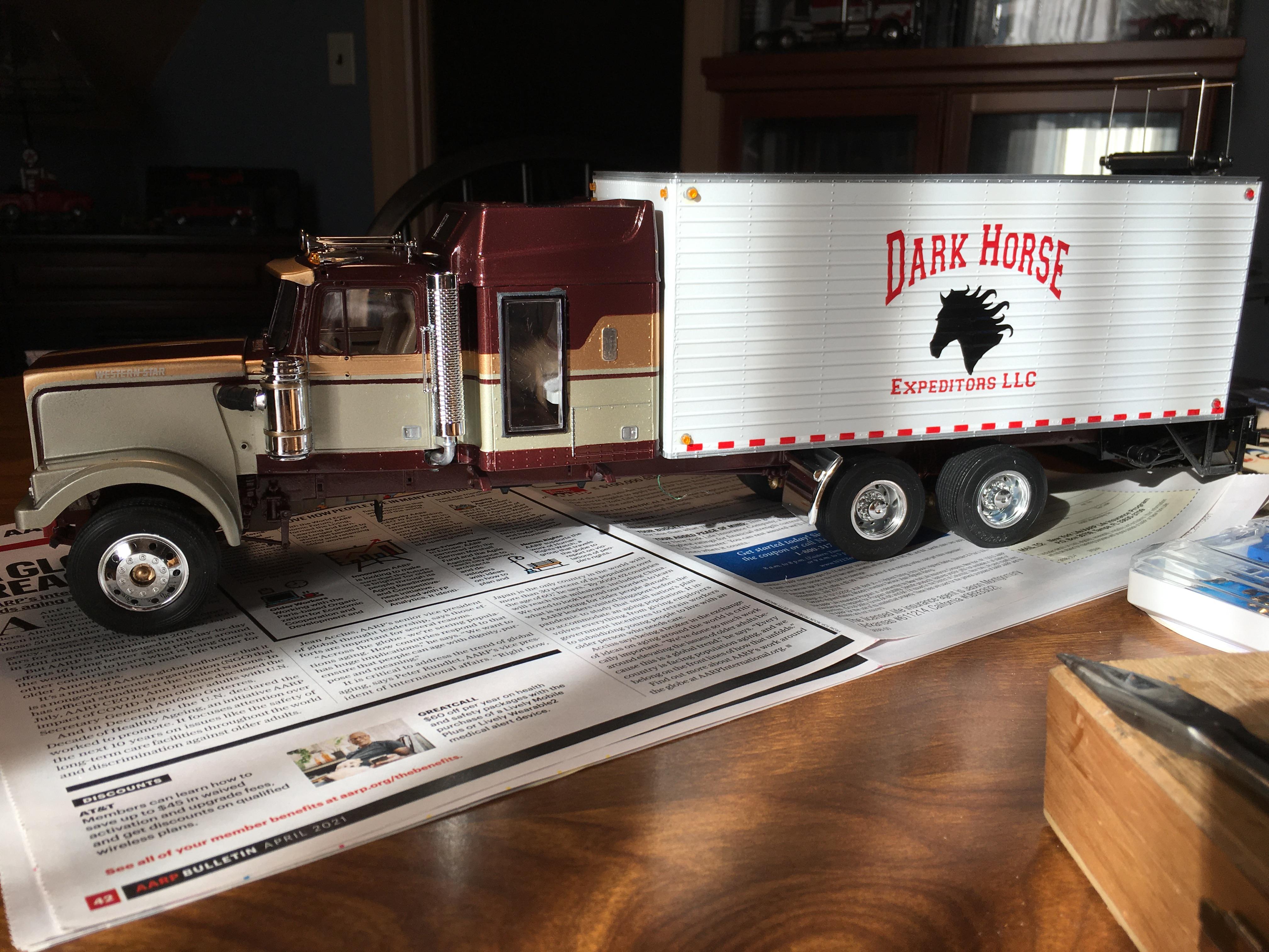

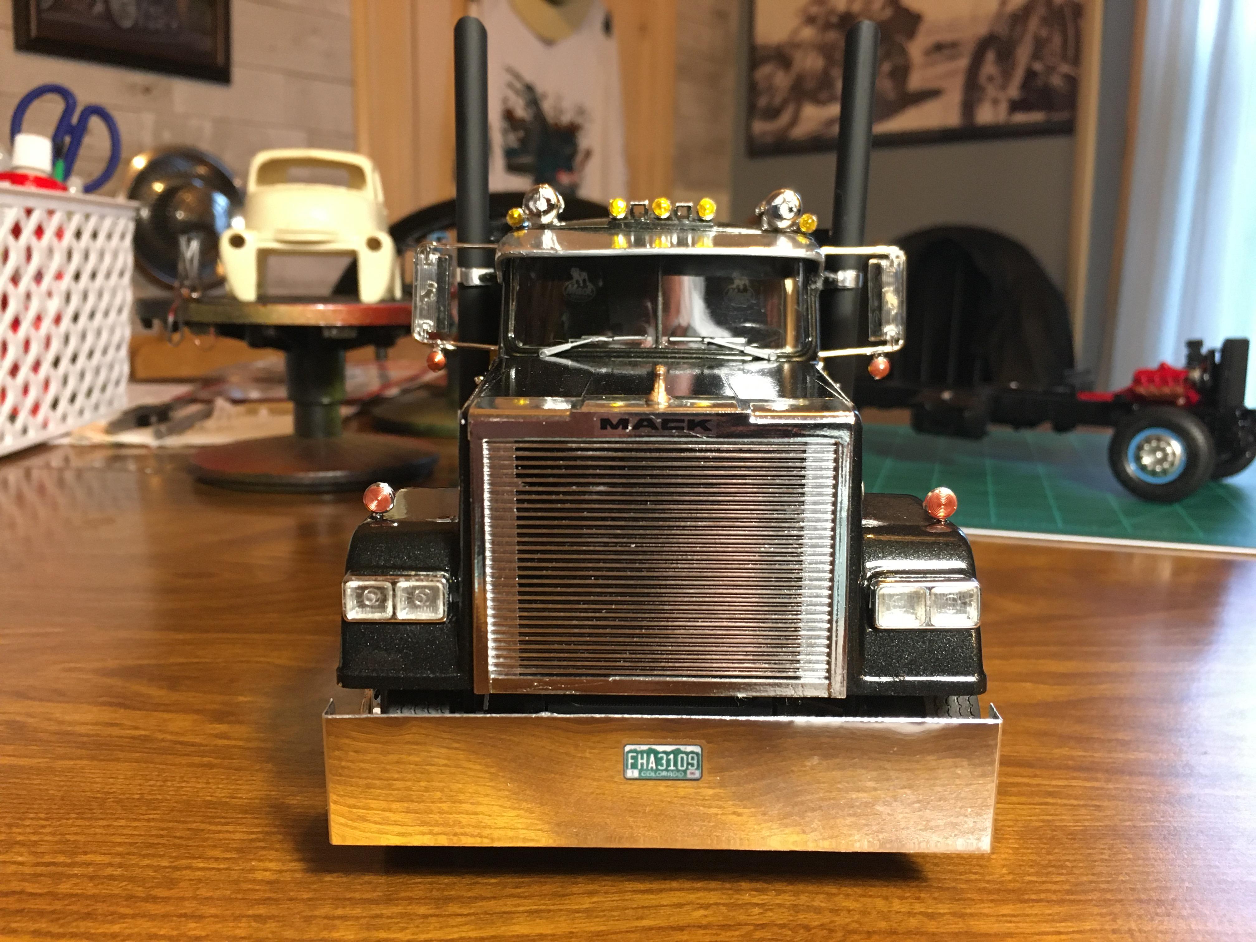

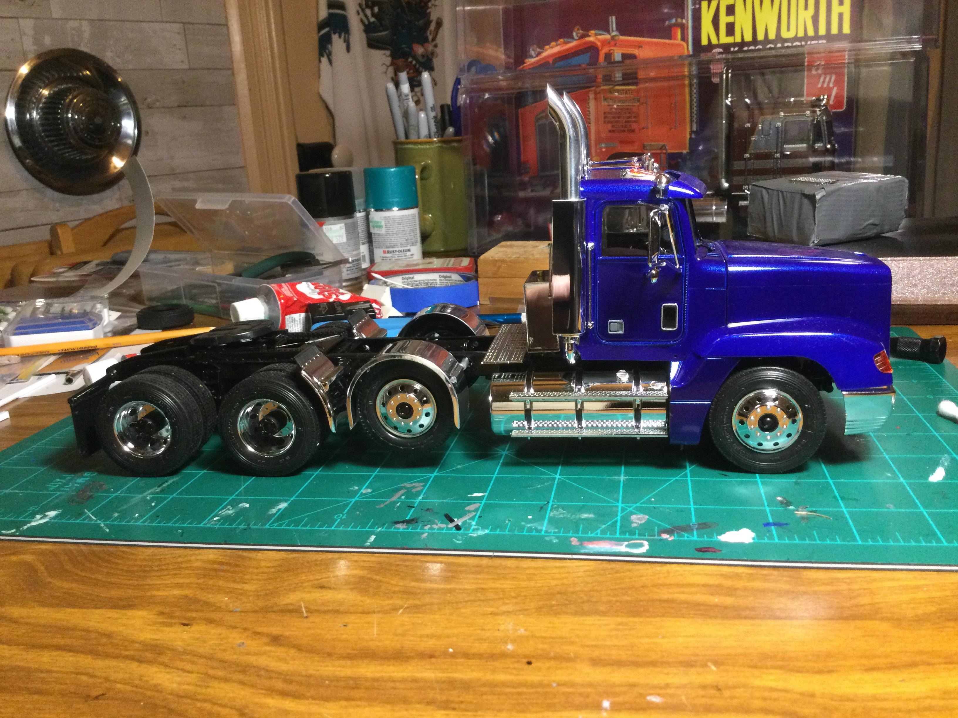

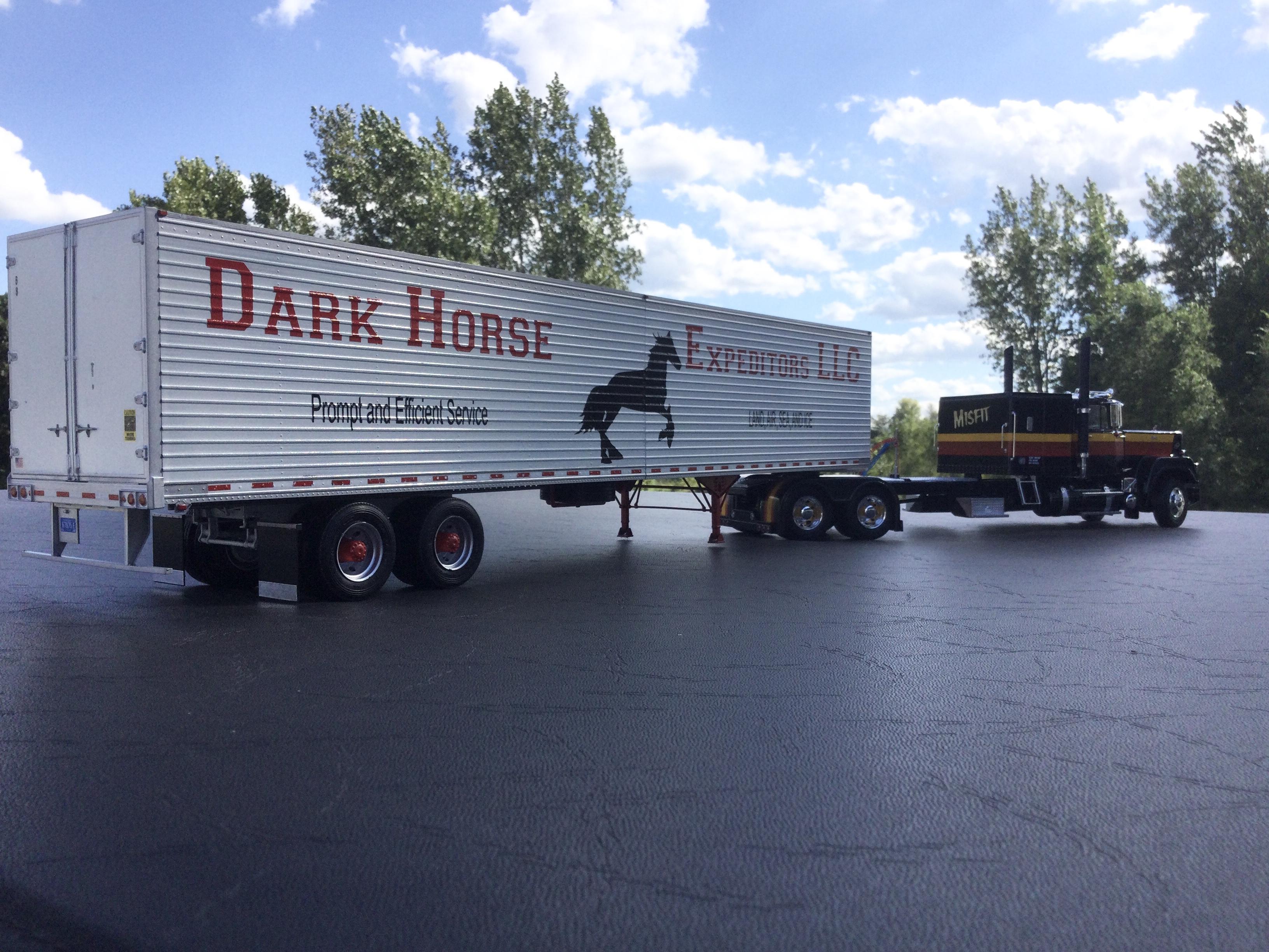

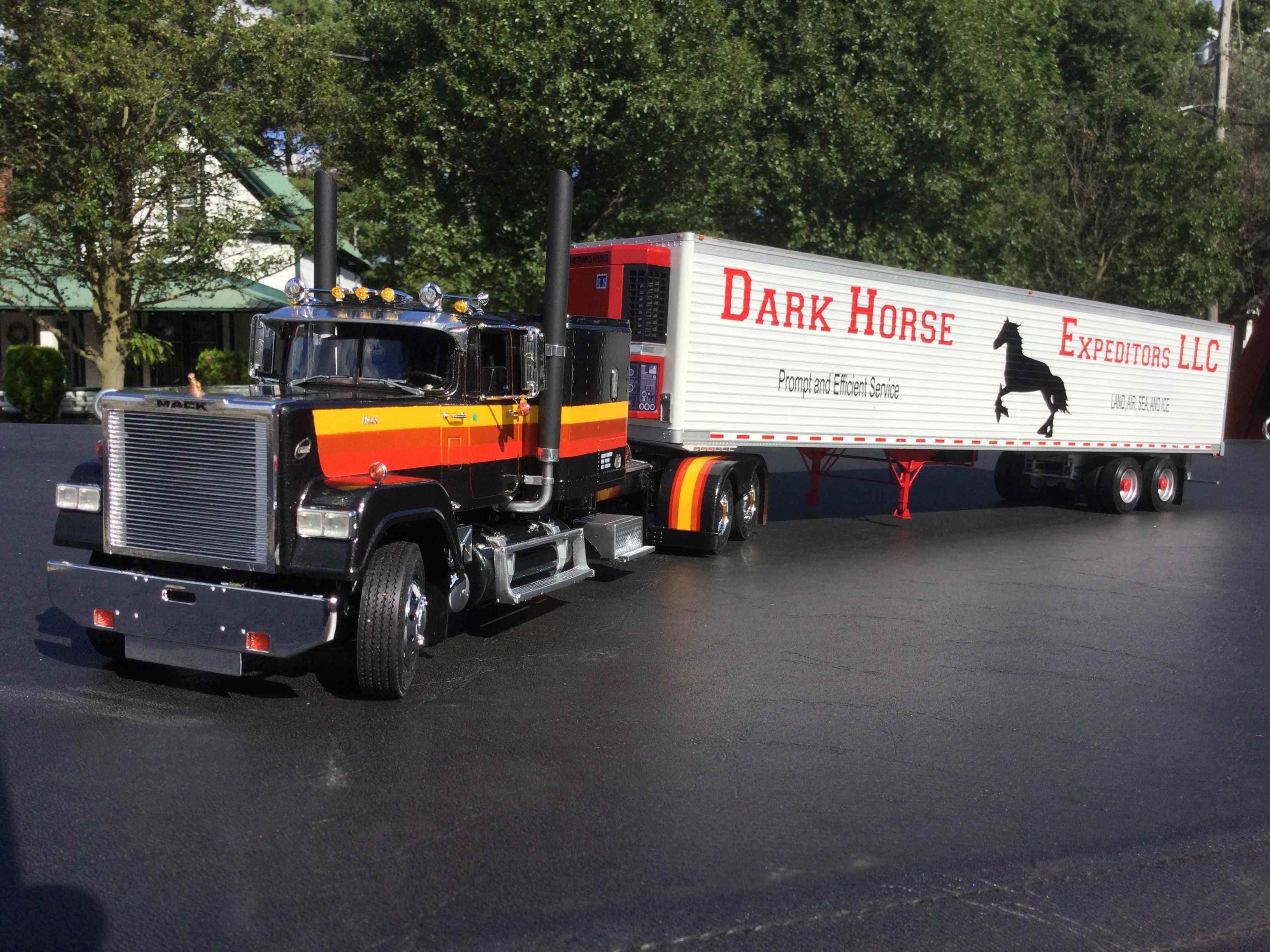

  16. Well as you can see it is not yellow this was my second frame stretch the FLC was my third (3”, 6 foot in scale) I done a little rework to the bunk I have a thing for flat tops I do not know if Mack ever done a flat top double sleeper I done a lot of looking and could not find one I also added storage boxes on each side also giving steps up to the back and a extended visor from auslowe and covered it in stainless duct tape,metal etched Superliner emblems and bull dogs on the mirrors and a bull dog hood ornament from an R model Mack because the Superliner kits no Mack emblems, 3D printed rear fenders

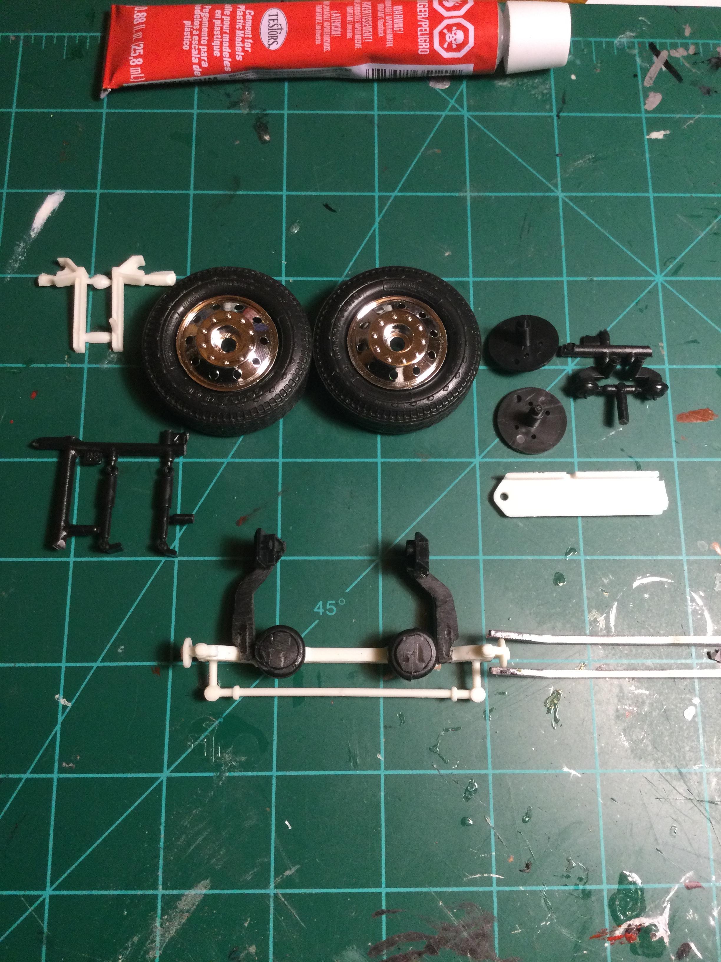

  17. Going to try my hand at building a steer lift axle for a 1/24 scale build still trying to decide what truck to do
