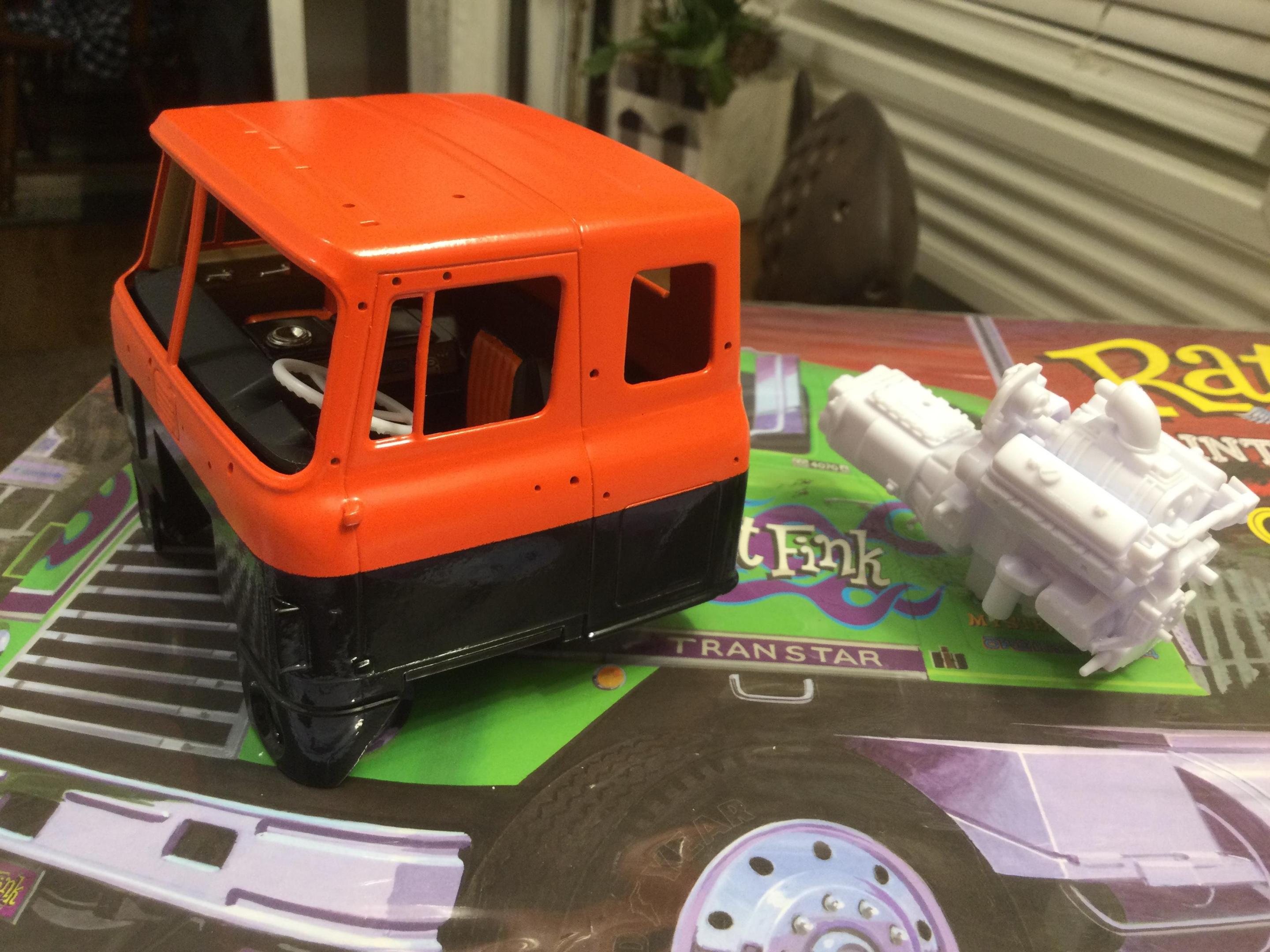

  3. I did not realize how many hurdles I was going to have to clear by shortening the cab and going to a single exhaust system

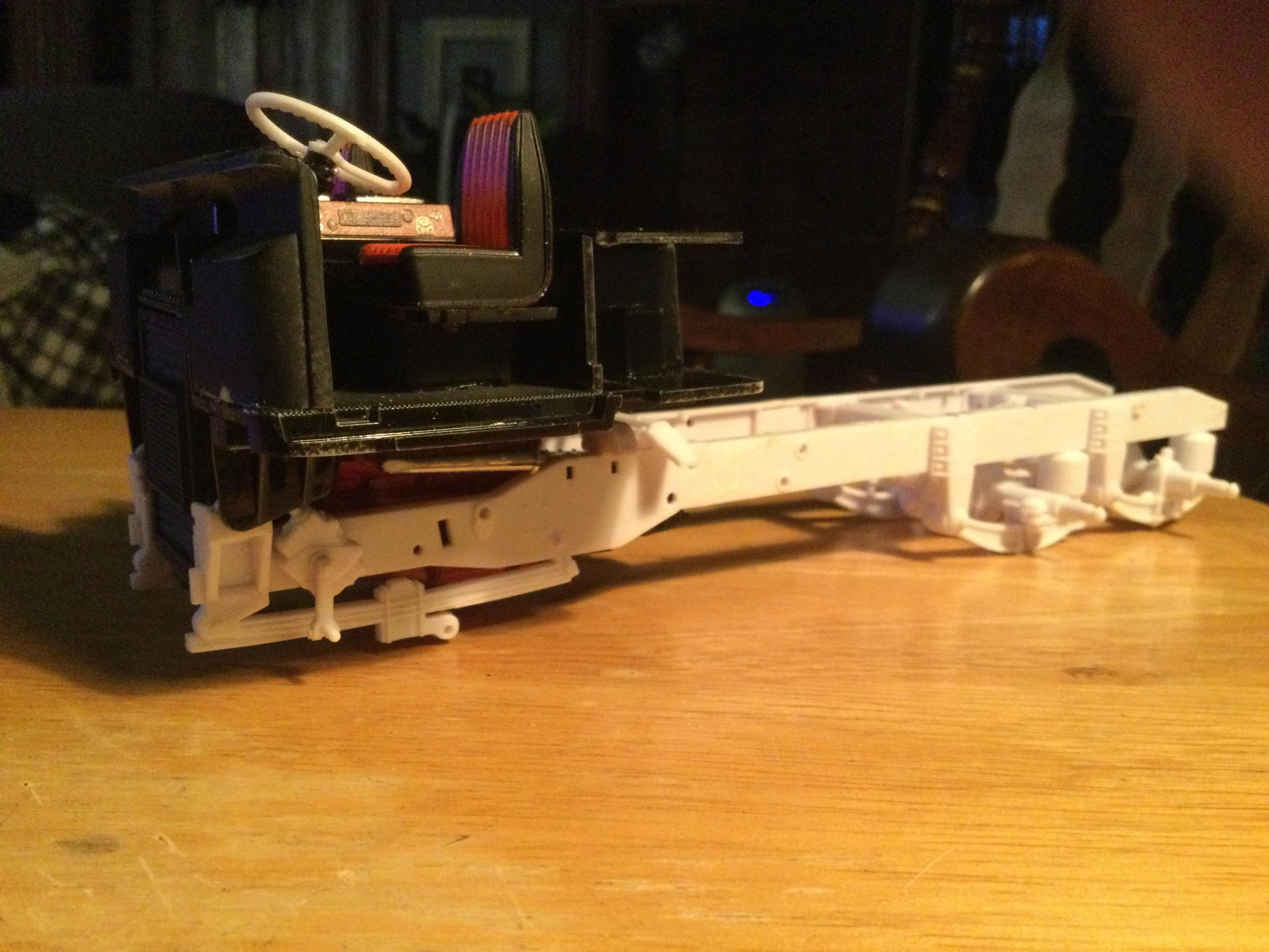

  5. Really like where you are going with that

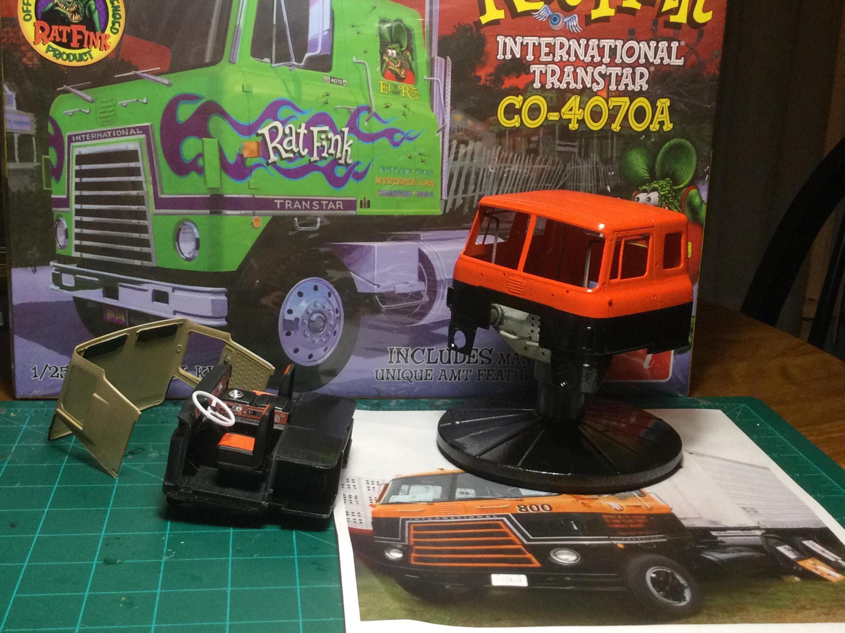

  6. This is the first time building a 4070 kit it is a very clean kit little to no flashing, parts fit together well no warped parts and very detailed and so far quite a challenge and thanks for the compliments

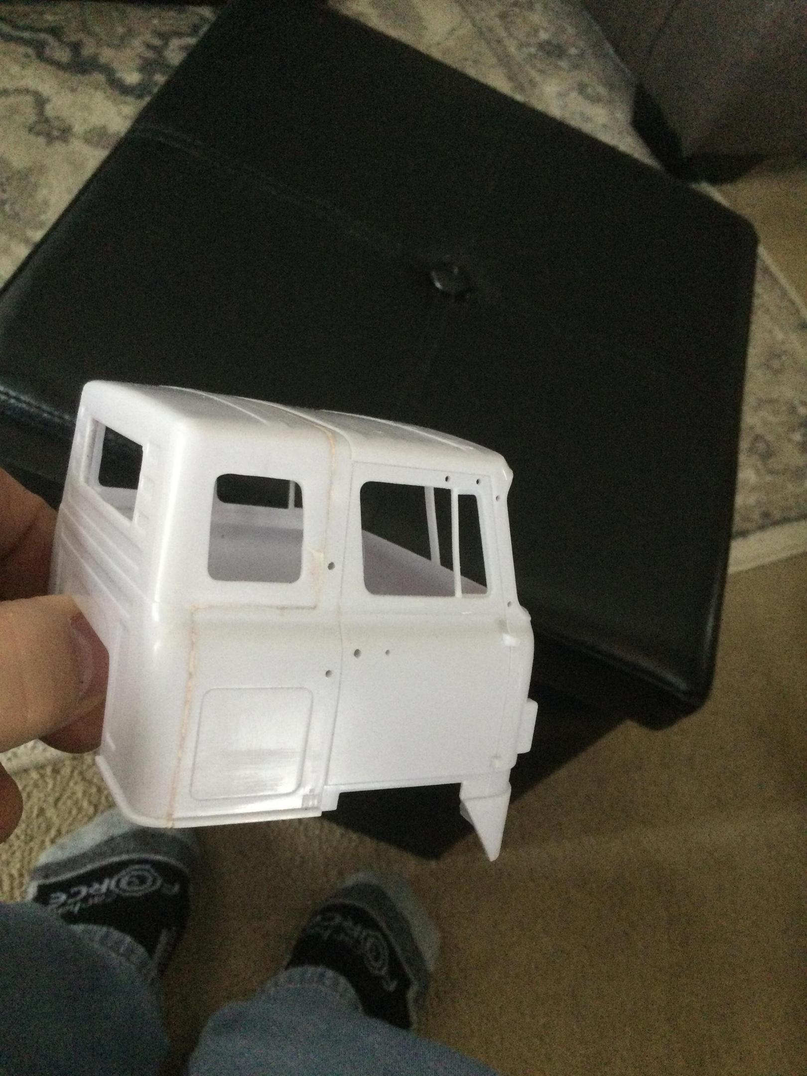

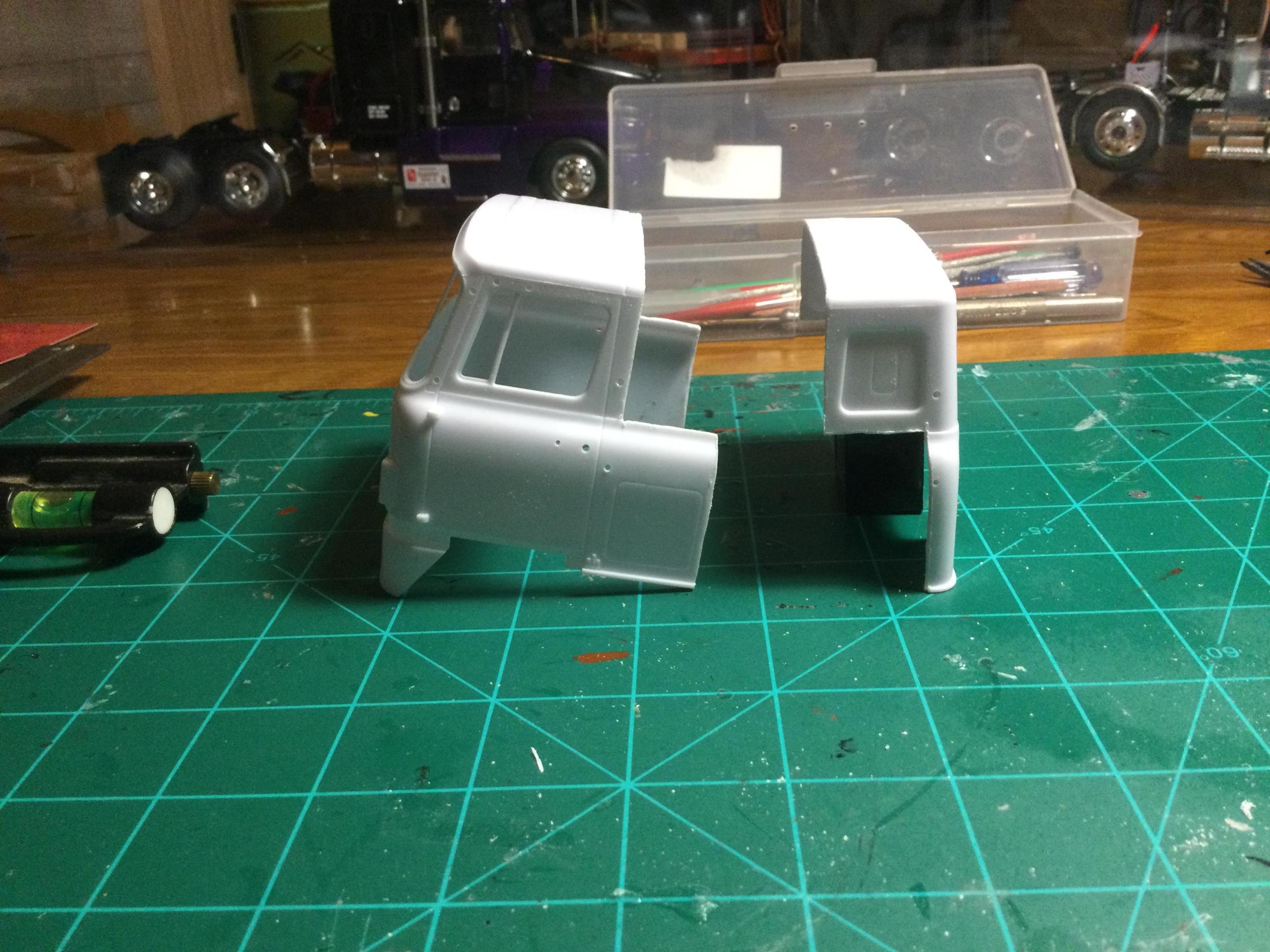

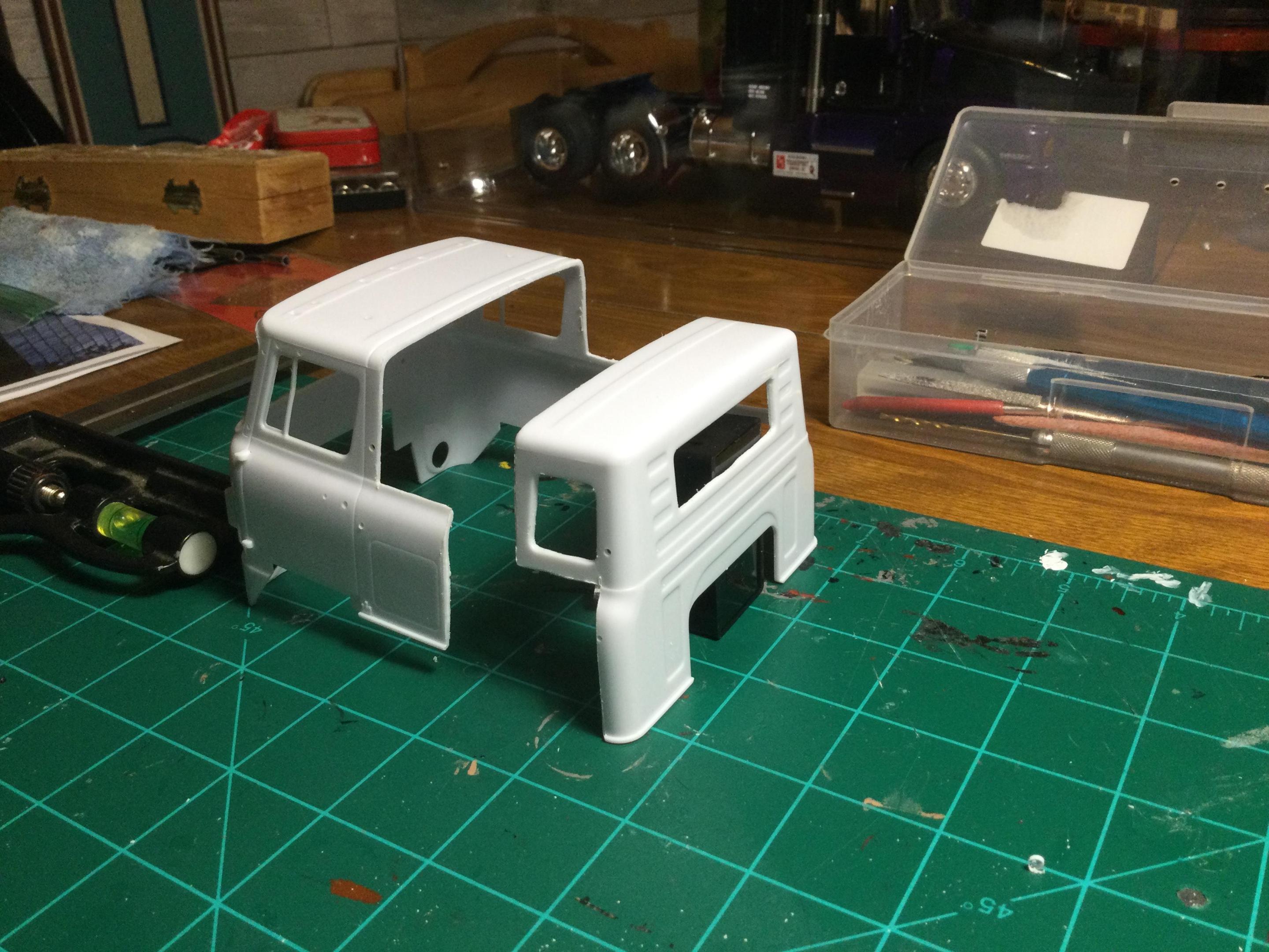

  7. Thank You for sharing the info. Here are some pictures of how I sectioned the cab again thanks for the info
  8. Slowly starting to mock up the frame after removing 1” inch from the frame rails and removing the stack bracket mounts

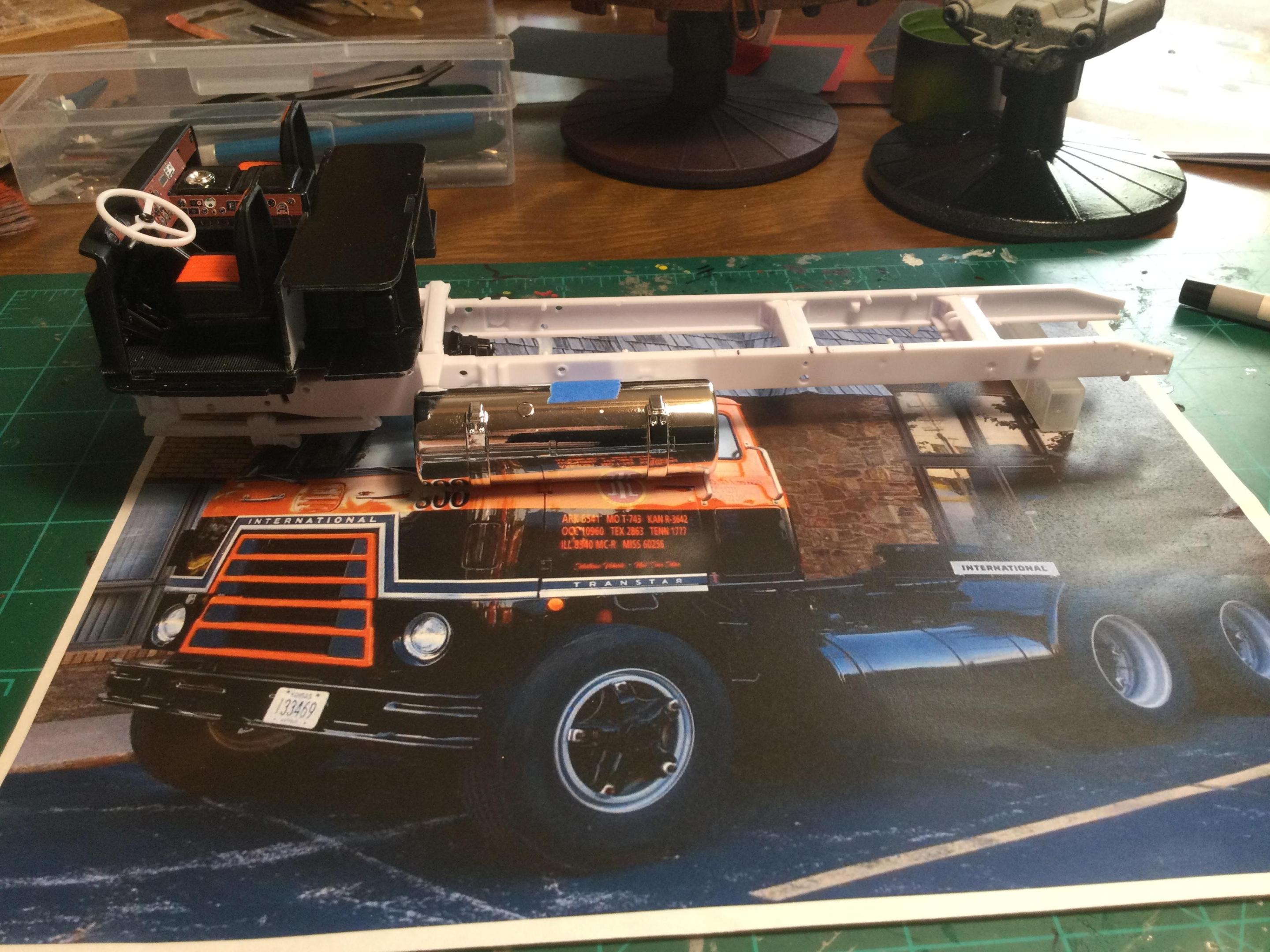

  10. The easy part is done, now the hard part short’n the frame rails remount the stack and air filter can, fuel tanks and replumb it all so it looks original

  15. When I started building again in 2000 I built a couple stock builds and changed and added some small things. that is when I decided I wanted to do something completely different so I decided to build a double sleeper witch led to stretching the frame then more horsepower and a lot of other modifications and what a learning experience on what todo and what not todo this is the first time of posting my first custom build on this forum

  18. First off a good cut helps a lot my first shot at a custom cab I used a exacto knife it didn’t turn out so well then I discovered the saws a good clean cut a light even coat of glue put your halves together I don’t try to wipe off are smooth out excess glue I let it dry for 24 hours then sand it down and then I use the Vallejo plastic putty to fill in the light spots
