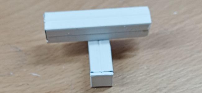

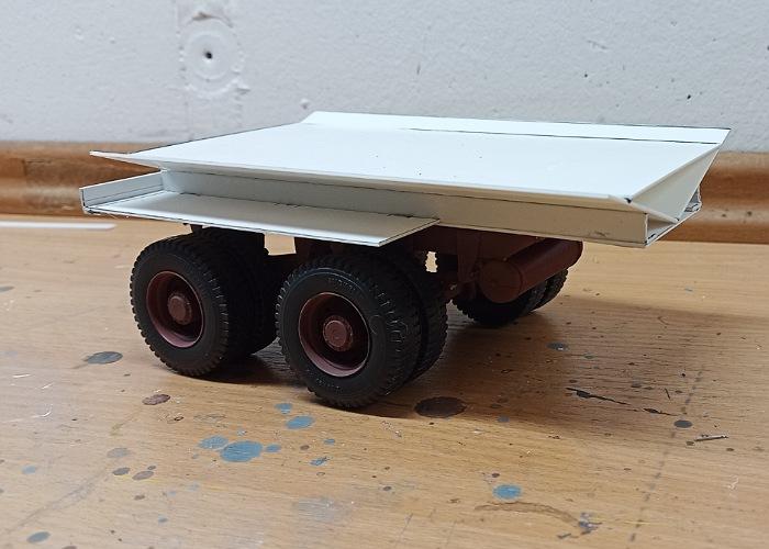

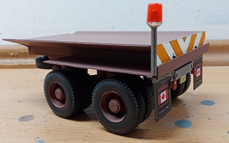

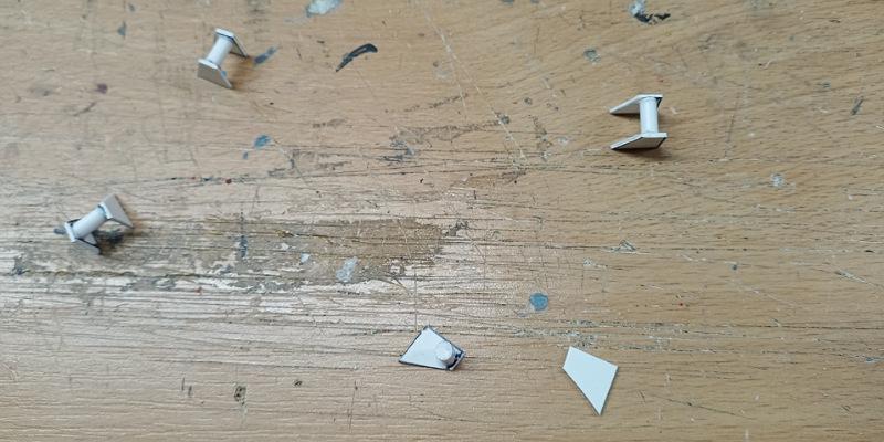

The fifth wheel of the second trailer ist printed ... ... so are the landing gears: I used the pins to keep the "feet" movable. Not that it's necessary but it looks nice! ? The landing gears are printed in one piece! Saves glue! ?

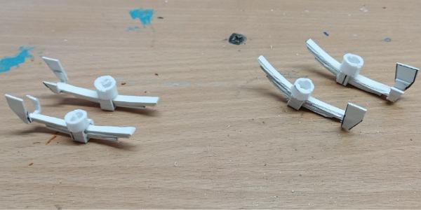

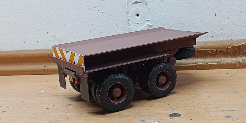

The rear chassis of both trailers are printed and assembled. The drawbar is designed. I experimented in making it of one piece. Just the brake cylinders and the brake drum covers need to be attached. Hope the print works out well.

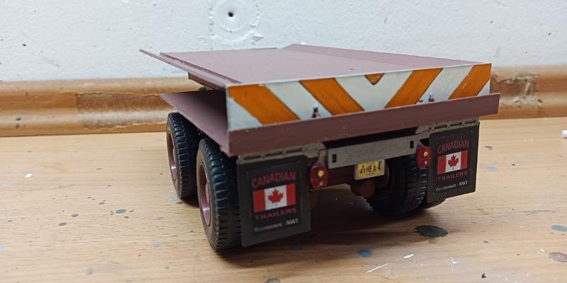

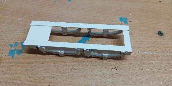

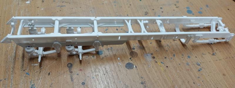

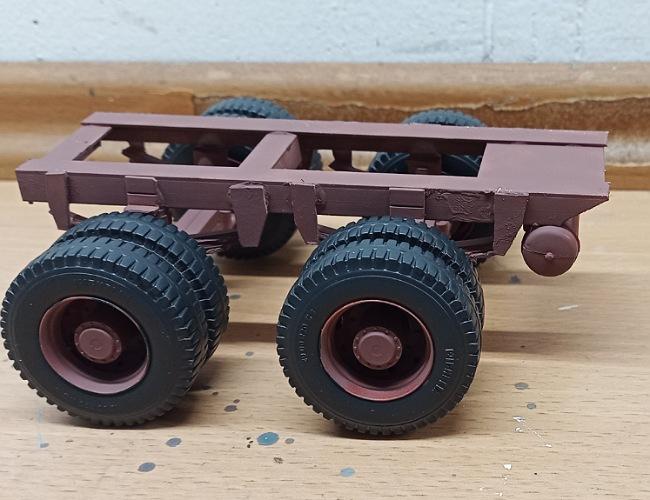

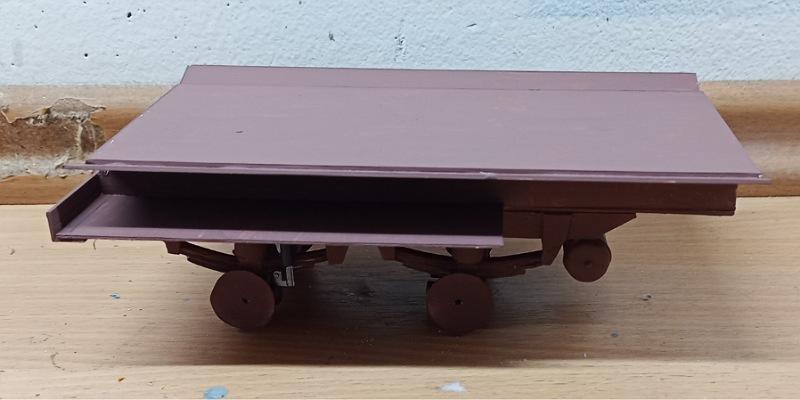

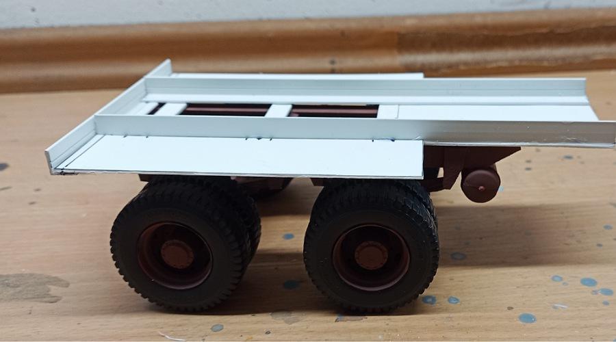

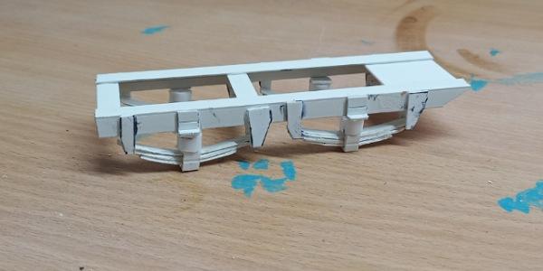

Here's the chassis of the first trailer. I used metal rods as axles since printed ones don't always have enough stability unless you make them thicker. They too have advantages though. You can keep the wheels from sliding off by using a hot knife or something to melt the ends and press them flat just like it's done in some model kits. In this case I chose metal rods though. Here I made the brake drums fit the rods tightly so there's no need for "stoppers" at the ends! Fits perfectly! Also the walls of the first trailer are now glued to the floor: And I designed a new fifth wheel for the drawbar of the second trailer:
The rear part ist also printed. I put them together to see If they fit. Seems to work out pretty well. When they're glued together and painted I'm sure it will look even better! The roof will be printed soon. I decided to print the chassis and wheels first.

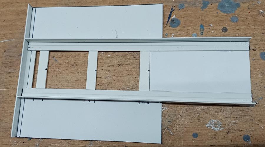

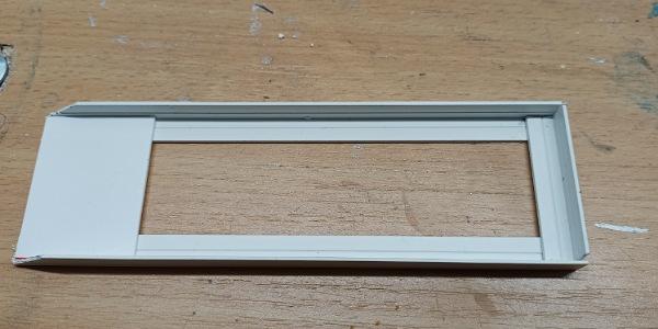

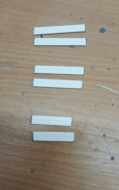

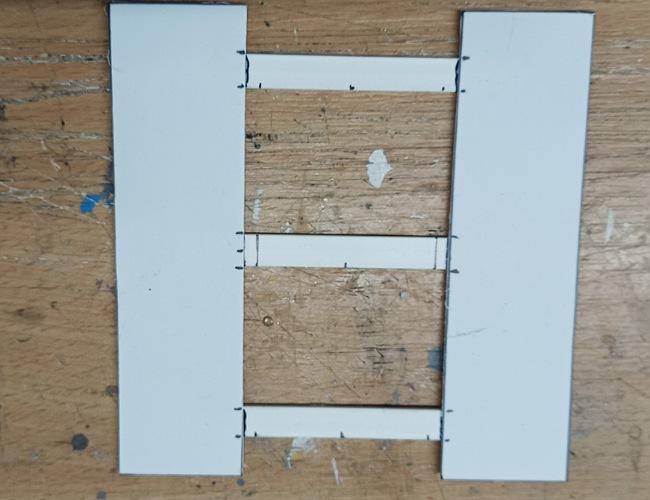

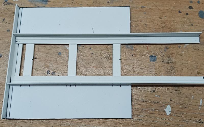

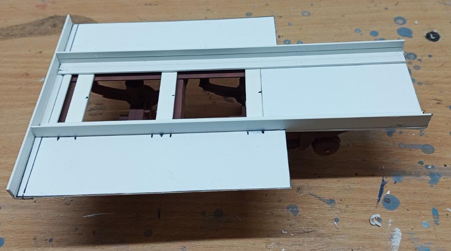

OK, I took your advice and changed the stripes from green to tan. Looks better! Thanks again! And I´ve started printing the first trailer parts: Here´s the floor made of three parts. (Only because I had designed them to 20ft and not 27! So I made another part to increase the lenght from 24 to 33cms. And here´s the front and side walls (only front half) being printed: VID_20240304_102412.mp4

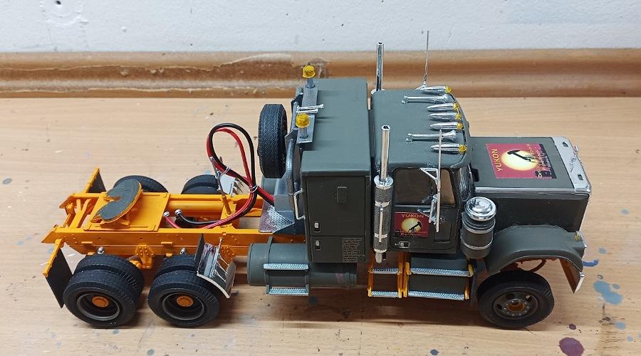

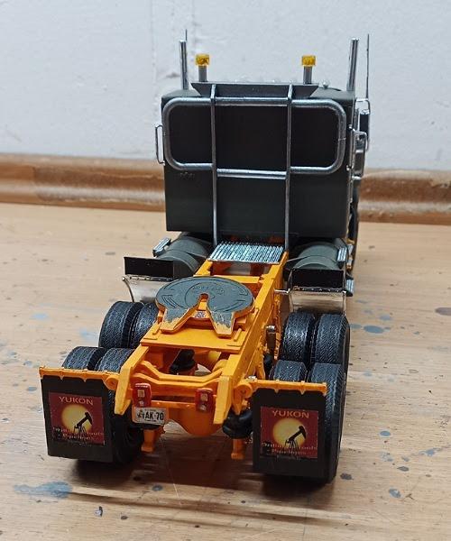

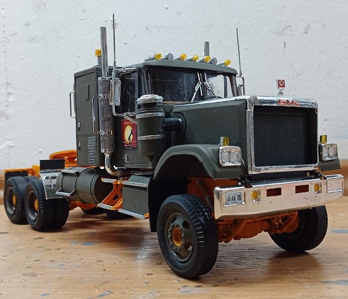

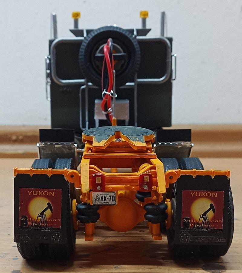

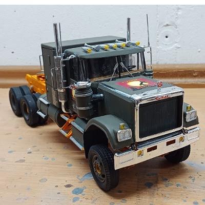

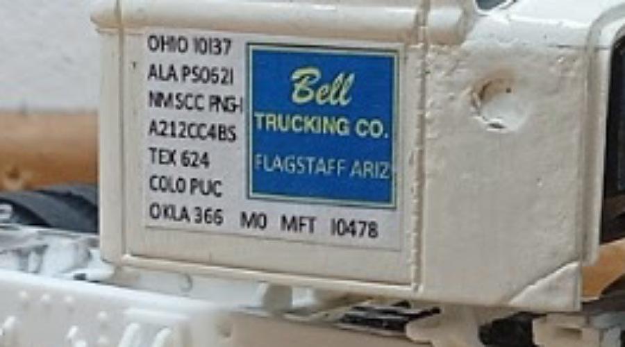

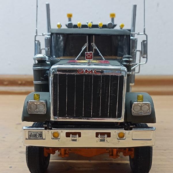

OK, guess I thought of everything. Turning signals, antennas, the number 2 in the sides, the screen on the grille, ....! Oops. Just saw that the right rear outside tire isn't sitting strait. Be fixed in a sec. Gonna Put some dust on it too. But I have to wait till the decals are on. Otherwise they won't stick! Now the decals have to be designed. Gonna be a toughy! I'm not sure how I'll design them, I mean with which design software. The standard stuff won't do the job I guess. I'm not talking about the writing on the doors, I mean the red pinstripes on the green. My hands aren't calm enough to do it with paint. Maybe If I practice a bit on some others parts. I'll think of something! By the way, this is the only shot I've got showing the doors. Anyone know exactly what it says? The white letters and numbers are very blurry!

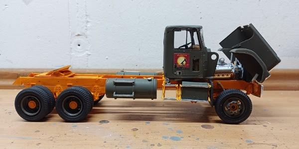

Good morning, I got a little more done: Got the too wide axle off without breaking anything. Also the breakdrums were detachable without damage. Got the mirrors in and the hood hinged. Now the fine tuning begins! Rear turning signals, tail lights, Bulldog on the hood, aging, more dust in the mud flaps, ... Then the tricky part begins: Designing and applying the decals!
Thanks! ? Glad you like it! I must admit I am quite proud of it myself too. But there's still a lot to do. The shortened front axle is finished and hast to be painted and mounted (The white one is the new one, obviously) , the air hose from the filter to the turbo charger still has to be designed and the mirrors are still missing. But I'm not in a hurry.

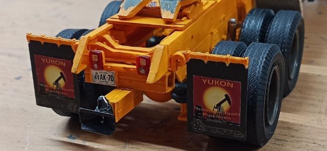

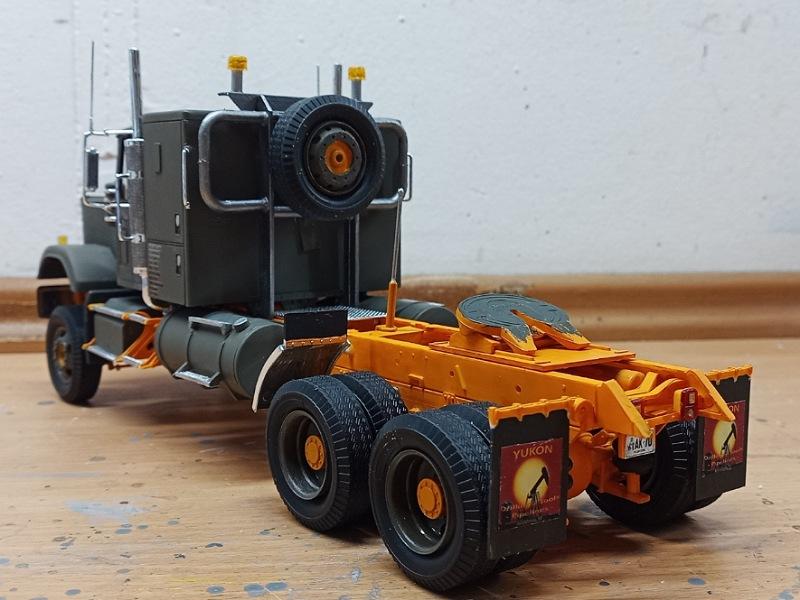

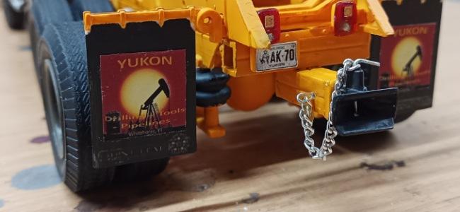

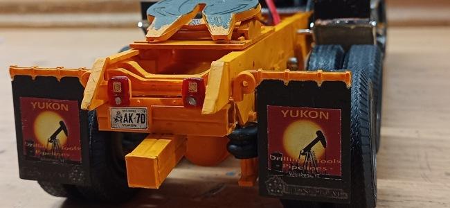

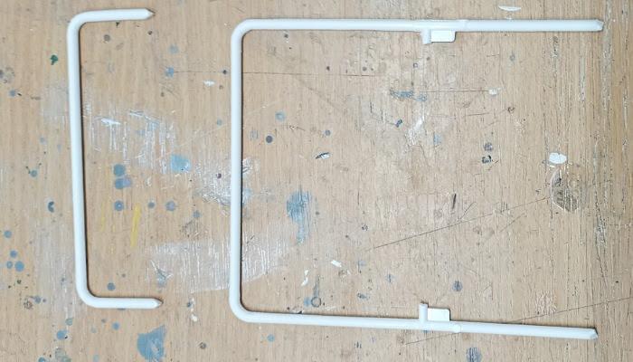

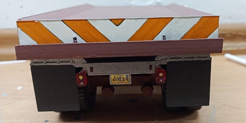

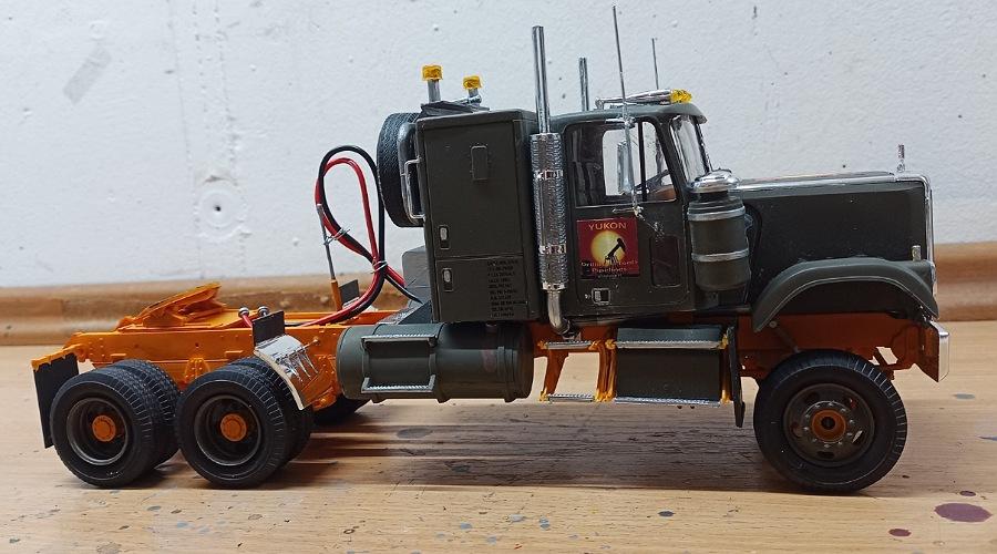

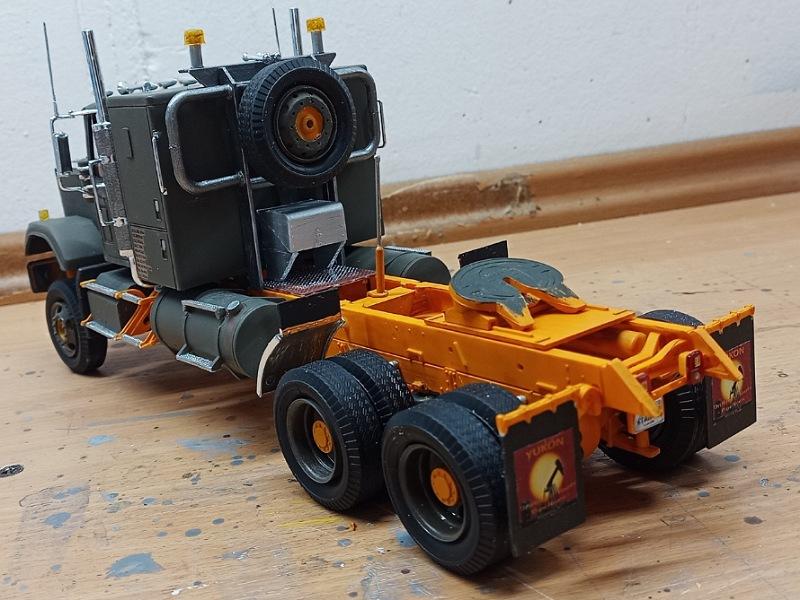

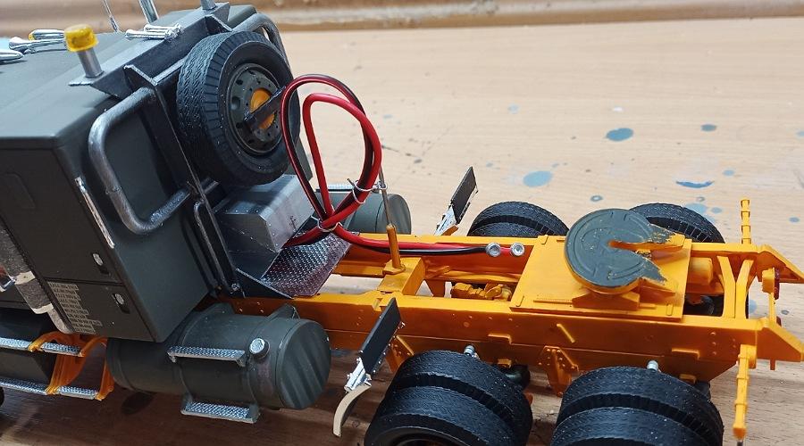

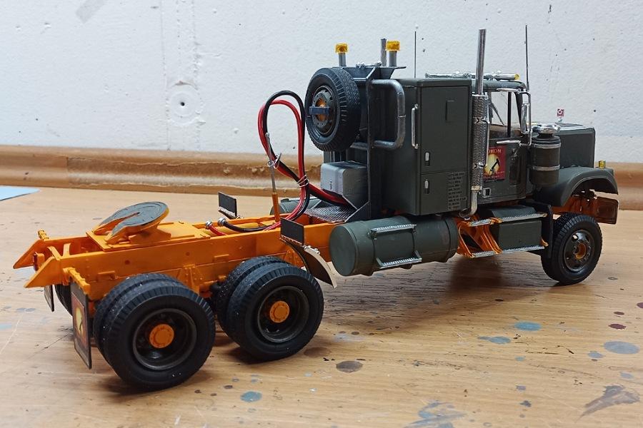

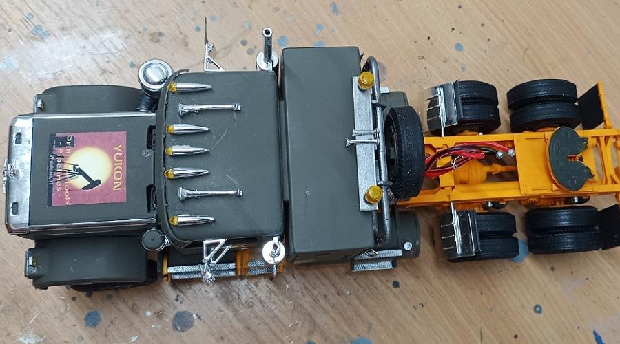

Here's a view from the other end: The mud flaps are printed also with loops to put through the metal rod. Still have to be aged more! The movie truck hast a long spring on the back side of the cab to hold the air lines. I'll do that when the first trailer ist done. Also there are brackets one the side of the frame, I believe they're the holders for quarter fenders. I'll have to see If I can get a good view of them in a movie scene.

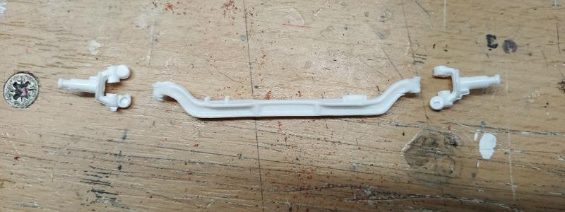

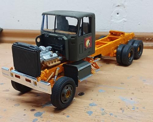

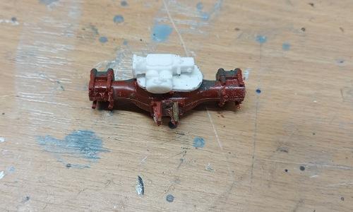

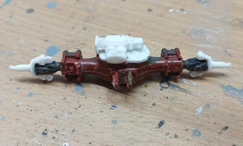

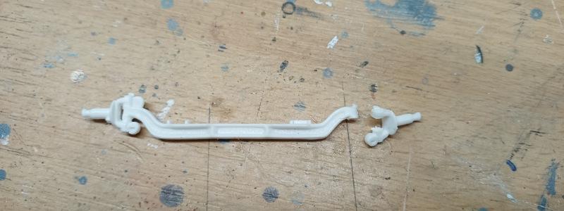

I discovered that the front axle is a bit too wide. The R685st is about 5mm smaller in width than other 1/25 kits which means the front wheels would be too far outside of the fenders. I actually decided to redo the complete front axle incl. steering. The 3D drawing of the axles is already shortened by 5mm and printed. Now I have to reprint the other parts but first I have to reduce the holes a bit to create a better fit. The wheels tend to tip a little to the inside which makes the whole thing look like a VW Beetle of the 70s.

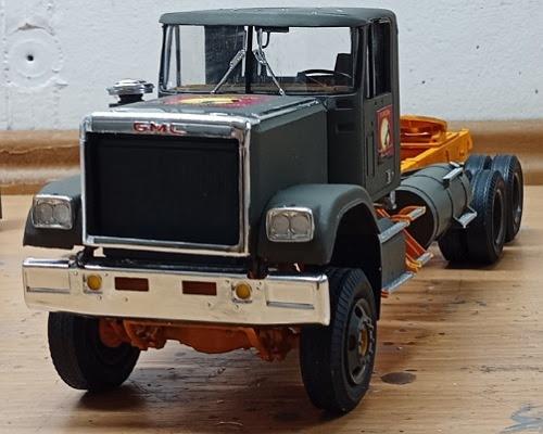

Had some trouble with the painting of the hood. It sort of peeled off. Don't know why but I suspect it's the mix of colors. I had the same problem when I built "Pig Pen" (Convoy). The aubergine tone was mixed out of 5 different colors and after having applied it, the paint began to wrinkle. Had to sand it off and repaint. What helped was putting a different primer underneath. I had used flat black. Just like this time! Using flat grey seems to work better. Hope it does this time too. Unfortunate that I didn't remember before painting! Looks good now. Primer didn't wrinkle! Hope the rest works as well!
Oh yes, by the way, the hood of the Big Nasty truck is from the Mack R685ST kit (old R.D. hood), only the cabin is printed. But I did print a new hood for the RS700L (Rubber Duck).

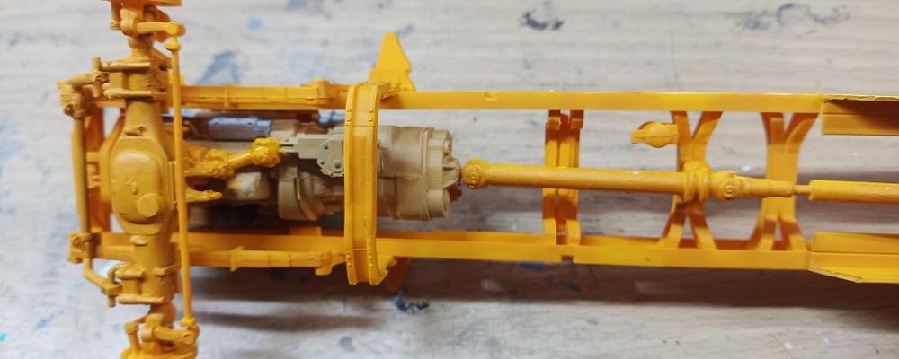

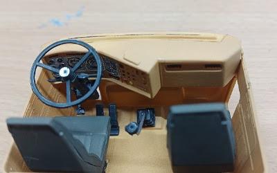

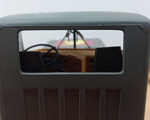

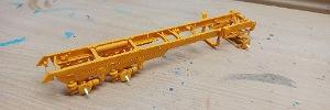

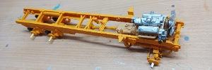

Good morning, I wanted to share the progress of my build. Actually I almost stopped building because you guys are used to much more precision in building, details, painting. I've looked at some of the builds in the forum and I must admit I'm far away from what you guys do. I'm really impressed! Honestly! But I'm not going to stop the build. I put in a lot of effort designing parts and trying to make them look as good as possible! Why quit? No, this is not fishing for compliments. I know where I'm standing but I'm still happy that some of you appreciate what I do, knowing I could do better. OK, lets cut the BLAH_BLAH_BLAH_BLAH, here's more progress: The red looks brighter in the picture than it actually is! The interior: The cockpit goes into the cabin, then they're combined! Painted chassis. The hood is just taped to see the fit! Here you can see the cab with the fit in cockpit! Double air intake from the filter: One leads to the cabin and (later) also one to the turbo charger!
