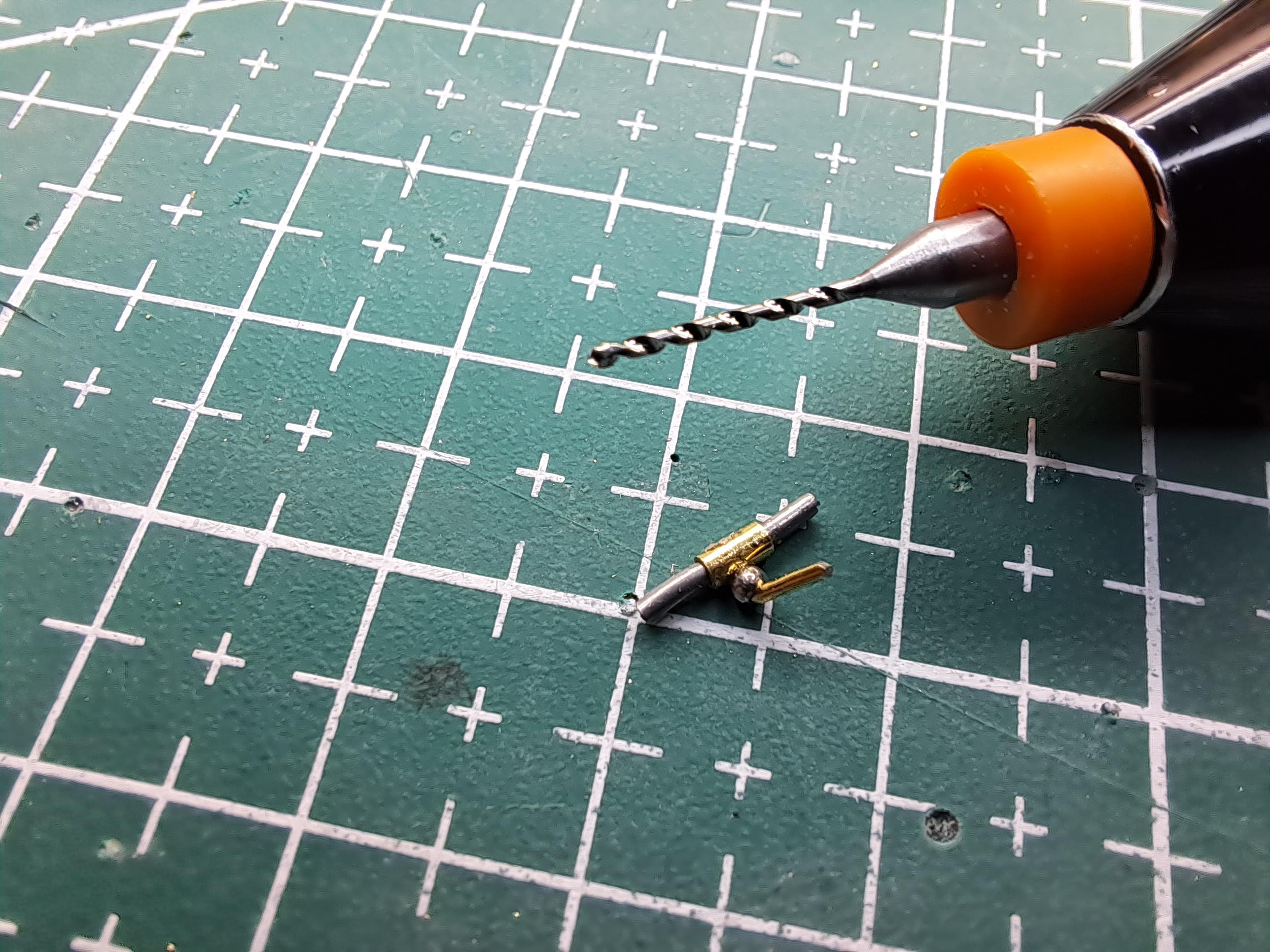

  21. Did a bit more work today. I made a sort of closing latch for the gas cap. I glued 2 tiny (.020 dia) styrene rod, 1 on the cap and 1 on the spout. The cap, when pushed in place makes à very satisfying click. Next up will be the tail lights assembly. Here's what will be done. Fabricate the mounting brackets Modify the light itself by drilling 3 holes to create an inner cavity and adding a light bulb (fake) inside Make the wire connection with braided line, rubber grommet and knurled nut. Here's what I'm aiming for Here's what the kit provides (yikes!!) First test with wire
