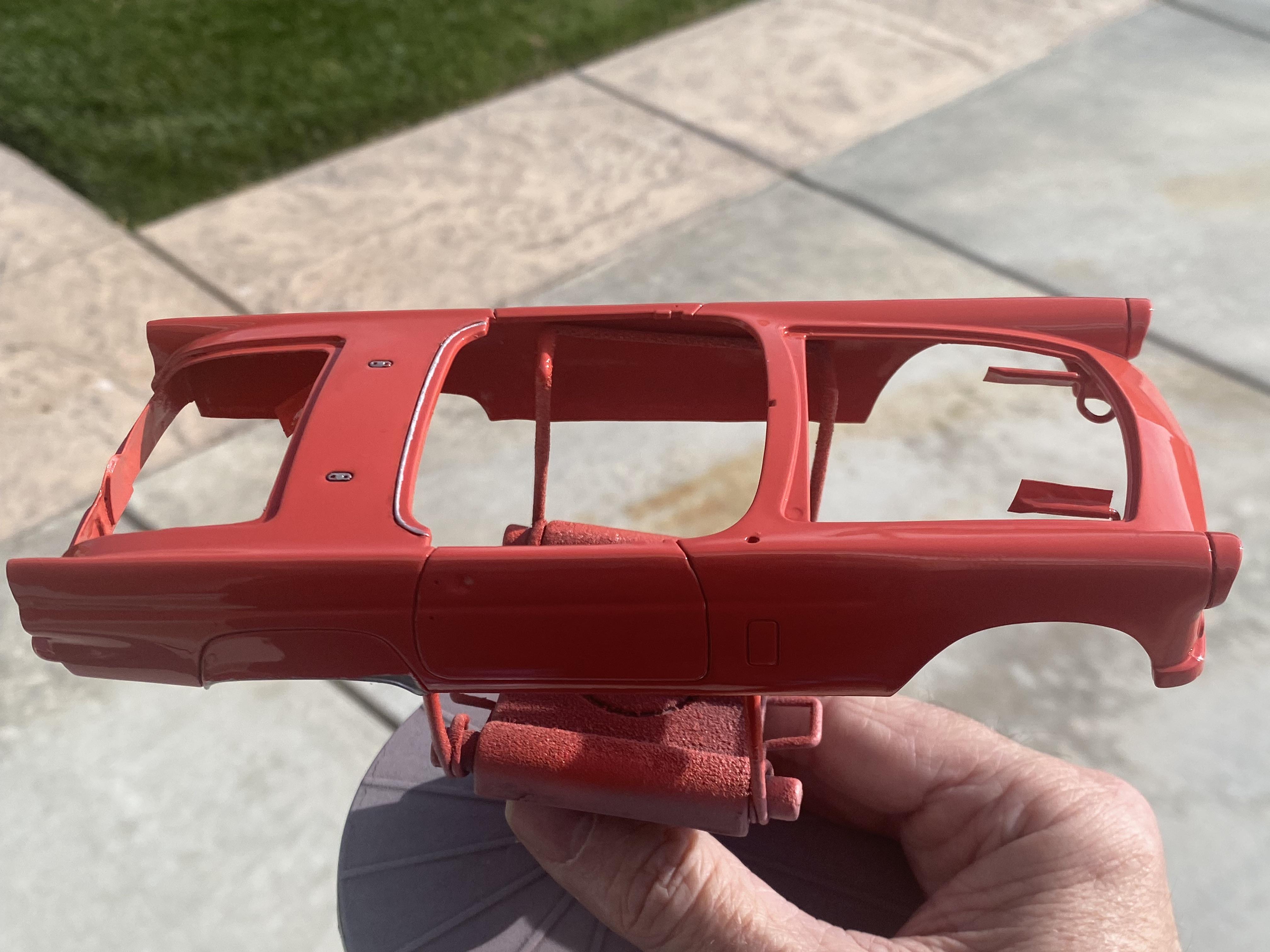

  2. Got the last of the airbrush work done now on to detail painting. I even got the carpet flocking done and painted surgical tape that will become the seatbelt webbing. There was a problem with the hood and I ended up having to strip the top back down to the bare plastic and respray it. Lesson learned, 2k over lacquer good, lacquer over 2k VERY bad.
  3. Thank You! Me too. I still need to wet sand and polish, but the body barely got any trash in it. The roof sadly will take a bit more wet sanding, but it isn't that bad either. Now just have to wait a few days for the 2k to cure.

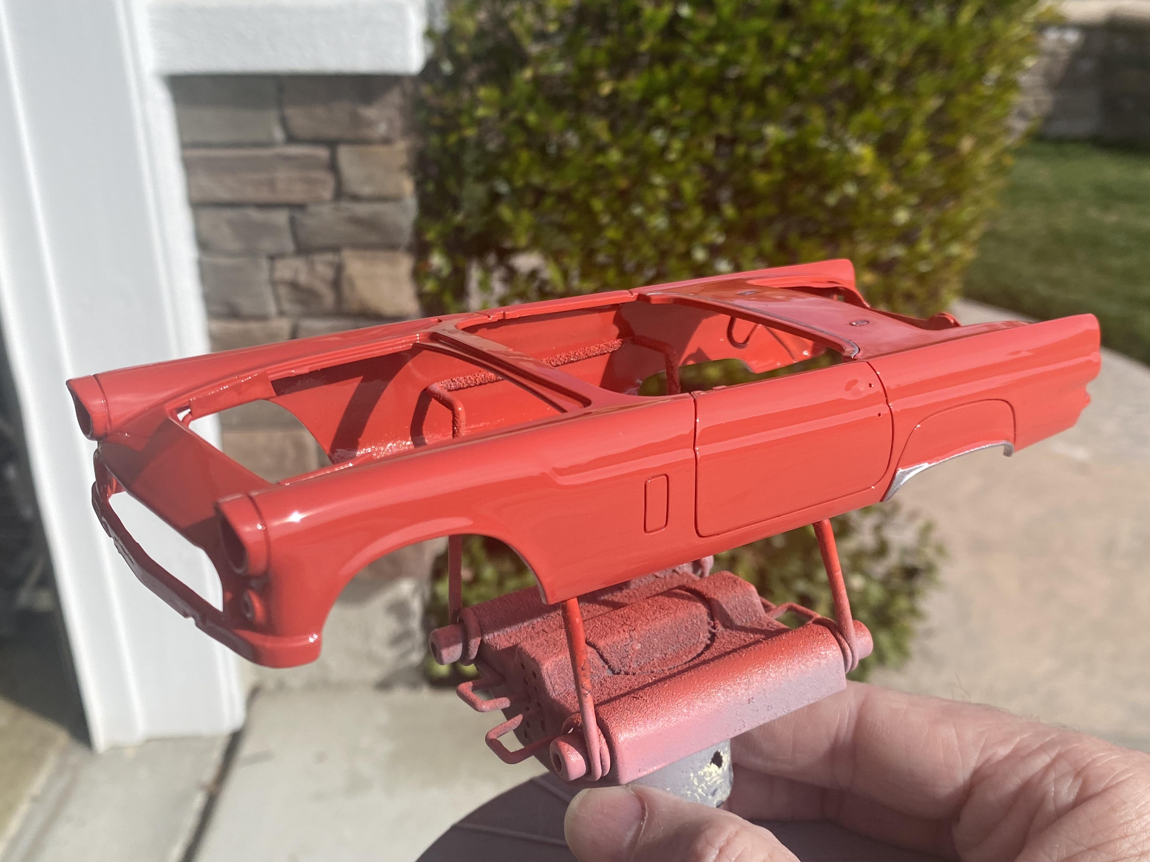

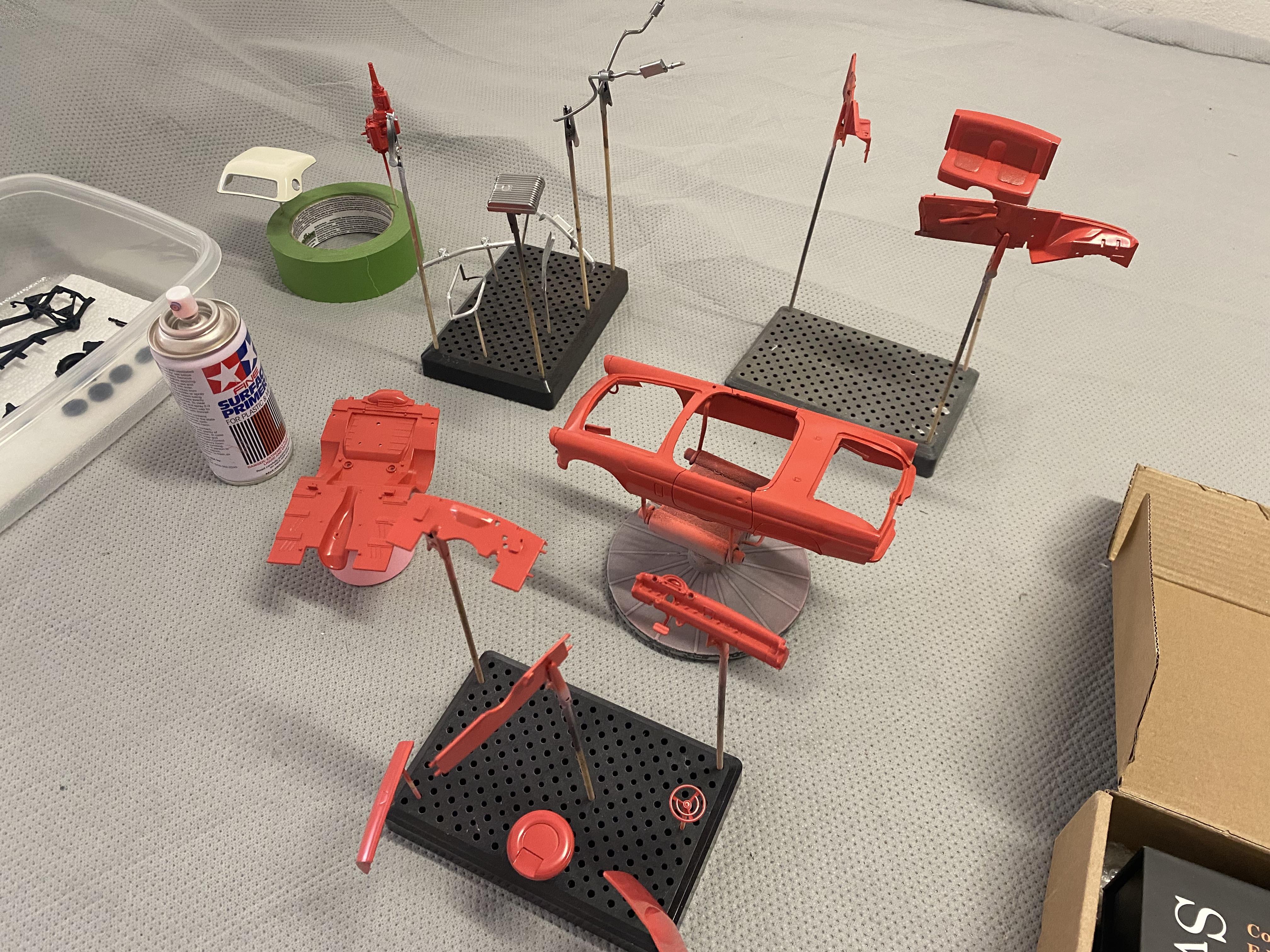

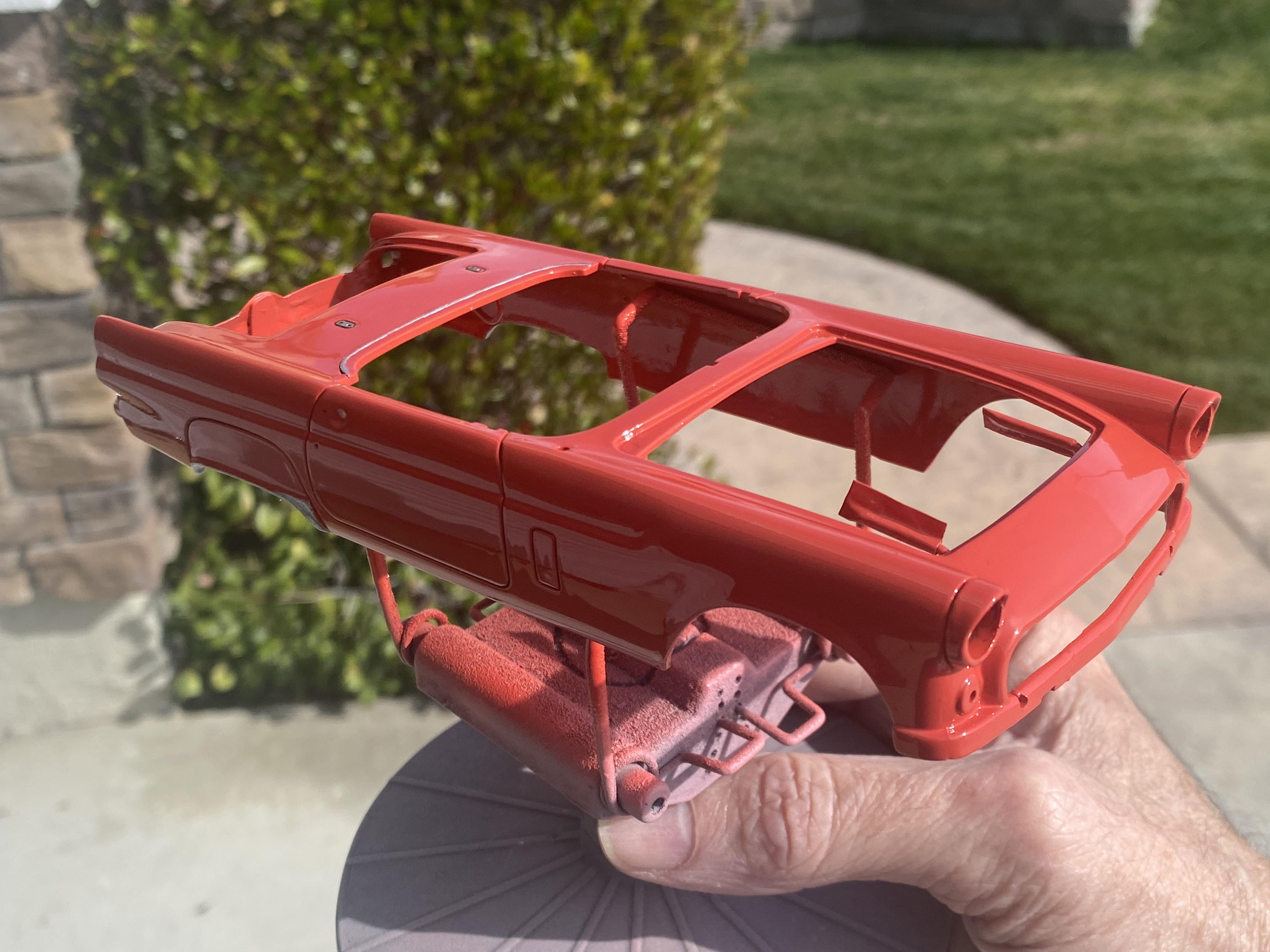

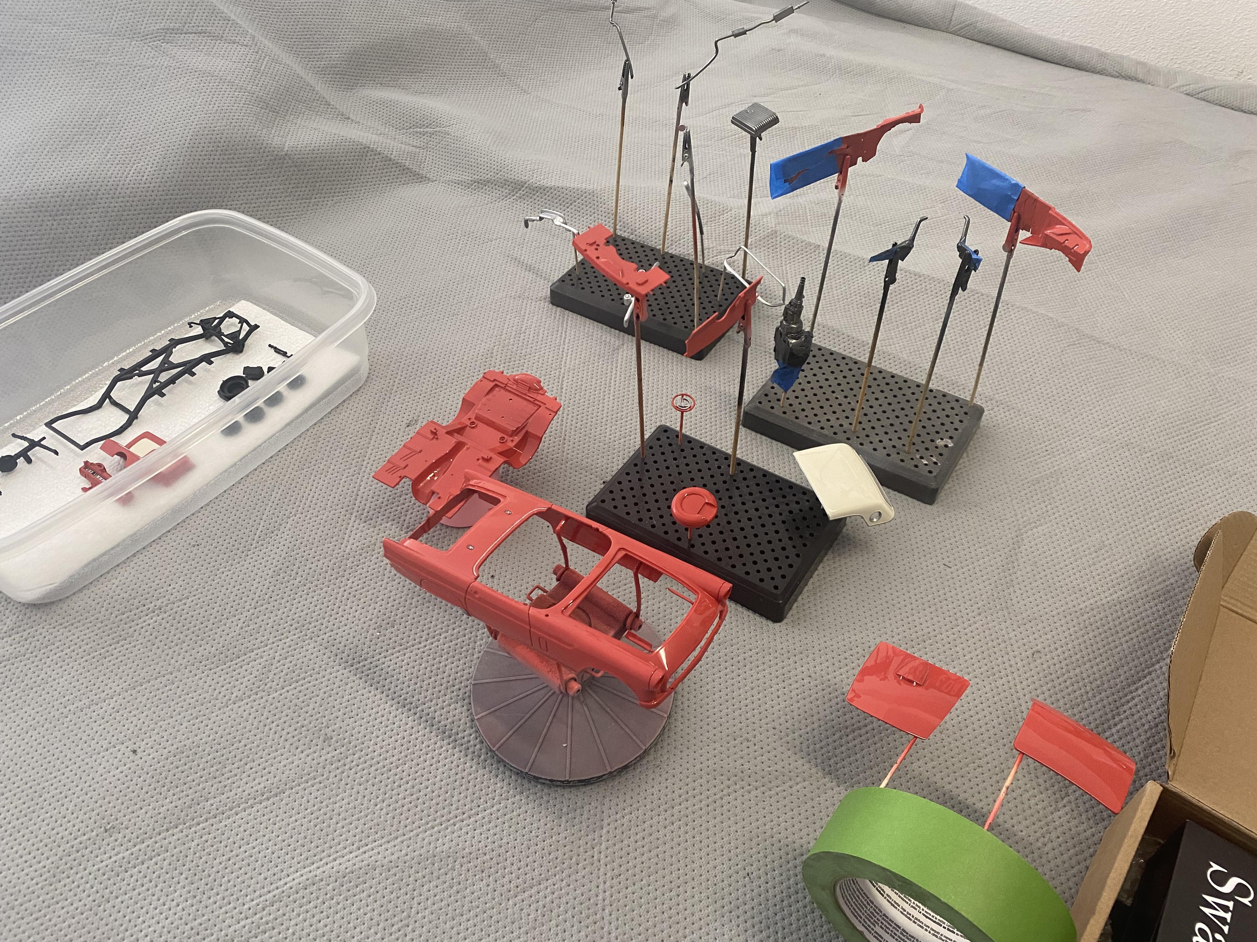

  4. I did get Fiesta Red sprayed on everything that is supposed to be that color and today sprayed 2K clear on sooo many parts including the chromed parts. The body came out well with the clear and little to no trash. Sadly the white top does have a little trash in it but it should come out in the wet sand and polish stage. the chrome does lose a little shine when sprayed with 2K clear, but not bad. There is a new Chrome out that requires over 2K black and 2k topcoat I am going to try out soon.

  8. Thank You! Yes, I usually wait 1 week and 2k clear. Have to do very light coats first to seal. If I am not extra careful it can lose some shine, but it usually still comes out ok. Thank you!

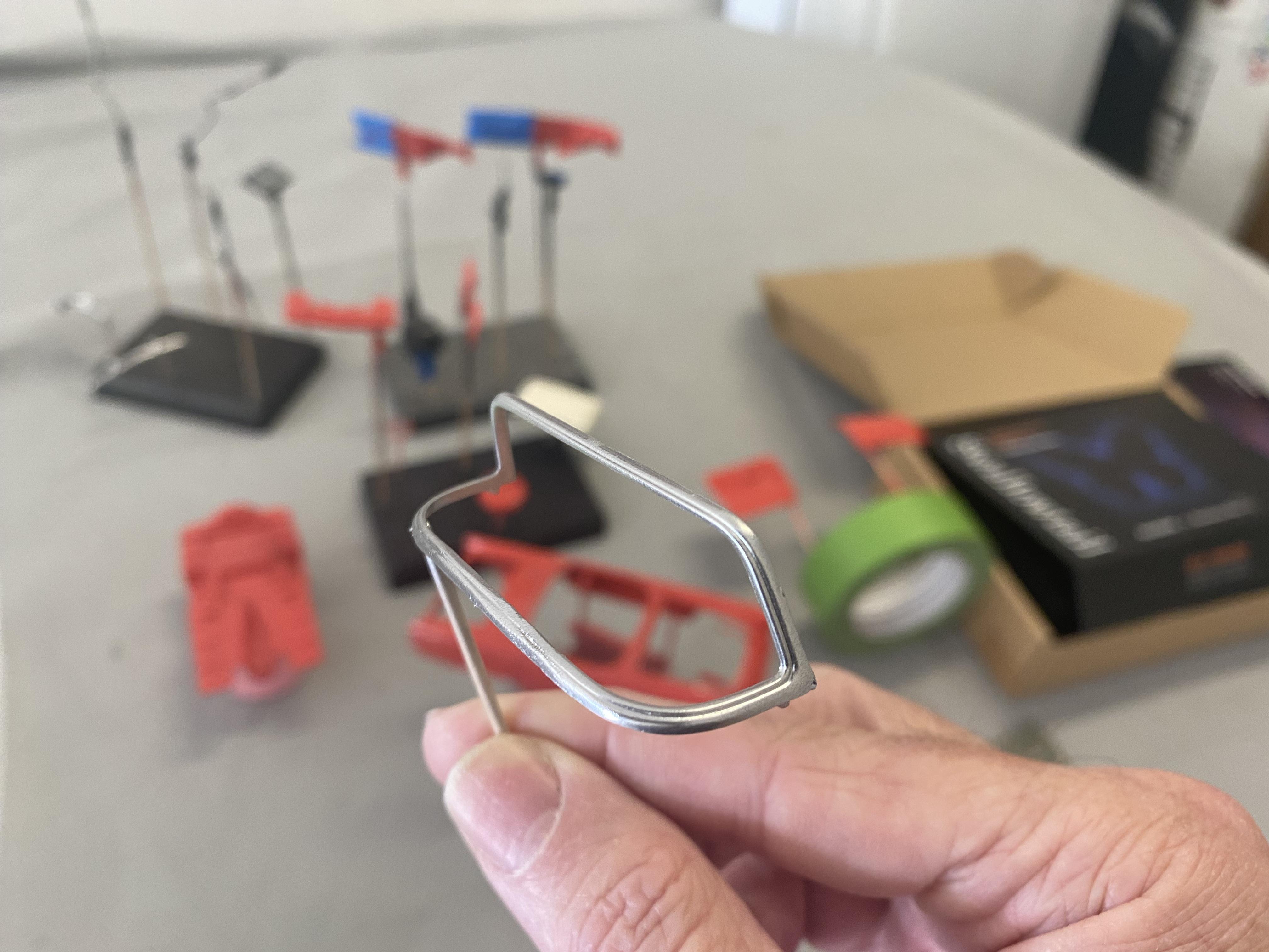

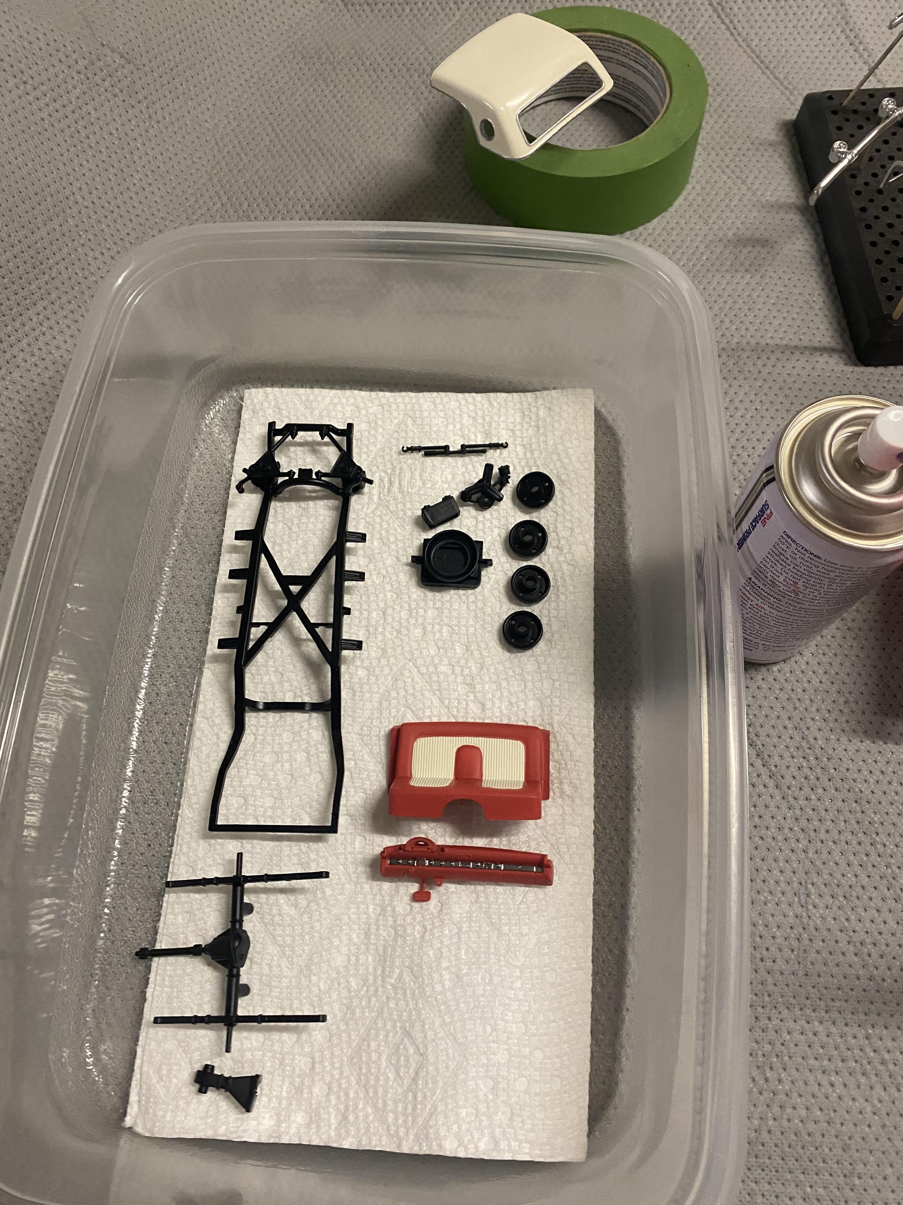

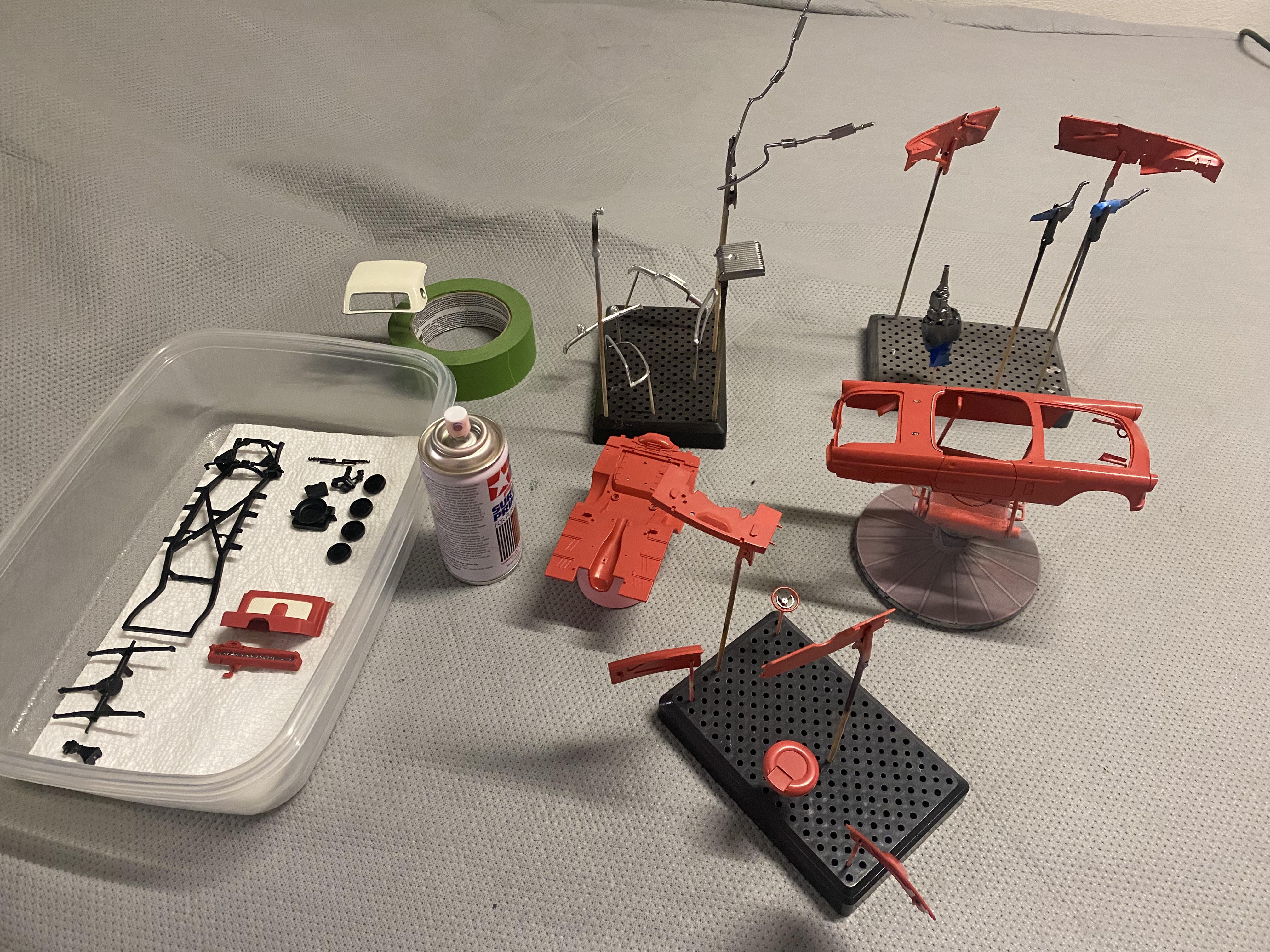

  10. Painting has begun. NO, it will NOT be pink. that is just the primer before the Fiesta Red base coat I am waiting to spray after I can mask the seat and door inserts I painted Colonial White. Chromed the bumpers, rear view mirror and grill surround. Alclad Airframe aluminum on the exhaust and gas tank.
