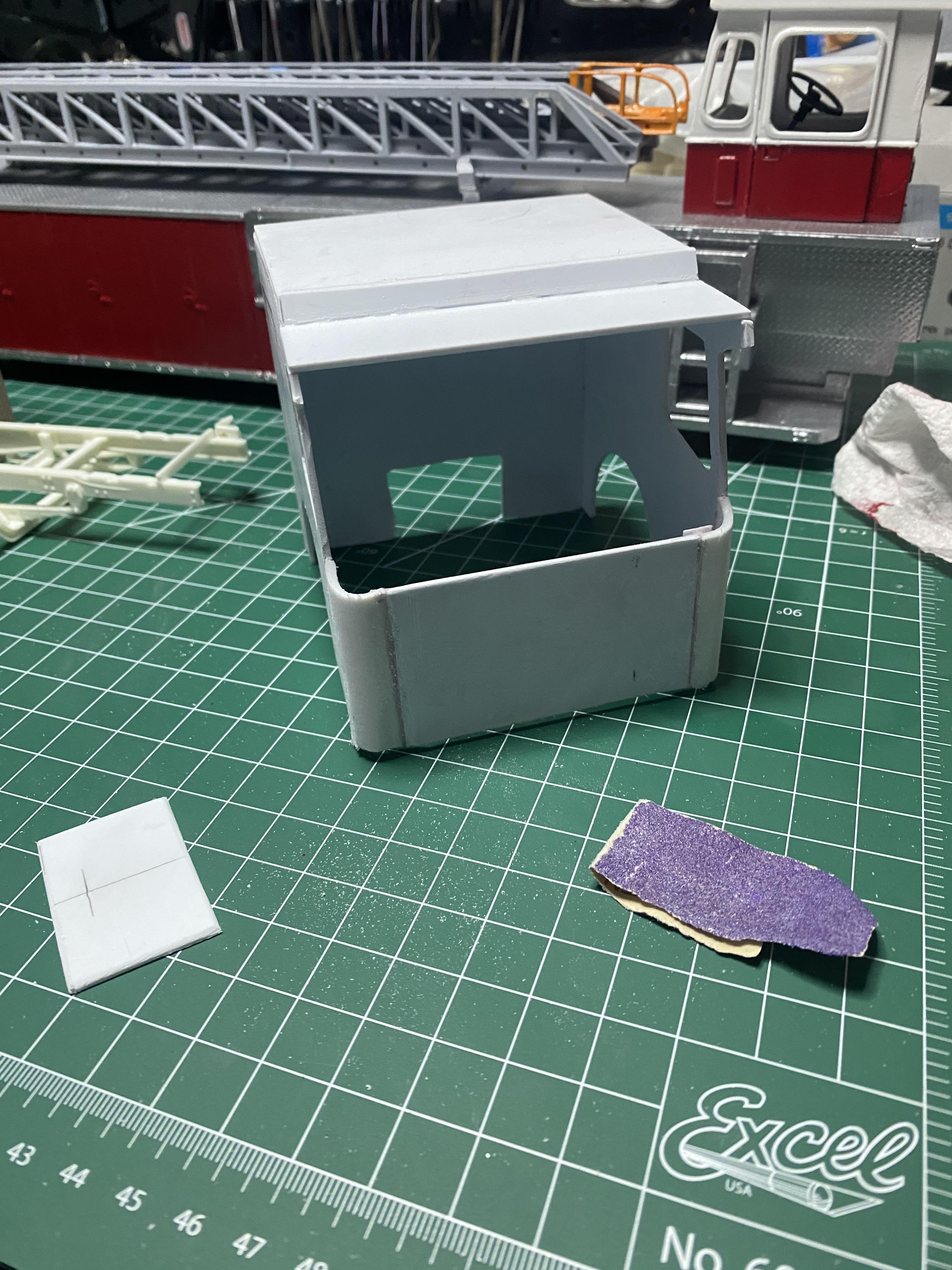

Finally got some primer on the cab, will leave it alone for a few days and then sand it and prime again. Started building the bumper. Work on the chassis needs to get done while waiting for primer to dry. -

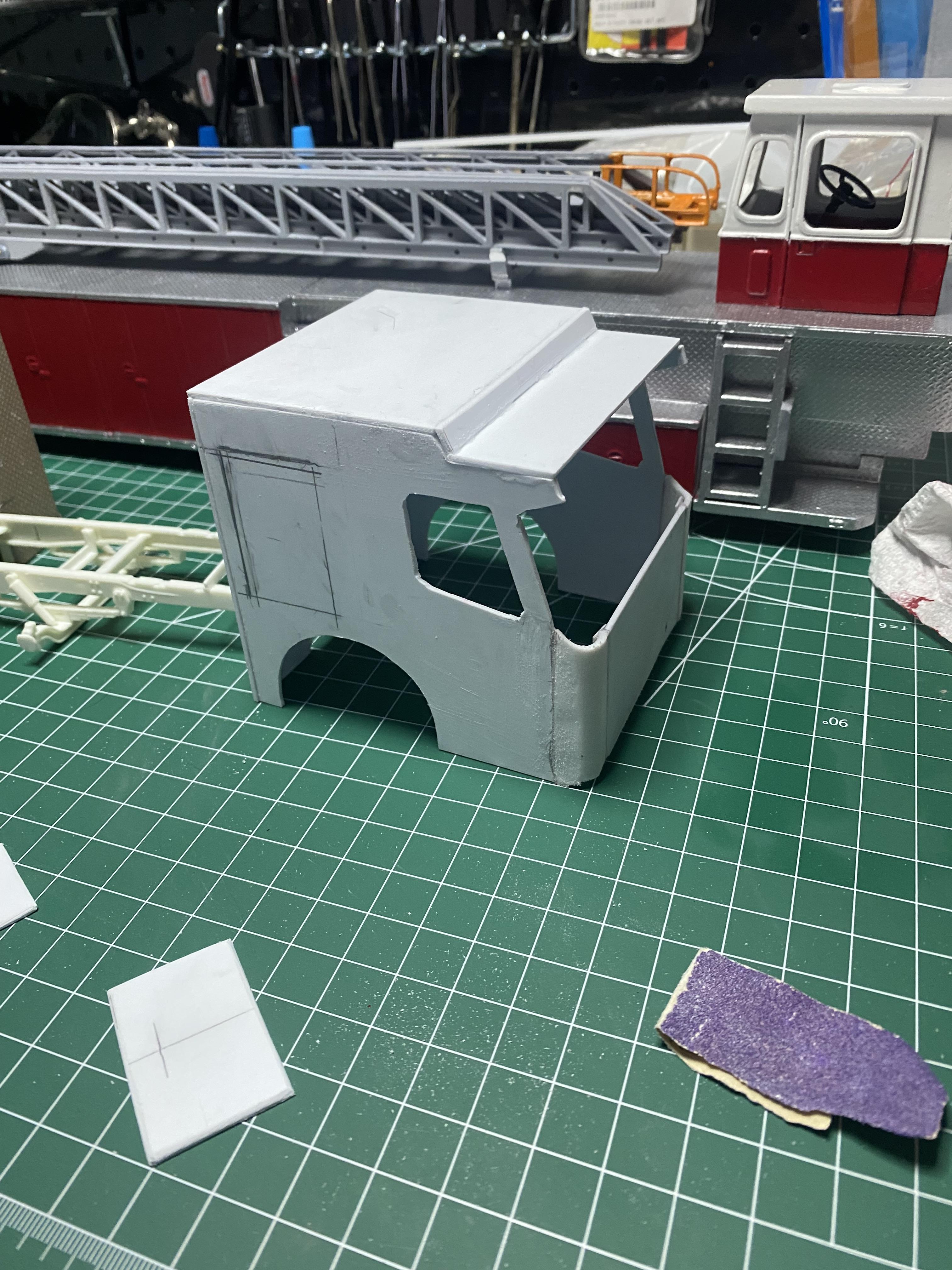

Charlie, I do plan on following your advice, the top left corner of the cab curve separated from the front panel when I was cutting the hole for the bezel. So I had to re glue and putty it. While I had the putty out I filled a bunch of the imperfections you are talking about. The grill is filled and being sanded again to. Then a wet sanding and on to primer finally. Then as you said more sanding and priming. Here are pictures at the 2nd attempt making a mold for the bezels. It was easier to make without the grill attached and came out much better than the first total failure. I used a different clay to pack out the back side of the bezel, and not as much clay as I did with the first mold. I have to pour the 2nd part of the mold, any suggestions before I do? The Alumilite instructions are not clear on what to do before pouring the 2nd half. Dom -

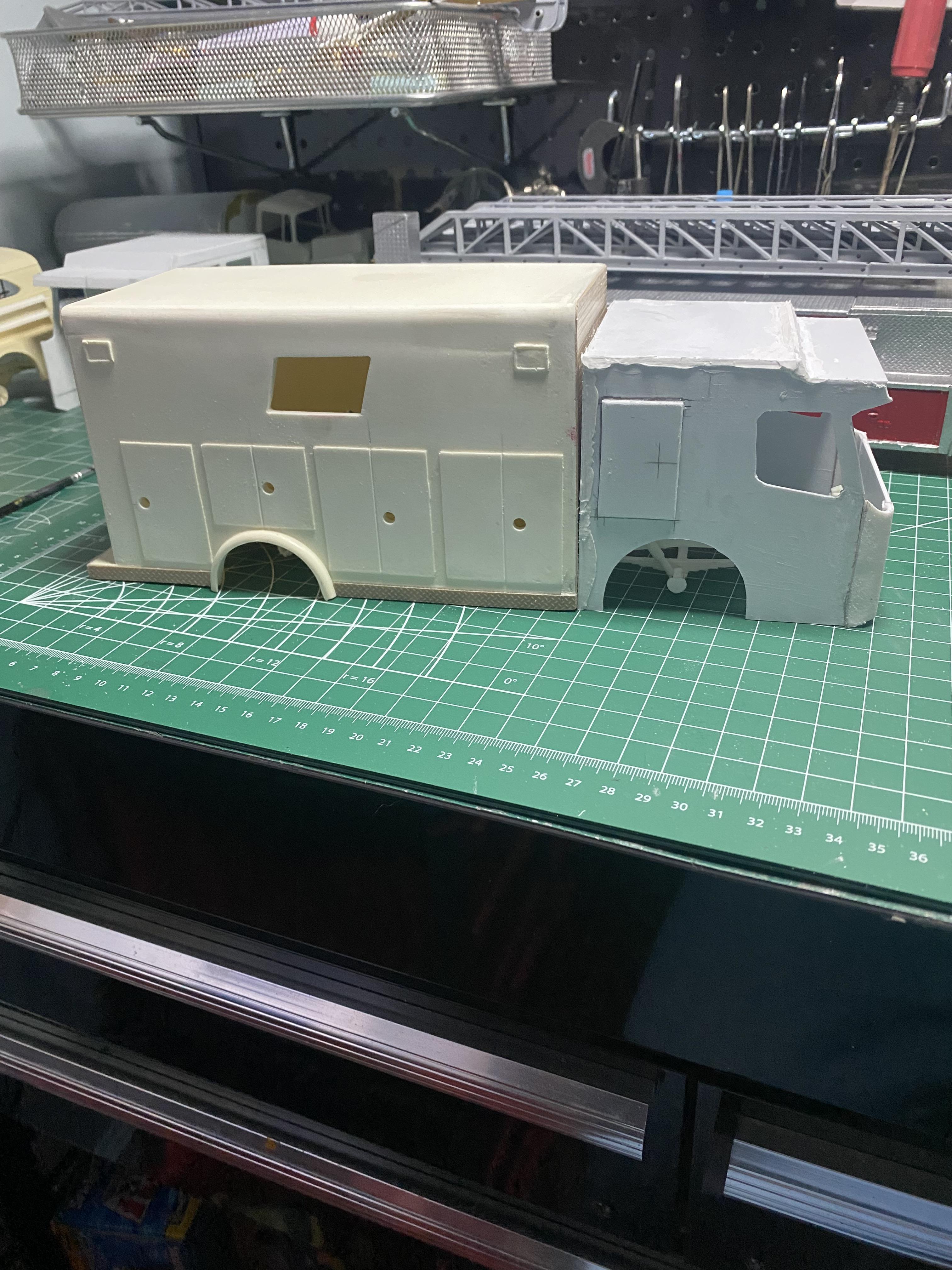

Greg, That is a SSB resin E450 ambulance. It was listed as a 2005. It took me about 18 months to find it on eBay. They don’t show up there to often and I lost a few bids, But finally found one with a buy now option . It is a work in progress duplicating a rig for someone I know. The cab is older than what they have now, being it’s a 2019 model, but this was the best I could for an E450 right now , I am contemplating building the box from scratch, originally I was going to modify the resin box that came with the kit, however after roughly marking it out, I have to change just about everything on there, including the roof line to match the existing rig. Dom -

The mold for the entire trumpeter eagle grill came out terrible. I am not sure where I went wrong with it, but the modeling clay I used to pack out some areas, stuck to the silicone. So I cut the light bezels free from the grill , and will attempt to make a new mold for just the bezels. Hopefully my second attempt will go better. I cut out the openings for the light assemblies and the grill. After some more research on this cab, I noticed they make several different grills for their apparatus. I went with one that was not to hard to build out of evergreen stock. I just need to find some scale grill mesh now. -

I have no idea yet on the windshield, I read your build thread and see you made a buck , and then vacu formed. I can make the buck, but not sure if I should do it in a one piece or two piece windshield. I don’t’ have anything to vacu form with, and I still have to research how to do that at home if possible and what would be needed. I did see a vacu forming machine on micro mark, but it’s a big investment for maybe just a few windshields, and I am not sure that is what would work for this . If I make the buck out of a block of wood, would it be to much grain? I found some Ren on a website and was thinking of ordering it and using that if it would be smoother. I also saw how you used that to make your grill, which is something else I have to tackle. I did make the mold for the trumpeter grill and lights, just waiting for the hobby shop to get in the resin. Once that is cast, i will cut the bezels free from the grill. I hope mold I made came out ok, it’s the first attempt at making a mold and casting a part. For now I am going to wet sand the cab, ending up with 3000 grit and then Get a coat of primer on and see what needs touch up. Dom -

Charlie , Thank you again for the great advice. My dashboard stash is limited, but I will see what I have . As for the rest of the dash, I am not looking to make it exact, I just want the proportions to look right. There are a lot of compound angles and curves from what I can see in the photos . So far what I have built either looks to big, or just does not look right. The angles seem off. I agree with you ,once enclosed, Not much will be seen, so I won’t go to far with details. Lol, and no, I am definitely not having opening cab doors. Maybe on future cabs once my cab building skills have improved! It sure would be nice if a new kit, maybe with an aerial device was produced, there is only so many models you can build with the amt and trumpeter kits before getting bored with them. The few resin kits out there are expensive, and trying to find just a resin fire cab is nearly impossible. I have seen some 1/25 scale 3D printed cabs, but the cost of the cab at $400.00 plus, is what led me down this road trying to scratch build my own. Dom -
