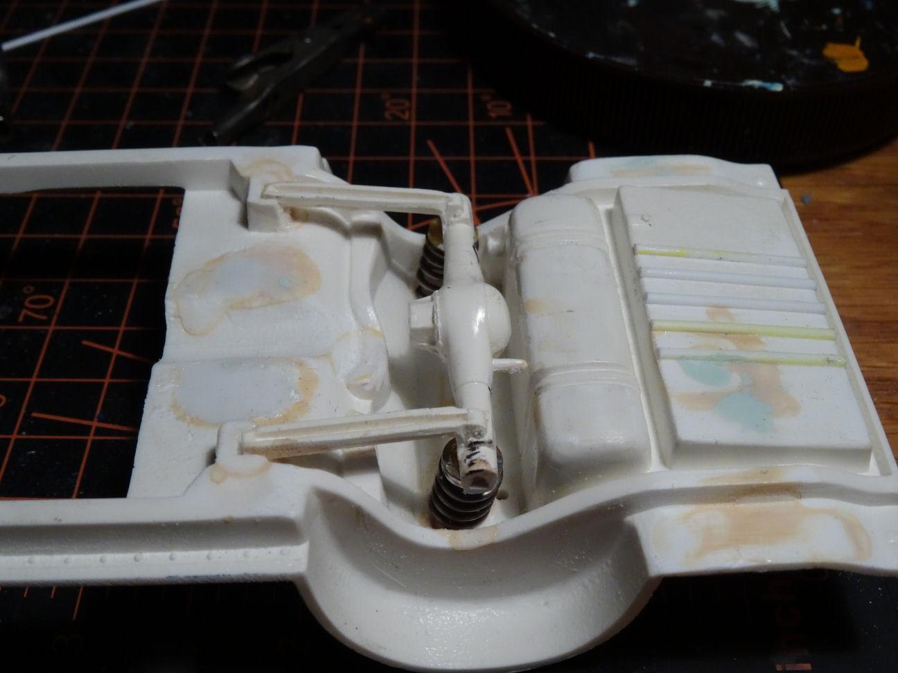

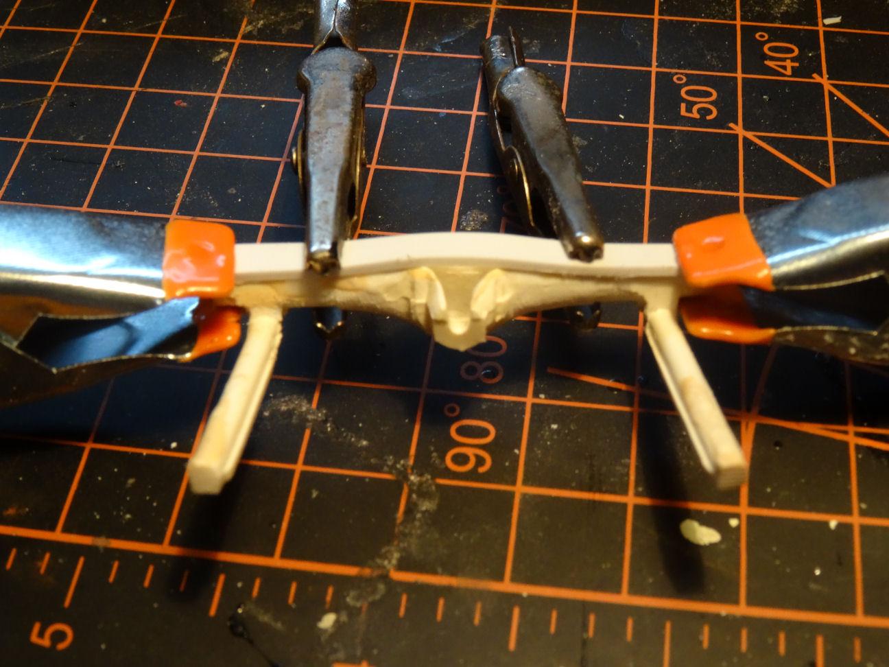

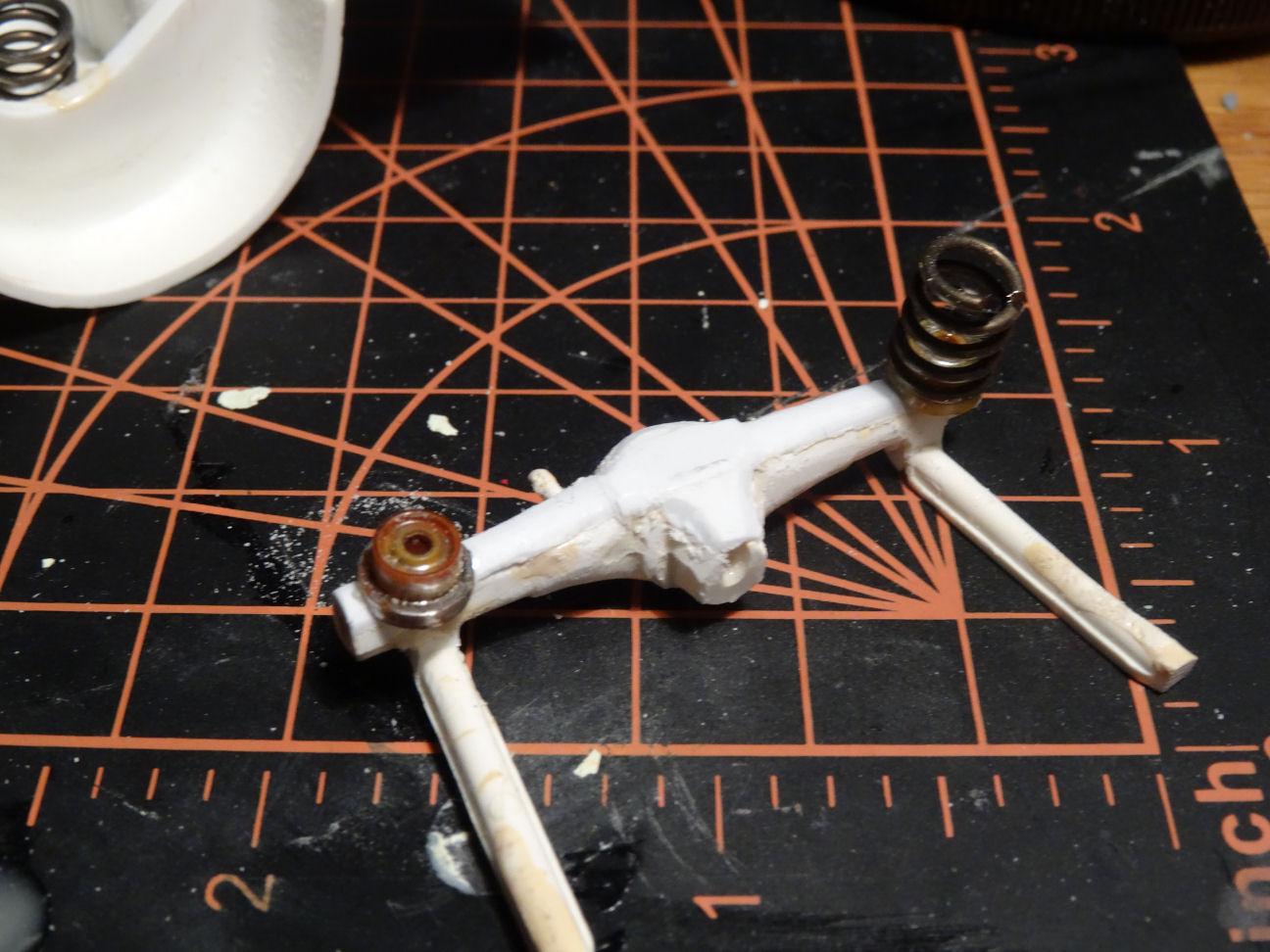

  11. Some more chassis work done this afternoon. Didn't find exactly the type of rear axle I was looking for so I settled on one from the AMT 1965 Galaxy. Problem with this axle happens to be the fact that it is open on the underside. Closed that up with some styrene strips. Axle is coil spring mounted so I added some spring perches to the underside of the axle. Can anyone identify the source for the spring perches? Found some springs lying around which I cut to the approximate length. Size will be determined later when I establish the ride height. Axle in place and it seems to line up all together pretty well. That's all for now, dogs have been fed and now it's time to cook dinner, chow🤓

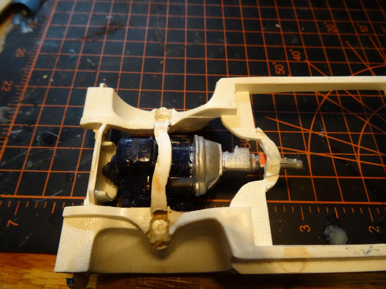

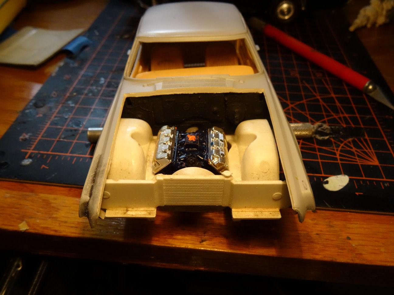

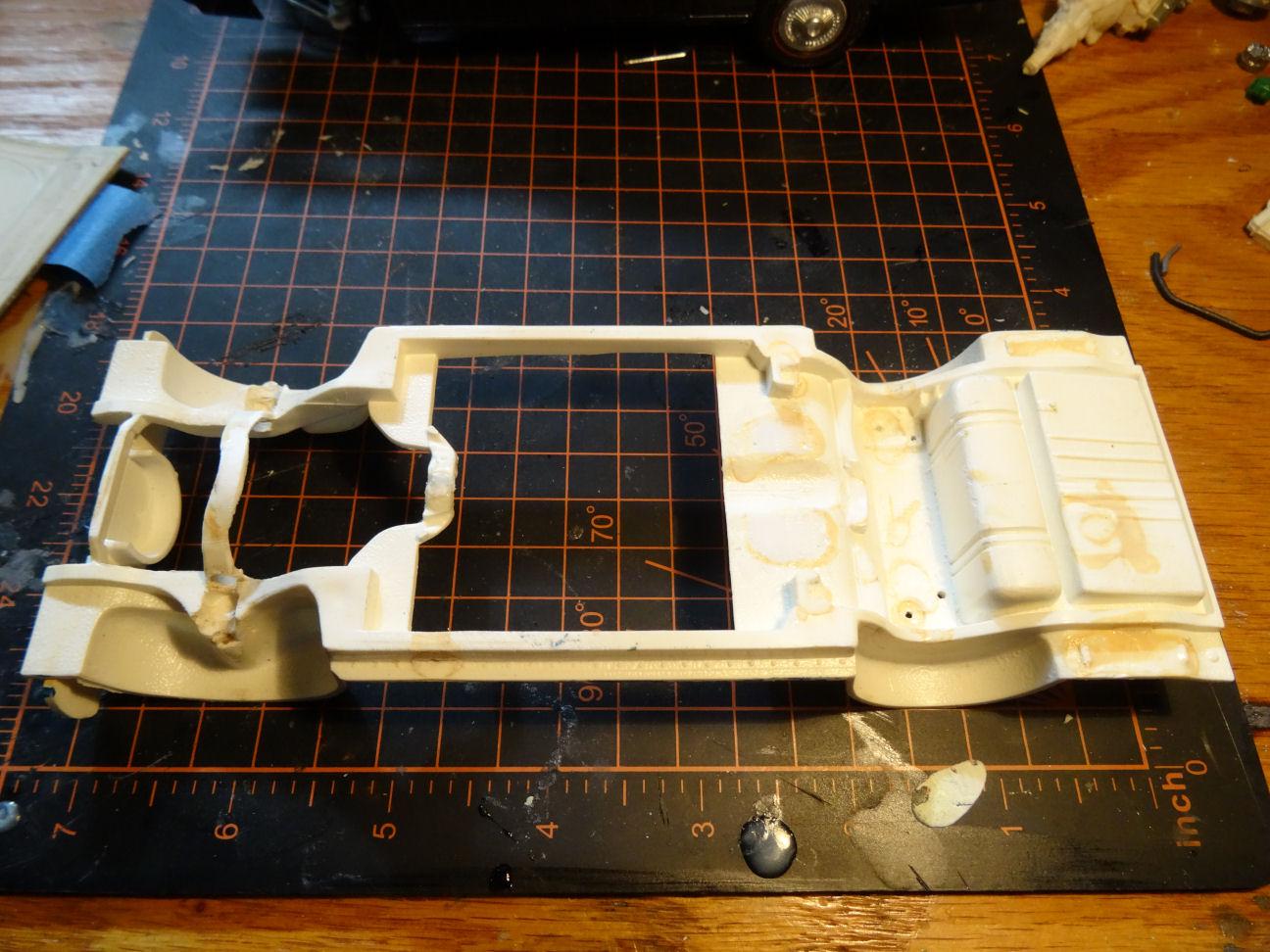

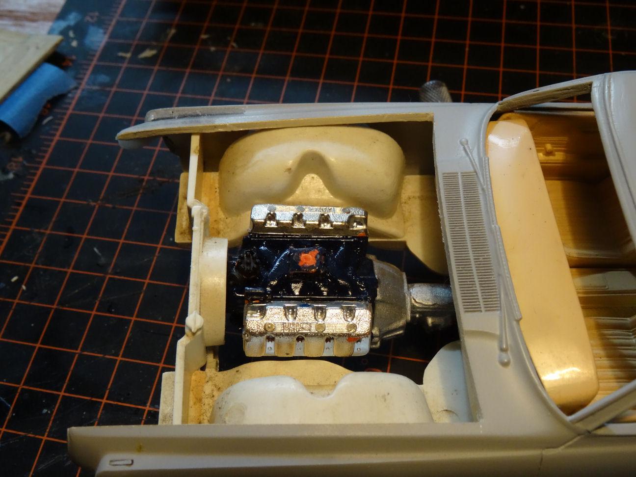

  15. Work progresses on the sad little chassis so I can do a mock up and figure out what is going to fit. First order of business is to clean up the glue bomb. Don't know if anyone else has ever tried this but I will actually apply liquid cement around the glued in pieces to soften the glue before I try to remove pieces. Got everything off and only suffered a little damage. The mufflers did not come off without a fight and actually left two gaping holes behind. Covered the outside of the holes with some duct tape and then poured some casting resin over them from the inside. Trunk floor will need some repair work and the area where the resonators were as well. 1/24th Boss 429 in place and it actually fits rather well. The transmission mount will need to be moved rearwards or the frame mount forwards. We are a little cramped up front but I can move the radiator core support forward so we can squeeze a fan in. But the engine really fills in the engine bay. Think this is the engine we are going to stick with. So off to clean things up a bit more, see ya soon.
