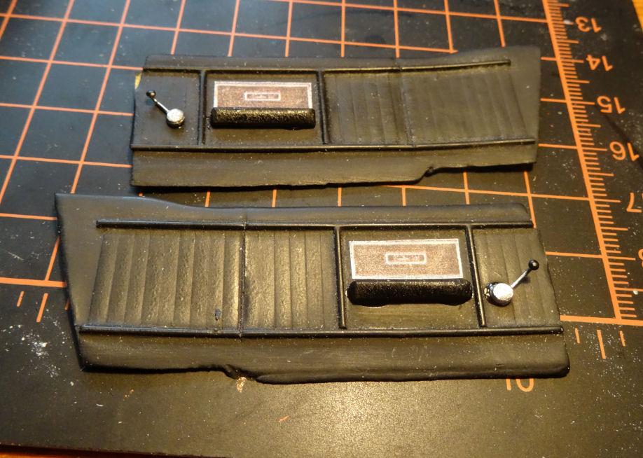

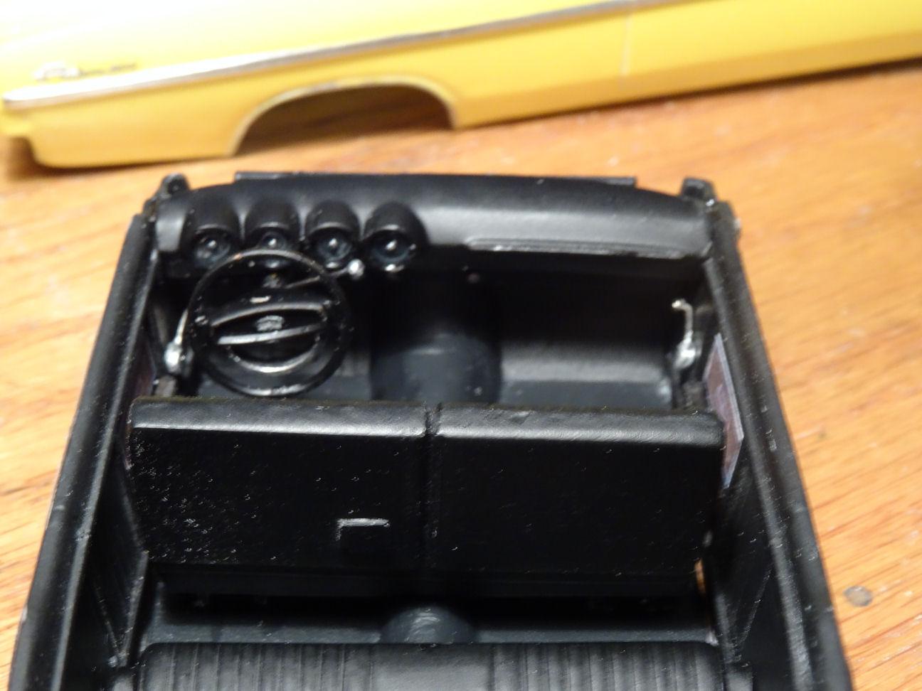

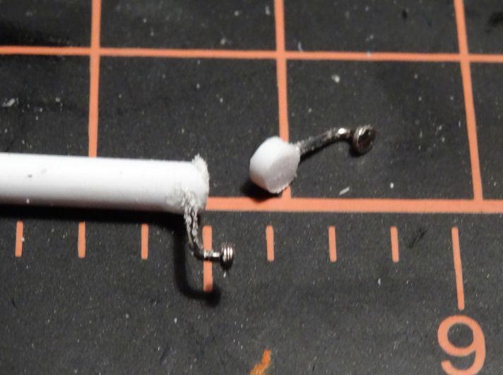

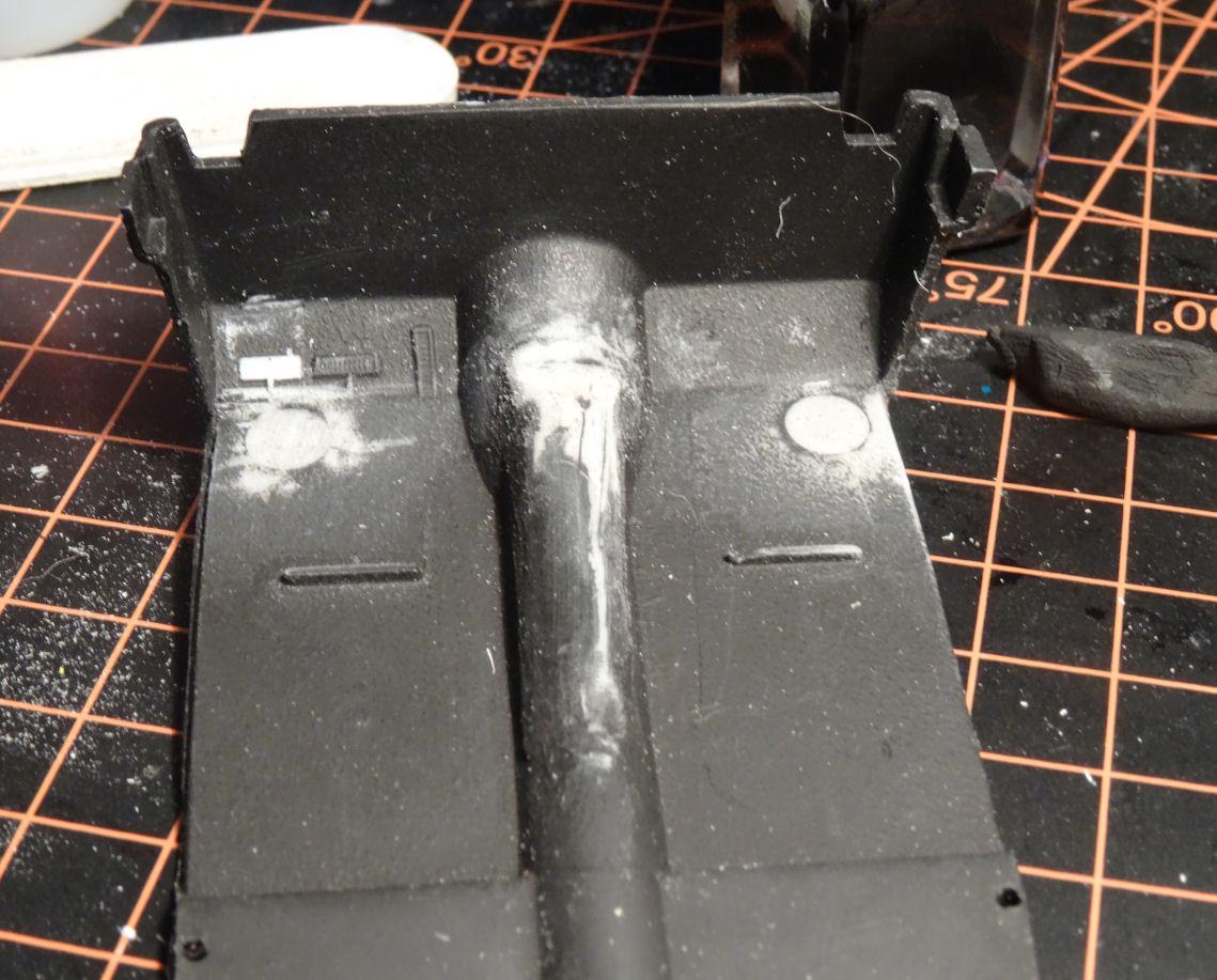

Not sure why but the Fairlane keeps getting pushed to the back of the workbench. In the back, in the corner, in the dark. Dug it out this weekend and made some progress on the interior. Removed the clutch pedal and cleaned up some mold impressions on the floor and finished up on the door panels. I sanded off the Torino door panels and converted them to Fairlane. Vertical ribs were represented with the use of some Tamiya masking tape. The moldings were made from some strip styrene and I printed up the woodgrain inlay that I scanned from a sales brochure. Only problem is I forgot to paint the trim before gluing the panels into place. I will now have to do it after the fact which will be a lot more difficult. Unless I tear the interior apart again. 🙄 I made up arm rests from some scrap and created some window cranks from straight pins that are no longer straight and styrene rod. I found a steering wheel for a 68 Torino in the parts box. Technically the Fairlane center emblem is different, but as AMT screwed up and molded the emblem upside down we are far from correct anyhow. I could theoretically remove the horn ring and reattach it 180 degrees out. But I'm not putting myself through all of that. For the most part all Ford vehicles in 68 used the same steering wheel just changed out the center emblem. '69 wheel was the same ,but the pad was changed as well as the emblem. I added a shifter and turn signal lever to the steering column. The gauges in '68 are black with white lettering, in '69 they changed the background to silver. You can get preprinted gauge faces for the '69 but they are not correct in this instance. So these were detailed by hand and then a drop of epoxy over the top to represent lenses. You can get a good shot of the ashtray on the back of the front seat here. If you recall I fabricated the front seat from a spare back seat. I made castings of the new front seat of which this is one. I've saved the master as I'm sure I will need another bench at some point. Also got the glass installed. I still want to make rear side windows for this. BTW that is not a smudge on the windshield, that's on the bench down below. Thought I got my bloddy fingerprints on it again didn't you, not this time. Maybe next.😯 That's it for now. Hopefully there will be more progress soon.
