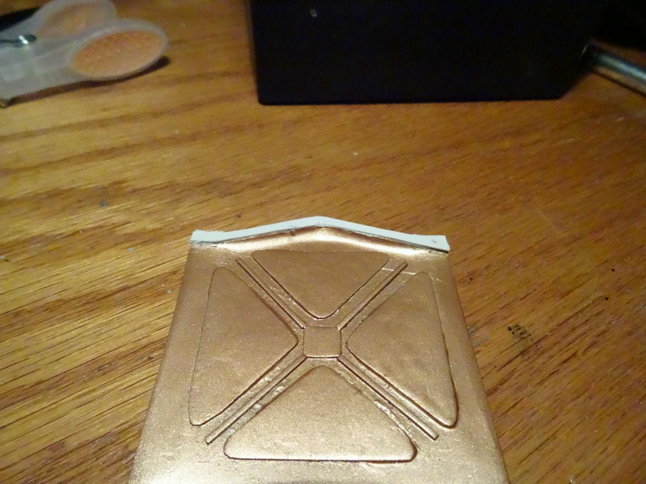

I suppose I should have posted this for the trim guide. I initially tried to fix the Revell trim with this method but as the trim was irregular in shape and thickness it didn't work too well. What I did here which worked like a charm was first to sand the trim down to the proper thickness but leave the edges straight. That left a good even surface for the scriber. After scribing the seam I then rounded off the outer edges. As for the Galaxie I'm currently trying to make a resin mold of the back seat so I can make a copy to turn into a front bench.

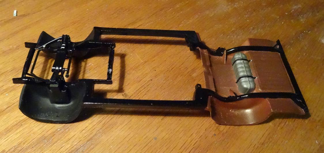

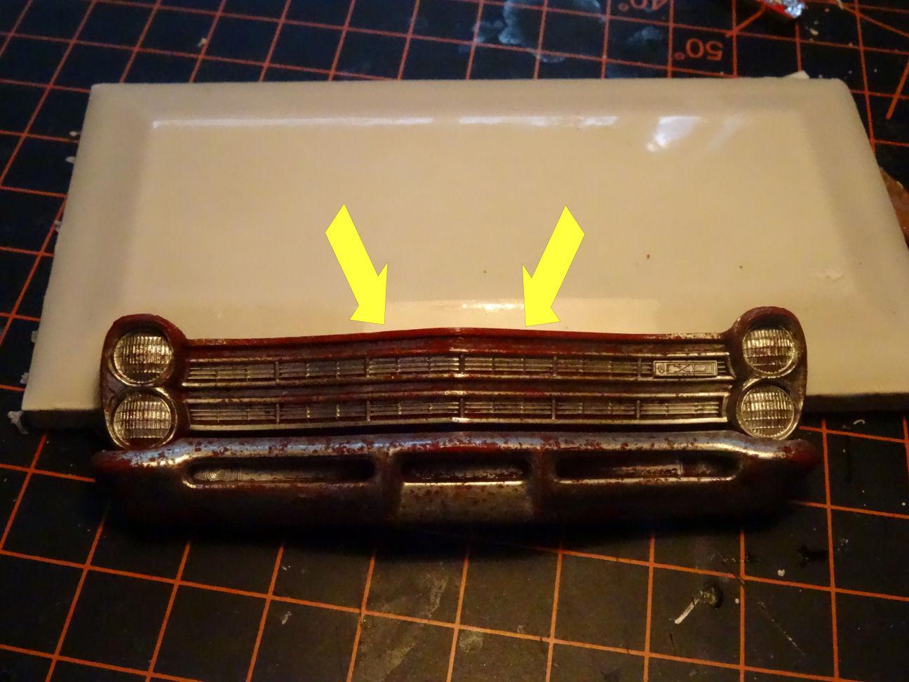

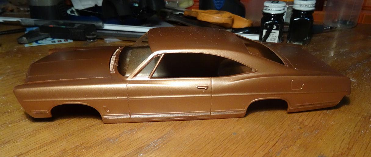

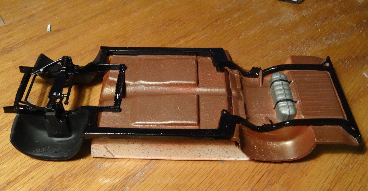

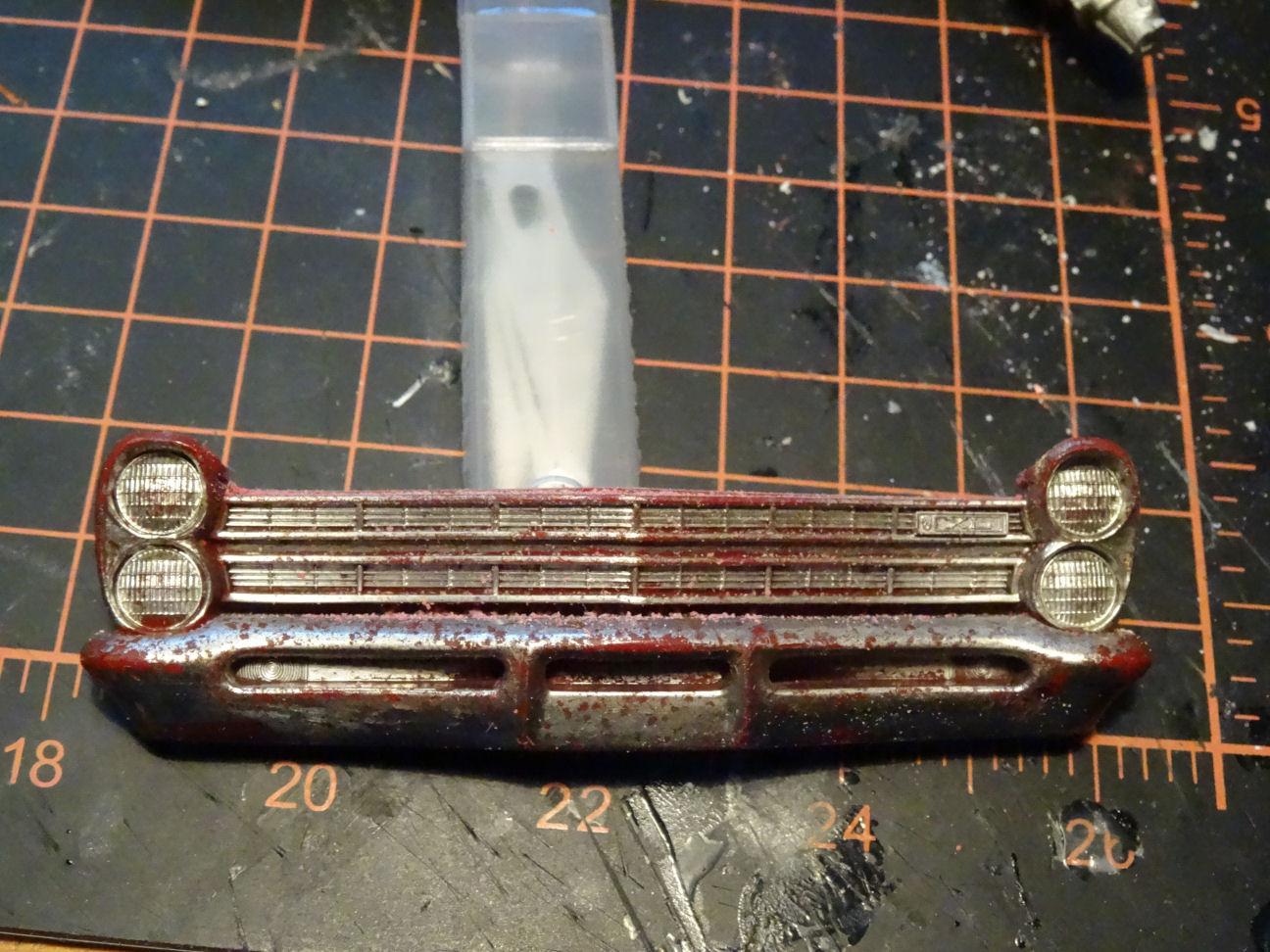

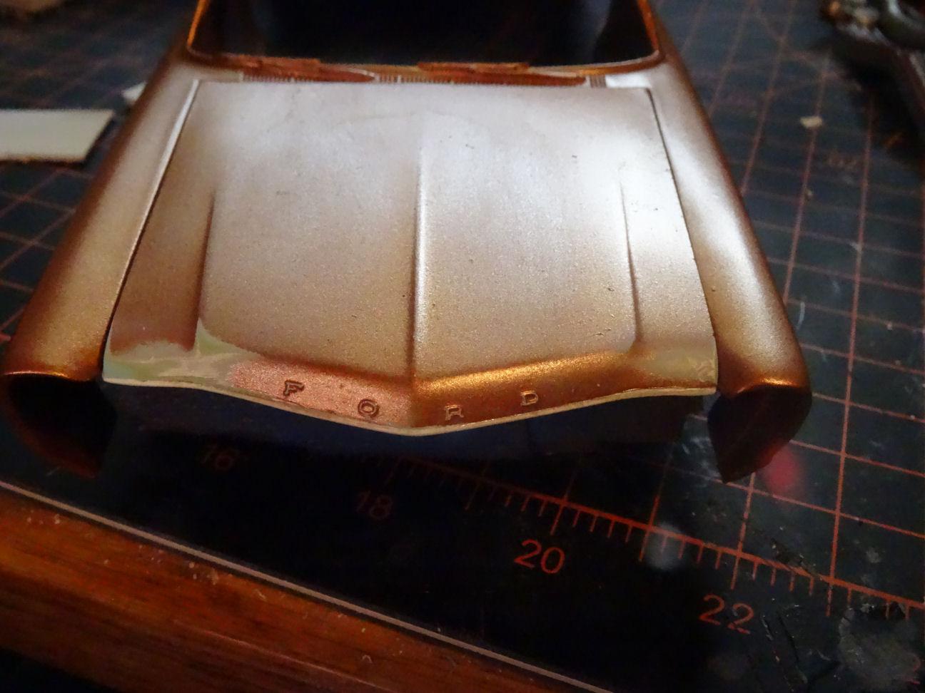

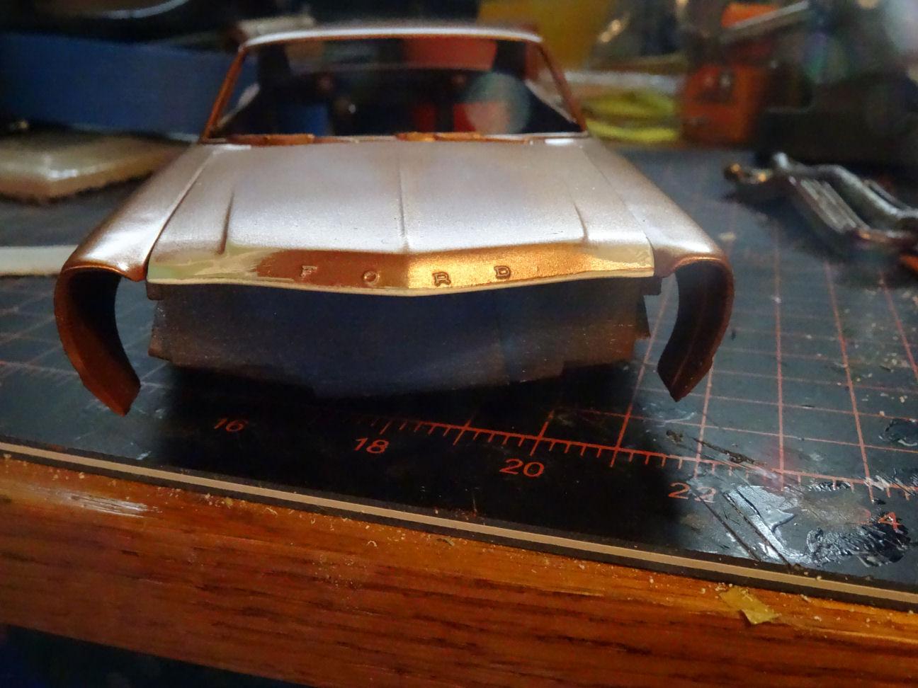

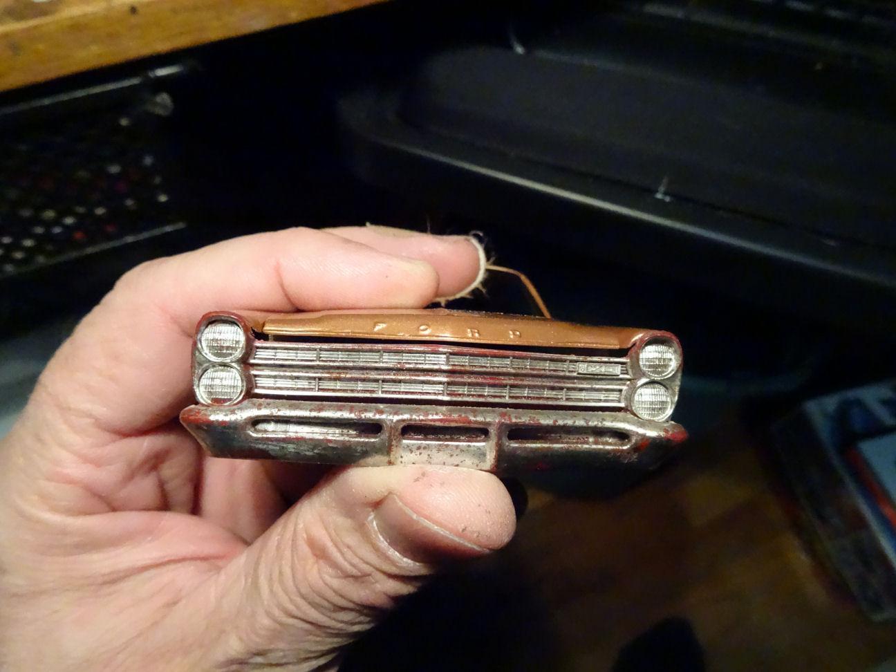

There has been some headway made on Jimmy's Galaxie, although it might fall into the category of one step forward, two back. I had some good weather and I was anxious to get some paint on the body but I probably should have waited. Not that anything went wrong with the paint mind you. I started mocking up the car and realized AMT did a rather silly thing with this car. The have the front hood molding molded as part of the front grill. (say that 3 times fast) For the promo I guess they can be forgiven as the hood doesn't open, but for the kit, sorry but that's a Bozo NoNo.. So despite the hood being painted I needed to do some additional work on it. I took some strip styrene and made a hood molding. Then with the molding on the hood, I removed it from the front bumper assy. Here we have paint on the hood again and my fingers trying to keep everything held together for a quick look-see. I think I am going to do some further work on the bumper unit and open up some of the other cavities like the bumper next to the parking lights. I bet you didn't even see those in there did you? A bit of work has progressed on the chassis as well. With and without the interior in place. There are still things I like to do the old fashioned way. A lot of the bits on the chassis I hand paint with good old Testors, and yes, my jars are old. Can't really tell in the pics but there are 4 or 5 different shades of black at work here. Need to find the rear end next. I'm sure it has highway gears.🥱 And I'll leave you with a pic of the painted body, dust flakes and all. Need to get it clearcoated next and then, Happy Happy Joy Joy, BMF time....
