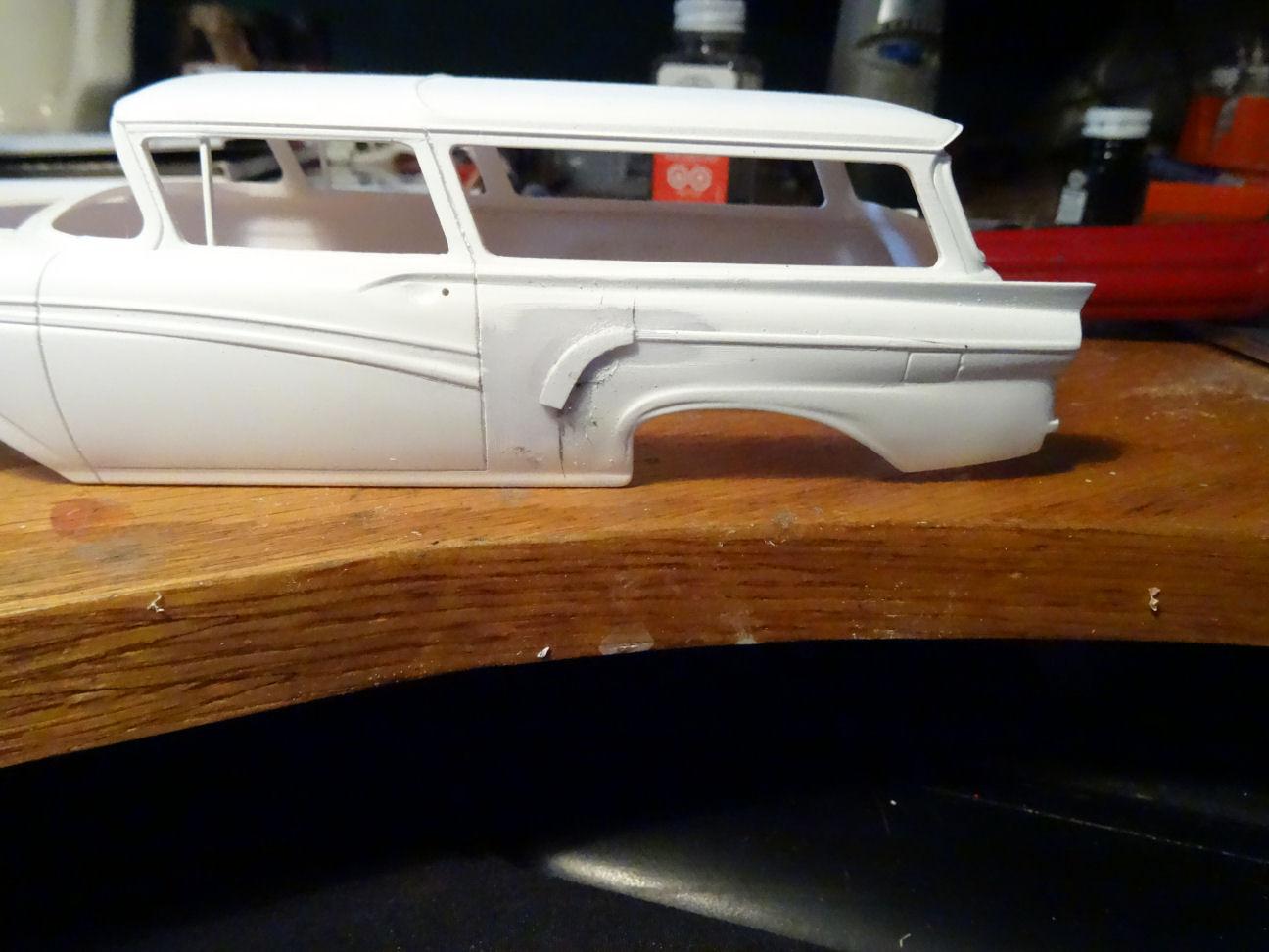

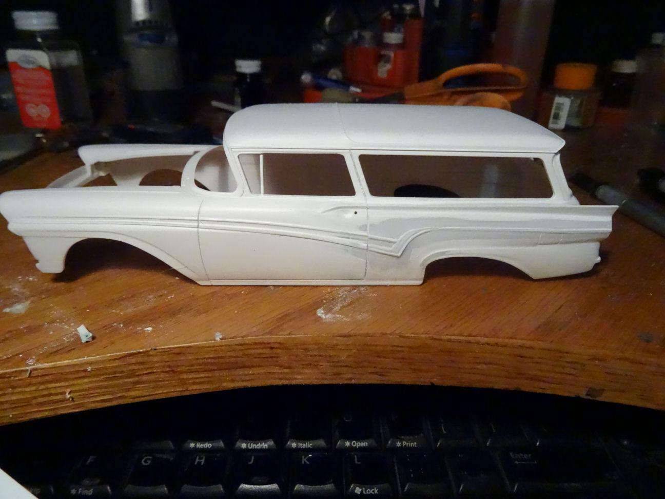

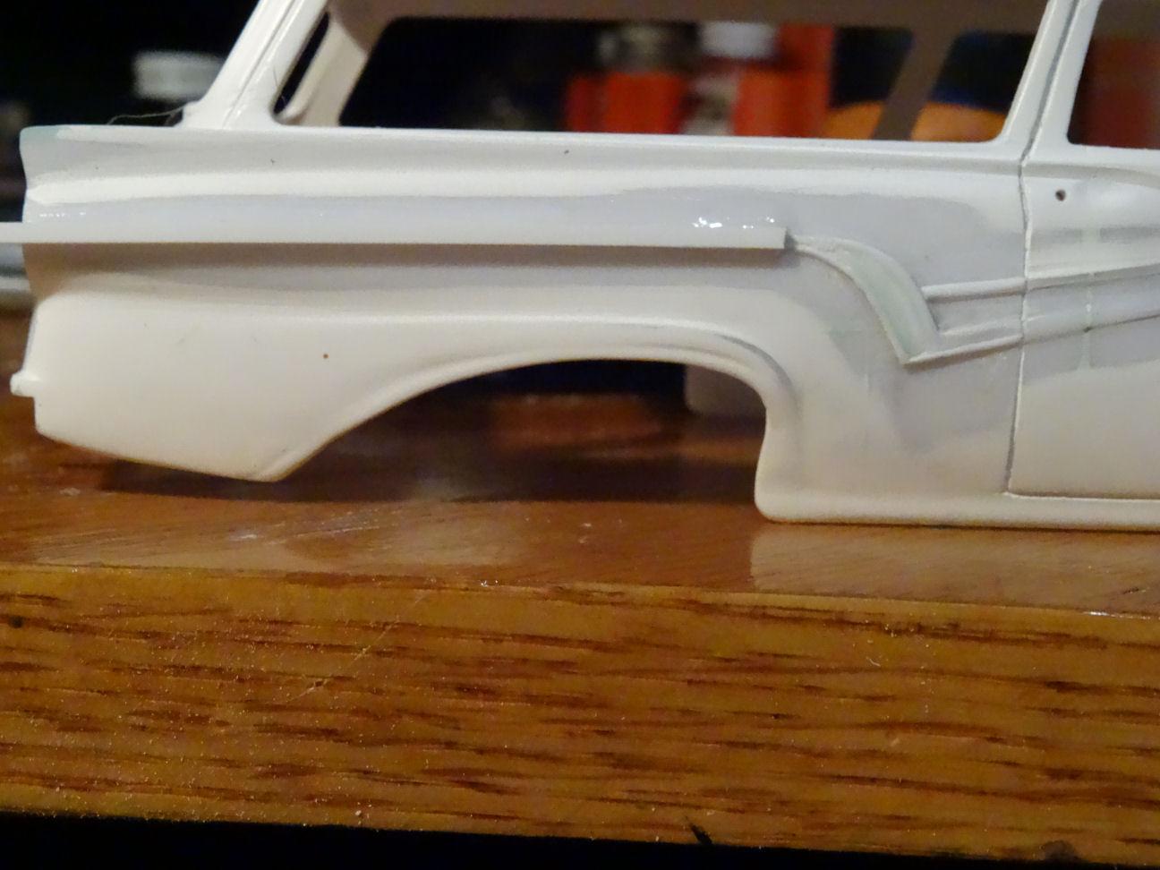

Thanks David.😀 But I was just sitting here and decided I'm not happy with the rear trim section which is Revell's doing. The thickness is irregular and the cove down the center, even after re-scribing, isn't satisfactory. I took it off completely and decided to start from scratch. Glued a piece of square stock in it's place, which is too thick but I will sand it down to the right thickness and scribe it with the patented @Maindrian Pace scribing tool. Once the glue completely dries that is. Wish me luck....😬

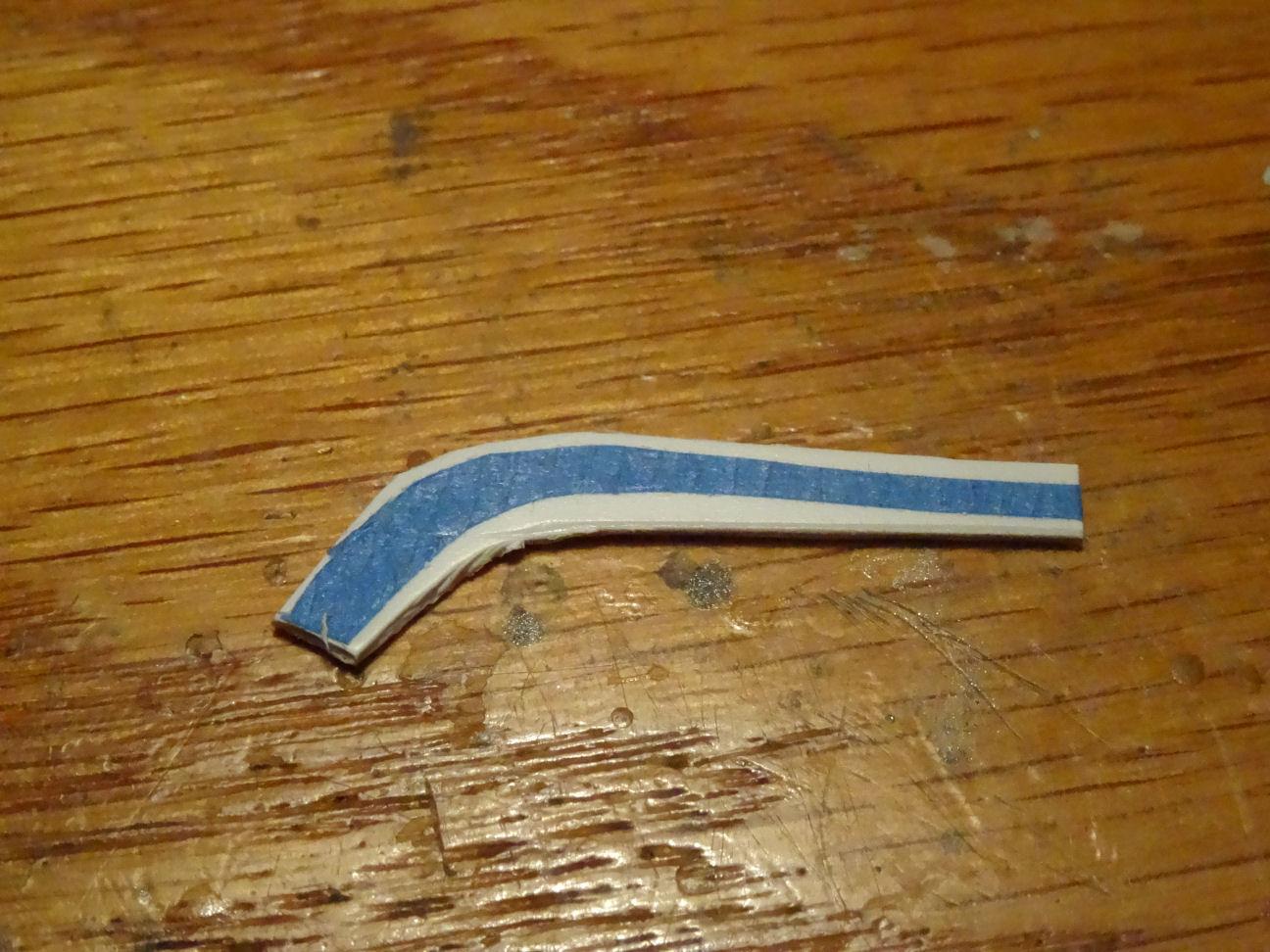

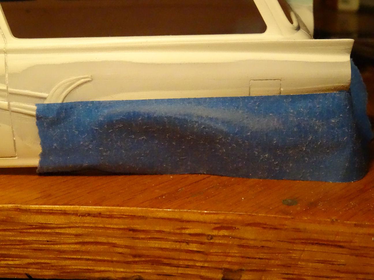

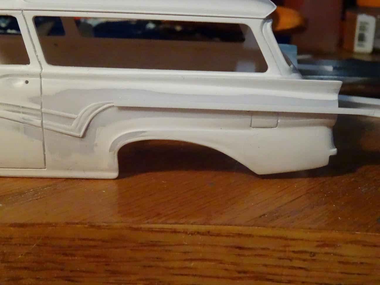

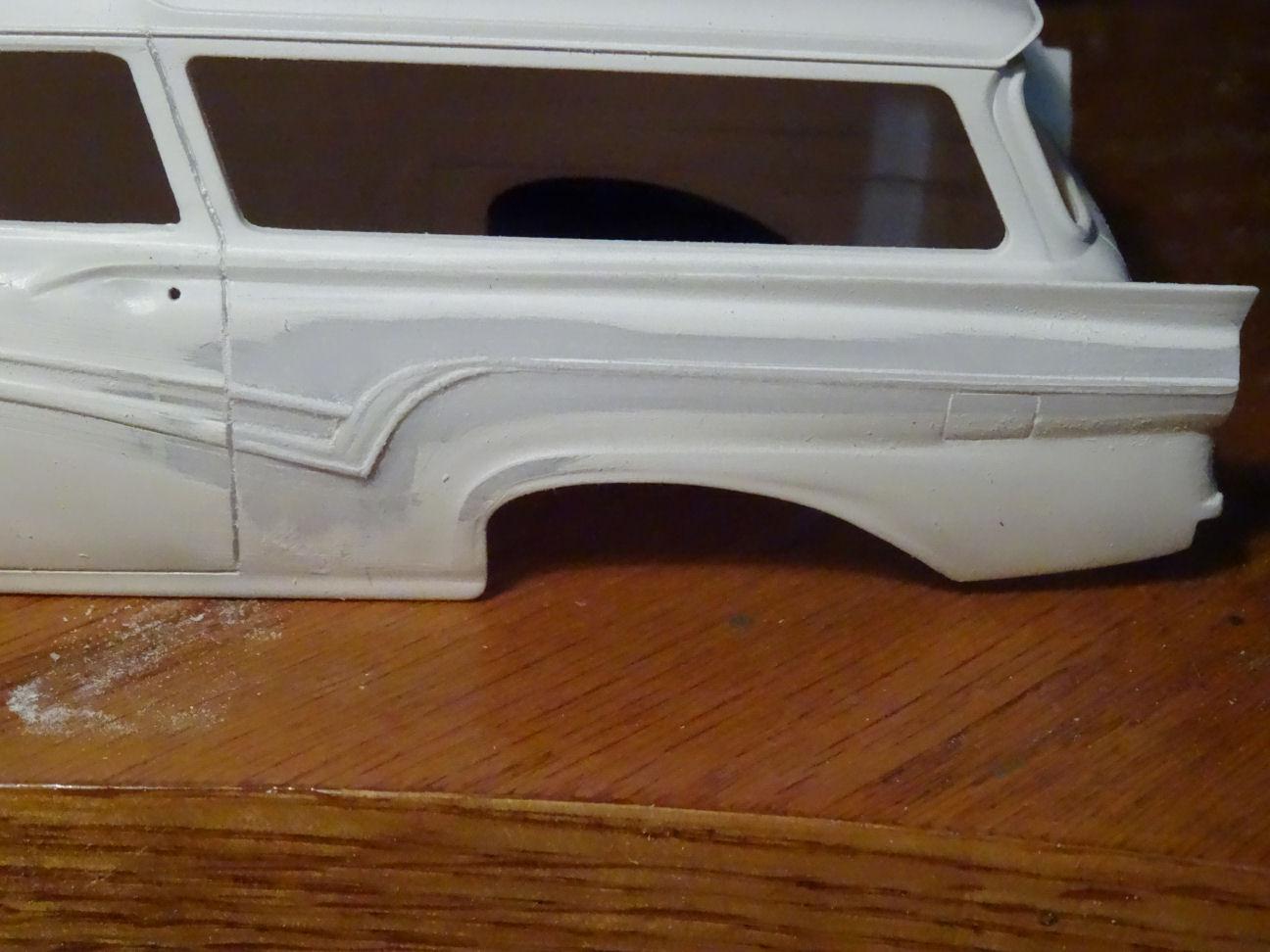

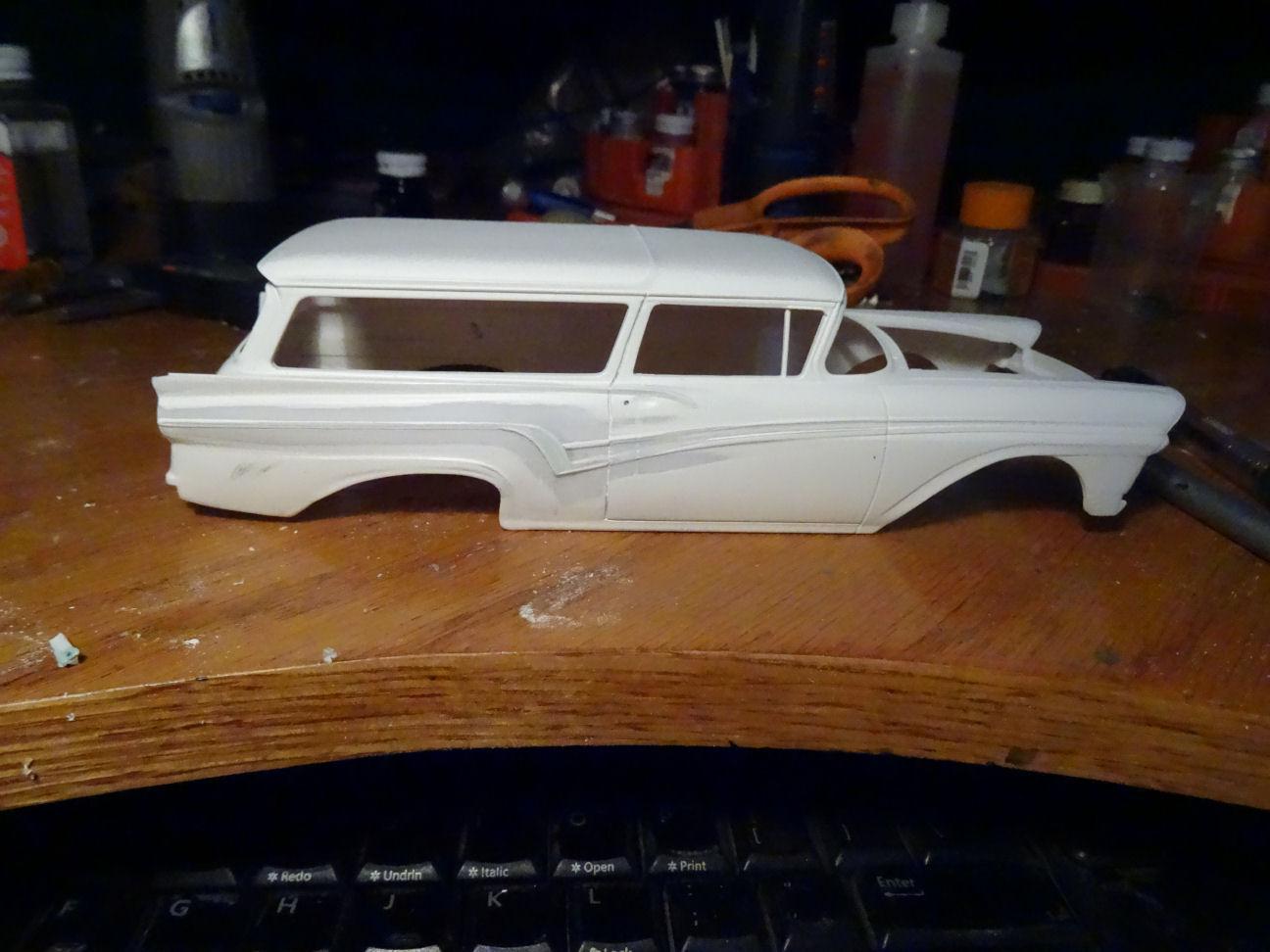

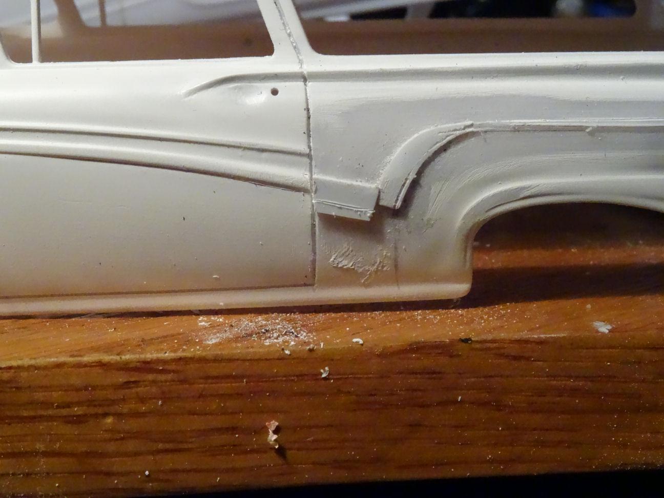

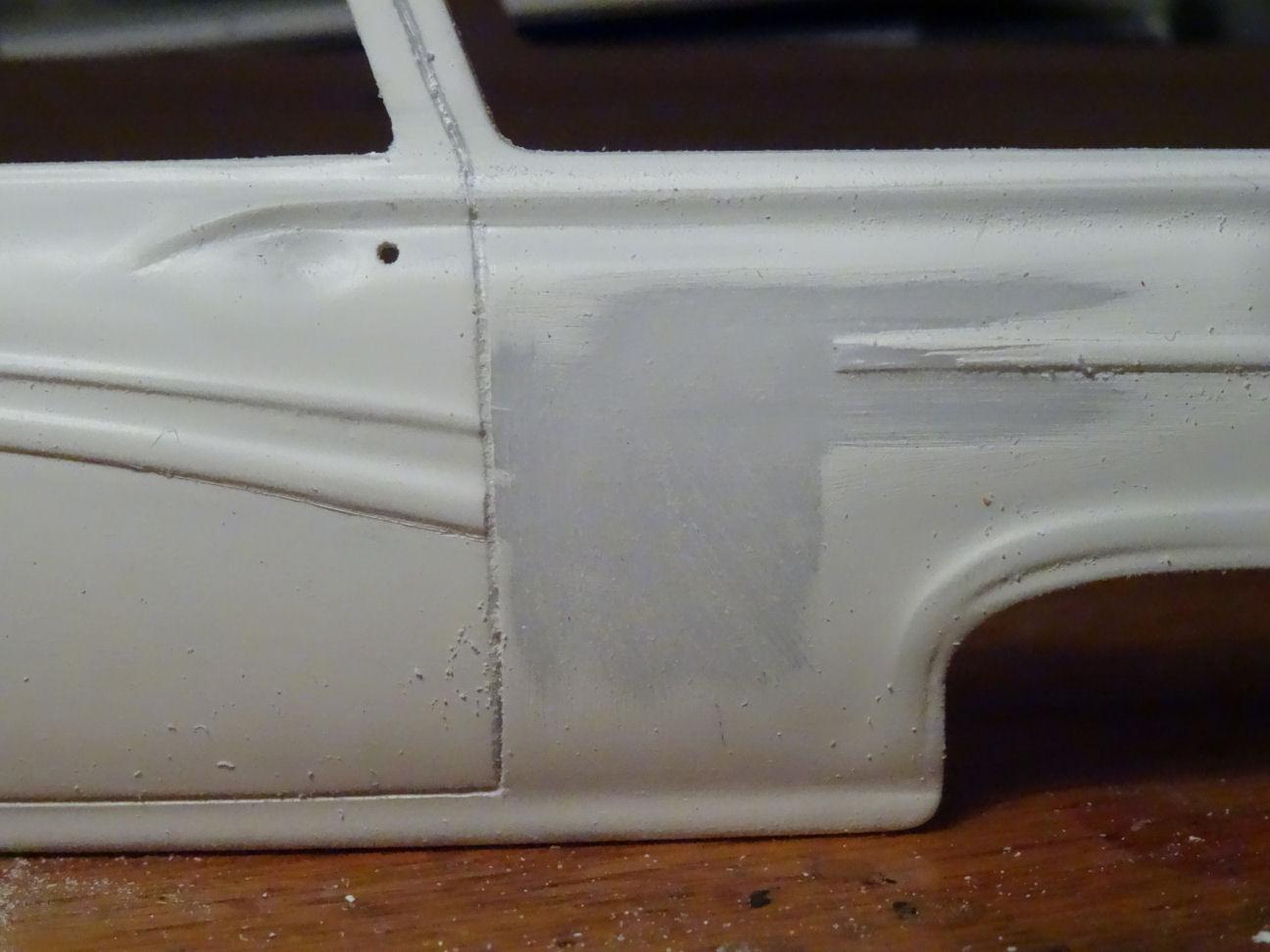

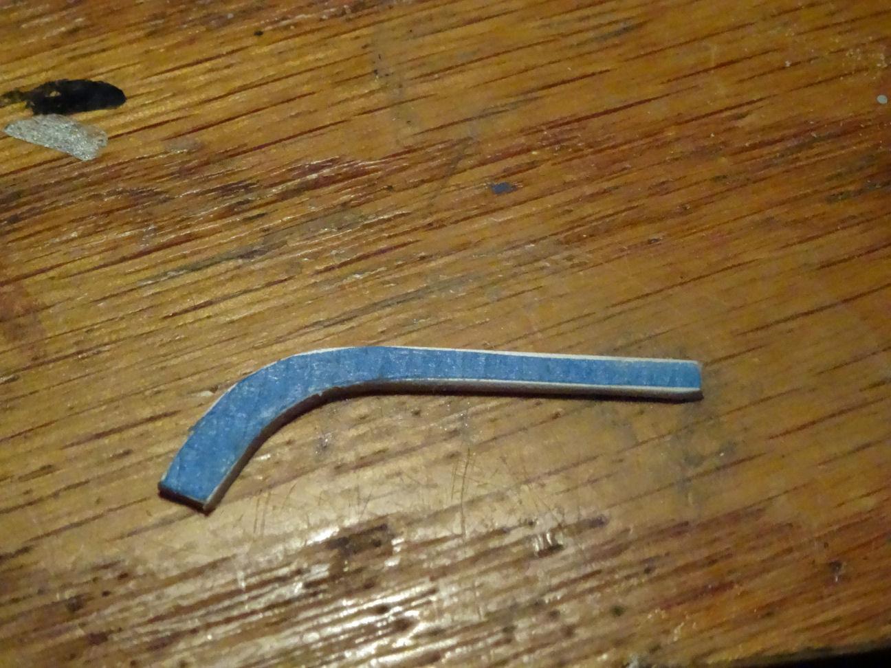

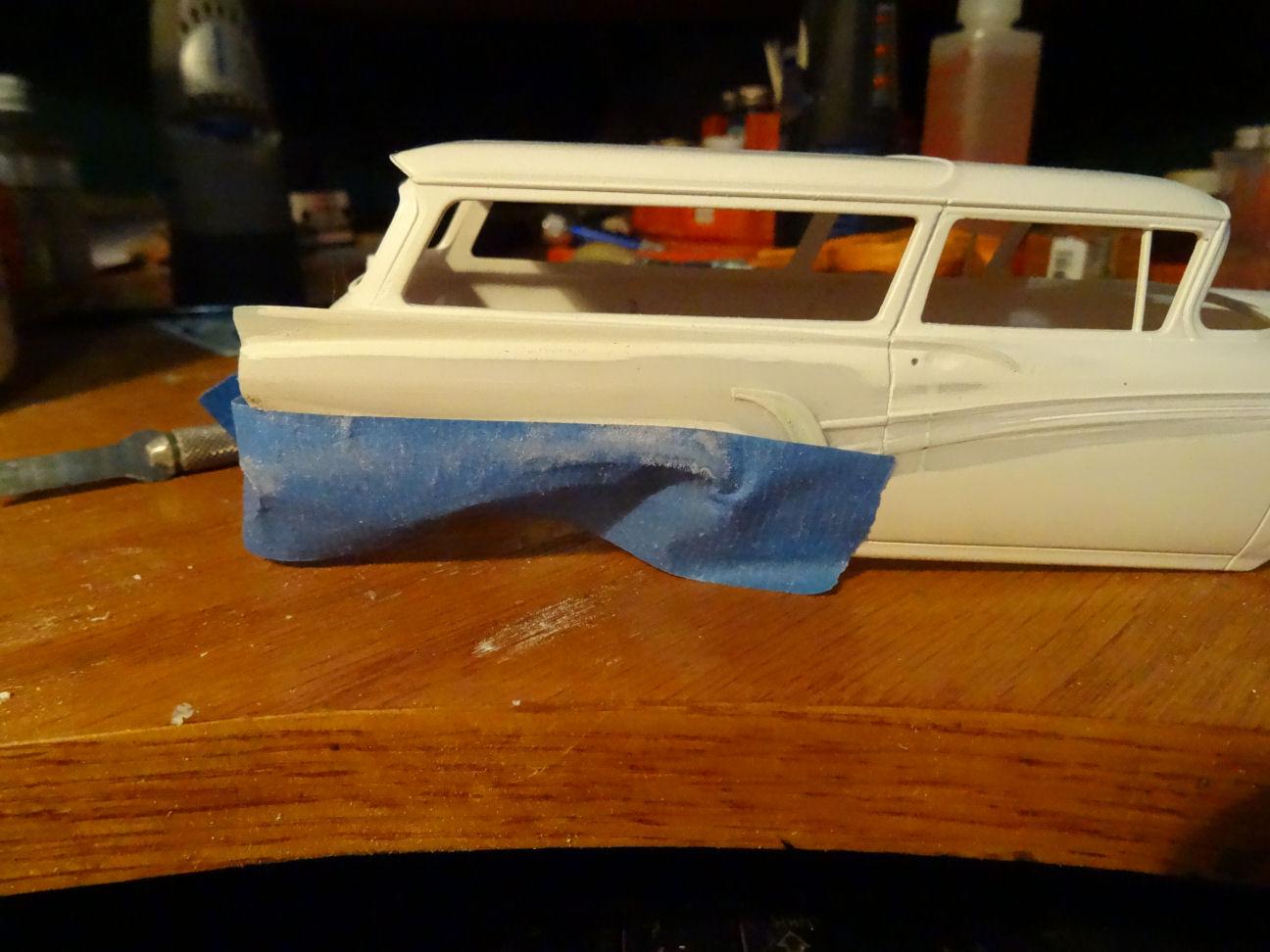

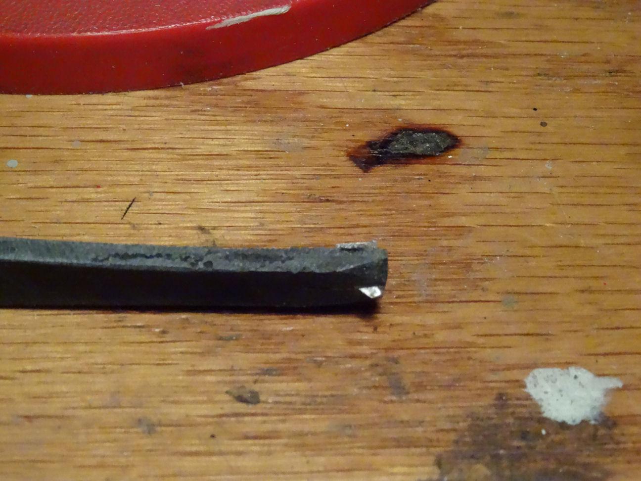

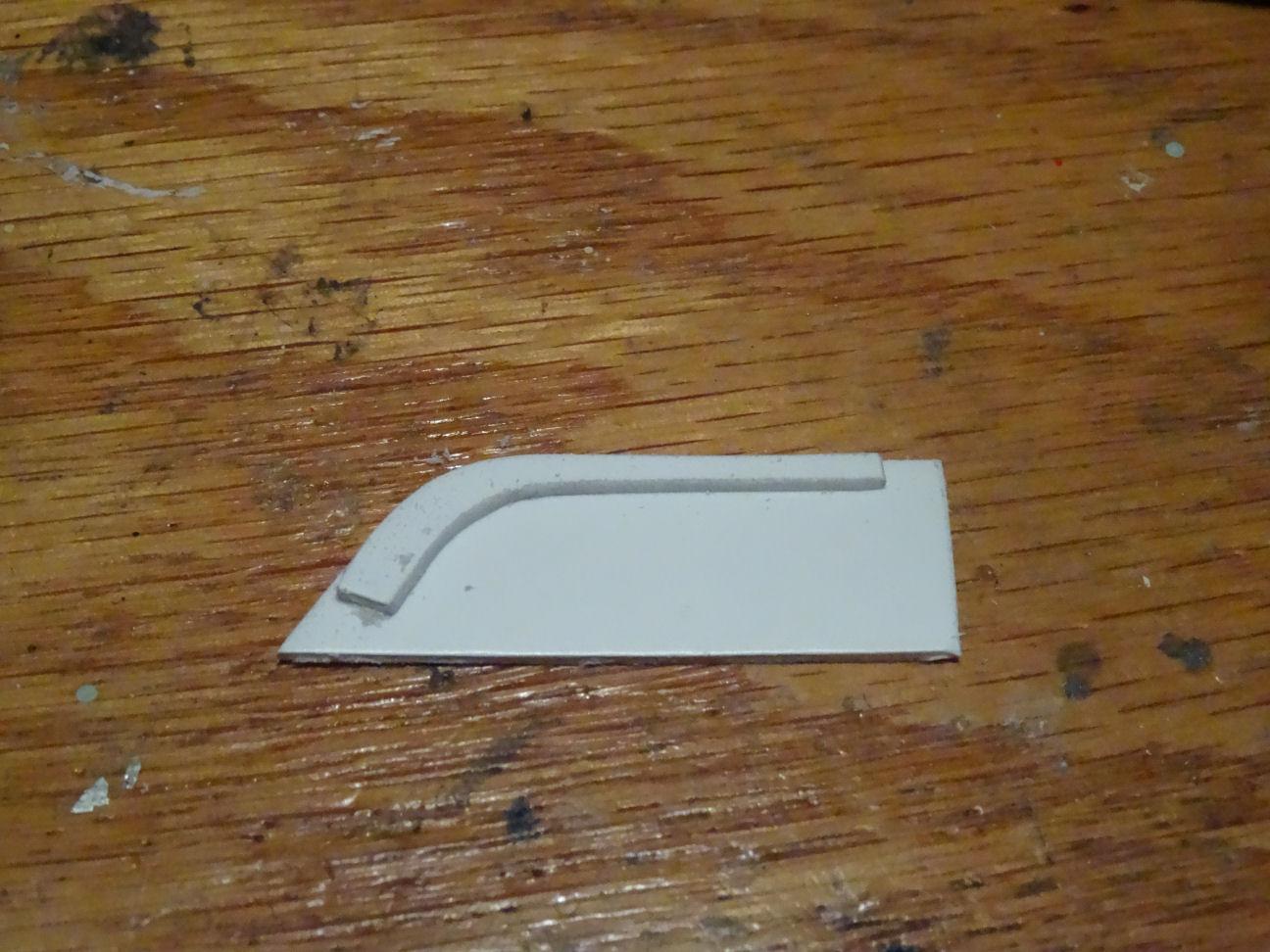

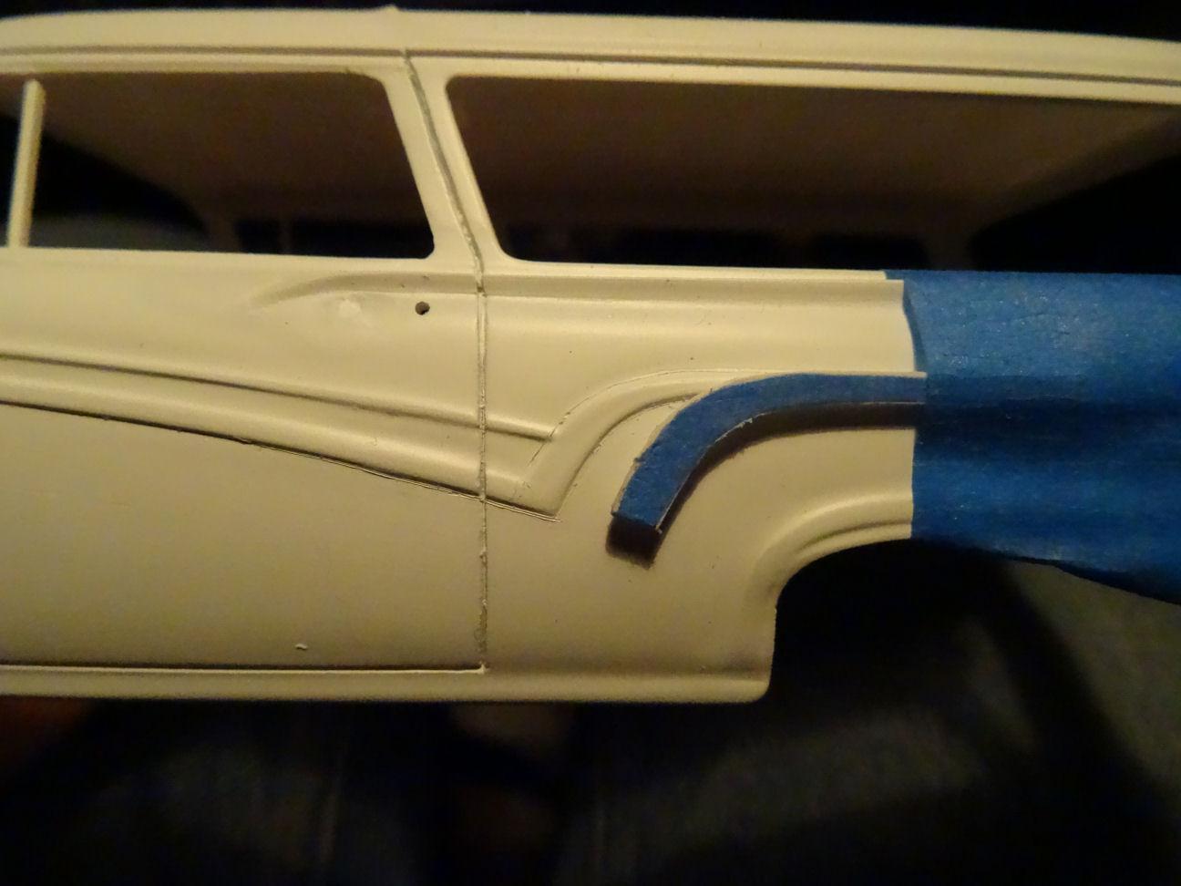

I put the wagon aside for a bit so that all the body work could dry properly but now it's time to get back at it. And we are at the point of tackling that side trim. This is where we either make it work or it all goes to 💩 I started out by tracing the current side trim with some masking tape and laying that on top of some flat styrene, I think .030. Then trimming it down until there was only tape showing. Then taking the piece I made and making a second. I eyeballed it's placement and basically I was looking to have the curve follow the arch over the wheel opening. I sanded the body back down to the bare styrene, if I was smart I probably never would have sprayed the primer on in the first place. I am discovering that the kit trim is not very pronounced and is actually rather uneven in thickness, Revell could have done a better job with it. Almost considered taking it all off and starting from scratch. The pieces were glued in place and at this point you can see they are thicker then they need to be. I made myself a scribe tool steeling the idea from @Maindrian Pace and I used this to sharpen some of the detail on the Revell trim and etch a reference mark on my pieces. Looks very crude here but I have added the bottom leg that extends forward and left it oversized so I can trim it down to fit. I started scribing on the hockey stick here which will later make more sense. Here you can see why I was scribing those lines as the trim is beginning to look like something. It still needs a bit more cleanup work but it is beginning to take shape and not looking all that bad. Time to let it sit a bit to dry and then we will fuss with it some more. See ya next time....
