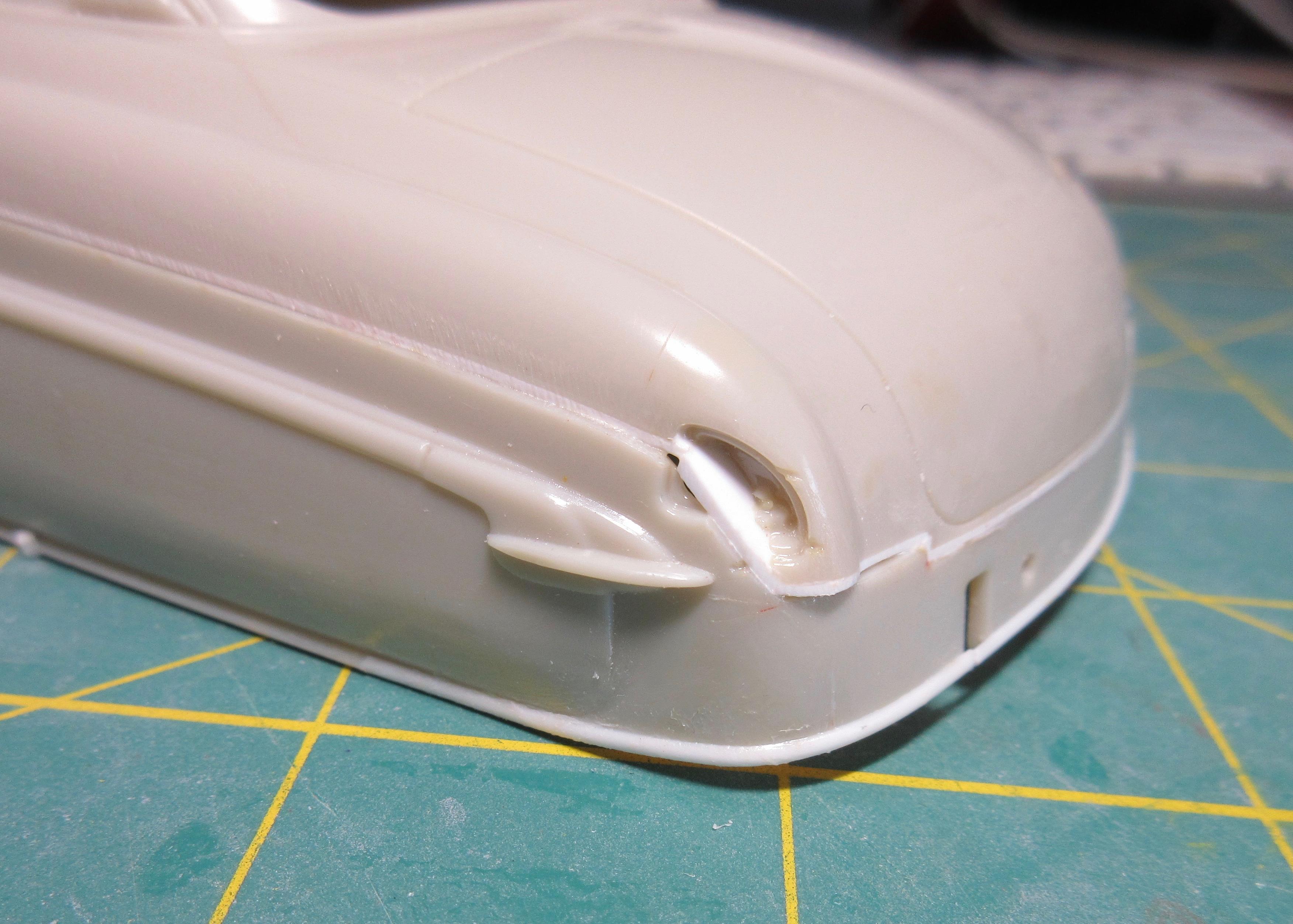

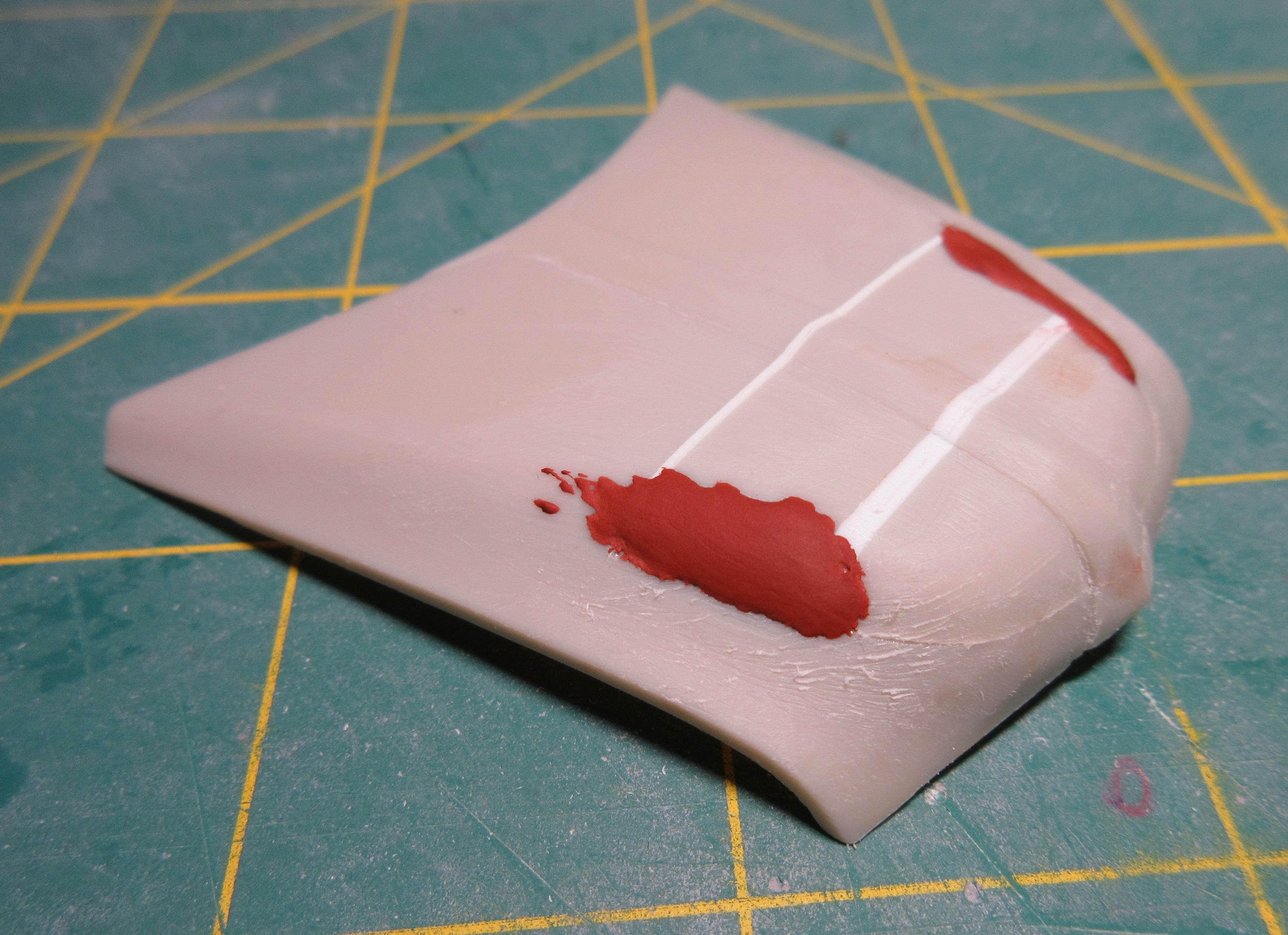

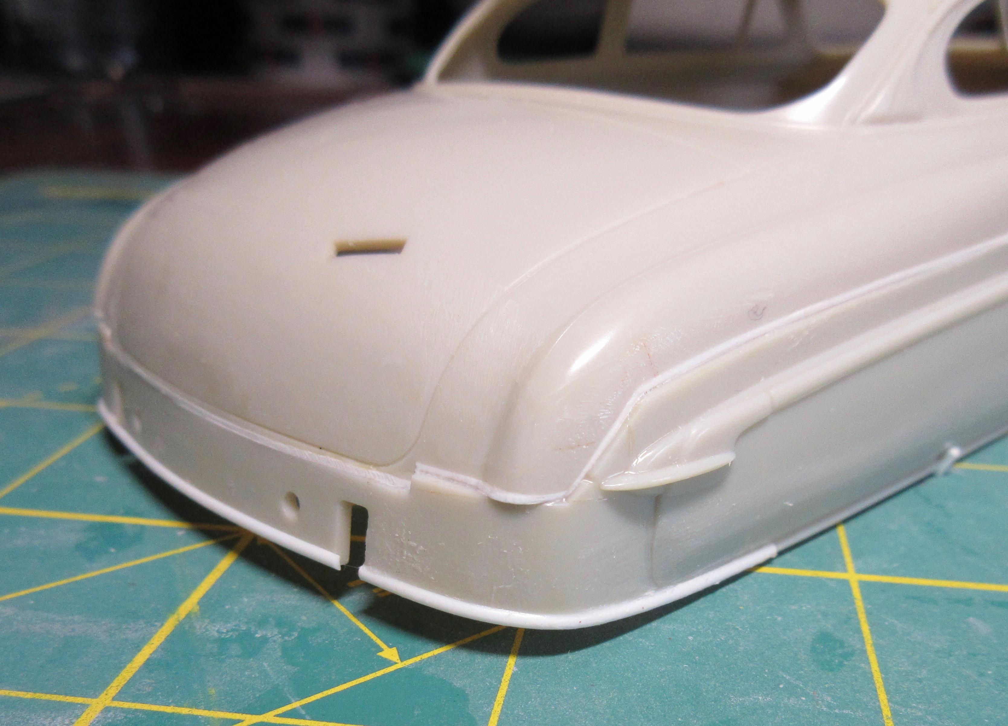

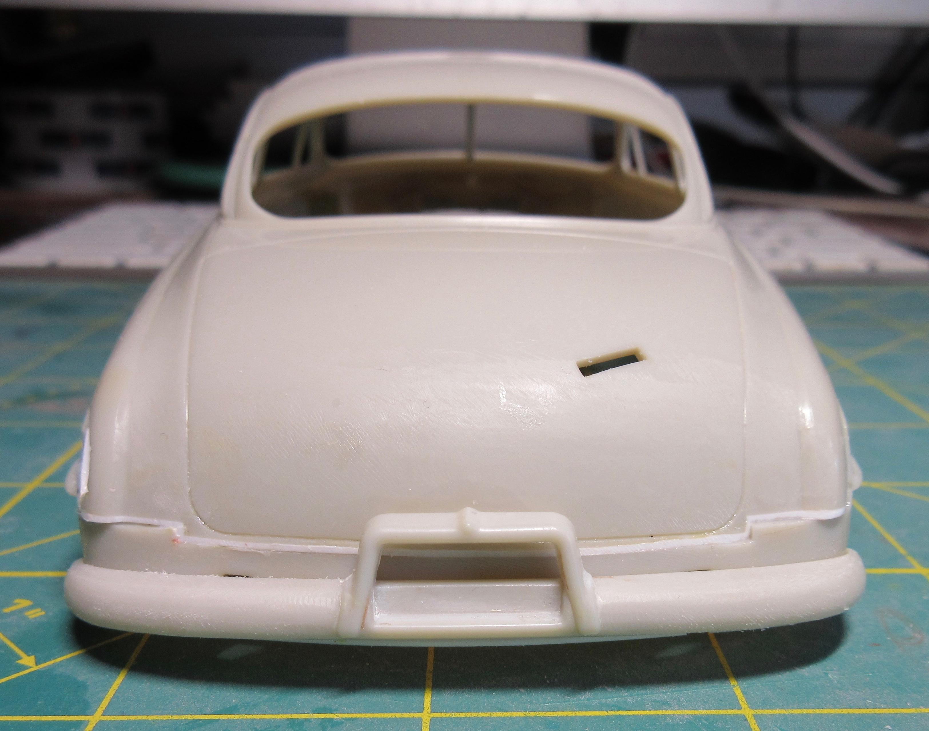

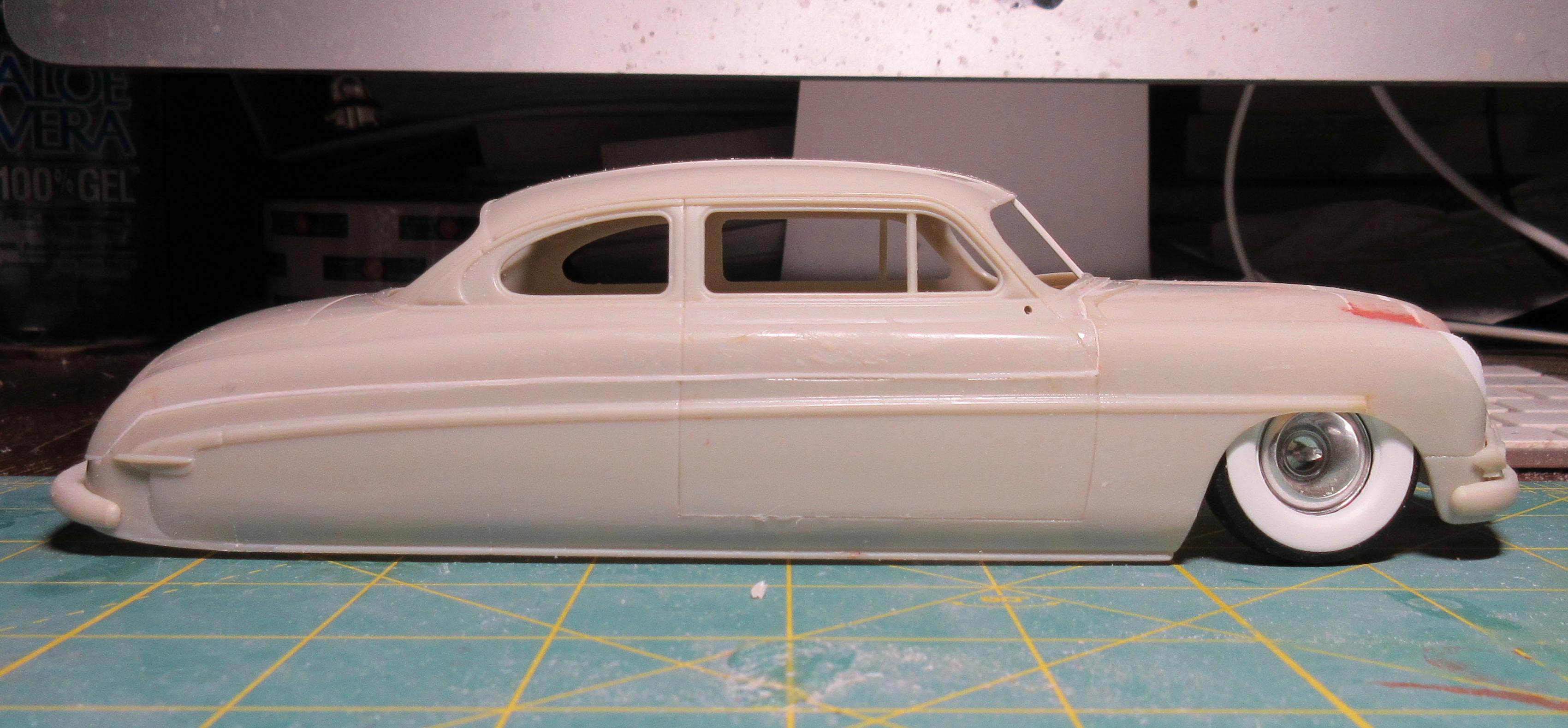

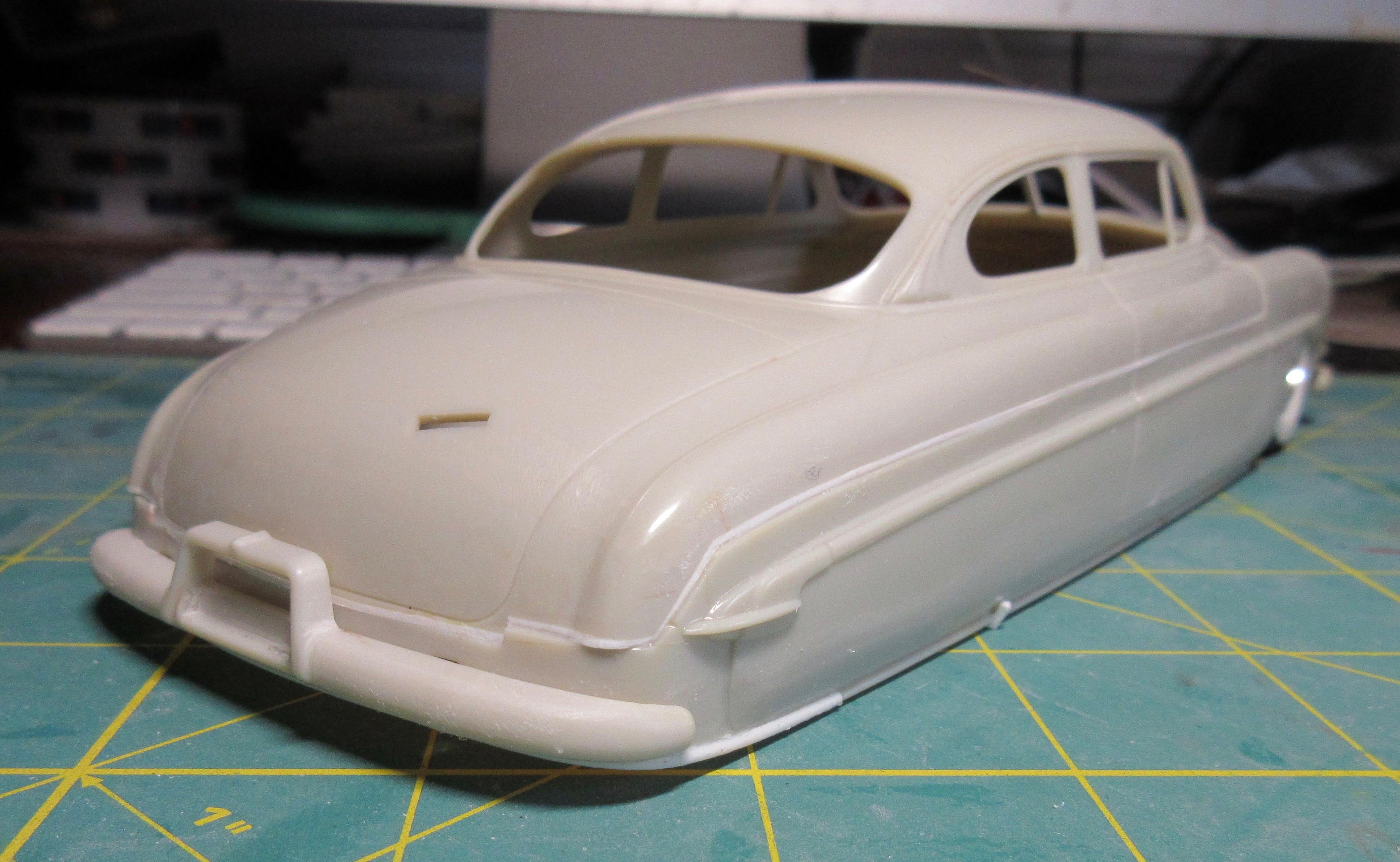

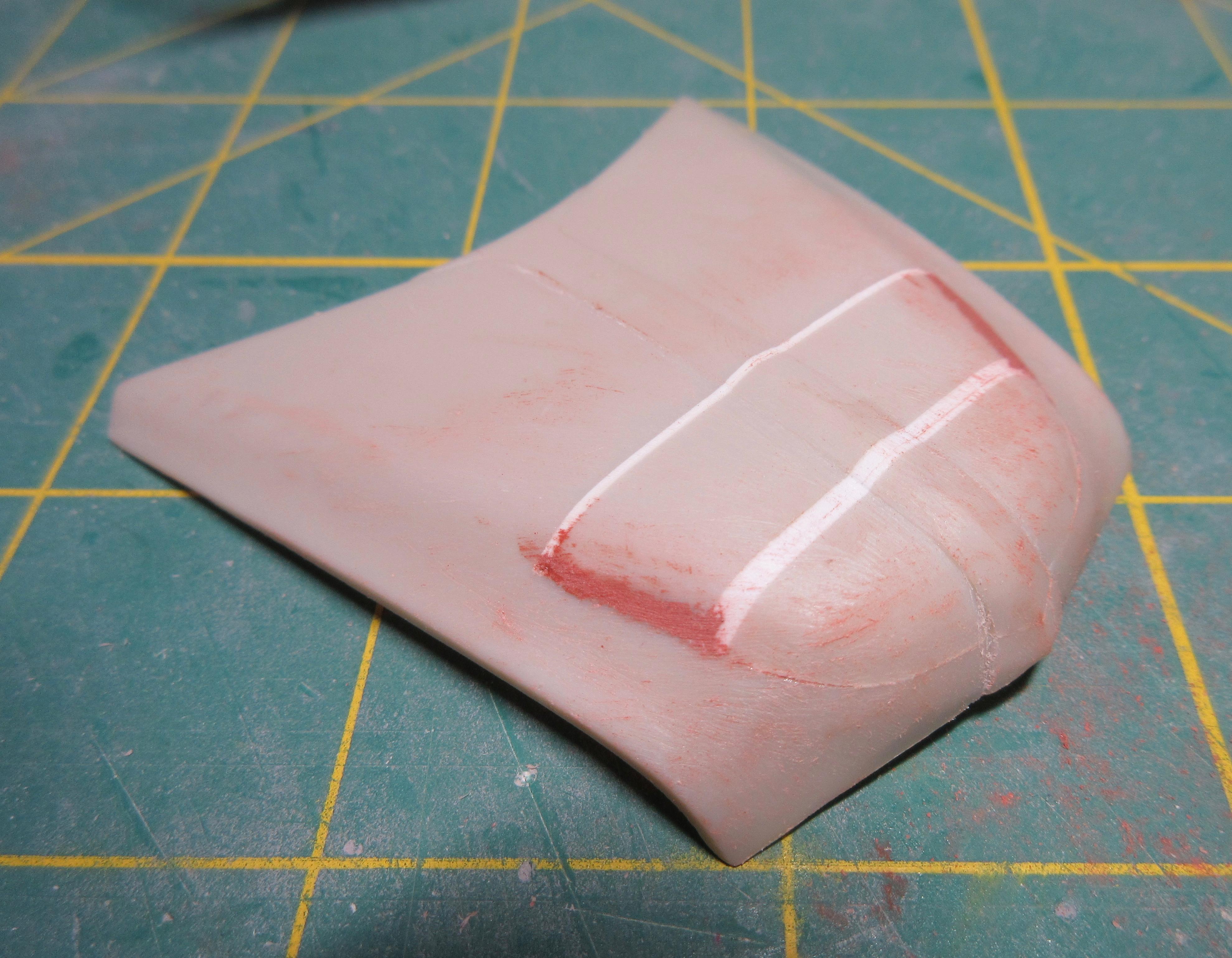

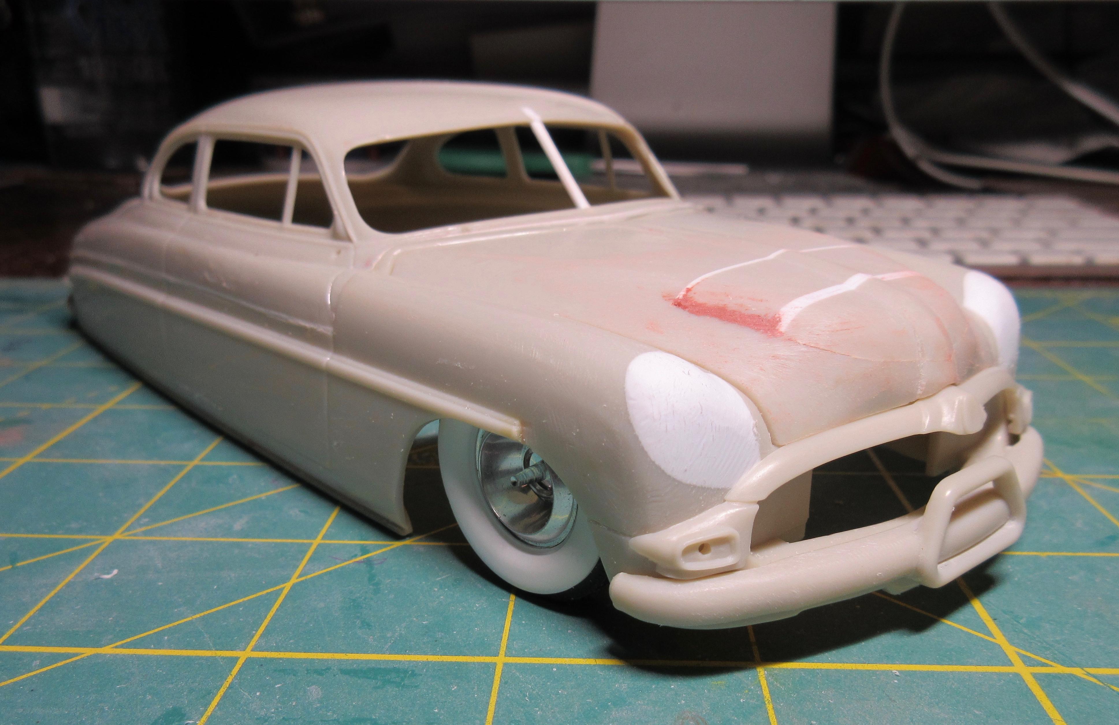

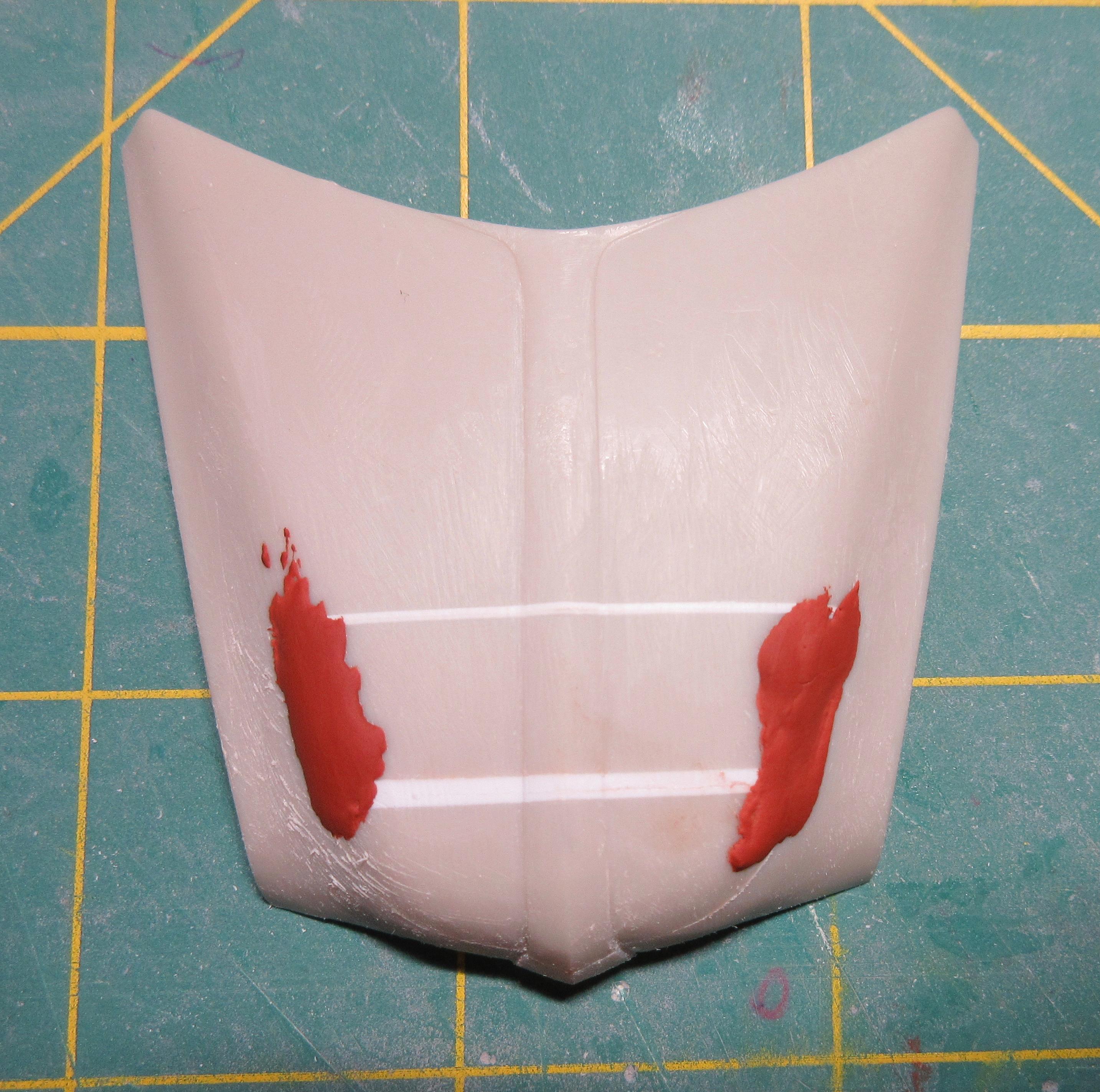

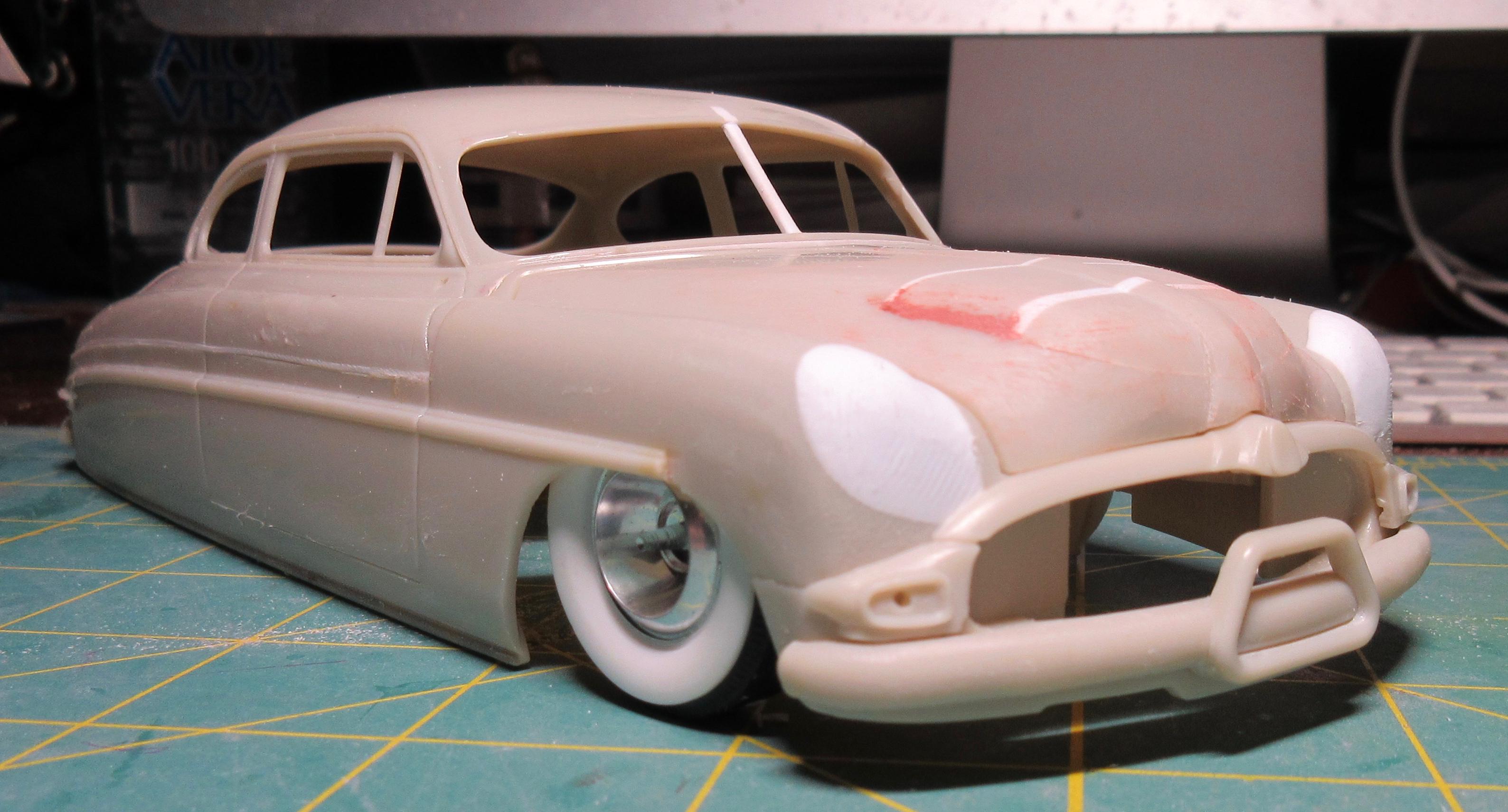

Small, maybe big update. Got the two body halves joined together and some additional work. Got the hood rough shaped and some putty put on. I don't usually like to use putty if I don't have to, but these were odd shaped spots and it was the easiest. I use BONDO one part glazing putty and find it works nicely: Another shot of the putty and shaping. It's nice that the hood has such a prominent feature down the center of the hood, I used it to line up my pieces: The putty on the hood sanded and hood shaped. It was easy work with a file to get it all flowing together. I had to work out some angles to smooth curves at the joints. The transition at the very front of the hood required some careful cutting and filing to get to work but it came out ok: And a mock up. The new sloped front end is shaping up nicely. You can see it slopes a lot more than stock for that cool streamlined look. I think the front bumper looks better without the guards, but I like that trapezoid guard in the center and it matches the rear so it's staying: Another angle showing the sloped hood off nicely. Think I'll work on getting the side trim to meet up with the grill surround next: Profile. The front really slopes. I finally got the body joined. It was a bit of a trick, had to take it apart once and adjust the rear to split the misalignment between the two sides, but it's done, ready for filling, filing and sanding. You can see the .020 filler to get the fenders to join up. The joints were nice and tight with only two gaps that I'll have to address later. One you can see on the passenger's side door, below the .020 filler piece and the other is at the rear corner of the driver's side, not bad for such a curved joint: Rear 3/4. I got rid of the bumper guards for a cleaner look. It will need filling, filing and sanding to get it all to blend. But it's looking lean, mean and streamlined. Love the stock trim down the middle of the side. Really has a nice flow. Gotta come up with taillights too: Dead on the rear. Looks better without the bumper guards, but I like the license plate surround so that's staying. Gotta fill that rectangular hole in the trunk. You can see the other gap here, it's on the left, the corner, just bellow the .020 filler piece: Added some .040 1/2 round to extend the remaining rocker molding around the rear: The .040 half round is slightly wider than the rocker molding so it will have to be filed to match its shape: And one last shot of the rocker molding extended. I liked this small bead around the base as it anchors the car, the rest of the lower chrome moldings were sanded off as I felt it masked the clean design of the sides: As always, thanks for stopping by and taking a look!
