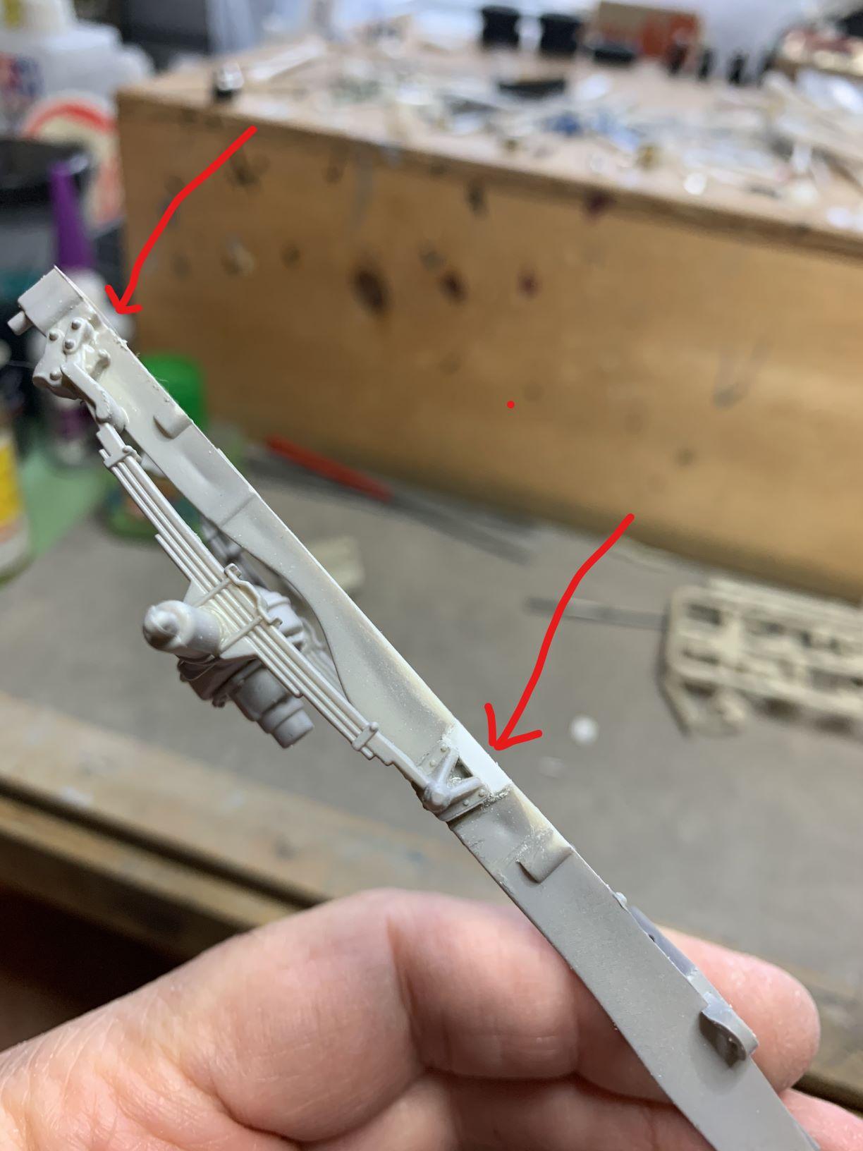

1: I needed to lengthen the rear of the frame so I glued 2 pieces of styrene together to the thickness of the frame and drilled and pinned extensions. 2: I made the very rear from 2 different sizes but now I have the length I need for this old pickup. 3: I made the cab floor from a '60 Starliner kit, it had to fit the original interior, after I cut that floor out, and the new frame. 4: I added some ribs, opposite of the topside, and positioned them so the frame fits right in.

I'm modifying a Mobius frame, and using Fireball's F-250 kit and the "Upgrade" kit. Started with a short wheelbase and had to lengthen it about 1/4". Could've started with the long wheelbase frame, easier to shorten, but I've done the lengthening successfully, and will show that soon. Your idea of the Foose chassis sounds great!

Great work so far! I also converted a short box to 4X4, and lowered the rear springs on the frame to make the rear sit a bit higher, here's how: Just opened up the slots and slid them down and filled in the tops where the spring mounts were supposed to fit. -
