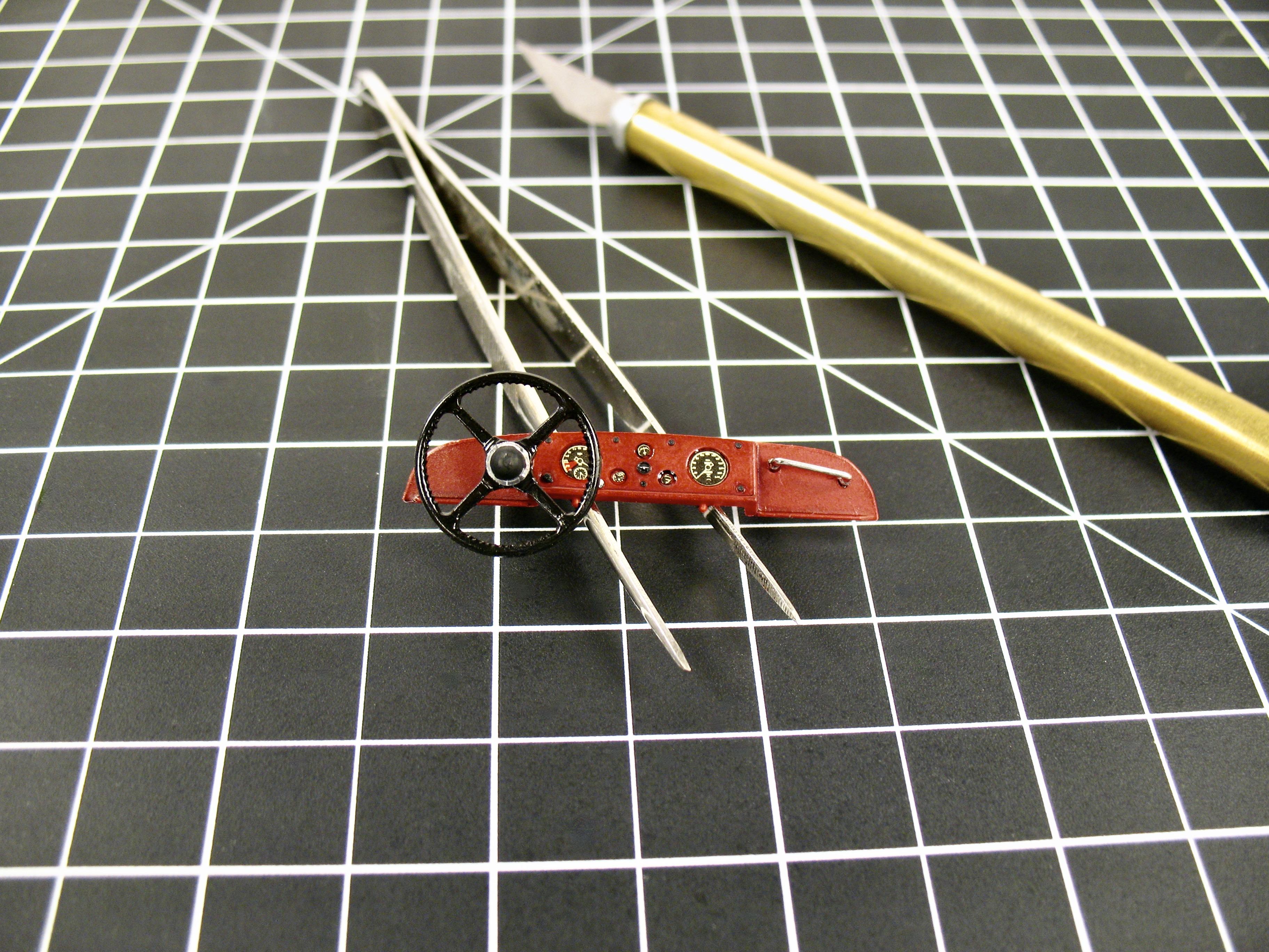

Finally some progress on this one. I almost forgot this kit. The chassis is completed, I redid the shocks, adding a real metal spring, and also modified the front hubs, so now the car can steer.

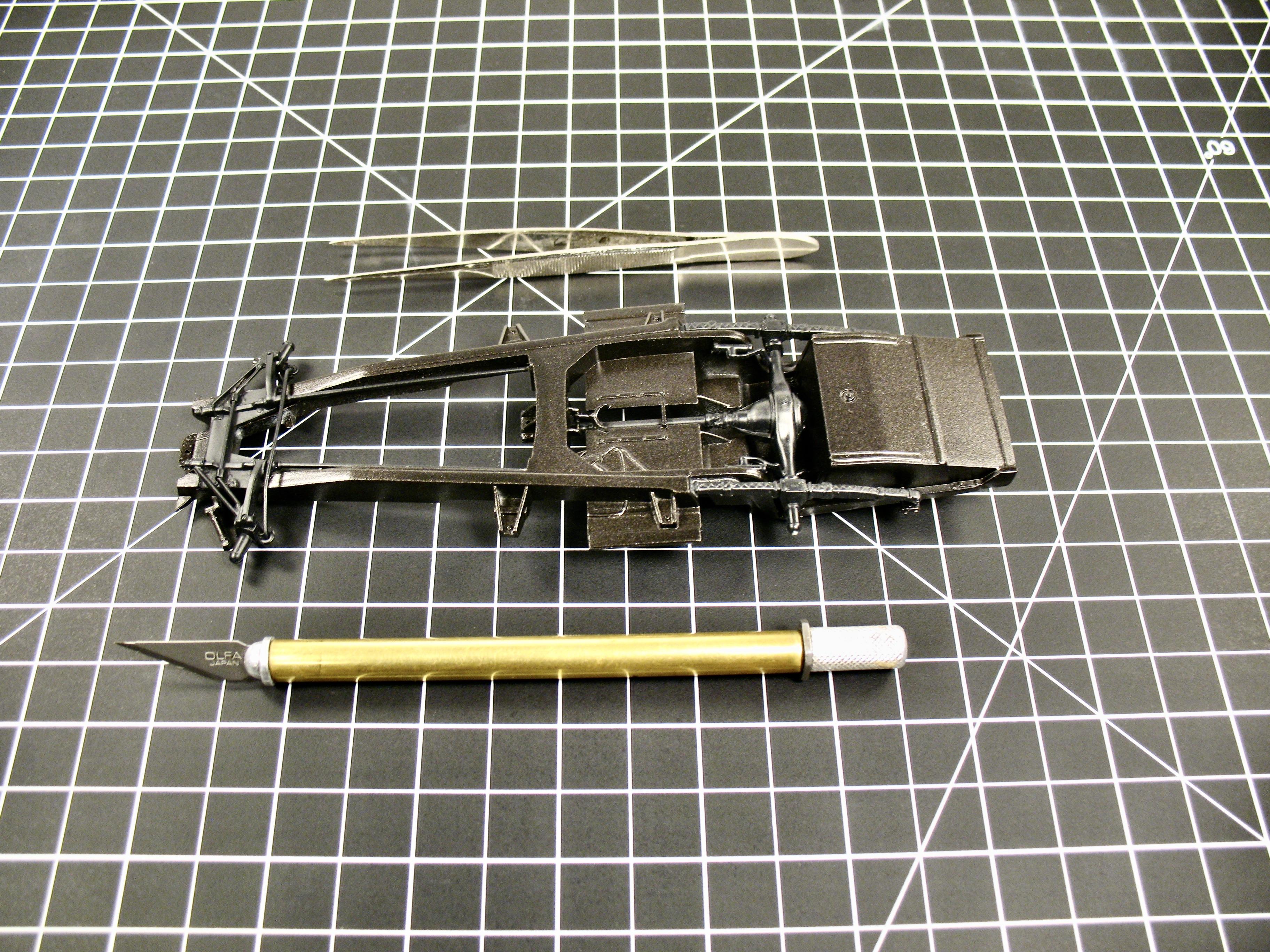

Update on this Jaguar. Here the chassis and the engine finally together. Wheels and tires got the first pass of paint. Second pass of paint on the wheels and tires. I will do a third when the body is installed on the chassis. And finally attached on the chassis.
