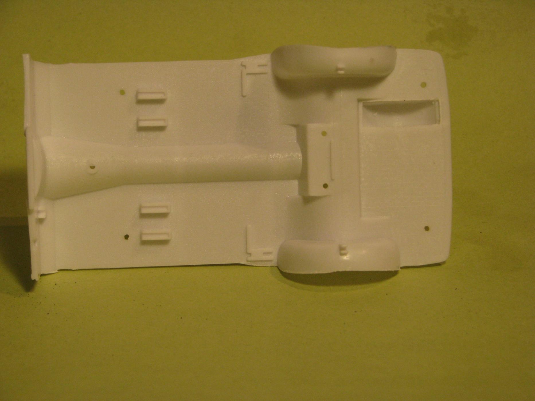

Well, better late than never. My apologies for the delay in this build but sometimes life gets in the way..... For anyone that may have been following, I'll try to get this completed in a timely manner from here, so here's where the build is at.... In this mockup, I've narrowed both the rear frame assembly and transaxle to allow tubbing of the tires. Note I added gussets to help with the integrity of the glue joint. I again modified the front end to clean it up a bit. I substituted a new spring/axle assembly so it won't sit so nose-high. Note the front spring extensions to keep the springs relatively horizontal. I also added a couple of 'lobes' for the rear of the springs to attach to. Here's a better view of the front end. Tires are from the kit but the rims are from the parts box. and here is how the floor assembly sits on it. I tubbed the wheel wells and gave them an aluminum skin made from an aluminum beer can. The decking is made from stir sticks from a coffee shop just to add some texture to the build. Rest of the floor will be done in a dark green. Gasser regulations were (are?) that there have to be 2 seats up front. I'm having one. I'll explain why in a future post. more later.

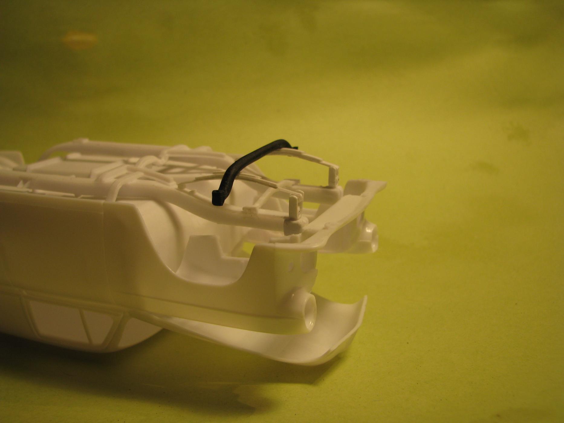

Here are a couple of mockup views of the front suspension with scratch built springs and hangers in the body/frame assembly. Details like spring straps and rear spring anchors ar yet to be added. Upside down but you do what you can To make it a bit clearer, here's the same assembly by it's lonesome. You'll notice (or not) that I had to add a couple of filler blocks for the springs to rest on. These will be refined before painting. ....and how it compares to the kit piece. This will lower the ride front considerably Comments and observations welcome

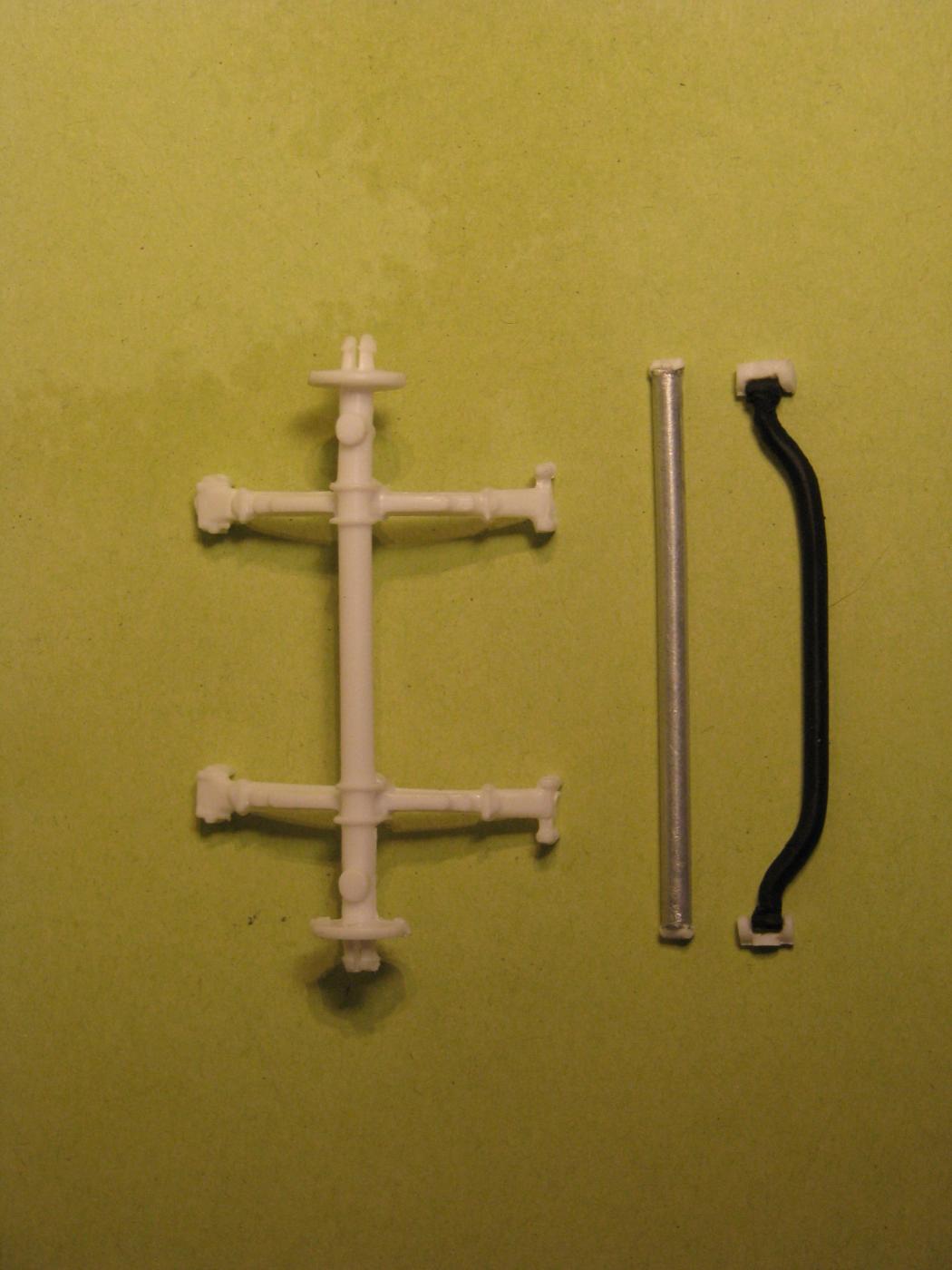

I've decided to rethink my axle.... The straight one just wasn't doing it for me....so to reduce the vehicle's nose-in-the-air stance a bit, I made a dropped axle from a length of tubing. Left to right is the kit part, the previous aluminum straight axle and the new dropped axle. It's painted flat black to get a better look at how even the symmetry was and mocked it up with the in progress knuckles. Comments and observations welcome.

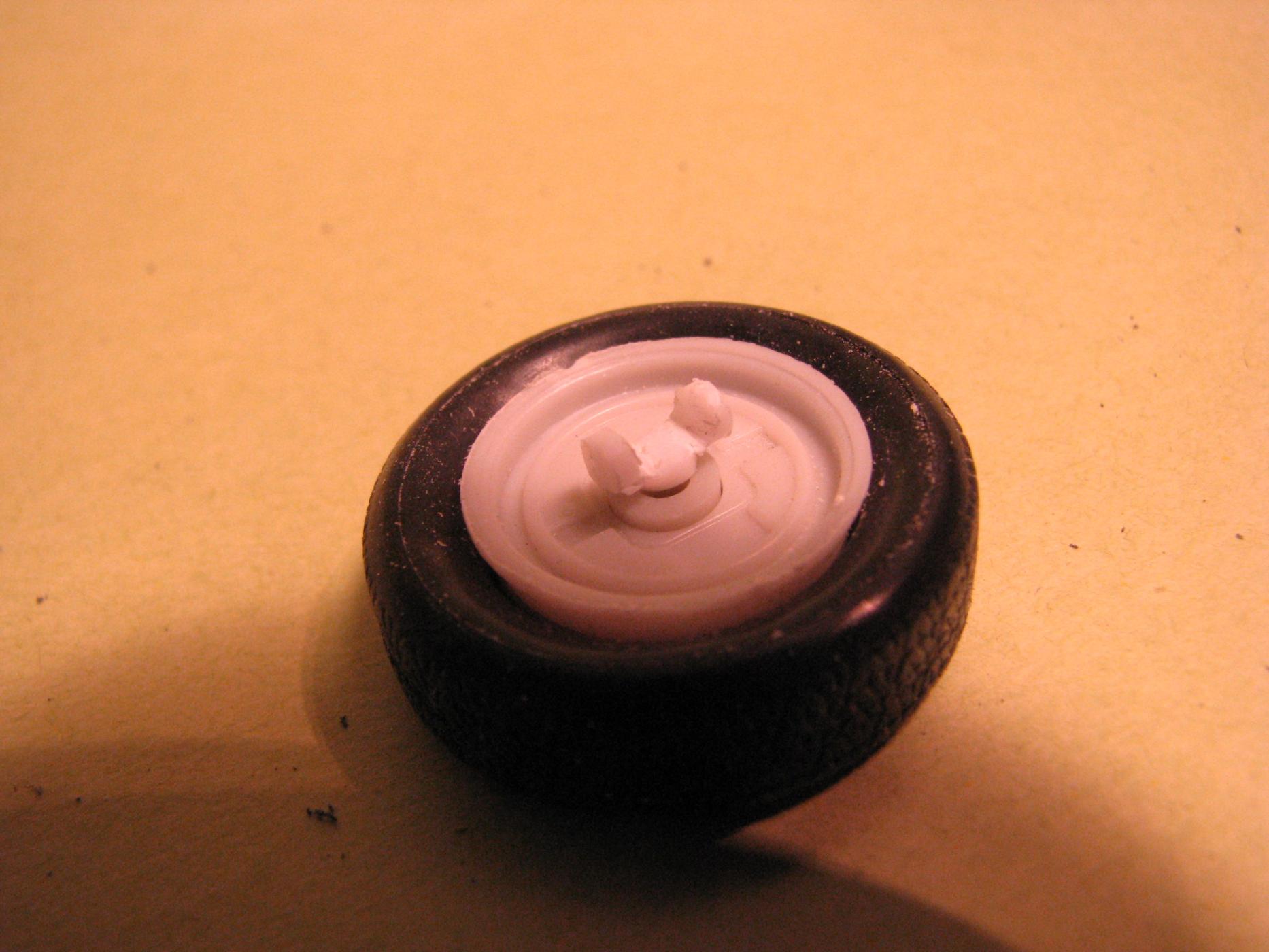

I made the axle from aluminum tube and half round styrene. When ready it will be shot with Alclad. I keep the original for measurement purposes. The pic shows the knuckle joint before and after. I made it from a T section of sprue....and almost limitless supply! I simply carved and filed away to fit the end pieces on the axle. You can see how it fits on the end (this is before final finishing). Pardon the dust, it's on the actual glass lens protector but obviously shows up on super macro. and here's how it sits on the back of the wheel. These are the wheel backing plates I got from the parts box, and they sit in the tire better lol. ...and here's an idea I'm working on for the knuckle horn(s) as they will fit on the knuckle. Made from small diameter solder, I simply flattened the ends and put a bend to suit. It looks worse at high mag than normal size, but it's my first one and hasn't been smoothed yet. There will be an upper and a lower on the passenger side wheel for the control arm off the pitman (upper) and drag link (lower). The driver's side will have a lower only for the drag link. Thanks for checkin' in. Comments and observations welcome.

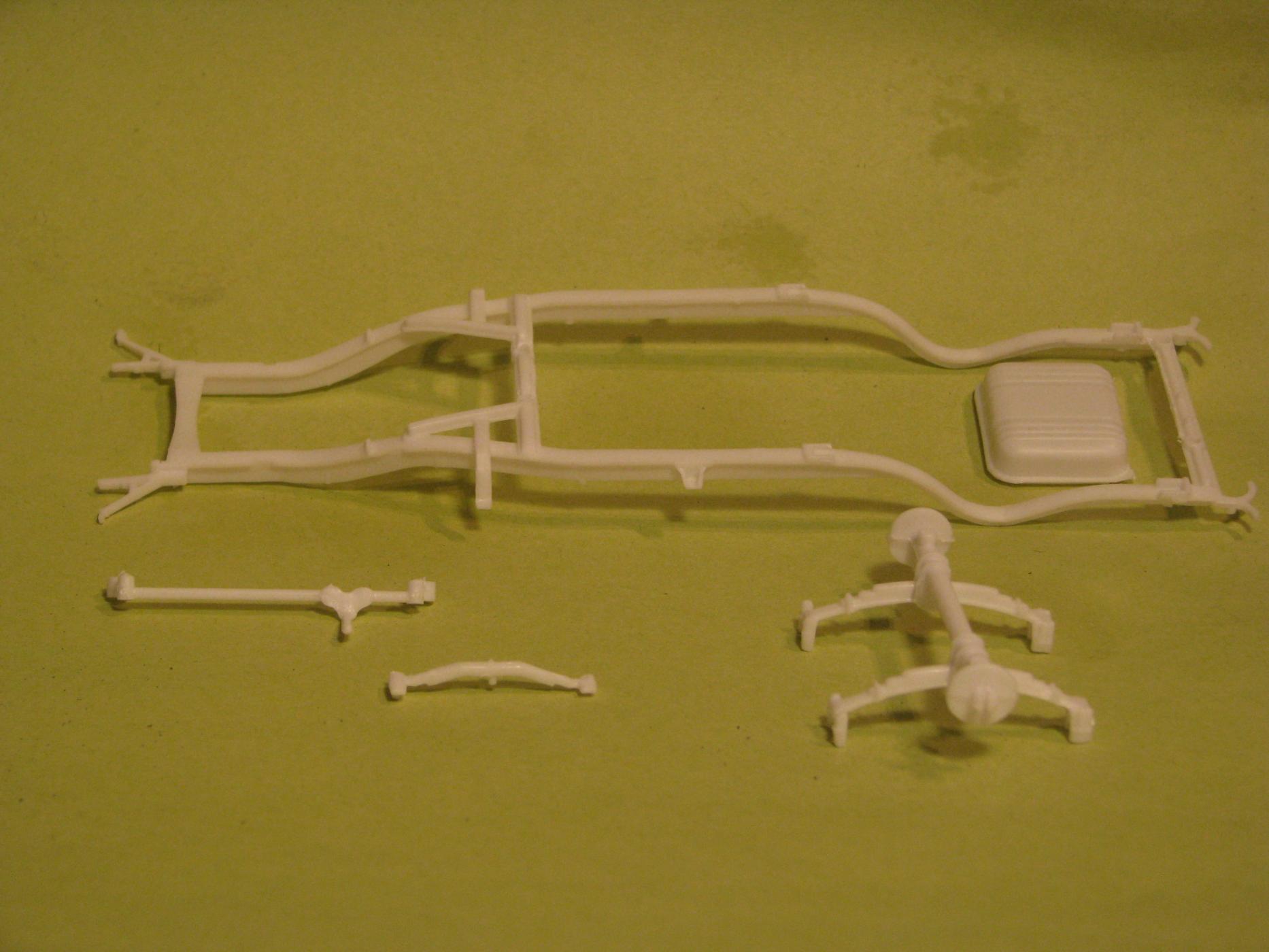

I'm about to begin building the Revell '53 Chev panel gasser. I'm sure this kit has been around for a number of years, seems I've seen it in a red/white/blue boxtop livery and maybe even some other configuration, however, memory fails as one gets older.... Anyway, this kit is very simply, a very simple kit. Some parts are unrecognizable, so much so that I thought it could use slight massaging in just about every step of it's construction. So, using my limited skills I thought I would give it a go and post mods/updates as I got them done. Release the Kraken! A number of pieces in this shot. The frame at the top has already had it's gas tank removed. I'm going with a moon type tank on the front of the car. The frame takes a lot of cleanup to make it sit flat against the floor pan. My specimen had lots of flash sticking up from the mold release dots, flash on the outside of the frame....take your time and clean it up. I'll also be removing the front bumper mounts (the antennae on the front frame members). Moving clockwise is the axle/spring assembly...or, it looks roughly like one. Fit is very sloppy with no detail. By the way, this is a one piece item. I plan to do my own axle and try building my own springs and mounts. As it 'hangs out there' in full view, I found 4 wheel backing plates with embossed detail in my parts box. The axle is my first plan of attack. Next to this is the engine support brace (Step 2). I've already modified this by removing two little nubby things. My guess is they were supposed to be shocks? Anyway, I'm already removed them and will install other shocks, either parts box or scratch built. The last piece is I guess the tie rod (control arm?). I would think it's for a power steering unit maybe, otherwise than that I don't recognize it. I will make my own tie rod/control arm from aluminum tube. The floor pan This is the underside the floorpan. That curved raised piece is the spare tire well, a separate part. There is some embossing on the inside guiding you where to cut out the rectangle so it will fit, but the part isn't even listed in the instructions! I installed it anyway just to add some variety. If you do this, hold the frame in position so it will fit correctly later. Next post I'll show what I have done on the axle so far. Hope you enjoy.
