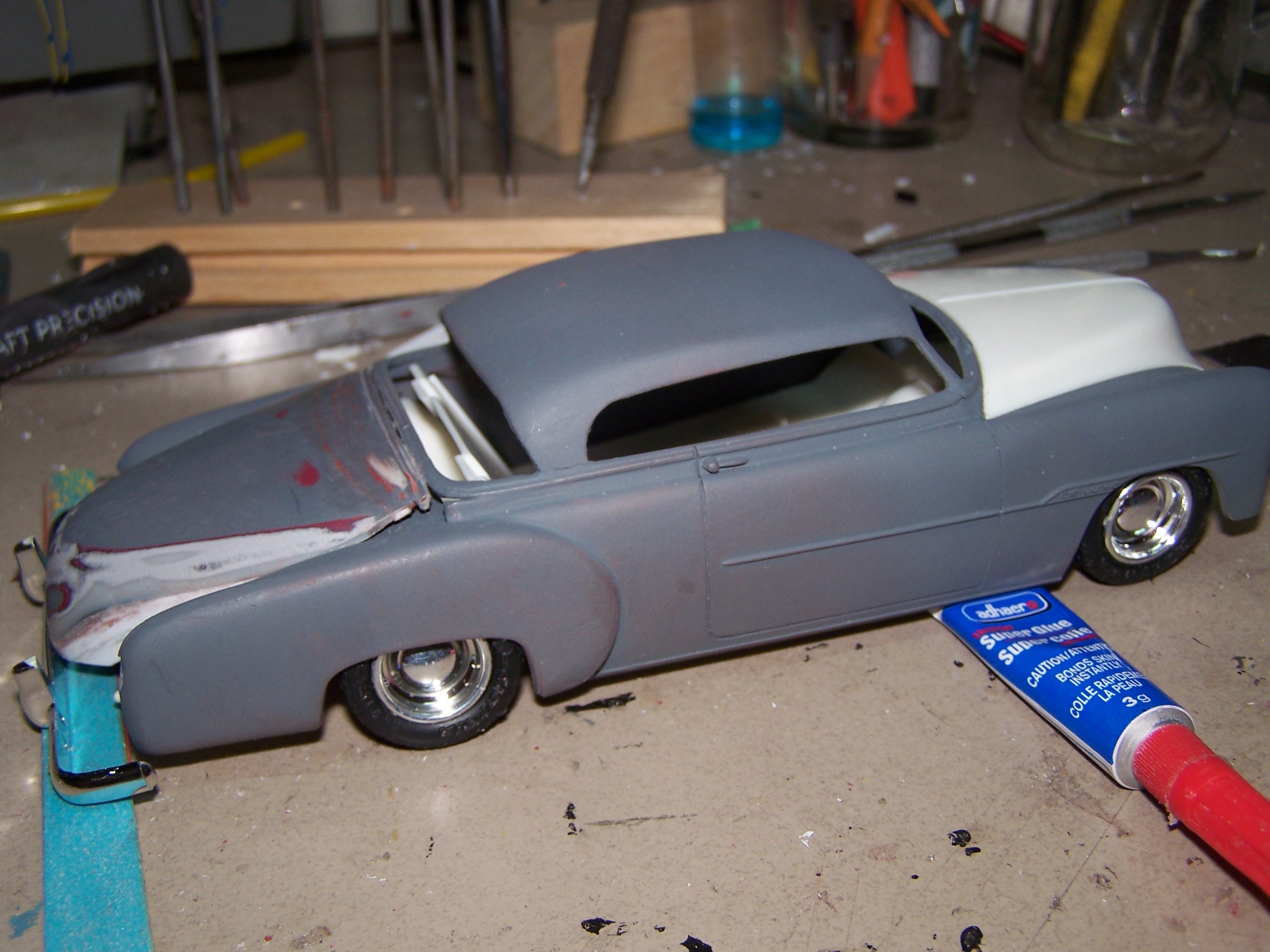

  11. Still in primer awaiting minor touchup and finish sanding but for all intents and purposes, finished. One nose....nosed. Comments and observations welcome

  13. onto the nose.... Quite a bit of changing and adjusting since the last pic of the section removed from the nose. It's been widened a bit in this shot... ...and after a quick primer coat to better see the lines, it wasn't wide enough for me ...so I widened it a bit more, readjusted the hood line and now it's more like I envisioned. lots of sanding, sweetening up the bottom piece, and more sanding and forming to do. Comments and observations welcome.

  19. Darn, ran in to a problem-ish. Due to the slope on the 'fall' of the trunk, there's no room to move the wheel wells back. Oh well, not line anyone would have noticed.... here's a few shots of the mockup. The boat tail trunk is committed. Glued on rather well, just a matter of making it look like it belongs there.... The mockup... it's on my bench sorry 'bout that, I was fussin' with it and decided not to move it for the shots. Fender skirts will be made and installed, and the rear fender assembly will be rounded on the bottom side to match the top....sort of. IComments and observations welcome
  20. Here it's just about ready for some finish sanding on the joint and you can see that the side piece is being taken down gradually to match the curve in the rear of the car. A paper profile will be held against this so there is a line to work up to. The difficulty will be adjusting the profile just right so the whole rear section has a correct slant to it. The side begins where the white piece stops. Comments and observations welcome.
