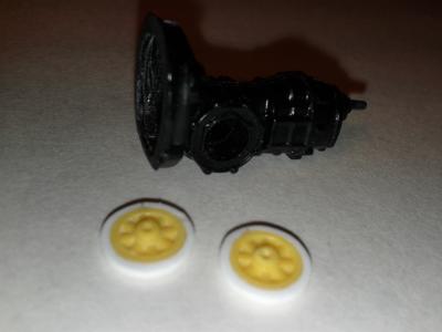

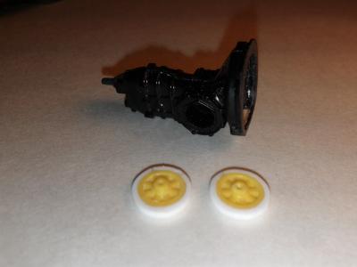

  3. Regarding the type 1 engine and trans that I modified for the master... The caster will have them cast up in late sept early oct according to our last conversation. He was hoping to sell a bunch of the rims out of his first batch of castings to help fund the engines, but has sold very few sets. Sounds like he is a little apprehensive with investing too much money in casting the engine parts if all he gets is lots of interest and no orders. Just my interpretation. He is selling right now just on Facebook which may not reach everyone?

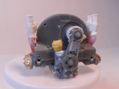

  5. Regarding the engine parts...the Resin caster is working hard on getting some test shots done by mid August to work out any problems before producing some inventory. Because of the Baja bug kit, we agreed to push some offroad wheels and tires ahead of the engine block. I mastered a Jackman style rim along with some other surprises. Randy.... The Porsche and VW engine are very different, but are based on a similar platform, shape and principles....air/oil cooled, flat four, opposed cylinders, upright fan, Mounted at the rear behind the transmission and rear wheels. The problem is that the model versions in plastic have been poor representations except for the fujimi porsche 356 version and the Tamiya 66 beetle/ Ghia version. How to hot rod vw engines is a great magazine/ book to learn the lingo. Hot VW's magazine is also helpful. Sometimes website or paper catalogs will give you learnings into the differences...check out Mid America motorworks or EMPI or others that advertise in Hot VW magazine. funny thing is, many of the differences of these different engines and parts can't really be seen in 1/25 scale very clearly once most of the parts are placed on the engine. It all depends on how accurate or detailed you want to get. The kubelwagen engine is a good example of the very early vw engine...25 horse...that would probably not be accurate for a late 60's Baja bug. This engine is also molded a little flat and looks good Detail painted inside the Kubelwagen, but does not look right outside of the engine compartment with no engine tin. I have seen 36 horse engines in Baja bugs....like the amt Meyers Manx kit version, but the trans was the earlier version. Post or send me any questions you may have and I will be glad to help.

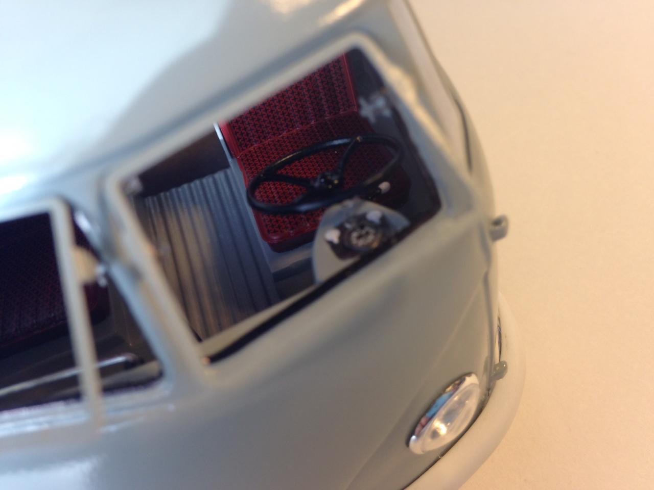

  7. Body on Chassis! Almost finished, plus have a few more ideas to add interest. Mounted photo etch safari windows and added hardware including wing nuts. Glass and latches next along with the sliding door glass. Mounted stationary glass pieces in door, sides and rear. Hard to see, but i added detail to the dash pod (speedo, 2 knobs and ignition/key). I scratch built the interior heater tube and added 2 tone interior panels to the door/sidepanels and front kick panel (copied from a Gunze hi tech pattern). Added weathered Meyers Manx Company decals, a hint of it's purpose.

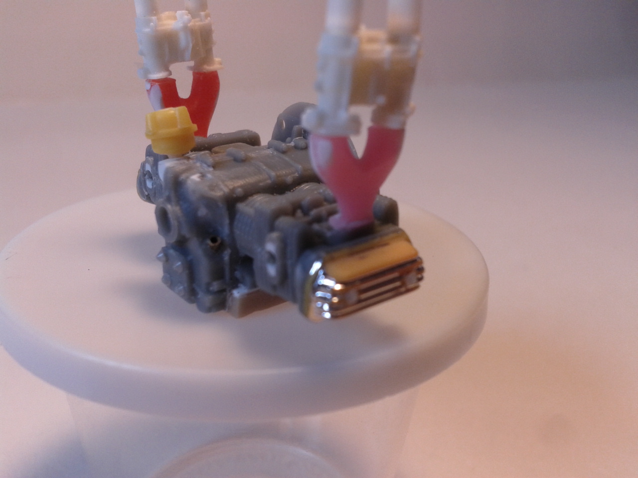

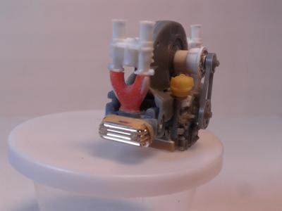

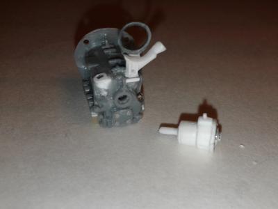

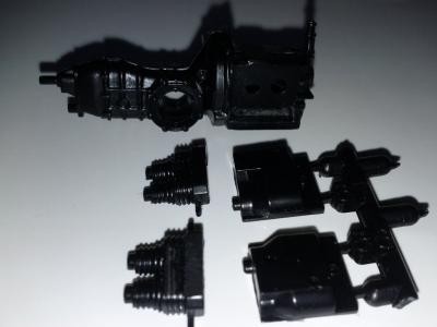

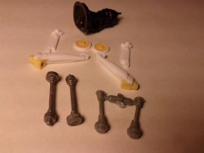

  8. That same motor is basically found in the Lil Van yellow dune buggy Tom Daniel Reissue. The person that built the motor did not assemble the pieces correctly. Here is an update: I added detail to the altenator stand, adding the distinctive ribs and little hole. Also added a hoop to mimic the strap and added the electrical hook up to the top of the altenator. I took your requests for an IRS tranny and created the side covers which could be added to the Tamiya Tranny. Will also have 2 types of axles/CV joints, one from a 930 Porsche. I custom made IRS trailing arms. These are a little lengthy and beefier(?) for Baja versions, but could be downsized for street versions. I also adjusted a Porsche 5spd tranny to fit the Tamiya chassis. Will add pics later as it is dechroming. Cheers
  9. I changed cameras and now realized the new camera does not have a macro feature. Here are some updated pics using the macro. Again, all parts are attached using temporary gel glue.
  10. Fan shroud is separate, check post #25.

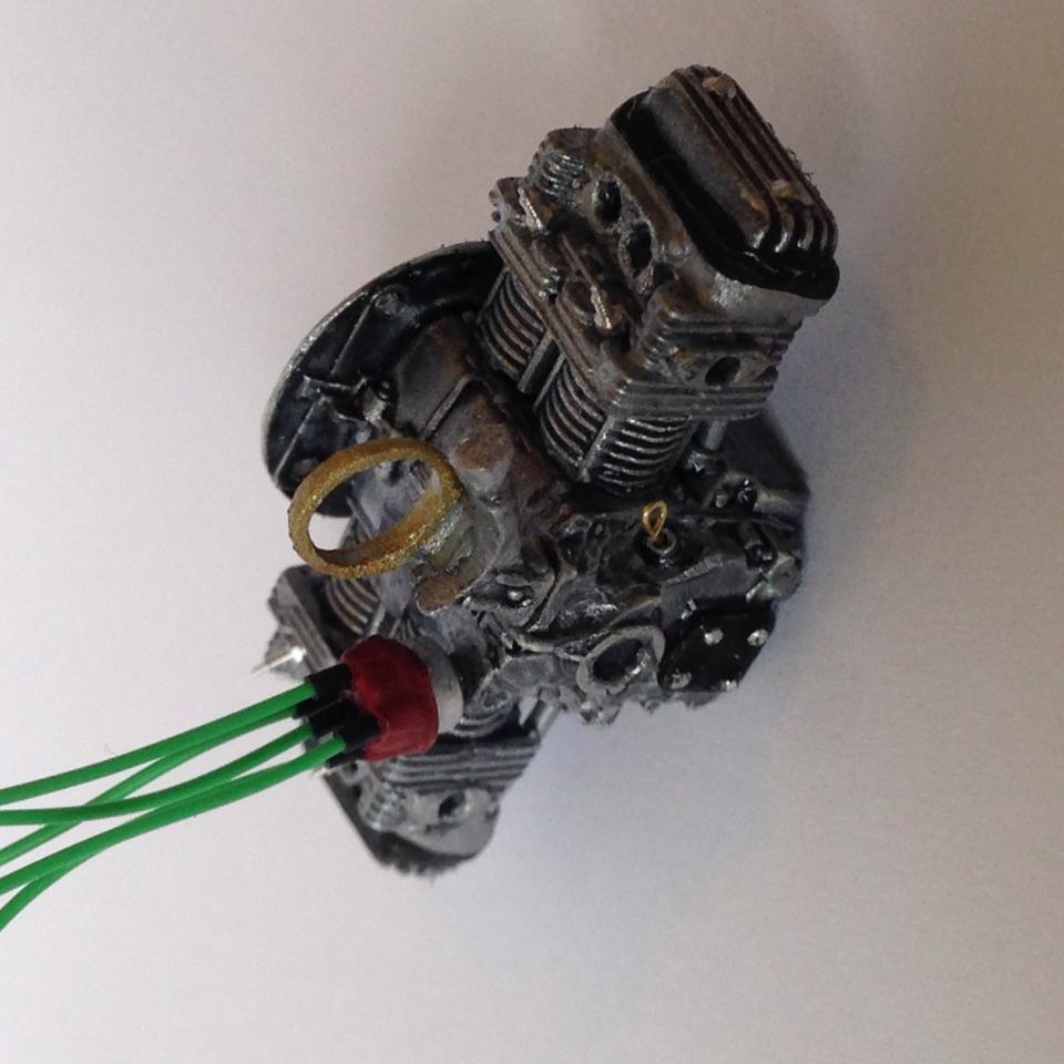

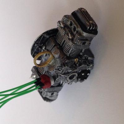

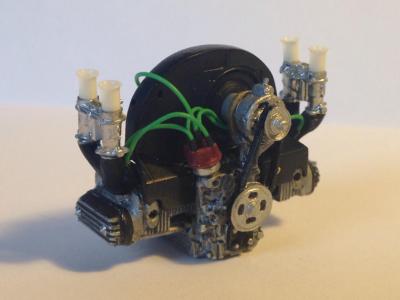

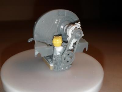

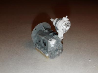

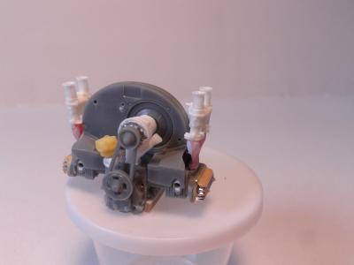

  12. Great to see the interest for a resin cast T1 engine. This is what I am about to send to the caster (excluding the Rep Min & Mld 48 IDA carb bodies). I modified the Fujimi engine case to look more like a VW based case. Added a dipstick tube. Fujimi Heads modified to VW. Modified exhaust ports from Porsche to VW (round). Added bolt on custom valve covers with scale bolt detail. Oil pump cover modified to VW with scale bolt detail. Altenator scratchbuilt ( 9 pieces). Still have to add connectors for wires. Modified Fan to look like dog House cooler fan and to accept empi manifolds. Empi manifolds modified to accept 48 IDA carbs from Rep & Min of Mld. Modified Distributor with wire holes. I used elmers clear gel glue for mock up as it is easy to remove and is not permanent.

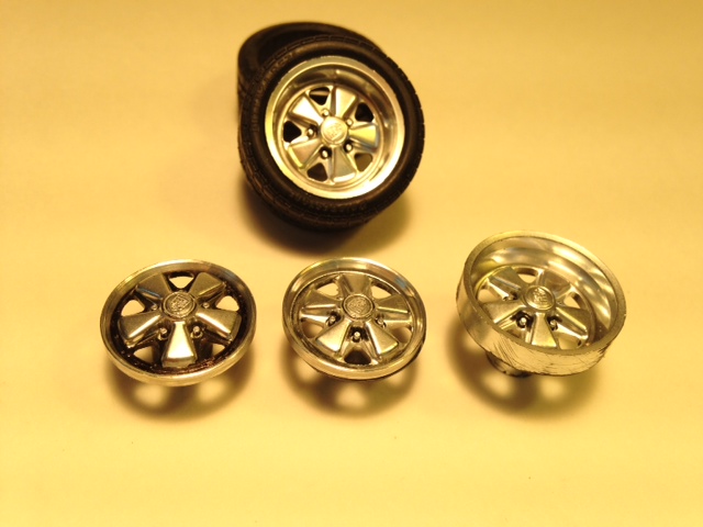

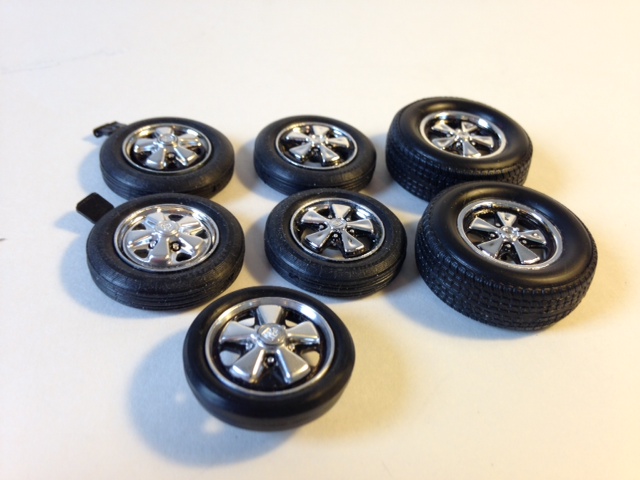

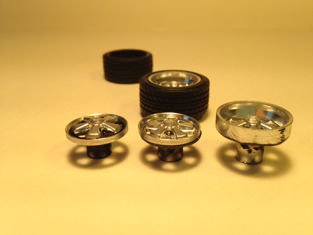

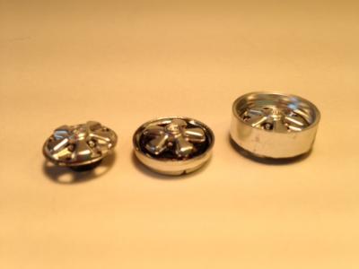

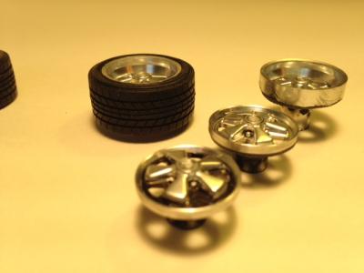

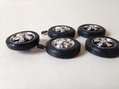

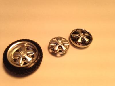

  13. This next set of pics show the smaller Tamiya Fuchs and Revell Fuchs. I made "crab leg" Fuchs with both using the front rim hoops from the Polar lights funny cars (grinding out the center section). In the group pic, the single, super skinny tire/crableg is the larger Tamiya center section.
  14. Here are some more "crab leg" options using Tamiya Fuchs. This first set of pics shows the larger (18 or 19") Tamiya Fuchs. 1st I removed some of the excess on the back of the rim to mount a skinnier tire. Then I removed all of the rim except for the center spoke piece on 2 of them. On one I mounted an aluminum rim on top of the center piece. On the other, I trimmed the center piece down to fit on TOP of the aluminum rim, creating a "crab leg" look.

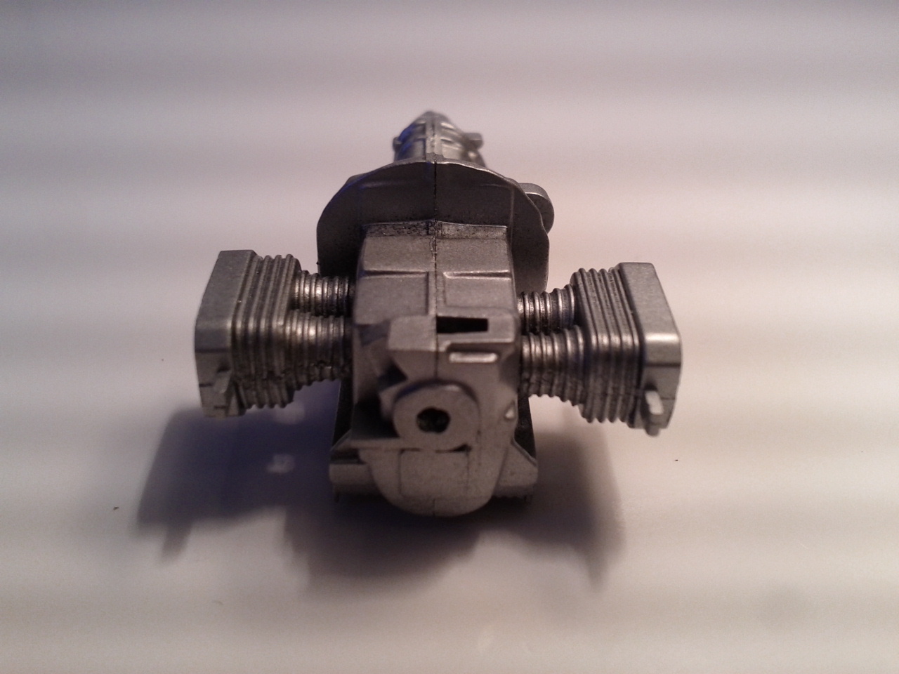

  17. Here is another option for a more detailed VW aircooled engine that would be used for a drag version, taking off the tin to show the piston barrels. You can take the bottom detailed piston barrel part from an extra kit and replace the upper engine tin part for a complete piston barrel. The part of the head that the pushrod tubes attaches to is missing and can be replicated with a thin (.030) piece of plastic. Tamiya does not mold the pushrod tubes but has molded dots on the engine case where they should attach. They can easily be drilled out. No VW kit offers a detailed altenator because they were not offered by VW for those years kitted. I have scratchbuilt mine. I will send a master to the caster and see if it can be cast. 92mm Barrels....just going to have to pretend or make your own. Bringing back memories....my 63 Bug with an 1835, mild cam and dual 36DCNF's would SCREAM. Deep sump....you could file some material off of the Manx or Calif Roller Bus engine case bottom and attach it to the bottom of your engine case.

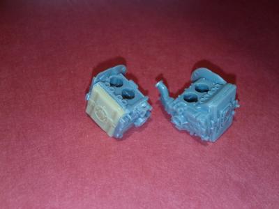

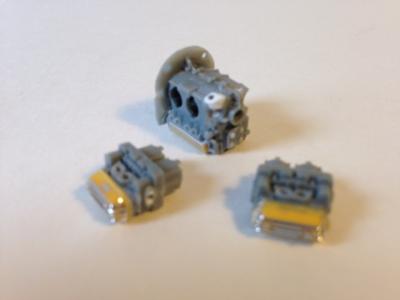

  18. Looking to have the following resin cast once I finish modifications to convert the case from an early Porsche to a T1 VW. Original case is on the right (in the pic with only the 2 engine cases). These are found in the Fujimi Porsche 356A with the 1600 engine. Fujimi cylinder barrels, heads and pushrod tubes are fantastic. The Head is actually cast separate, correctly. I have trimmed it down to VW T1 spec, using a bolt on aftermarket style valve cover from a Monogram Lil Van. Modified Tamiya options to follow.

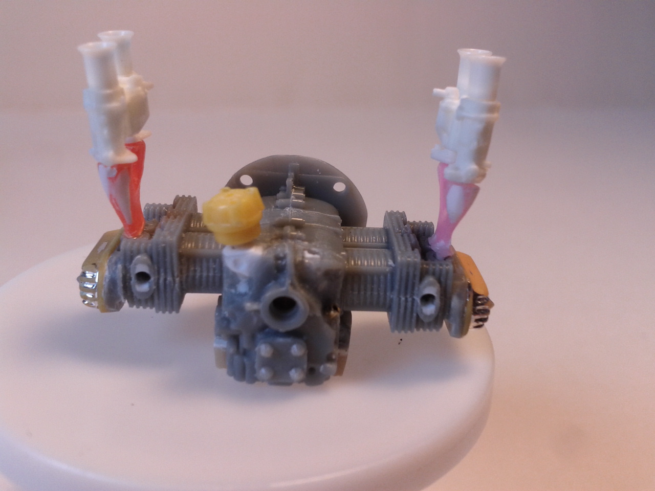

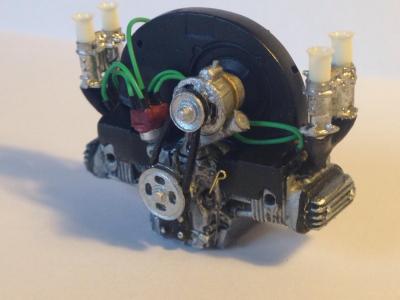

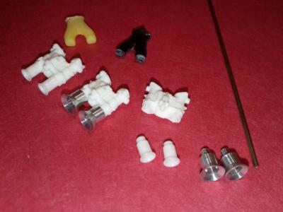

  19. Here are the Rep and Min of Maryland 48 IDA carb bodies with the Studio 27 Velocity stacks. The resin stacks (which are actually the correct size) are also shown. I like the extra large size of the aluminum stacks. The base of the aluminum stacks fit perfectly in the hole manufactured in the resin carbs! Rep and Min supplies the Venturi tube brass...nice touch. The EMPI manifolds shown are from the various copies of the original 1/25 Revell 1968 Beetle/Convert. These manifolds are for a dual port and are the tall version of the manifold.These are located on the option tree molded with Revell's version if the IDA. I have cut off the carb body, but have not yet modified these to fit the more detailed resin carb body. You can add material on each side or carefully make a cut in the middle and spread the tubes carefully to make them fit. Add plastic to fill in your cut/open space and you are good to go.

  23. Thanks Mike, Carl, Dan, Mike and Dale. The manifolds are the empi tall manifolds from the Revell 1/25 beetle kits on the option tree. Cut off the IDA carbs that have not survived the many repops and modified slightly to mount the fabulous 48IDA's from Rep and Min of Mryld.

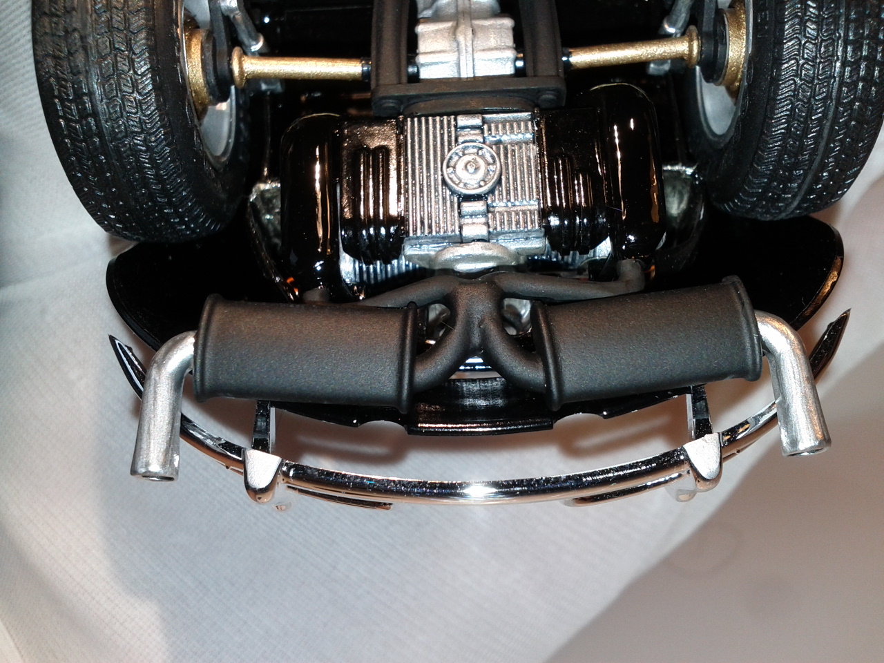

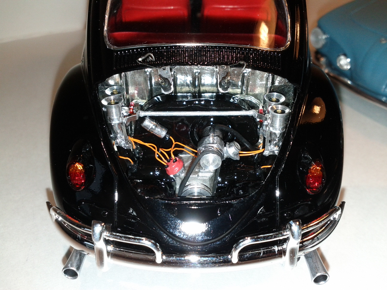

  24. Finished this awhile back but added a better exhaust (dual quiet pack) and also detailed the carbs and added a "cool lid" kit so the engine lid clears the carbs on the tall Empi manifolds. also added a wash to the cylinder barrels and block. Some of the glass was never mounted correctly so I popped them out and used fresh BMF and white glue. The black Tamiya paint has held up well....it was sprayed over the bare plastic after only a bath to clear the mold release. Even after polishing with novus #1 it immediately attracts dust. Working up a custom Calif. black/yellow plate. Rims are one offs replicating American wide 5 bolts I created using Americans with the smaller bolt pattern removed, then adding the wide 5 bolts from a Fujimi Porsche.

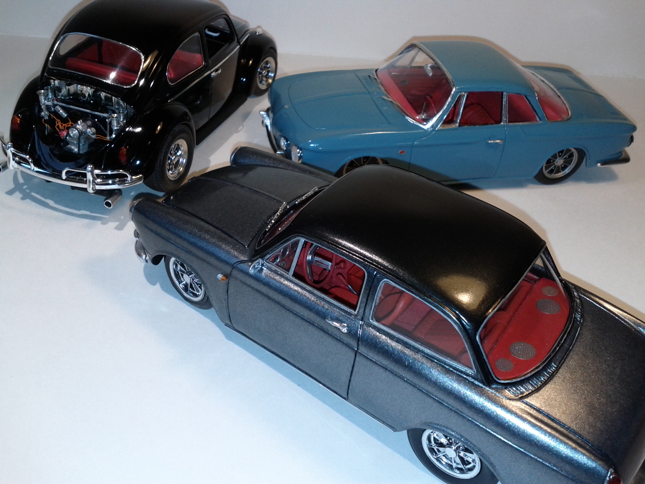

  25. Thanks Ray, Jesse, Lee, Steven and Harry! Appreciate the kind words. I think this was the first resin Notch that made it to these shores from way back and some of you know (Gregg included) I have been fighting this model every step of the way for more than a few years. I was tired of staring at it half finished. I used the metallic paint to hide (try to hide) some of the body work/resin issue flaws, but had more issues on the roof and went with just Black for a 2 tone. Now I can move on to the Split, Binz, Hebmueller and Stoll. You VW nuts know what I'm talkin bout.
