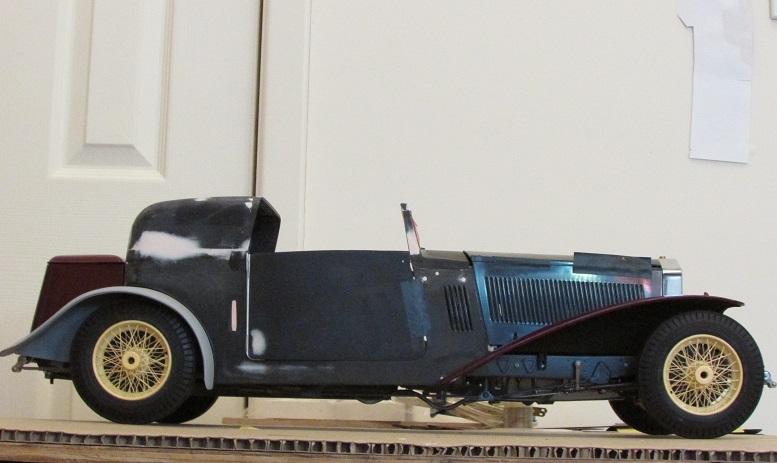

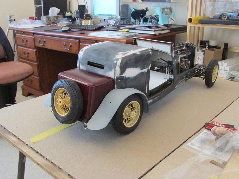

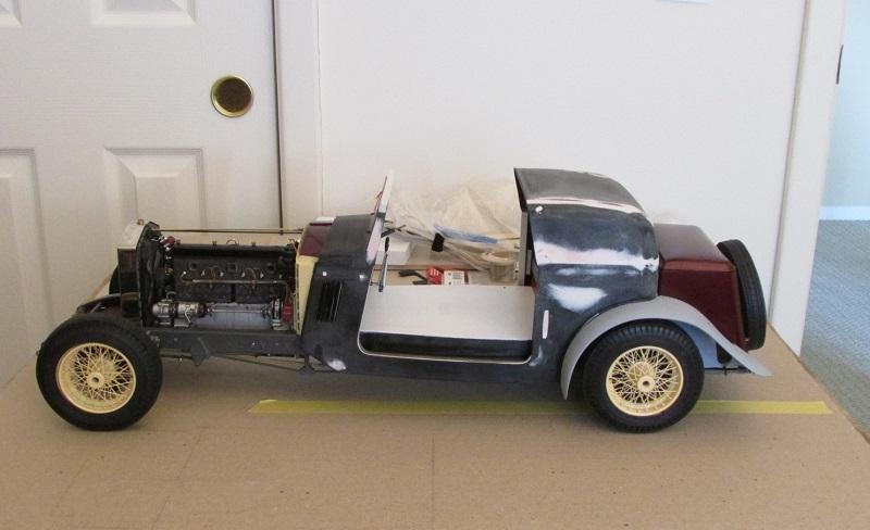

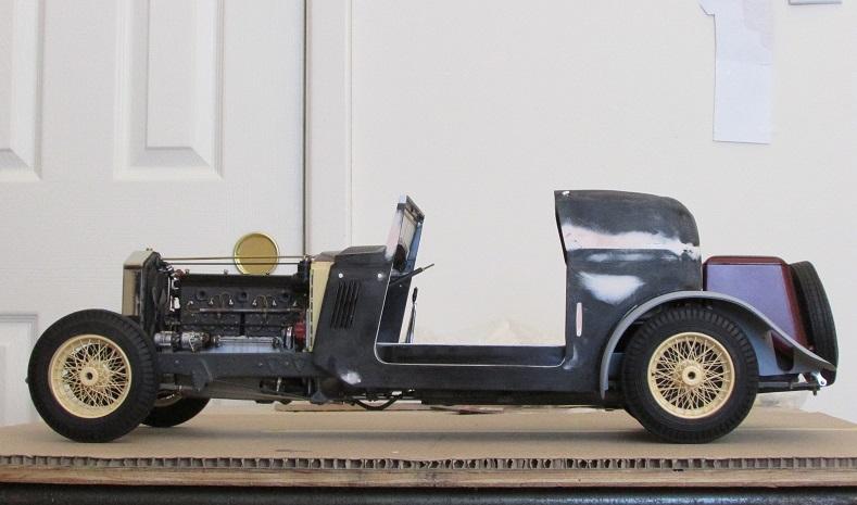

The roof was pie-cut; 13mm at front edge, 4mm at the back. It's all in the thread but probably too hard to dig out. I wanted to kill the 'coal scoop' look from Pocher. The rear glass is untouched, just lower due to the cut. That's why the trunk height was cut about 6mm too. This is much closer to Gurney cars. The back of the rear seat comes up to the bottom of the rear window. I did in fact cut 6mm from the bottom edge of the upholstered seat back after the roof chop. looks all very proportional now. No wearers of period hats will sit there. Only slightly reclined, scantily clad, slinky starlets and '29 flappers. Dude, this is my bucket build so don't harsh my dreams. Yes, the roof will be covered in deep red gabardine with Marvin's beautiful landau irons. First the beltline must be designed to sweep front to rear. The fabric will not have the exaggerated dip ala Pocher but will be lower on the body side because of the chop. In fact the top won't look so radically cut when its bottom edge is defined lower. Spent a lot of time studying this. Style is everything. Loren didn't build his collection around cars he could wear a top hat in. PS - Your eyes are far less out of whack than mine are... Nice thought but I need the length of that board to continue the largely horizontal look of all the lines. Also, it gives me a chance to make chromed brass step strips as further accents.

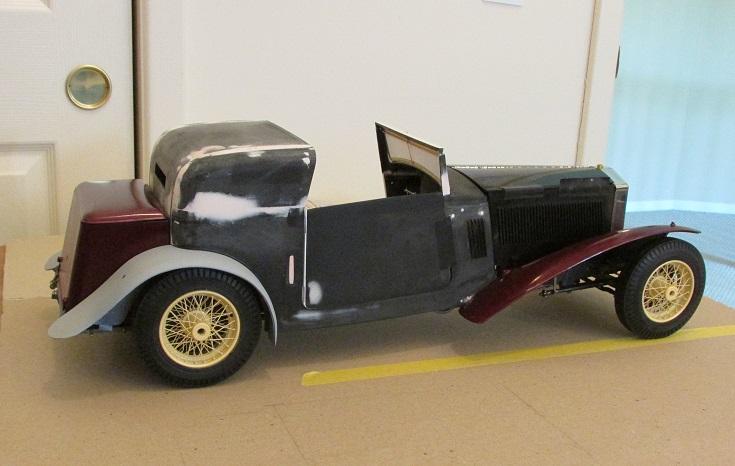

Down on the ground... A much clearer view of the final look. Almost all elements in place except running boards and beltline. All temporary; must be blown apart for the fabricating and assembly. But this is the main 'architecture' of look and stance. Finishes and textures of paint, chrome, glass and fabric will make a huge difference and (I hope) improvement.
Your observations about reference and and equipment are always welcomed. The Pocher India's rear doors are too high and distorted and bear no resemblance to 1:1. Must have been an engineering difficulty that forced that. Also the door posts. Face it; it could not have been easy to kit design for accuracy in the late '70's compared to today.

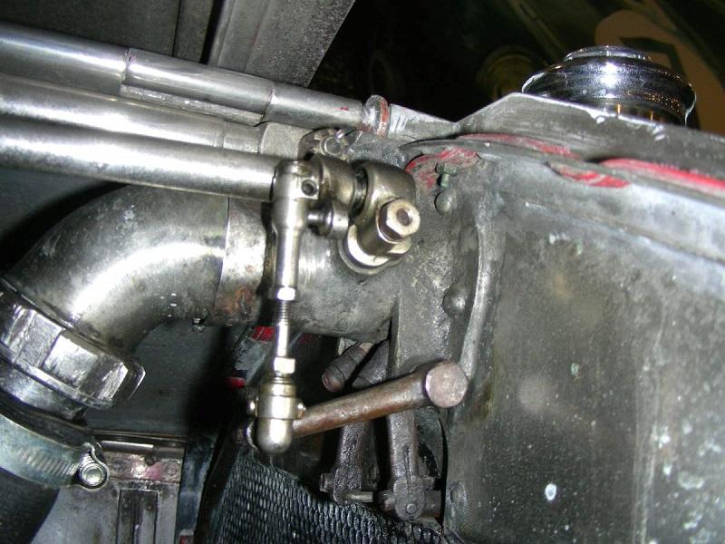

It's important to remember the Pocher car is an amalgamation of features seen at various times in production. You can't pin it to one year, series number, chassis number or anything. The carb, gas tank and shutters are other examples. Plus the 'mystery' Sedanca fenders. We can only hope to build 'representative' models. That's why we're both not 'wrong' in interpreting our cars to our ideals.
I sure did move it, per Marvin's kind instruction. Dunno why Pocher put it there unless for a left hand drive car. Huh? Why would they do that??. Anyway, Egon's '29 reference shot shows it the way I have it. I think mine does not align with what I assume is the control knob in dash center. But who's gonna pick that nit? Knob could have been under dash too. I closed the left side, drilled and cobbled links on the right. So it is aligned correctly with the firewall linkage. At some later point in P II production, RR went to thermostatic shutters so none of this. Confusicating ain't it??
