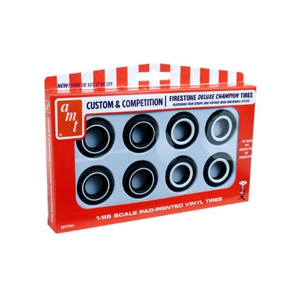

Craig, I'll have to paint part of the insert black. I need thinner white stripes on the tires. -

Thanks Bill! It looks like they have an insert that has to be painted. I'll have to try and find a set. Mike. -

These seem to be the size of the tires that come in the Jo-Han 1964 Cadillac Deville kit which I have. I'm trying to find a set of tires the same size as the tires that come in the Polar Lights Ecto-1. The Ecto-1 tires use larger wheels and most 1/25 wheels are too small and the back side of the Polar lights tires are cut out larger to insert the wheels.
