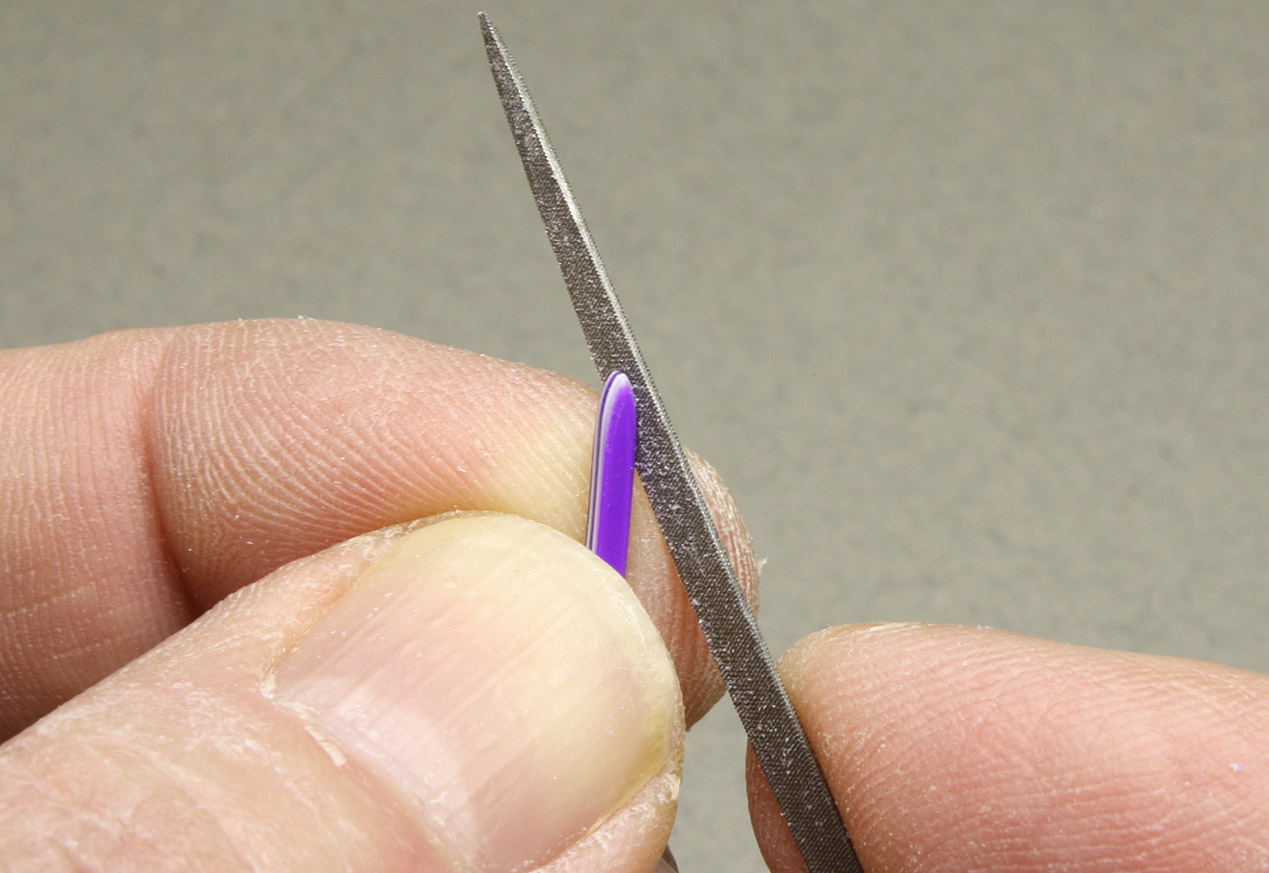

	Yes, I glue 1" x 1" squares together, slice them into thin strips & shape with files & polishing sticks.

	Sorry, I didn't answer your question earlier. The colored plastic is from Midwest Products. I found some at a local RC/hobby store, but many places online carry it. The white sheet I used is Evergreen. Here's a link I found, but just do a seach on Midwest Products, & you may find a dealer in your area. http://www.caboosehobbies.com/catalog/index_home.php?manufacturers_id=647

	I've been working on this '49 Mercury for a little while now, & I finally almost have the interior done. I reshaped the seats & door panels & used acrylic paint as the tuck & roll inserts. The armrests, door handles, window cranks & steering wheel are resin copies of pieces that I scratchbuilt (except the steering wheel rim). The side panels & front seat still need to be glued to the floor, so please excuse any gaps that are visible. The dash is from Replicas & Miniatures of Maryland. The dash & shift knobs are made from laminated purple & white plastic. Here is an older photo of what it's going into. The body has since been painted purple like the dash, & awaiting polishing. For those interested in seeing more photos, including step by step photos of the top chop, check out my FB album. https://www.facebook.com/pages/Steve-Boutte-Kustoms/136565936448460#!/media/set/?set=a.141065212665199.23984.136565936448460&type=1
