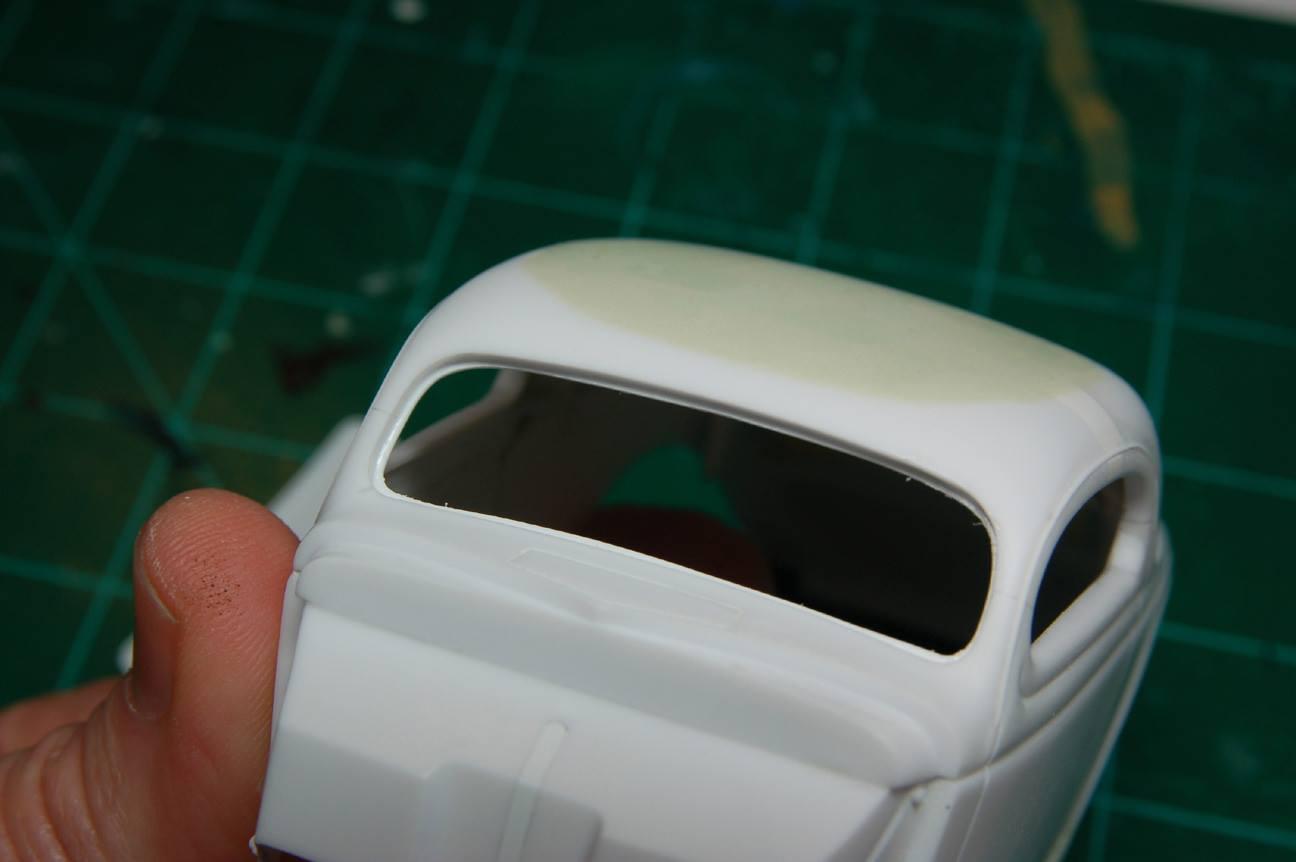

Looking good! Here's how I did a windshield frame for a 36 Ford. After cleaning up the opening, I added a .015" styrene lip on the inside of the it. I traced the shape of the opening onto a piece of paper & transferred that to a piece of .015" styrene sheet. I kept sanding the edges until the fit was tight, but did not bind or bend the sheet. I then built a frame around it on the backside using .020" x .060" strip. Using dividers, I scribed, following the outer edge, making the outline that would later be cut out. I used a motor tool to grind out the middle portion of the sheet. Then, cleaned it up with files & sanding I cut a piece of .010" clear PVC sheet to fit in the opening as "glass". I got the idea to do this from Rik Hoving. Go to this link & scroll to pic 108. http://public.fotki.com/Rikster/model_cars/projects/40_ford_project/page2.html
