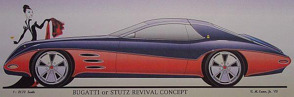

It was derived from this set of designs... http://www.madle.org/exjspy.htm http://www.madle.org/exjspynx.htm http://www.madle.org/exjimp.htm http://www.madle.org/exjaero.htm http://www.madle.org/exjxspynx.htm ...etc.
