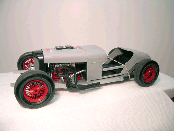

Twokidsnosleep Posted April 3, 2015 Posted April 3, 2015 That , sir, is awesome !!! You Frankensteined together a beauty I saw a thread about using fine wire around the pulleys to give them some more 3D effect with the belts...have to search for it Ever done that??
LaughingIndian Posted April 3, 2015 Author Posted April 3, 2015 That , sir, is awesome !!! You Frankensteined together a beauty I saw a thread about using fine wire around the pulleys to give them some more 3D effect with the belts...have to search for it Ever done that?? No, but I did see tape used that looked good. I learned as a kid that black rubber bans are the best ... for about 2 months

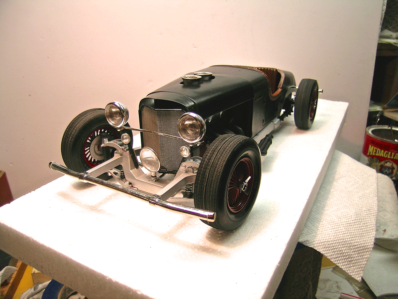

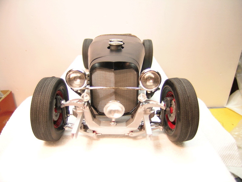

LaughingIndian Posted April 5, 2015 Author Posted April 5, 2015 Structural design done. Loose fit and everything looks as hoped including hood: I'm going with the spokes ...
bobthehobbyguy Posted April 5, 2015 Posted April 5, 2015 Looking good. Great choice on using the spokes.

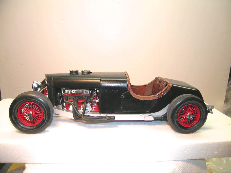

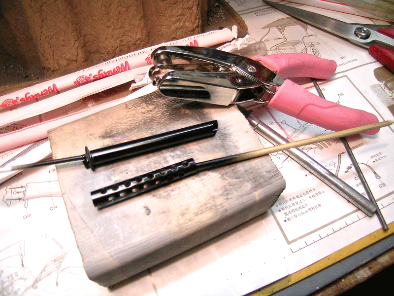

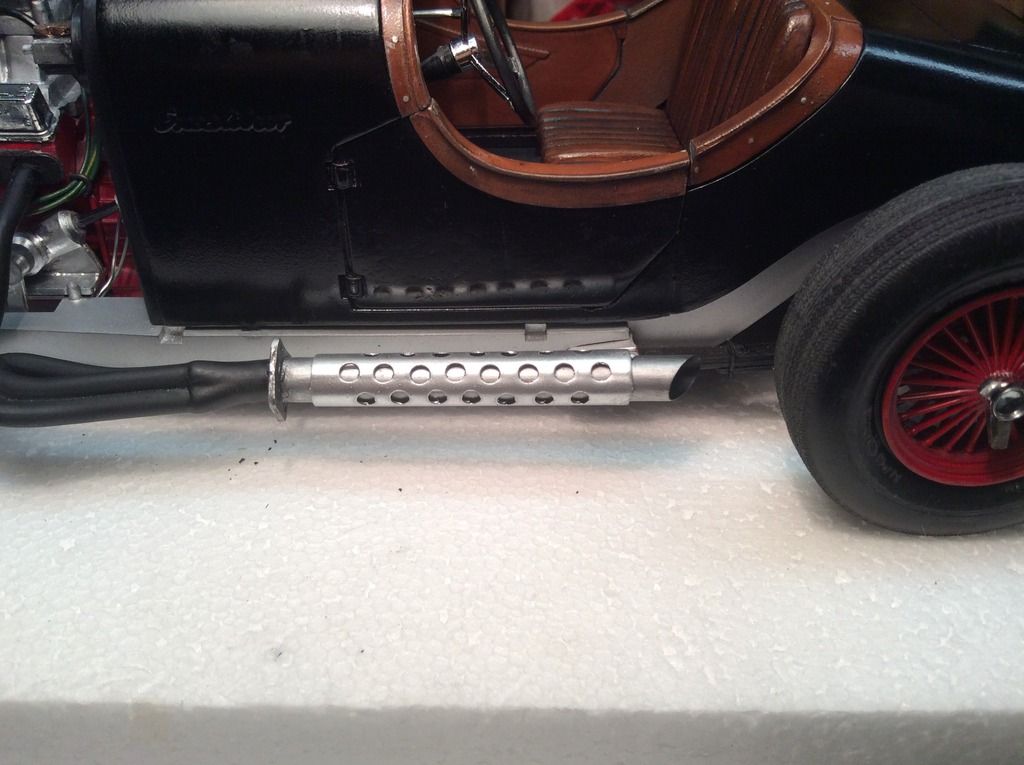

LaughingIndian Posted May 1, 2015 Author Posted May 1, 2015 (edited) progressivo interrupti per paintorosso ... I screwed up the paint. After a huge success on getting the perfect effect of a realistic 'satin black' using krylon Fusion spray, I decided to touch up a small area on the doors and cowl ( I detected a slight mottling). Big mistake. I should have left alone. Too much of this stuff makes TAR. I just spent most of my April late night modeling time stripping, sanding, painting, stripping, painting, stripping, painting ... etc. It still ain't right and will have to go glossier to even out the paint but here's some progress shots: I'll probably knock the bumper back like the original SSK and deal with the Mass. Inspections at the same time as the fender less wheels: Now for a mid-sixties treatment to the side exhaust (Michae'ls scrapbook dept sells nifty tools): Edited May 1, 2015 by LaughingIndian

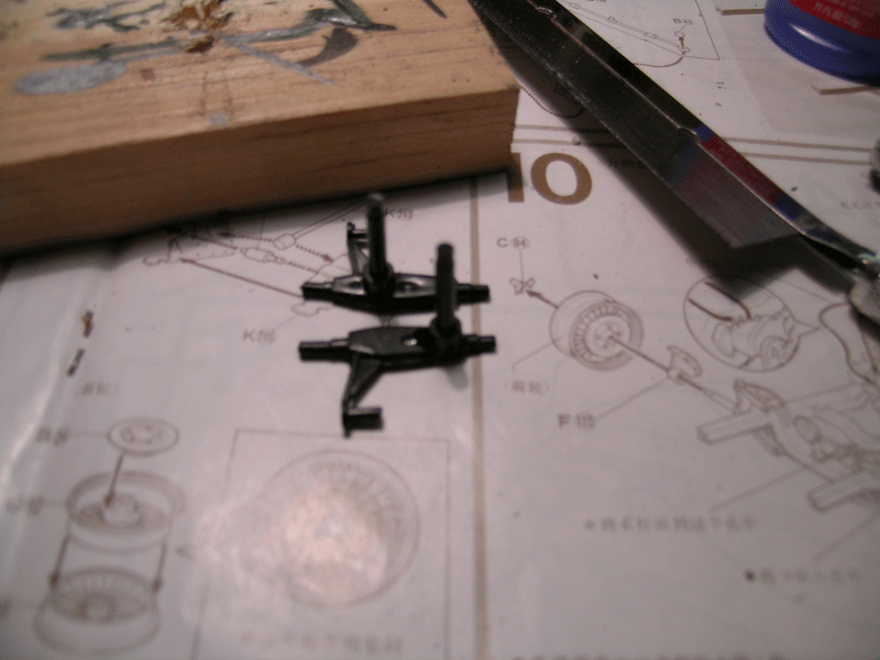

Junkman Posted May 3, 2015 Posted May 3, 2015 Did you use any form of reinforcement when you relocated the spindles on the uprights, or did you just glue them back on? If the latter, what glue did you use? Btw. you made me search for my kit - and I found it. So it's all your fault, really. I can not be blamed...
LaughingIndian Posted May 4, 2015 Author Posted May 4, 2015 (edited) Did you use any form of reinforcement when you relocated the spindles on the uprights, or did you just glue them back on? If the latter, what glue did you use? Btw. you made me search for my kit - and I found it. So it's all your fault, really. I can not be blamed... It was easy to cut flush and I then sanded both parts smooth which offered a great surface to super glue (CA). I use Loctite Professional of North America, Henkel In Europe. I didn't see a reason to reinforce with a peg. You're going to like this kit, so I'll take the heat ... Edited May 4, 2015 by LaughingIndian
