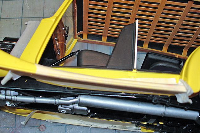

Harry P. Posted June 1, 2015 Author Posted June 1, 2015 That roof structure detail can't be seen unless you turn the model upside down, but for what it's worth... it's in there.
Twokidsnosleep Posted June 1, 2015 Posted June 1, 2015 (edited) Rather the smart way out with the spare I really like the interior roof detail....is very convincing. You could have said you made that by bending all those little bits of wood and I would have believed it. Edited June 1, 2015 by Twokidsnosleep

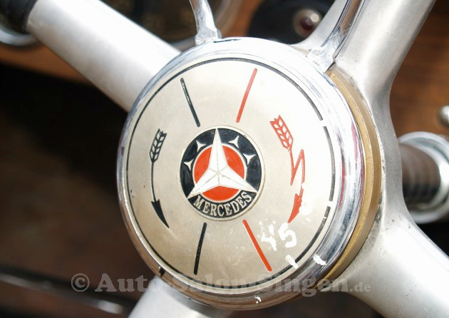

sjordan2 Posted June 1, 2015 Posted June 1, 2015 (edited) Fabulous roof, especially the interior part. As for the spare tire wheel covers, I can't say I've seen fabric covers that go over the entire wheel. I've seen fabric covers over tires but not wheels. I'll repeat my offer to send you two complete PII wheels if you'll clean up an SS 100 gauge photo that I can make decals from, plus the steering wheel hub art for the Mercedes SS. I have good base art, but I just can't clean them up sharply in my apps. These Jaguar gauges just need to have a white background with blue gauge printing and the red pie slice. . This goes on the 1/16 Mercedes steering hub you already did. I have a somewhat larger hub for my kit. Edited June 1, 2015 by sjordan2
Harry P. Posted June 1, 2015 Author Posted June 1, 2015 The Pocher RR Sedanca has a fully covered spare. I think they modeled the kit on a specific car, so that may not be "typical," but I guess there were covers like that. I already made the covered spares, so too late to take you up on your offer. But I can still do the part about cleaning up the gauges and steering wheel hub.

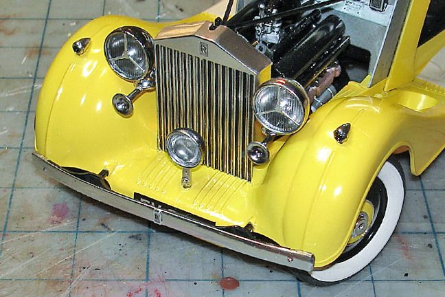

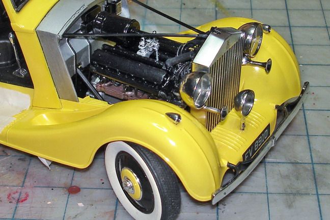

Harry P. Posted June 2, 2015 Author Posted June 2, 2015 A few front end details. All "chrome" is Spaz Stix. The radiator hoses aren't connected to the radiator yet... still waiting for the radiator/shell to dry completely first.

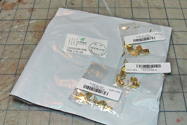

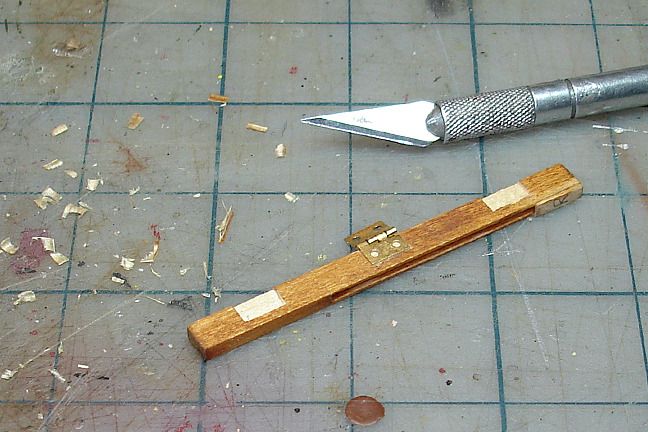

Harry P. Posted June 2, 2015 Author Posted June 2, 2015 The hinges have arrived from Hong Kong... Now I can hinge the doors and finish up this project. The trick here is to cut the mortises for the hinges just deep enough so that the hinge leaves will sit exactly flush with the surface of the post. If I was working on a real woody, I'd make these mortises with a router, but in 1/16 scale world, a sharp X-acto and a steady hand are what's needed. Each door has three hinges... that's 12 mortises I'll have to cut into the doors (3 per door) and 12 into the door posts (6 per post). So I have to cut 24 individual mortises, each one perfect (or as close to perfect as I can get). I have some woodworking to do!

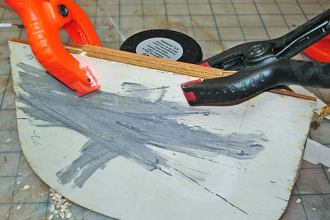

Harry P. Posted June 2, 2015 Author Posted June 2, 2015 The door posts are easy to work with... they're just solid pieces of wood, very sturdy. I can carve the mortises in them without worrying about breaking them. But the doors are another story. They are made of many separate parts, and are not necessarily "fragile" but still, I worry about snapping a glue joint while carving the mortises... so I use two thick scraps of wood and clamp the door between them, just exposing the door's edge where the mortises will go. Now I can hold the door between the wood pieces and not have any chance of snapping or breaking the door as I carve.

Harry P. Posted June 2, 2015 Author Posted June 2, 2015 I'm having problems with hinging the doors. Each door has three hinges, and in order for the door to open smoothly, all three of the hinge pins have to be in perfect alignment, otherwise there will be binding. In 1/16 scale, getting these hinges in perfect alignment is hard to do. The hinges themselves are very "tight" to begin with, there is no slop or play in them, and they don't operate very easily... it takes some effort to open and close them. If there was some slop, they wouldn't have to be perfectly aligned; the slop in the hinges would allow for some imperfection in alignment. But because there is no margin for error, I'm finding that once the hinges are glued in place, when I try to operate the door some of the hinges are just popping out of their mortises... the CA bond isn't strong enough to hold them in place if there is any stress on them as the door opens or closes. I'm trying to finesse things, trying to realign things as best as I can... but it's frustrating, to say the least. I'll keep trying, but I think I might ultimately have to get some cheaper hinges with more slop and looser tolerances to get the doors to work.
southpier Posted June 2, 2015 Posted June 2, 2015 is there enough wood to use a piece of upset brass rod in the hinge holes? or an escutcheon pin?
bill w Posted June 2, 2015 Posted June 2, 2015 Get the appropriate diameter wire and slide one side of the hinge ( all three) onto the wire and glue them to the door. Then take out the wire and attach the other side of the hinges and glue to the door pillar. They should open and close smoothly!
