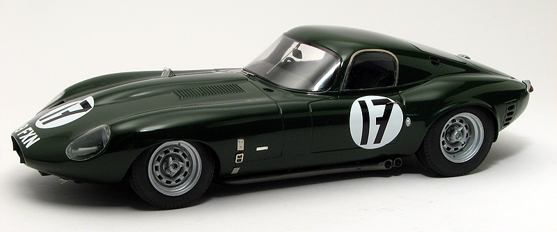

aurfalien Posted February 3, 2016 Posted February 3, 2016 I love this kit, albeit haven't personally laid eyes on it.http://www.profil24-models.com/model-kits-modeles-reduits/en/gamme-au-1-24e/77-jaguar-type-e-light-weight-le-mans-1964.html
Zoom Zoom Posted February 3, 2016 Posted February 3, 2016 (edited) I love this kit, albeit haven't personally laid eyes on it. http://www.profil24-models.com/model-kits-modeles-reduits/en/gamme-au-1-24e/77-jaguar-type-e-light-weight-le-mans-1964.html It's a great kit...very simple, I built this during the 24 hours of LeMans in '07: Edited February 3, 2016 by Zoom Zoom
aurfalien Posted February 3, 2016 Posted February 3, 2016 It's a great kit...very simple, I built this during the 24 hours of LeMans in '07: WOW, what a looker!!! Thanks for posting.

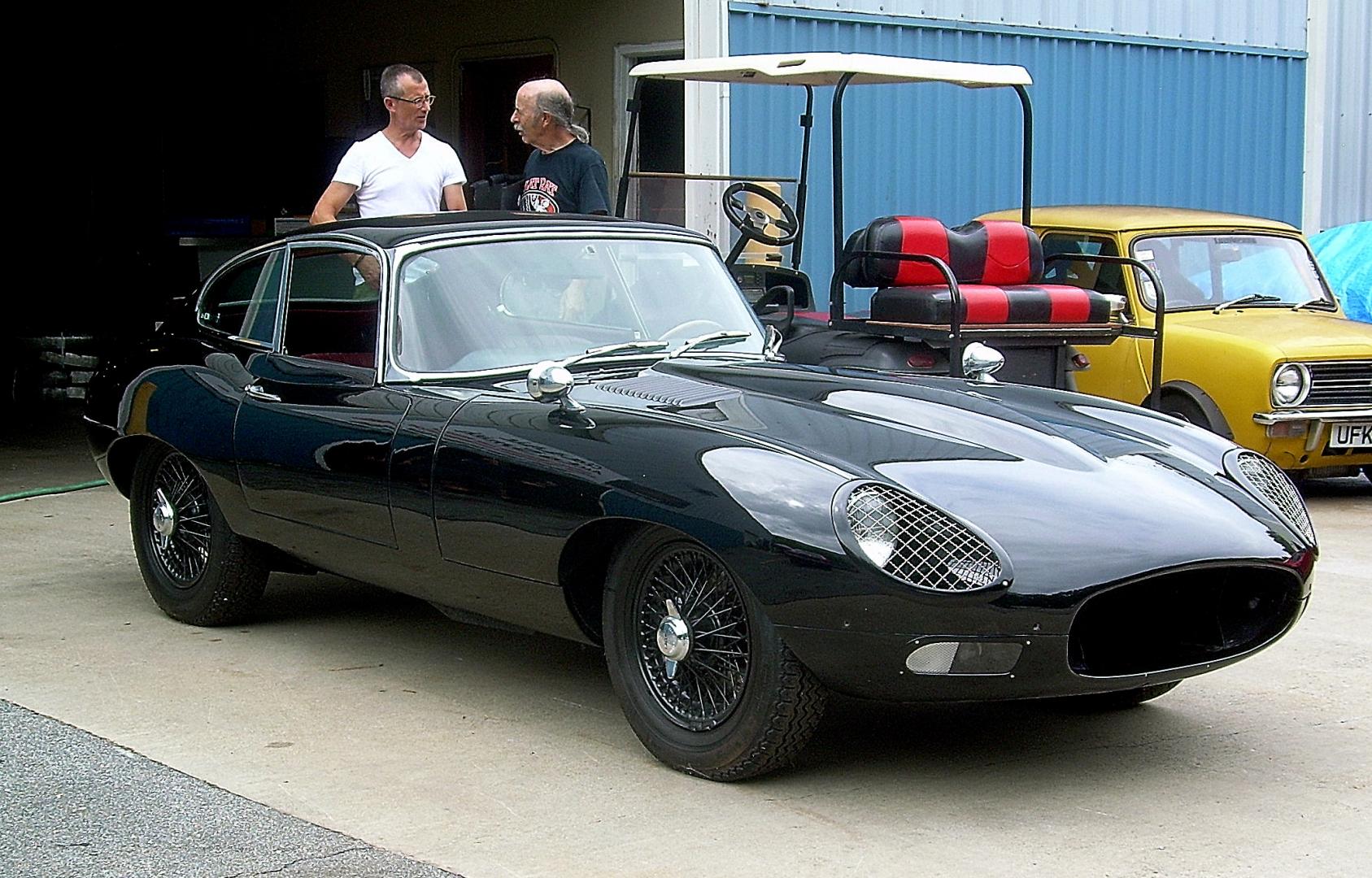

Ace-Garageguy Posted September 28, 2017 Posted September 28, 2017 (edited) Excellent design, especially that E-types are among my favorites. Great mods that add some muscle without killing the beauty of the original design. Did you use the headlights with integrated turn signals? Thanks. I was also very careful to respect the car's originality. All the mods are designed to be relatively easily reversible, should the owner decide to sell it off if prices continue to rise...though I believe he'll keep it no matter how high they go. Nice thing about the guy...he drives his cars aggressively. The engine in this is uprated from two SU carbs to the earlier 3-carb configuration, with hotter cams and headers. The provenance of this Jag includes time as a European hillclimb / rally car, and it's definitely had a hard life at some point, though the chassis structure has been rebuilt recently, and the interior has been redone in a beautiful dark red leather. The park / turn lamps on this car, also hyper-bright LEDs, are now located in the outboard segment of the new custom lower light housings, behind custom Lexan lenses. I felt that, to be fully visible when the rest of the lamps were illuminated, this location would be best. The headlights themselves are very bright Euro H4 bulbs, shown illuminated here, as are the LED H1 projectors (visible inboard of the signal lamps). As you can see, it's still possible to see the turn signal quite distinctly. That's not always the case when the signals are incorporated into the headlights. And I've been an admirer of Bo Zolland's work for a long time. Edited September 28, 2017 by Ace-Garageguy

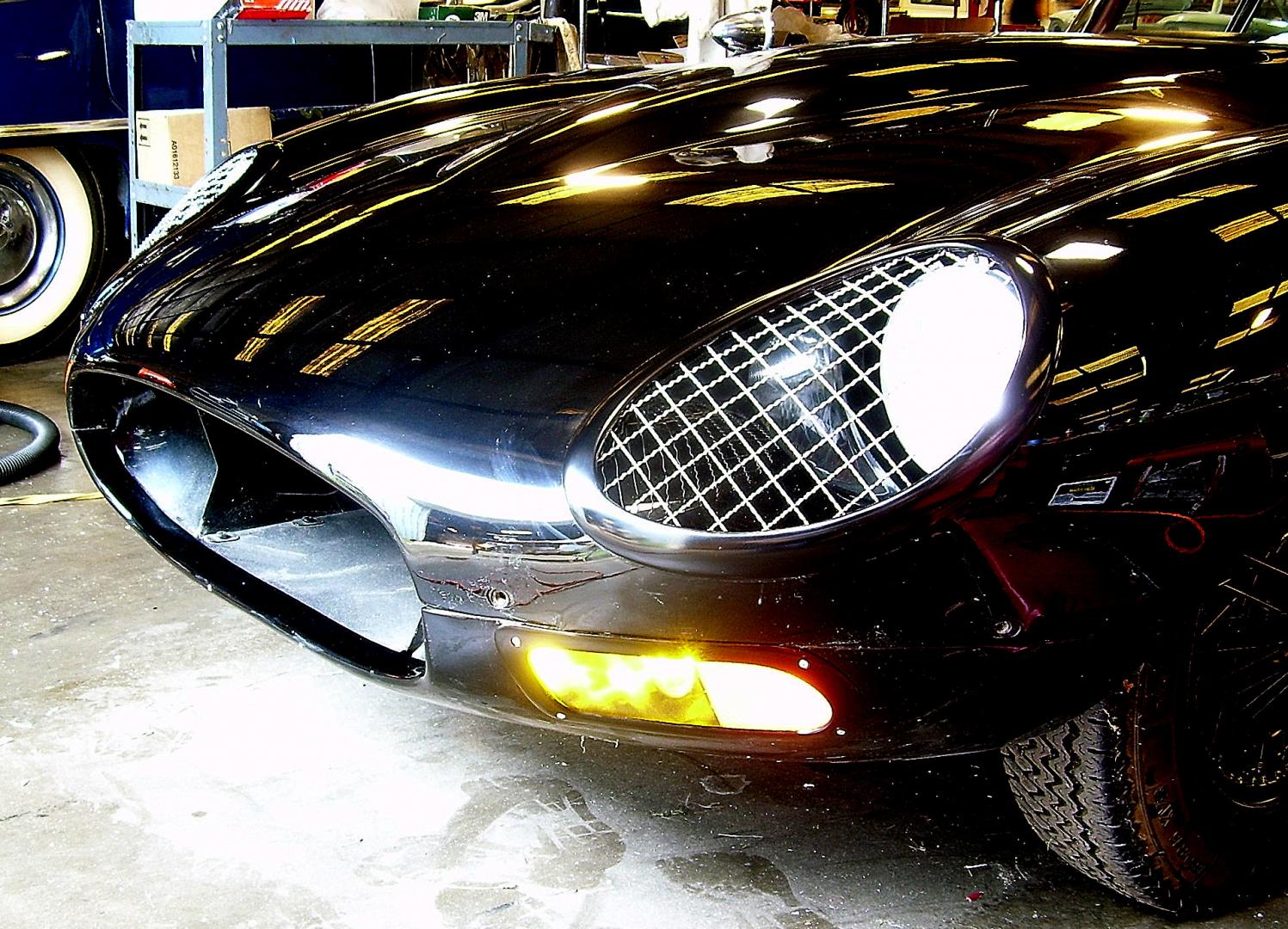

Matt Bacon Posted September 29, 2017 Posted September 29, 2017 Bill... since you've been up close and personal with one recently...For the larger "mouth", does the whole nose of the bonnet flare a bit to form it, or is it just a larger hole in the same shaped nose? It also looks as though the lower lip drops more, with squarer corners, and the upper curve is closer to the S1 shape. Just wondering whether, if you wanted to do the conversion, you'd need to Milliput around the nose and build up a whole new interior and exterior contour, or is just a matter of expanding the hole and blending in the new edges? I somehow seem to have acquired a couple of scrap e-type coupe bodies, so the cut and shut for extra length is feasible...best,M.
Ace-Garageguy Posted September 29, 2017 Posted September 29, 2017 ...For the larger "mouth", does the whole nose of the bonnet flare a bit to form it, or is it just a larger hole in the same shaped nose? It also looks as though the lower lip drops more, with squarer corners, and the upper curve is closer to the S1 shape. Just wondering whether, if you wanted to do the conversion, you'd need to Milliput around the nose and build up a whole new interior and exterior contour, or is just a matter of expanding the hole and blending in the new edges? I somehow seem to have acquired a couple of scrap e-type coupe bodies, so the cut and shut for extra length is feasible... Excellent questions, and I haven't ever really looked at it very carefully from that perspective. I'll be back in that shop next week, and should have measuring access to an S I, the black S II shown above, and a recent S III barn find. The shape of the cutouts for the headlights is also significantly different, and I'll post side-by-side pix on molds I made of the S I chrome rings next to shots of molds of my new S III black rings, with dimensions on everything I can think of. In the meantime, here's a shot of the S I nose from roughly the same angle as the black S II above.
Matt Bacon Posted September 29, 2017 Posted September 29, 2017 Thanks, Bill.. at first glance from those photos, it looks as though the radius of the lip going into the intake is much tighter on the S2, so maybe from a "look" point of view, you could just sand the oval out to a larger size at the top, and do the same with slightly squared lower corners at the bottom...best,M.
